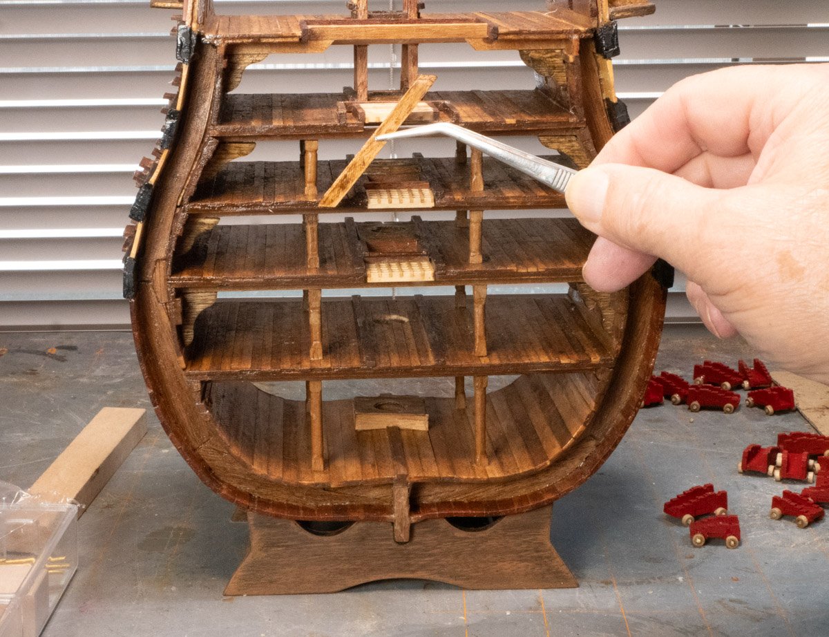

I'm making progress.  I added another deck.   I noticed that I placed the columns inline with each deck with the first columns, the kit shows the columns next to the center features.  I haven't decided if I want to move them of leave them as is and call it a personalization.

I installed the top deck but I didn’t want to install any pieces on the deck while handling the structure during the planking installation.

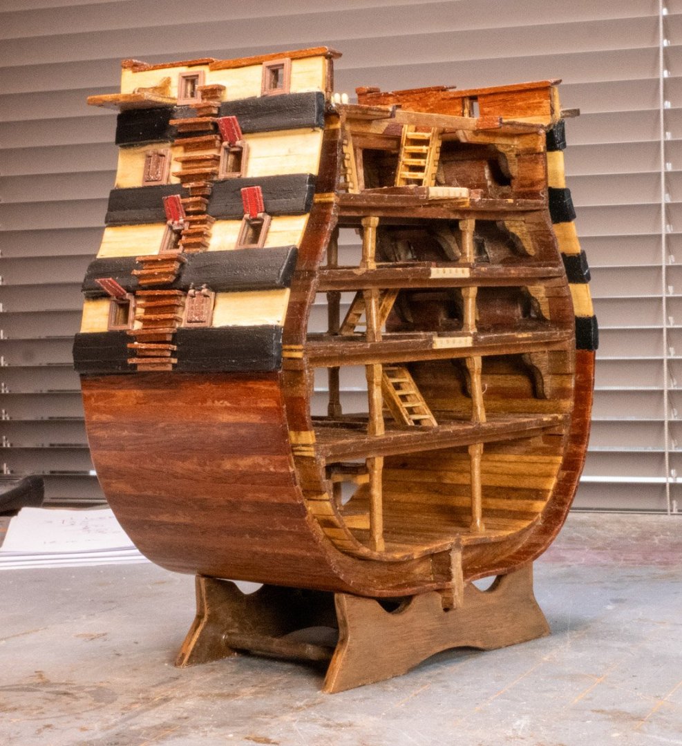

I installed the plywood gun ports backward.  I knew the ports were offset on each deck but after I installed them, I realized the gun ports in top piece were aligned with the gun ports of the lower deck.  I had to cut the tops off and glue them on the other end of the pieces.
I discovered that my kit had no 2x5 mm limewood stock for the light-colored planks.  I used basswood instead.  I also discovered that the 2x7 mm sapelli wood (item 91) included in my kit is too short for the gunwales (a new chellenge).
I’m making progress. I applied some finish to the planks before I paint the planks black to help prevent the paint from wicking to the light wood.
I've been making progress.  I figured the lower decks would be dark places but I think my staining turned out darker than I intended.  Before I installed the exterior planking I drilled pilot holes in line with the rear cross beams in case I want to add lighting in the future (I have not looked into lighting).  I'm trying to decide about painting the canon doors.
My fancy frame covering will probably not be noticed but I know it is there - I had fun making it.

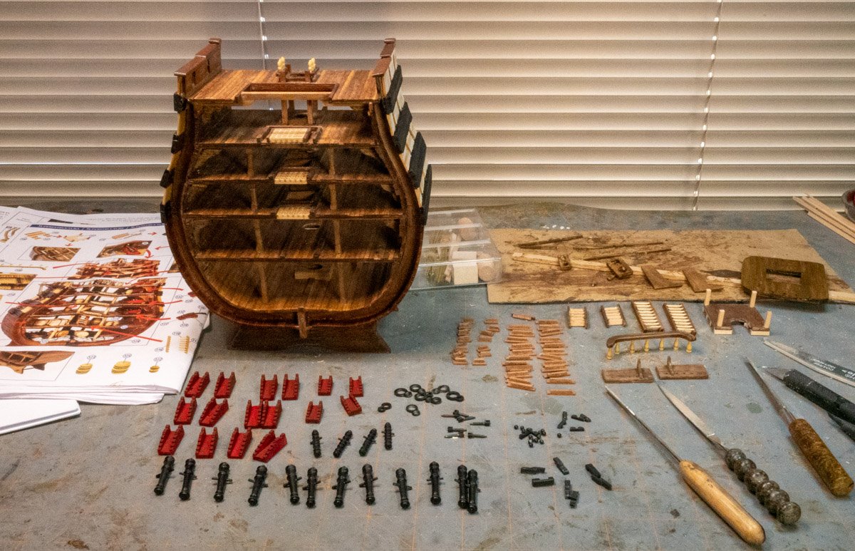

I evaluated the work I did last winter and the interior turned out darker than I wanted. The stain applied on the bottom of the hull turned out how I wanted but when I applied stain to the other levels, the wood turned out darker because the wood absorbed the stain differently from the stock used in the bottom.  I’ve been looking at other build logs and I might add some lights to the interior (I had drilled pilet holes for lighting during construction).
To ease back into the project, I’ve been working on processing various smaller pieces.  I’ve been doing some painting, staining, and assembling sub-assemblies.
The lower deck stairs were longer than they need to be because the height of the two decks is different.  The instructions call out 1x4 mm stock for the treads but I didn’t have any, the stringer slots measured 5 mm.  I glued 2 pieces of 0.4 x 5 mm planking from a previous kit together, cut the treads and they slide smoothly into the slots.  I cut the completed stairs to size.

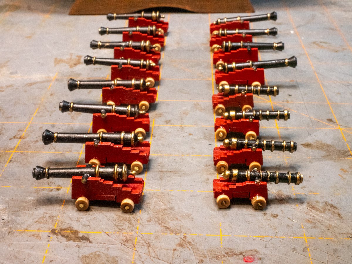

I made the canons.  I use an airbrush like a can of spray paint, mine has a pistol grip and a pull trigger.  With a fan nozzle it covers a good area.  I painted the canon black and put a coat of matte clear coat on it because I was going to try and use a brush to apply a bronze color to the rings and if it didn’t work it might be easier to remove.  It turned out OK but I had to touch up with black to cover errors with the bronze brush.  I used CA glue to attach the wire axles; when dry, I attached the wheels with CA glue, then I clipped axle wire as needed.

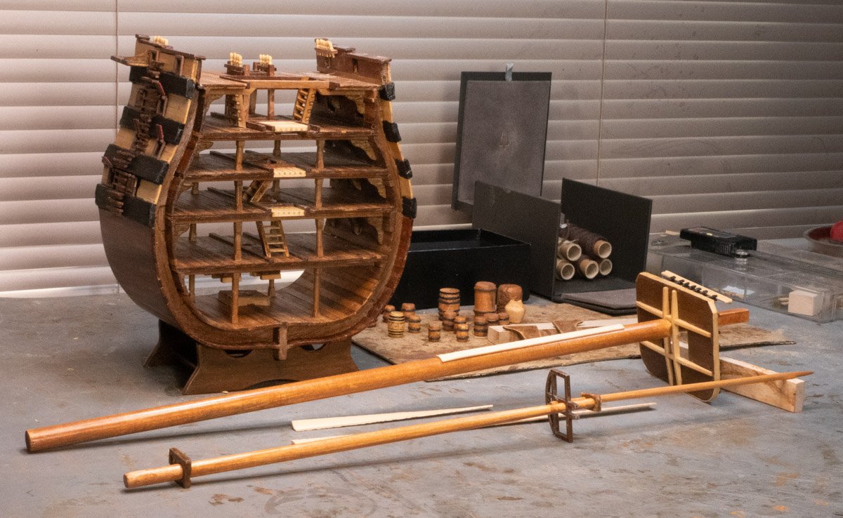

I continue to process various parts.   I’m reaching the end of the picture steps.  I’m scoping out the mast drawings to determine a procedure.
I had trouble with the bracing under the mast platform.  I broke one piece while handling it after I cut it from the laser cut plywood parts.  I broke another piece while assembling the structure.  I kludged the pieces together glueing them to the platform, then I discovered and had installed it backward.  I dissolved the glue and removed the structure.  While disassembling the structure I broke a third piece (leaving 1 piece I didn’t break).  I had to make replacement parts.
I removed the original cutouts from the plywood skeleton to make measurements, then I scanned the originals to create a file to cut the parts on my CNC spindle machine.
The first set or pieces I cut matched the originals exactly, unfortunately the material I used was a different thickness so I had to modify the notch dimensions for my material. (I made a pile of mistakes).
Now I have to figure out how to shape the mast from round to a square end.
