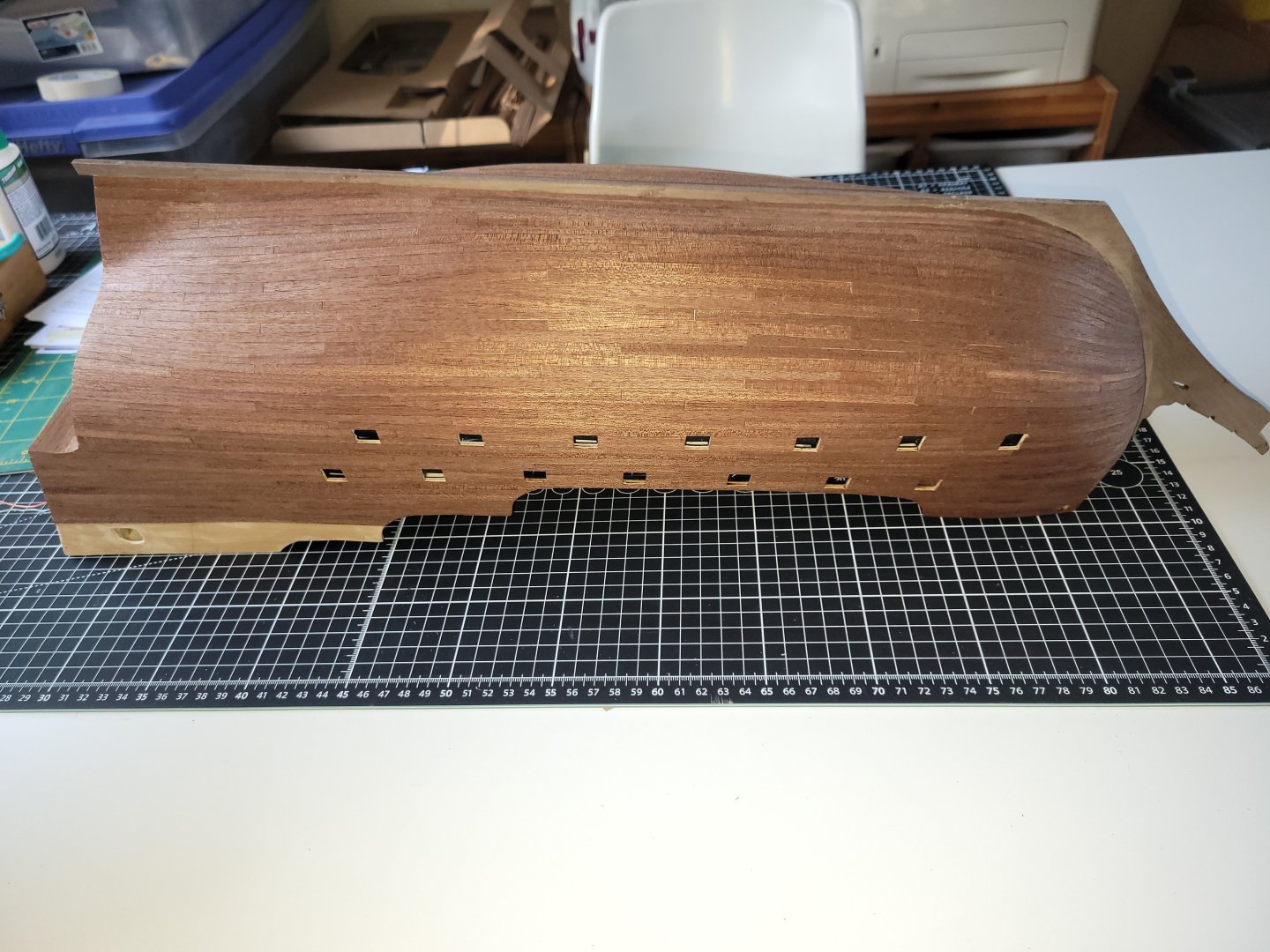

Been a long while.  Still working through planking the hull but work and other priorities have made this very slow.  I'm also treating the first layer as a final layer as practice for one day doing a single layer scratch build.  Isn't perfect but first layer is a lot cleaner and tight than prior builds.  I'm also painting a thick layer of black acrylic on the back side after glue set on each plank (with a bent qtip).  Testing as I go it's actually doing very well to eliminate bleed from the leds.  Getting a lot of bend at the bow and trying to avoid steelers/drop planks as I go on this so we will see how it ends up.

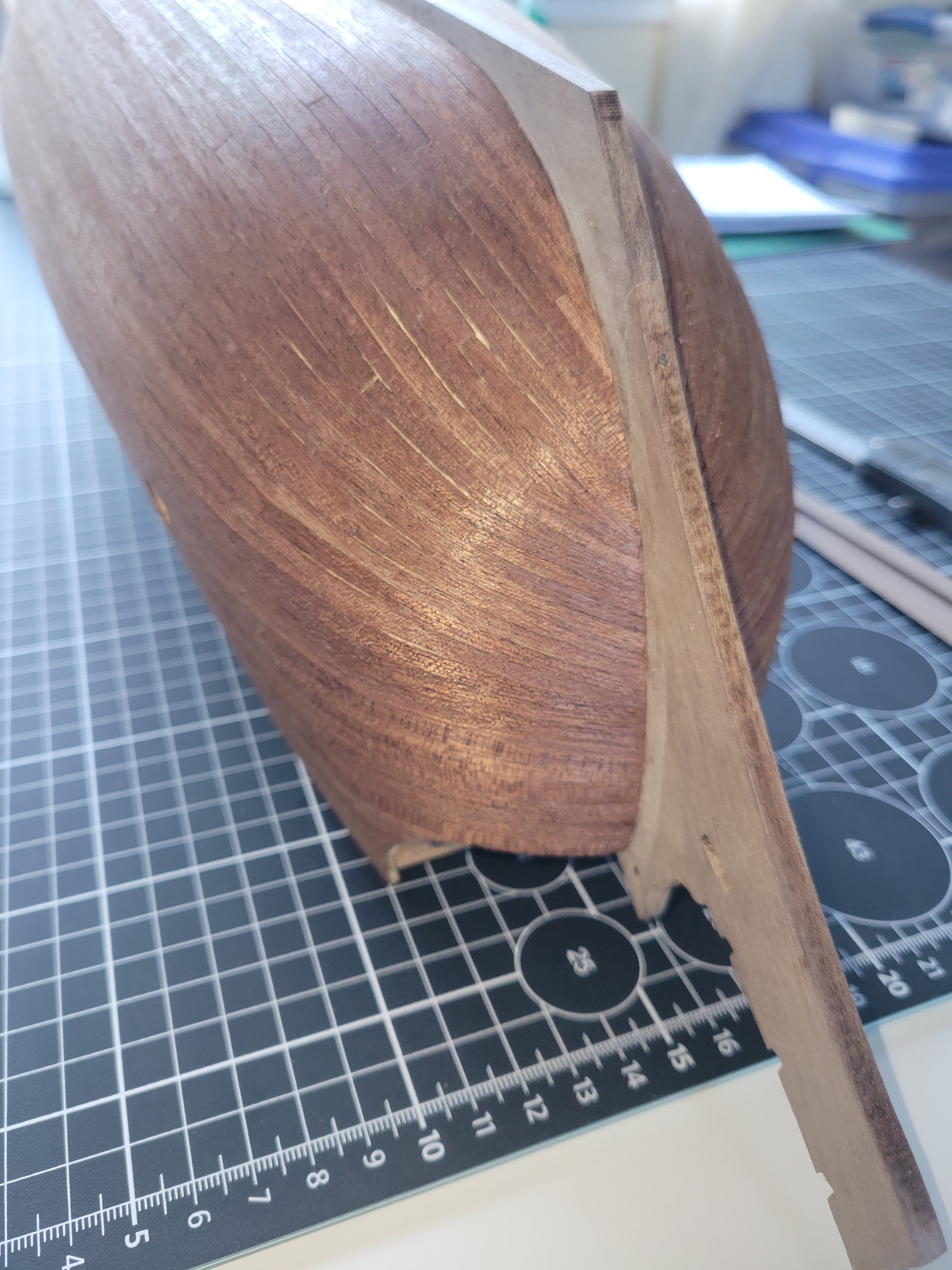

Hull is planked.  Sanding and filling now.  I tried planking like this was single layer.  Came out pretty good for me but still need another round or two before I'm actually ready to do a single plank.  But should be a nice underlayer for the second plank.
Edited by travis

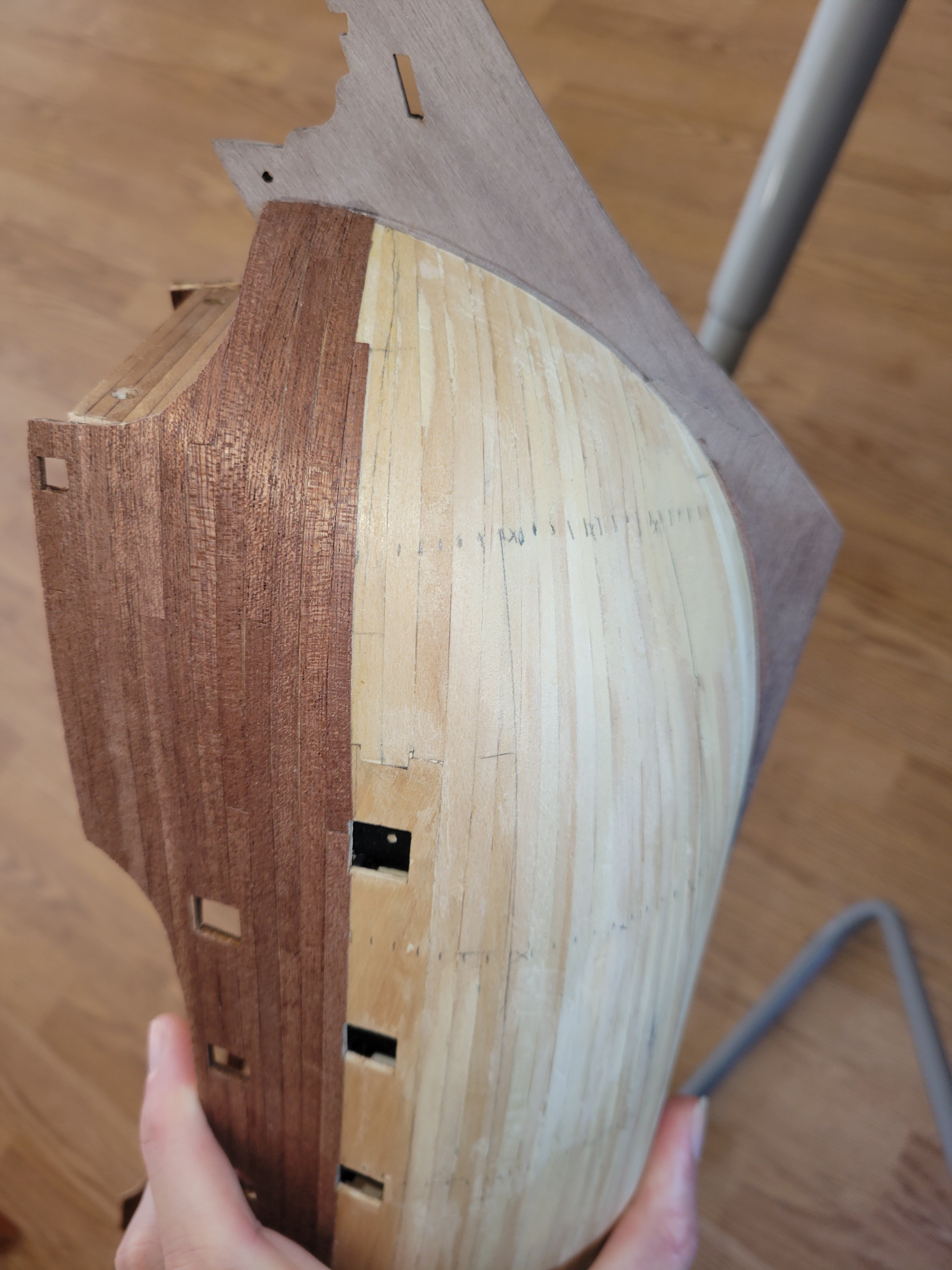

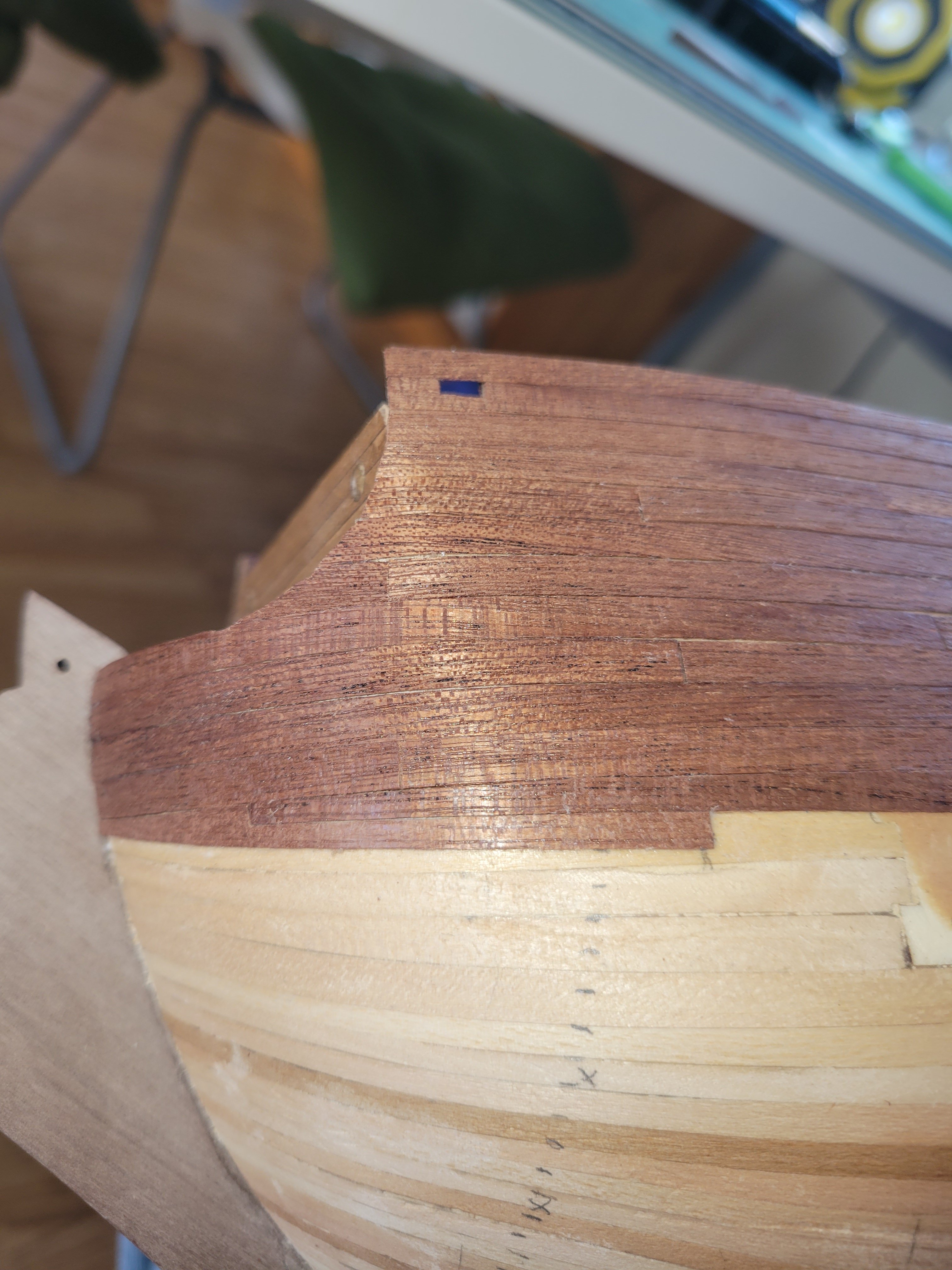

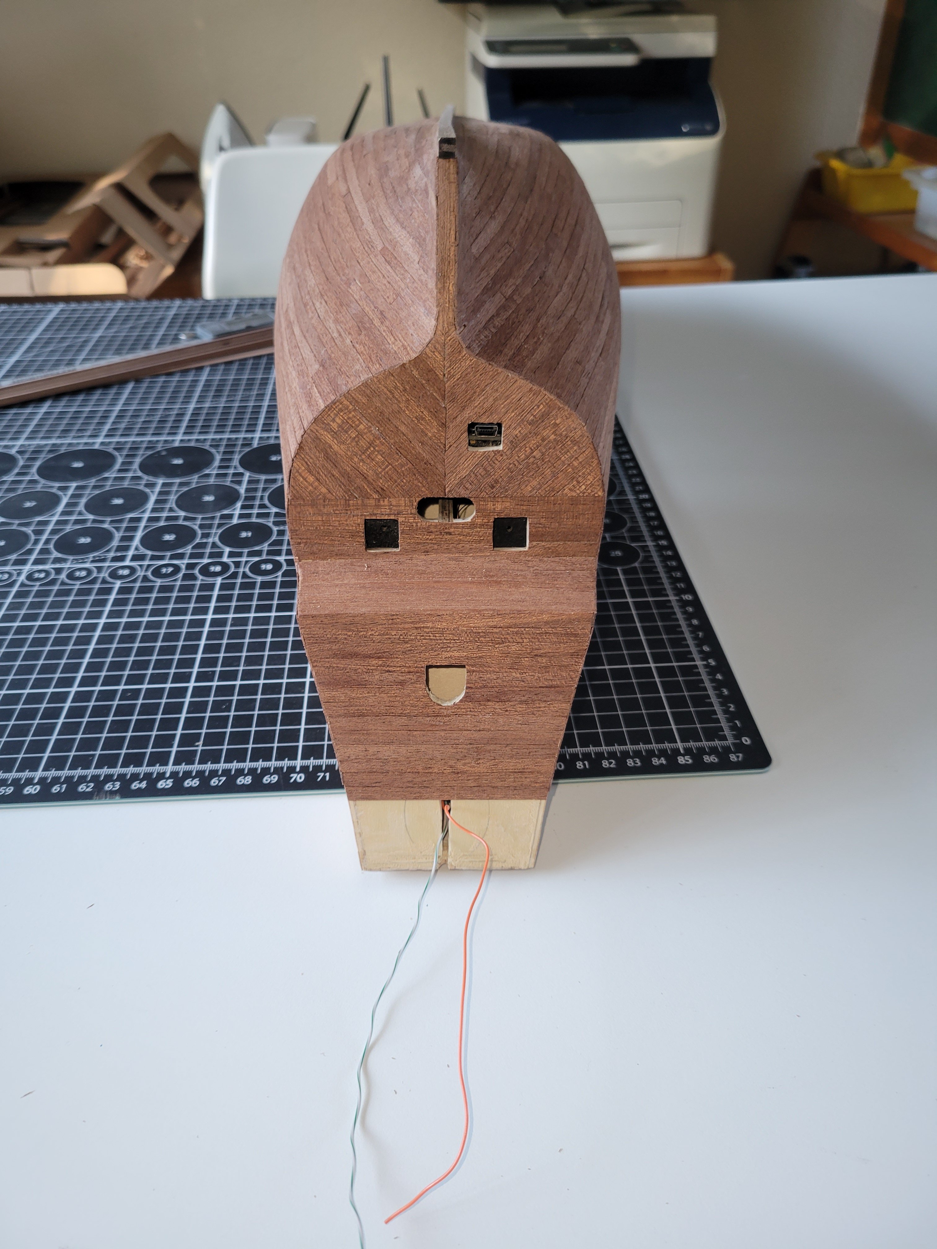

Decided to set the keel before the final planking so I can get a clean finish (even kinda did a kerf in the bow to help hold the planks flush ).  Planked part of the stern, set the garboard and first full plank at the Wales.  A big change using contact cement but I see how it is beneficial for the final plank if you take your time.  Nice to have the planks stay exactly where I put them. Now to plan, measure and cut all the tapers!

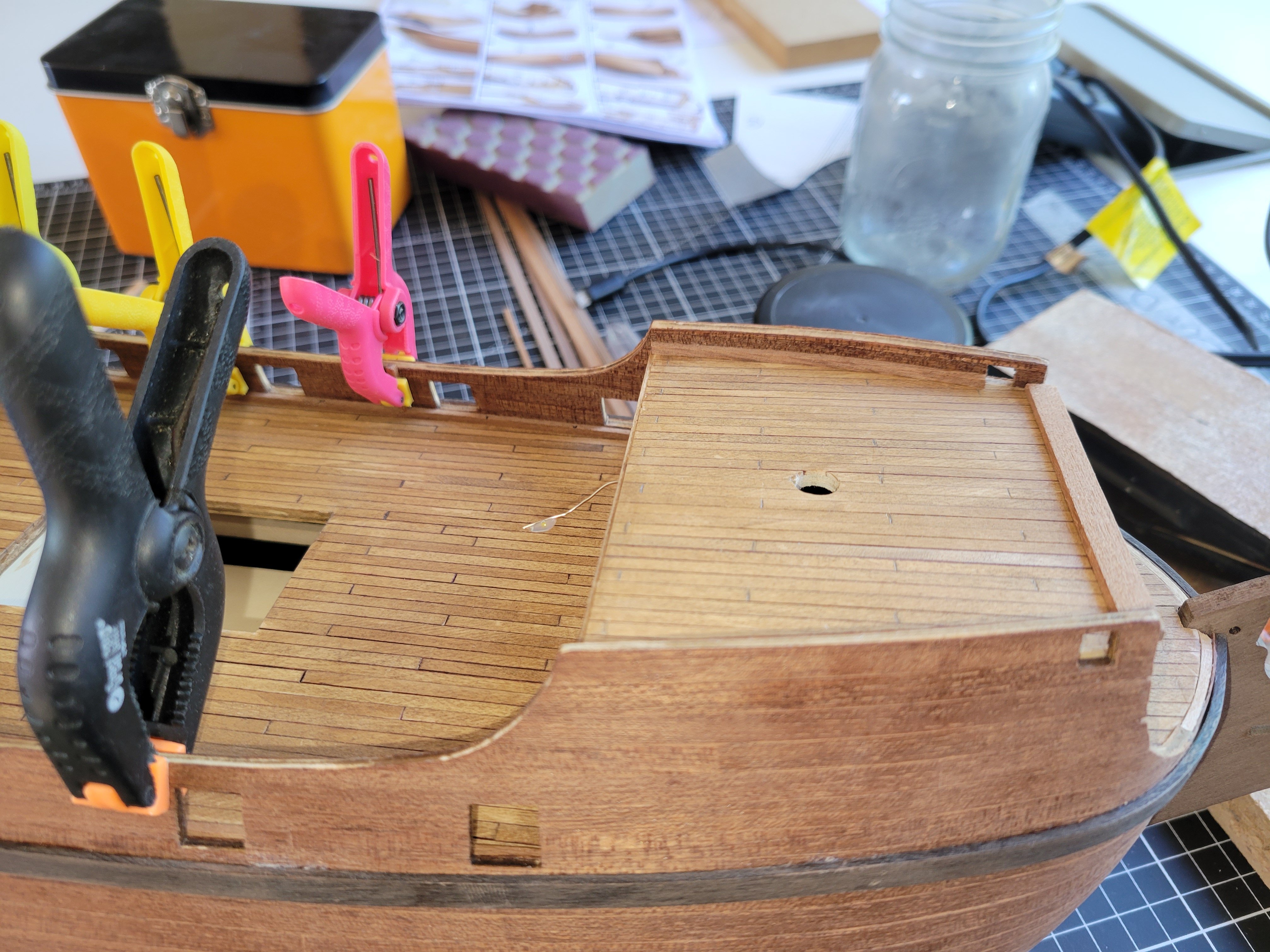

Took a long time but the hull is finally planted!  Got a little left to do at the upper stern but I'm holding that until I get further along and ready to wire in the aft lantern.  My first layer was treated like a single layer and came out pretty good for first time trying to have that layer at finish quality.  Second layer came out even better.  So glad I cut all the planks to actual scale plank size rather than. Trying to bend full length straps.  Allowed for a lot of adjustment as I went, especially with the more intense curves at the bow.  Time to figure out bending the strokes.  Haven't decided if I will cur them into smaller sections or not.  Going to make a bending jig similar to the one amati sells and see how that works.

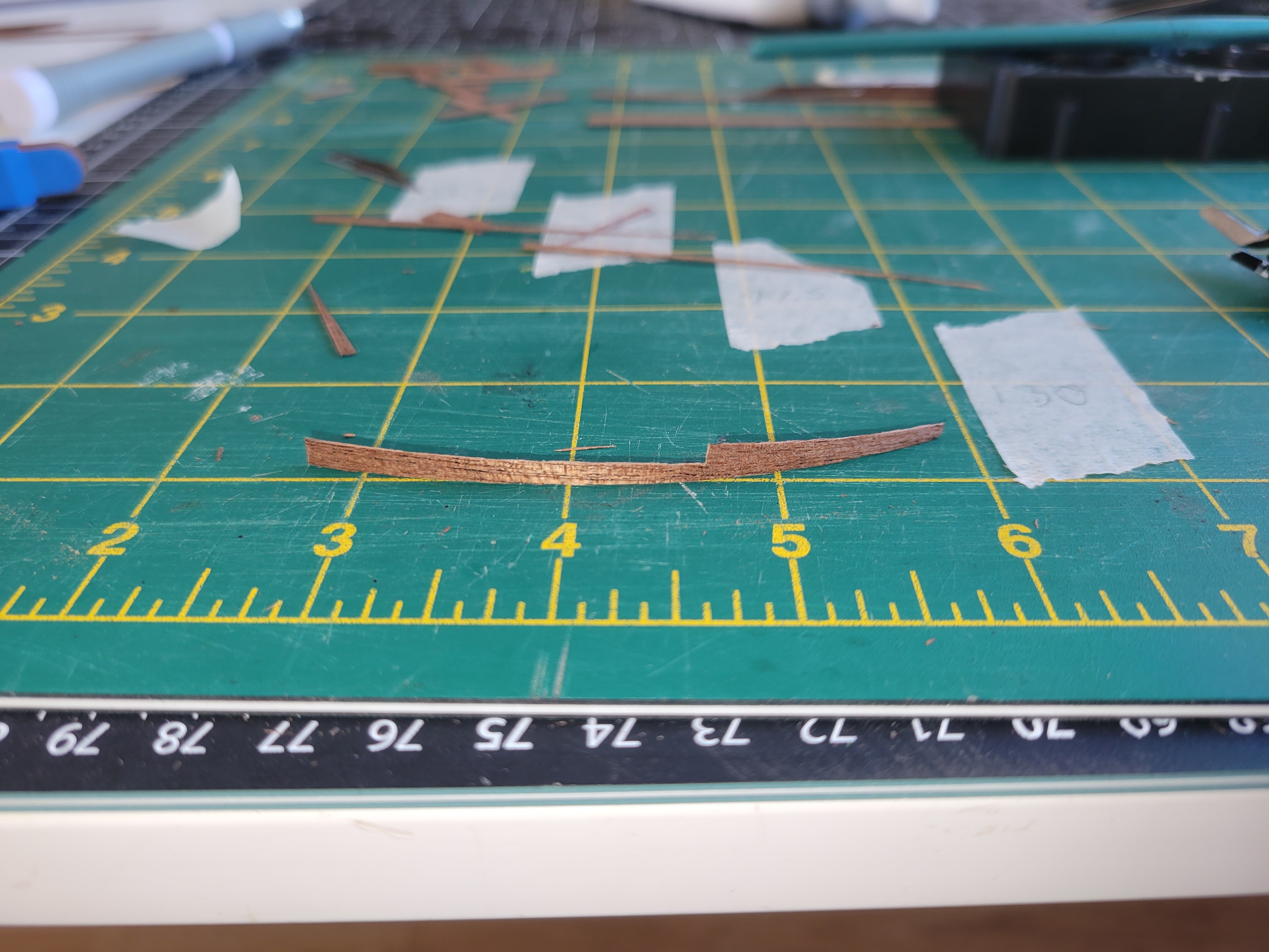

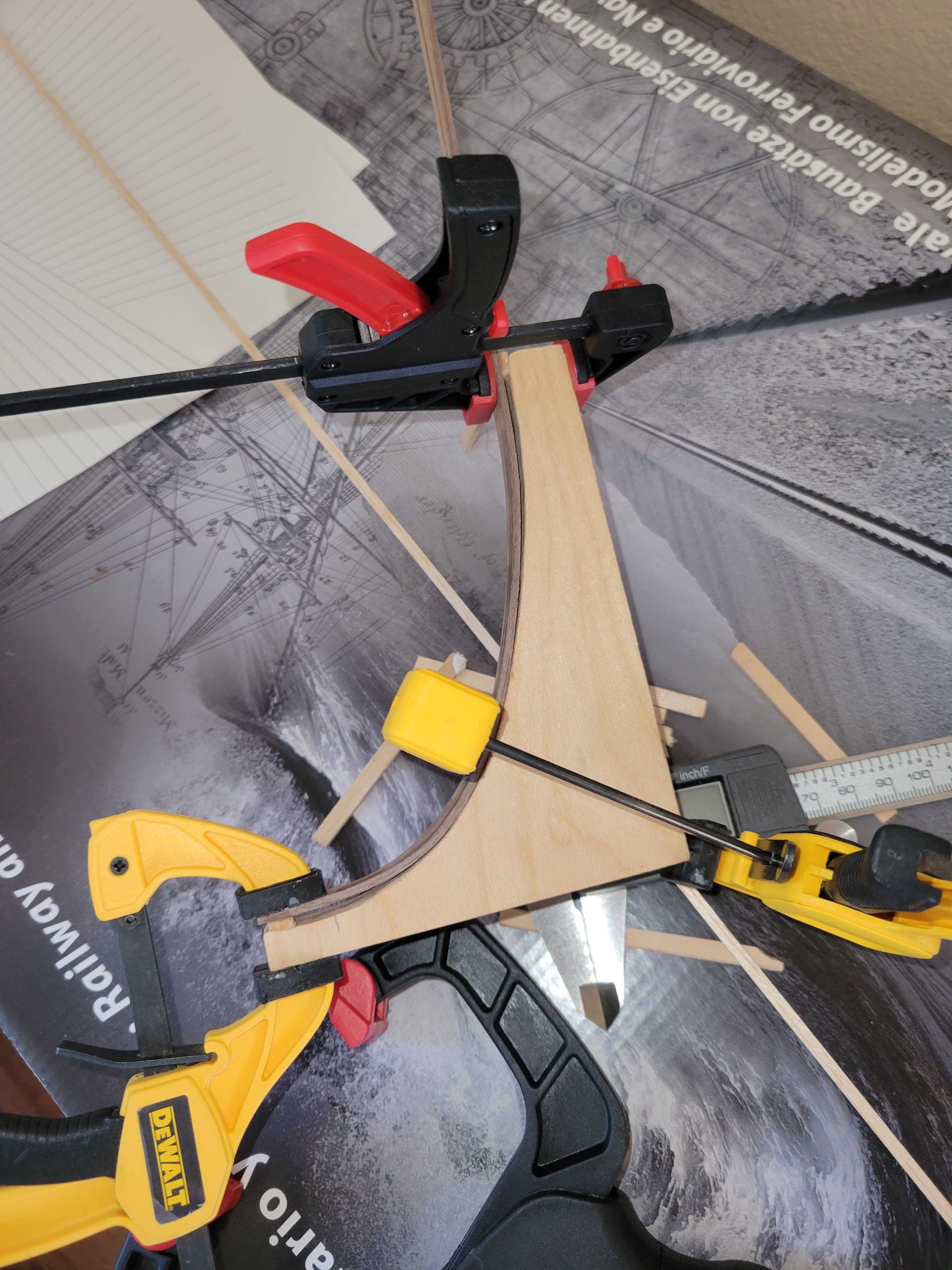

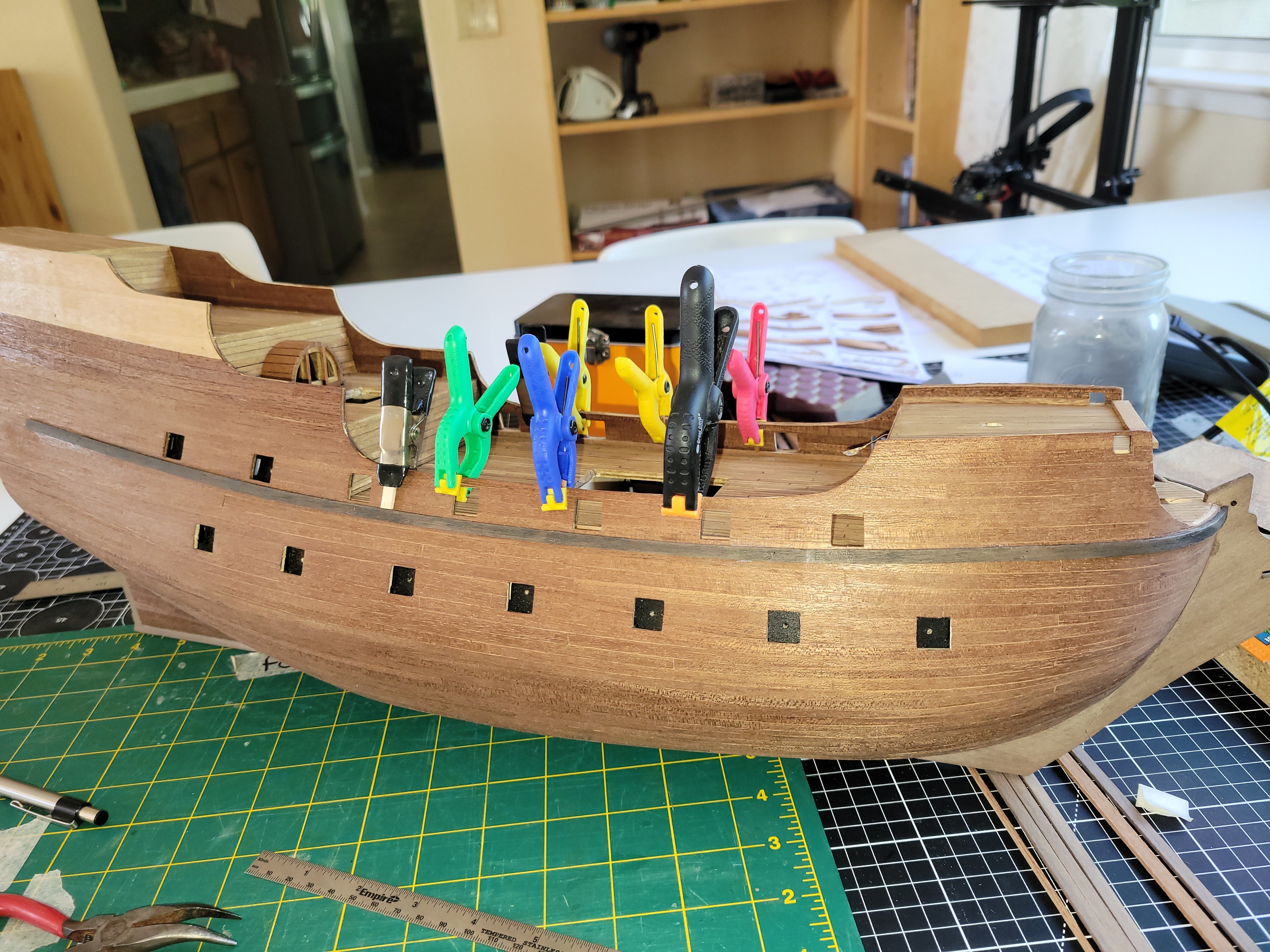

Couple updates.  First wales bent, stained, and glued.  Running parallel with doing other wales (extra time for bending), limber boards, waterways, and stations. Cut an scrap plywood for a bending template.  Using a soldering iron (reduced accordingly!) And then clamp and time to get the bends.
