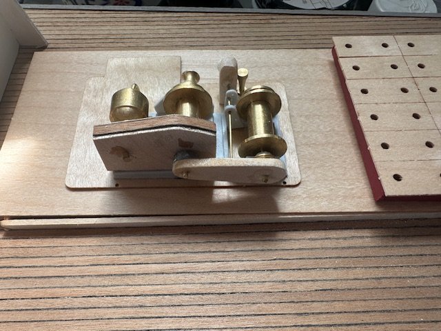

I had time to work a bit more on putting together my wench assembly today. Feeling a bit like a watch maker at times with the variety of interesting brass parts.
Once painted, I will add the four posts and the canopy.
I added a small, curved wire to the electric motor and have it disappearing under the platform to simulate an electrical supply conduit.
It has been fun working on the crane and wench, but I am now ready to get back to working on the ship.
