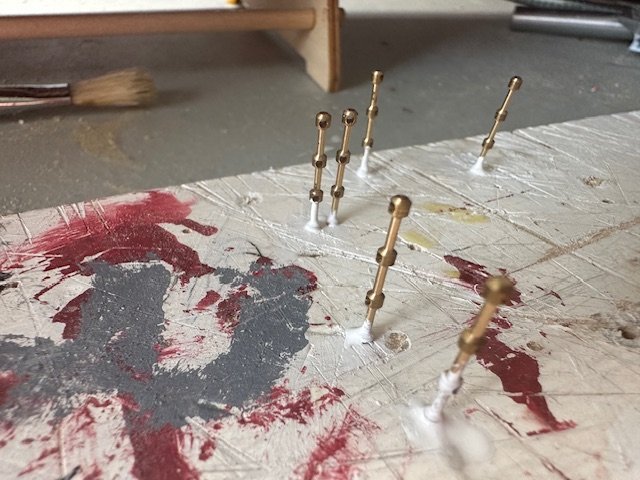

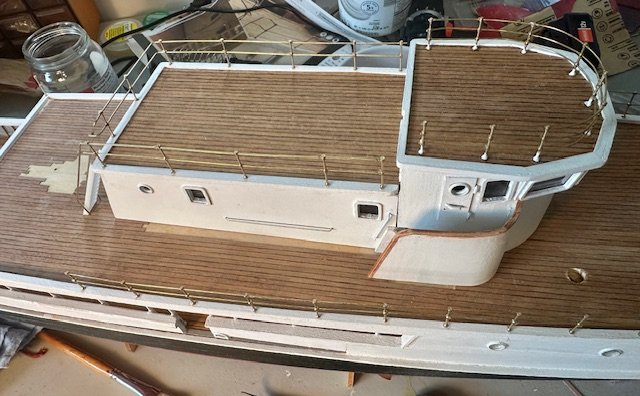

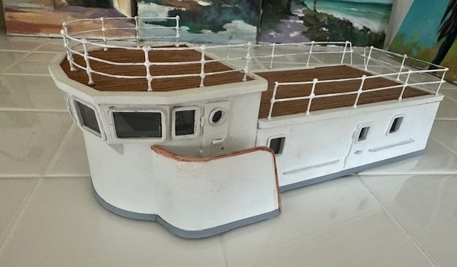

Installed the lower safety rails today.  Began by dry fitting running the wire through the stanchions to line the stanchions up. Once dry fit, I began gluing the stanchion bases in place.
Then added a small dab of thin super glue to all of the joints. Next, the safety rails over the pilot house and upper deck.

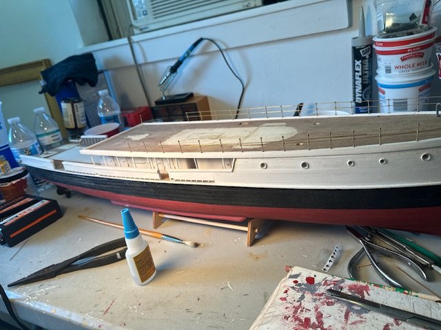

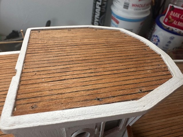

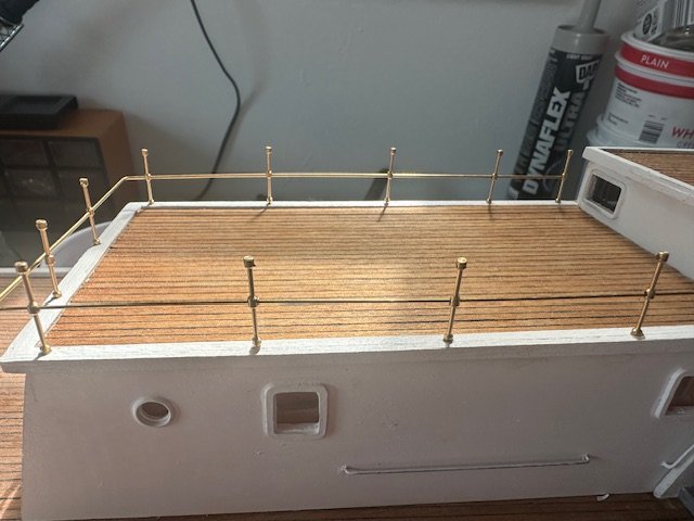

I came back this afternoon and started the wheelhouse safety rails and the upper deck safety rails. The rails above the wheelhouse are set in natural wood decking so I placed the stanchions in predrilled holes and painted the bases careful not to get paint in the holes. This will help when it comes time to paint the rails.
Back at it today.

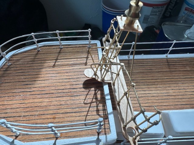

For whatever reason, I was not looking forward to the safety rail installation. I thought of it as threading a number of small needles but in this case, threading multiple thin wire strands through stanchions. It turned out to be tedious but not too bad.  Patience required :0)

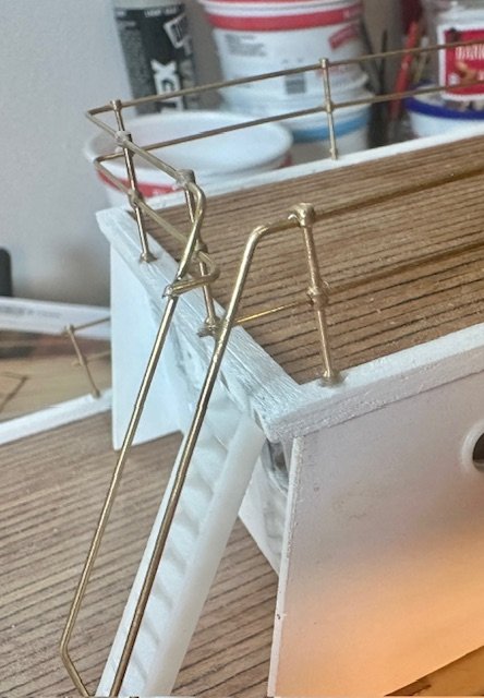

I was careful to try and get the downward sloping rails at the same angle as the stairs so temporarily had the stairs in place.
Now to add safety rails to the bow pulpit and to paint these safety rails.
Thanks Alan. If I had not had the ladder temporarily in place and guessed the angle, I would have been way off and as you said, it would look very wrong.  I appreciate you following my build.

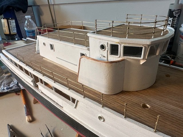

I put some white enamel on the railings previously installed which makes the safety rails fit in with the ship.

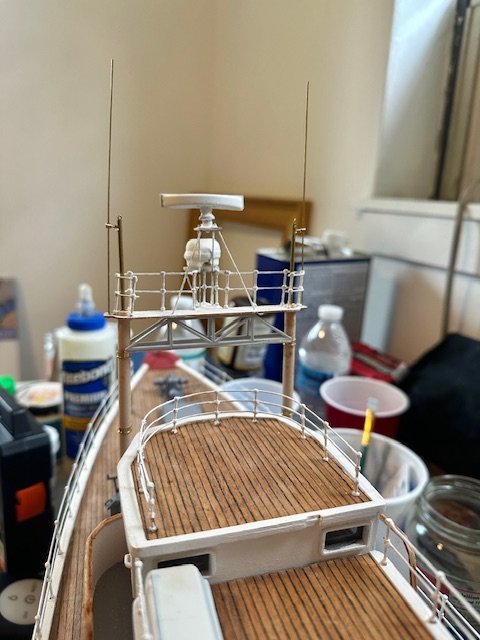

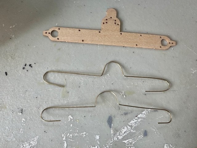

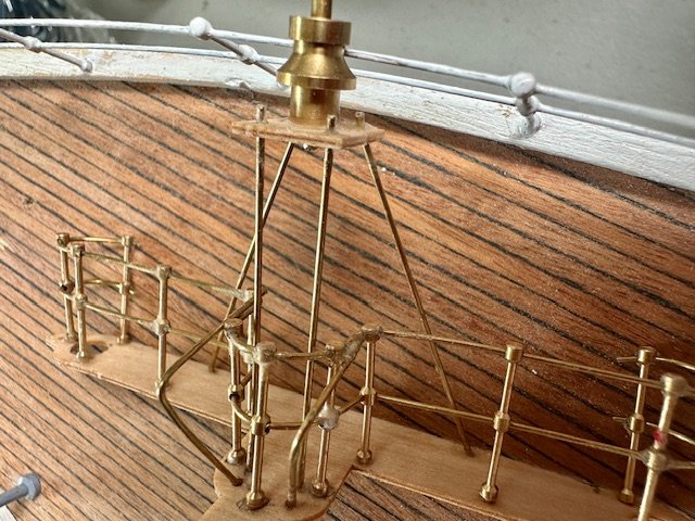

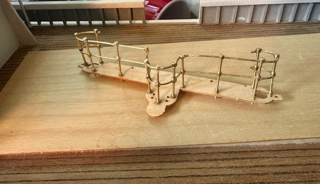

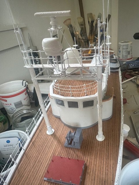

Since I was in the railing mood, I began the safety rails for the upper mast observation platform. It was a bit challenging to make two identical matching wire shapes.
I ended up using a pencil to form the outer curves and a larger ball point pen to form the two forward curves.
Then slid all of the rails in place onto the two wires and began gluing down the bases.  Finally straightened the post vertical and added a dab of Ca glue to all of the joints.
To begin with, thanks to you that are following this thread. We may never meet, but I feel some level of support as I plow ahead on Calypso.

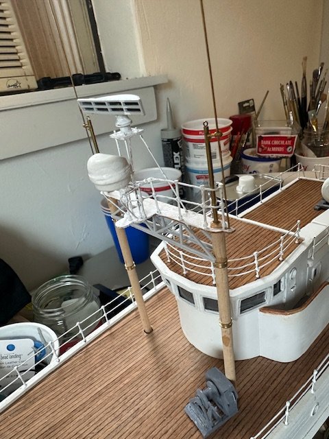

Today, worked on more detail of the observation platform above the masts. There is a four-legged taller radar platform and some forward supports for another satellite communication.
Happy with the progress. There is a lot of detail in this small section. More antennas and wind indicators etc. to come.
This structure will be atop the two forward masts.

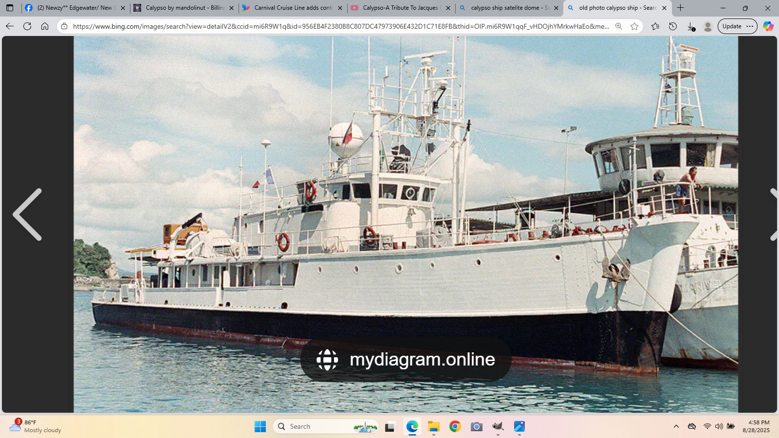

I think the radars on the mast are not correct.  The upper one is a very early 50's (probably K-band), and the lower is probably from 80's.
The model depicts Calypso in 80's era (see the satcom antenna cover, the big 'egg' behind the bridge), therefore i'd change the radars for more sleek nautical models like those on below pictures:
image.png.f695b7a00c447325d64e059587c451cf.pngimage.png.129caf5a3c82e65380f48ed0adcd6ff0.png
Also i'd model the iconic circular storm-visor on the middle window of the bridge:
Edited by Veszett Roka
typo elimination
Thanks for those wonderful photos Veszett.  They will join my collection of Calypso photos. I will be adding "the big  egg"  satellite dome later.   Interesting to see the narrower thinner radar.

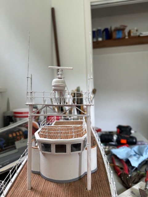

I went through many digital photos of Calypso and could not find any with the radar type included with the Billing kit. It was easy enough to remove the old one and replace it with a carved wood Decca type radar as seen in all of the photos.  Thanks again to those of you that pointed this out! There are so many details and visual candy on this ship it is easy to miss one of the details.

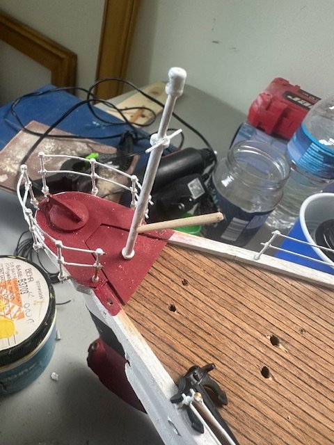

Installed the bow rails today and painted the double mast assembly.
Here is before and after regarding the radar.
BEFORE
AFTER

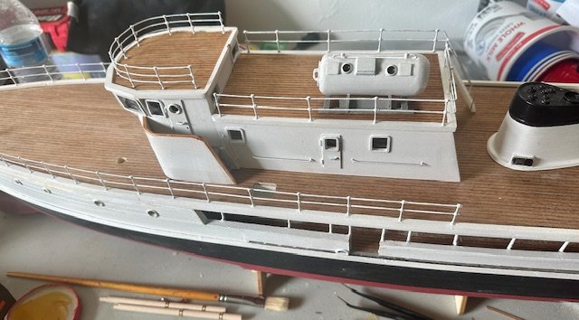

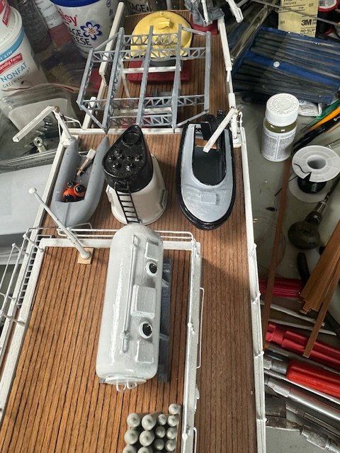

Today, I believe I finally finished installing the last of the safety rails.  Time for a cold one.  These are the two aft pairs of corner safety rails for the upper cabin top. There will be a flexible line connecting these to the other forward safety rails. Also began the two upper cabin top davits and the flagstaff.

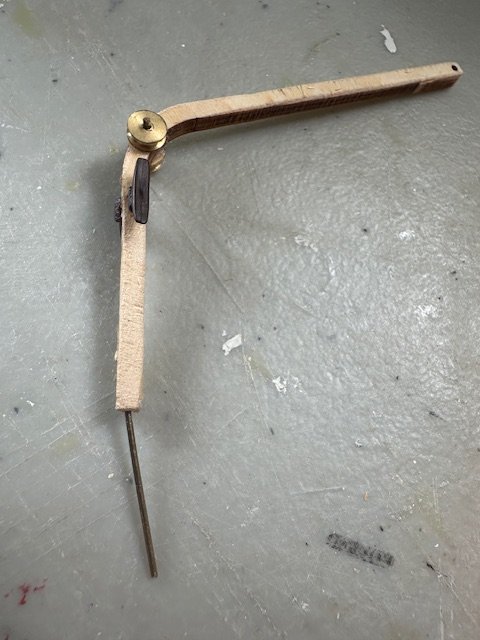

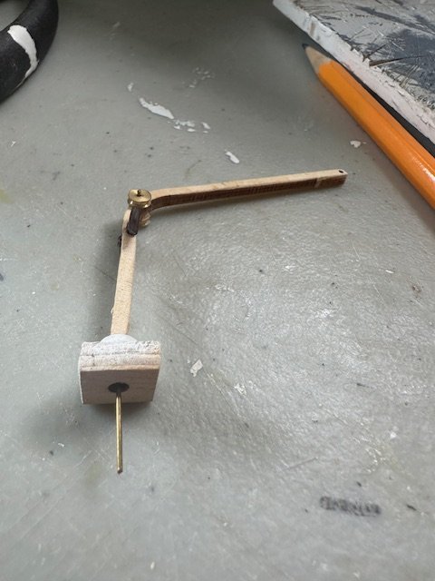

I decided I wanted the upper davits to be able to pivot (as they do) so I could decide later to put them in any position I wanted. I drilled a small hole through the brass base plate and another hole at the bottom of the lift and inserted a small brass rod. should work out well.

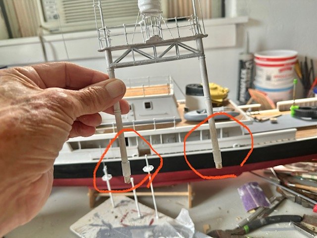

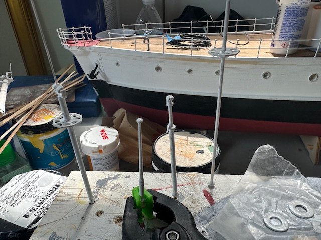

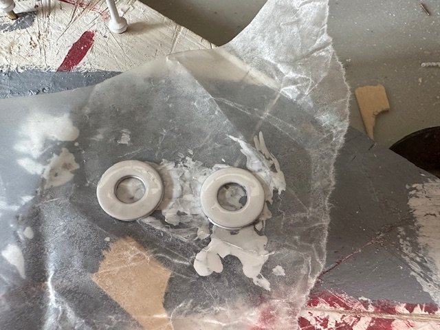

Then built up the base of the two masts as it appears in old photos to represent a pipe within a pipe for more strength. I used painter tape. There are two washers painted that this will insert to before going into the deck holes.
Also painted the running lights and assembled the communication antennas. Really enjoying this journey.

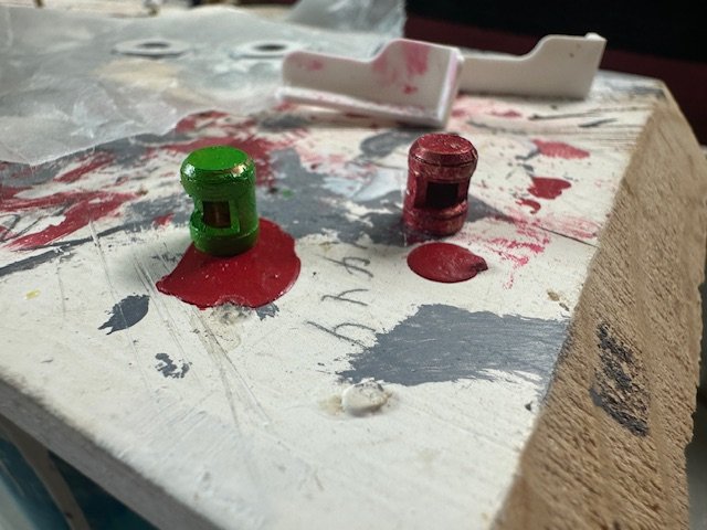

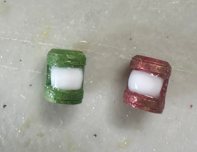

I used the same Micro Krystal Klear I used on the port holes to create a lens for the port and starboard running lights. It will dry glass like clear.

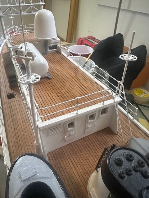

Finally glued the upper cabins and pilot house to the deck. Also glued the two larger masts in front of the pilot house.
This allowed me to add the two communication towers aft of the upper deck.

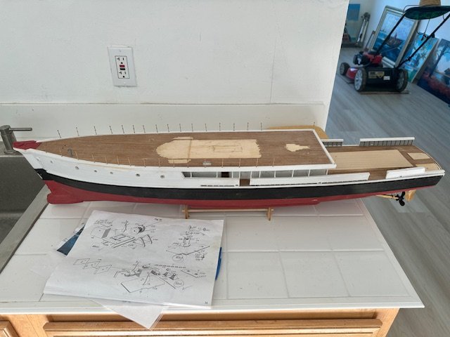

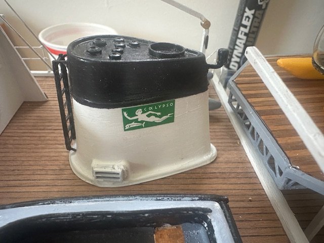

Then added decals to the smoke chimney and found out my starboard decal would not fit due to my door height being too tall, so removed the door and filled and sanded smooth. Then added decal to let me know new door height and position.  (port side shown)

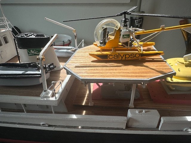

Lastly, planked the helicopter landing platform.  I did not have enough mahogany strips to plank it all the same so dug into my lumber yard and found similar strips that were a bit lighter. I like the way it turned out, sort of a teak and holly look.  Added siding to protect the thin delicate planking and give it a more solid look. As Mark Twain said, "Don't let the truth get in the way of a good story"
