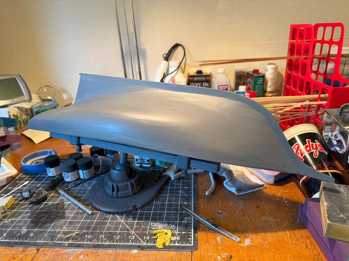

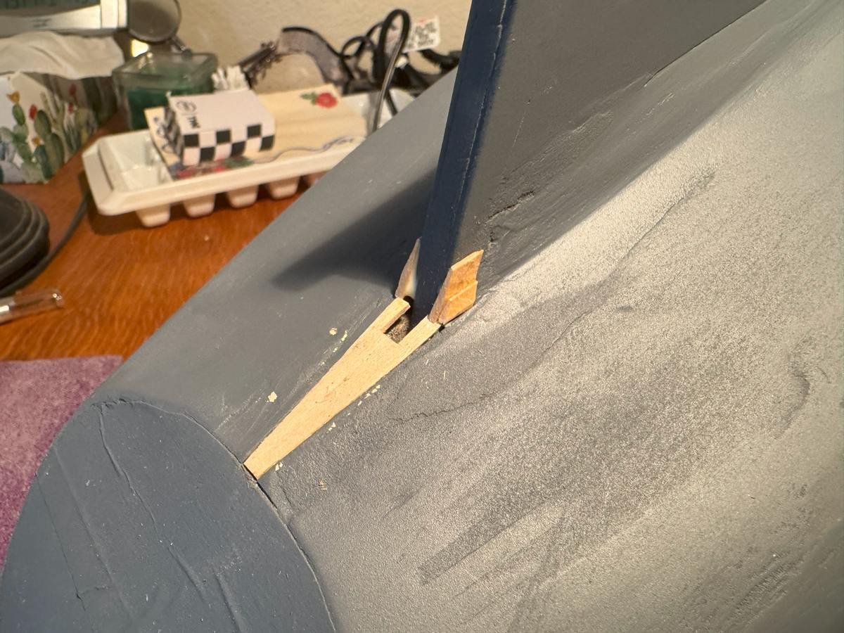

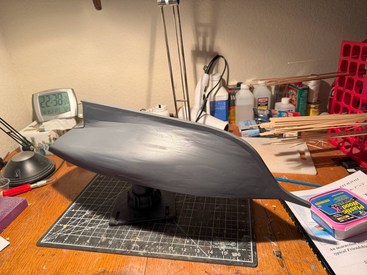

I've applied the next coat of primer and I also patched up that little hole between the stern post and transom.   Obviously I need to do more filling and sanding around there once the glue dries.
Looks like I still have a few small spots elsewhere on the hull that I want to add some filler to, and then another round of sanding and priming.   So far I've just used 120 and 320 to sand it.  I think this time I'll go to a higher grit and try to get down to a final smoothness, then one last (I hope) coat of primer).
I am still thinking white or off white top sides and green or greenish blue hull but I have not settled on anything 100%.  I am almost ready for that but should determine what other parts, like the rudder and rudder post, should be painted at the same time.
And pay no attention to the clock in the background, I obviously don't.  I took those first two pictures around 9am on April 24, not last Friday night 😆

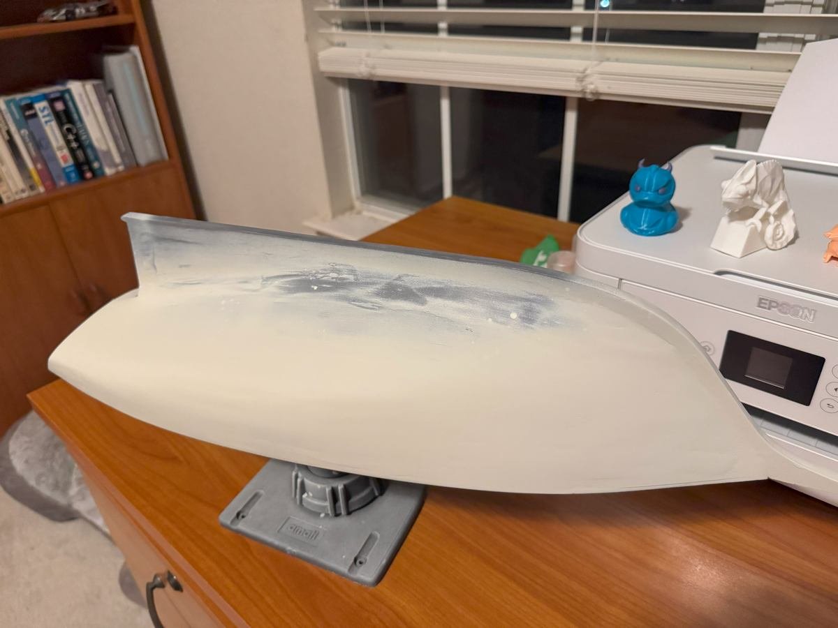

Primer coat number 3.  I am going to resist the urge to use any more filler and just sand this down a bit and do one more coat of primer, once this coat cures a bit more.  There is one place where I have just about sanded through the planking but I have access to that part of the inside of the hull so I can put in some reinforcements.

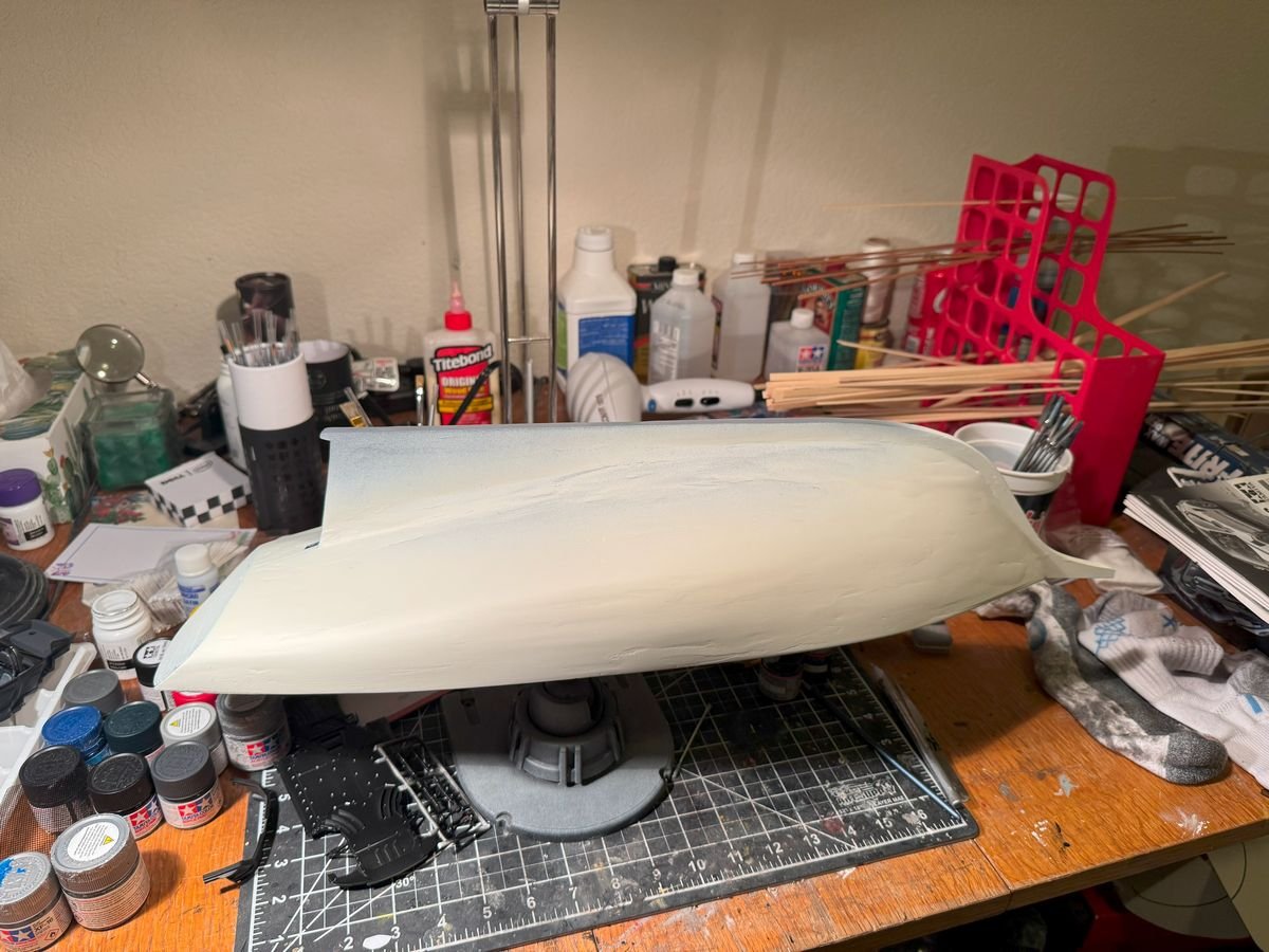

I've done more sanding and yet another coat of primer.  It is still far from perfect but getting better, and of course without the bright lights the imperfections are less noticeable.  I will also say I do not recommend that wood filler I have been using.  It seems difficult to get a good smooth finish with it, and somehow it seems inconsistent when you sand it....sometimes it sands off easily other times the edges continue to show even after sanding.  This latest coat of primer is still curing; I'll probably decide tomorrow if I am going to work it more or say it is good enough.IMG_2365.jpg.1dcdf2cb888aec793a1e01bbc6cab673.jpgIMG_2366.jpg.7a9aa72273d38fa04b152640bbf502b6.jpg
Ok, one more round of sanding and priming.  I swear I am done this time.  I'll let it cure a day or two then do some light sanding, draw a waterline, and add some color.  I bought two more rattle cans of paint....and off white for the top sides and a dark green for the bottom of the hull.

I wouldn't know a George Strait song if it slapped me in the face, but I can see why that song came to mind.  Note that I did not say how many iterations of sanding and spraying I was going to do with the color coats.
And speaking of that, I finally sprayed on the topsides off white color.  The color is not quite as off white as I expected but it will do.  And yes those flaws in the finish on the side do bother me a bit so I guess I am not done sanding.  Once I am satisfied or tired of it, I'll tape off the water line and repeat with dark green below the water line.
Ok, I sanded down the color coat (just once!) and repainted and it is looking good.  Now to mark the waterline, tape it off, and paint the hull with the dark green paint.
Haha....I see now some of the test prints from my recently acquired 3d printer in the background.   I took this shot by my computer instead of in the modelling room.

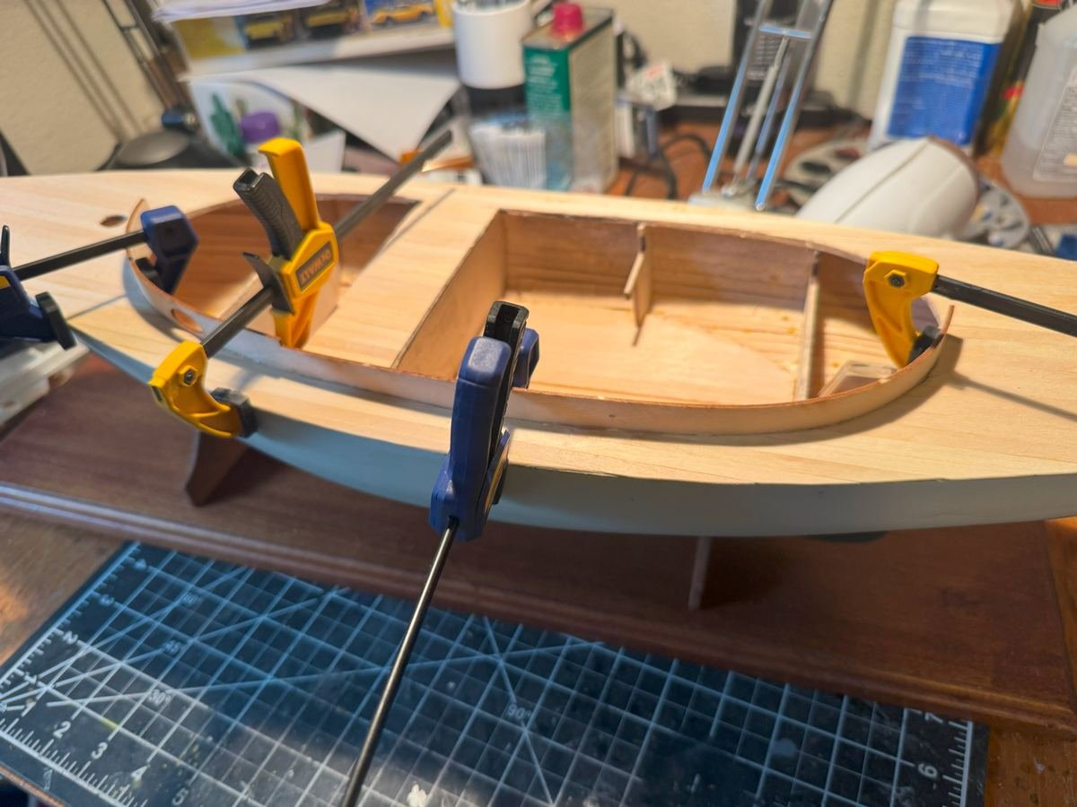

The cabin sides and cockpit coaming sides are two laser cut parts, one for each side of the boat.  Here I am trying to bend the pieces.  I first soaked the front half in hot water for a while (15-20 minutes) then carefully clamped it to a small sauce pan while also applying more heat with a hair dryer.  The sauce pan is obviously not an exact match for the curve of the front of the cabin but it is a lot closer than a straight line.  I'll probably let it dry over night then unclamp it and see what I have.  Assuming it works I'll repeat the process for the other end of the pieces to accomplish the curve around the back of the cockpit.
I've now glued in the cockpit coaming/cabin sides on both sides, as shown below.   The instructions say to "plank" both sides of the cockpit coaming with vertical pieces of the same wood used for the deck.  However, many of the completed builds of this kit that I have seen online seem to have skipped that step.  I guess I will go ahead and do that planking.....if nothing else that will allow me to cover the gap I accidentally left in the back between the two sides of the coaming, as I trimmed one of the laser cut pieces just a bit too much.  Doh.

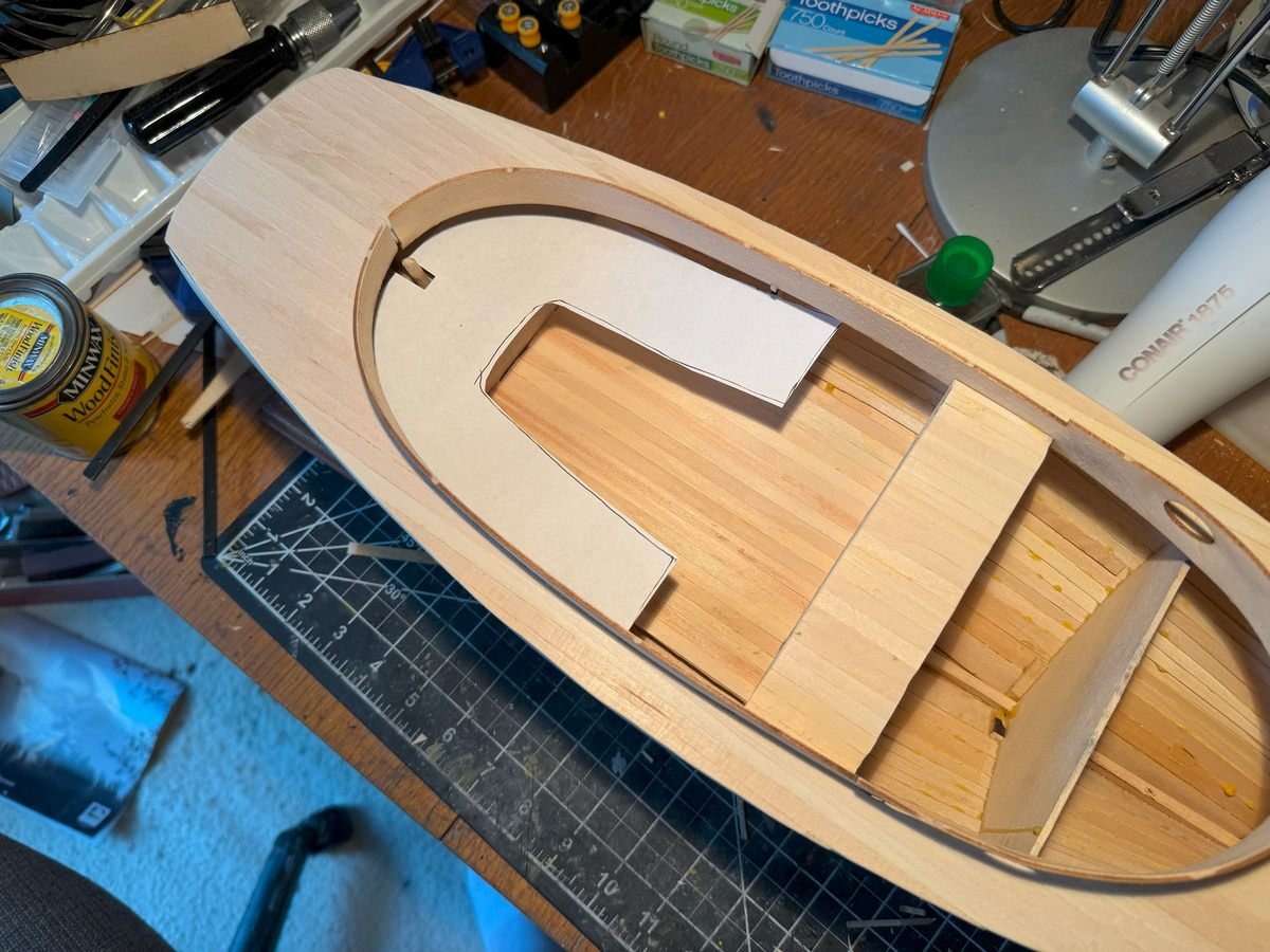

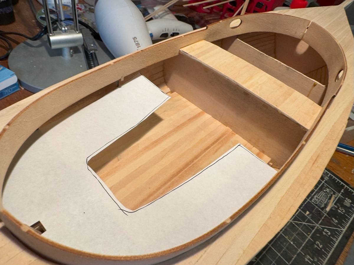

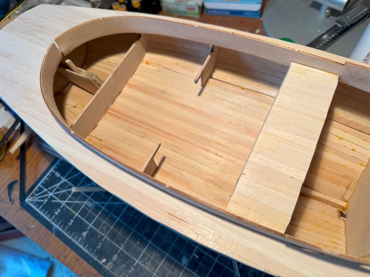

A little more progress.....I have planked the cockpit floor.   I also did a paper template of the seat and test fit that.   I have not decided what, if anything, to do with the bulkhead at the front of the cockpit.  The kit instructions do not seem to address it....maybe plank it vertically or horizontally or just paint it.  I've also dug out a couple old tins of stain and done a bit of testing to try to figure out which to use on the deck, cockpit floor, and seat.   Though I am not yet sure.

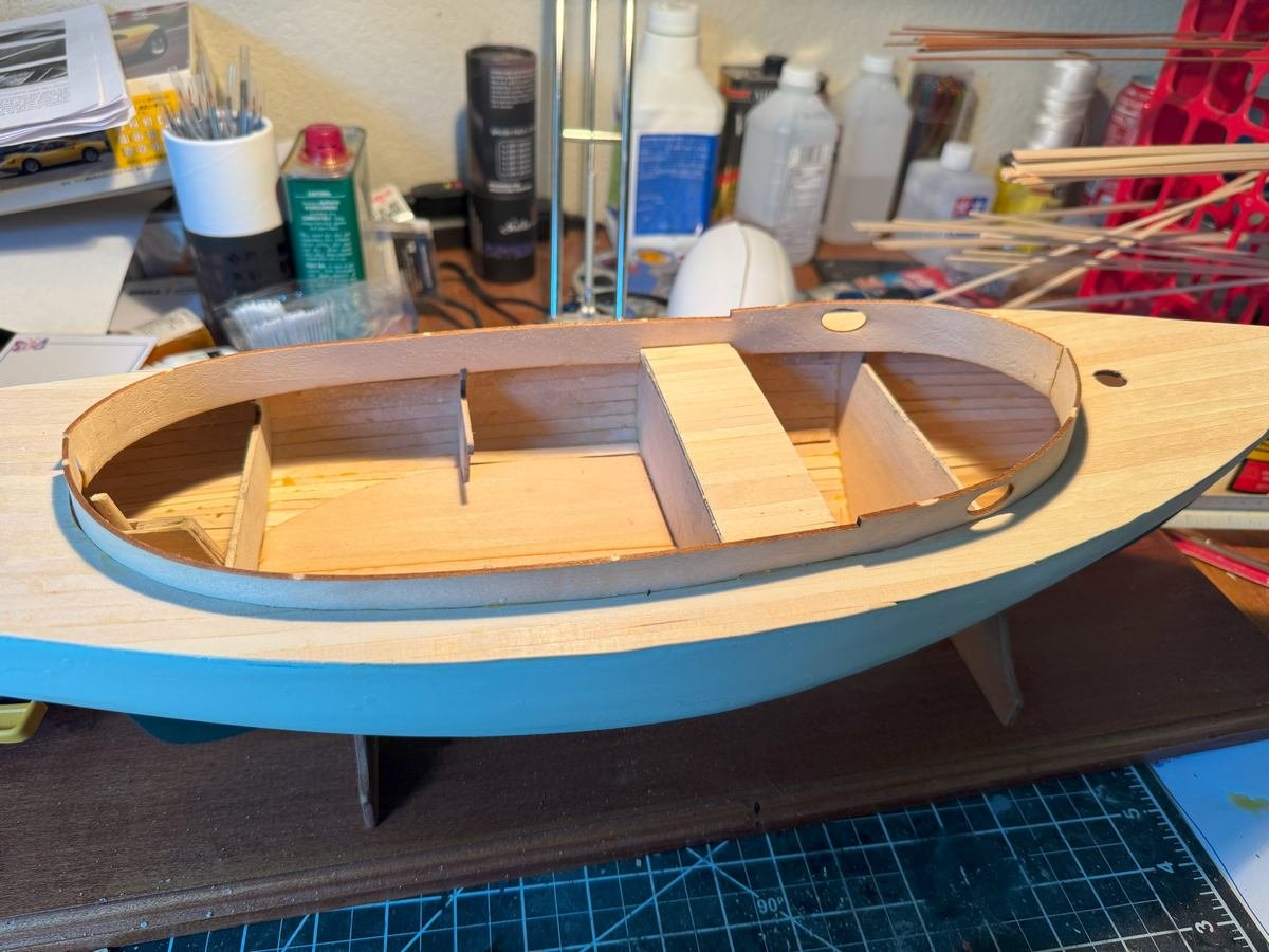

Meanwhile, I've stained the deck and cockpit floor.  As usual, the stain is a bit splotchy on the basswood but I can live with that.  I've also started doing the vertical planking of the outside of the cabin and cockpit coaming.  As you can see, I glue on the rough cut pieces and then trim off the tops to get things even.   I'll do similar planking on the inside of the cockpit coaming and add a cap rail on the coaming and a roof over the cabin.  And all of that will be painted white (with the possible exception of the roof).
Have not decided what to do with the rest of the inside of the cockpit yet., e.g. the inside of the hull planks.  I might just paint that area gray.  Much of it will be hidden when I add the seats.

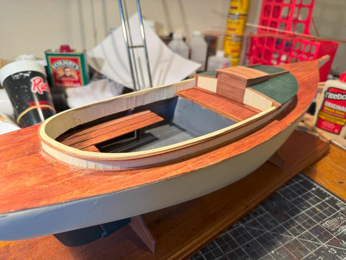

I repainted the coaming with the same off white color as the top half of the hull.  I think it looks much better.  I then made the seat and installed it into the cockpit.  I simply cut and laid out the strips over that paper template I showed a couple posts ago.
Thanks all for the likes or for just looking in.

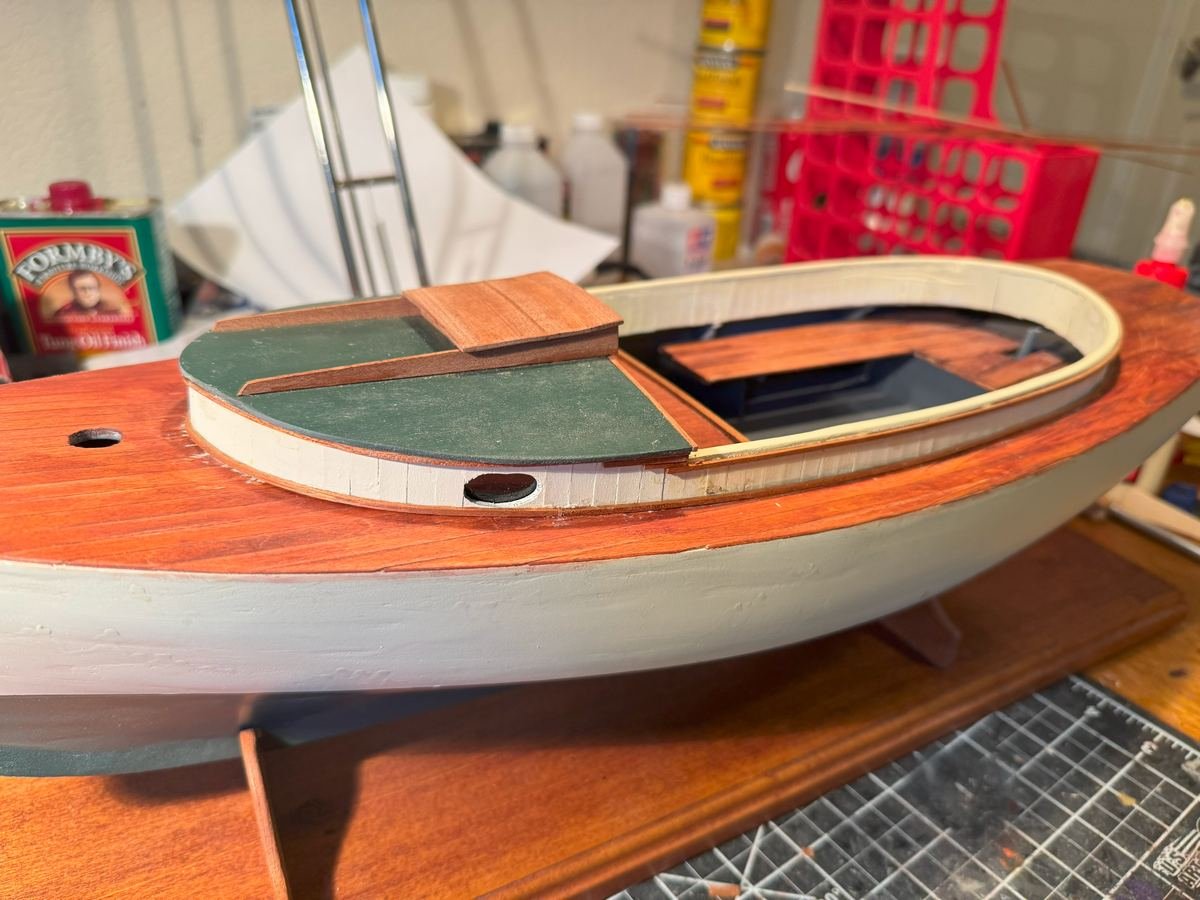

I've now completed most of the major parts of the hull.  I opted to paint the top of the cabin the same green as the bottom of the hull.   I still need to do the rest of the hatch assembly atop the cabin and then a lot of various trim work.   For the latter, I feel a little bit on my own as the instructions and plans are not entirely clear or complete.  The kit provides a couple different sizes of mahogany strips for most of the trim.
Thanks all for the likes and Jacques for the compliment.
Work continues....I completed the cabin hatch and have been doing some trim work around the cabin and cockpit.  The trim is primarily 1/16th square mahogany.  I bend it by wrapping it in a paper towel, soaking it with water, sticking it in the microwave for a minute or two, letting it sit for a bit, then clamping it around the rim of an old kitchen sauce pan.  That gave enough of a curve to put the pieces around the cockpit.  I think I have that trim complete now.  There is still some sheer trim where the deck meets the hull, some trim around the transom, then a rail all around the perimeter of the hull, then trailboards, bowsprit, cleats, etc. before moving on to masting, rigging, and sails.

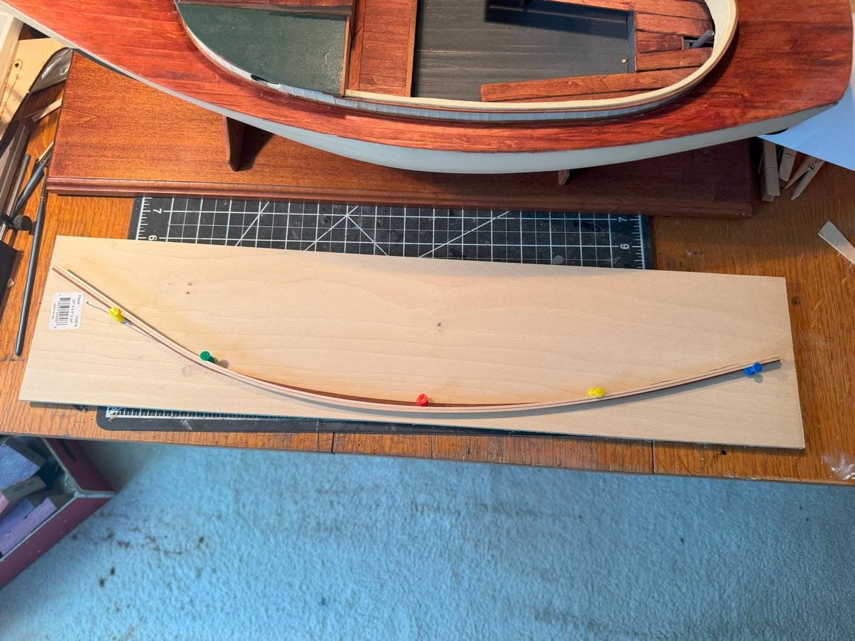

I took a few days off from the build, but have resumed, at least a tiny bit, today.  Part of the reason for the pause was that I had trouble locating my supply of thumbtacks/push pins.  🙄  They were needed for the jig to help bend the strips for the rails.  The rails consist of a basswood strip that is set on edge, at the perimeter of the deck and that is topped by a flat mahogany piece.  Both strips are 1/16th by 1/8th.  Bending the basswood is no issue but the mahogany is an edge bend.  So I created the jig below.   It is a little hard to tell but the mahogany is laid flat and held down by the flanges on the thumb tacks to create the edge bend.  I soaked the strips in hot water and placed them in the jig and also applied some heat thanks to a hair dryer.  I'll let them dry more and see how it turns out.  Before installing, I will paint the bass wood the same off-white color but leave the mahogany bright.
