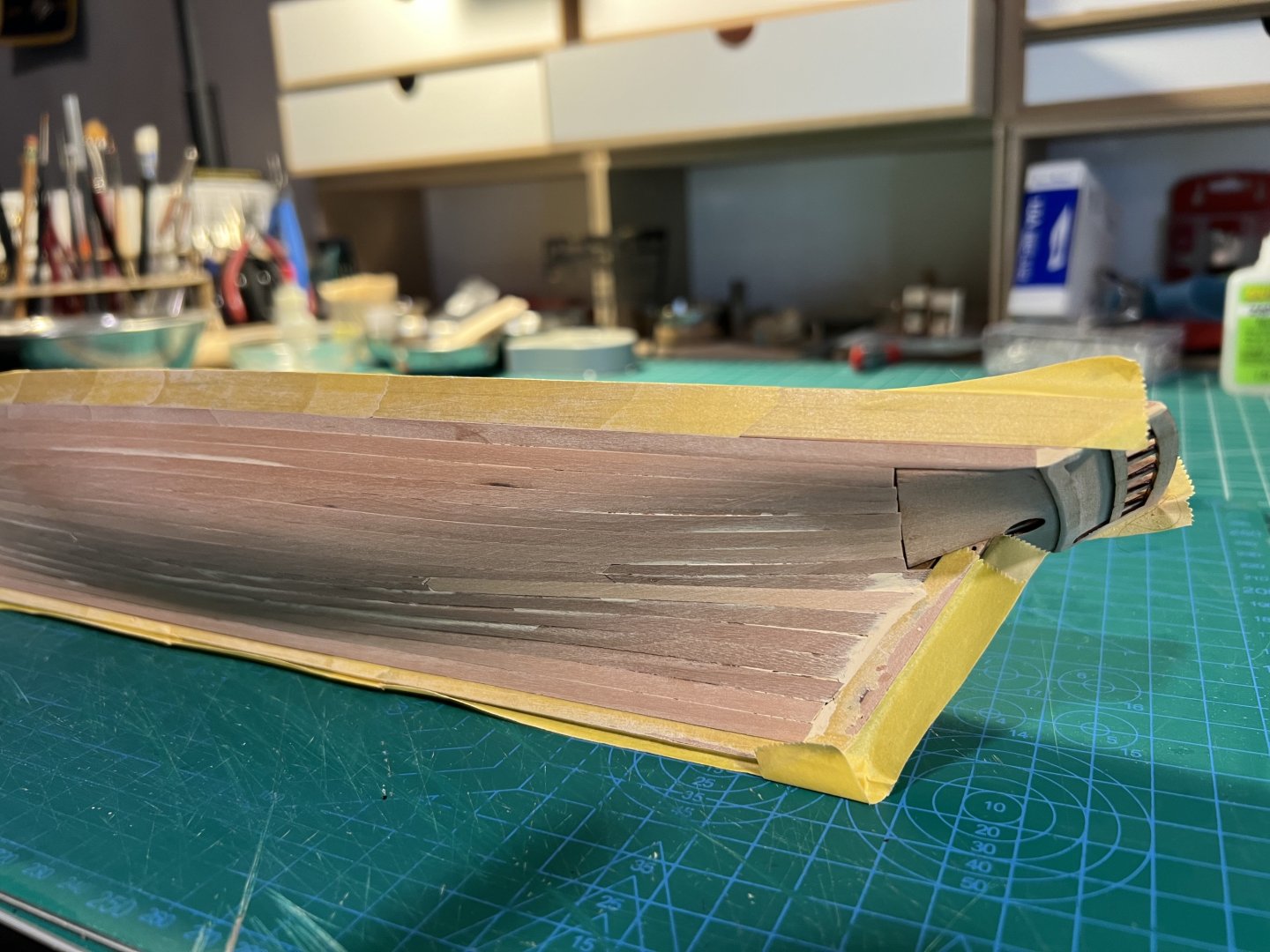

Finished the 2nd layer of planking. Just needed filler in a few spots. Definitely a better job overall than my Sherbourne. It’ll take several more models before I feel remotely competent. We’ll see how it looks after sanding. It’s taped to protect the engraved pear wood pieces while sanding the hull.
First sanding of my Ranger. I need to do a tiny bit of filler and another sanding pass. The hull will be mostly (perhaps entirely) painted.
