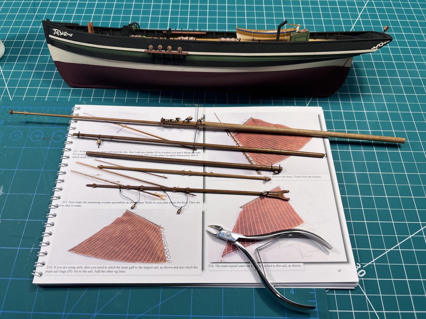

Getting ready to dye the sails. I was looking at some other build logs of the Ranger and was recommended to me on this one when I asked about it.
@Dfell says in their log "Sails all dyed using RIT Cocoa Brown and Scarlet (equal mix of each)."
@DB789 says in their log "Decided on a colour for the sails, RIT dye Tan (mixed quite strong) and after that the sails dipped for a minute or two in weak RIT dye Scarlet mixture, the latter to give the sails a less bland brown colour."
@DB789 added earlier on my build log "I did try mixing dyes together based on the colour mixes on the RIT website - I think that’s probably the recommended way of dyeing. My dye mixing is all in the Nisha log that I sent to you. ... I only tried the sequential dyeing for this set of sails as I was disappointed by the colour achieved from tan dye alone. Had no idea if it would work, but was very pleased with the outcome. "
The instructions for another Vanguard fisher, the Lady Eleanor says "you can use any dye of your choice, but for prototype, this is the product we used" and it shows a RIT dye in Wine (Bordó).
@DB789 also recommended this RIT video. First time dying something except for tie-dye. We'll see how it goes. I did buy some linen-like fabric to practice on. It's not quite the same as the sails, but closer than something like an old t-shirt would be. I'll post some comparisons between the fabric and the actual sails when I'm done playing around.
Edited by palmerit
