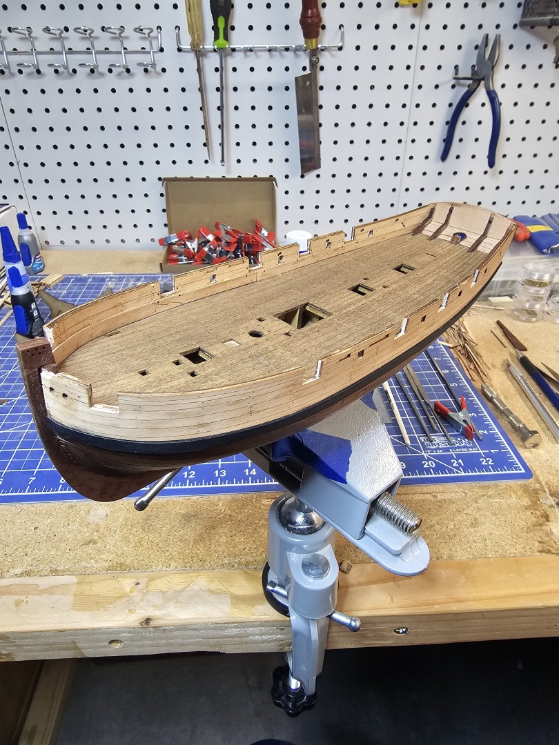

Back on MSW after quite a few years break from working on my MS Niagara...
Decided on Vanguard's Sherbourne since it's an entry-level kit with much simplified rigging compared to the Niagara (get some basic skills in first before finishing that one).
Started Sherbourne in January while taking some pics along the way.
The kit is done exceptionally well- materials and instruction book are 1st rate!!!  Chris does an excellent job with his products and kit designs! Highly recommend!!!
So far, no problems with the build (recalling it's of the lessons I learned from Niagara, yet learning new stuff as well)
Only major change from the original kit is my color scheme (decided to stain the hull and deck, and keep most wood as natural as possible, sort of a rustic/worn look to it)
Hull stain was English chestnut (minwax)
Deck was weathered oak first followed by red oak stain (by minwax). LOTS of wipe/rub to get the look and coloring I wanted.
For blackening the brass I used Birchwood-Casey (several dips in the solution, then wiped/rinsed).  Solid black would be too dark, so I like the rusty steel/gunmetal look the parts took on.
I'm trying to be as clean as possible, yet I'm still fine with the blemishes (gives it character I think). That's one of the reasons why I chose to stain the hull- show of the small errors and flaws, yet blend together so it all works as one.

Thank you!  It's slightly darker than I wanted, but still ok!  Tried over a dozen combinations of stains on some of the scrap pear wood to see how they'd look... unfortunately Lowes only had a few in the 8oz cans (don't need a whole quart).
So it's a good idea to test paint and stains on scraps of the actual wood to see how they'll turn out! 😉

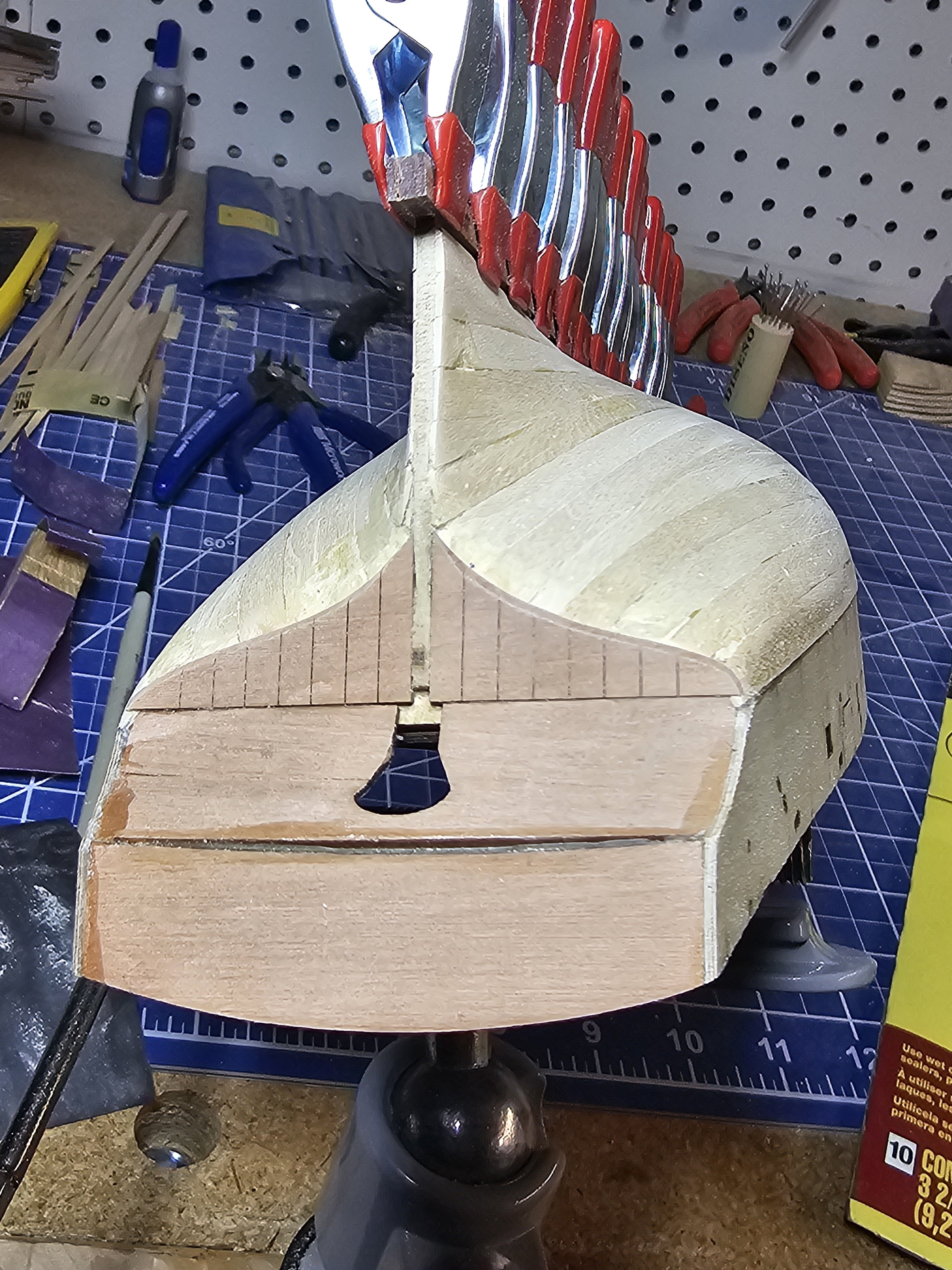

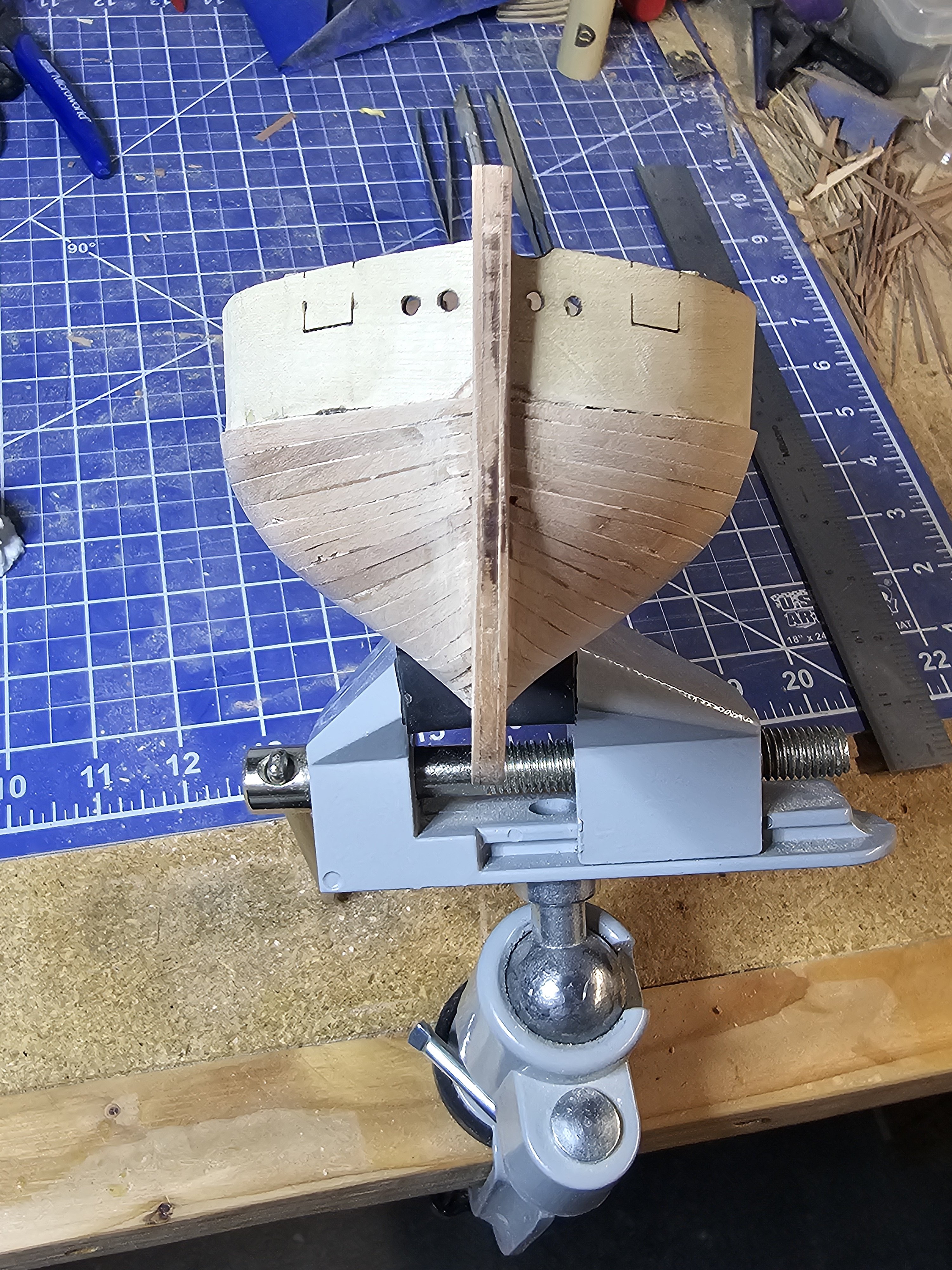

Rich,
I have looked at many of the build logs here and suggested videos that explain about marking the frames so all the planks are tapered correctly in width from stem to stern.  Do the instructions show this?  It seems to be logical as the space for frames from the keel to the top of the hull is different at every frame.
Thank you.
Bill
8 hours ago, Billpitts said:
Rich,
Thank you.
Bill
The instruction manual describes the planking process.  Yes, plank widths will vary slightly from one bh to the next... since the bow is curved, a lot more tapering is needed (stern needs barely any tapering,  and actually widens, hence using stealers between planks).   There's TONS of info on here to help with planking.  For Sherbourne, the this are laser marked where to taper to aid with the fairing, and i think it calls for 12 planks (1st layer, 2nd layer was 13 for me).  For this particular hull shape, zero tapering for majority of hull length midship, but quite a bit (~4-5 bulkheads or so) at the bow.
