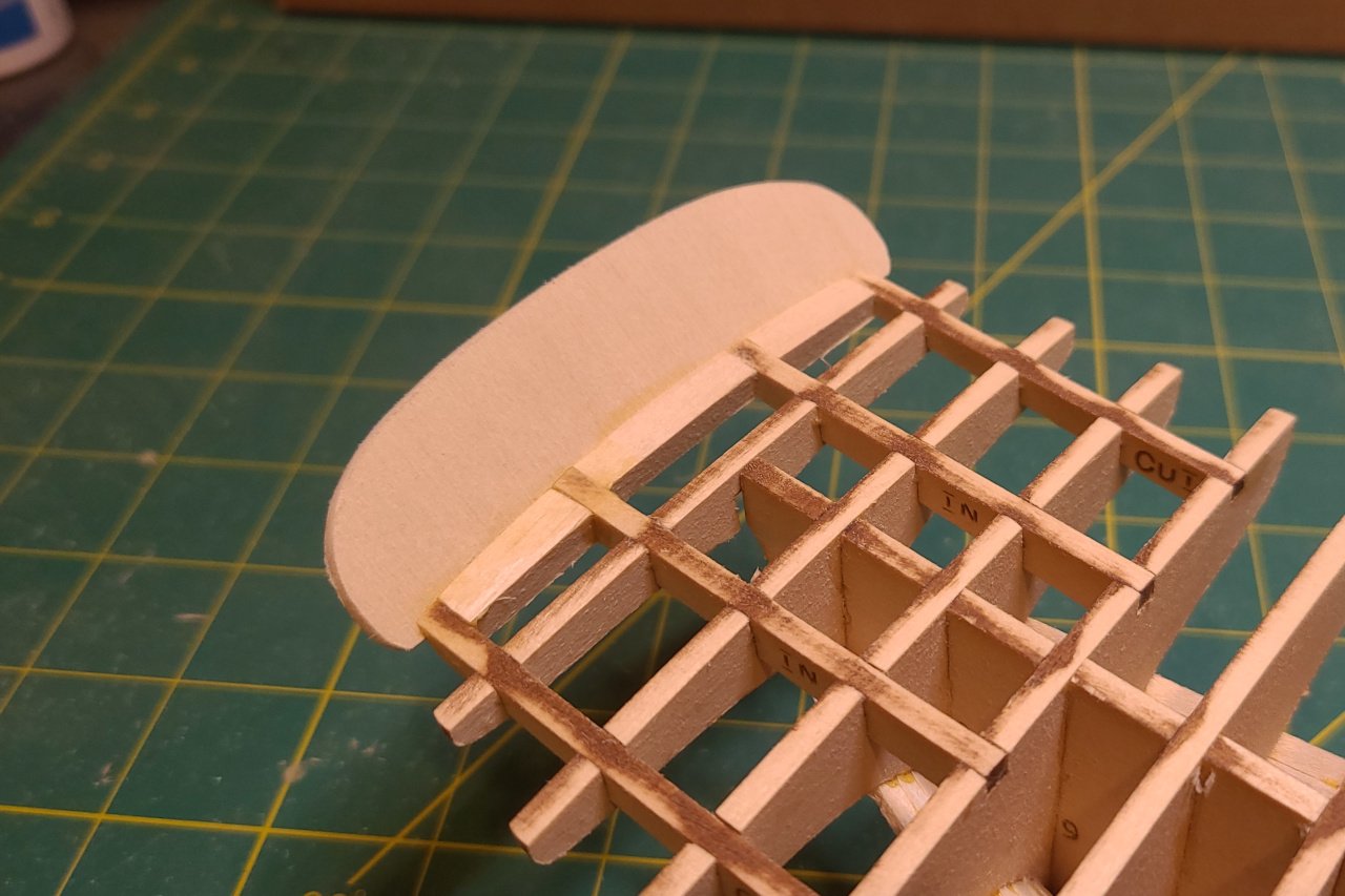

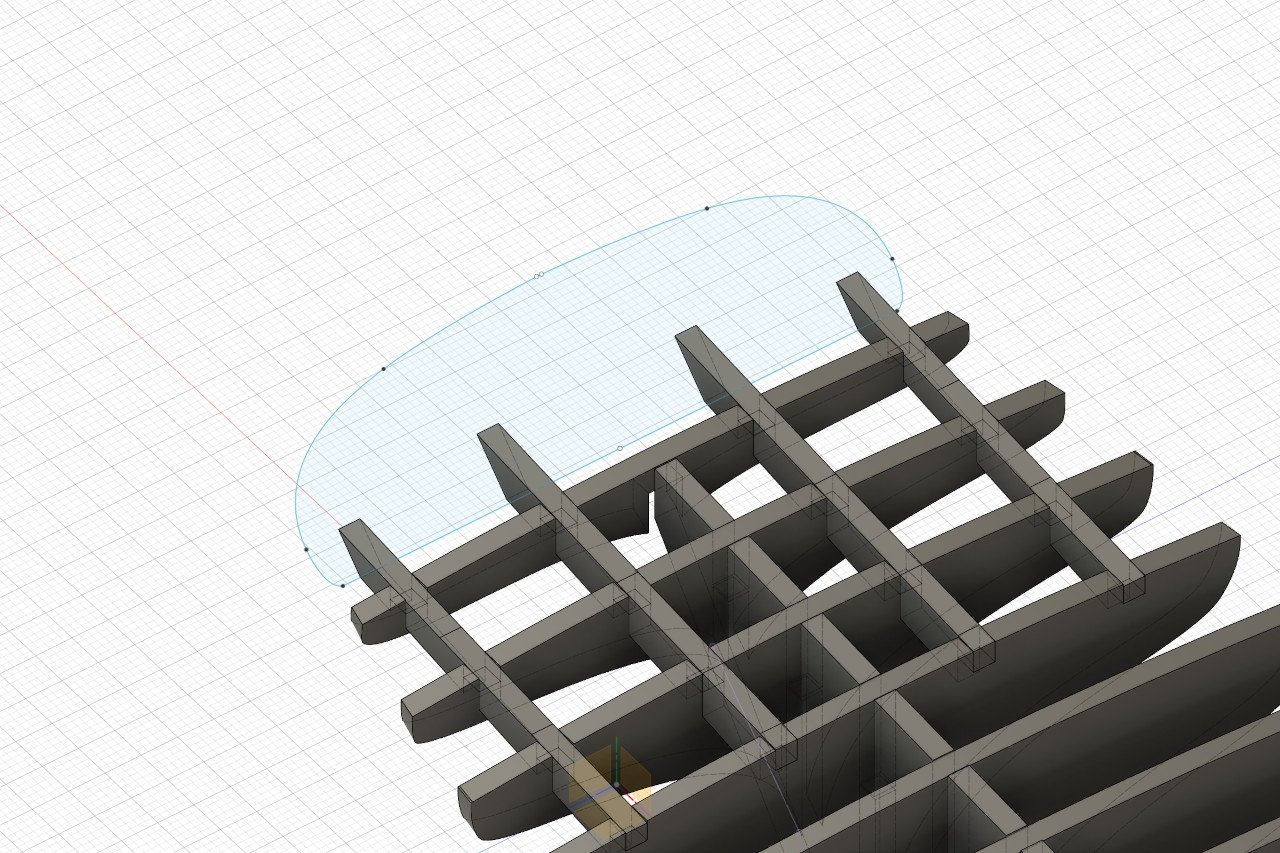

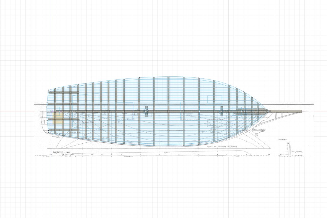

In Fusion, I designed the stern piece.
It was not worth the trouble to go get it laser cut.  I just printed out the pattern and then cut it from 1/16" sheet.

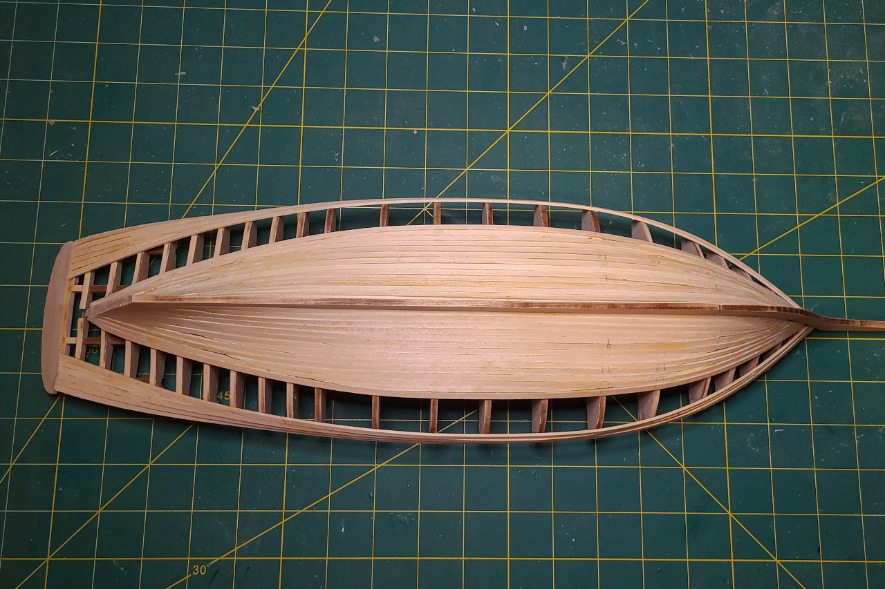

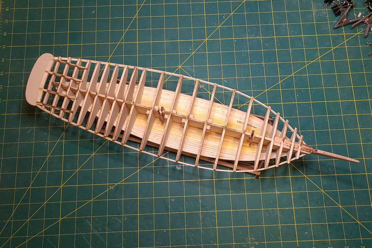

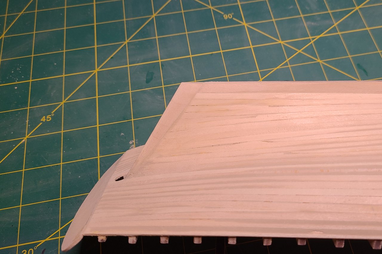

The strake immediately below the "bends" was planked.  If you look back at my laser cut patterns, you'll see where the location of this was marked on the bulkheads.  Getting this strake in exactly the right position is important, so that the bends (which will be thicker) will run correctly.

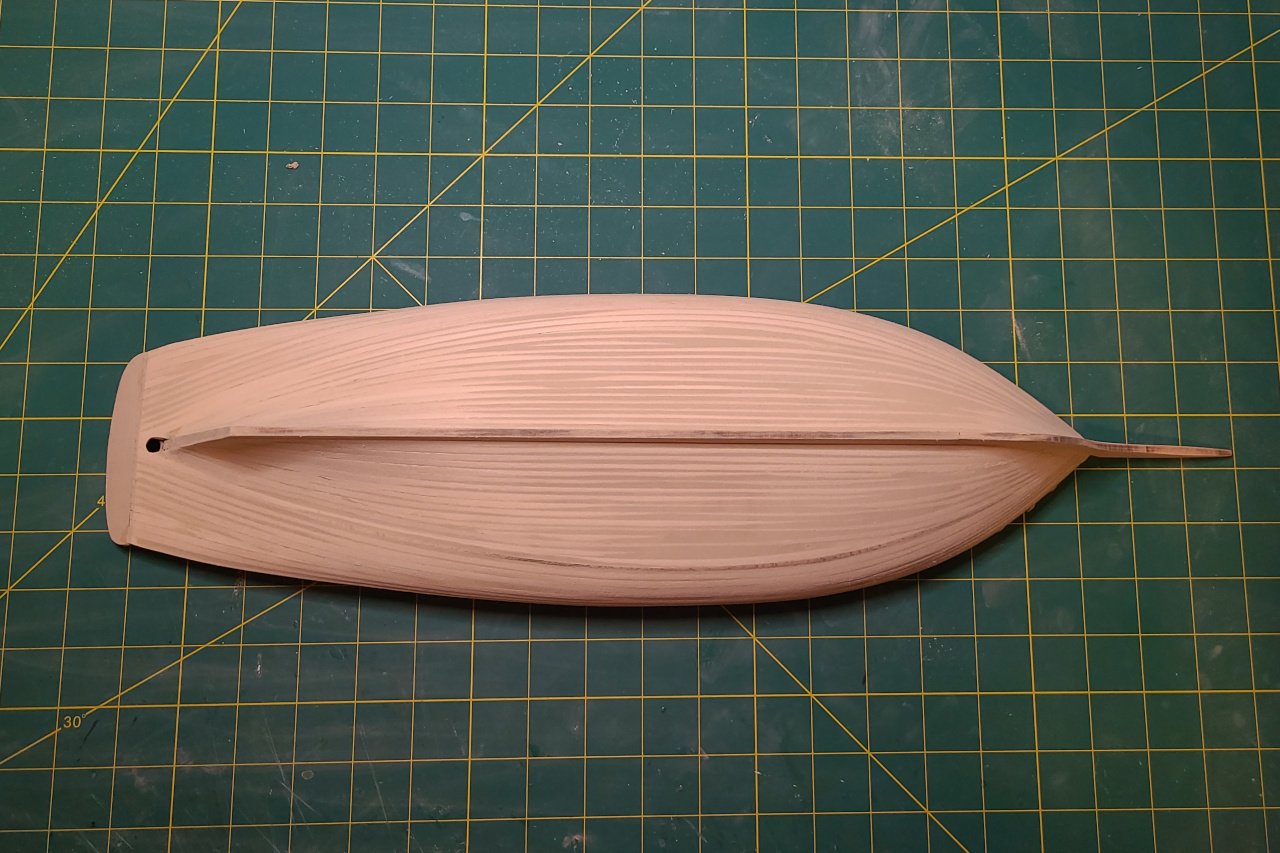

Now I'm planking the remaining space to complete the lower hull.

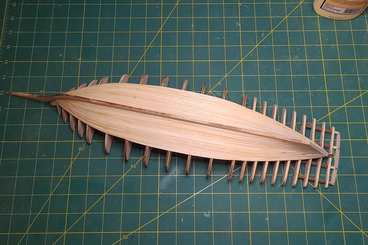

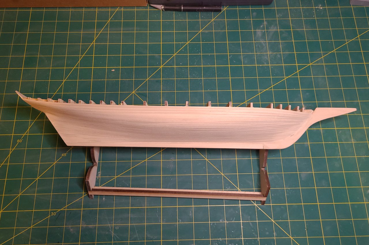

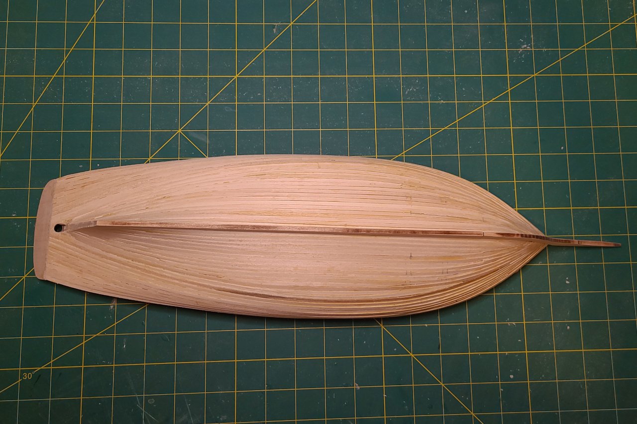

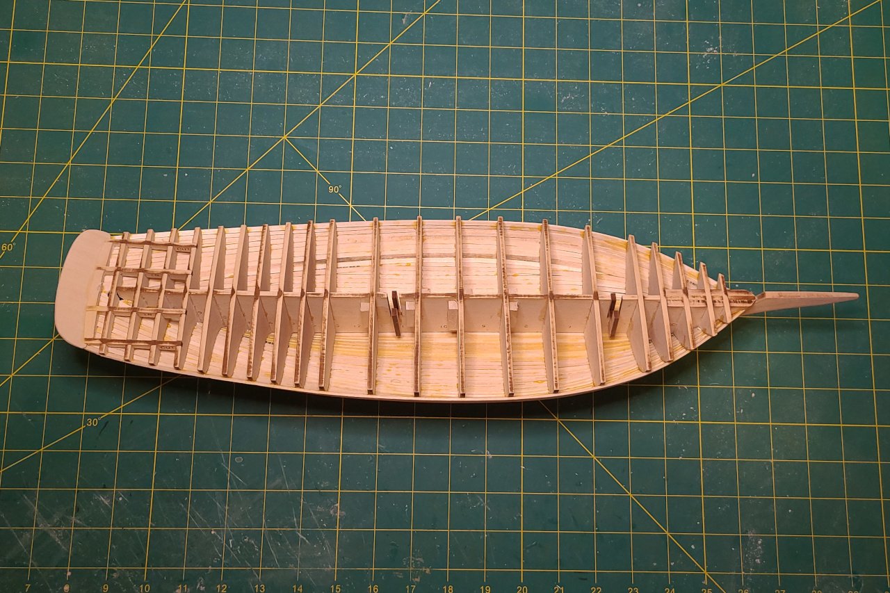

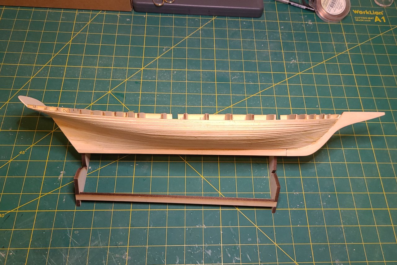

Planking of the hull was finally completed.

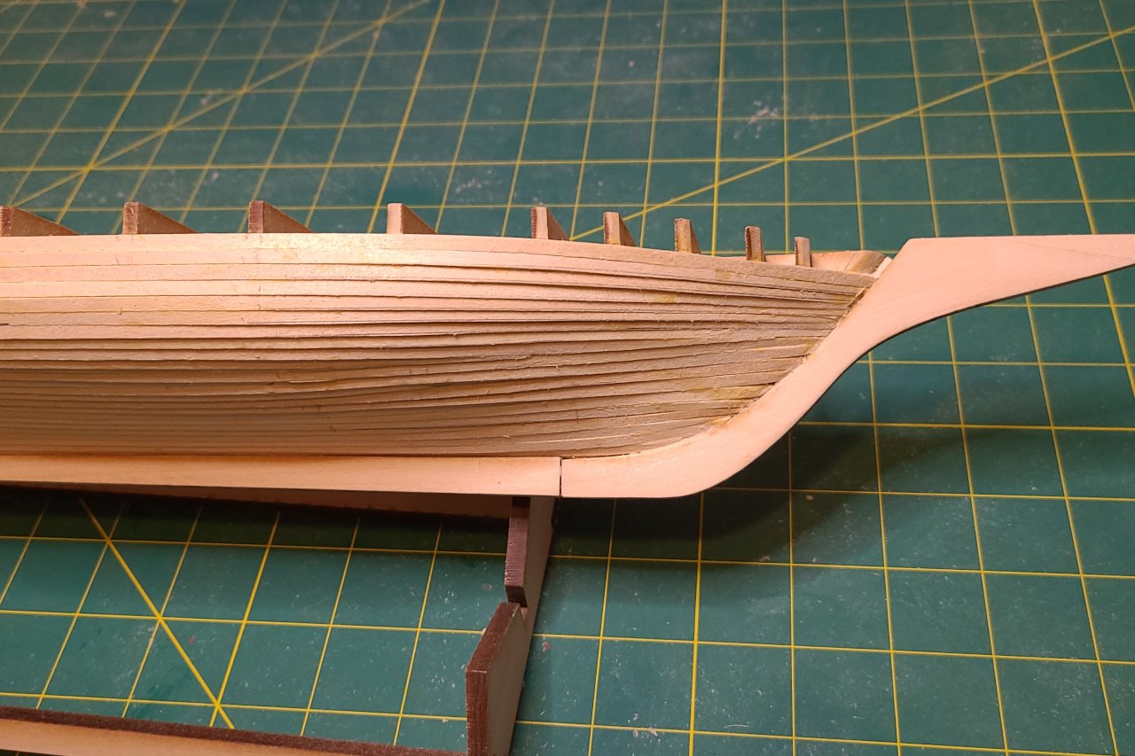

The planking was quite clinkered in spots, especially here at the bow.
Fortunately, wood filler exists.  After a generous amount of wood filler and lots of sanding, the hull is pretty smooth.
The stern post was glued on and a few gaps were filled in.

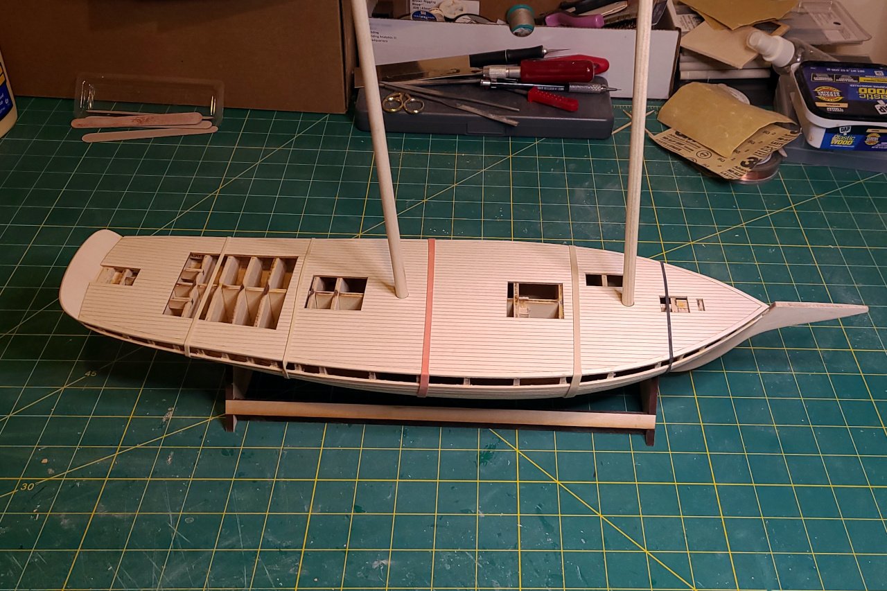

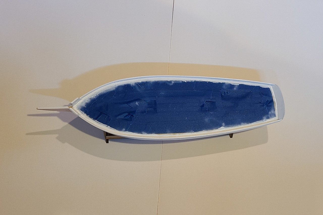

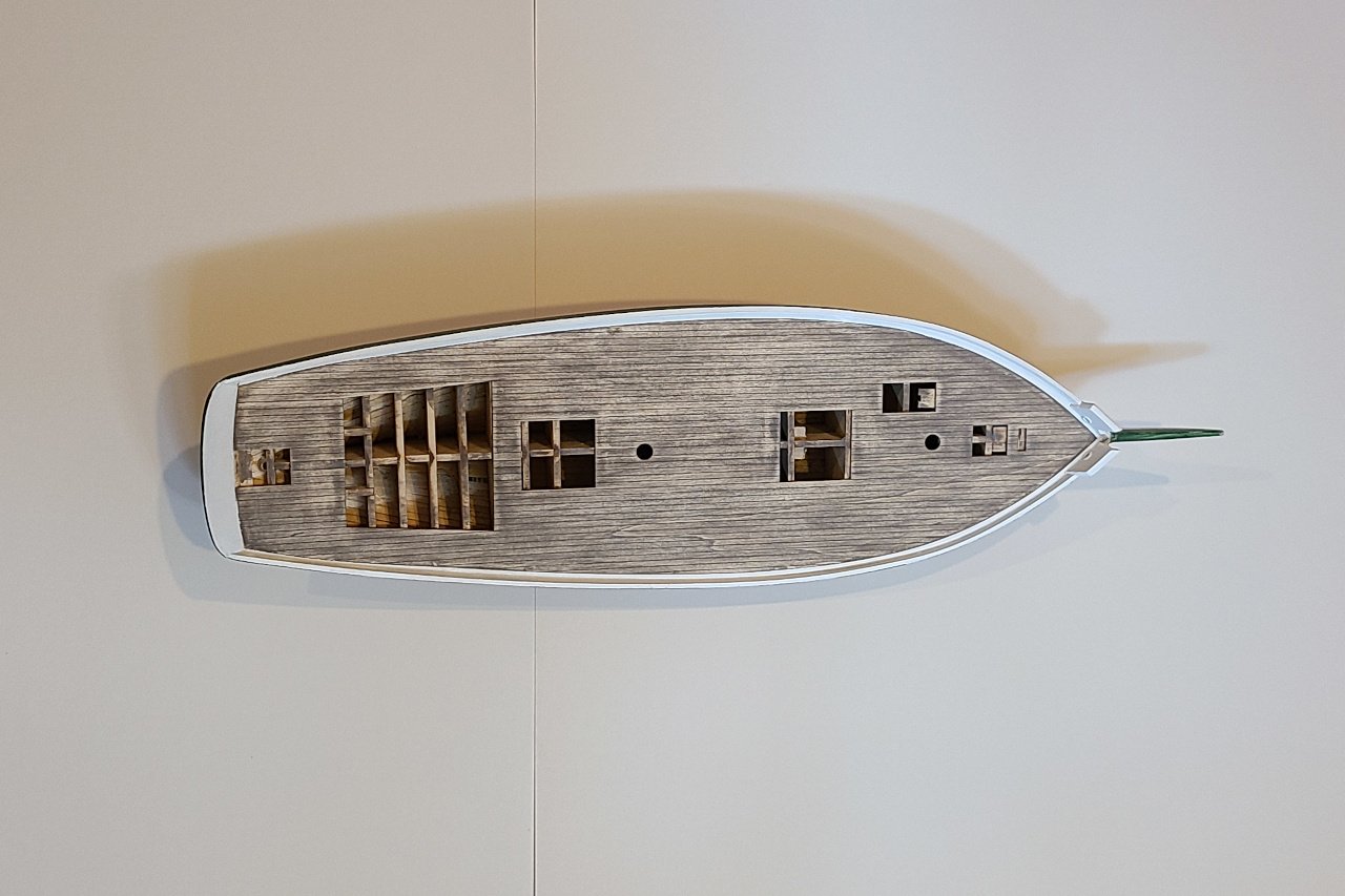

I wanted to get the deck in place next, as the sides of the deck would add more surface area to attach the bends planks.

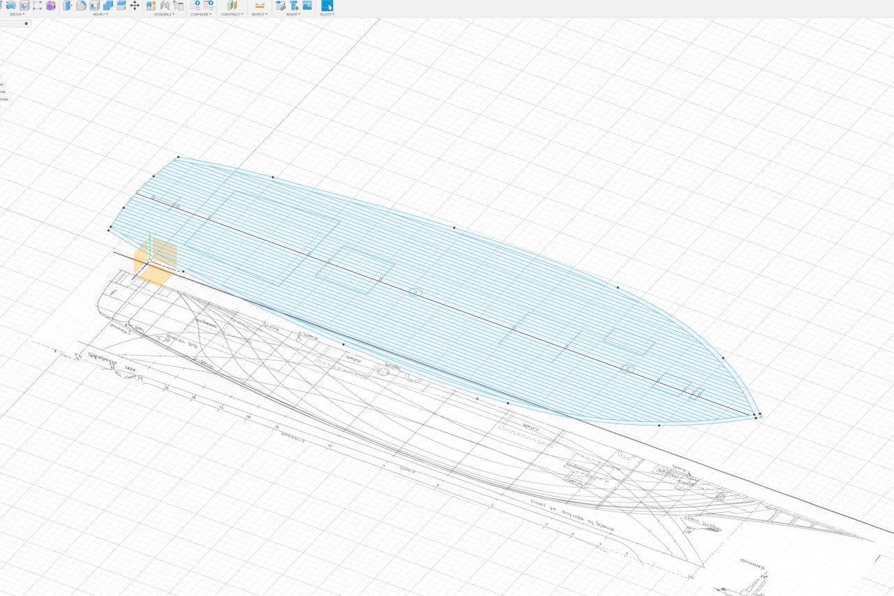

Rather than planking the deck, I chose to laser cut a scribed deck.  First I had to determine the pattern for the planks.  Looking through pictures of schooners of the same location and era, I found that straight planks were as likely as planks that follow the curvature of the bulwarks.  I did not find any examples of nibbing.  I decided to go with the simple option of straight planks.  The design was laid out in Fusion, including the waterways and cut outs for the various deck features.
And it was taken to the laser cutter.  (This was the second version.  I cut one originally then discovered a flaw in it later.)

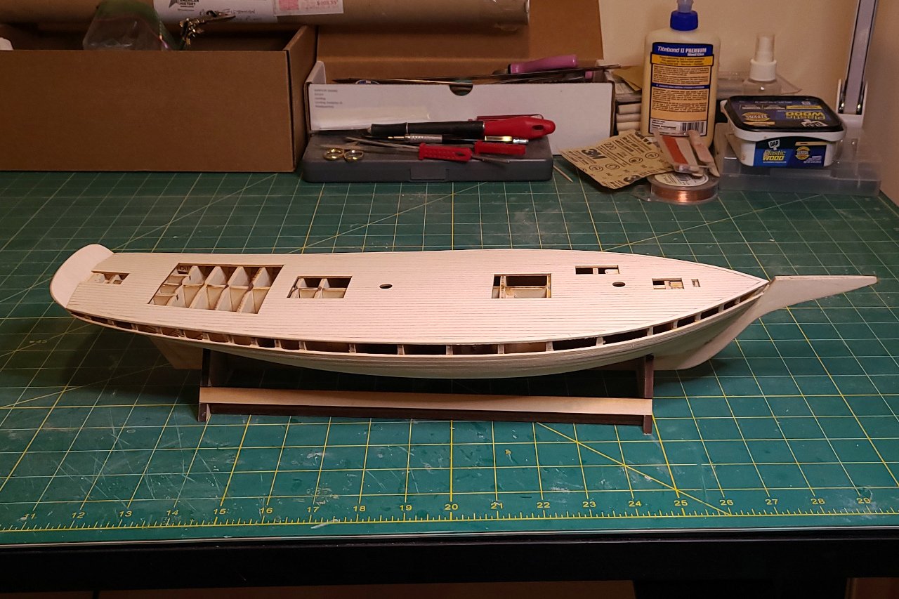

The deck was aligned with the hull by inserting dowels into the mast holes.  Then rubber bands held the deck in place while the glue dried.
And the deck is in place.

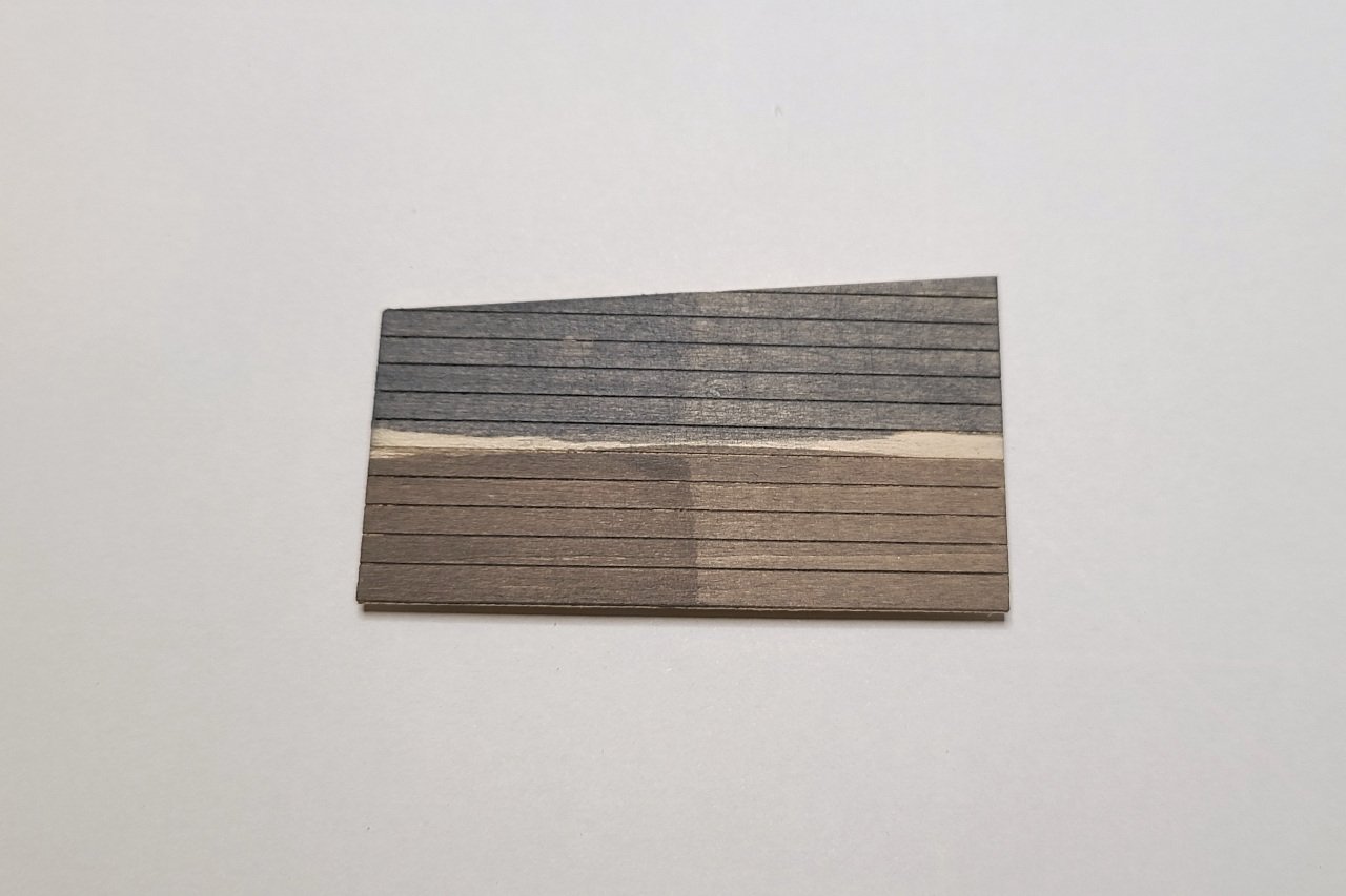

I want the deck planks to have a weathered look.  I picked up two stains that looked likely to work.  The top is "weathered gray" and the bottom is "classic gray".  A solid coat is at left and at right was the result after wiping the stain immediately after application.  None of these is exactly what I'm going for, though the result at the bottom right is closest.

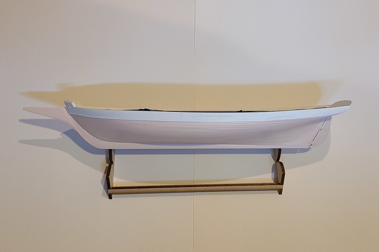

Now it's time to plank the hull above the bends line.  The planking needs to be thicker, so I used 1/8" x 1/8" strips.  They don't bend well on their own, so I soaked them in water and clipped them around a bowl to encourage the most extreme curve needed.
Two planks added...
And four planks...  There is a bit of a gap between the planks aft.  (And other imperfections not visible in these pictures.)
These bits were added at the front that reinforce the hawse holes.  (There is probably a name for them, but I'm not aware of it.)
The stern has issues.  The thick planking just added runs too high and will need to be reduced.  And the whole stern needs to be more rounded.  Also, I think the piece I fashioned is too short.
After wood filler and hours of sanding, things are looking better.
The stern is improved, but still needs work.  I'm going to try to bend a thin strip to fit around the top of the stern.  Somehow...
I also stained the deck, then tried to sand it back to give it a weathered look.  It's not too bad.  The biggest issue is that, because the deck was laser scribed from a single wood sheet, there are some natural patterns in the wood that continue across planks.
Next time: Adding some hull details and getting it ready to be painted.

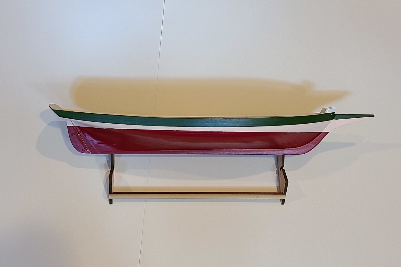

A small update.  I built up the area at the bow.
afl_build_log_016_01.jpg.d37f752e0e8b8411aa33bdeb51e2dd79.jpgafl_build_log_016_02.jpg.08d38d6a3bc23933ec21f677d951fa7f.jpg
And also addressed the issues with the stern.  Have a look at my last update to see what was wrong.
I needed to add a thin strip along the edge that would add enough material so that the entirety of the stern would be smoothly rounded.  Since I already had the shape of the stern in Fusion, I created and 3D printed a piece to use to form the strip.  A 1/16" x 1/16" strip was soaked until it became flexible, then it was bend around the 3D printed piece and allowed to dry.
After gluing the piece on, adding some filler, and sanding, the stern now has a nice shape.
afl_build_log_016_04.jpg.c0f27fef1f13e815d04251fecd0a97b9.jpgafl_build_log_016_05.jpg.b71ccea54c663d33e47ab918fcd3c05a.jpg

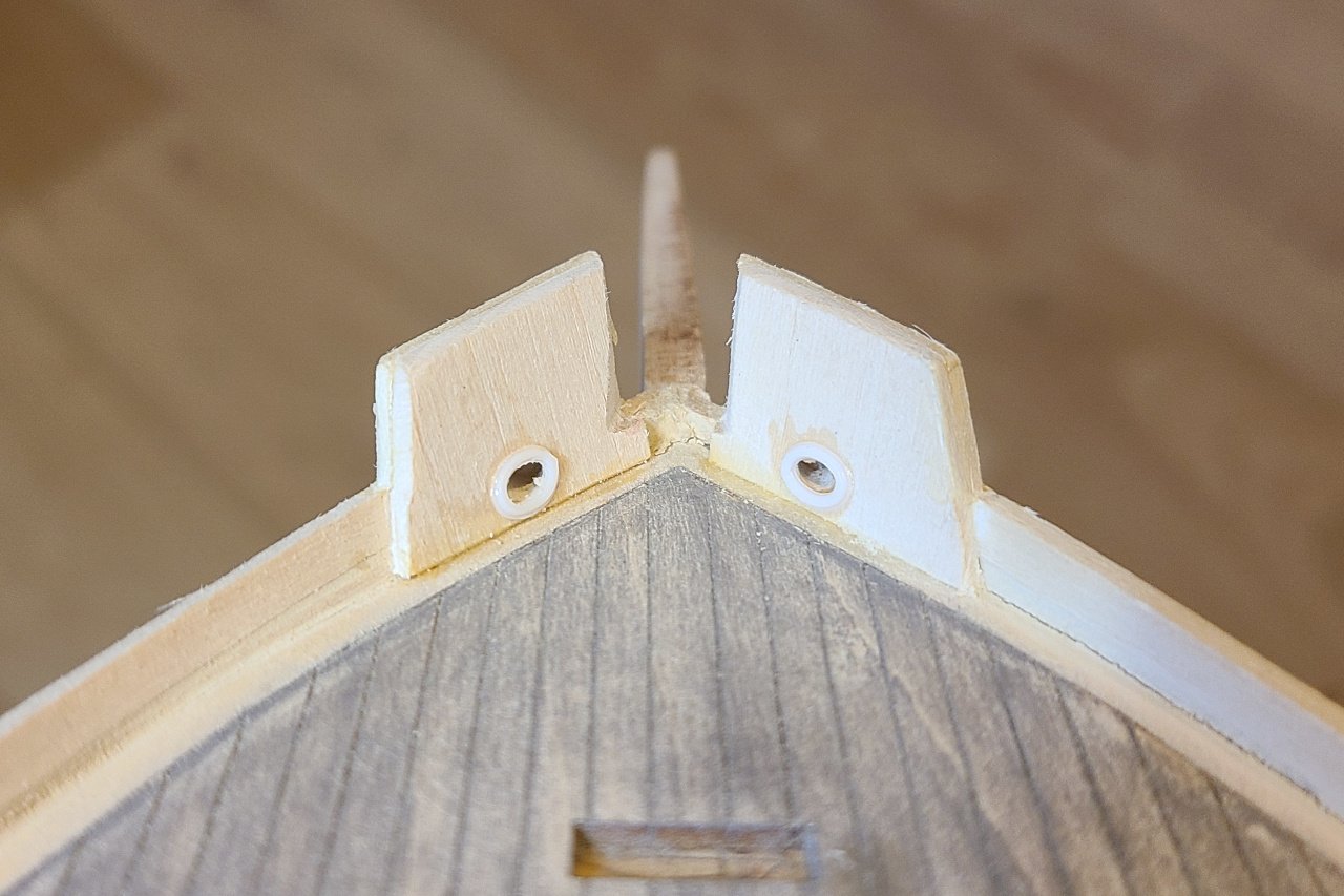

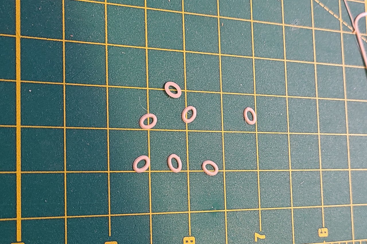

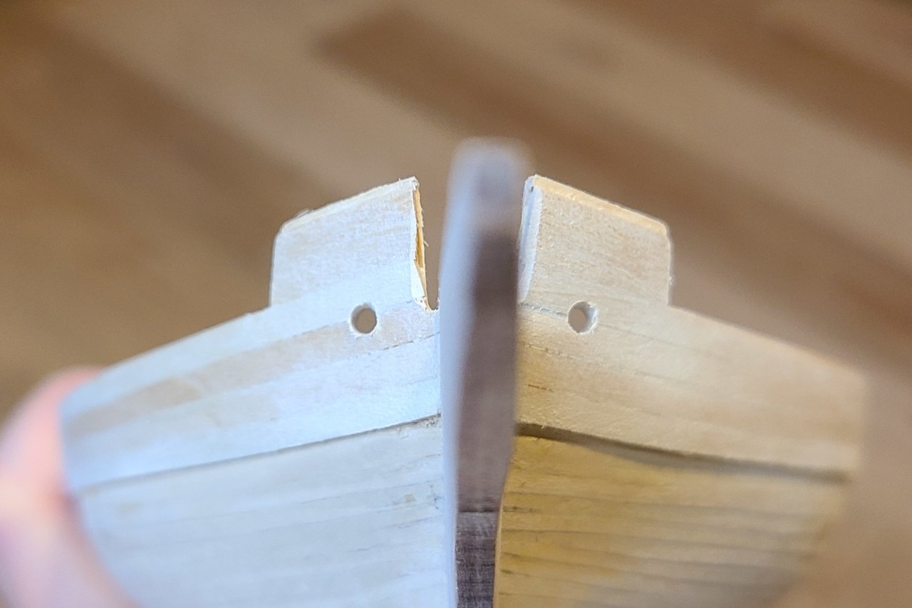

The hawse holes were drilled through.

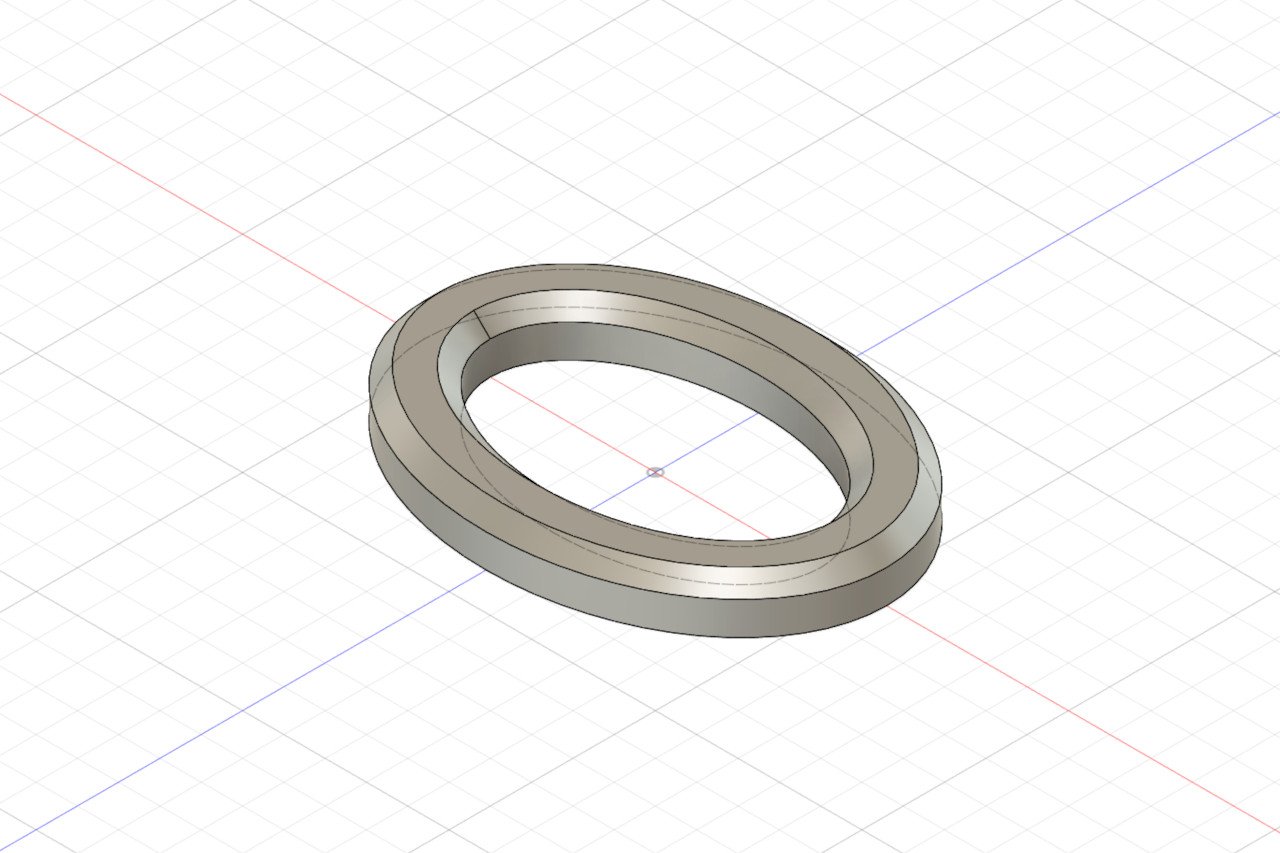

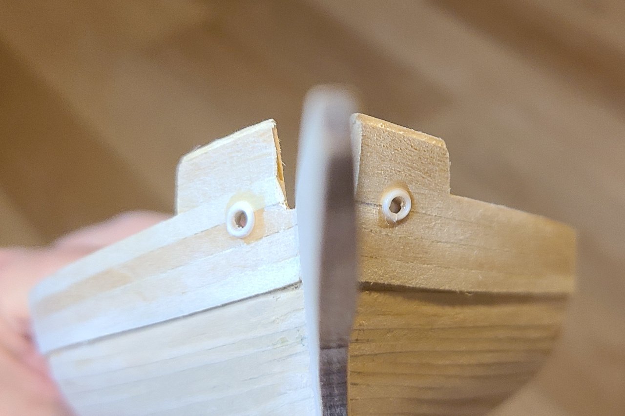

And a 3D part was designed to go on the hawse holes.
I printed multiple because there are sometimes a few duds.
Glued in place.
And on the inside too.

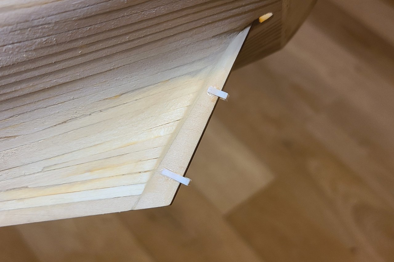

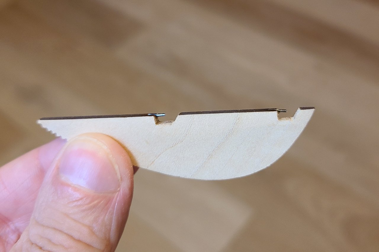

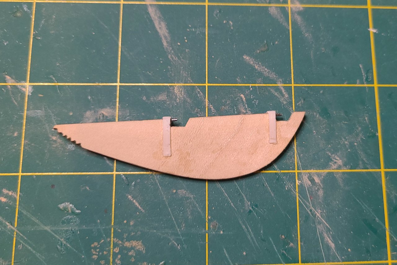

Pins were added to the rudder.

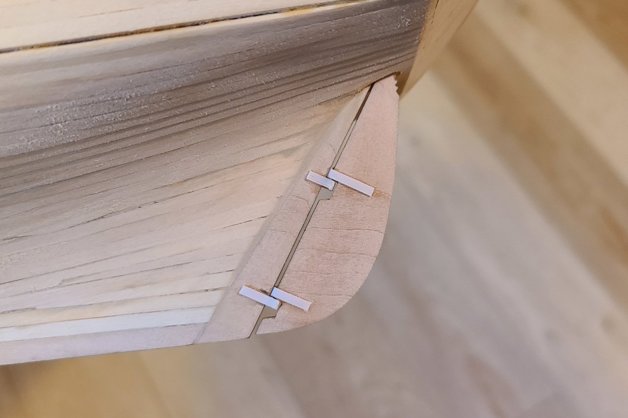

And straps to make the pintles.
3D printed gudgeons.
And all of it put together.
All of this will be painted, so color and glue stains don't matter.
