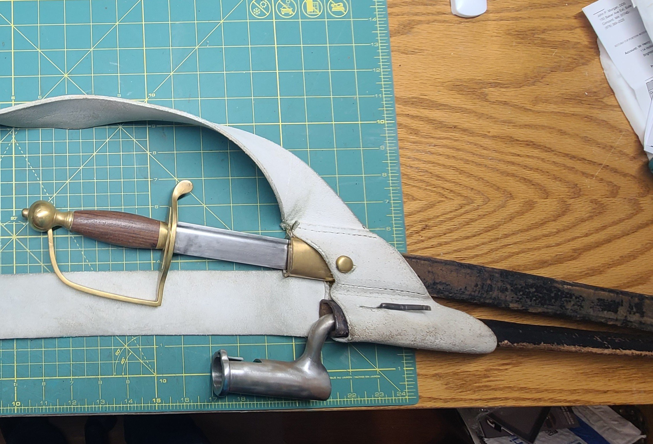

The first item is a baldric, also known as a shoulder belt,  to carry the bayonet.  The one in the picture is for the sergeant and has a double frog to carry both a bayonet and a sword. The other enlisted ranks would only have a bayonet.
The next item is a cartouche box. This holds 26 rounds of ammunition for the musket in paper cartridges.
Here is the neck stock.  This is where the US Marines get the name "leatherneck". Contrary to popular belief, the neck stock is not designed, or capable of, stopping sword cuts.  It is there simply to keep your head erect and improve your military bearing, so you can't do what is termed in the modern military, "eyeball the deck."
Next up is the snare drum carried by our musics. "Musics" is the word used back then to refer to the drummer and fifer, or musicians, assigned to every company.

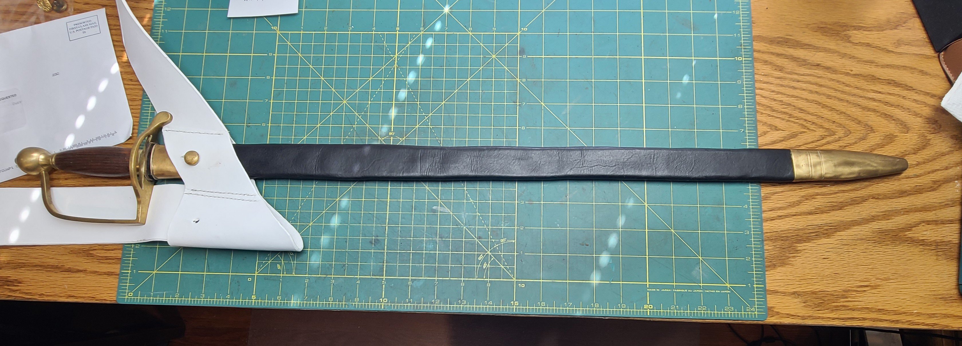

Finally, here is my new officers sword.  The regulations of the period did not specify the sword that an marine officer could wear, except that it have a gilt (non-leather) scabbard. This is a Georgian period, horse head saber.  It would have been worn by a gentleman of means due to it being more elaborate than the average sword of the period.  Since I am portraying a more senior officer, Captain, I thought it appropriate.

The first step in making the patterns is to pull apart one of the existing items. I do not have a picture of the sergeants baldric pulled apart because after I made the pattern I had to put it back together to wear it aboard Constitution last weekend. But, you can see how it is stitched together. The cross belt halves are stitched on to the frog that holds the sword and bayonet scabbard.
Since the Captains sword is a new item I will have to design the pattern pieces myself.

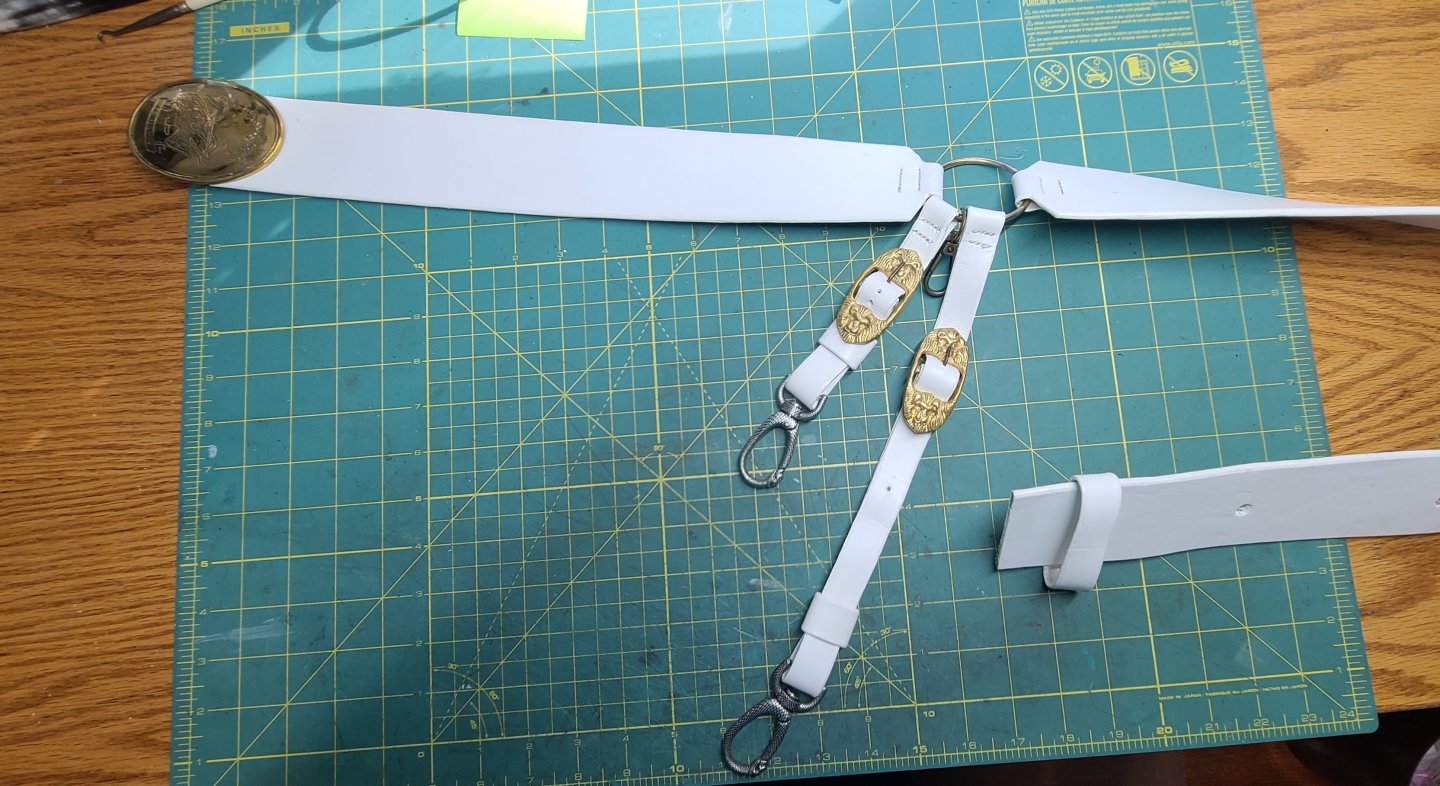

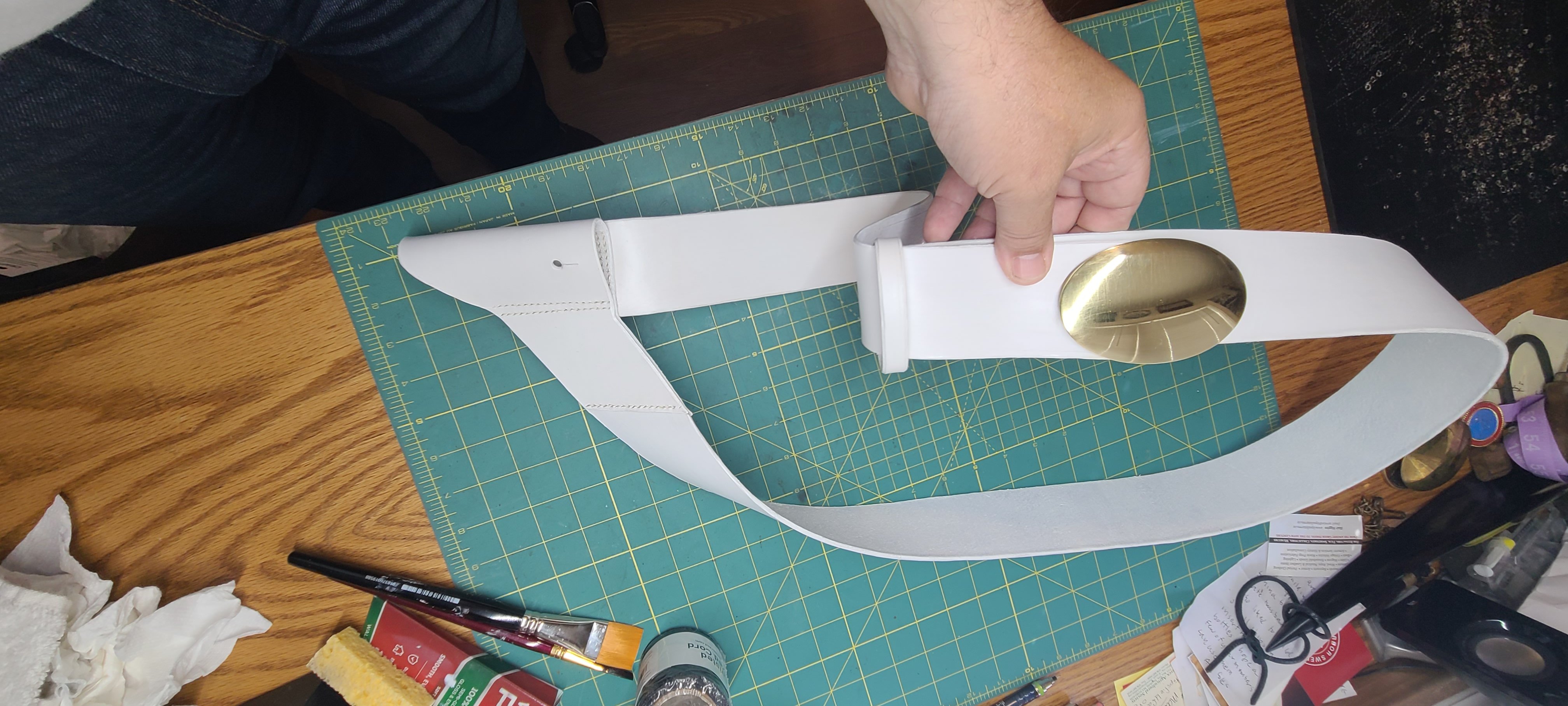

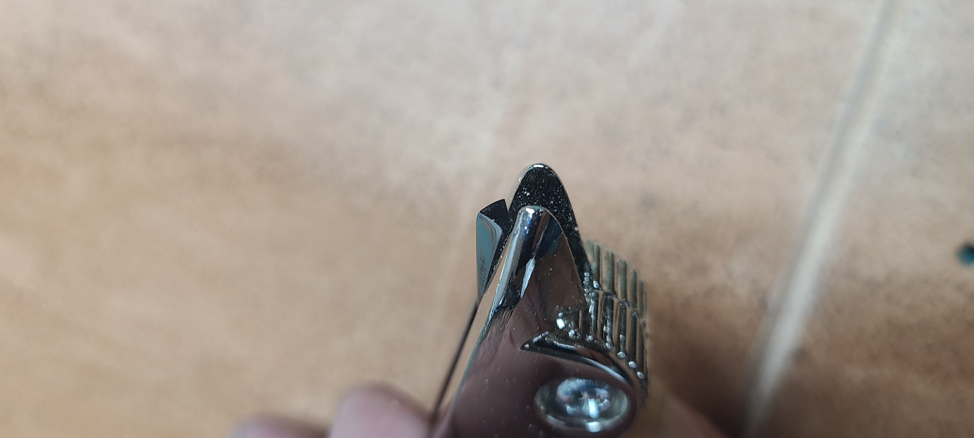

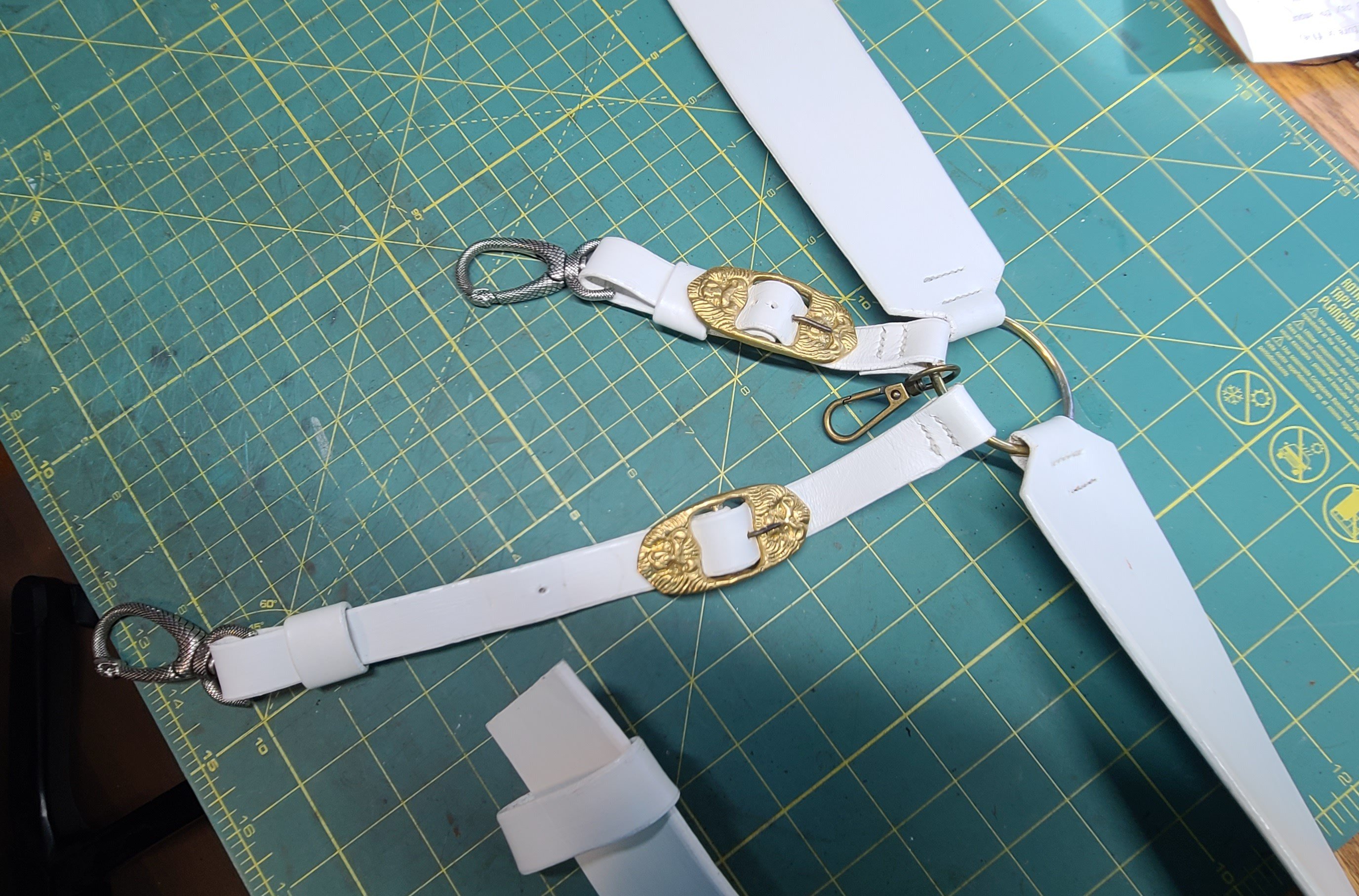

I had to search a few different places to find the hardware to make the Sword baldric and slings.
These are the items I finally settled on to design the baldric around.  Basically, the two halves of the shoulder cross belt and the front and rear sword sling all attach to the large ring which will sit at my left hip.
The hanger hooks will attach at the end of the slings and the sling length will be adjusted by the buckles,
The large hook on the ring is to hang the sword from while walking so that the sword hangs more vertically.  The two pieces were purchased separately and I opened the small eye to get it on the large ring.
The sword scabbard has two loops for the hanger straps to hook in to.  They are carved to look like infinity snakes with the snake swallowing its own tail.  I happened to find these snap hooks that are also styled as infinity snakes and they match quite well except the hooks are silver color and the loops on the scabbard are gold.  I may just live with the difference, or I might find a way to plate the hooks sometime down the road.
The sling buckles are brass lion heads.
All in all, some very cool finds.

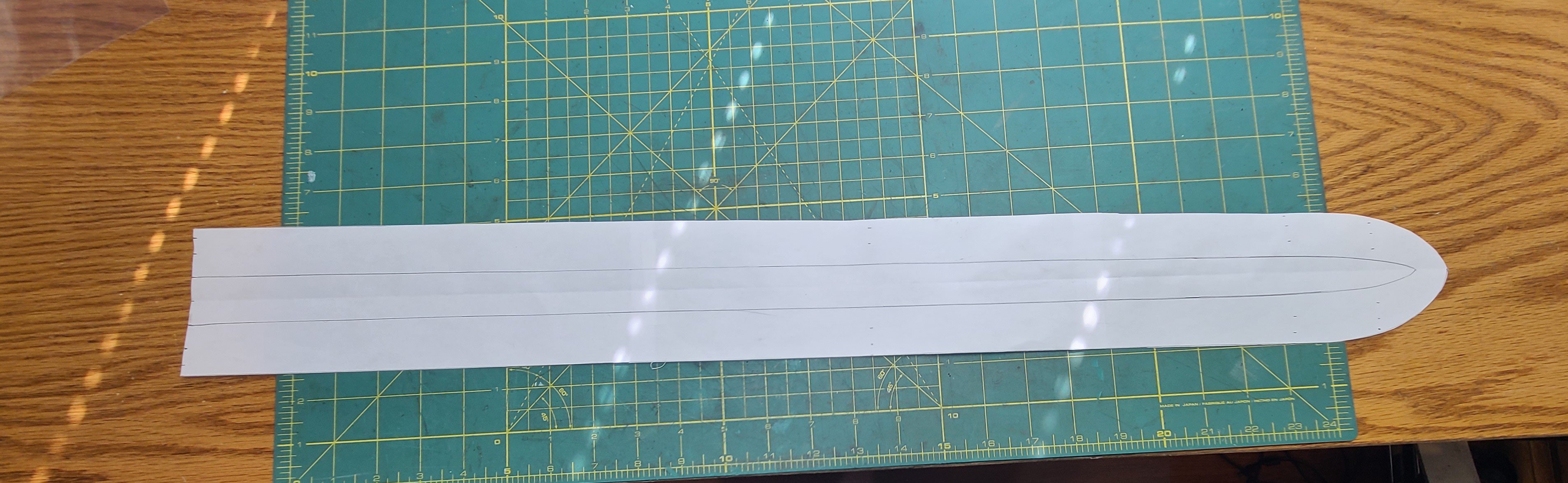

Patterning the cross belts.
The cross belt patterns are pretty straightforward.  After taking all the measurements off of the originals I lay them out and mark off the locations of all the punch holes.
Round holes for the length adjustment, button holes for the breast plate and scabbard, and diamond shaped stitching holes.

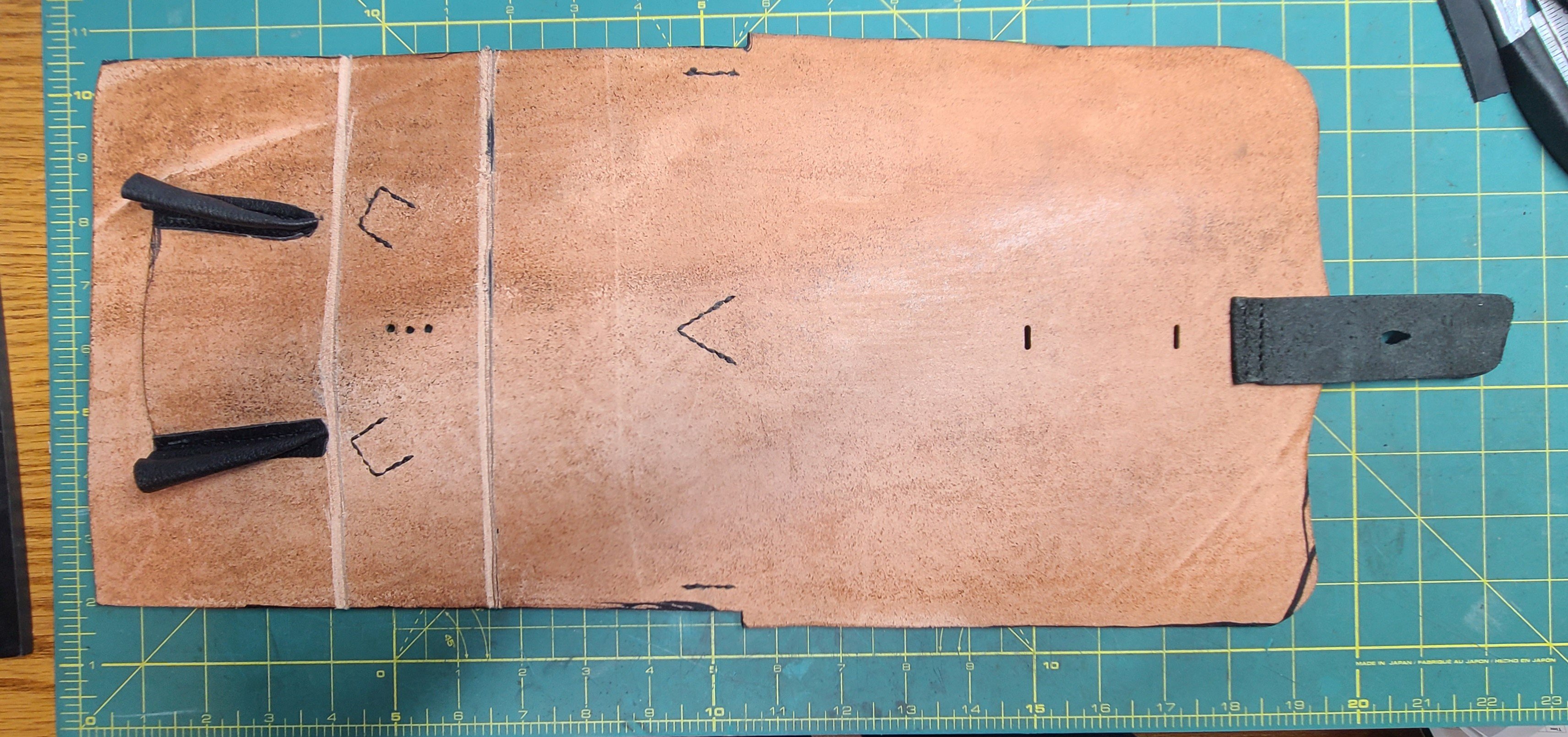

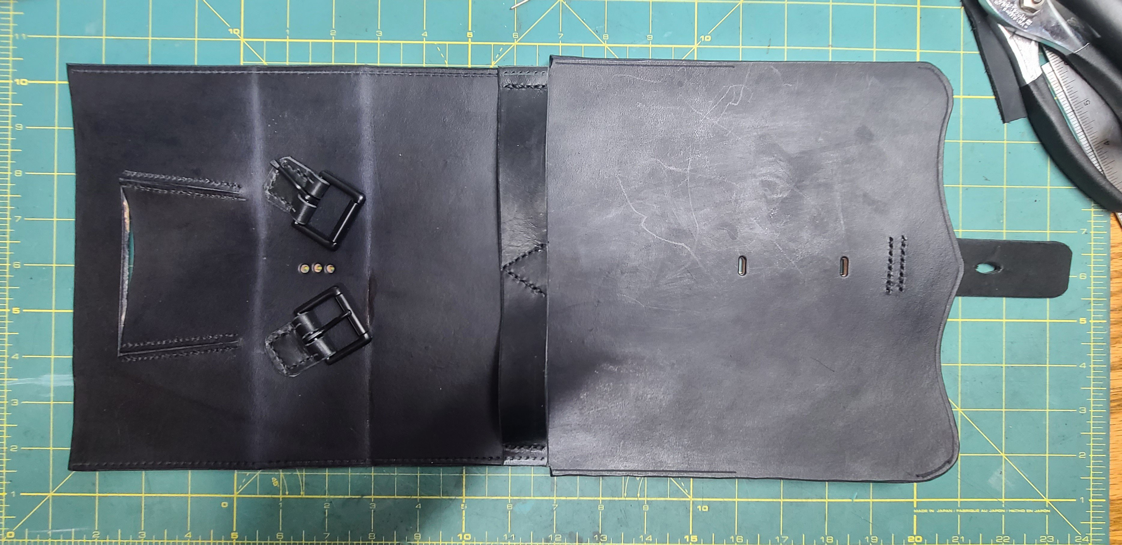

Here is the pattern for the cartouche box.

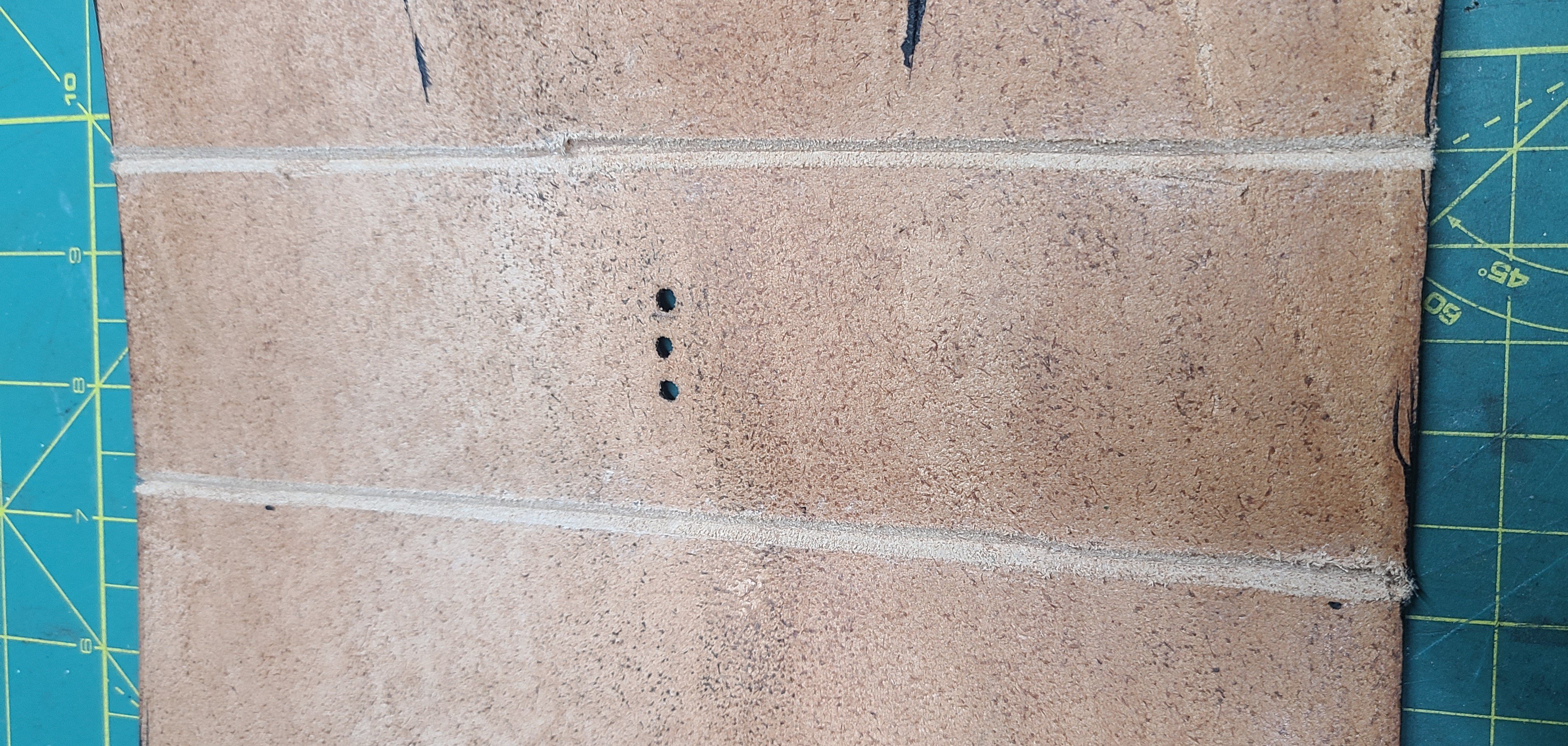

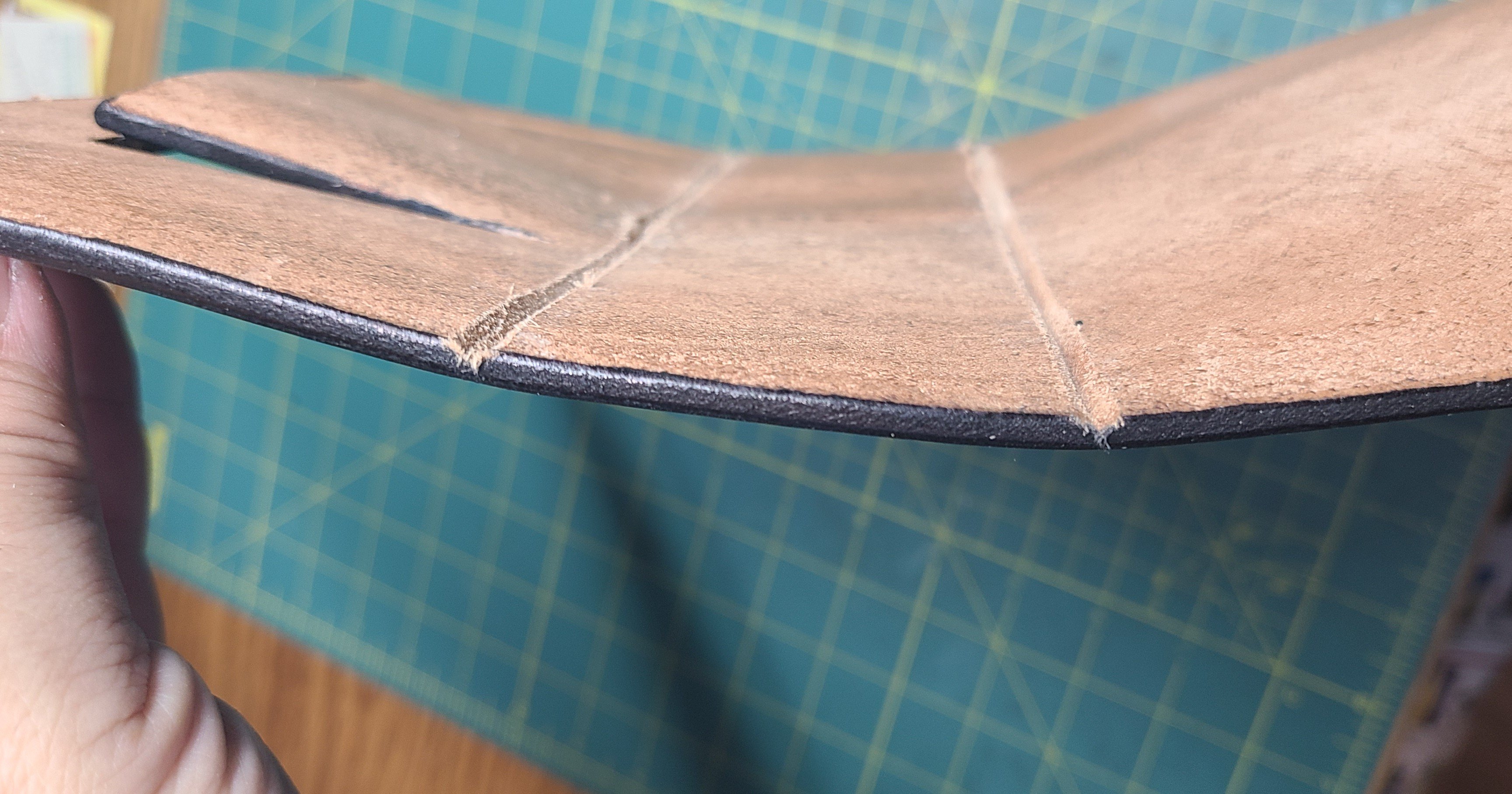

It's fairly complicated. The box itself is made in one piece and will be grooved and folded along the dashed lines (right side) to form the bottom of the box. The angled rectangles take the straps for the cross belt buckles.
The v-shaped stitching at center holds the cross belt keeper ( the long rectangle at bottom of picture). The two oblong holes take the marine emblem plate for the cover.
There is a closure strap at the cover end (decorative curved left side). The leather toggle that will hold the cover closed is not shown. That will be fastened through the three small holes to the right.
The trapezoid shaped flap cutout on the right is to access the tray that will be inside the box. Your supposed to be able to access that tray while the box is closed to get at spare flints and the like.
At the bottom are the various pieces that get stitched on to the main body piece. The circle (will be two half circles when finished) form the side walls of the cover. The domed rectangle is the side walls of the main box. The triangular piece with the trimmed off corners will be gussets for the access flap.
The last two items are the closure strap and the buckle straps

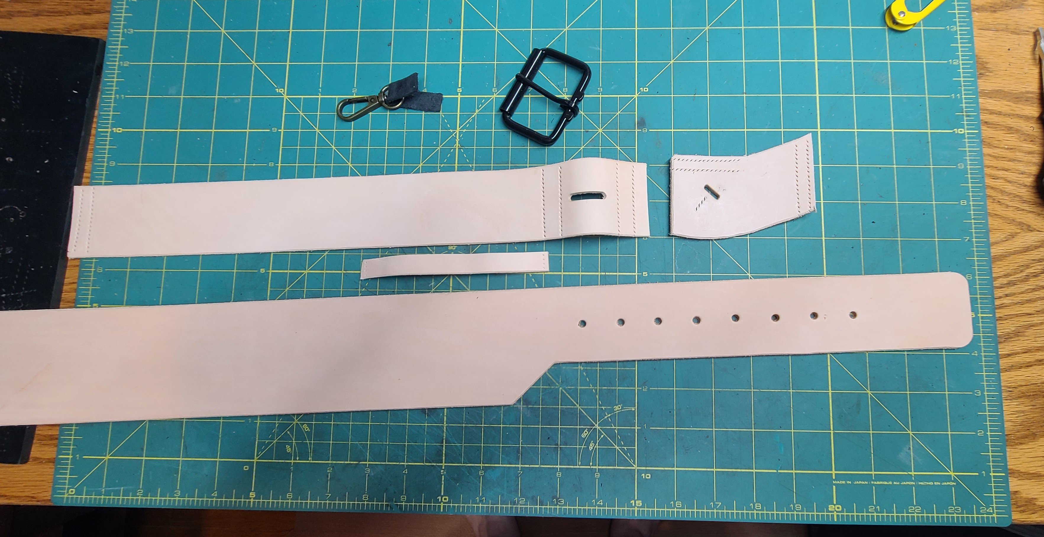

First up is to cut 2 1/4" strips of leather from the veg tan sides.  Using a long straight edge I squared up one side of the hide.  Then it is a simple process of setting 2.25 inches on the strip cutter and running it down the trued up edge. I was able to get enough strips for 6 sets of cross belts.
Next is to punch all of the holes according to the patterns.  Using an edging tool I knocked off the corners of all the edges so that they can later be burnished to a smooth rounded surface.  The grooving tool is then employed to prepare the stitching lines and then the stitching irons are used to punch the holes for the saddle stitching that holds everything together.
After all the tooling is done it is time for the dye.  I am using Angelus Brand flat white acrylic leather paint.  As I have mentioned previously, I do not know of anyone who is currently making a true leather dye in white.
First step in preparing for the dye is to go over the leather with isopropyl alcohol. This cleans the leather and also raises the grain a bit so that the dye adheres better.
Next, I started applying the first coat which is about a 50:50 mix of dye with water.  Apparently the water allows the paint to penetrate the leather a bit so there is less tendency for it to crack and flake off. This will be repeated for a few coats with gradually increasing concentrations of dye/water. The idea is to build up multiple thin coats of dye to create a more flexible robust surface.  It is always better to lay down the dye in thin coats rather than one thick coat.
Below is after two coats of white dye. It is hard to se in this picture but you can still see the natural color of the leather through the white.  It is going to take a few more coats to get the depth of color that I want.
The top piece is actually from the officers sword belt, which I have just started to cut. I also need to start cutting the pieces for the cartouche box and making the pattern for the neck stock.  All of that cross-hatching ought to be fun. I may have to buy a new tool for that in order to get consistent depth grooves for the cross-hatching.
Notice, also, that the button holes punched in the top belt are what happens when you don't keep your tools sharpened.  There is a big difference in how clean the holes are from the bottom two pieces.

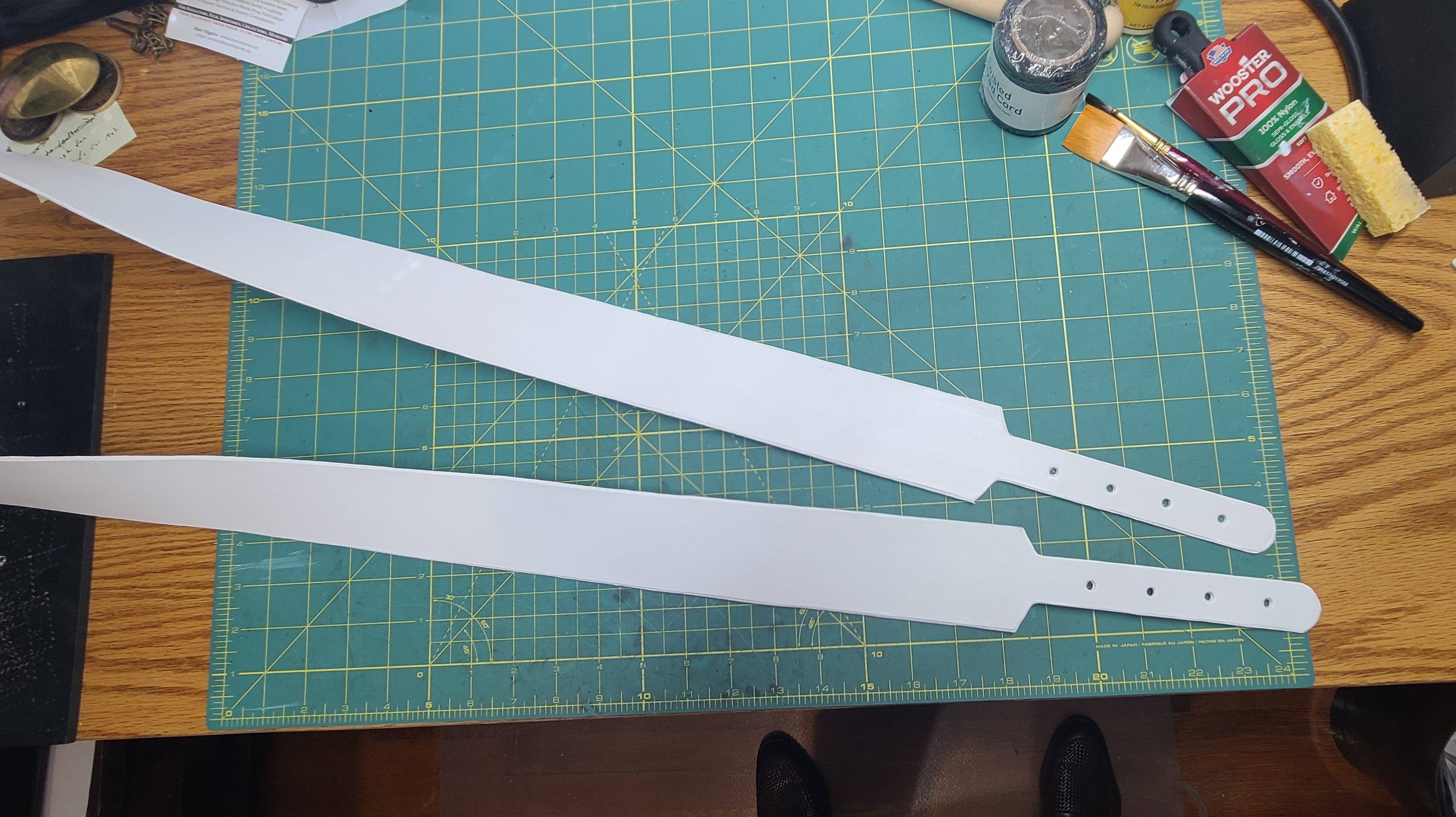

I finished dying the leather white.
It took 4 coats of white dye to get the coverage I want.  The first coat was 50:50 water with increasing concentrations of dye applied in the later coats. The final coat was close to 100% dye.
Now that the leather is white there are still a few more steps before I can start stitching up the pieces.  The water based acrylic really dries out the leather.  You can see in the picture where the edges of the leather have curled.  The next step is to get some moisture back into the leather by applying neatsfoot oil. Neat is an Old English word for cattle.  The oil is literally rendered from cows feet. Since the acrylic dye essentially seals the top of the leather the neatsfoot oil is applied on the flesh side (back) of the leather.
After the neatsfoot oil has been applied, I apply a topcoat satin finish over the dye to further seal and protect the dyed leather.  Next, if the piece needs more moisture I  will do another application of neatsfoot oil before starting on finishing the edges and the back of the pieces.

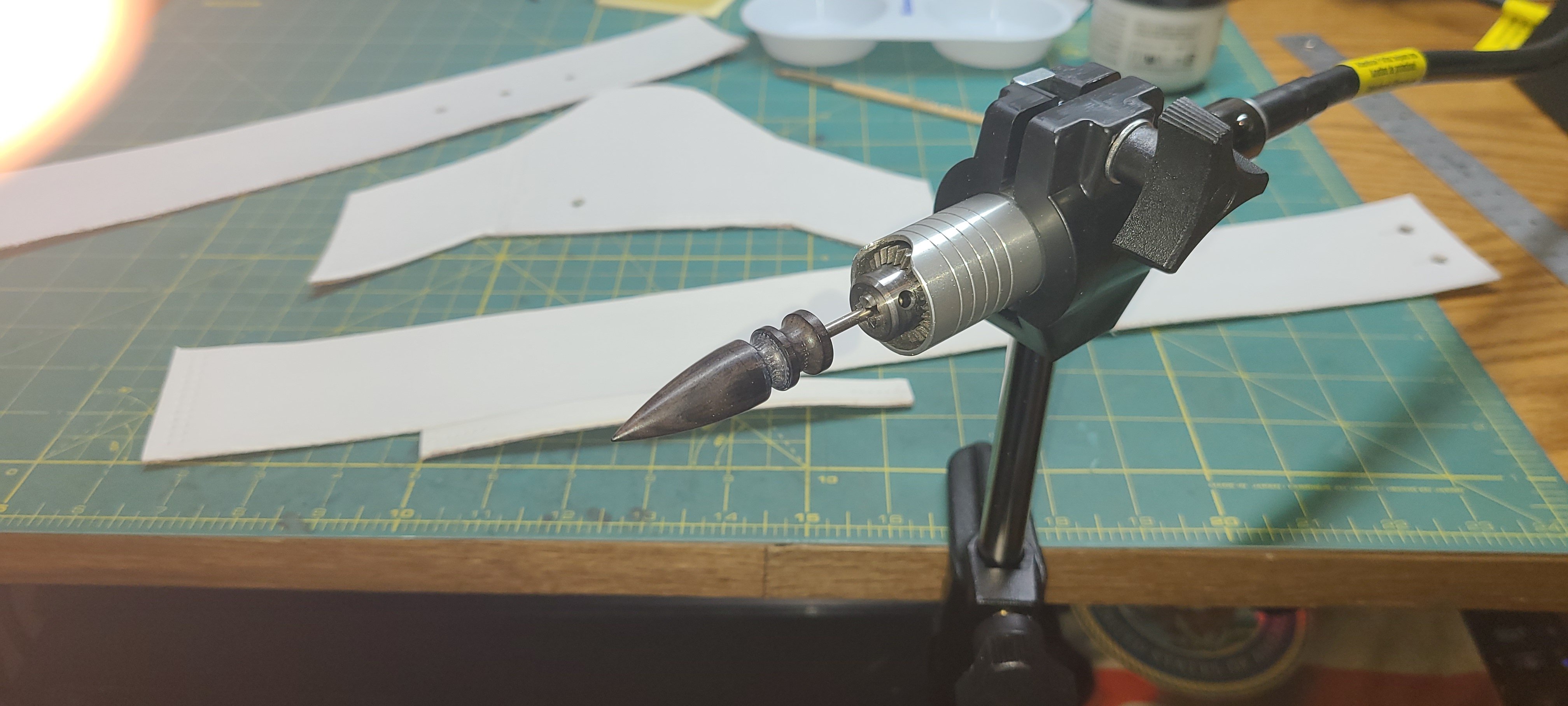

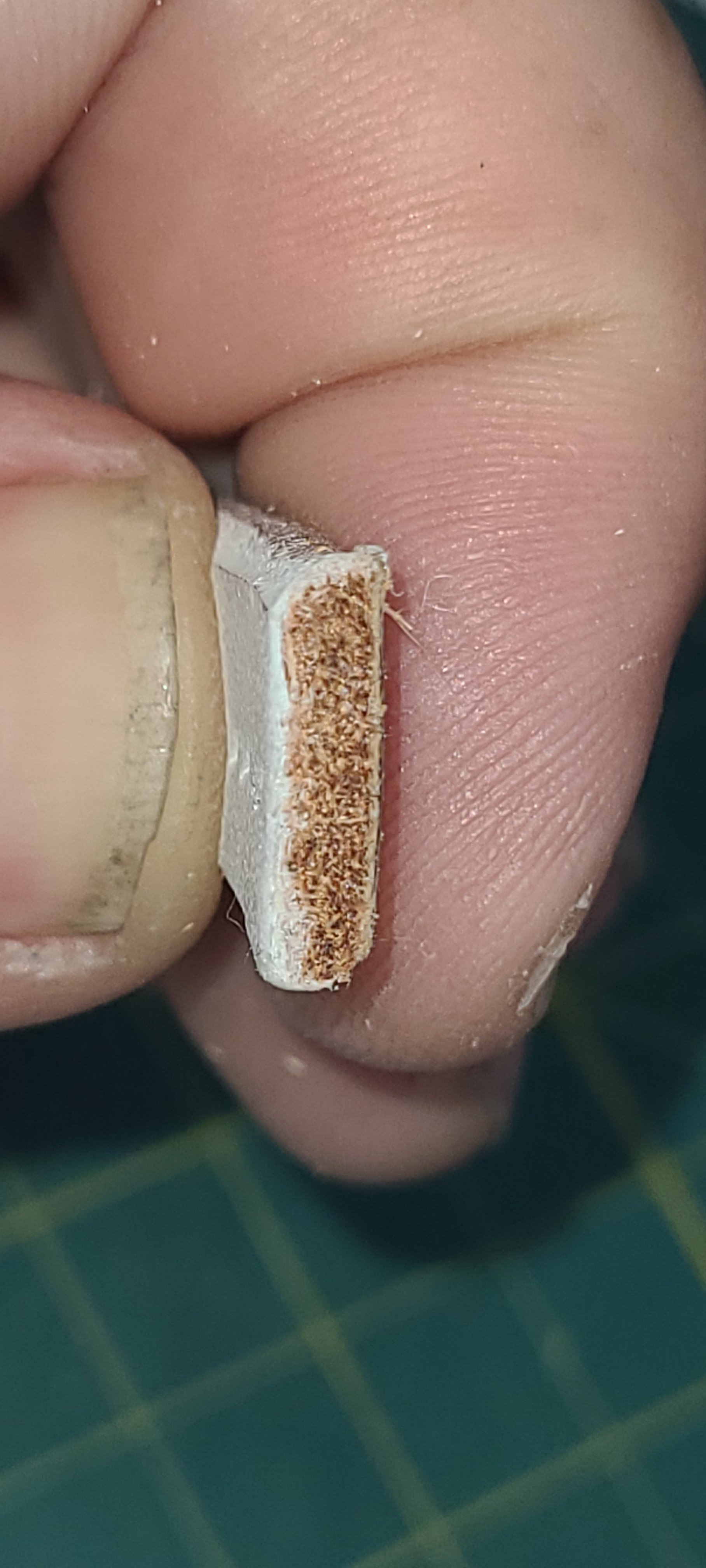

Now that the fronts of the pieces are done and the leather has been re-moisturized with neats foot oil, it is time to start finishing the edges and backs.
I set up my Foredom drill handpiece with a wooden burnishing tool. The desktop mount is a brand new acquisition. I found that setting the tool up in the drill press mount was a bit awkward.
The first pass through the burnisher is with the edge wetted with a little water.  This starts to shape and round over the edges.  The next passes are done after applying a gum compound called Tokonole. It is a Japanese burnishing gum.
A light coat of the Tokonole is applied to the edges and allowed to partially dry before burnishing.
The result is a smooth, rounded edge, ready for a white edge coat. You can see the contrast with the raw rough edge in the pictures below.
Burnishingedges2.thumb.jpg.3278eeb546ee0f80289b7d28935604b6.jpgBurnishingedges3.thumb.jpg.6b7b3b5642f6fd13b5e2018a947341f4.jpg
Now that I am looking at that last picture, I can see that I am not quite done.  Another pass through the burnisher is due.

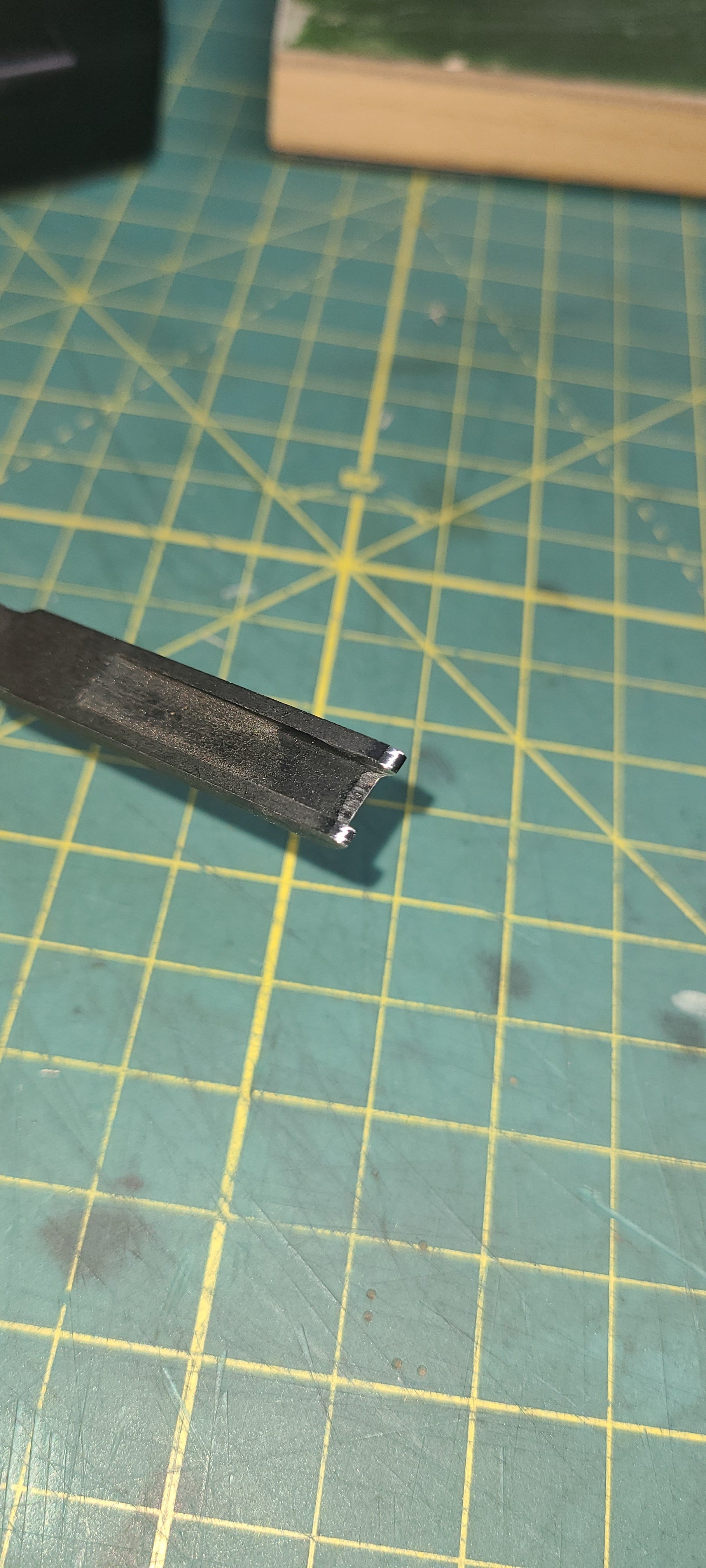

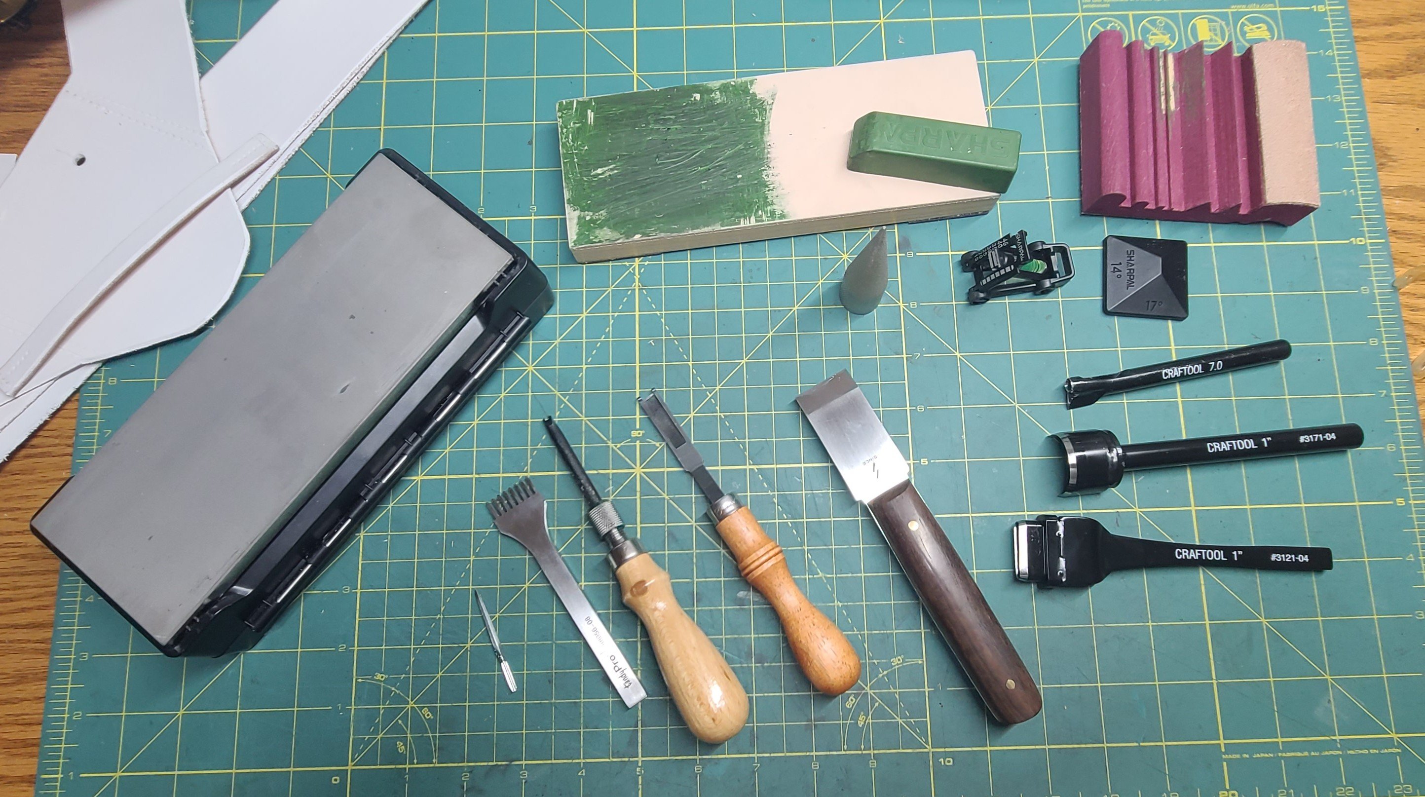

I promised you a short piece on sharpening,
Here are some of the tools that need to be extremely sharp in order to get a clean cut when tooling leather,
The other items across the top of the picture are the sharpening tools. The black box on the left holds a diamond grit sharpening stone with two sides; course 325 grit and Extra fine 1200 grit.  I would prefer to have an additional intermediate grit, but I have not ordered that yet.  I have been using the 1200 grit to keep my tools sharp. The 325 grit is really useful to put a fresh edge on a tool. It can remove a lot of metal.
Next to it is a leather strop that has been charged with a polishing compound.  I use this frequently between every few cuts to maintain a keen edge.
In front of and to the right of the strop are a couple of gauges that can be used to keep the tool at the proper angle when honing the edge.
The multi grooved tool at far right can be charge with polishing compound to hone the inside edges of curved and pointed gouges.

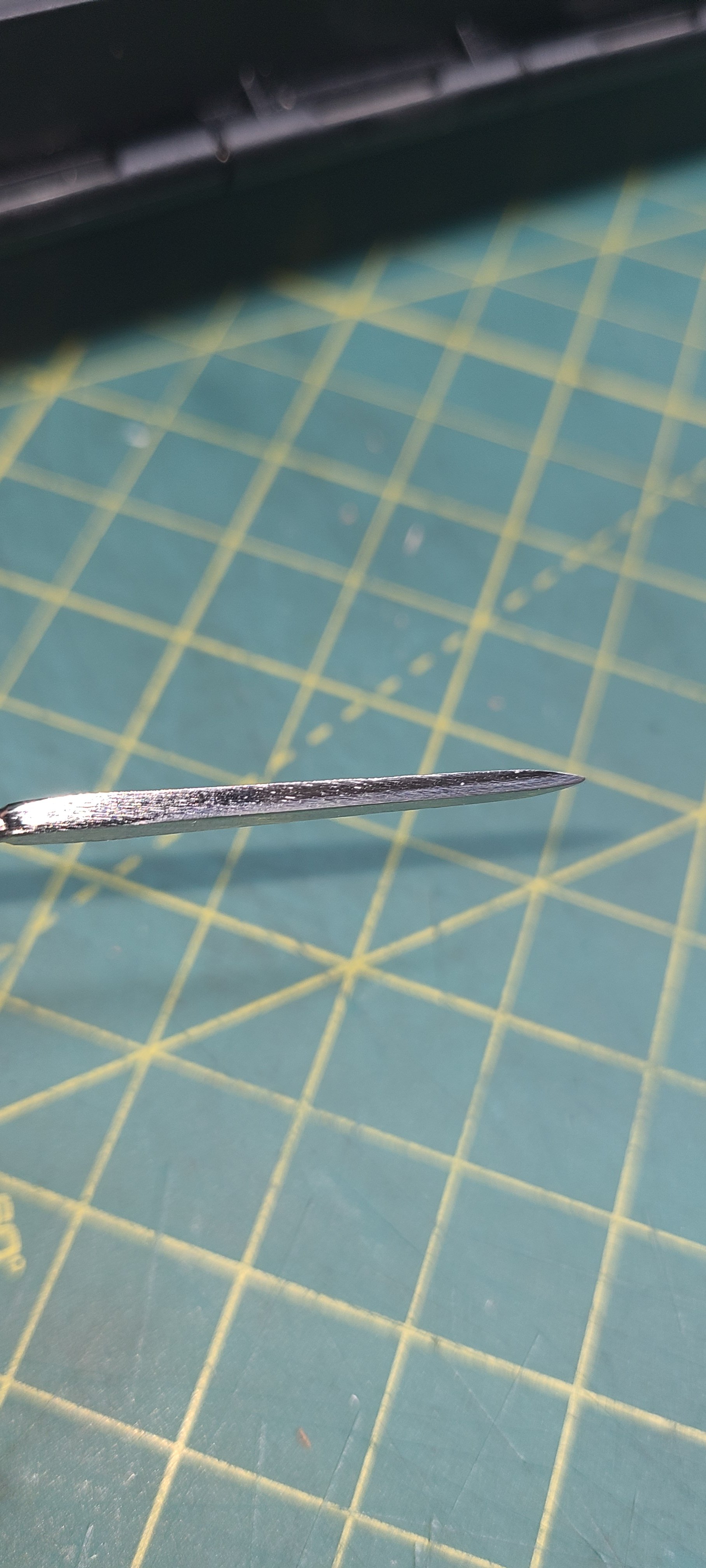

Finally, the cone shaped item in front of the strop is a diamond grit round tool sharpener. The cone is hollow with diamond grit on the inside face also so that one can sharpen the inside and outside edges of round punches.

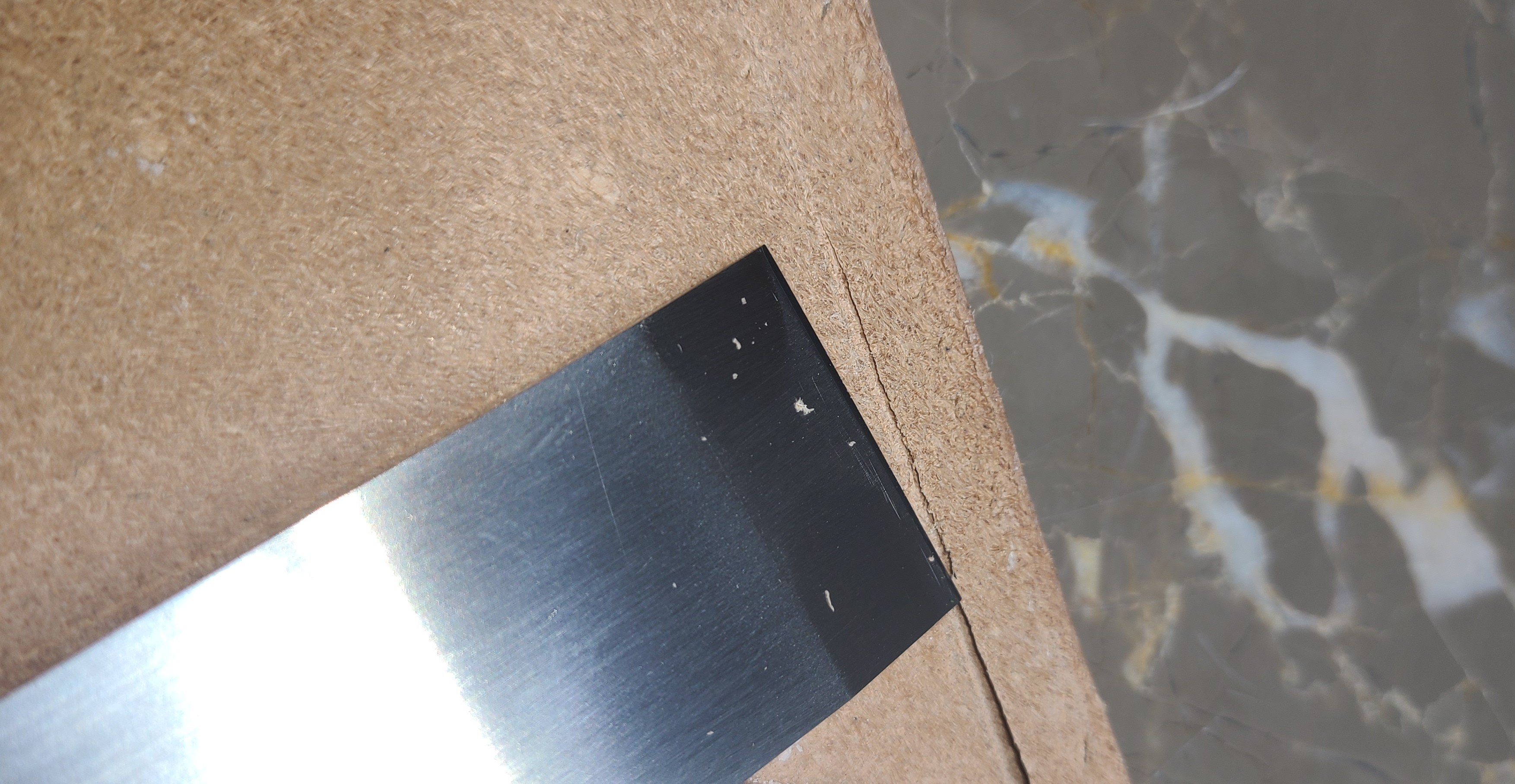

Some of the tools are fairly straight forward to sharpen. Once you get the hang of keeping the correct angle the flat knives and tools are easy.  What you are trying to achieve is the apex of the blade being centered and straight across the whole blade. When you get that right you will start to form a burr along the edge. The burr is essentially the sharp edge being tapered down to a microscopically fine point.  You then knock the burr off by stropping and you are left with a very fine edge.
The benefit to keeping your tools razor sharp will be very obvious as soon as you try to use a dull tool.  You can still get the job done but it is going to require a whole lot more effort and your cuts will not be as clean, You are also asking for injury because as your effort goes up so does the risk of slipping and sending the tool where you do not want it to go (your hand).
Here are some close ups of the above tools.
Diamondawl.thumb.jpg.848057705b904deb0e321e2a78207dc0.jpgThis diamond awl has not been sharpened yet.  I can almost guarantee that your tools will not be sharp enough straight from the manufacturer. This one is not bad but a few passes on stone and strop will polish the faces and make it push through and then pull out of the thickest leather easily.
Edgebeveler.thumb.jpg.f3a339a6212ae3f0762c83c9f2a39033.jpgFrenchedgingandskivingtool.thumb.jpg.444edfd3fffa6e2da9ec8a7978880f34.jpgThe edge beveler and the French edger are sharpened on their flat outside edges on the stone. The inside bevel is honed on the grooved honing block.

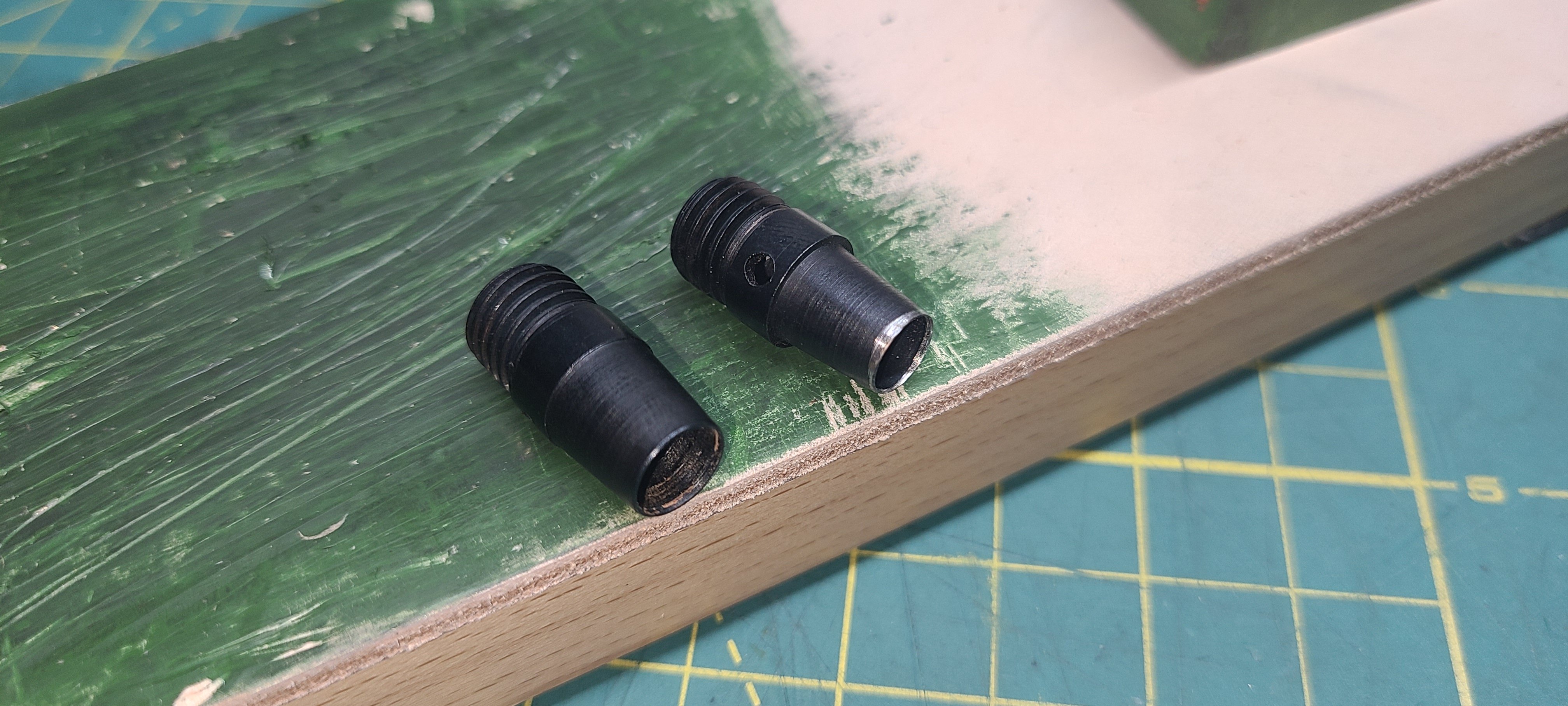

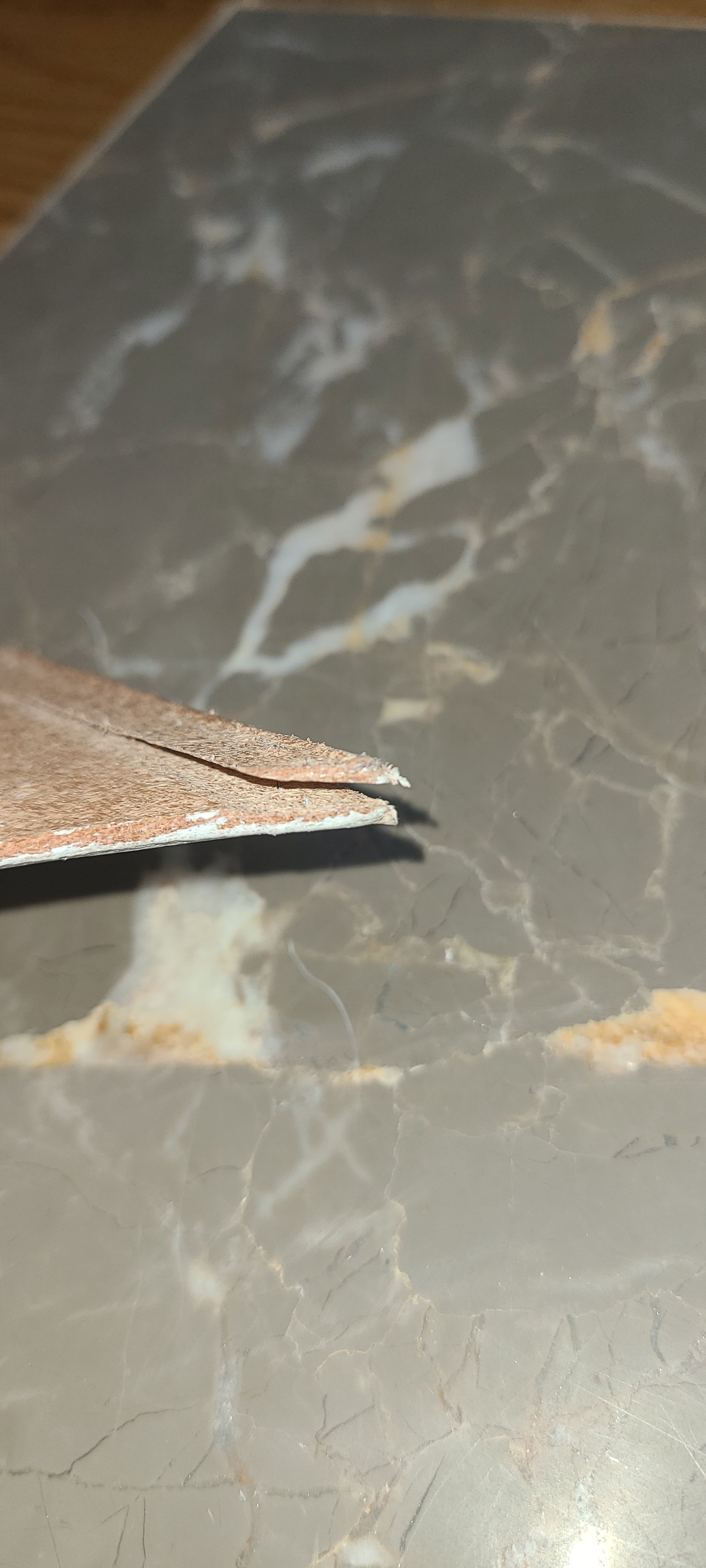

The round punches are sharpened with the diamond grit cone. The sharpening cone is pushed up into the punch and rotated to sharpen the inside face of the punch and conversely, the punch is inserted into the hollow of the sharpening cone to put an edge on the outside face of the punch.
The punch on the left is right from the factory while the punch on the right is after my sharpening.

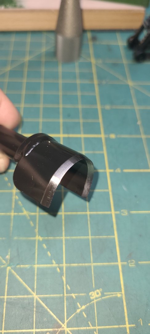

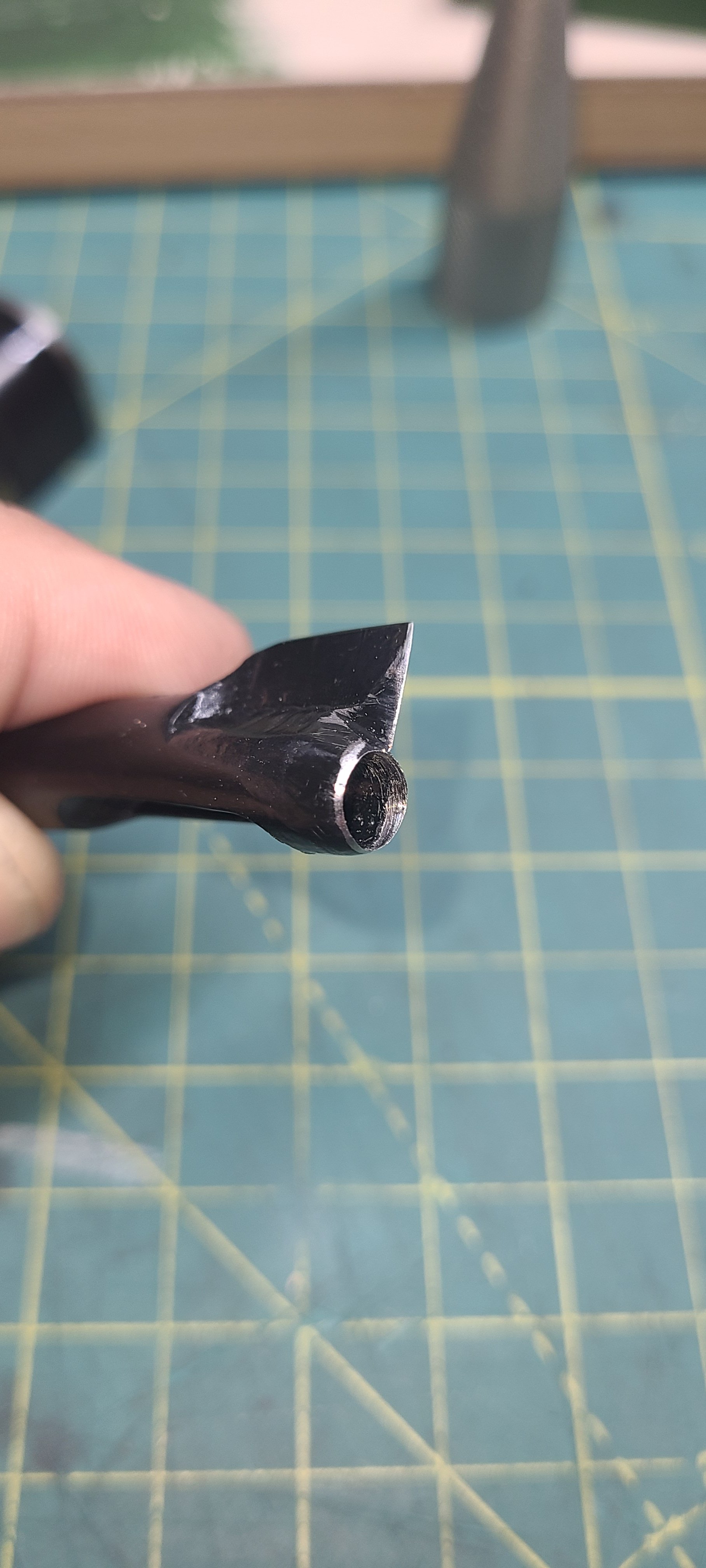

The most difficult tools to sharpen are the unusual shaped punches.  The round end punches are not so bad, but getting inside the oblong punch is not easy. And the compound faces of the buttonhole punch are a bit difficult.
Roundendpunch.thumb.jpg.970a0debb7db3daf76d005efbffa9483.jpgOblongholepunch.thumb.jpg.8b6d0b013592a51842fddb0cc868a186.jpgButtonholepunch.thumb.jpg.e1219c983164e995a3b7928cfb9cb21f.jpg
You can see where I could not quite get to the round part where it butts up against the straight section. There is actually a good size nick in the blade there that I may have to do some more heavy grinding to get out. That is where the 325 grit diamond stone will come in handy.

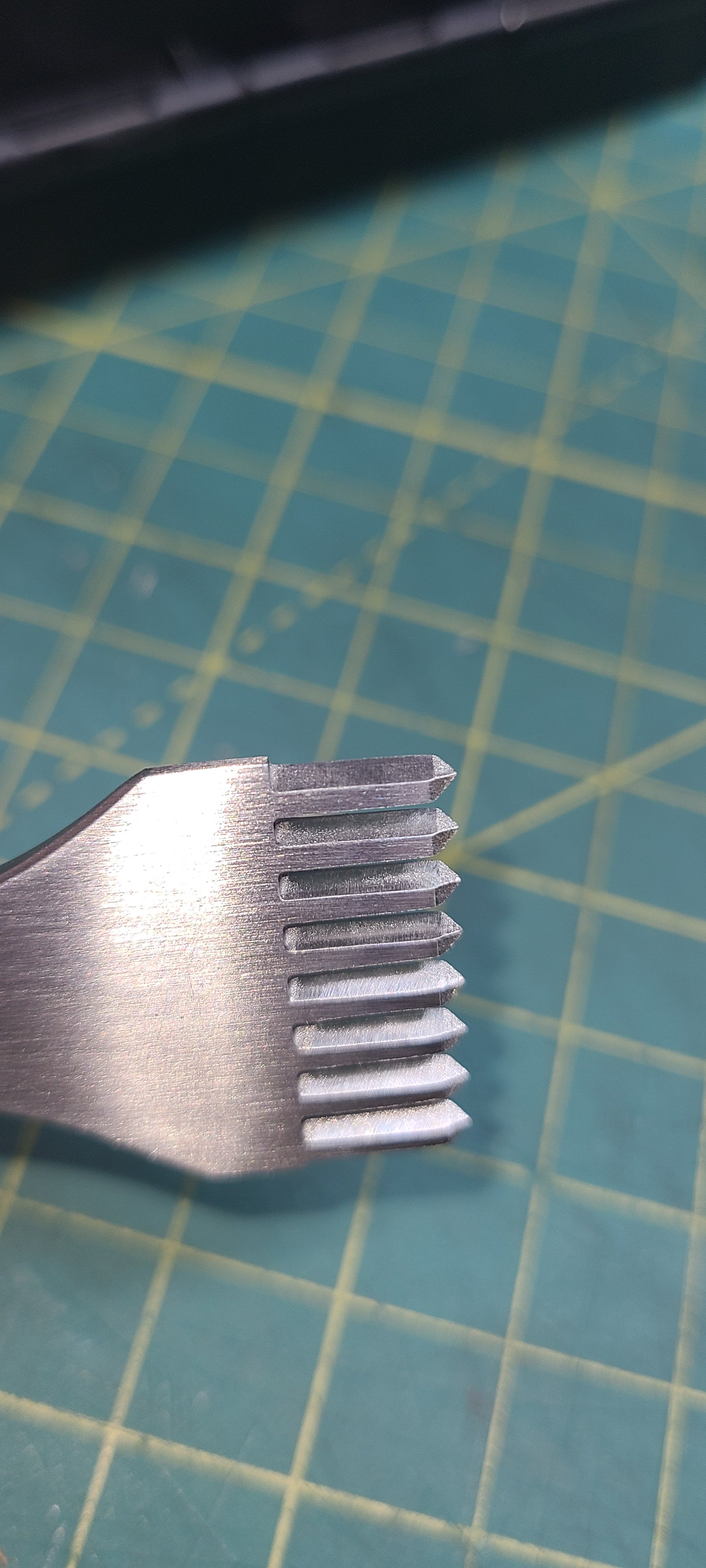

Finally we get to the diamond stitching punches.  These tools make the line of stitching holes for saddle stitching leather pieces together. The problem with sharpening these is that the blades are only 3mm from tip to tip.  Thankfully, you don't really have to sharpen them as much as polish up the faces in order to make them not get stuck in the leather.
Diamondstitchingpunch.thumb.jpg.e0fed95980386a93466725ee4ff4dc87.jpgSandingdisk.thumb.jpg.b0e8f613c1fb5ccf8d391615b67d44b3.jpgFor these stitching irons I use a 240 grit sanding disk chucked into my Foredom drill handpiece that is held in the bench mount. The 240 grit is probably too aggressive but it is what I have on hand.  I introduce the stitching iron to the disk at a relatively low speed with a very light touch to just polish the face. You don't want to change the shape of the blades. You can see, if you look closely, that the fourth blade from the top, I did just that.  It is no longer perfectly even from end to end. It will not really affect the work, but I was highly annoyed when I did it.
There you have it.  Sharpening your tools is well worth the effort. It makes the crafting so much more enjoyable.

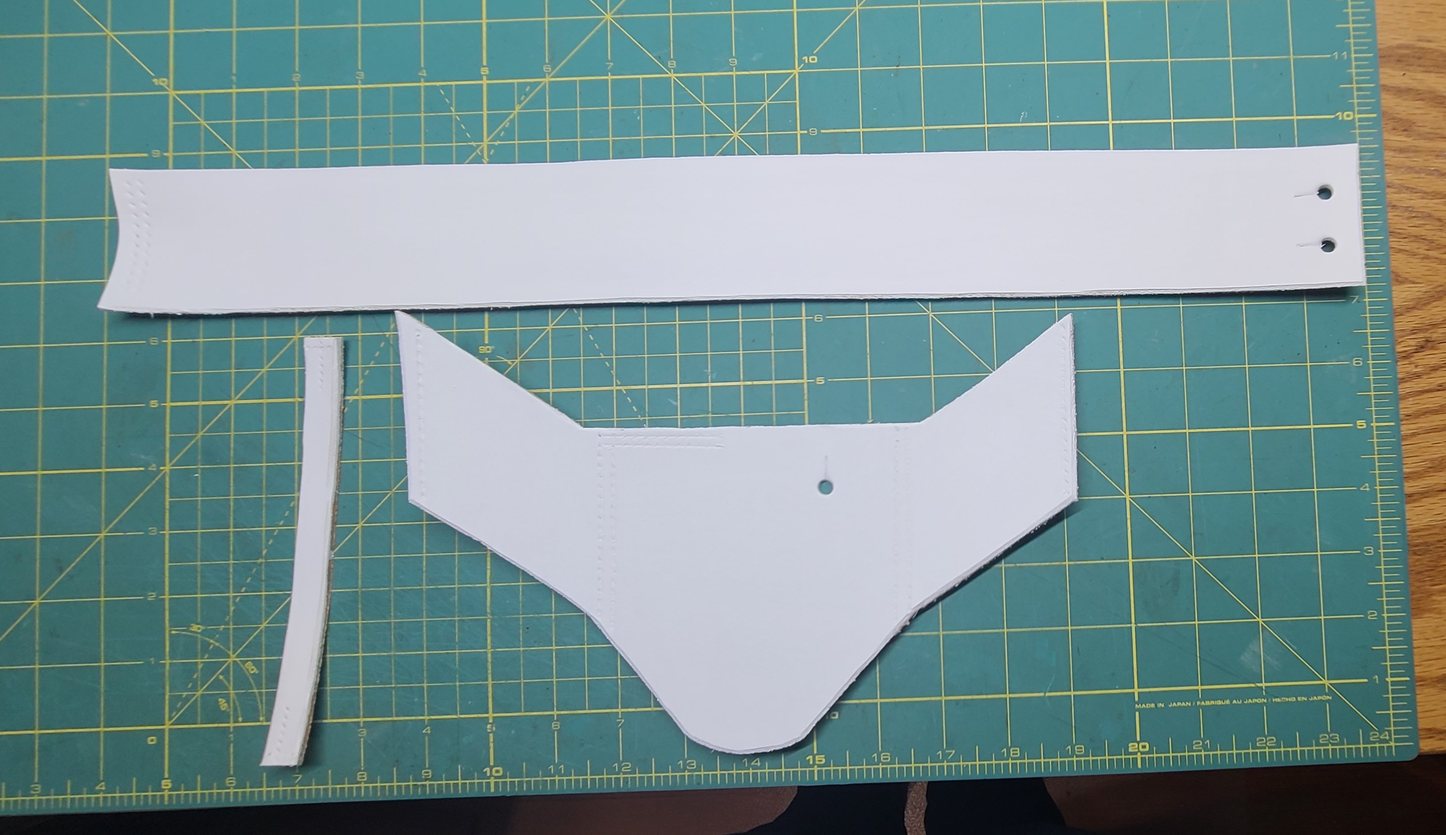

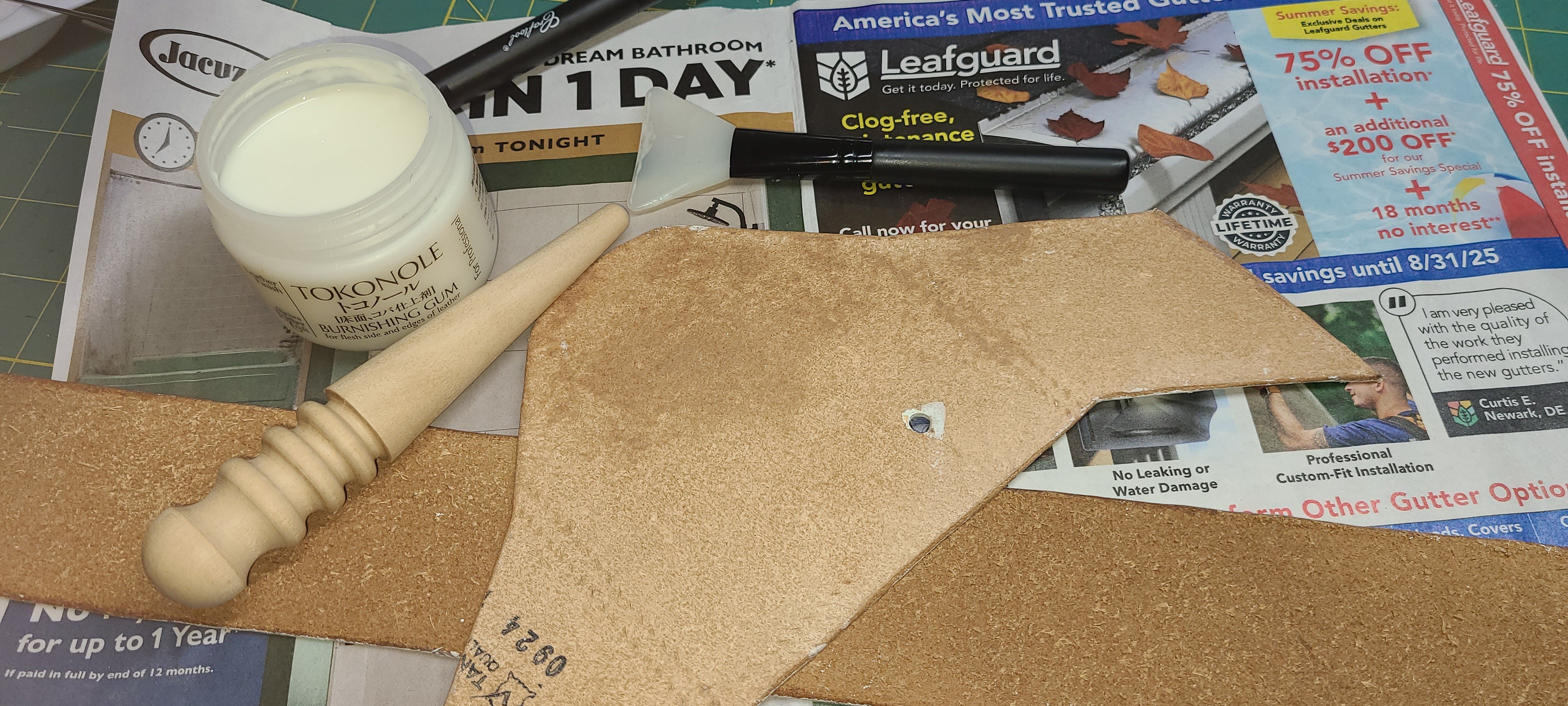

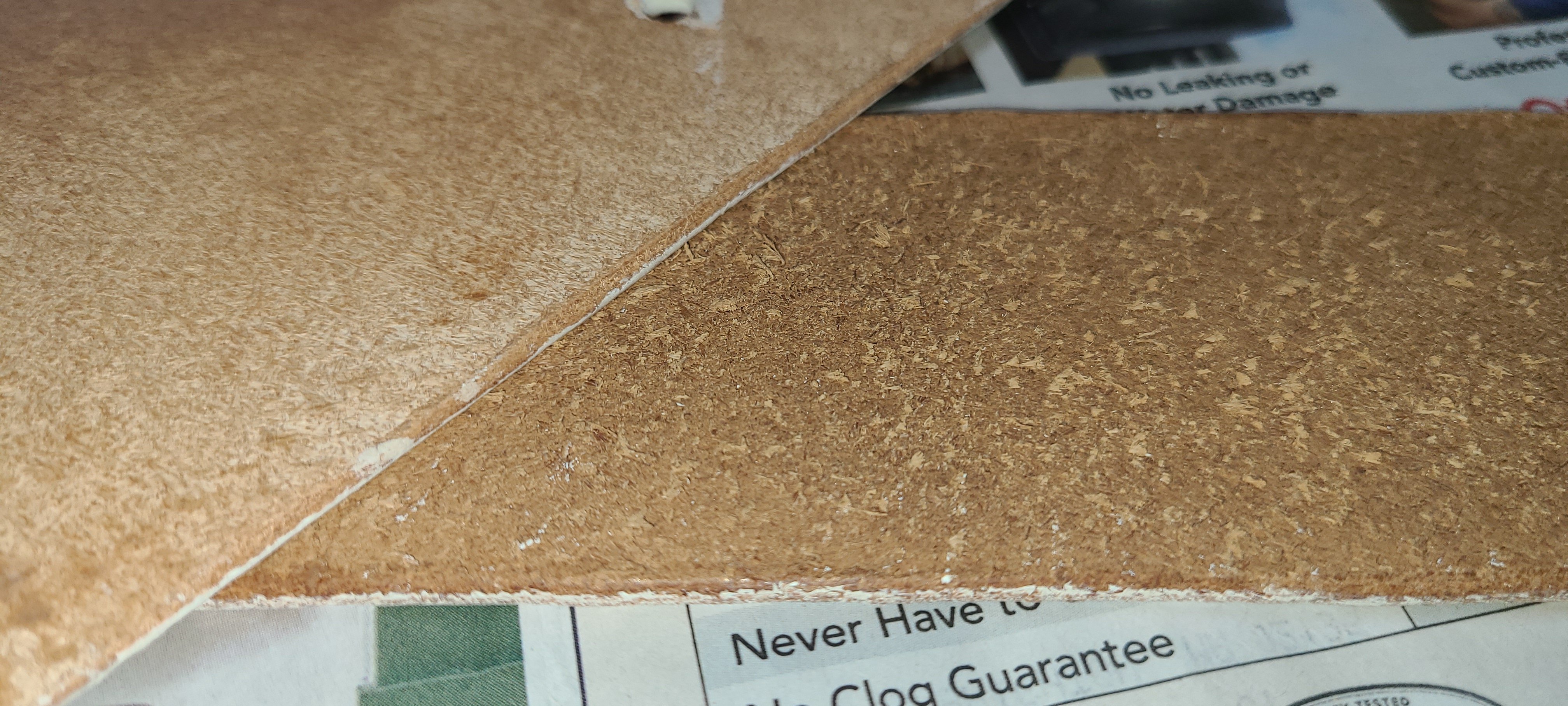

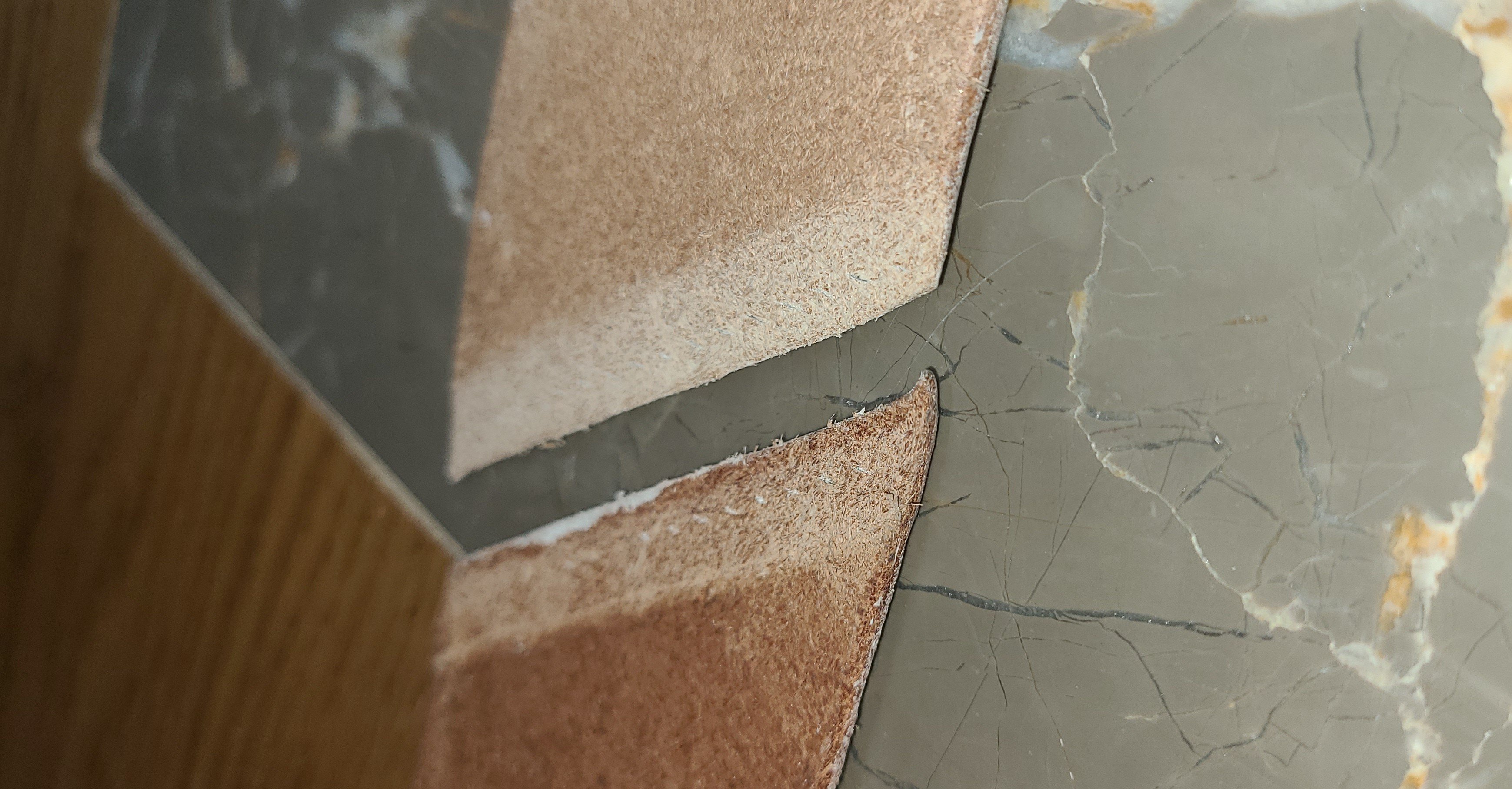

More progress on finishing the edges and backs.
The edges round over and polish up nicely with the burnishing burr mounted on the drill.  I am moving on to the backs of the pieces.  The nap of the flesh side of the leather needs to be knocked down and polished and a coat of dye applied. I don't need it to be super finely finished because it will be on the inside of all the cross belts when worn. It just needs to be whiter instead of raw leather.
Below are the items used to accomplish this part.  Tokonole Burnishing Gum, a thin spreader, and a wood burnishing tool
In this second photo, you can better see how much the nap is knocked down. The piece on top is finished ready for white dye.
Next step is dying the backs white followed by white edge coat, and the pieces will be almost ready for assembly.

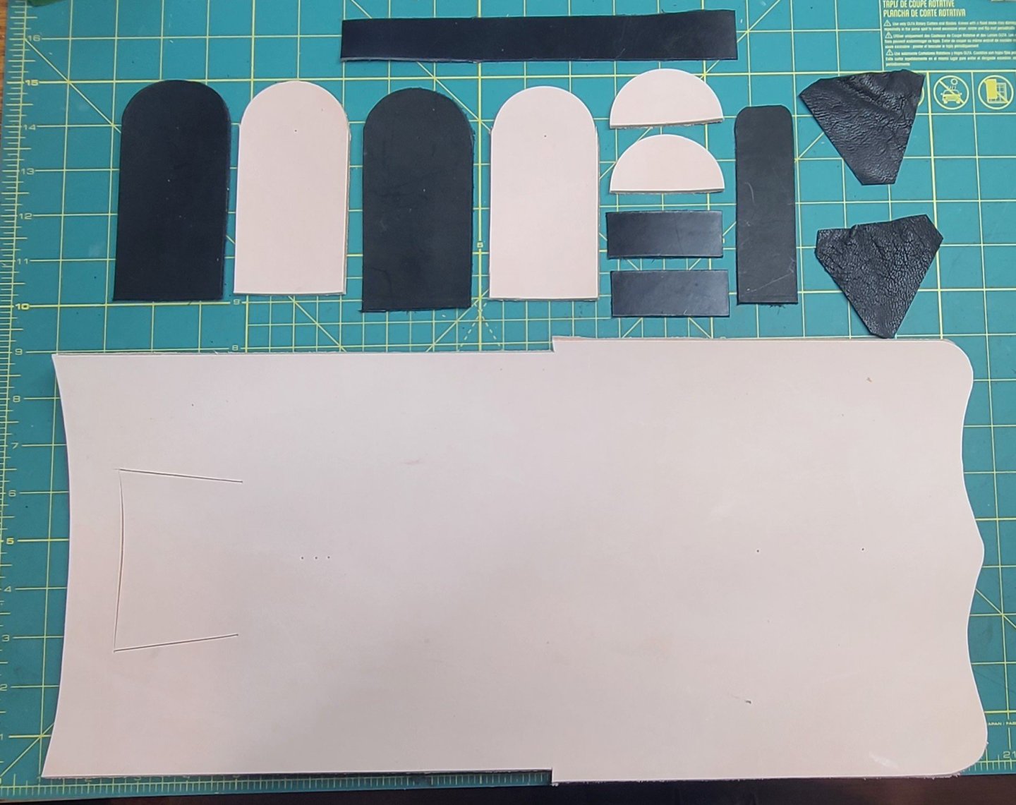

I am waiting on delivery of another item before I dye the backs. There needs to be a little bit of thinning of the leather where some of the pieces come together.  I am waiting on some alignment pins before I can get the locations for thinning marked.

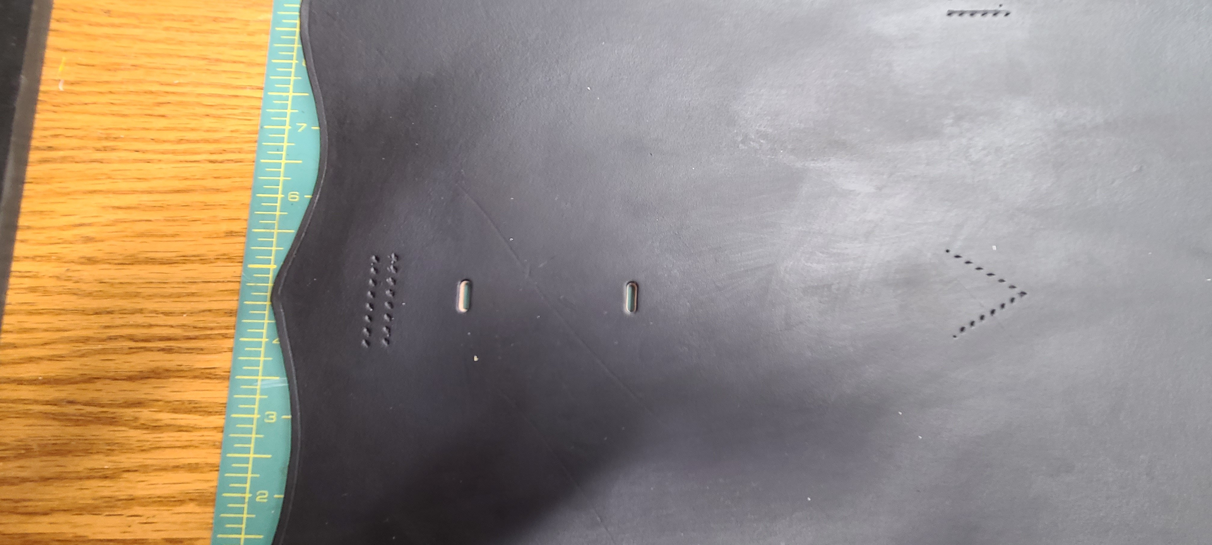

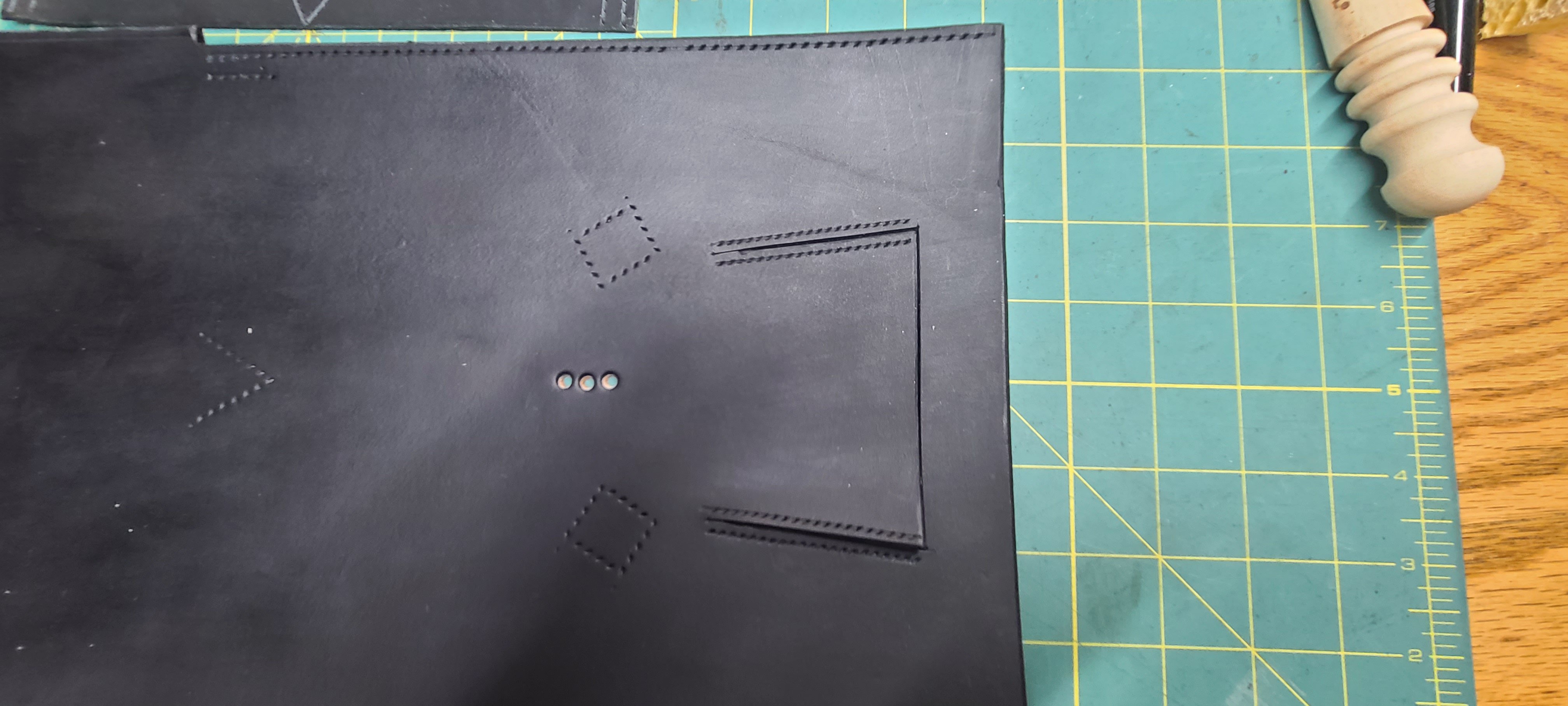

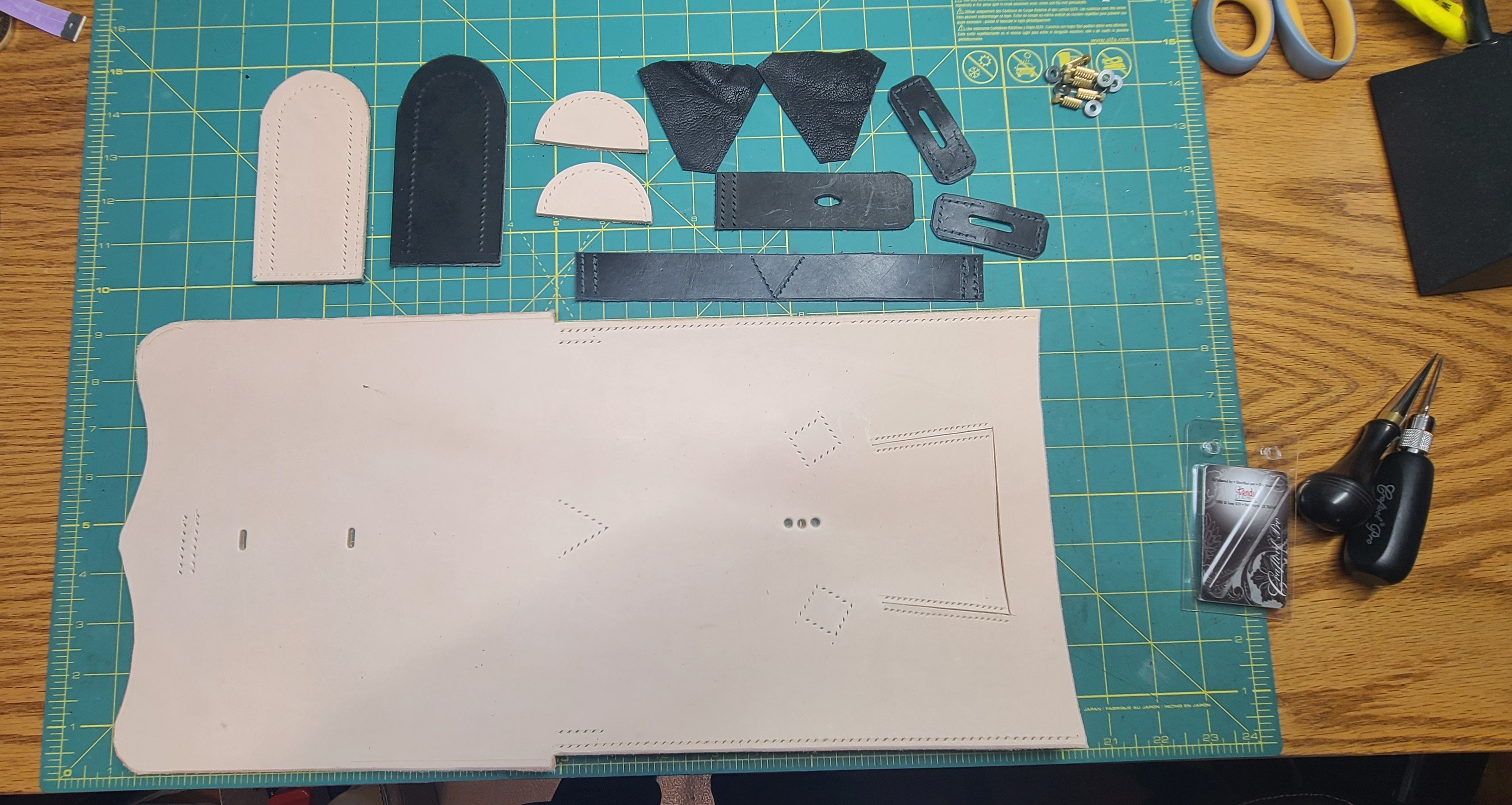

In the meantime I have started cutting leather for the cartouche boxes.

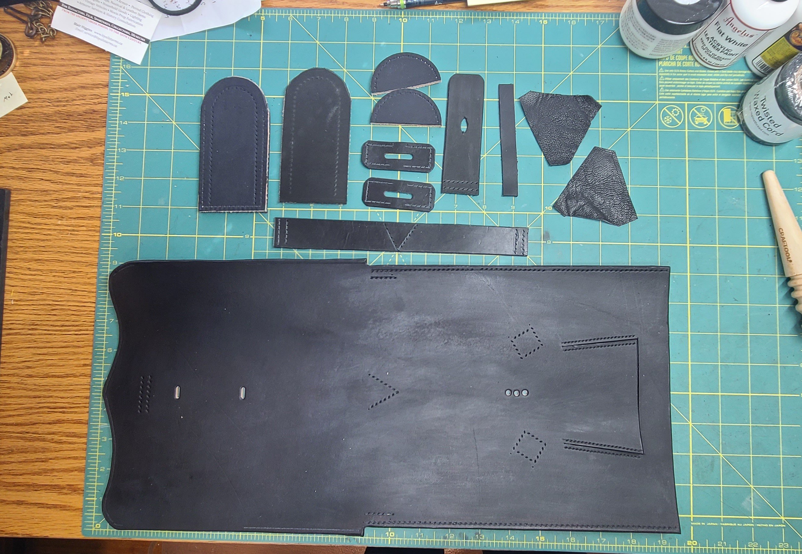

Here are all of the pieces that make up the cartouche box. The body of the box is at bottom. It will be scored and folded to make the front, back, and lid of the box (lid on the right). The box end pieces with their linings are the tombstone shapes. The half circles are the lid ends. Beneath the lid ends are the buckle straps for the cross belt. Next to the right is the closure strap and two gussets for the access panel in the front of the box. Above is the keeper for the cross belts that run across the back of the box.

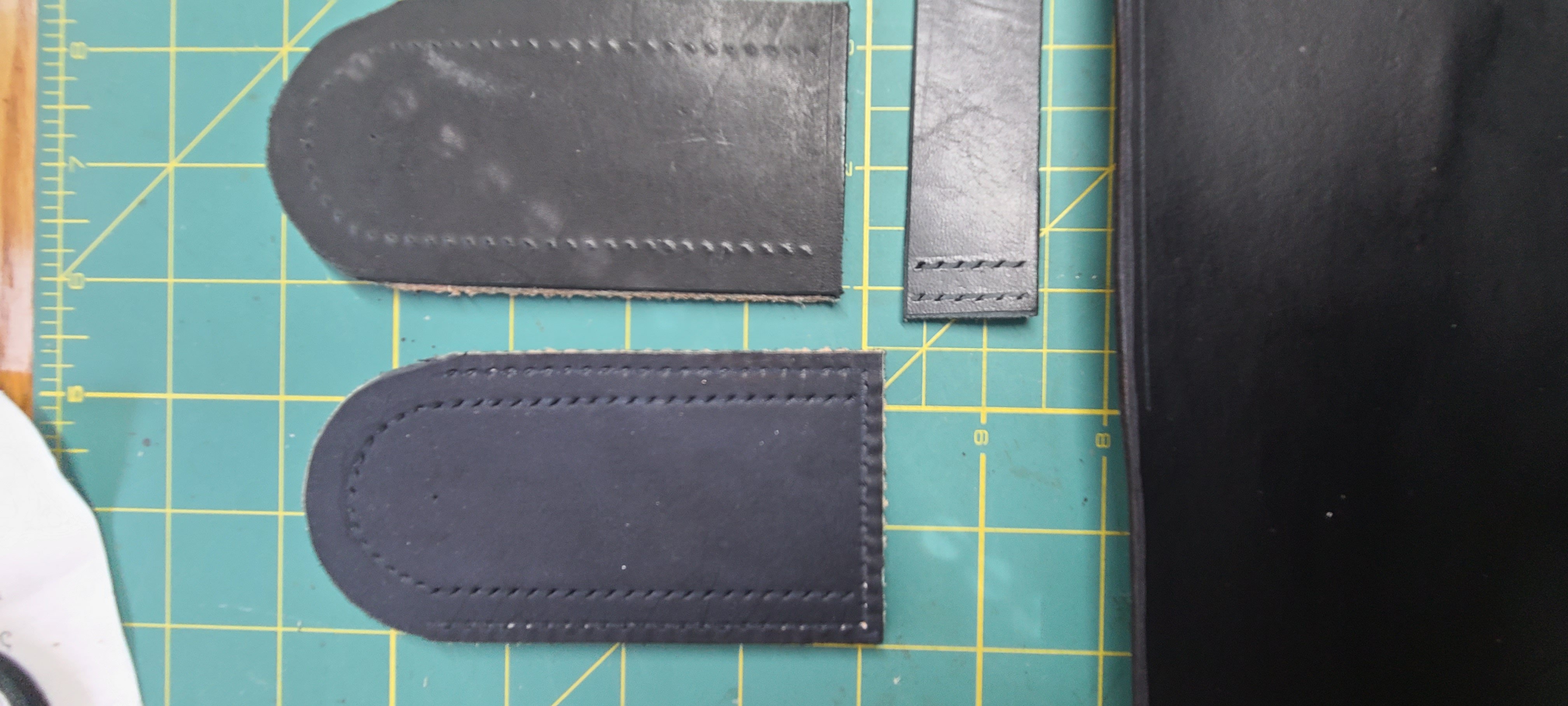

All pieces will be black. I still need to punch all of the stitching holes.  One last piece that I have not figured out how to make yet is a leather knob like object that fastens the box closed.
Stay tuned.

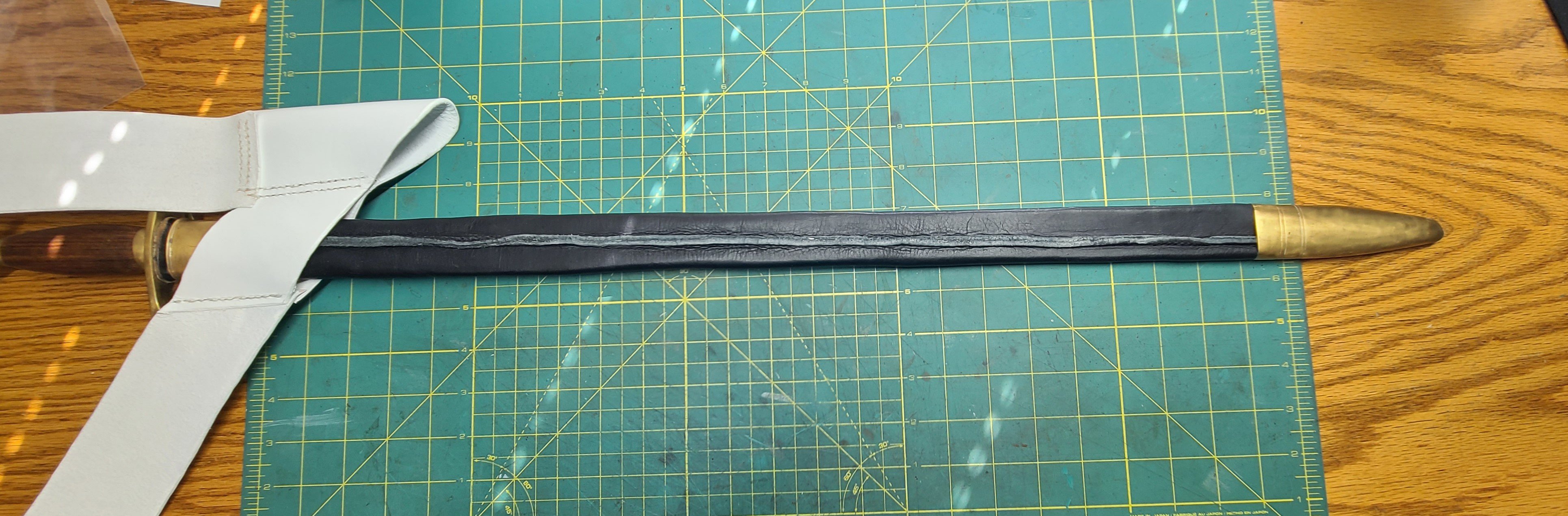

I did decide that my existing sergeant sword scabbard and baldric was not in good enough condition to pass along to the new sergeant so I made him a new one.  I will include a photo and brief explanation of the manufacture here also.
So, to continue...

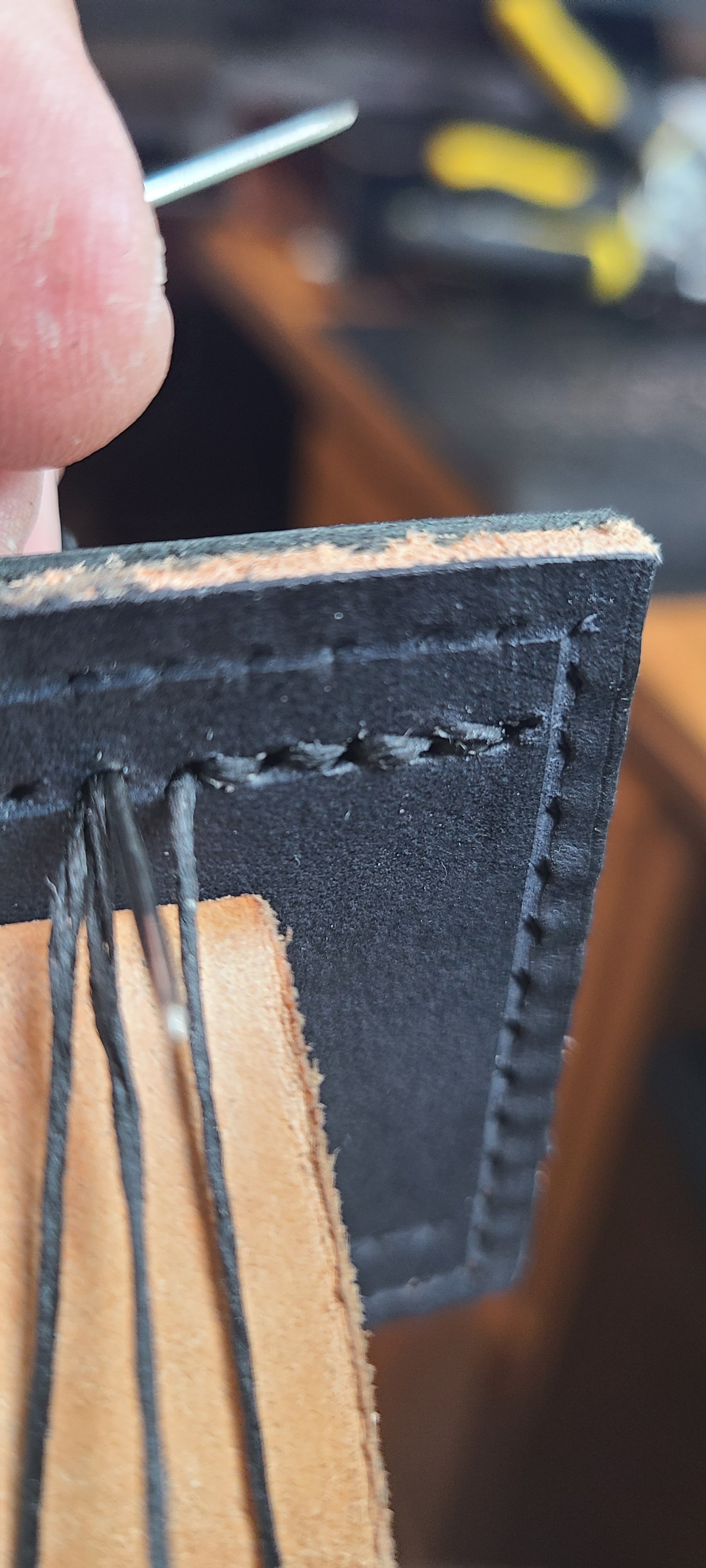

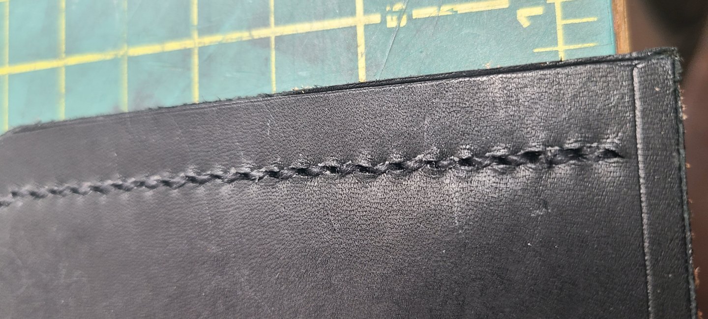

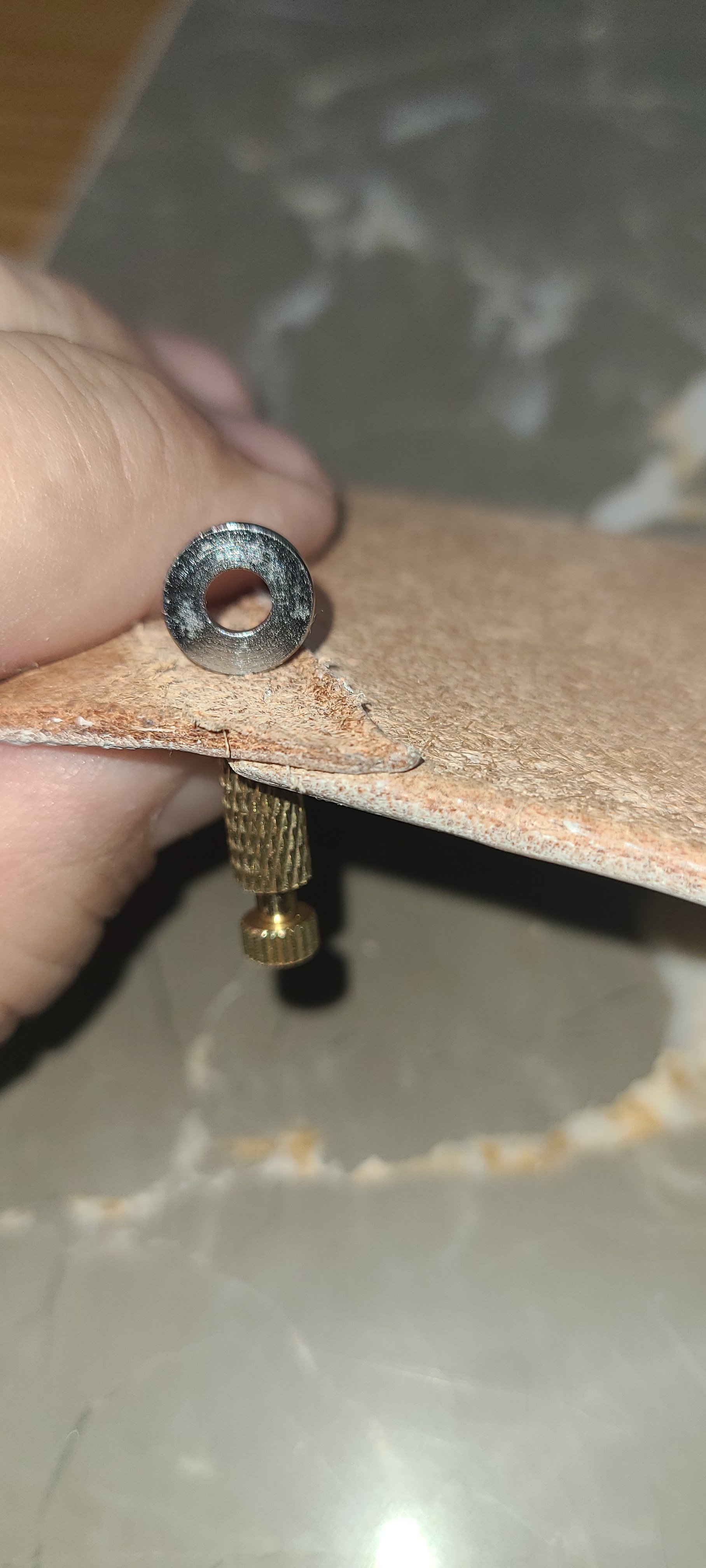

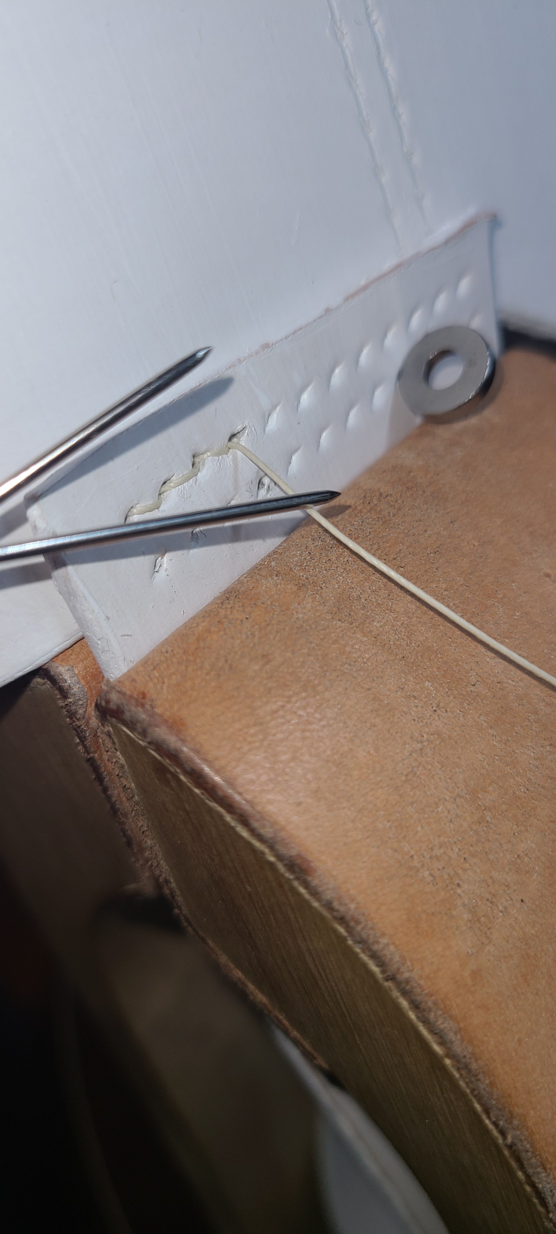

I received those alignment pins mentioned earlier.  You can see them in the upper right corner of this next photo.  The pins are helpful in holding two or more pieces together for alignment, punching, stitching, etc.  Here are all the pieces of the cartouche box with all of the holes punched. The box end linings have been glued to the facings with contact cement. They will also be stitched together. You can see the front and back of the end pieces in the photo.
These pieces are now ready to be dyed and edge finished prior to stitching up the box.

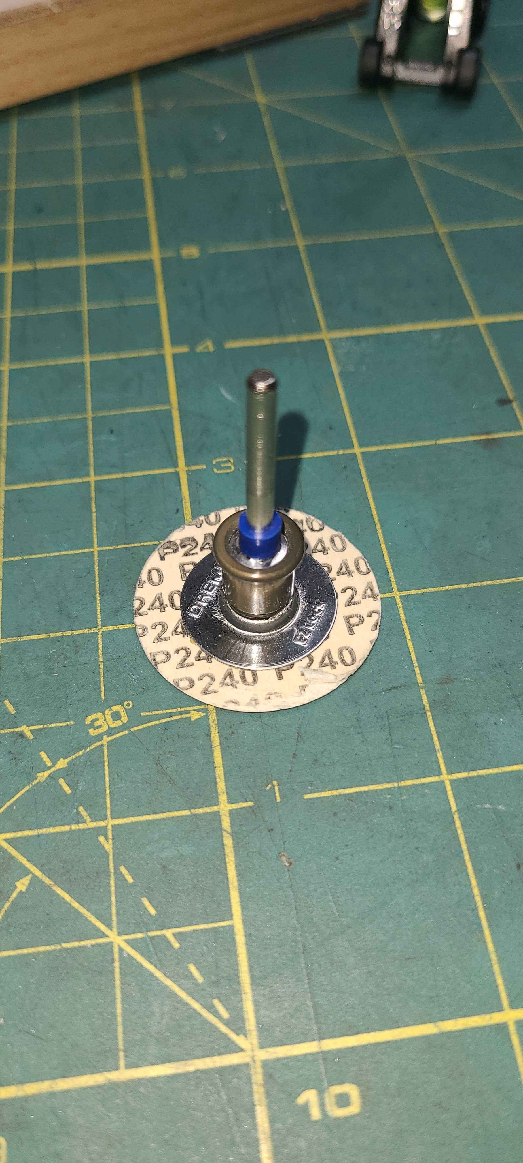

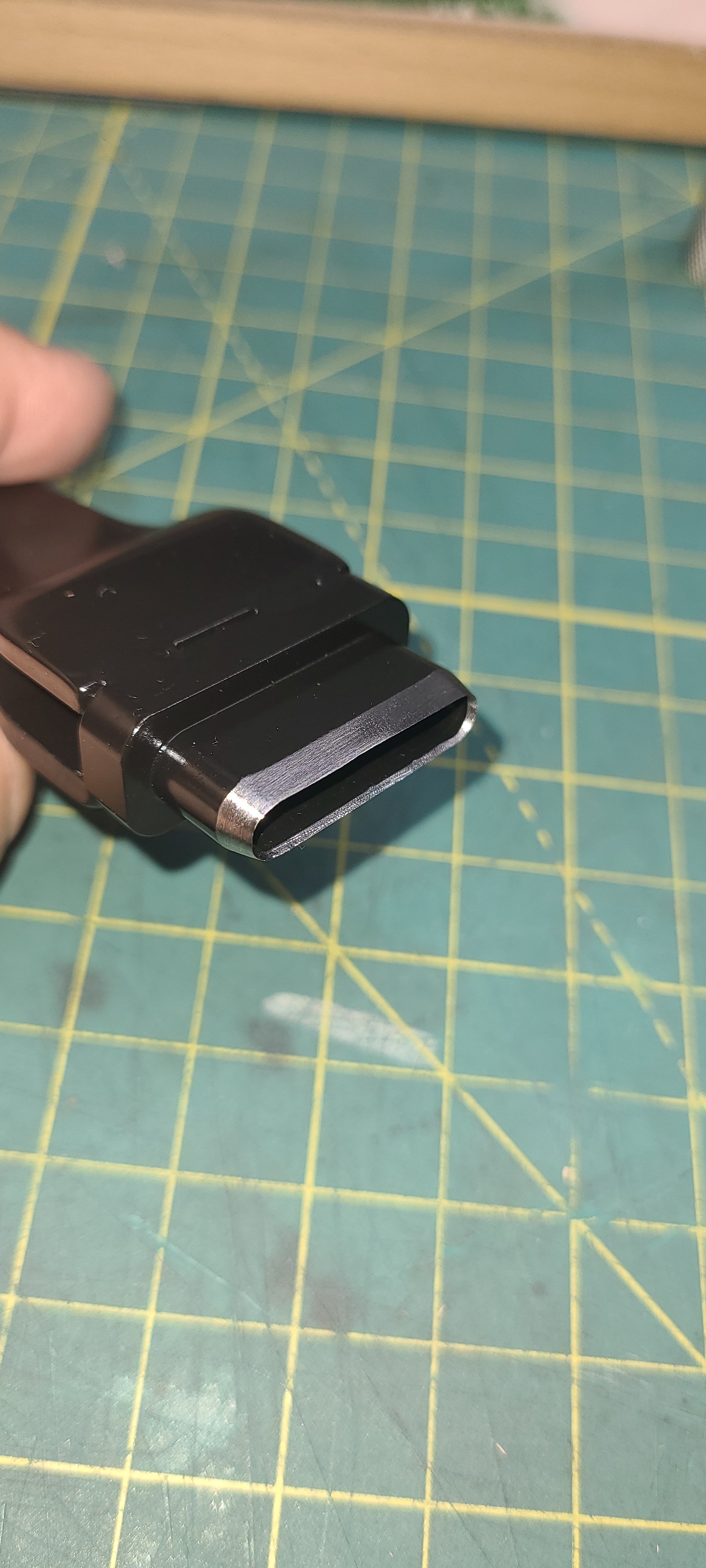

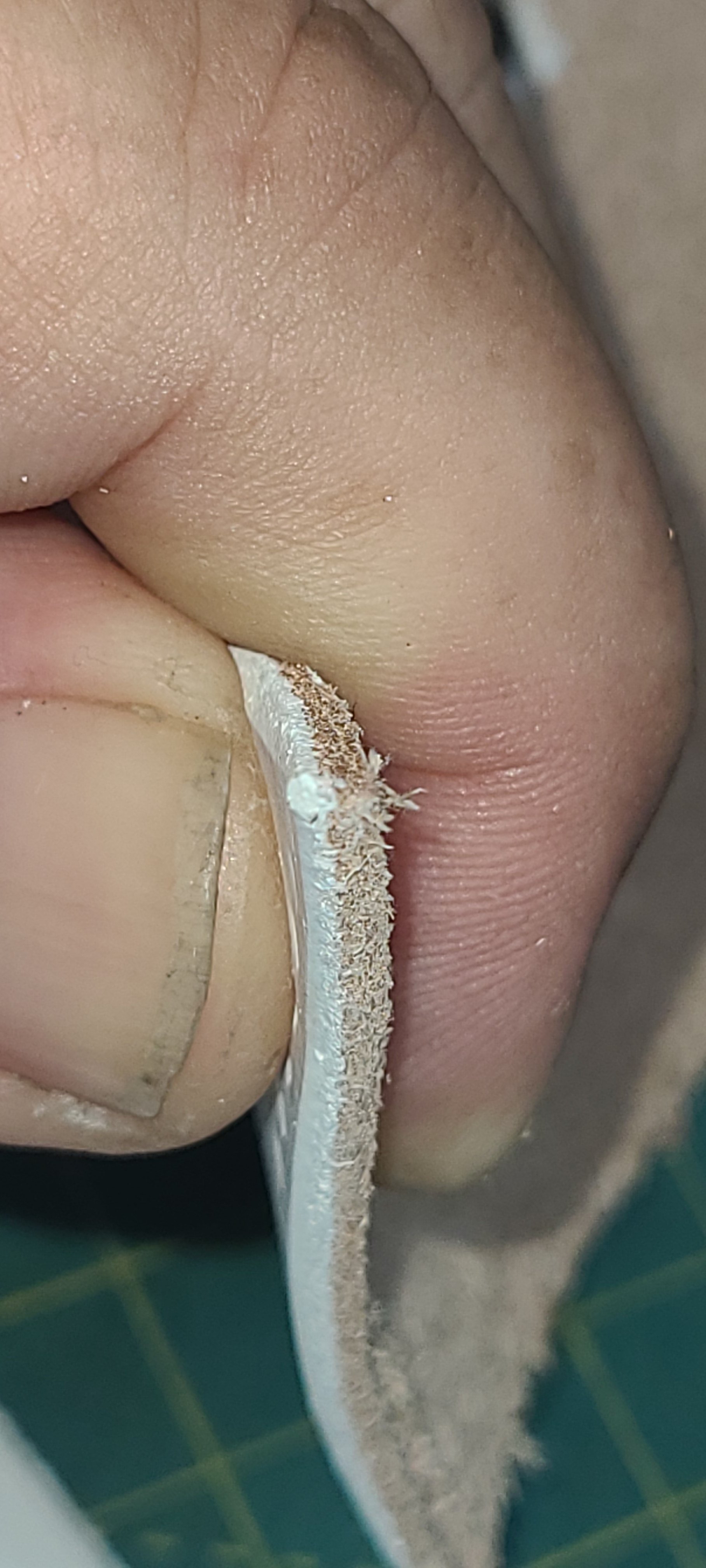

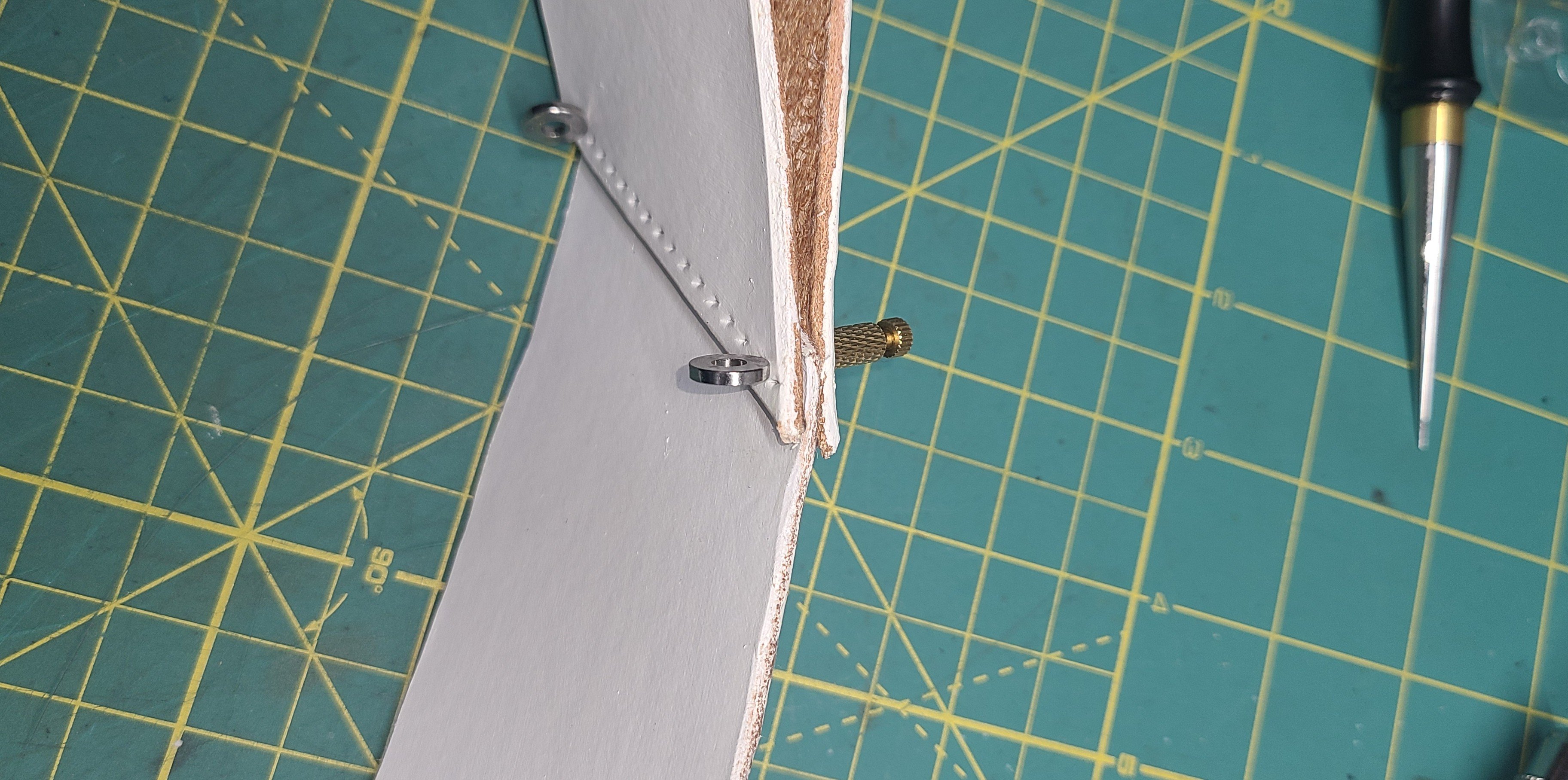

Next we move on to the baldrics, or cross belts.  I use the alignment pins to hold the pieces together to determine the fit.  As you can see, laying up several pieces of leather makes for a very bulky and hard transition, so the leather must be thinned in a process called skiving.  Basically skiving is just shaving off part of the flesh side of the leather to make it thinner.  The skiving knife must be kept razor sharp. The blade is not pushed directly through the leather but moved in a slicing motion along an angle like you see in the photo.  You work the edge in small bites from one side to the other to thin out the edge. In this case I am beveling the edge to create a less harsh transition between the finished layers of the baldric.  There are other variations of the skiving knife employed if you want to thin the entire face of the leather.
Here are the beveled edges and the improved fitment when put together.20250610_211036.thumb.jpg.21568f9554714f3dd35e9eecf06a5a2c.jpg20250610_211343.thumb.jpg.ed766e1e1ad5b6c14b37dfd0e1ae28ae.jpg
Regards,

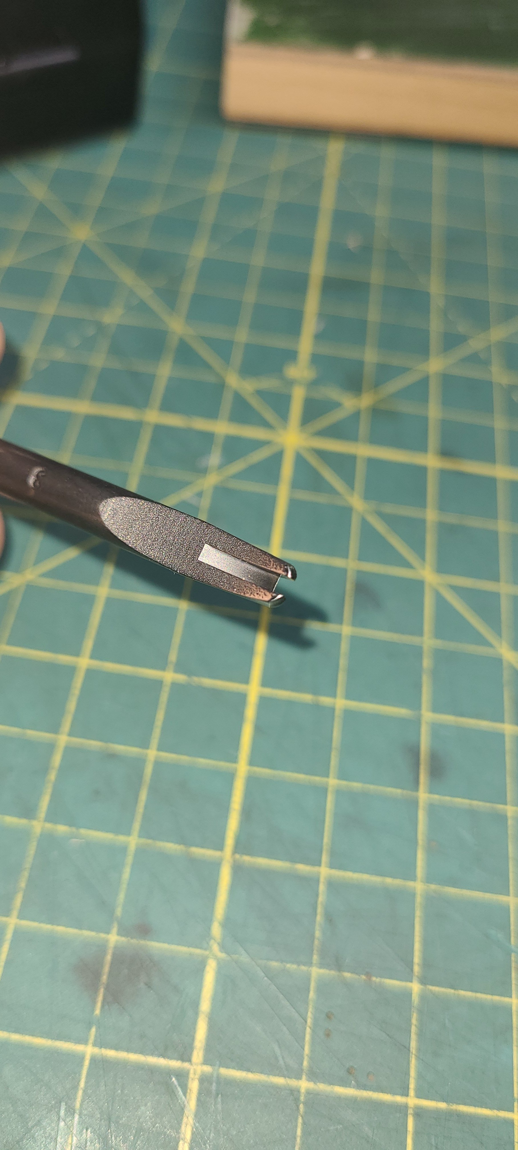

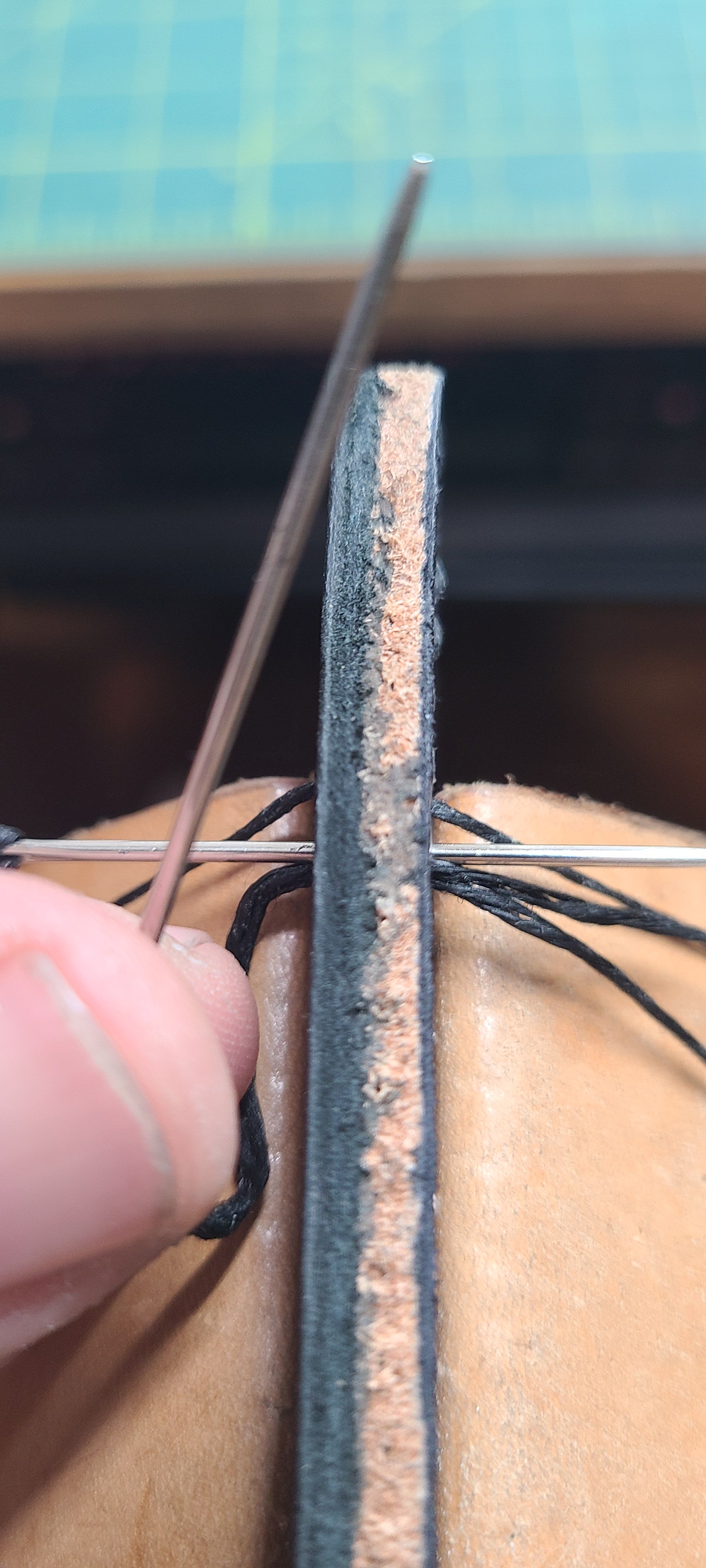

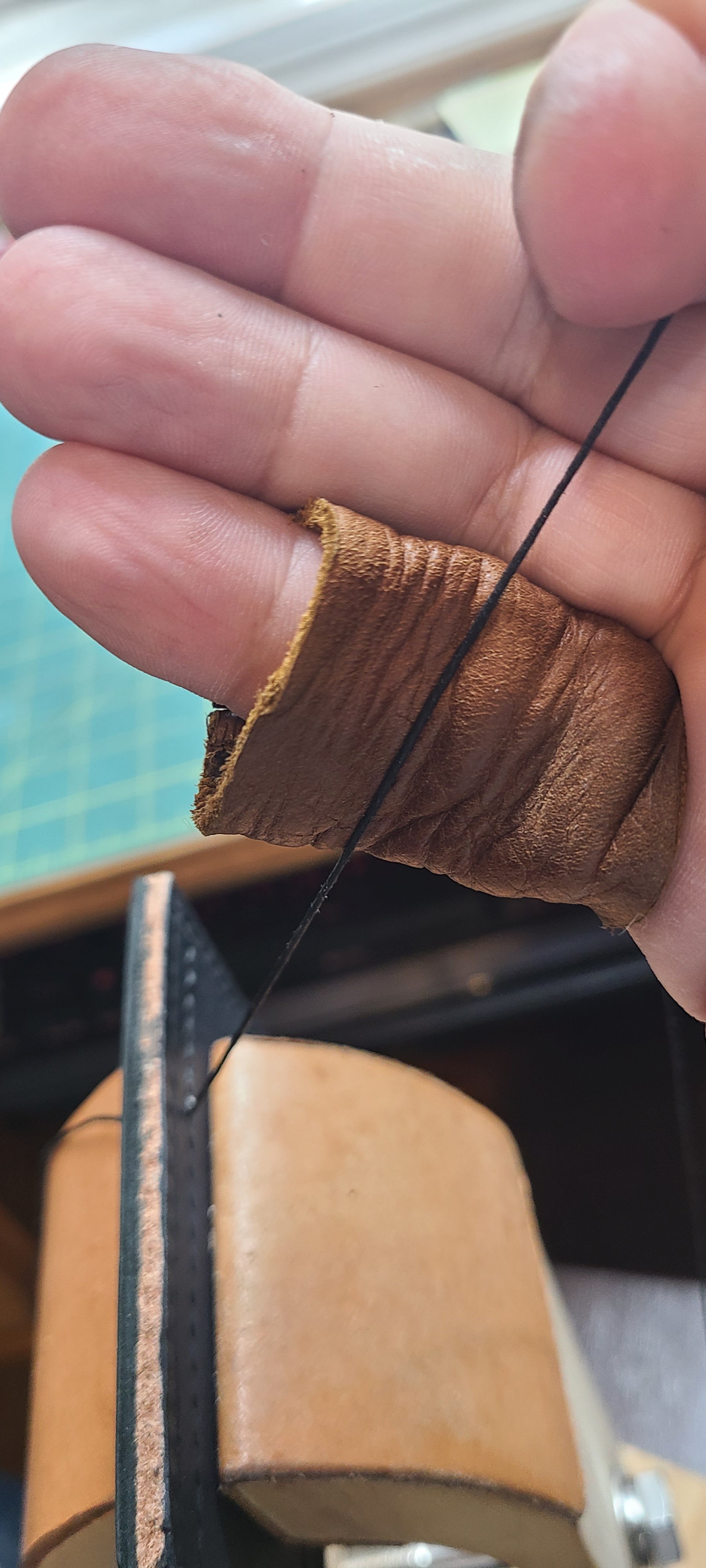

Next up is stitching up the baldric.
Here is the piece being stitched.  It is being held firmly in the stitching pony and the positioning is being fixed by the alignment pin.  I am using a basic two needle saddle stitch. The needles are specifically made for leather stitching, They have a blunt tip and a large eye.
You can see short demo of how the stitching proceeds below.  The small overcast that is done before the thread is pull tight insures that the thread lays in the correct orientation in the holes to produce a consistent angle on the top face of the completed product. It is just a more polished, refined look than a simple straight stitch. You can also see in the video that I am wearing a set of leather finger protectors that I made.  The thread will tend to cut up your fingers after a long stint of hauling those stitches taut.

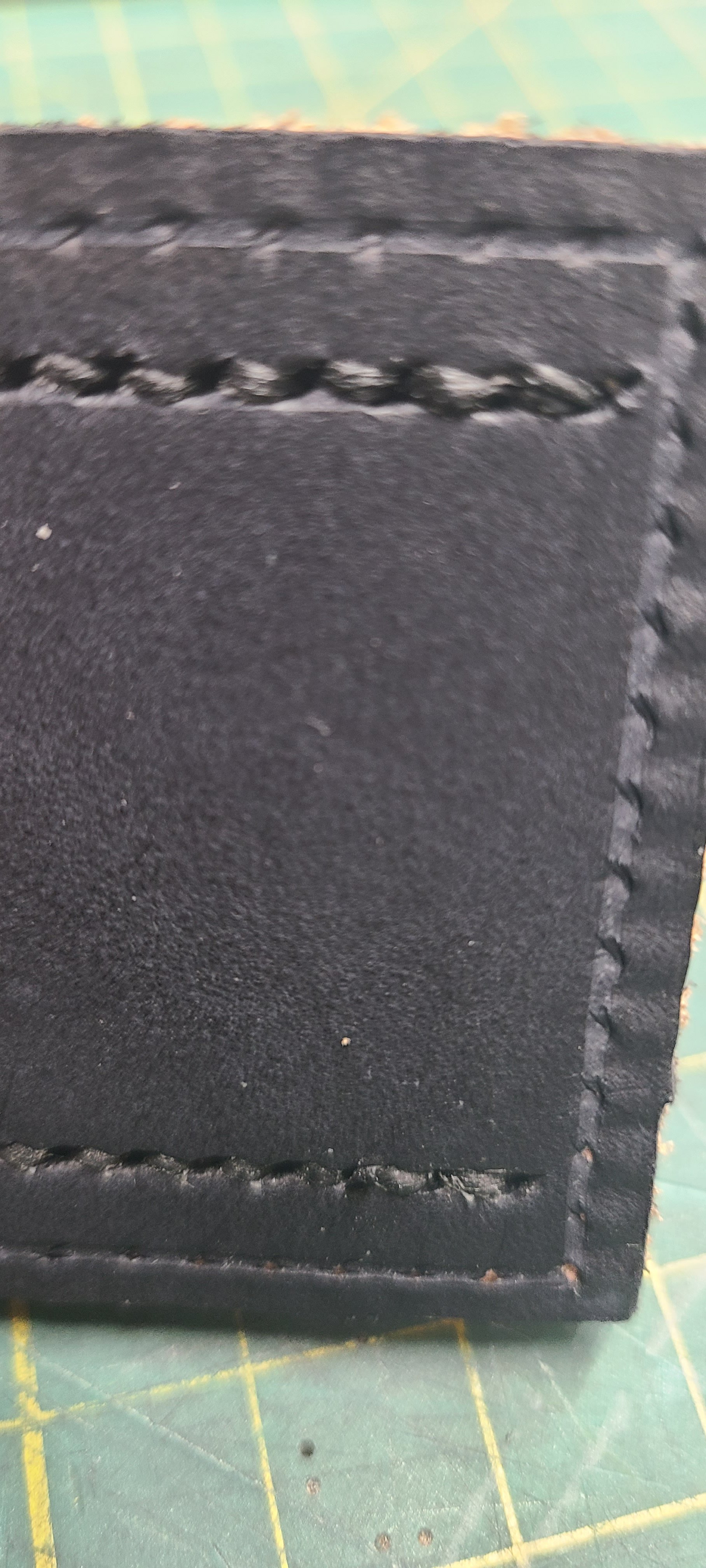

Here are the finished leather cross belts
20250619_143638.thumb.jpg.22b7a165e9d61e646007da50ca7a7c2c.jpg20250619_143521.thumb.jpg.df76c33e6c2b81f36a10a88e34b6a292.jpg

Back to the Cartouche box.
Here I have dyed all the pieces black.20250619_143901.thumb.jpg.da071b1e30e77d07b31bfe8e464b401b.jpg20250619_143952.thumb.jpg.c714d376568993ef6e76f21e1c0f71d1.jpg20250619_144033.thumb.jpg.34d00dcf8083052691bad6534f45808a.jpg20250619_144038.thumb.jpg.d5e547d18c84888b4f98b8fb8d344e6a.jpg
Starting to stitch the parts together. After the stitching is done the finished seam is tapped down with a leatherwork hammer.  The hammer has a highly polished, slightly convex face.  Tapping the seam down sets the row of stitches down into the stitch groove and closes up the hole so they don't have that puffy, ragged look that you get after stitching.
20250619_145851.thumb.jpg.55e89c7f40403a39f2c3b72da99228fc.jpg20250619_145914.thumb.jpg.f8d1a49f8a056e9642cf2f9c1b30f715.jpg20250619_150157.thumb.jpg.0bf7a3a42f77d0f2fe360318b03b9274.jpg20250619_154123.thumb.jpg.3fc61f9582c392217eb53f4b6bc72105.jpg20250619_154146.thumb.jpg.acc2167e7017c3183b32bab8ed5ed32f.jpg

Before I can finish assembling the cartouche box it must be folded into shape.  To make that possible, two grooves have to be cut to form the bottom of the box. I bought another new tool, the v-shaped groover, to accomplish this.  While it is not a difficult tool to use, it is a bit nerve wracking getting the groove deep enough to fold the heavy leather, but not go through the whole piece to leave a gash in the finished side.
( I was not entirely successful in this. Luckily the small gash is in a spot that will be covered by the cross belt. This was my first attempt at a cartouche box. Mistakes were made.)
20250619_193953.thumb.jpg.62346985d27383b515cd92d2b029d4b1.jpg20250619_193618.thumb.jpg.6db0c01630e55ee8469ac3f20cc3e1f0.jpg20250619_193708.thumb.jpg.2ed2d5daed26cf3b71c97233e5c18887.jpg
The various pieces are stitched on to the body of the box.
20250620_175628.thumb.jpg.ece72f9288fd2ae6aab95f3b642102e8.jpg20250620_175645.thumb.jpg.48f409333e02b1a2941337026d4a04a4.jpg

Final assembly of the cartouche box.

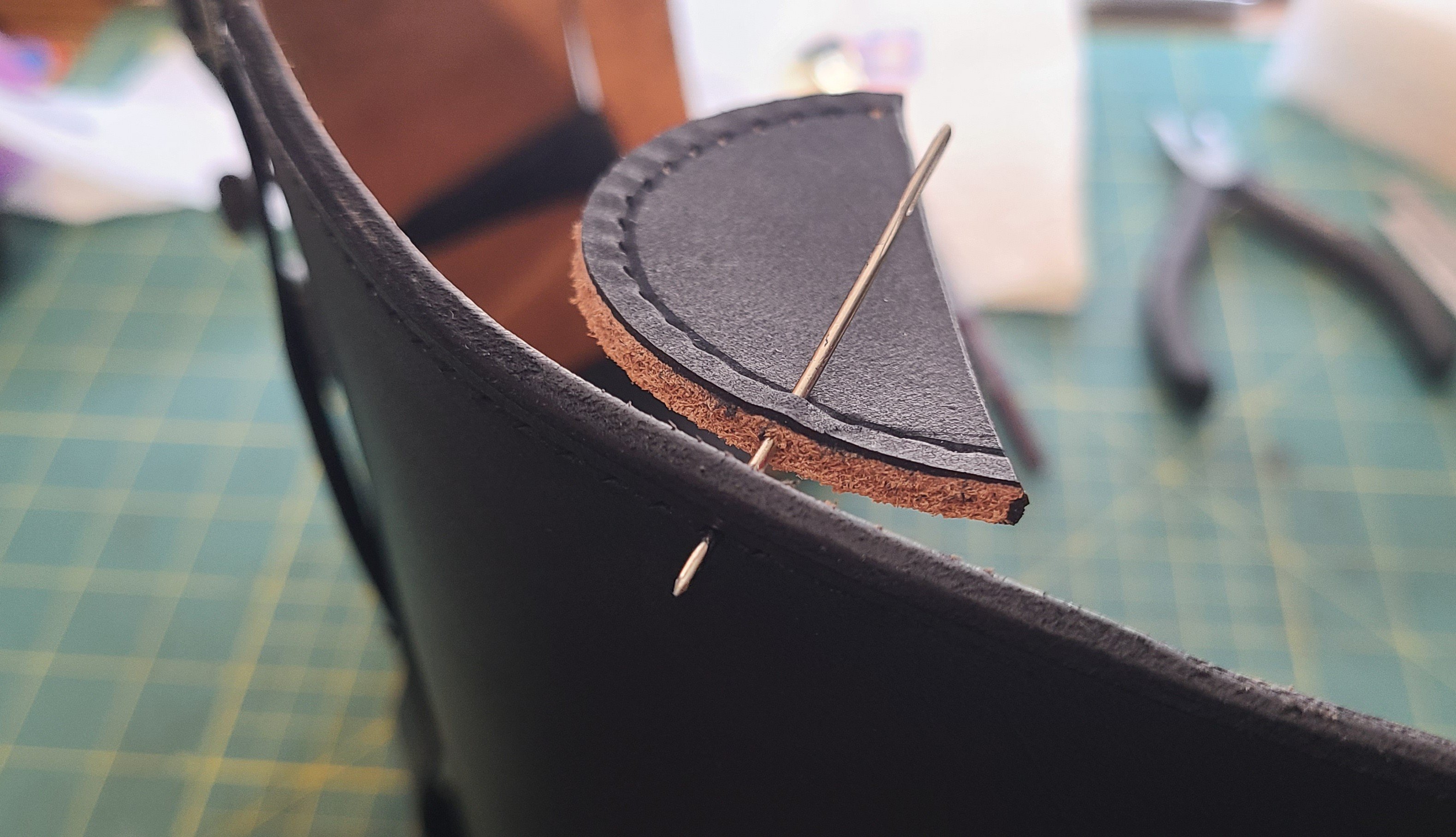

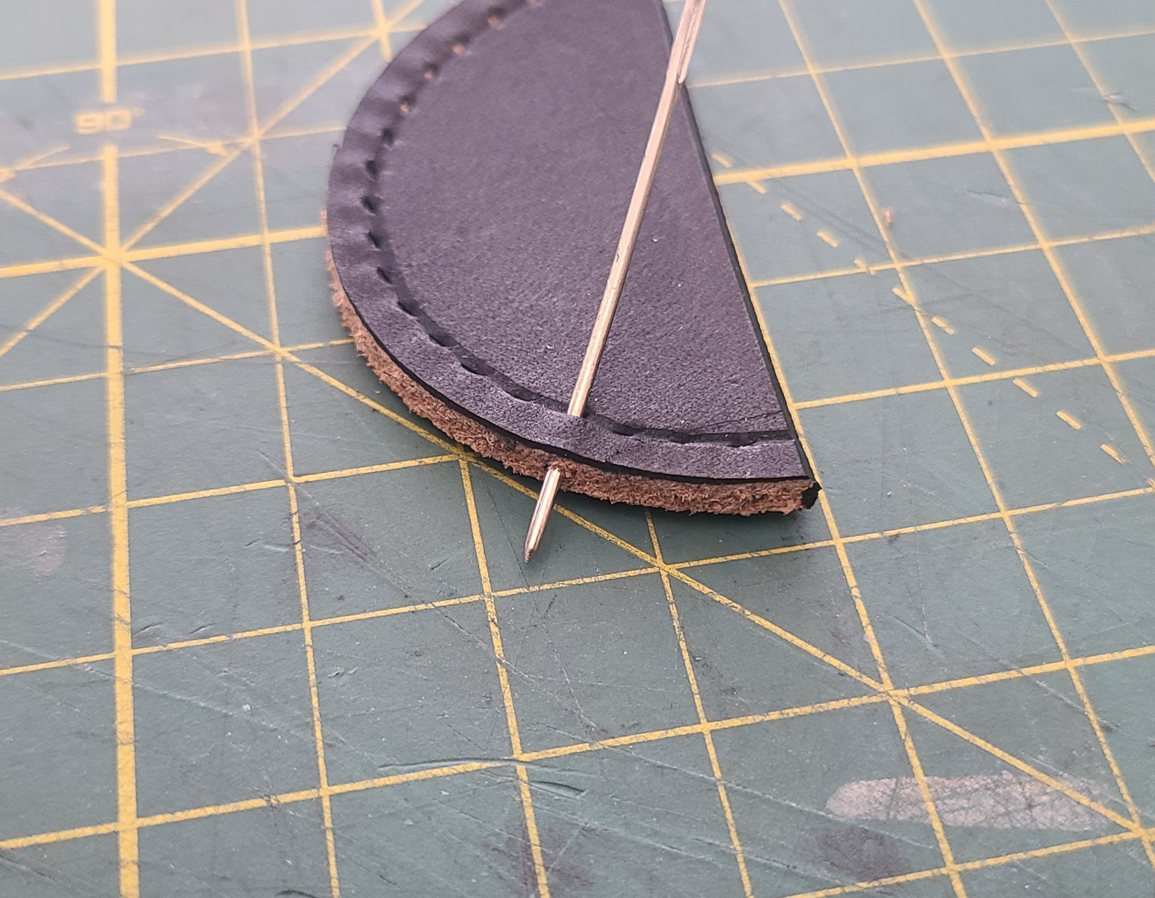

In order to stitch the sides and end pieces into the box, I use a different stitch; the box stitch.
The box stitch is different from the saddle stitch in that instead of the two pieces lying flat on top of each other one piece is stitched end to. In order to do this the holes are punched differently.  On the piece that will be standing on edge, the holes are punched so that they pass through the edge grain instead of through the back face.  You can't just punch the holes with a stitching chisel, eight at a time.  Each hole has to be made with an awl one at a time, being careful to push the awl through at the right angle to come out of the edge in the right spot. It takes practice.  (Once again, being the first iteration of this type of piece, mistakes were made).
These photos are of the end caps for the box cover being stitched into place.
20250624_162116.thumb.jpg.2a066c357d5d8bc7ec896f45d7a35125.jpg20250624_162209.thumb.jpg.6504557c1859d4a2c5f947b2f7705288.jpg
The sides of the box were stitched into the box in the same manner for the final assembly
One last item that I forgot to take a picture of is the leather toggle for the box closure.  It consists of a strip of thin leather that is narrowed at one end and rolled up to form a toggle.  The dimensions of the strap are determined as follows. The width of the strap will determine the length of the toggle. The diameter of the toggle depends on the length of the strap from the end to where it narrows.  You can figure out the size your toggle needs to be by the size and shape of its corresponding hole in the closure on the bag.
The portion of the toggle strap that is cut narrow passes through a slot cut in the larger end and holds the rolled up toggle.  The toggle strap should be sized to fit the holes in the bottom of the cartouche box. (Those are the three holes punched in the bottom of the box seen in previous posts).
I know it is hard to envision how the toggle is made, but there are YouTube videos if you are interested.
After the toggle is formed, the narrow strap is passed through the three holes in the bottom of the cartouche box leaving enough length to toggle through the closure. A bit of contact cement is used fix the toggle strap to the inside of the box.

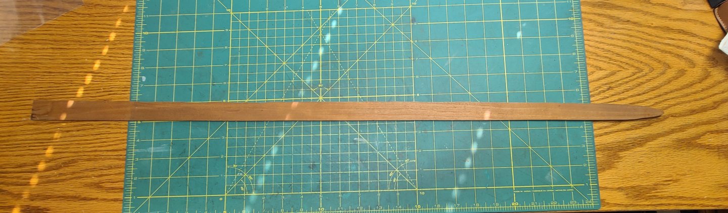

New sergeant scabbard.
You can see in the picture of the old sword scabbard that the leather is old, dried out, cracking, and falling apart.
Here is my first attempt at a replacement scabbard.
First the pattern is made by tracing the sword onto paper. An allowance is added on either side for the width of the blade plus a seam allowance for stitching. Then a wooden former is cut out using the sword as a template. The leather is cut to the pattern size.  I am using the same black leather that I used for parts of the cartouche box.
The leather is folded in half length wise, finished sides out and cut edges aligned, and contact cemented together. A single row of saddle stitches are run along the seam allowance from the throat to just before the tip. The scabbard is then soaked, submerged in water, for about 30 seconds. After soaking the scabbard is allowed to sit for about 5 minutes to allow the moisture to penetrate all of the leather. Then the  seam is pressed down into the middle of scabbard, making sure it runs centered down the middle of the face. Then hammer the seam down with a mallet. Slide the former into the scabbard all the way to the tip.  Ensure that the seam is centered on the face of the scabbard.  Using an edge slicker, smooth down the edges of the seam. The hammering and slicking helps to get the seam allowance flattened out and tight against the face of the scabbard.
Now comes the pressing.  In order to press the scabbard into its final shape I made a simple press out of  two 1 x 2 pieces of wood.  I cut a shallow groove the width of the scabbard seam into one face and then sanded the faces of the wood that would come in contact with the scabbard.  Any imperfections in the wood will get transferred into the leather when you press the scabbard.
Place the scabbard into the wood press with the seam in the slot.  You can add pressure by standing on the wood or you can use clamps.  Press the scabbard down hard.  Take the former out of the scabbard and press it again.  Now one last press with the former back in.
Once the scabbard is pressed down hard, remove it from the press and check it to see if you have a good, clean, smooth, straight shape. Now you can let the scabbard dry, with the form in, 12 to 24 hours till completely dry.
To finish the scabbard, the brass throat and tip guards are press fit onto the leather.
scabbardpattern.thumb.jpg.3adaff2960402ea64a784e2bb9616258.jpgscabbardformer.thumb.jpg.00da930bc3fd802fda68c62800d47aba.jpgsergeantsword.thumb.jpg.6e66b89a3a0f0ea96c25ef22c09767fb.jpgsergeantsword2.thumb.jpg.6ffc28ccd3024a2c2710c78905453f88.jpg
You can see with the last picture that the seam on my scabbard is not very centered all the way down.  That is because the sword is not symmetrical. The back of the blade stays relatively straight and the cutting edge curves a bit more towards the tip.  I tried to make the pattern do the same thing but when I formed the scabbard up it ended up twisting a bit.  I am not going to redo the scabbard.  The seam side is worn towards the body so it is less visible.  I will, however, re finish the seam so it is a bit smoother and edge coat it so it disappears more against the face.

Finally, my new officers sword baldric.
The back story:
The current person portraying an officer in our unit has decided to step down.  The next person in line for the position is me. Therefore I have had to start the process of acquiring and/or making a new officers uniform for myself.  It is not an easy or inexpensive project. The wool and other materials have to be authentic and the tailor has to be familiar with period tailoring construction and techniques.

That brings us back to todays topic. I have completed fabricating the sword baldric.
Here it is
The fittings, from left to right, are all stitched to a central ring that hangs at my left hip: Breast plate, front sword hanger, hook, rear sword hanger, shoulder strap.
Here are some photos from an event last weekend showing how it is worn.  In the interim between when my officers uniform is complete and now, I am portraying what , in the era, was called an orderly sergeant; a sergeant who was in command of a ships detachment of marines. I am, therefore, authorized to wear the sword and the sash denoting command. When the new uniform is complete I will switch over to portraying a captain of marines.
In this next photo is demonstrated the use of the small hook that is installed between the two hangers.  When 'in use' the scabbard depends from the hangers at an angle convenient for drawing the sword. When not in use the scabbard can be reversed and hung from the small hook. This allows the sword to hang more vertically along the left leg making it more comfortable to walk about without the sword banging around your legs.
One more note: the decorative gold and red sword knot on the hilt of the sword actually has a function. The sword knot is composed of a long loop of braid with a tassel on the end which is knotted and wrapped around the guard.  When in battle the hand is passed through loop of braid so that if the sword is un-handed it will remain hanging from the wrist and not be lost.
