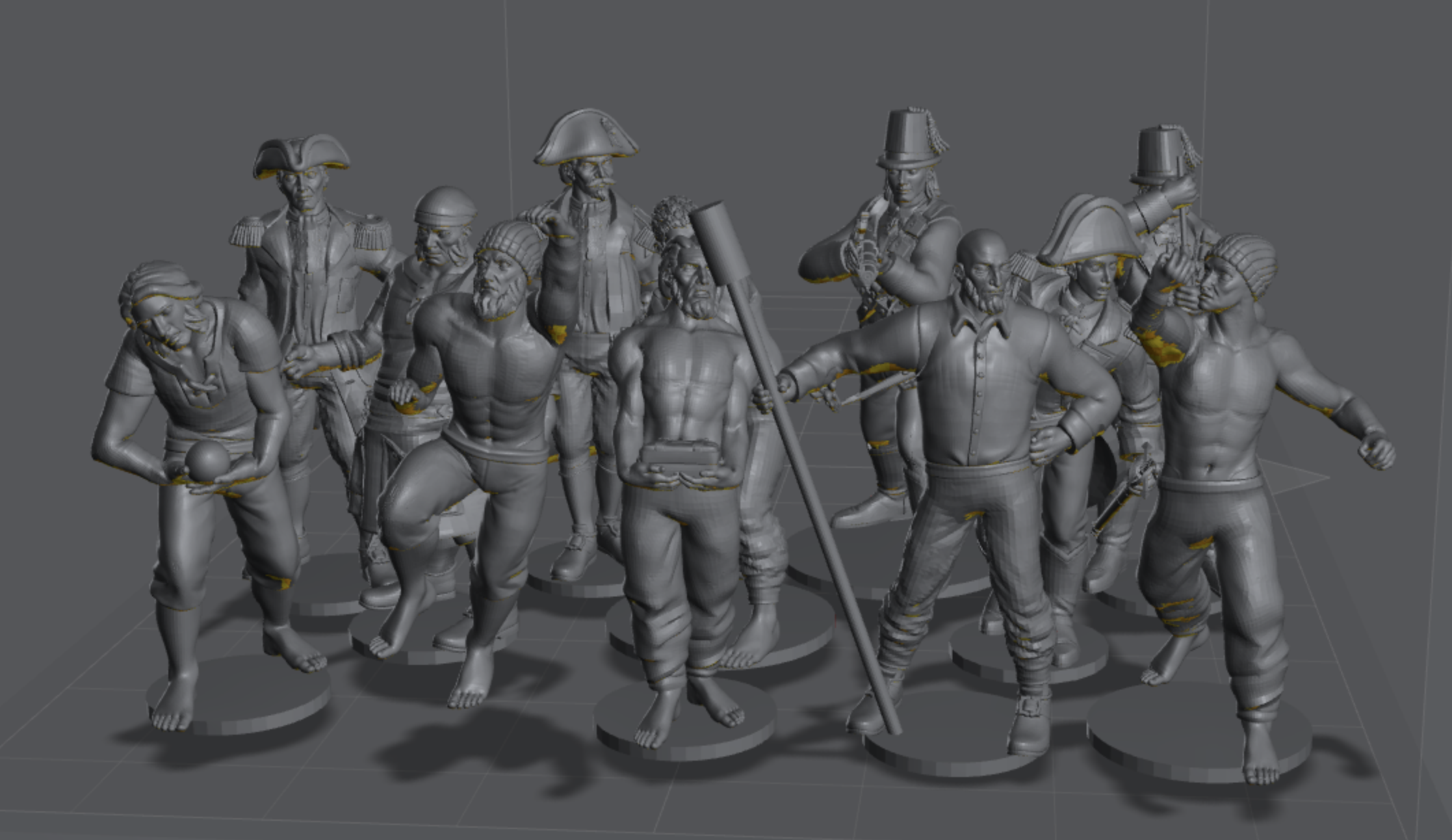

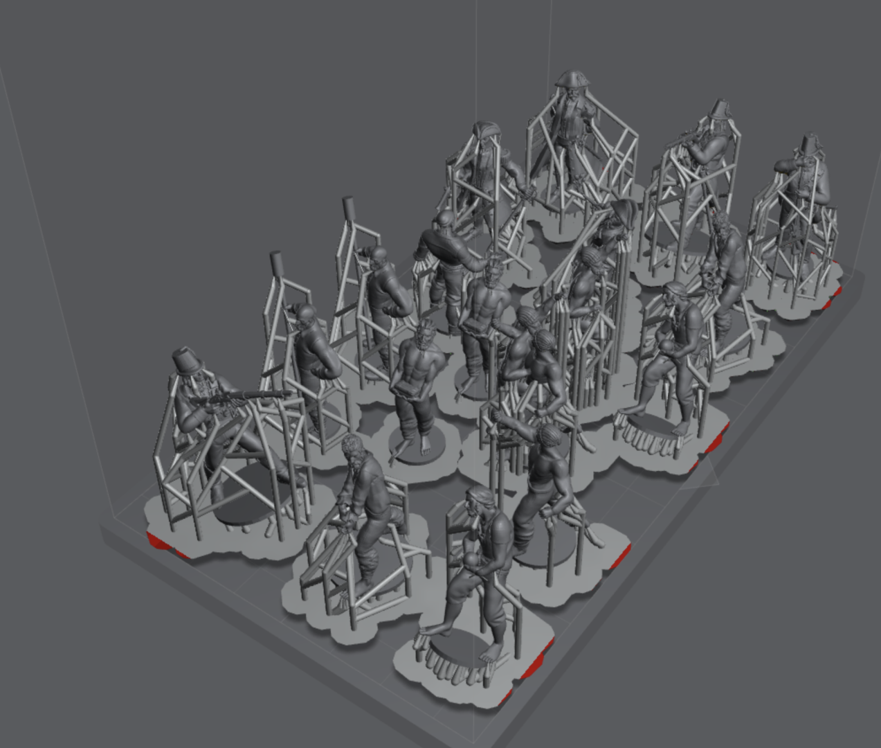

Here are a few images from the slicing software:

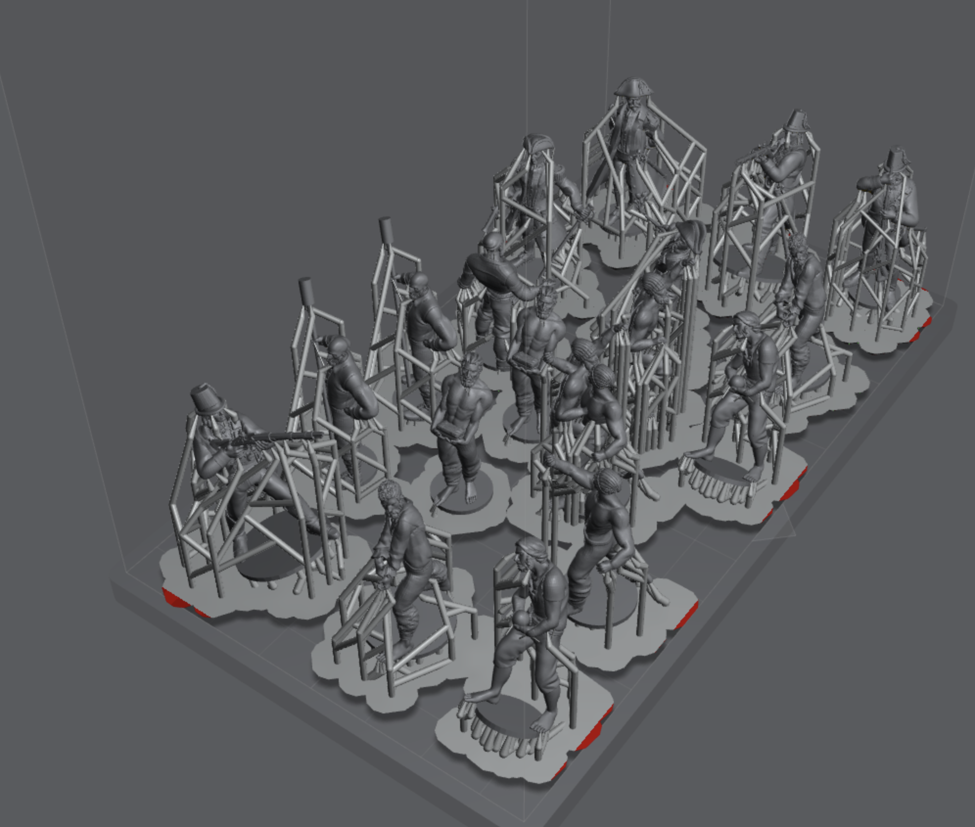

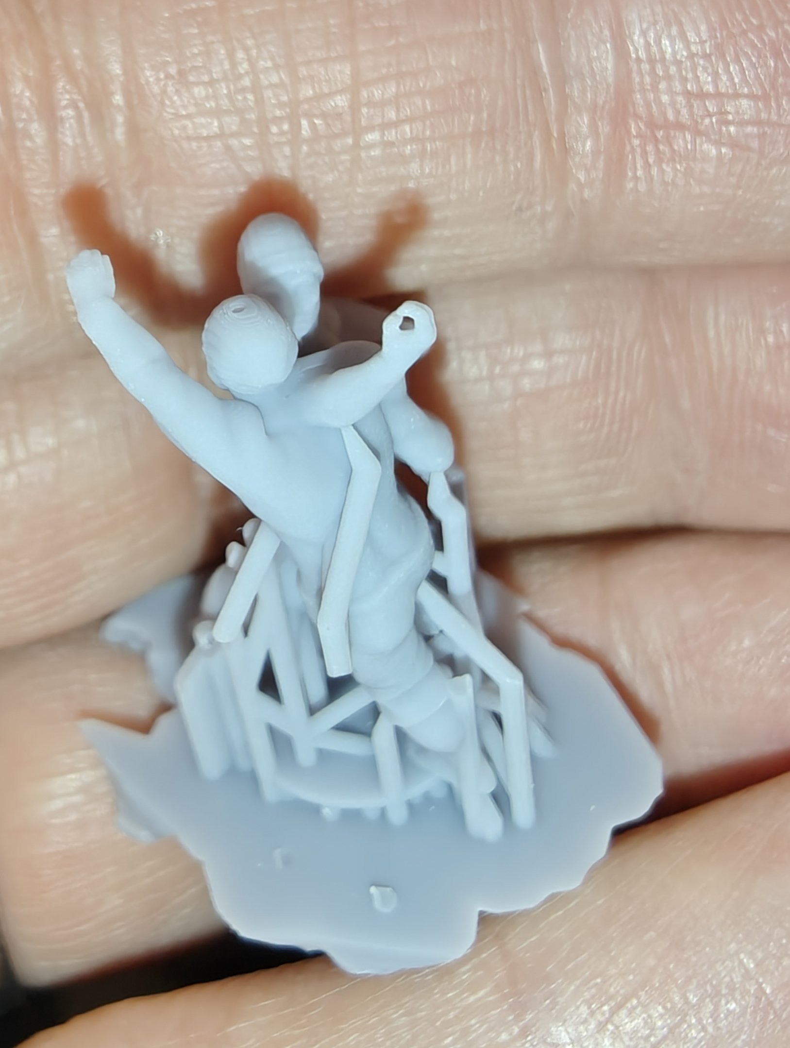

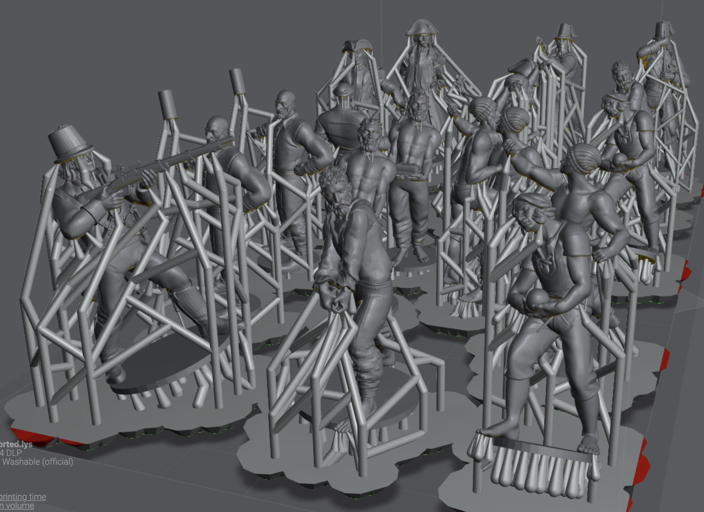

I have prepared a supported set and filled my little build plate:
Now I have to try to print them, hopefully I will get a chance to try tomorrow. They are only about 26 mm tall (plus/minus, depending on hats and posture) and I have no idea if I have supported them sufficiently. Lets see how it goes!

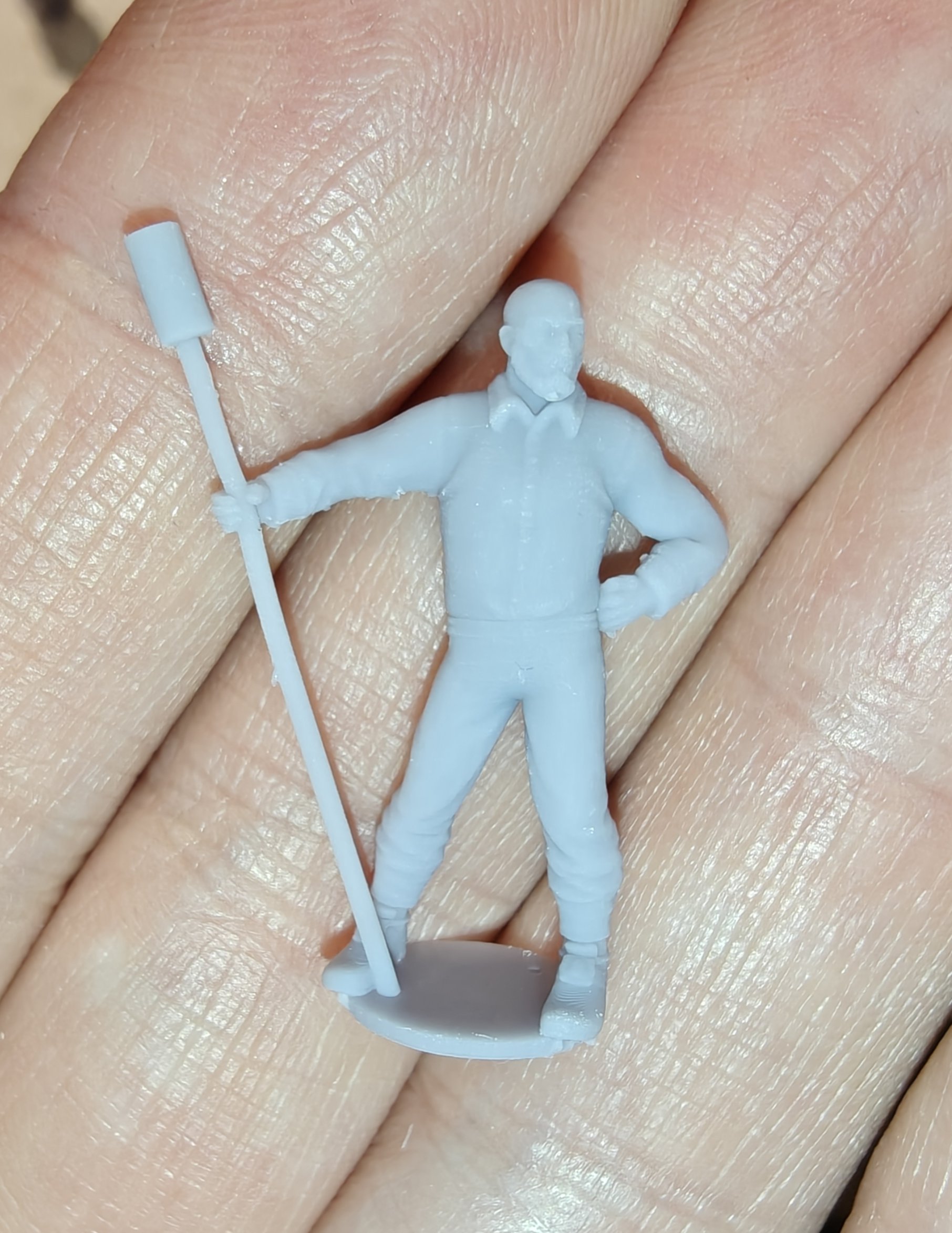

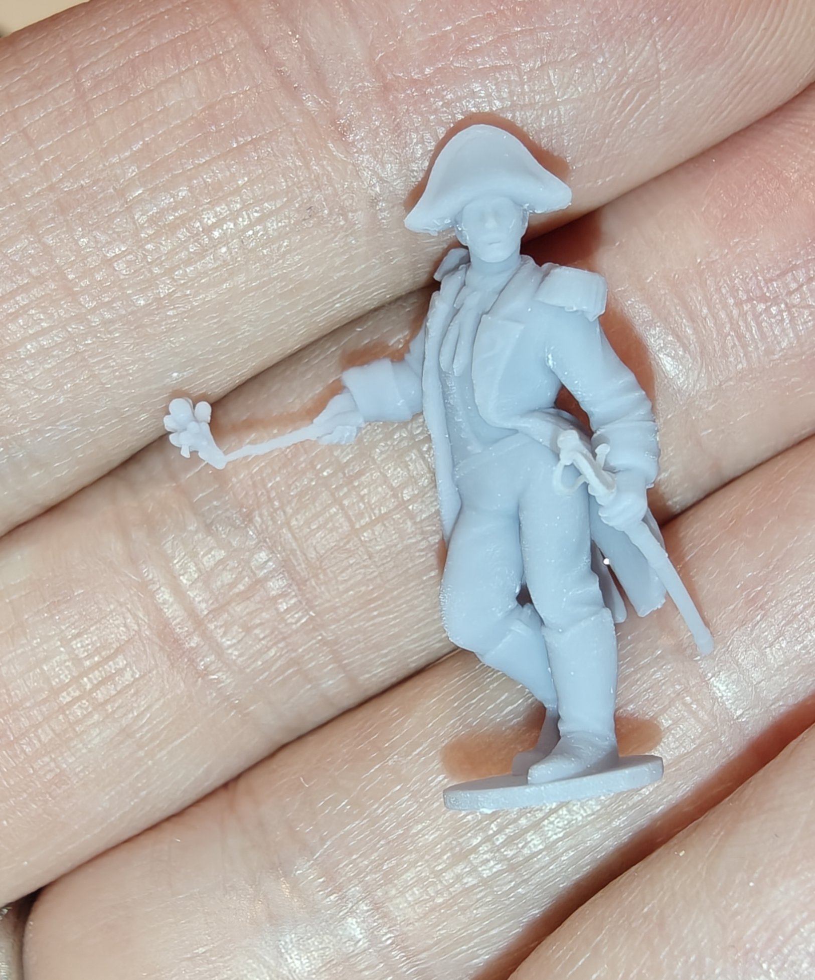

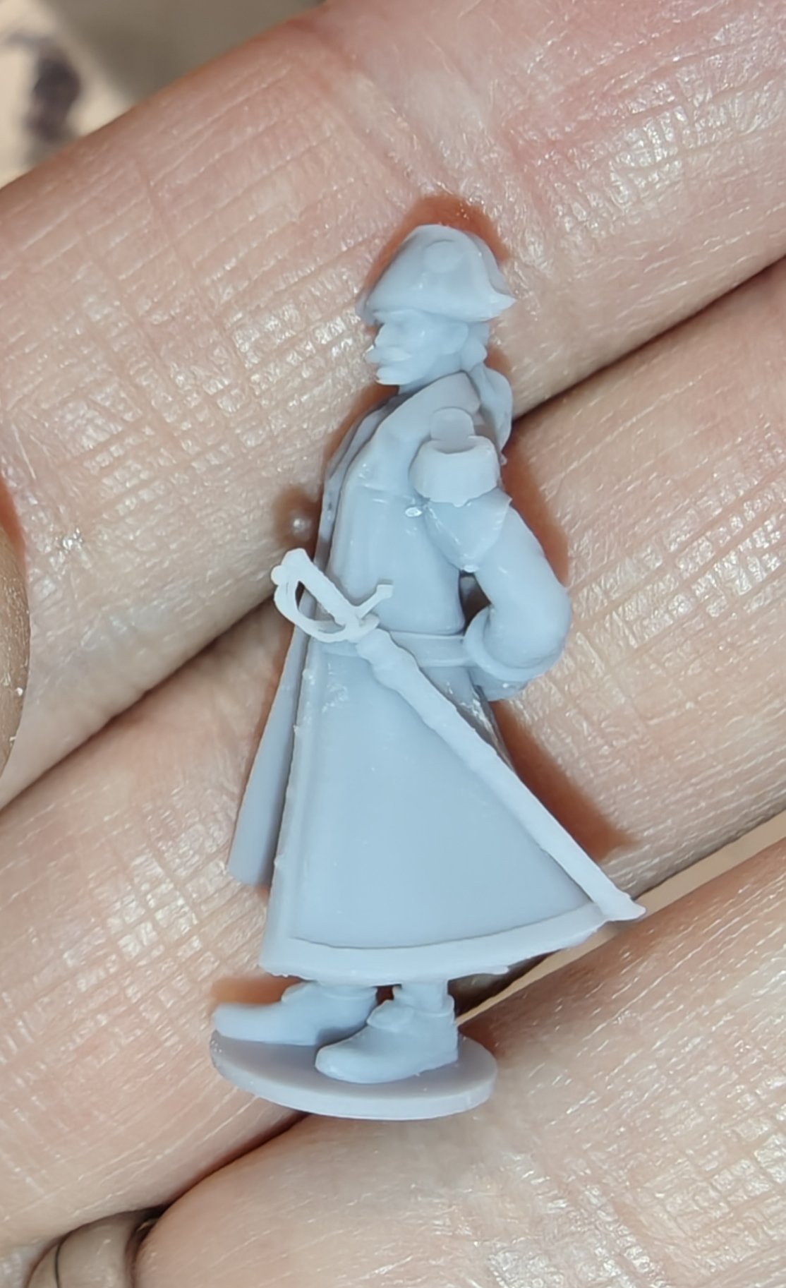

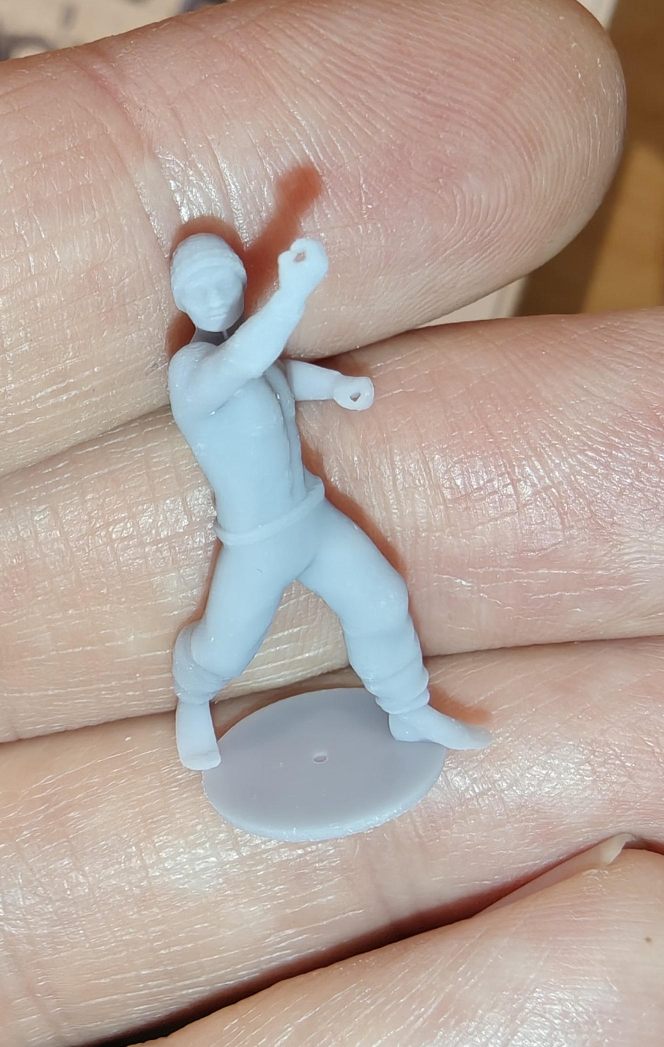

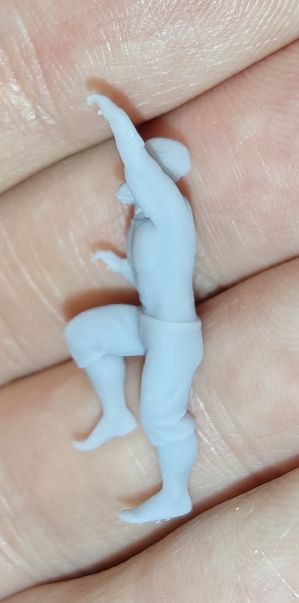

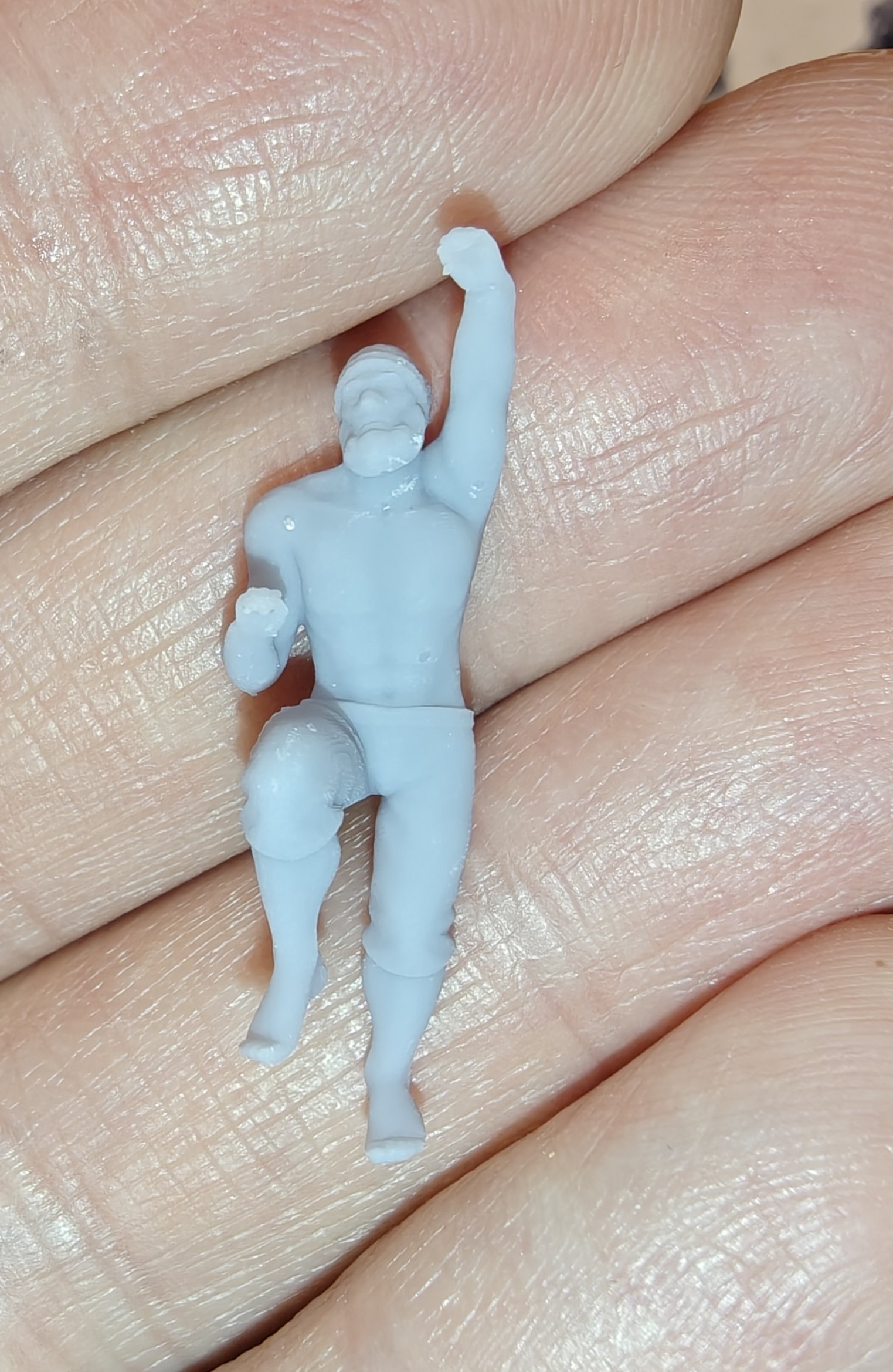

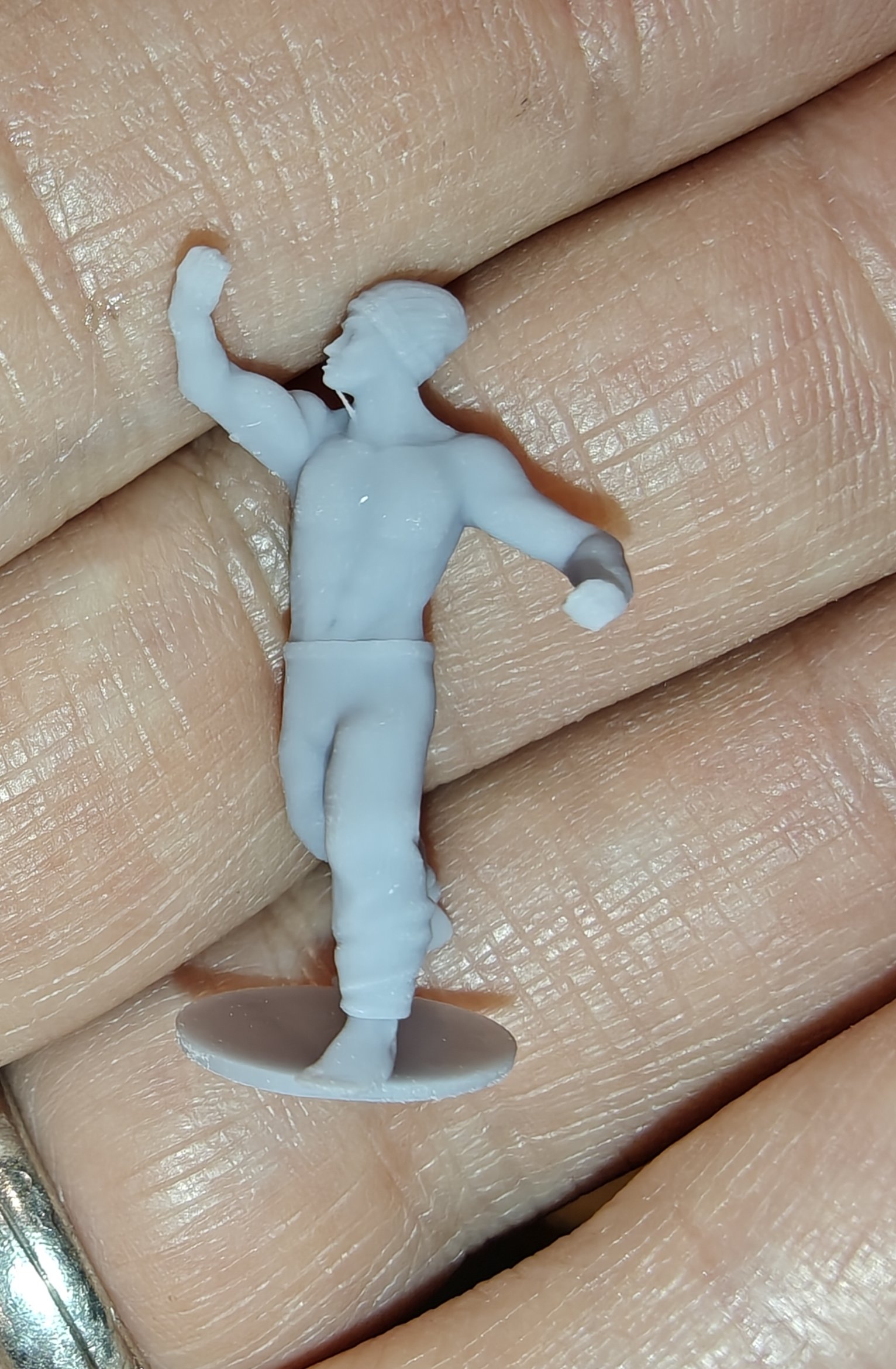

Alright, that went much better than I had hoped!
Except for two figures with insufficient supports in one spot, they all printed perfectly!
Even with all the ridiculously thin elements like the saber hand guards etc. This technology is some real Sci-Fi. Remember, these are at 1:64 scale, so around 26 mm for man-height.
Here's a bunch of pictures:

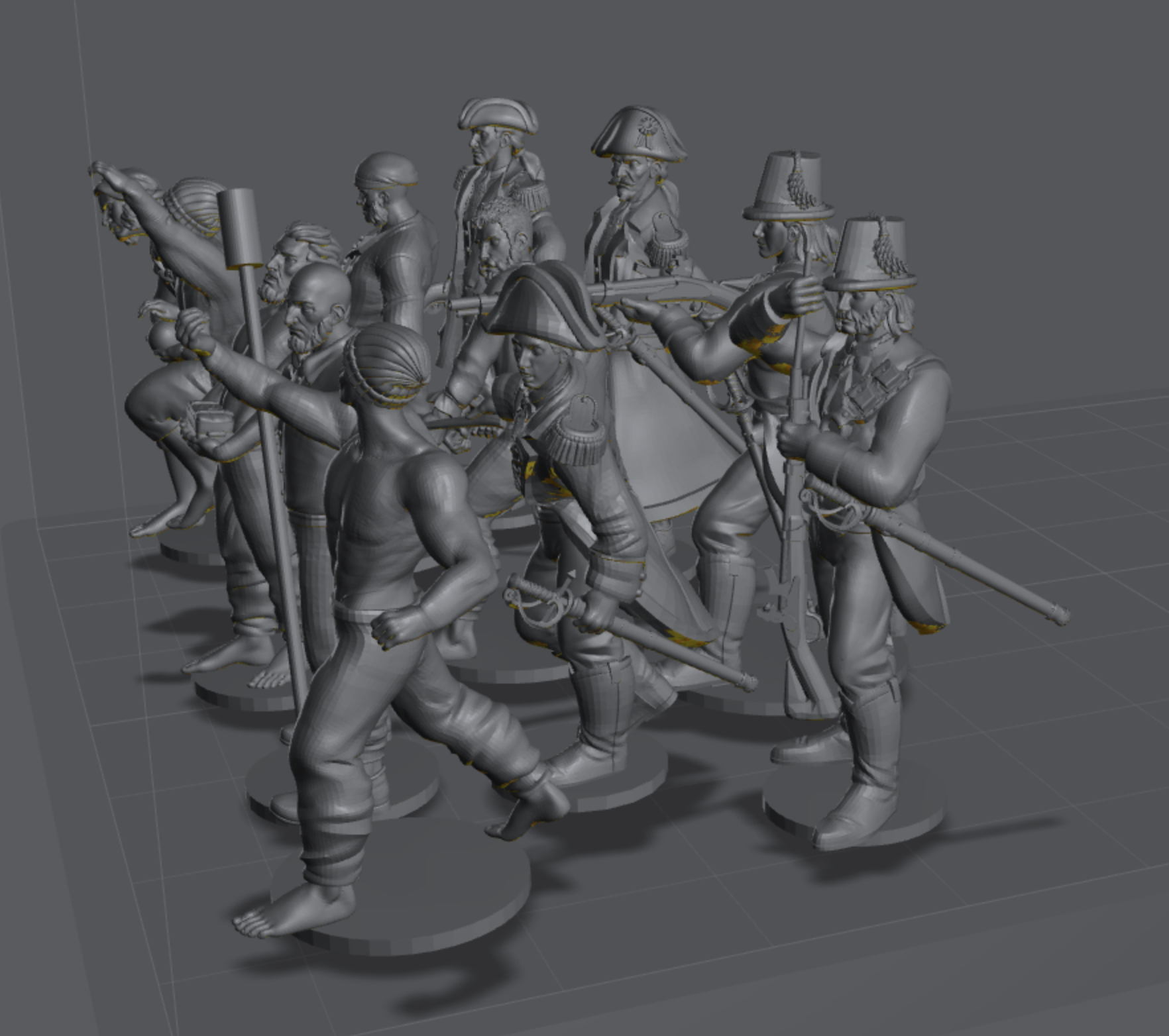

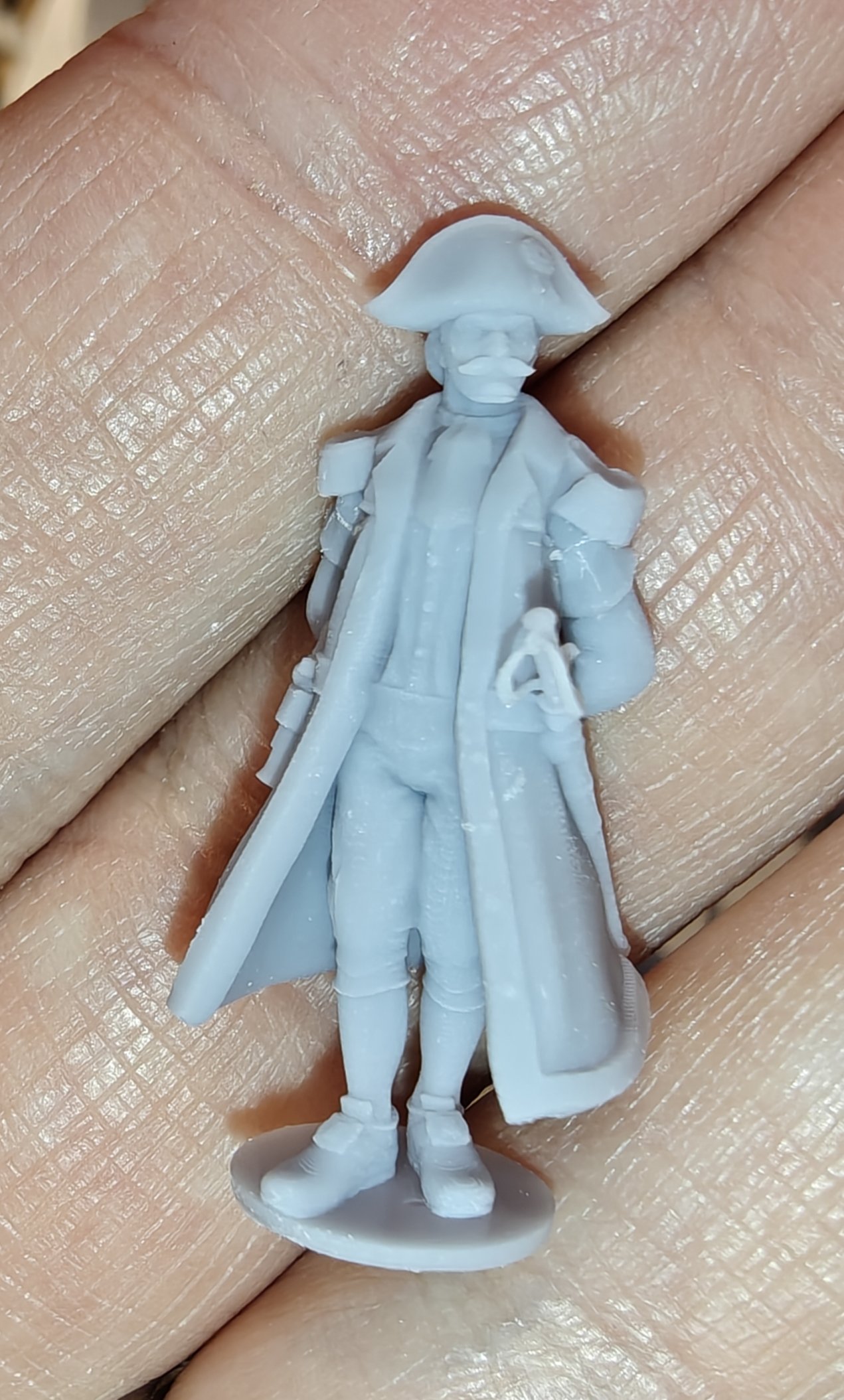

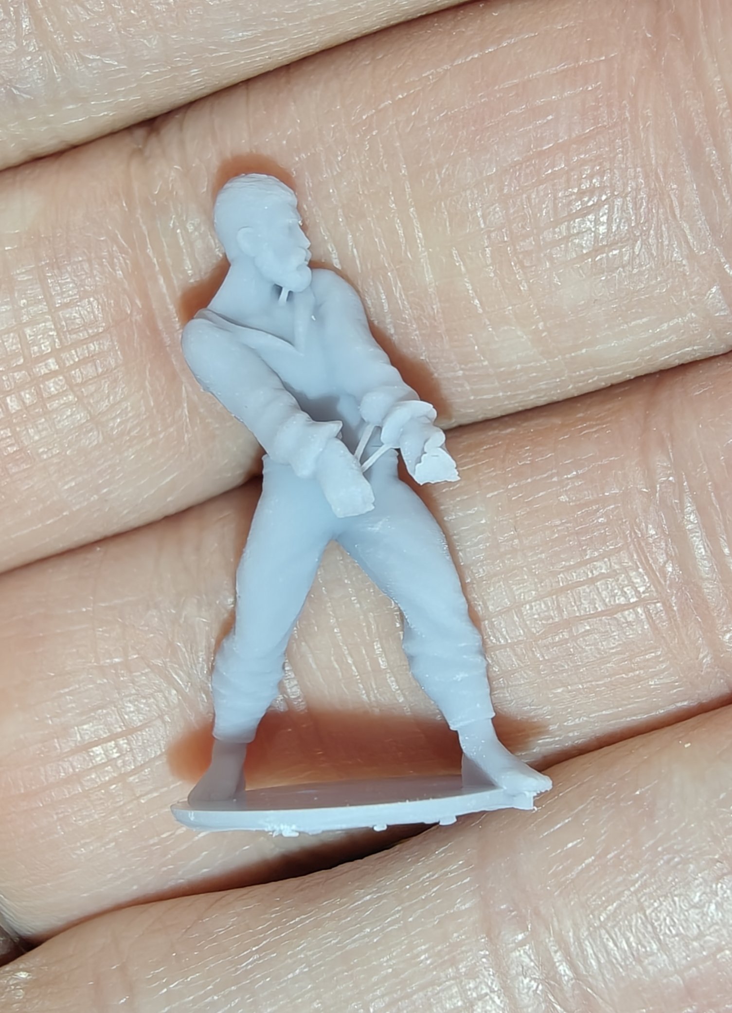

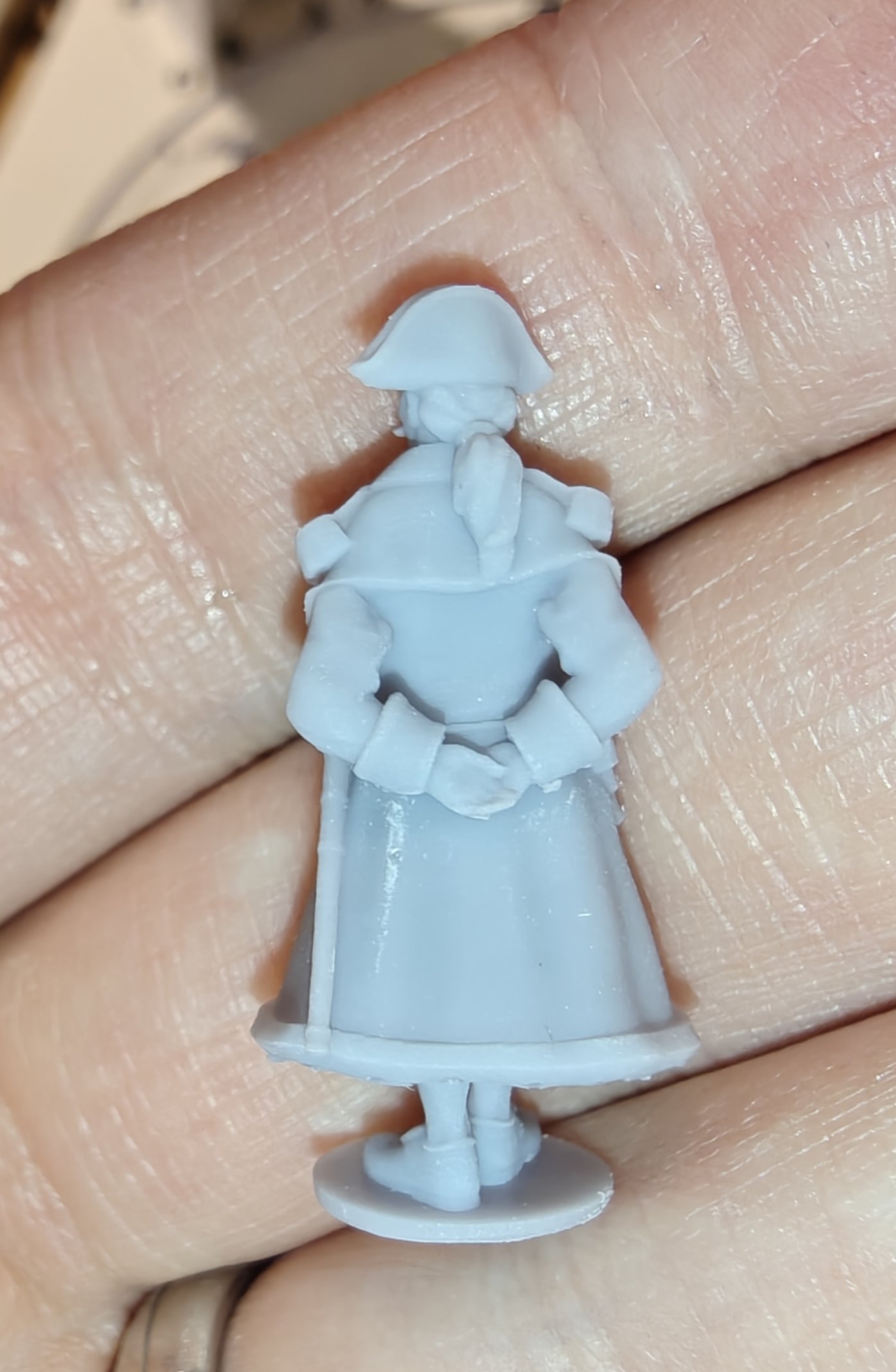

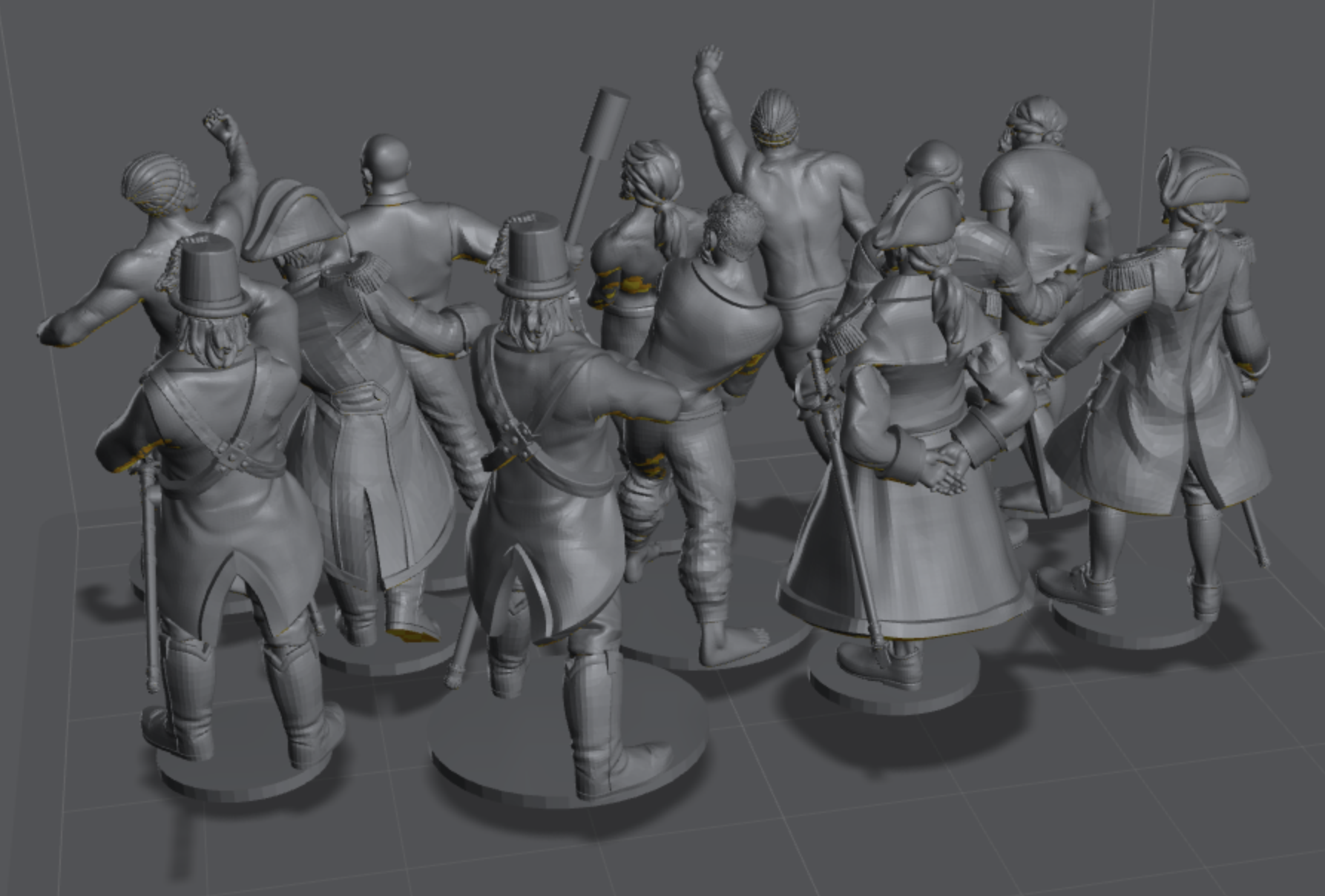

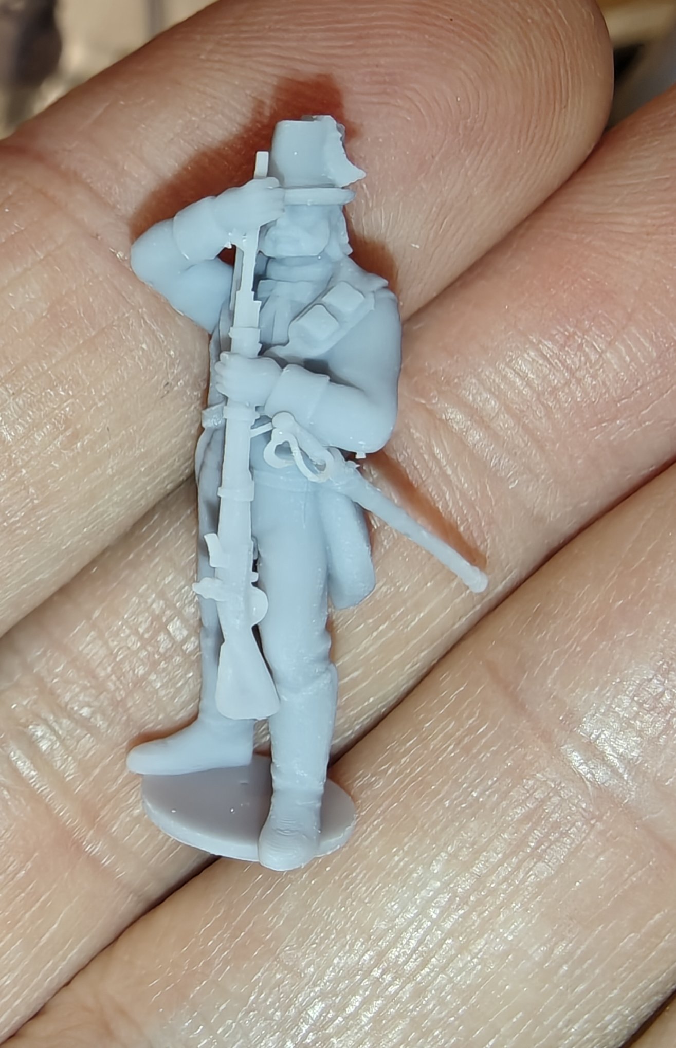

Here is a few of the latest additions - these are 17th century crew, officers and soldiers for future ship projects from that period.
I have some very thin parts that would be completely un-viable for any commercial production. They all printed fine, but I broke a few during work-up. But I can just try a few times until I manage. These use very little resin at 1:64 scale.
