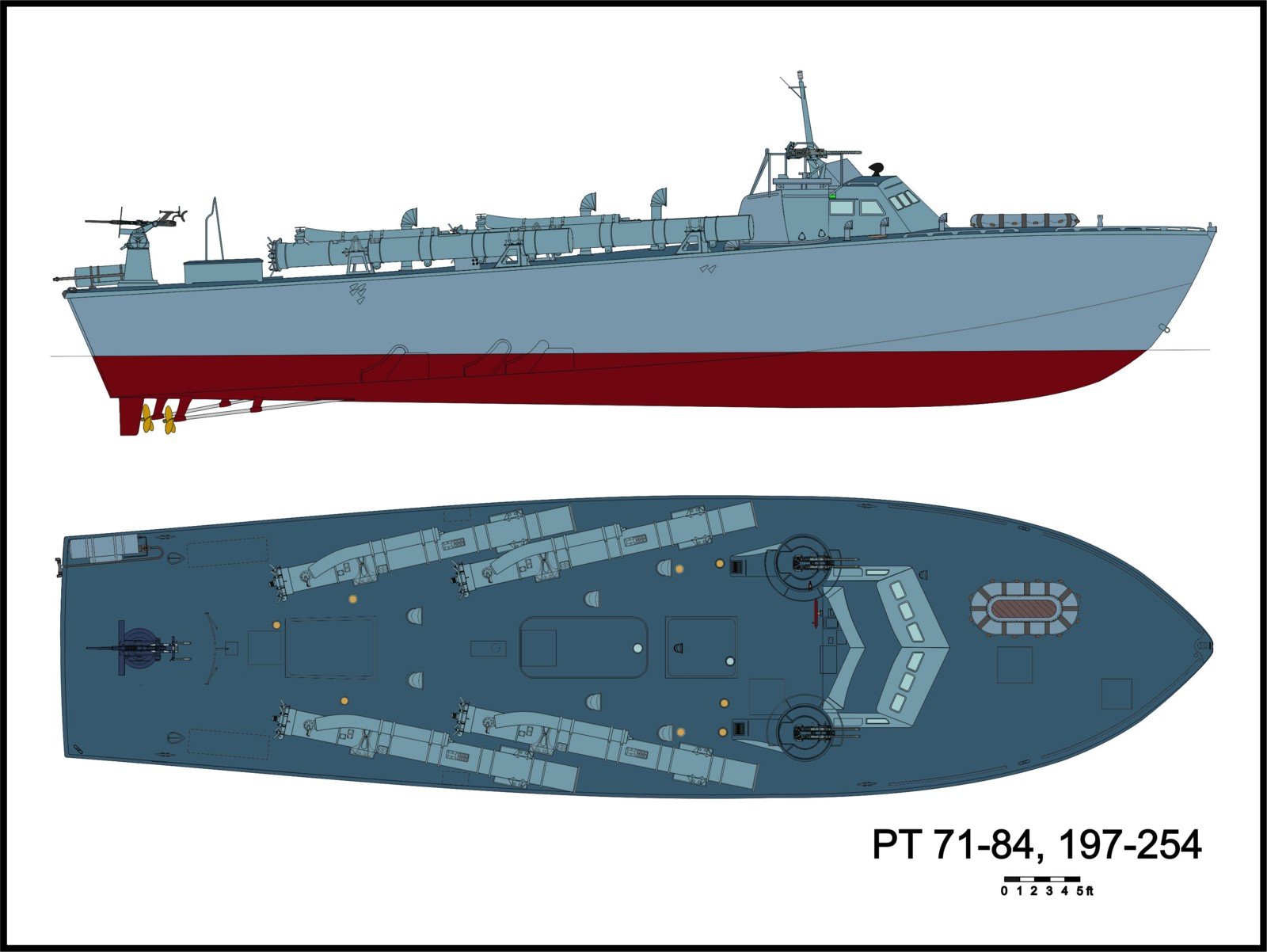

I know most of you folks are "stick and string" enthusiasts but am curious if anyone is interested in more modern vessels.  Rather than watch TV in the evenings I've been slowly working on a potential 1/48 kit of a WW2 Higgins 78' PT boat.  Structurally, it will be like most of the later kits I've done for BlueJacket - laser-cut planked hull built with the Hahn method, resin and britannia parts, etc.   It will be an early boat with tubes and can be built as either a Mediterranean or Pacific boat.

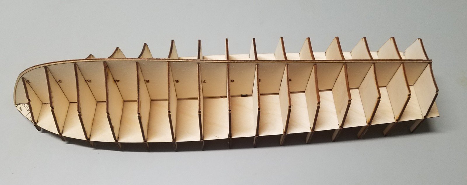

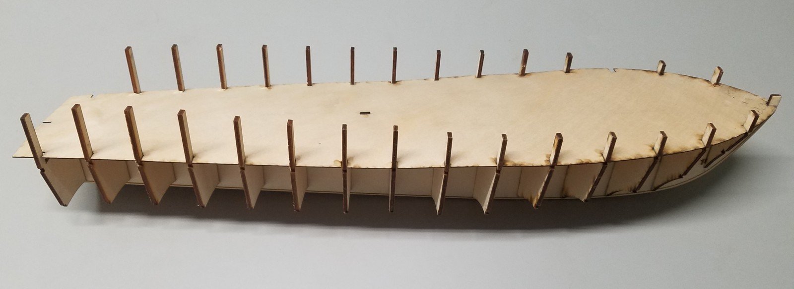

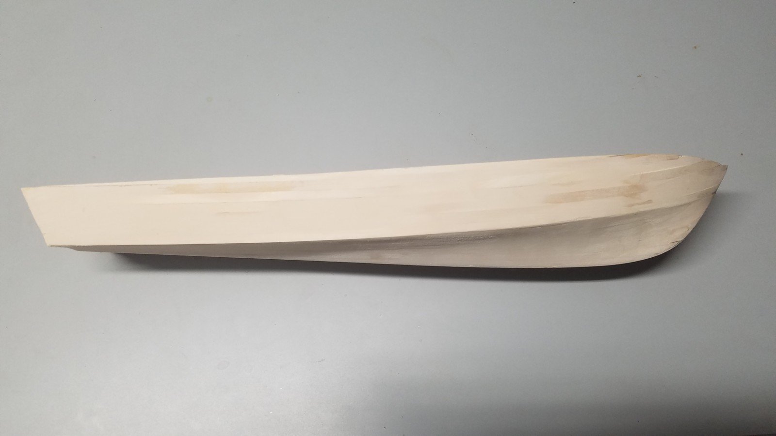

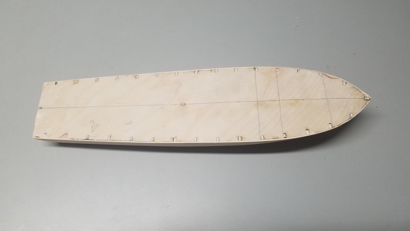

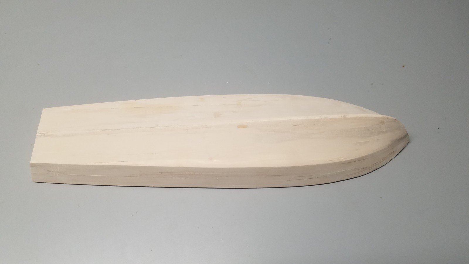

A bit further along on the potential 1/48 scale Higgins kit. The hull is planked and filled and I've adjusted the laser drawings a bit. The deck you are seeing is the subdeck. It will be covered with a 1/32" ply deck that has the positions of the primary components (deck house, engine room hatch, etc.) lasered onto it.  I'm toying with the idea of including enough materials to do any of the three different classes.  There were two slightly different hulls.  The initial hull form was slightly tunneled aft while the later hull was flat aft as they discovered the tunnel caused drag.  There were three different pilot houses as well.  We'll see what happens as I play around with this one.
