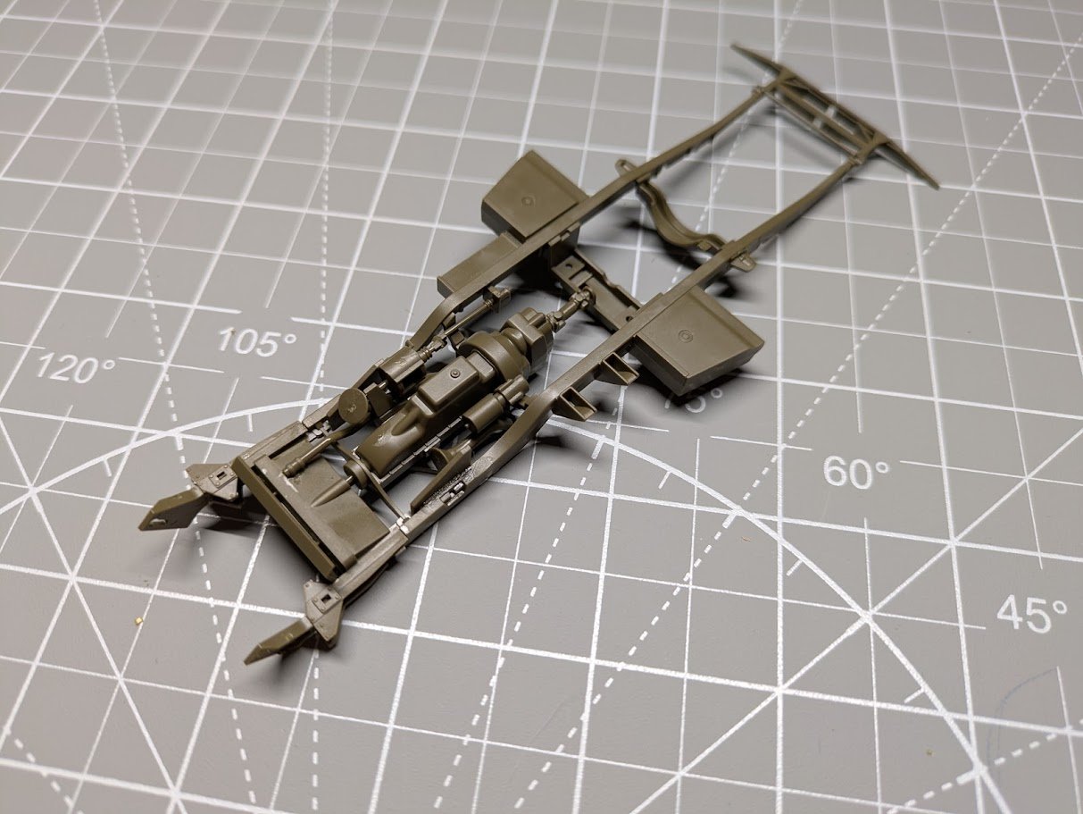

I recently finished up my Vanguard Speedy kit, plus the Photo Etch kit and reference book came in the mail.  So it was go time to start the M3a1.

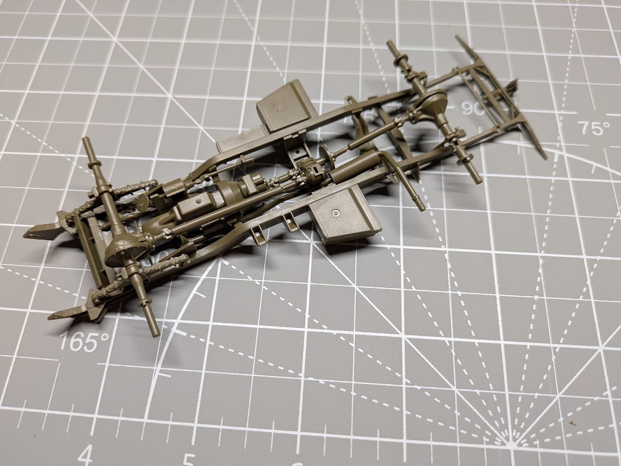

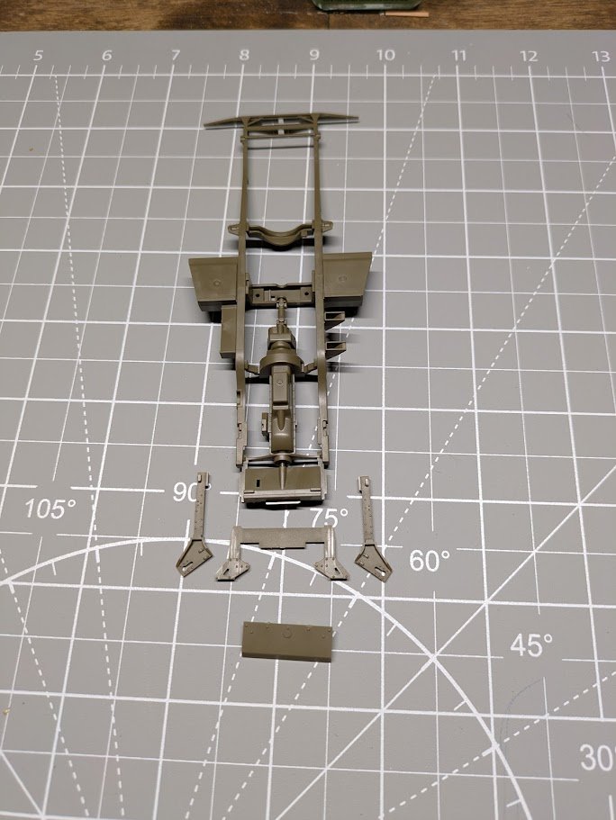

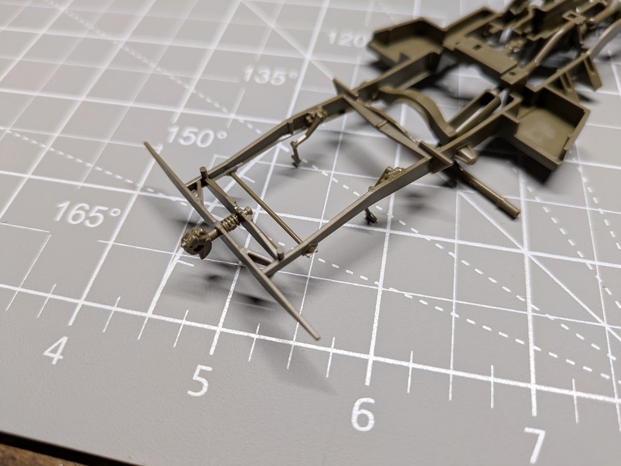

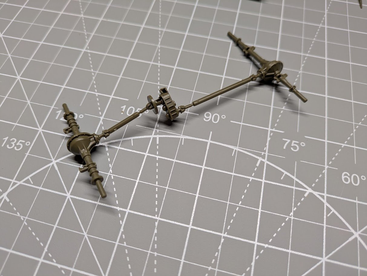

The kit starts with building the under carriage.  I am really impressed with the fit of the parts in this kit, the pieces slot together exactly as they should with minimal to no seams.  I'm also impressed with the Tamiya Extra Thin Cement, I wish I knew about this stuff when I was into plastic scale models 20 years ago. I love that you just fit the piece where it should go and swipe the cement brush on the joint and the part is glued firm, my only complaint is the odor is very strong which makes it hard to use with a baby in the house.
The start of the undercarriage.

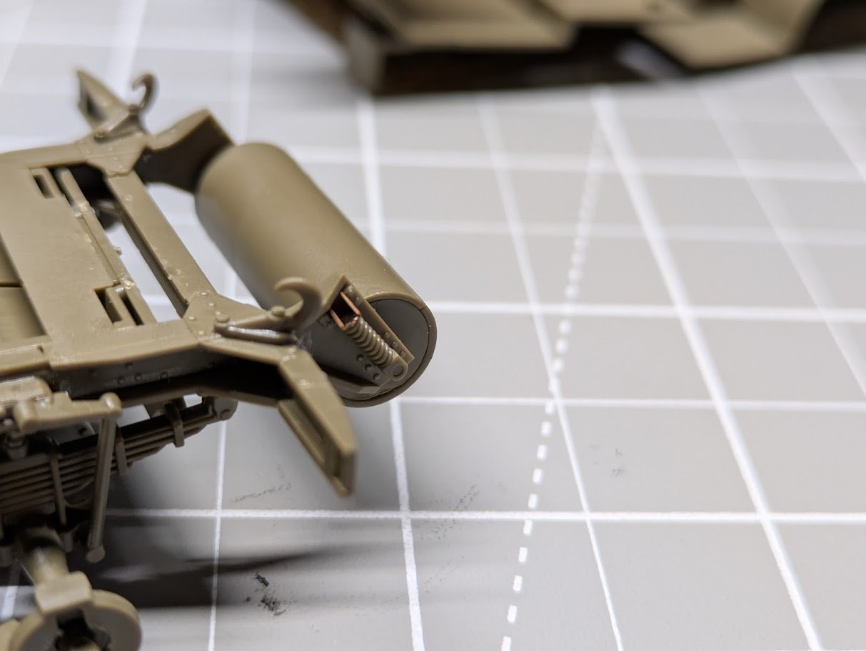

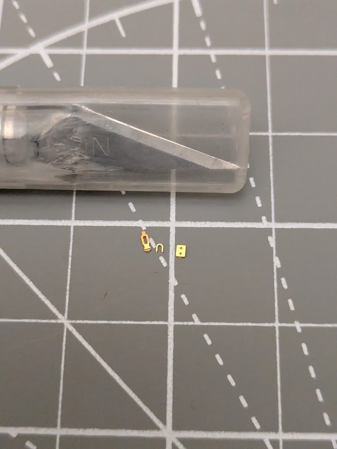

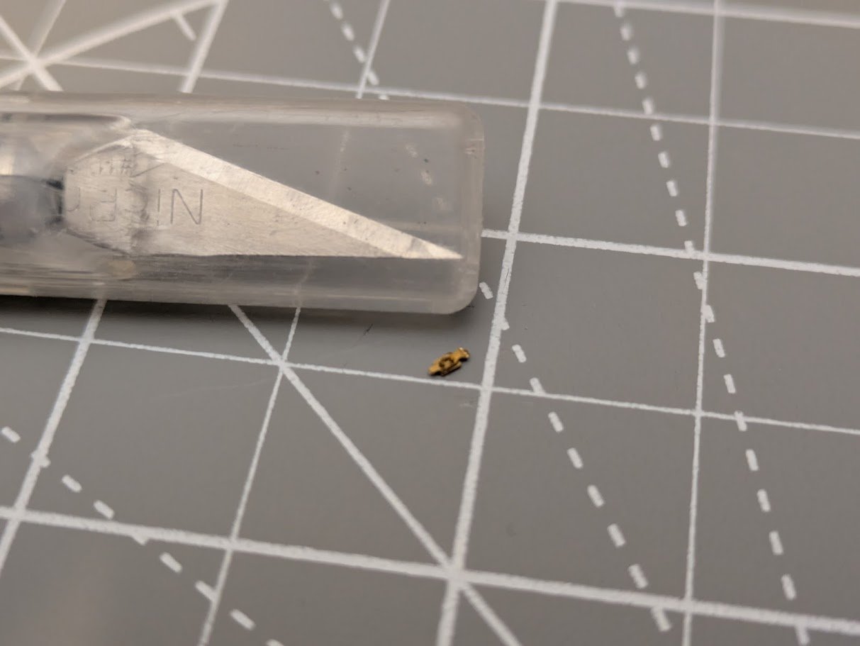

The first PE parts I use replaces the spring brackets on the roller on the front of the vehicle.  Just cut off the top of the piece with a knife and fold the PE part and inset it in place.
Here you can see the parts installed.
The last step on the undercarriage is adding the wheels.  I will leave those off until I know what I am doing for the wheels and they are painted.

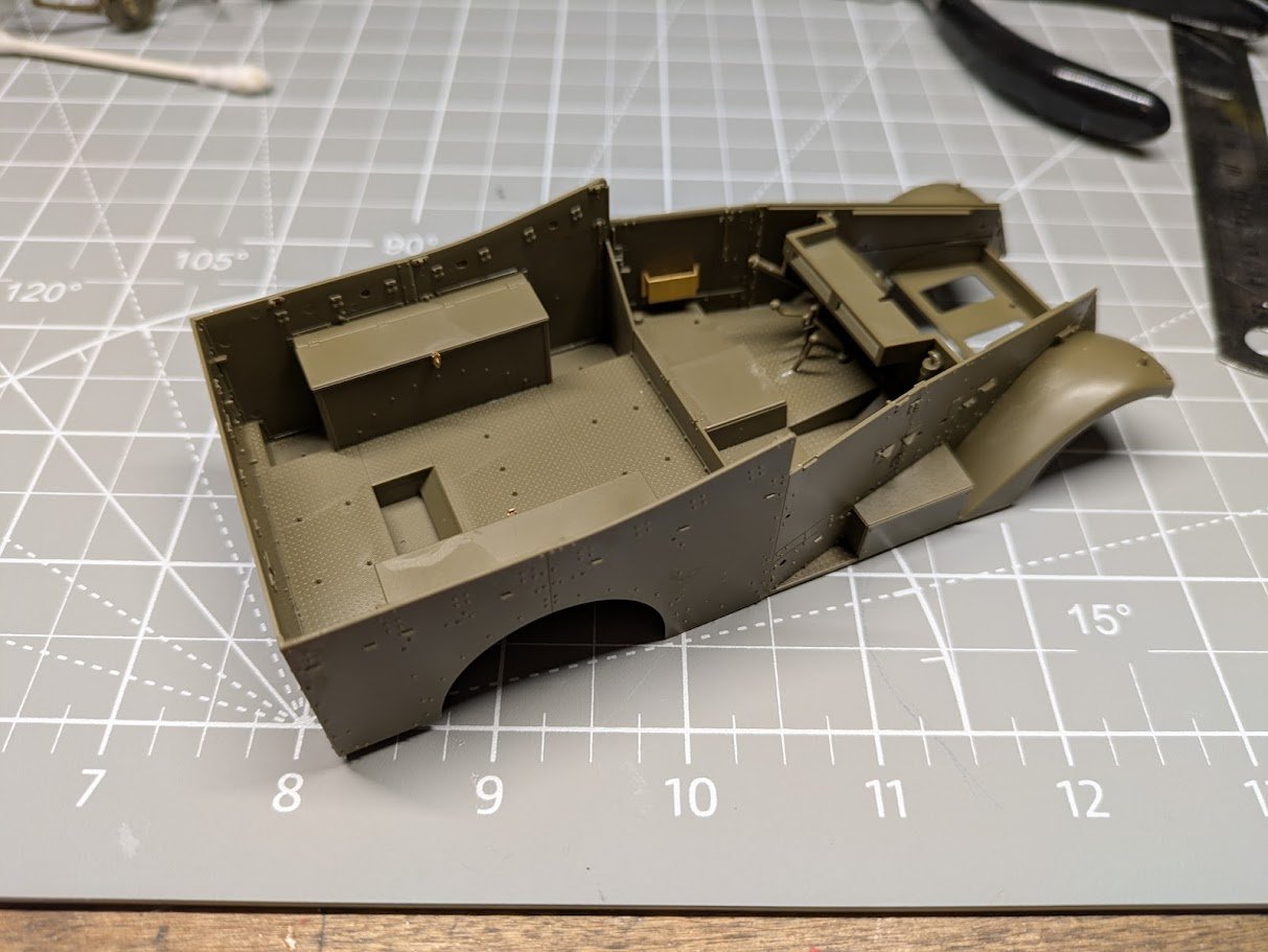

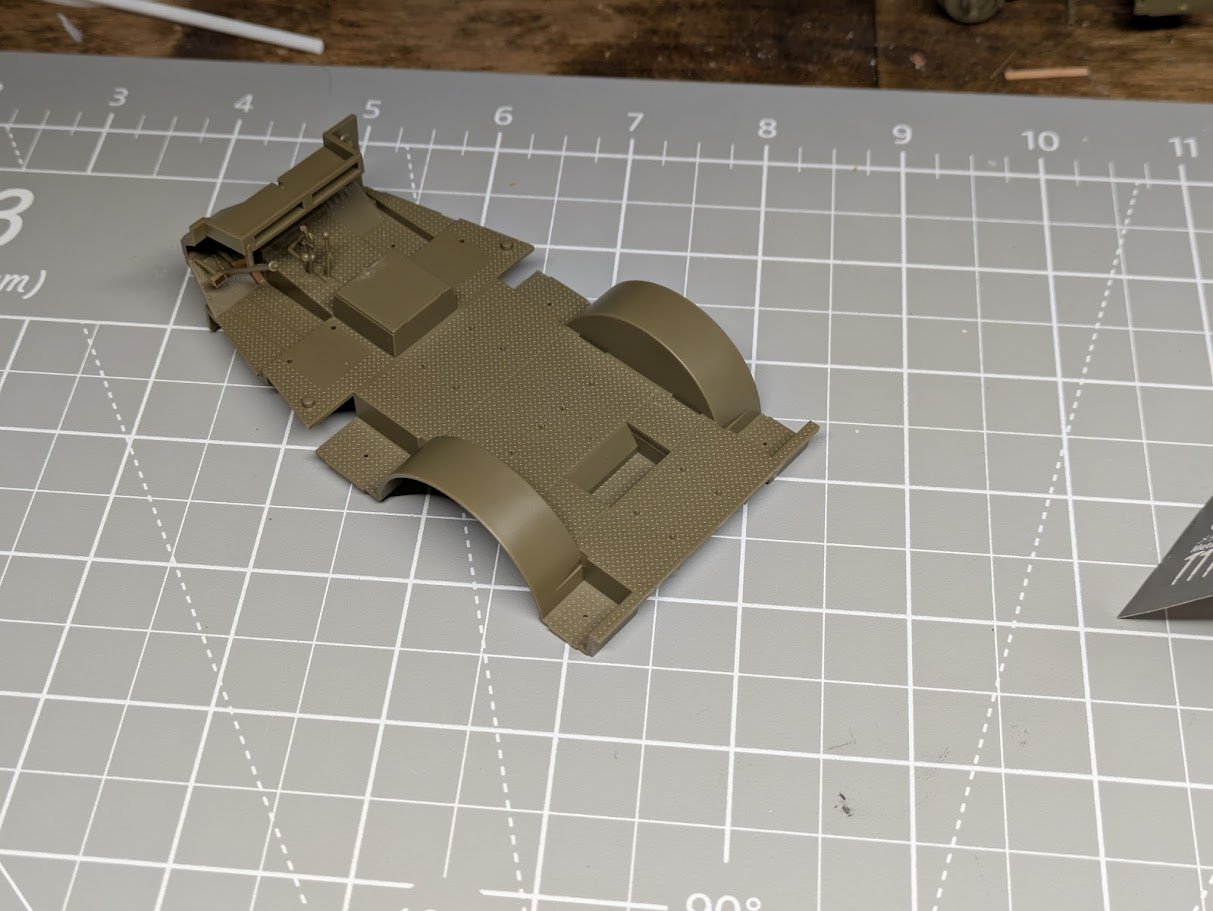

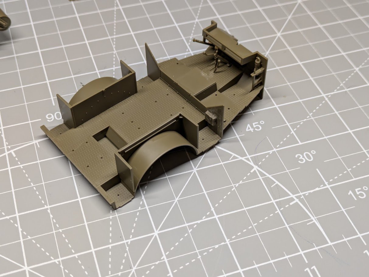

Next I started on the body of the vehicle.

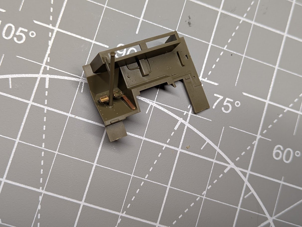

The brake, clutch, and gas pedals have a PE piece that adds a little detail to the pedals.

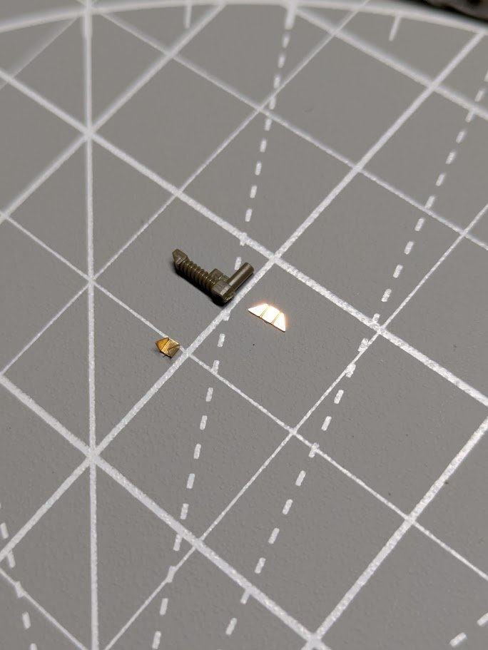

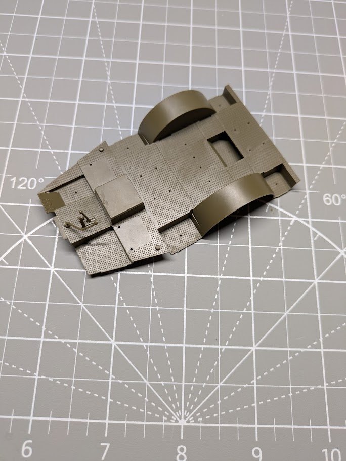

Next were the storage containers that cover the rear wheel hubs.  The PE kit came with some insanely small pieces to make up latches for the storage hatches.  Some of the PE pieces don't seem to be a huge upgrade for how much work it takes to put these insanely small pieces together.  But I though these added some really nice detail and were a great upgrade.
I also added some PE pieces that look to be map compartments to the sides of the doors.
And that is where I am currently at.  I am loving how smoothly this kit goes together, the PE pieces are going to be a struggle as some are just insanely small, and the instructions take quite a bit of studying.  But I am enjoying this kit so far, it's a nice break from wooden kits that take a good investment in time.

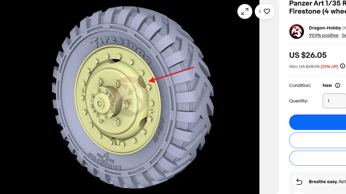

6 hours ago, brunnels said:
I saw those, but my only issue is they have bead locks where the ones in my grandfathers pic don't have beadlocks.
Well, check these out brother....
https://www.ebay.com/itm/172103212015?_skw=tudibaker+US+6+wheels&itmmeta=01K5A51C2WE4H5GSF9K47AF4VB&hash=item2812269bef:g:hZYAAOSwezVWwkdT&itmprp=enc%3AAQAKAAAA0FkggFvd1GGDu0w3yXCmi1dPAcq5kxXbKIx%2BI9M%2BSgx%2BdadejbVBD8ltaeZCluDQSCsCtuoebQZFFECwZuD1l0vid4IWEhNr08kPkVQZLyGBdjAmXSHLlP1WDcJ65T5A7RUrJwu1sTugKEdJuRxmdu7vz64GobWGkg2eSWDMgpdbB0HJvJ%2FxiGcZcU0UkM4mgB6SOFrmA%2BGop8%2FxbCp0UeyAglzUFZeASptfYGum0OXhwcGqwBPMiUez3yAiEQYCCHEEFU3fXVgmbYQPnCqHbio%3D|tkp%3ABk9SR77ChcWqZg
Studebaker 6 ton wheels and tires... Same size as the M3 Scout car with the same non-beadlocked rim, and it has the proper split lug traction tire tread... Out of Virginia in the US...
I can't tell if they are the Goodyear or Firestone tires, but in their e-Bay store they have both versions... The tire size is a 7.5X20, the standard US truck tire of WWII...
I think they will ship anywhere...
