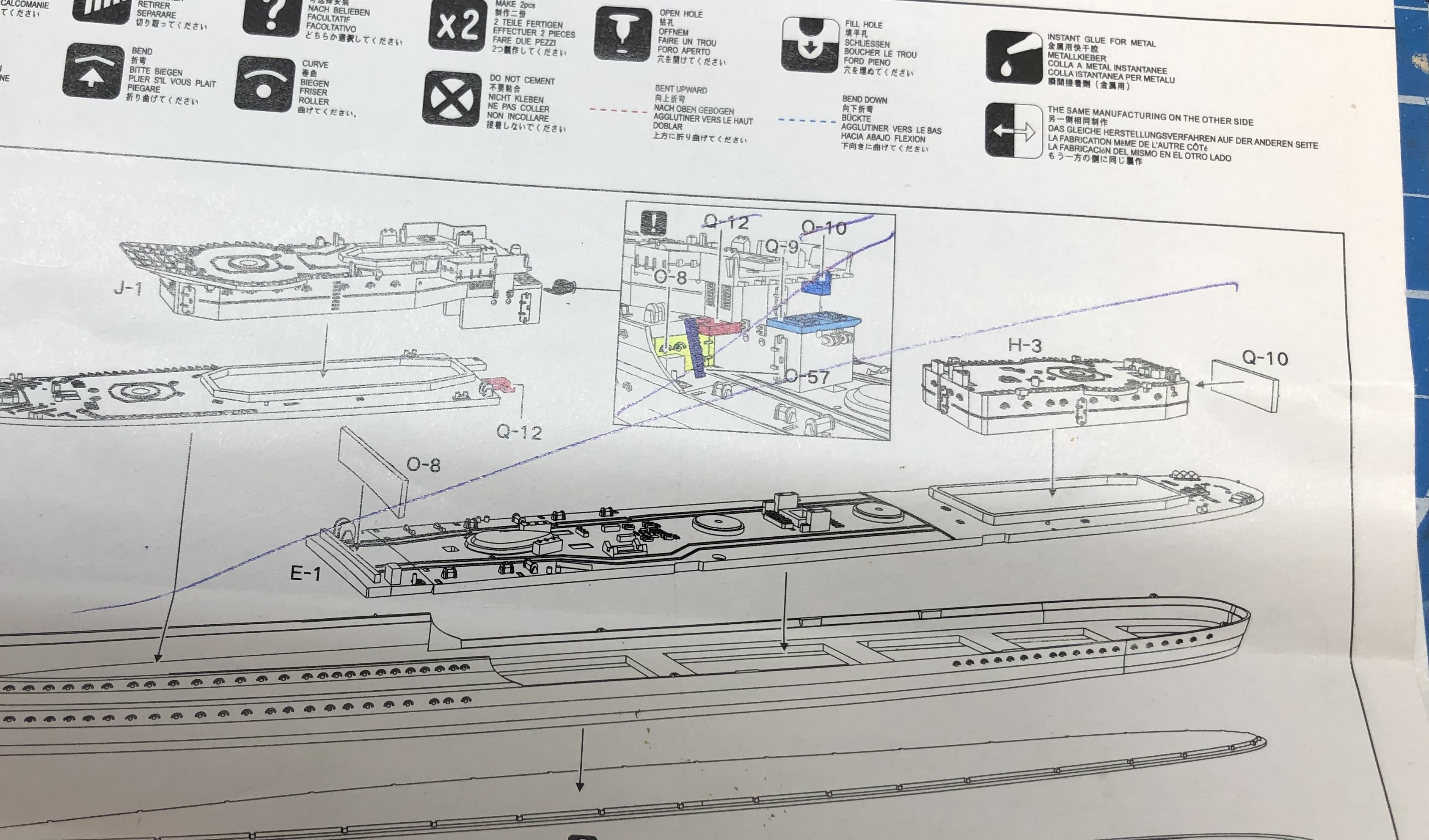

The Flyhawk instructions are a bit wired at times although I think they are trying to be helpful but it doesn’t seem to match the way my brain works.
As an example from HMS Kelly, the above inset shows certain parts to be added in color and again partly on a second inset. It took me quite a while to make sense of it.
