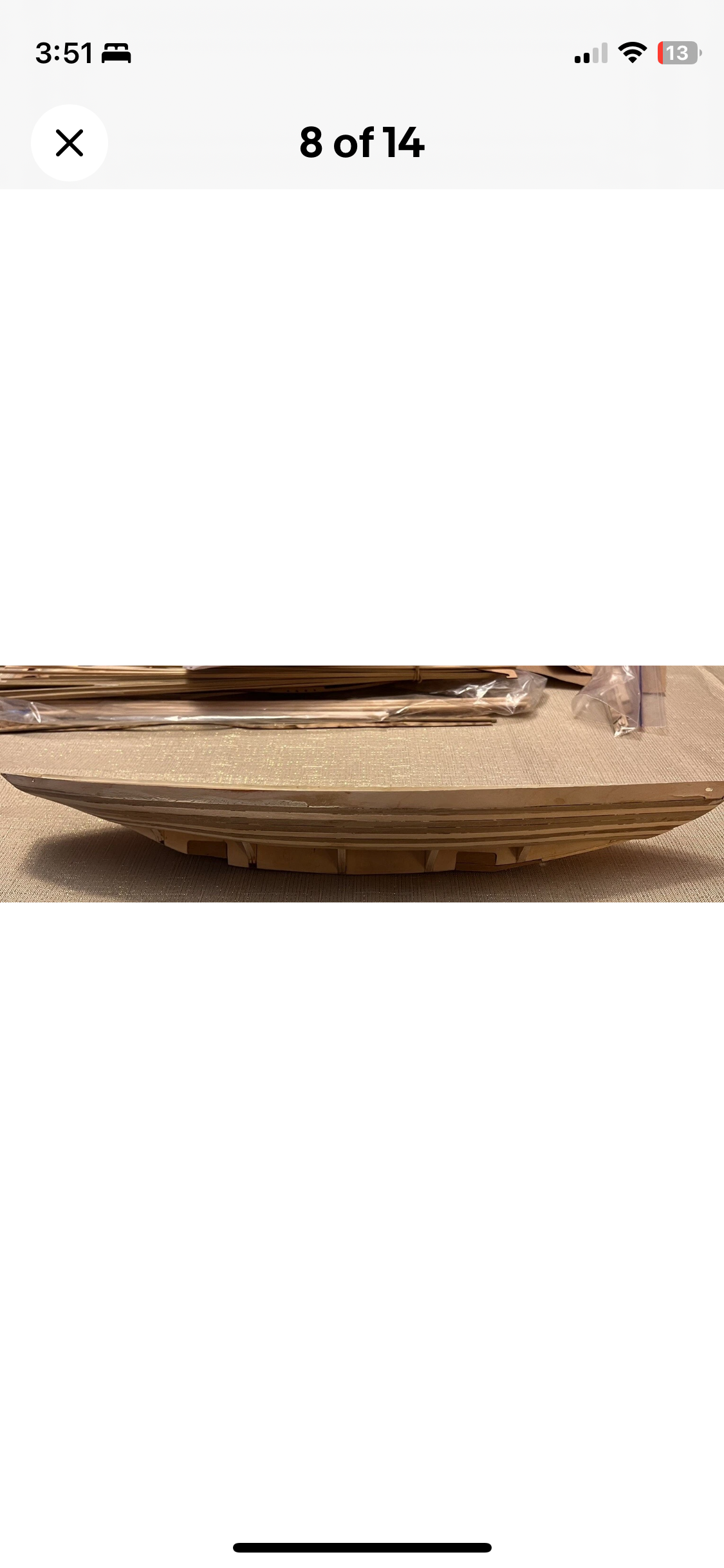

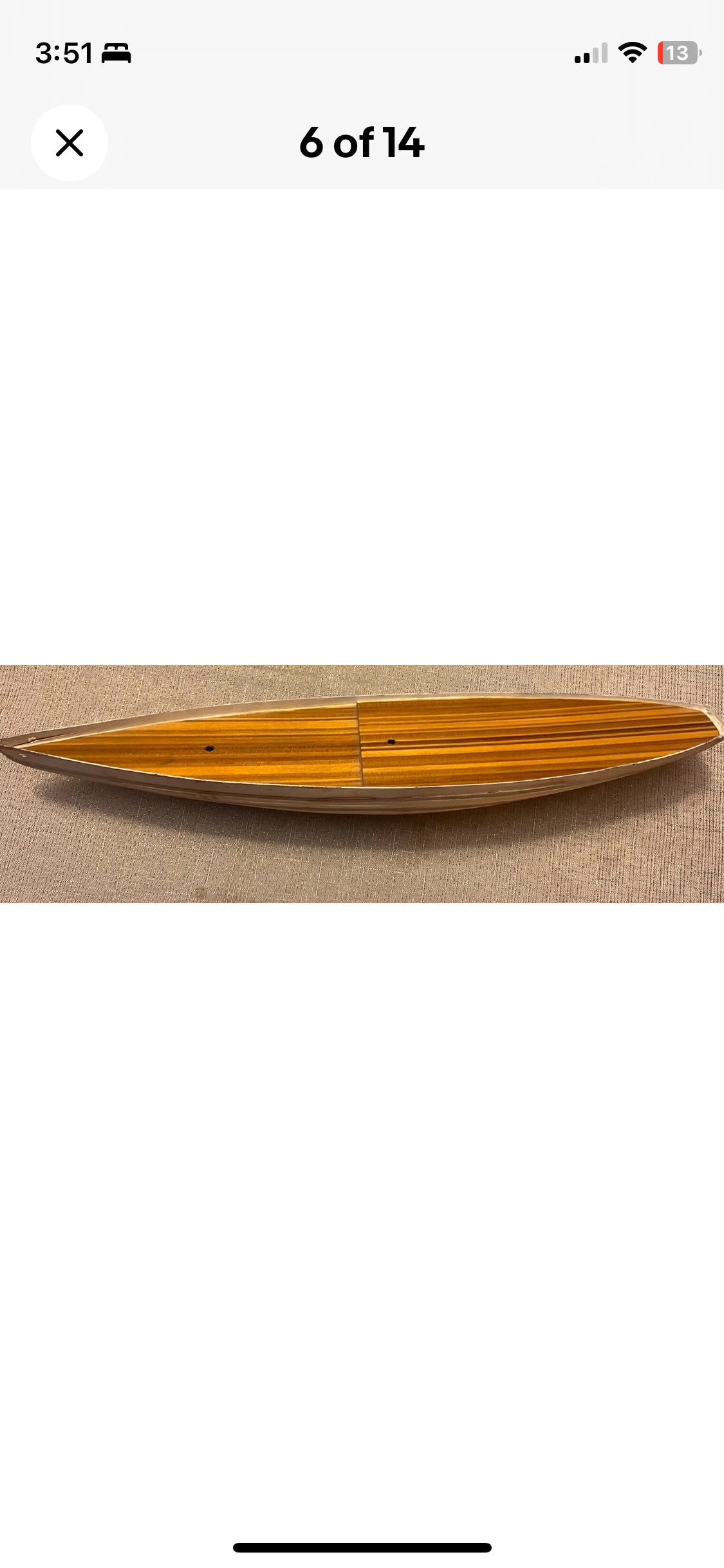

This was an abandoned kit for sale on EBay. It appears to have been abandoned after a planking attempt. As you can see from the pictures it has broken and missing parts. After a very low offer it was accepted. The kit arrived 2 days ago. After cataloging the contents it appears to have a broken false keel with a section missing. Most other parts are with the kit. The attempted planking will require some filling. The deck planking was done well but the color and vanish is atrocious. Any suggestions on correcting it short of sanding it down 1/32” and replanking it  will be highly appreciated. Since numerous Bluenose histories are on MSW I will only post the limited history that’s is on the front of the box.

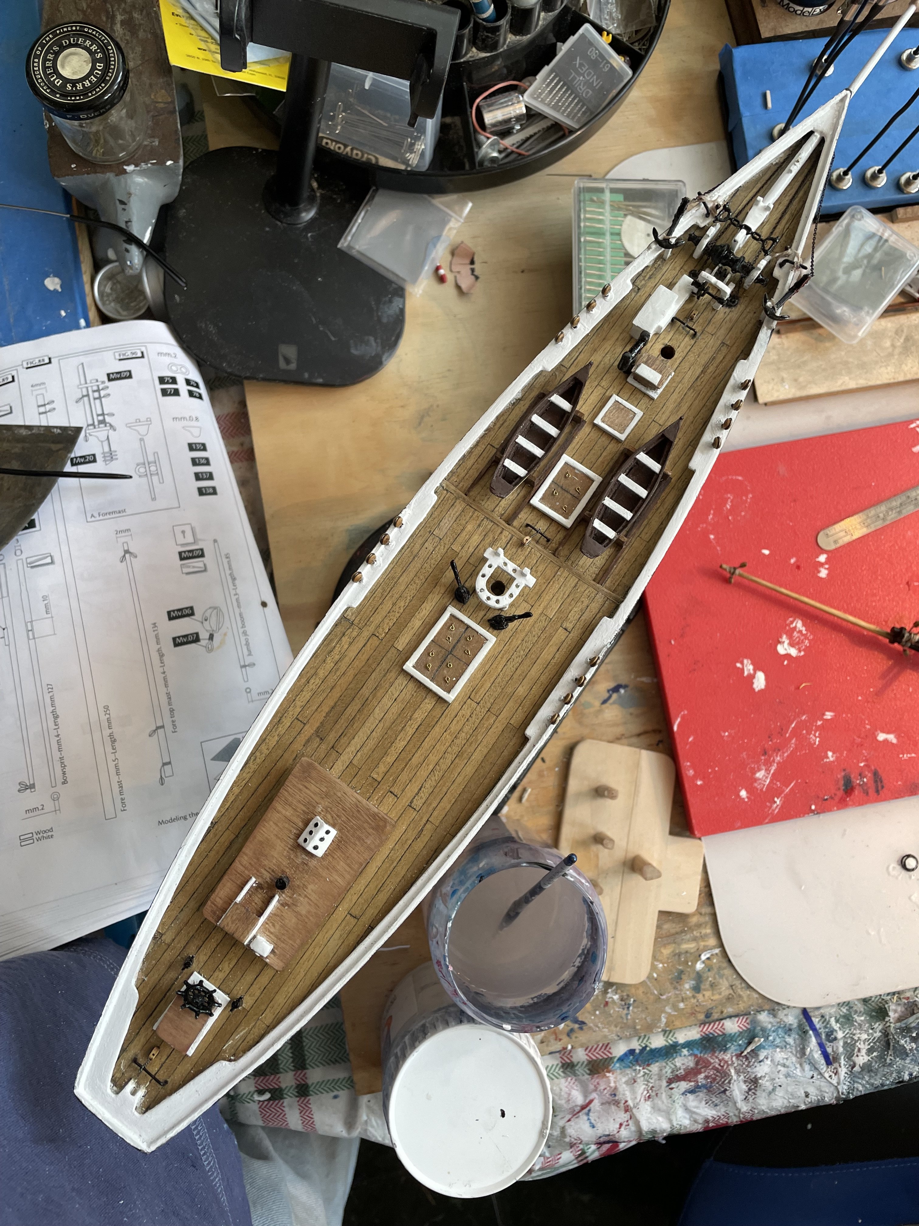

When I look at the decking it drives me crazy. It appears to have a plastic coating. I plan on covering it with 0.5 x 4mm teak decking.

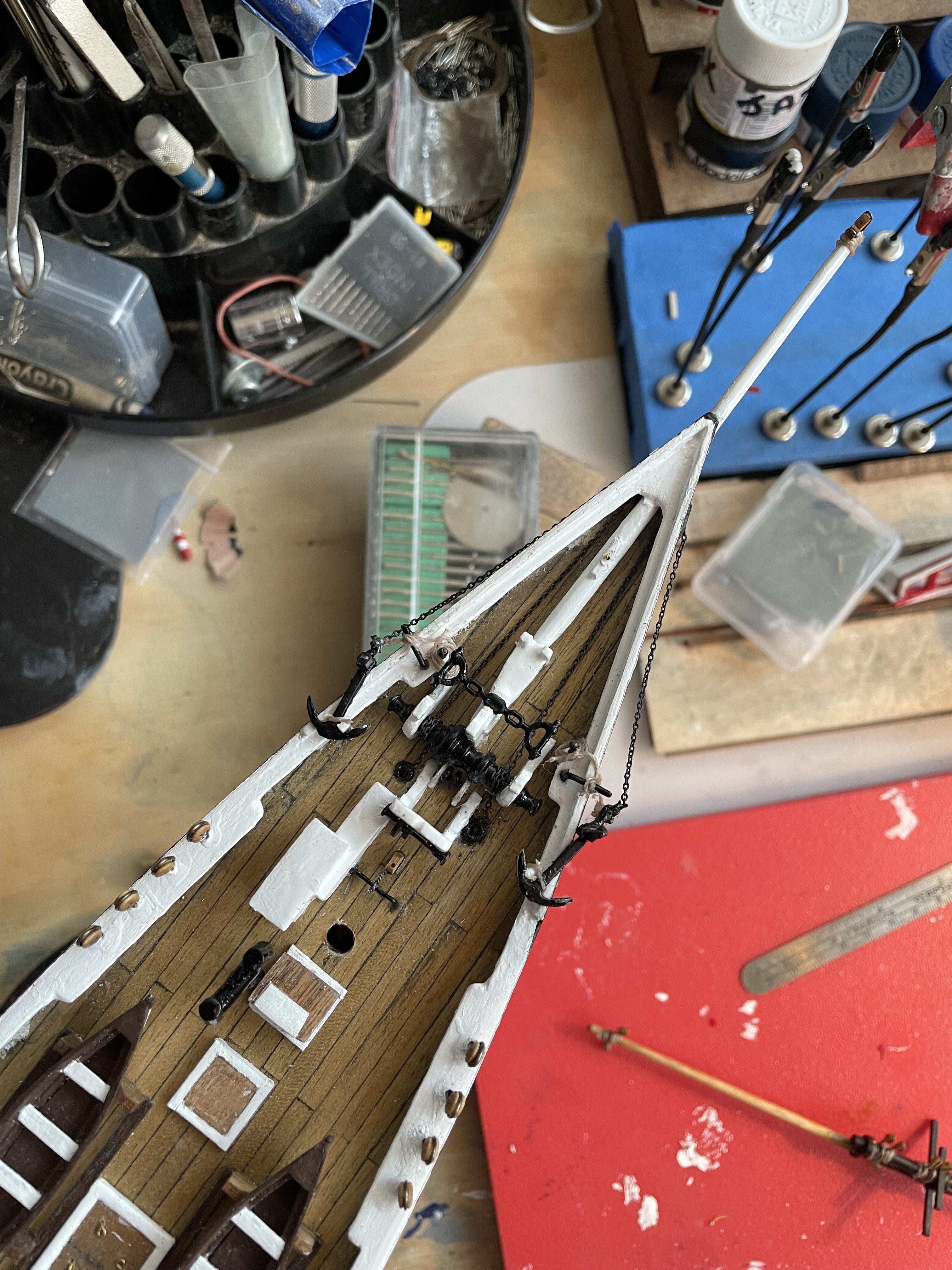

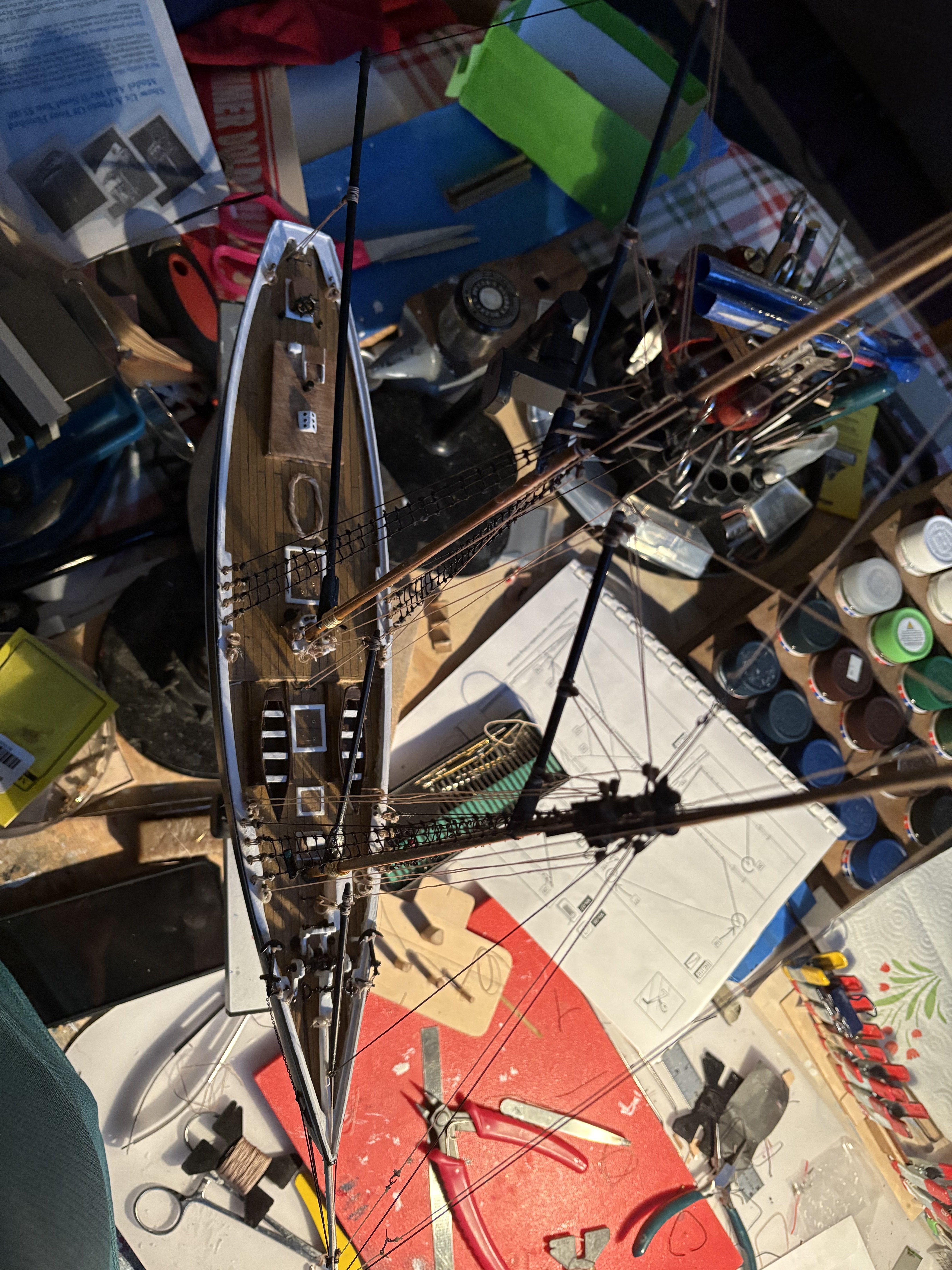

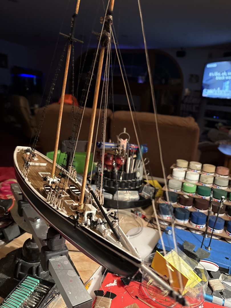

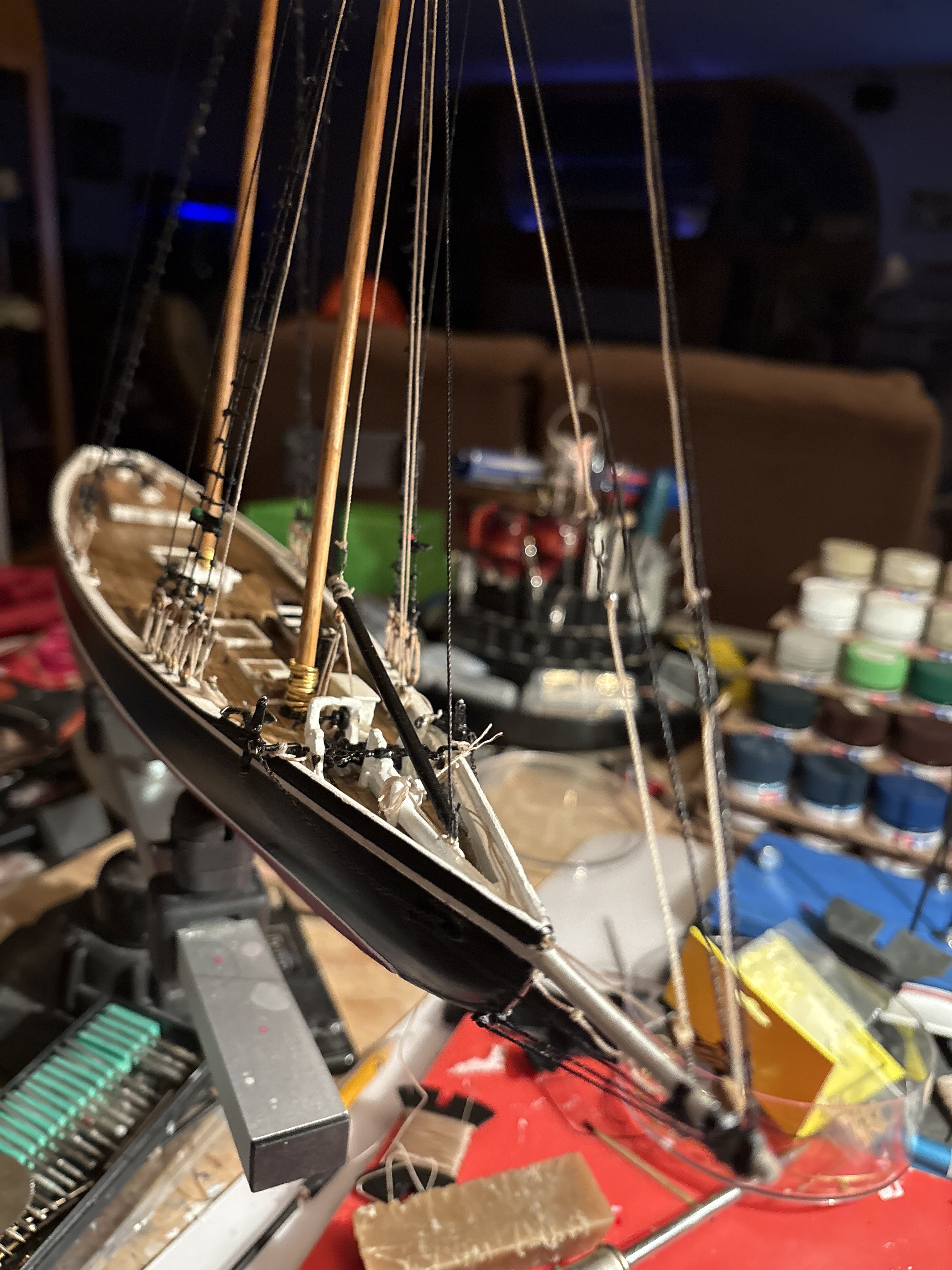

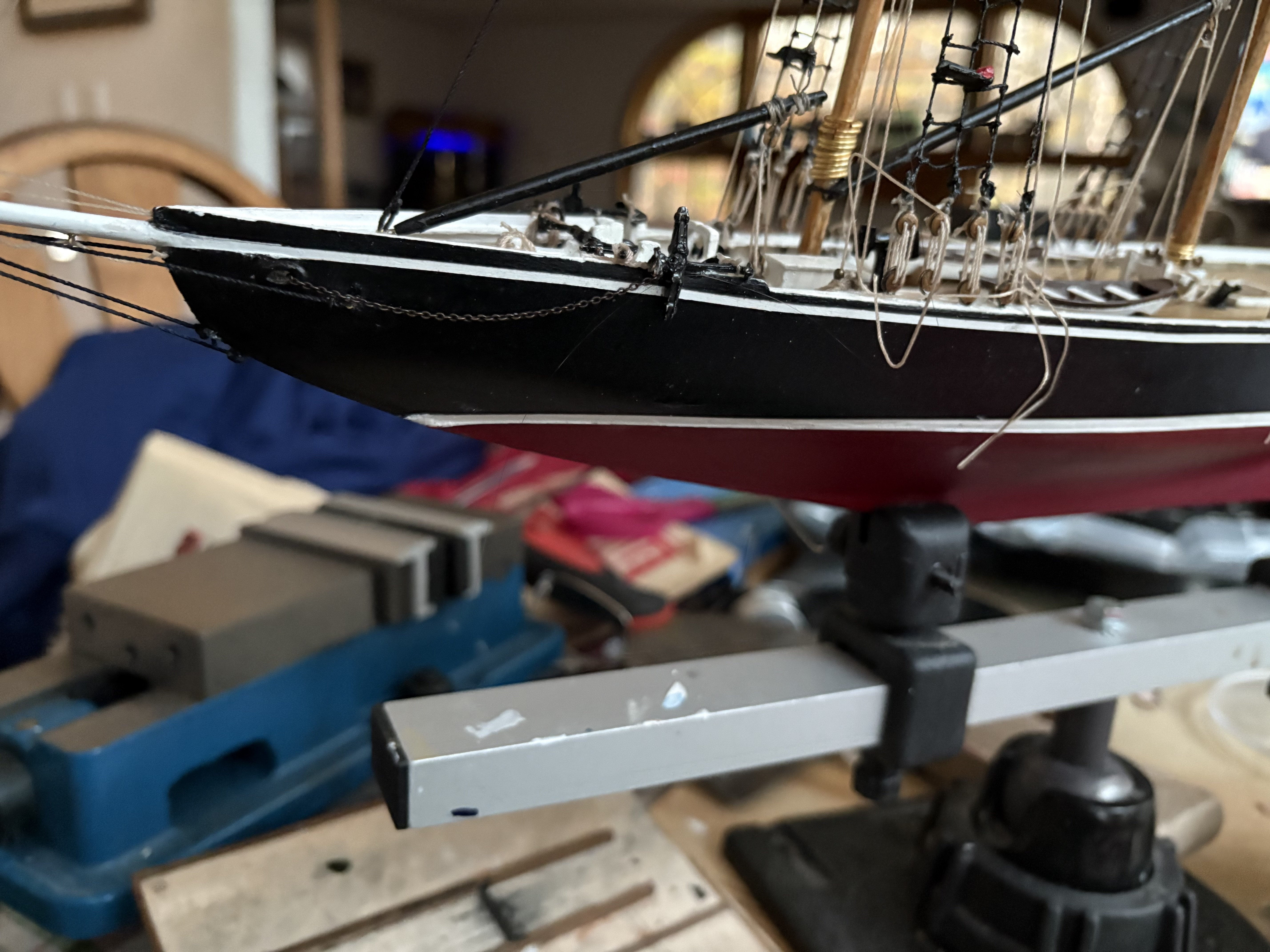

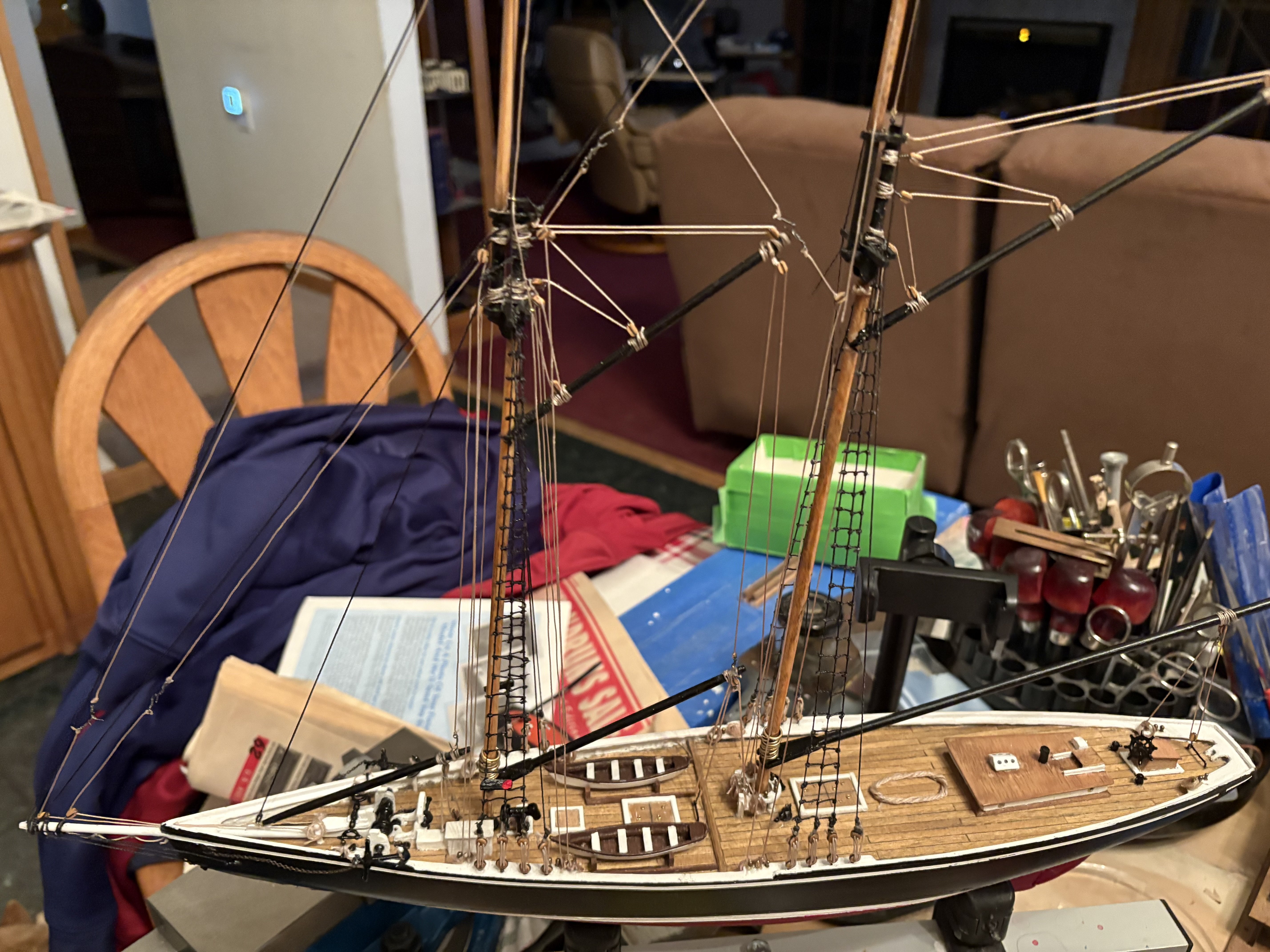

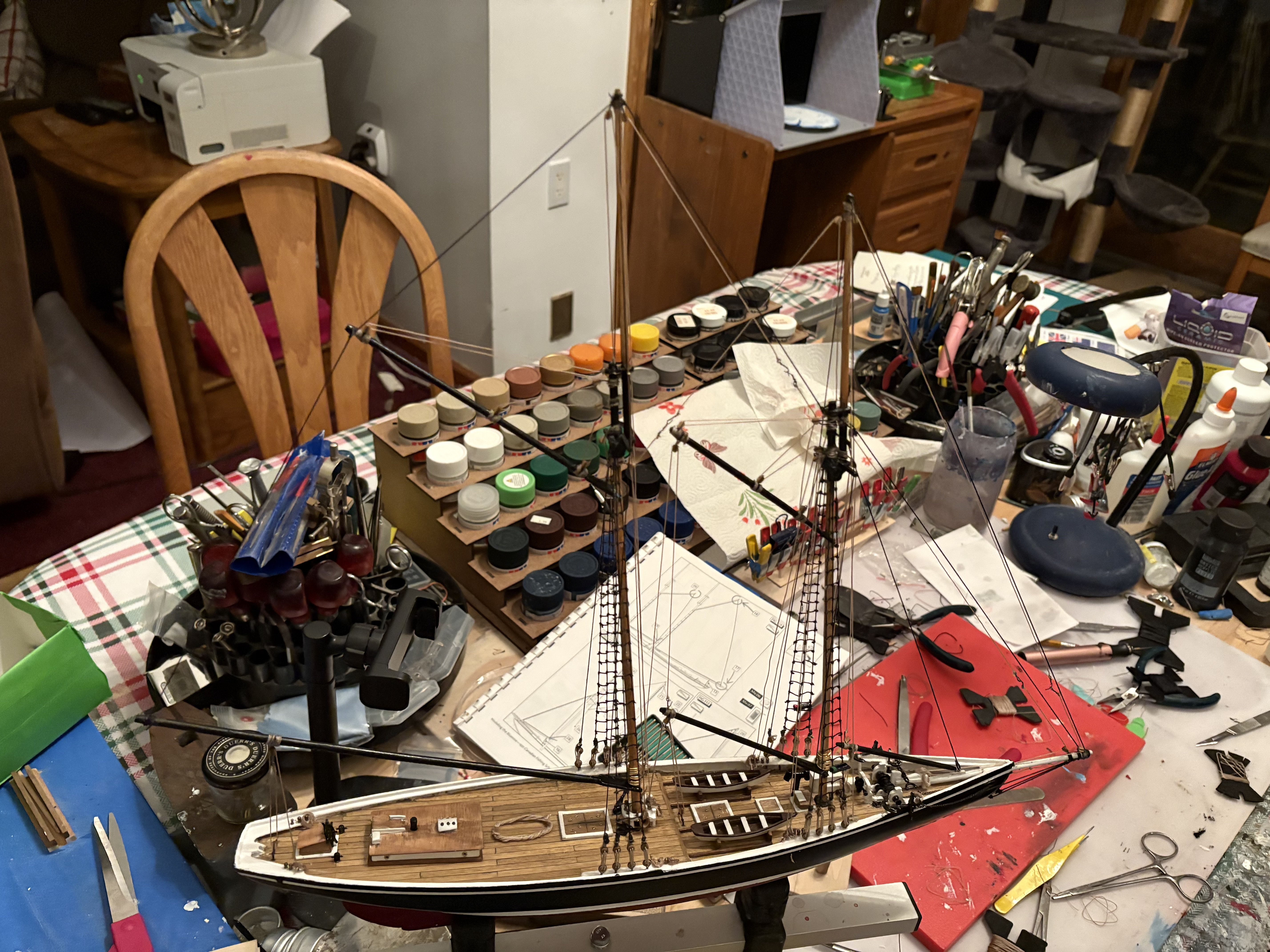

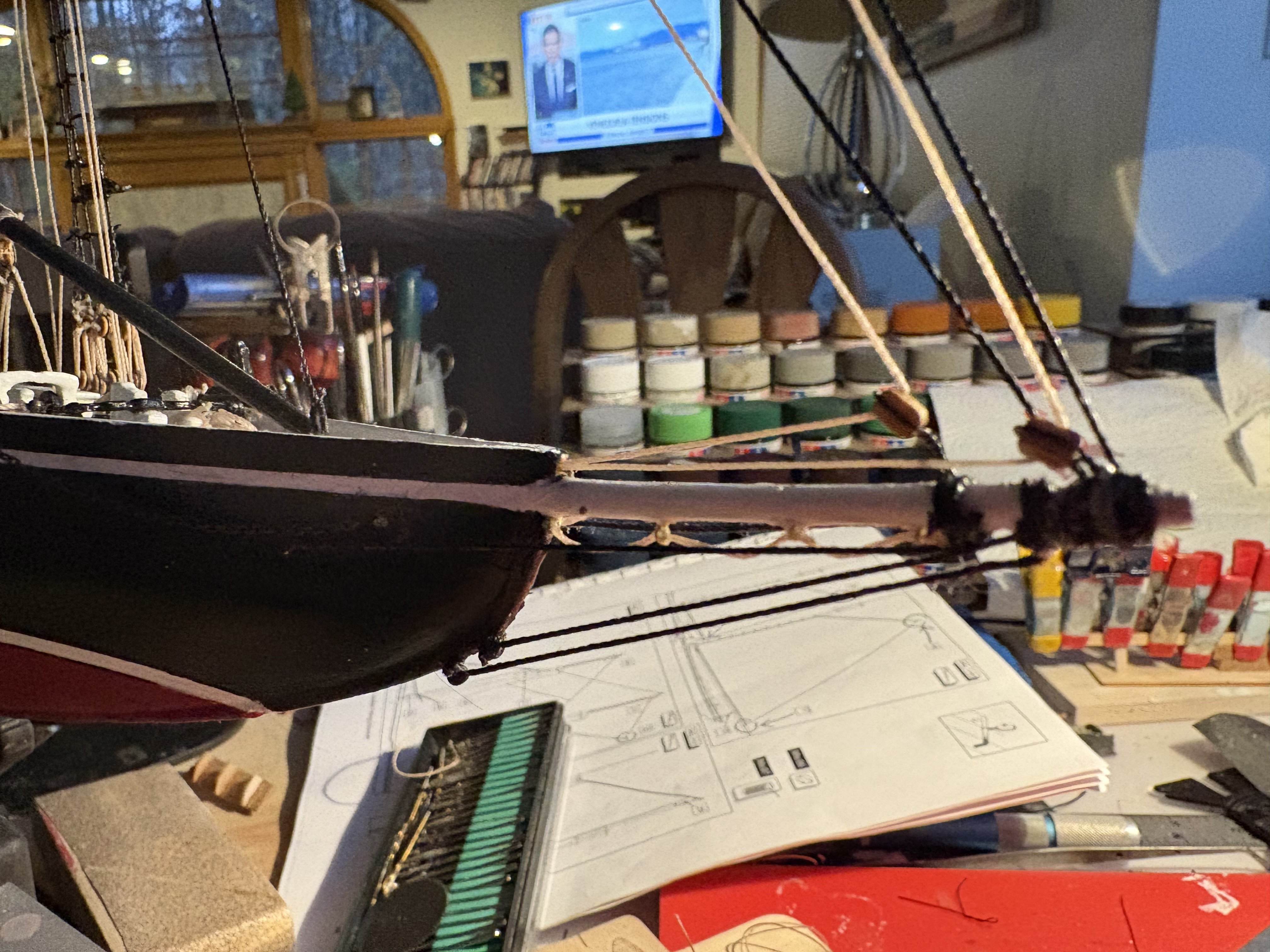

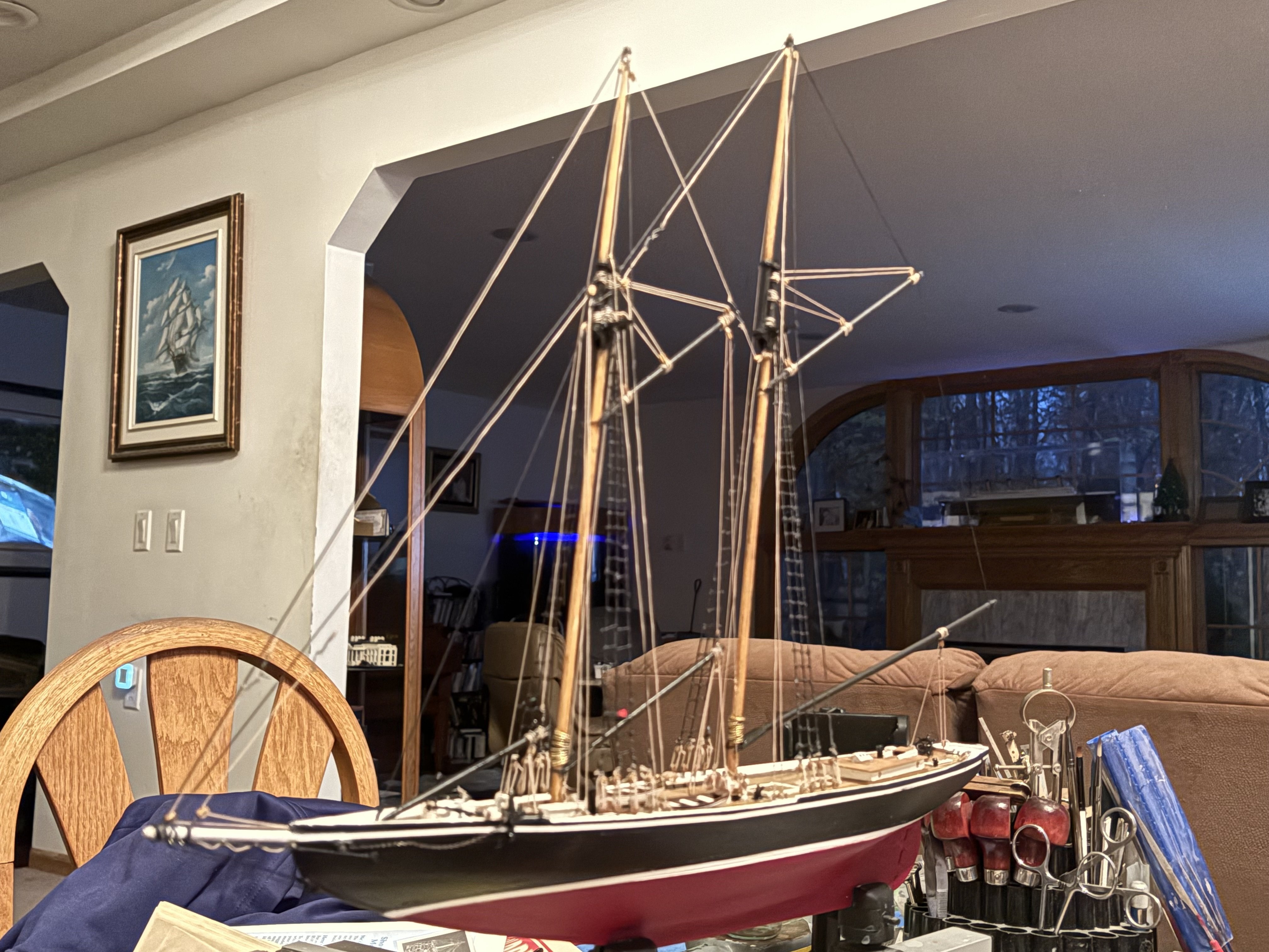

Finally almost to the rigging stage. I think I am going to rig it with standing rigging vs sails. I feel that sails will take away from the deck detail. Any opinions would be appreciated.
Great work so far in refurbishing and continuing the build of this Bluenose, RVB!  Looks really nice!  The Bluenose was without question my favorite ship to build (to-date).  It looks like you are already a seasoned model ship builder, but I would encourage you to look at upgrading your Amati kit-provided blocks, deadeyes and rope to better quality products as you get to the masts and rigging stages.  And yes, I left my Bluenose without sails, as well.  Although I fully realized that the Bluenose was a celebrated racing ship and, thus, should have its sails displayed in full glory, I really like showing off all the rigging so chose mine without the sails.  Besides the fact that I suck at making good sails... 🤷‍♂️🤷‍♂️  Continued success on your Bluenose, sir!
Gregg
Thanks Gregg
i just ordered model shipways brass belaying pins vs the Amati ones supplied.
I also have beautiful blocks to use in the rigging. I agree with you that builds look nicer with standing rigging vs sails which hide detail.

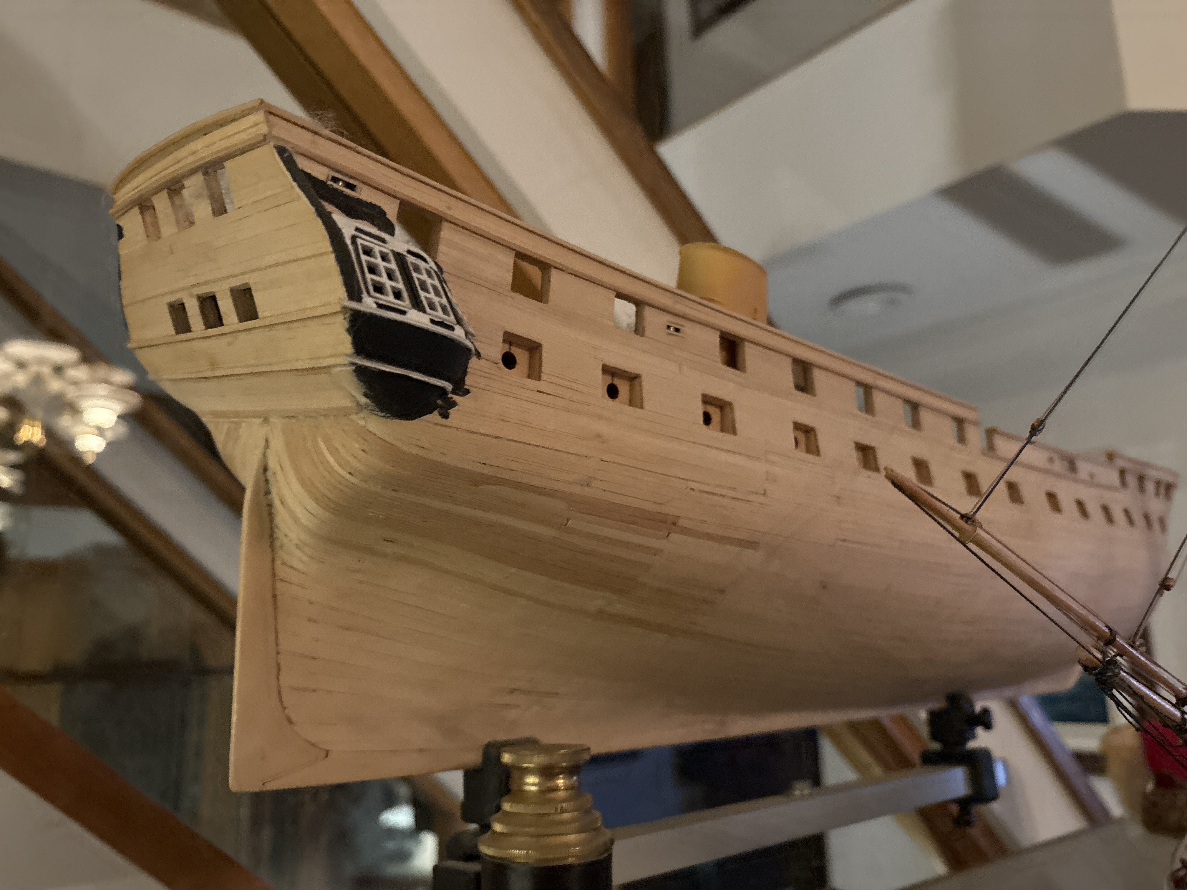

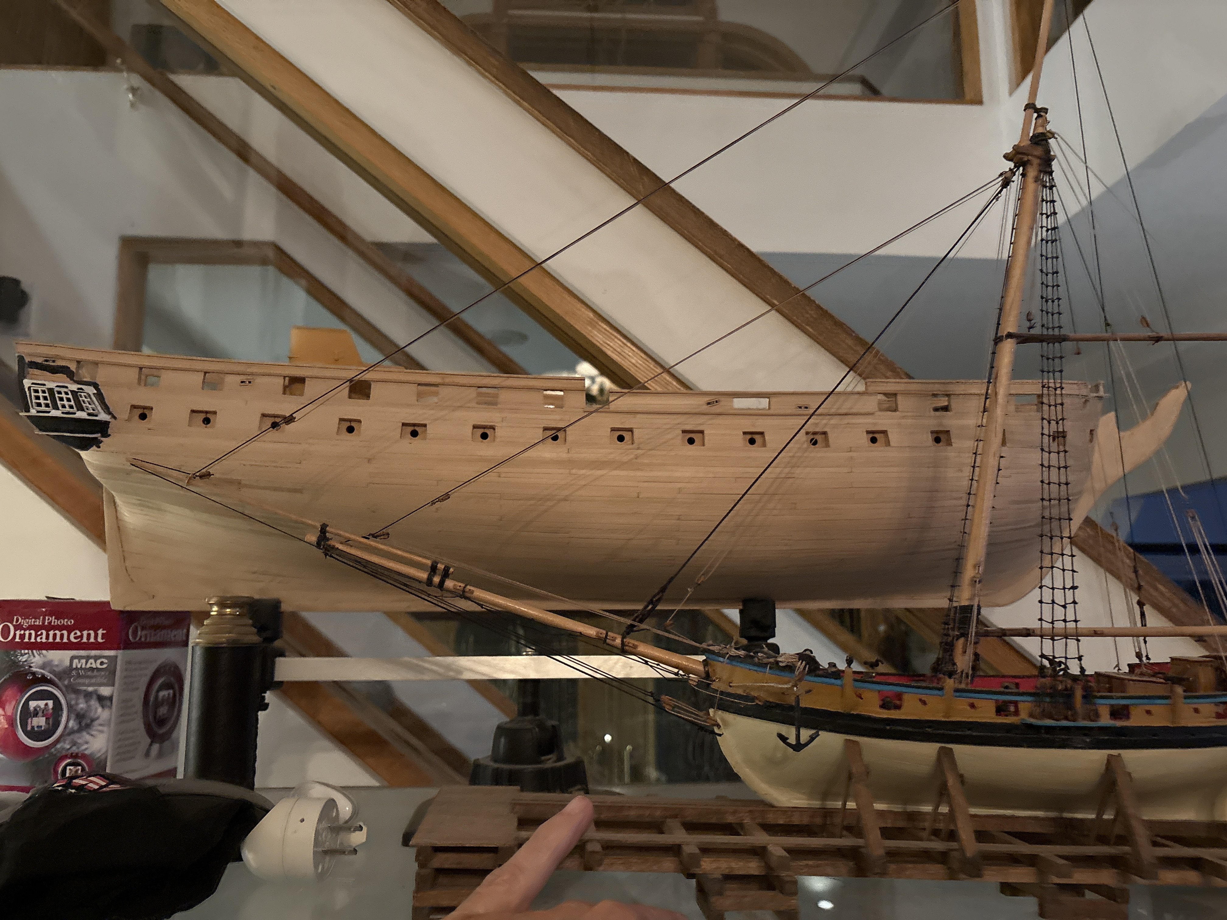

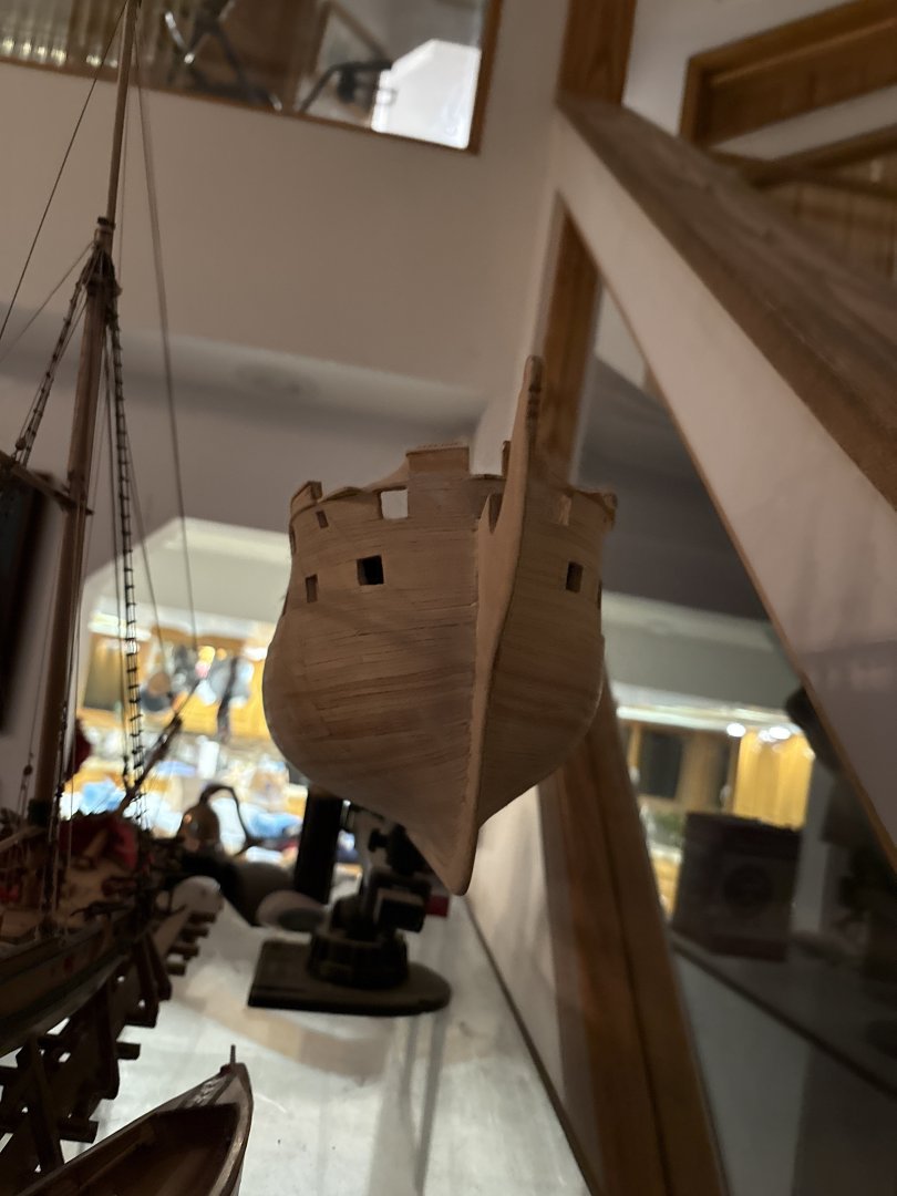

By the way I have the hull of model shipways  USS Constitution almost finished. I need to get back to it. This may sound crazy but I have 2 or 3 boats presently in progress. I am sure there a lot of us modelers in the same position (Some finished Some not)
Enjoy your model shipways USS Constitution build. It is quite the undertaking.

14 minutes ago, vvvjames said:
Is this the build you're doing with your son? It looks so amazing, I appreciate all the work you're putting into the details.
Thanks for the compliment. The answer is no my son and I are building the Midwest Chesapeake Crabbing Skiff. I bought the kit for him and I because he plans on building the real thing and it is very similar. He is an architect and is designing a kit to be laser cut of the boat he wants to build and we plan on building that one together before he builds the real thing. We will post a joint log when we start. Like most of modelers on this forum I have 3 ships in progress at the same time.

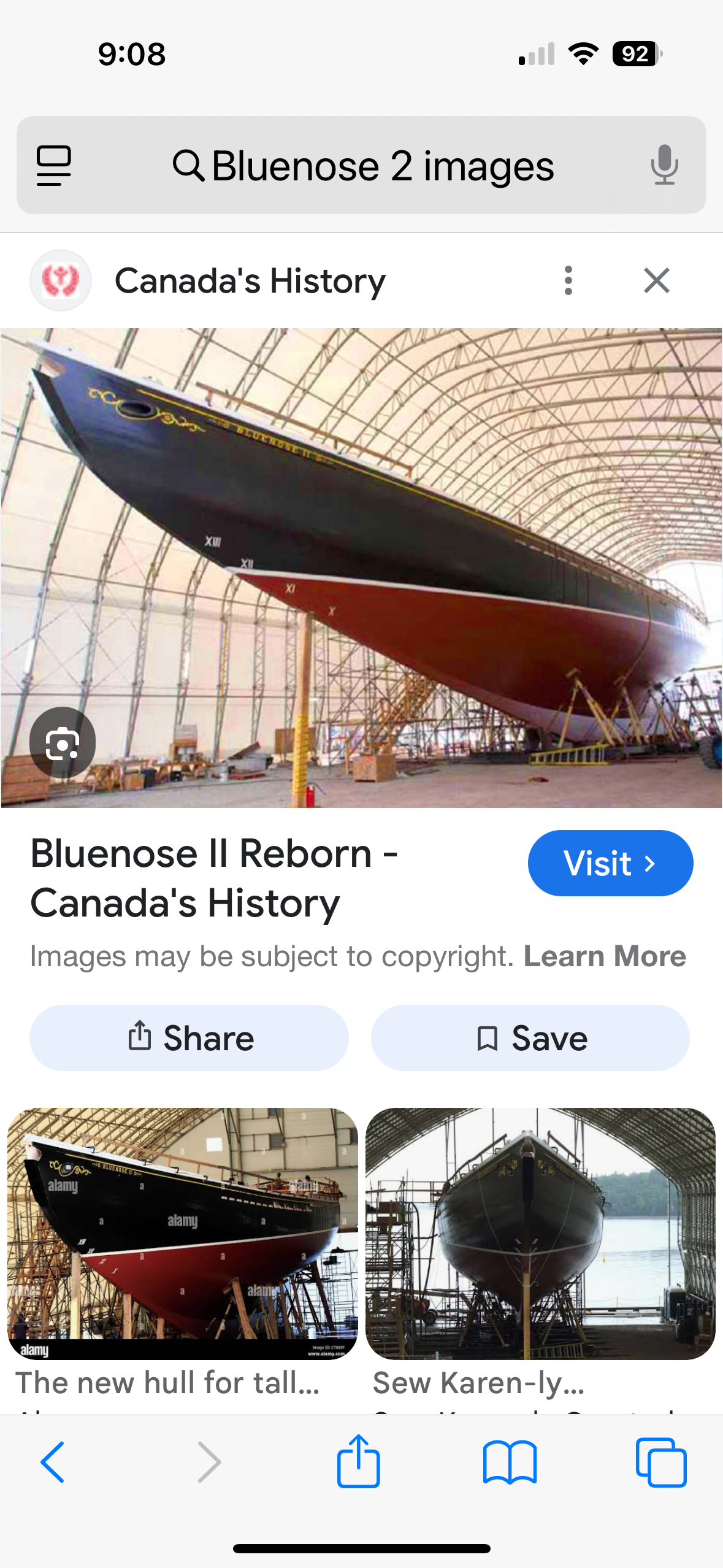

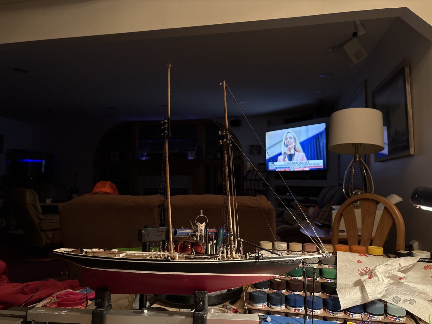

By the way it took weeks to find the right burgandy to match the the color in the actual images of the Bluenose II. The acrylic paint was from Michael’s. And is Liquitex Basics Acrylic Fluid (Alizarin Crimson Hue)
Price is very reasonable $10 for 4 fl oz.
Rick

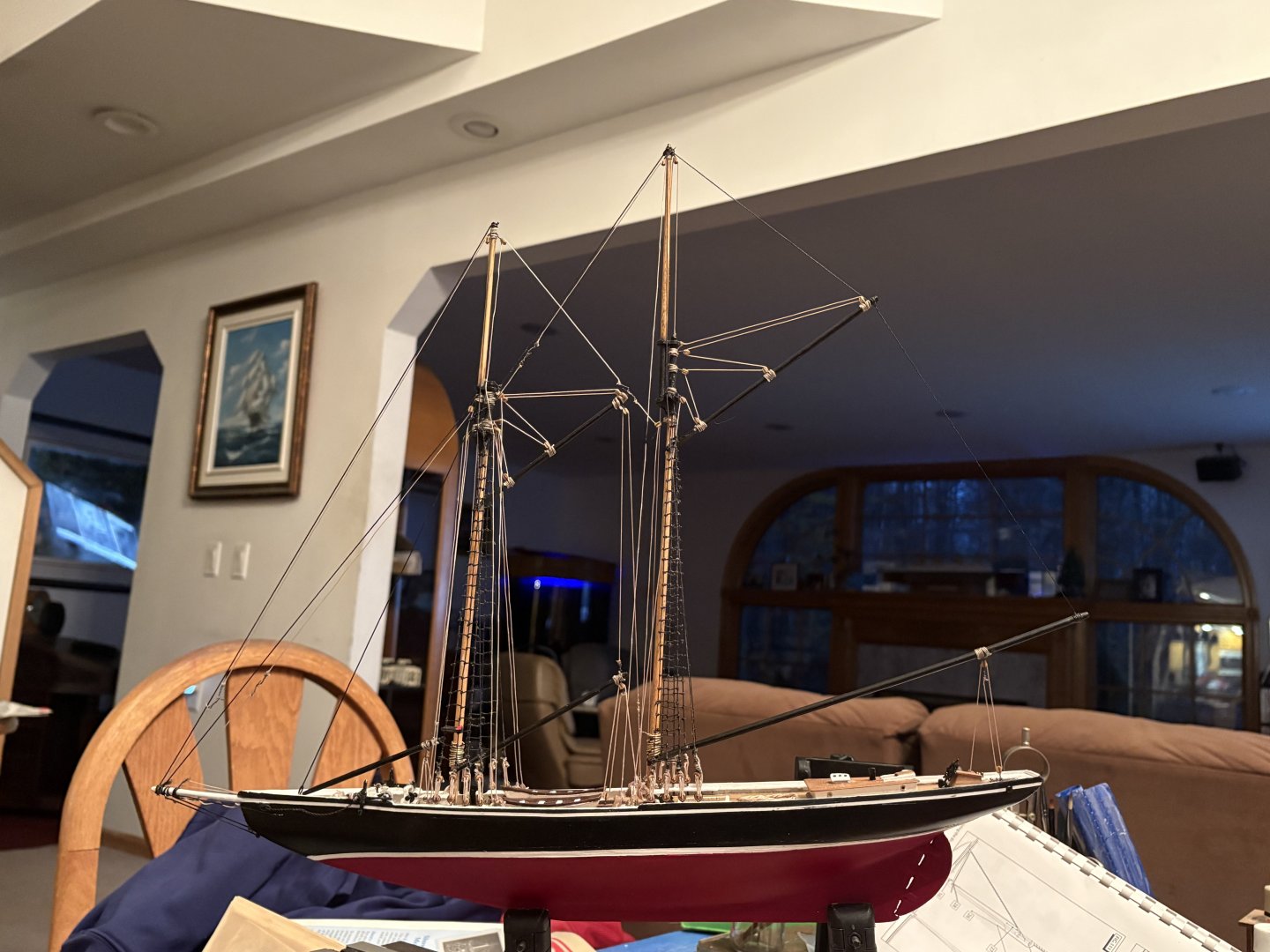

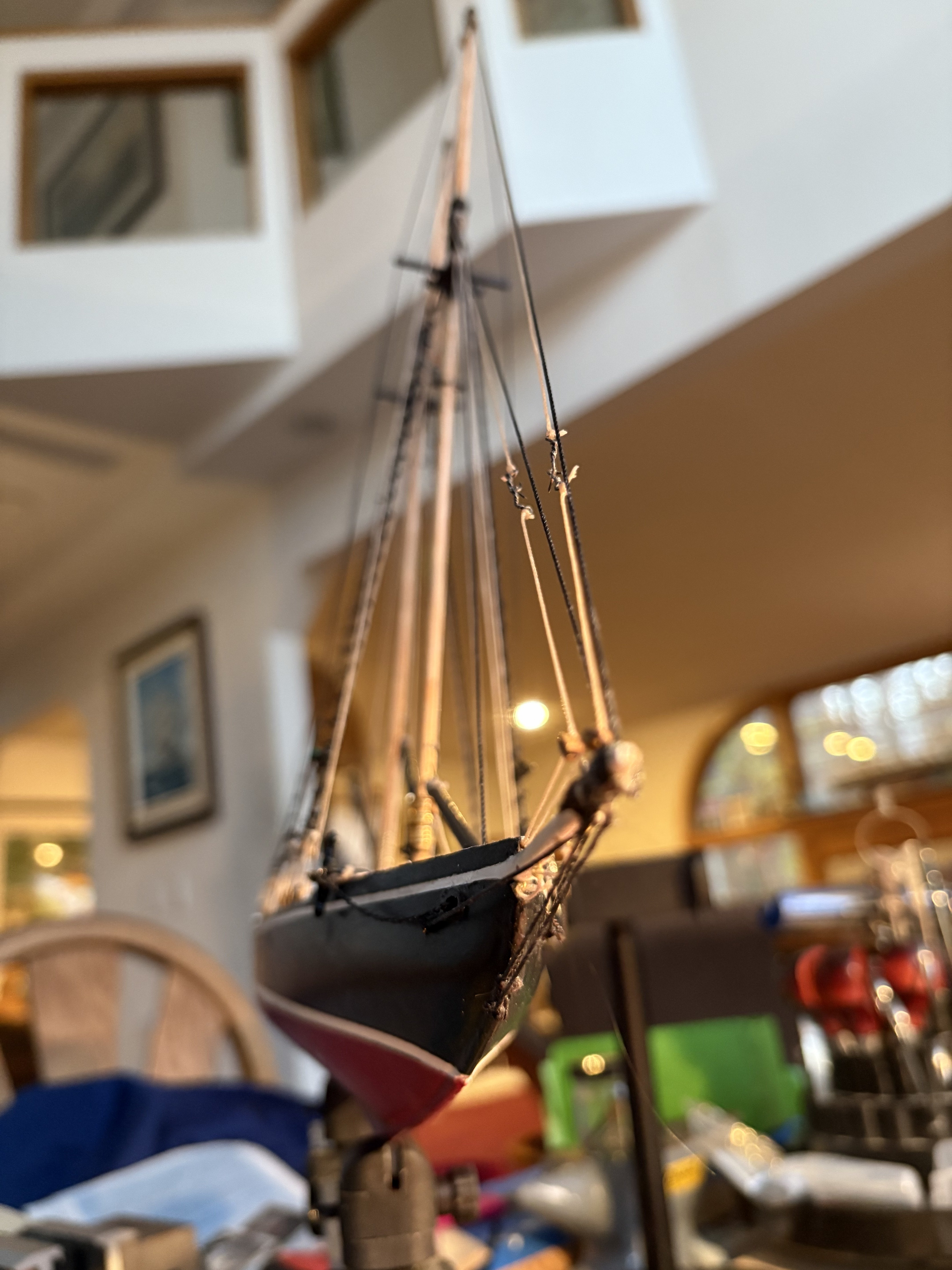

Awesome rigging work to complete your Bluenose, Rick!  Congratulations!
Gregg
Nicely done,  awesome :cheers:

Still need to finish the name board and I think I will display it on a Launchway since it is in standing rigging vs sails.
As Always Best Rick (RVB)
