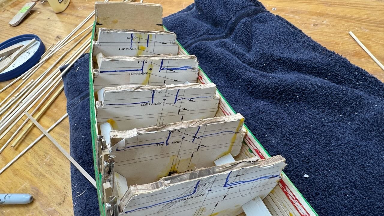

  • The next two images show the keelson drawing rescaled in front of the old kit box.  Not sure what I will use the hull for and all the other stuff all went into general supplies. The stations are all printed out and glued to 4mm plywood.

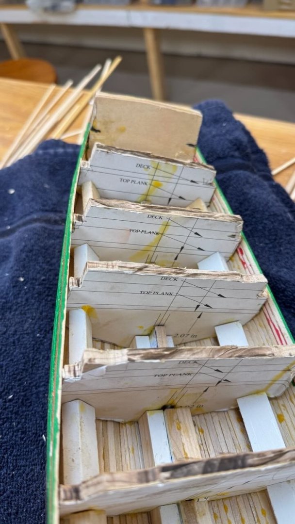

  • The final three images show front or back views of the glued stations and then the overall with the outer blocking supports.
  • GJOA-01FFF_2433.jpg.e8cb9a2d355d9d534d31efdaac4831a8.jpgGJOA-01FFF_2434.jpg.9bf35517e1319f85f6d94ea7907886f0.jpgGJOA-01FFF_2437.jpg.043902733e66d94109e438b7fd9c43b4.jpg

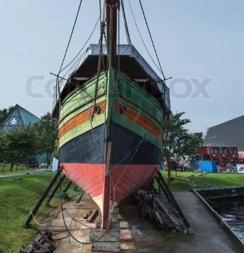

Amazing to think this was a San Francisco landmark for many years albeit before my time.   Such things are so underappreciated outside the local cultural context.  Similar things happened to the cities clock and watch collection, which no longer fit in with the Academy of Sciences desire to teach the fear and hate of technology.  At least that collection is still complete in the national museum in Lancaster PA, but it is a bit difficult to visit.   One has to learn to enjoy such things while available. The Vaillancourt fountain is next on the deacquisition list.
Really need a ♥️ emoji in the likes.   Looking forward to following along on this one.  I like ships with a local connection.
Dear Sheepsail. thanks for your interest.   I think San Francisco has lost a treasure but the whole story of her return to Norway was fun.  And now the Maud recovery from Arctic Canada.....  the beat goes on.

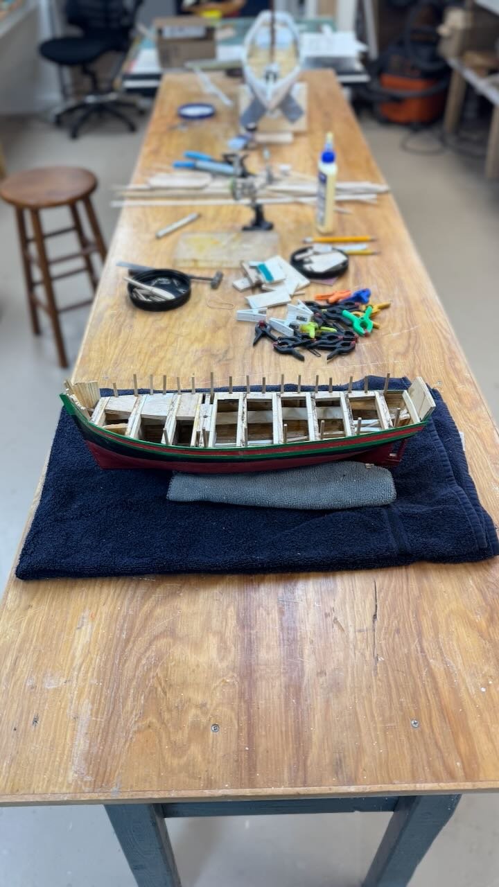

3 partway  through the planks

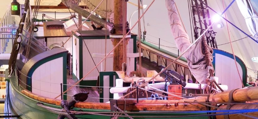

We had a little excitement last month when our annual Northeast Shipmodelers Guild show took place in Bath Me.  We went this year to the shed associated with Maine's First ship.  That is the reconstructed replica of the 1607 Pinnace built here,named Virginia, known to the be first European vessel built in America.
  • Here is their website internet image of her sailing from the shed
  • Gjoa-02IMG_2151.jpeg.bfd9d9cffbffac3c26e444c04f1ecf20.jpegHere is an image of Gjoa sitting with other of my collection at the show inside the shed. The idea was for all of us to bring models being worked on. The audience was lots of fun, some came for the models and others were waiting to go sail on Virgina.
Over the past several weeks I dove into the reading of Amundsen’s diaries of the venture across the top of Canada.  Wow. What incredible people and how, according to Amundsen they all got along so well. Lots of fun sailing tales too.  The gaff seemed to break several times, and the lack of wood was a big impact.  During their third winter they were on a beach loaded with driftwood and the tried to replace it....more on that later.

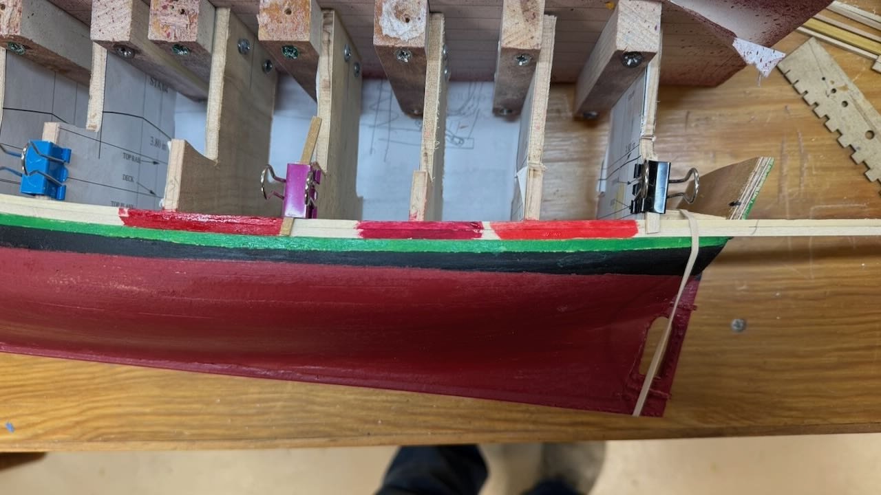

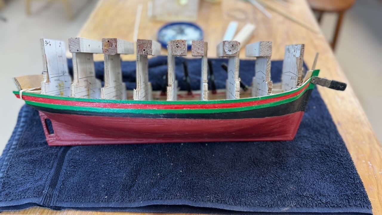

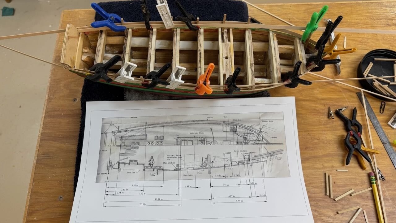

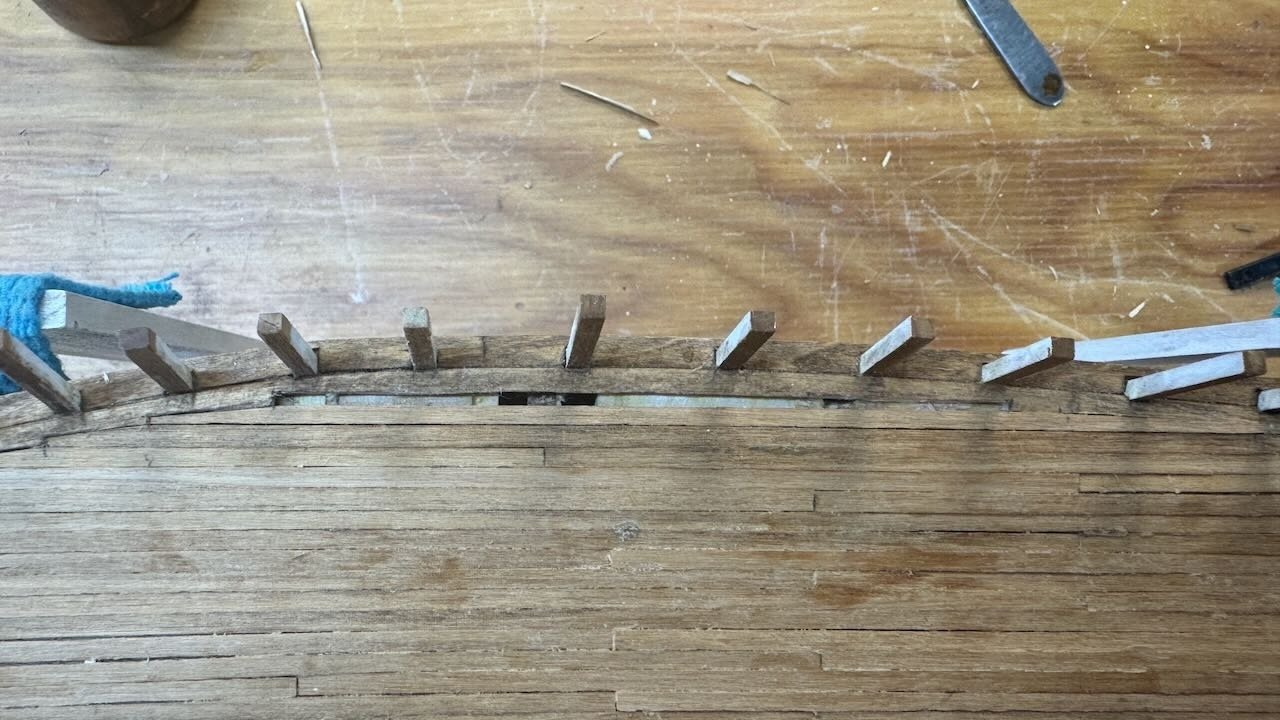

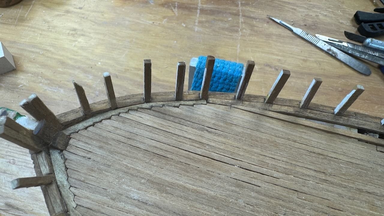

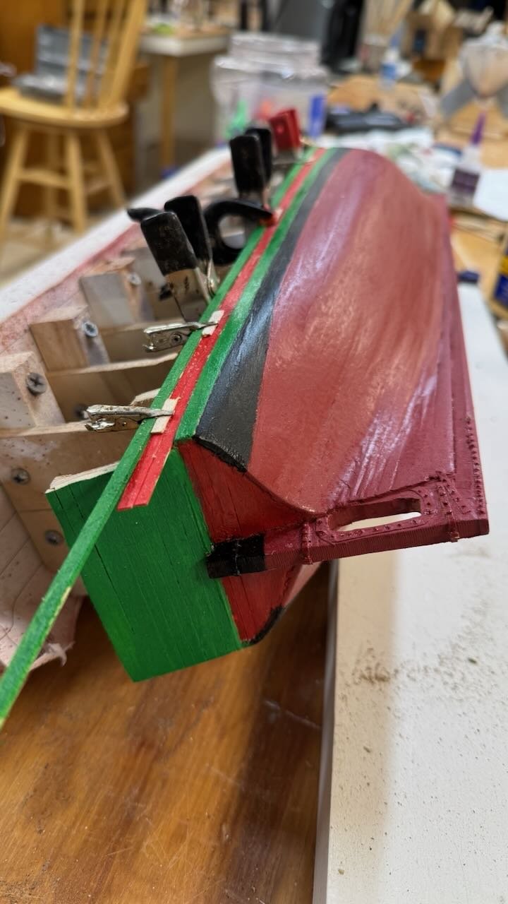

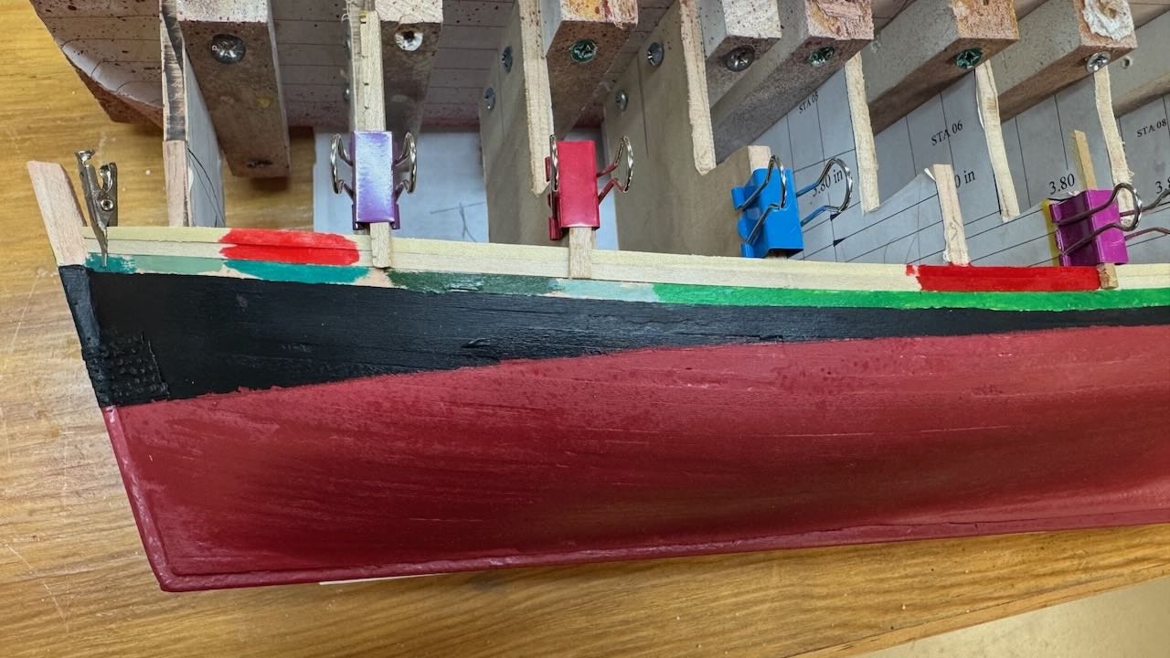

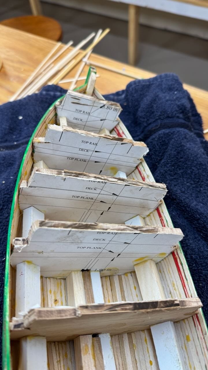

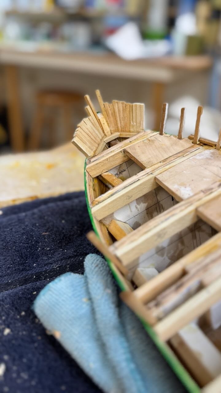

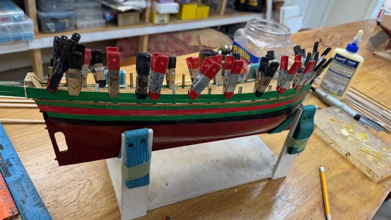

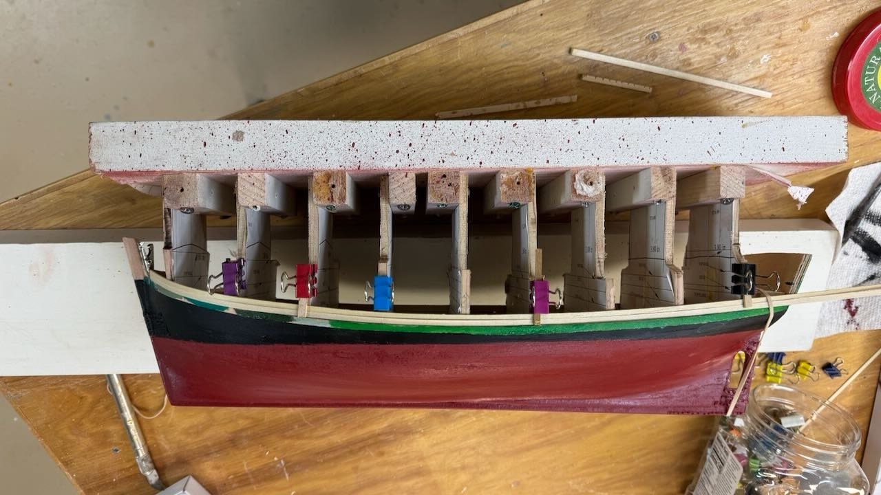

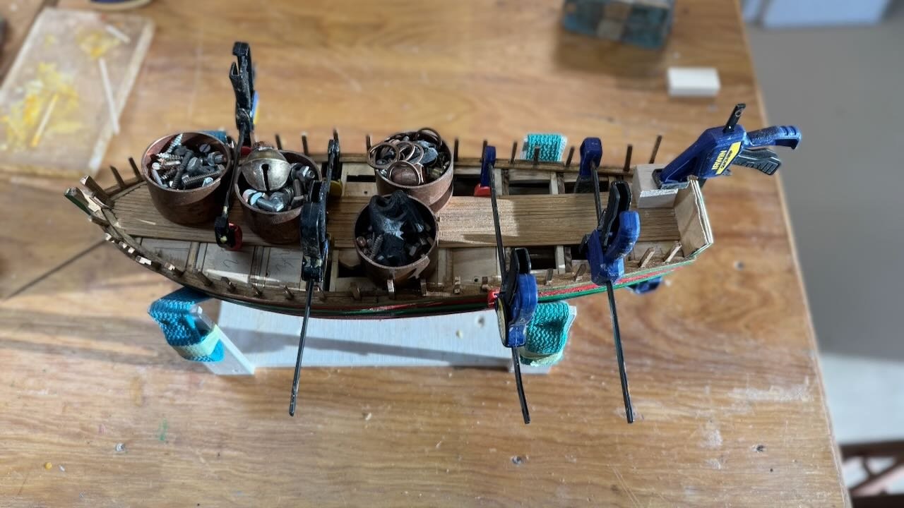

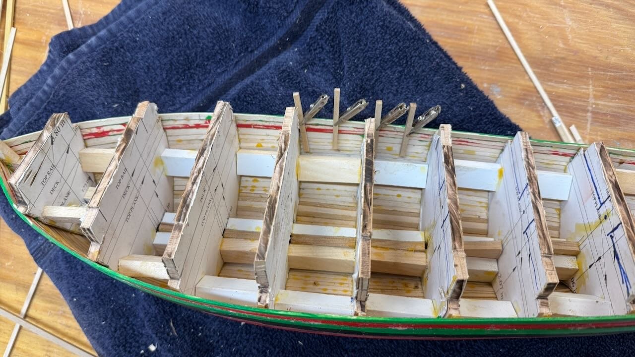

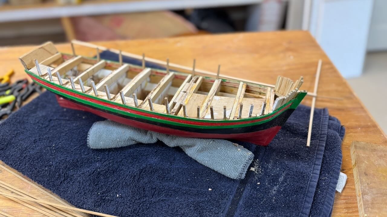

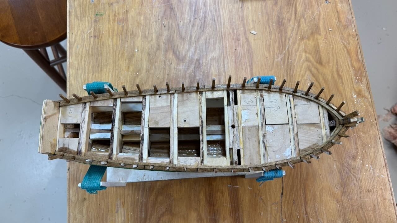

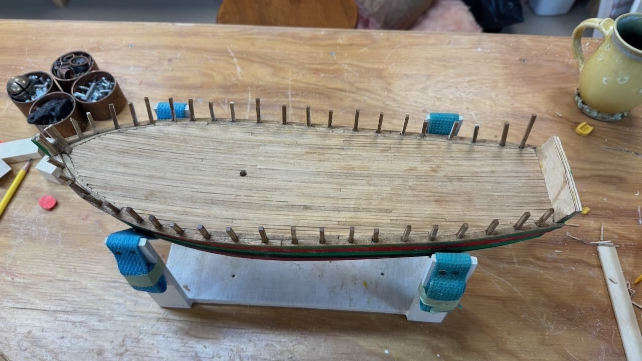

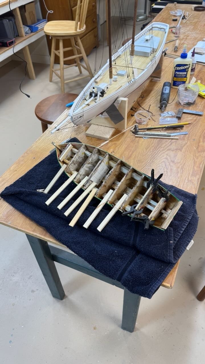

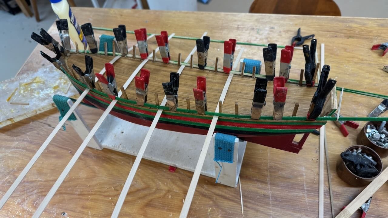

Progress

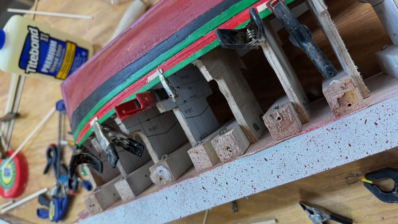

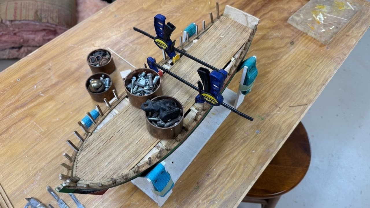

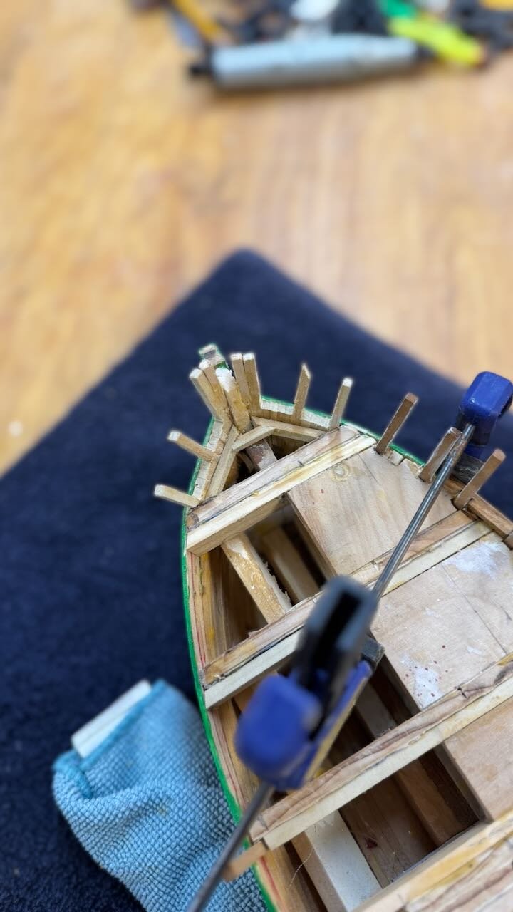

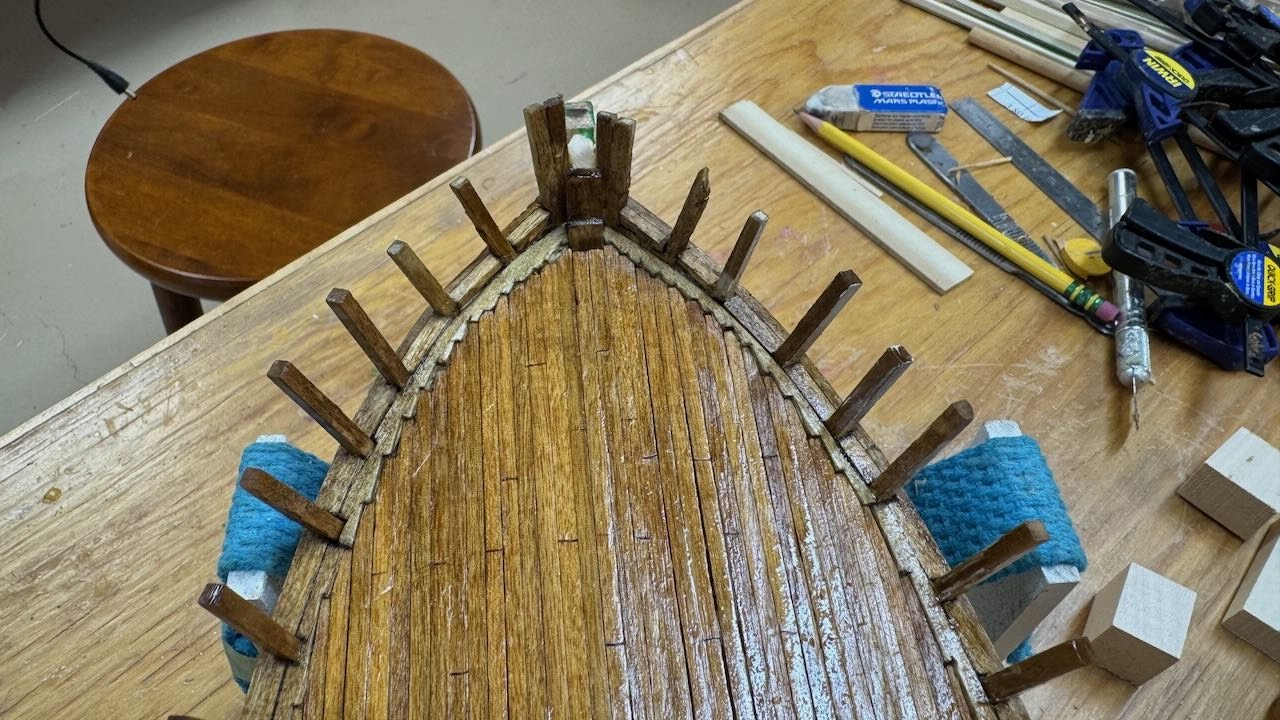

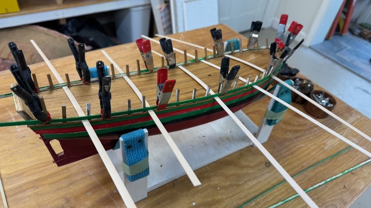

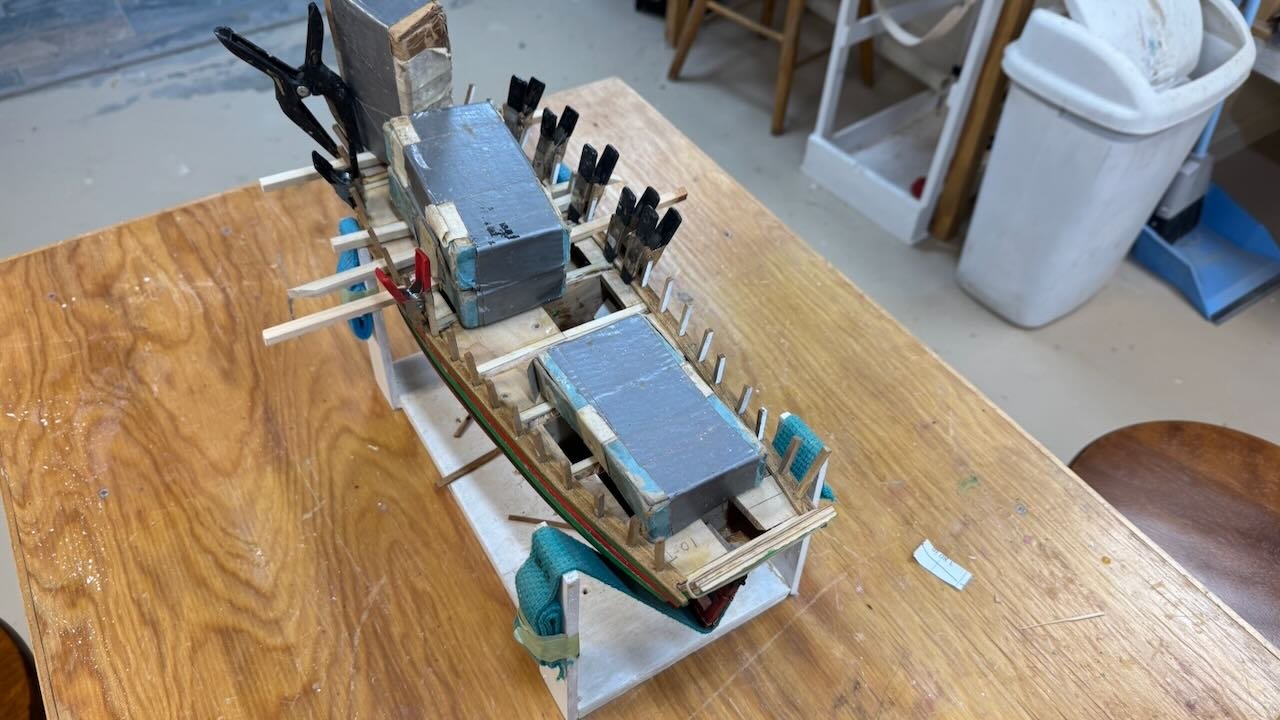

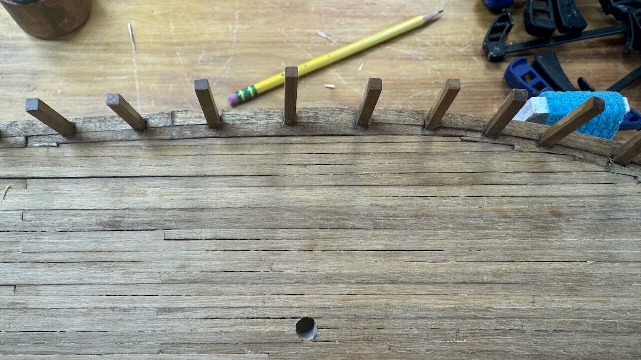

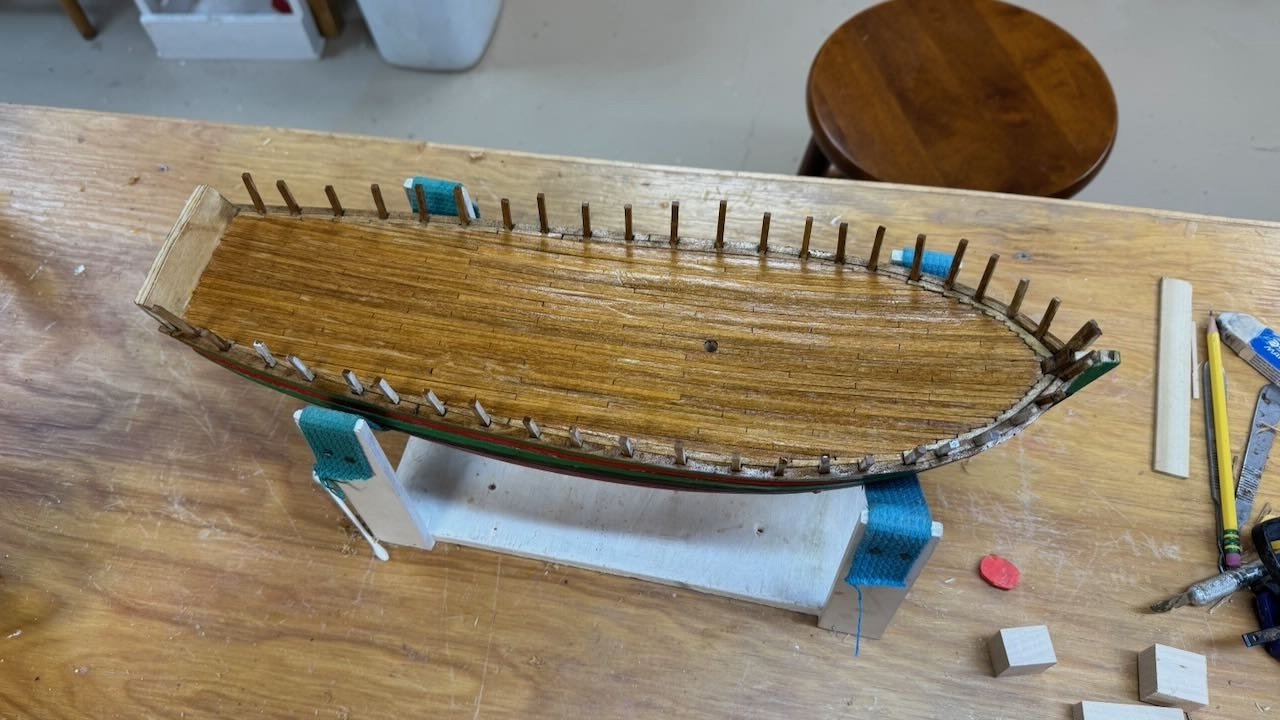

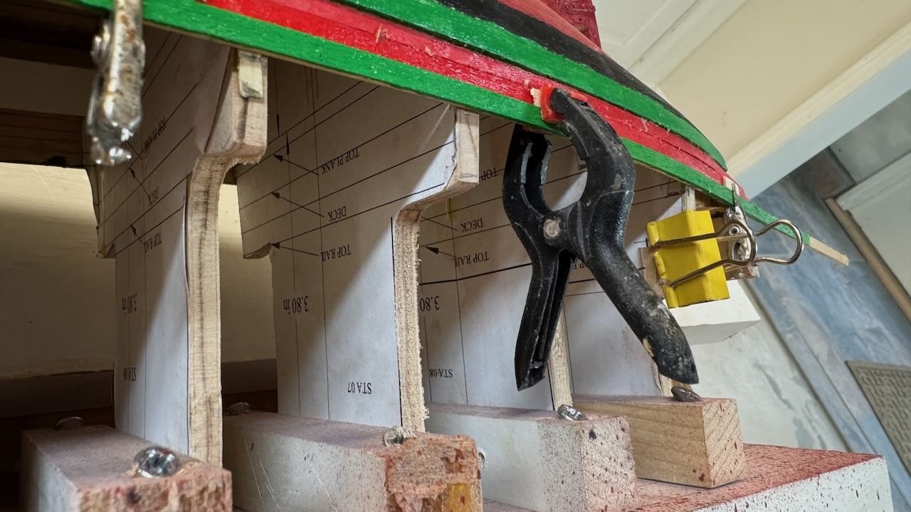

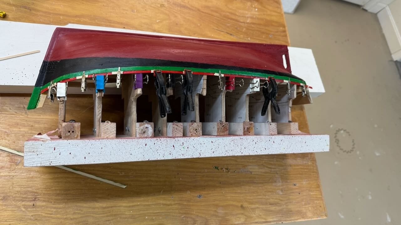

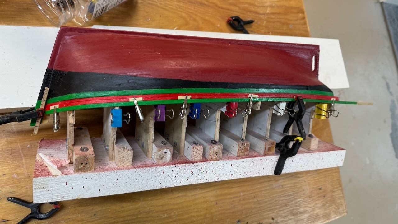

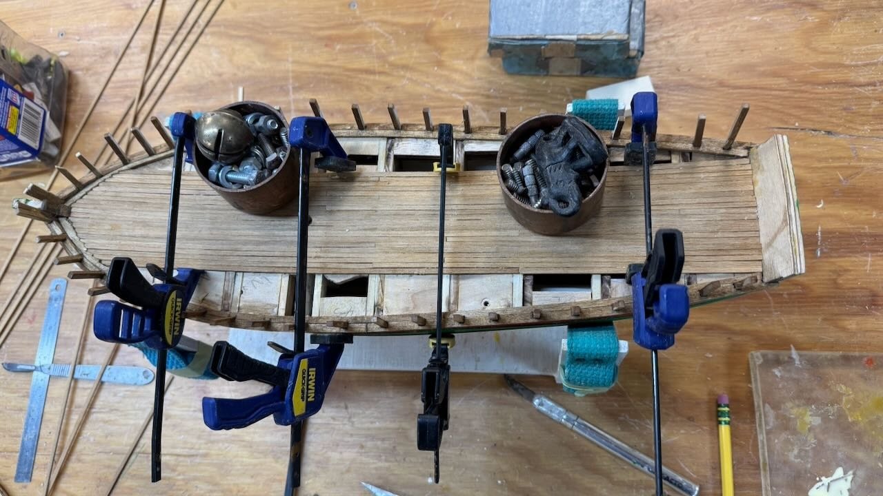

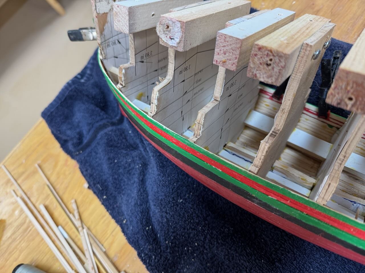

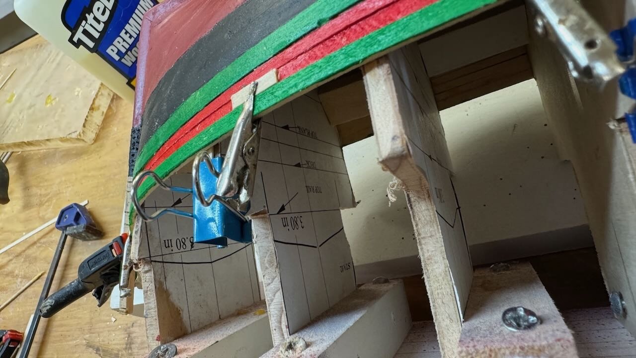

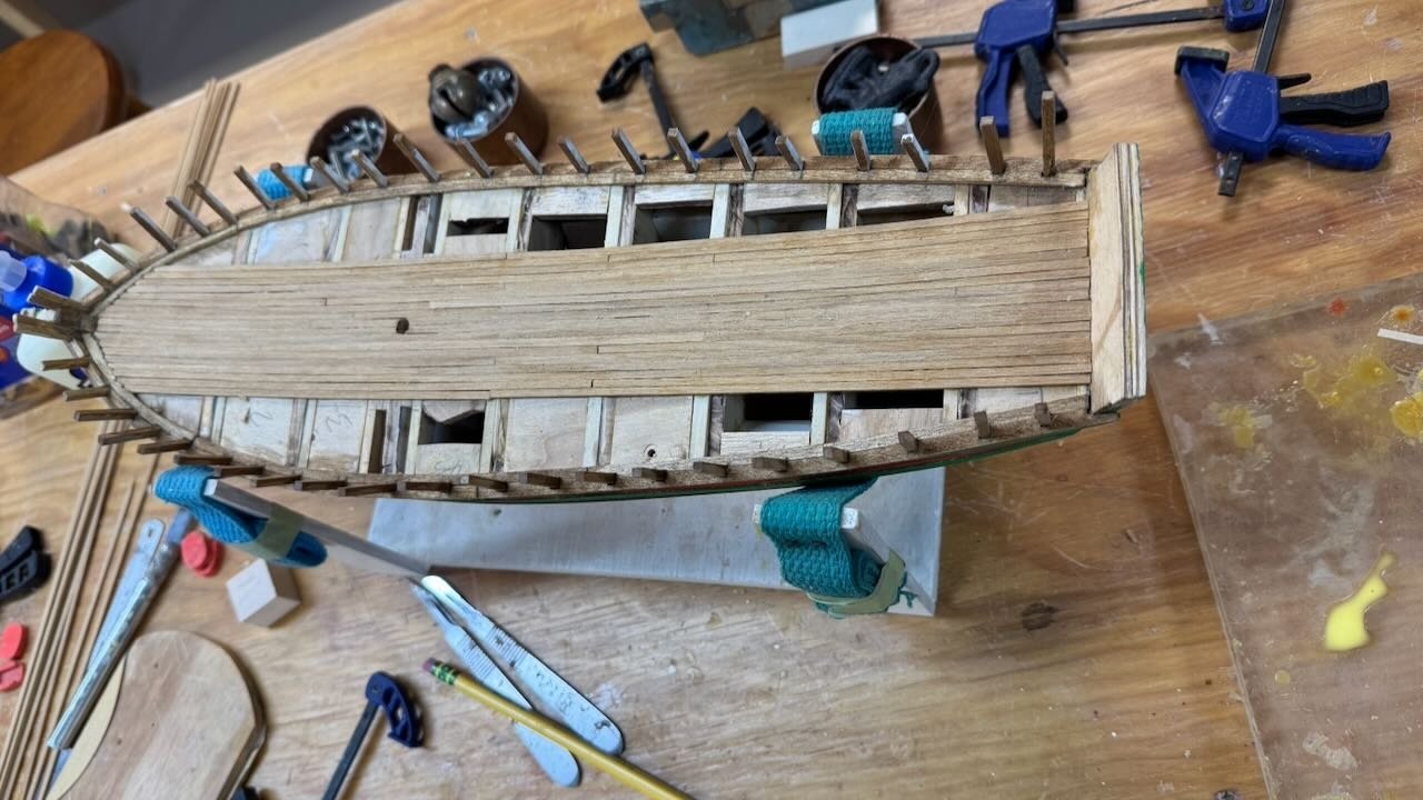

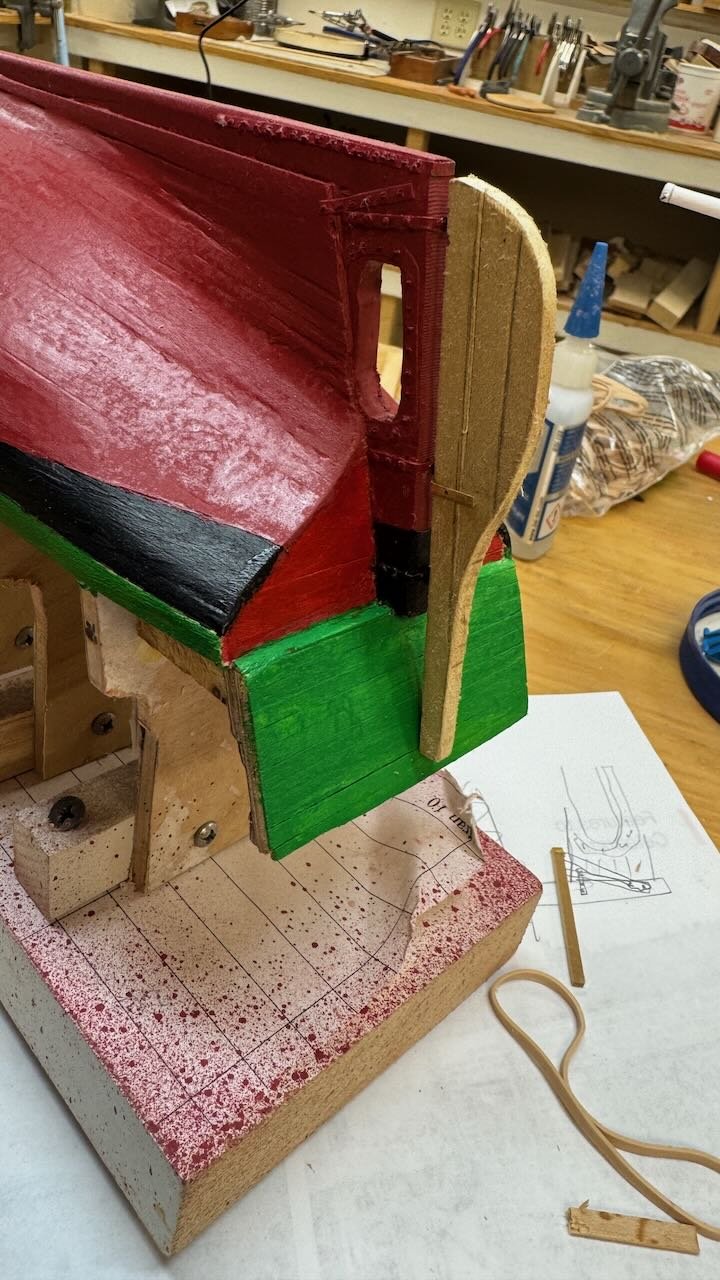

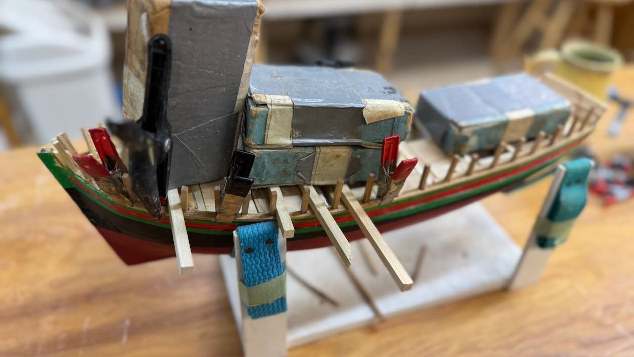

  • The next 7 images are the familiar porcupine type images of early planking and all the finagling we do to fit clamps.
  • Gjoa-02FFF_2444.jpg.0fd2e59485de33462073d8f071b6ddf2.jpgGjoa-02FFF_2443.jpg.fbe61f7fe804feb366ae3006795b85e1.jpgGjoa-02FFF_2442.jpg.3881586fd4ca6595ca85bdd78bab3e4b.jpgGjoa-02FFF_2441.jpg.60ab041707723239f94344015a52ce02.jpgGjoa-02FFF_2440.jpg.2fde35279d5b26eae77fb0b68ab83575.jpgGjoa-02FFF_2439.jpg.38c4de022707fb23735b51224bfd5ef4.jpgGjoa-02FFF_2438.jpg.c0d30b0ec7fe3950b83f74476f5066d7.jpg
  • Here are two images while at a breathing point, when the first two bands are done and planning the tough center ones commences. Since this is a painted hull, I am milling a few types of scrap wood.  most of the planking is cut down bass wood, but a few maple planks are in the stock. Gjoa-02FFF_2448.jpg.497fffe4fcdbeb65f94cb501ca1fa61b.jpgGjoa-02FFF_2447.jpg.75b741d9f671929434bce9a2b4a5cf25.jpg
