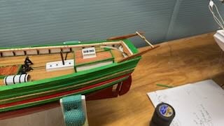

The 4th image shows starting the delicate job to paint the inside of the bulwarks and sides only of the ribs white,
Nice work on the Bulwarks. I like your method of aligning the scuppers. Better than drilling them out, after planking is completed. 👍

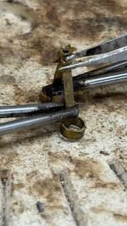

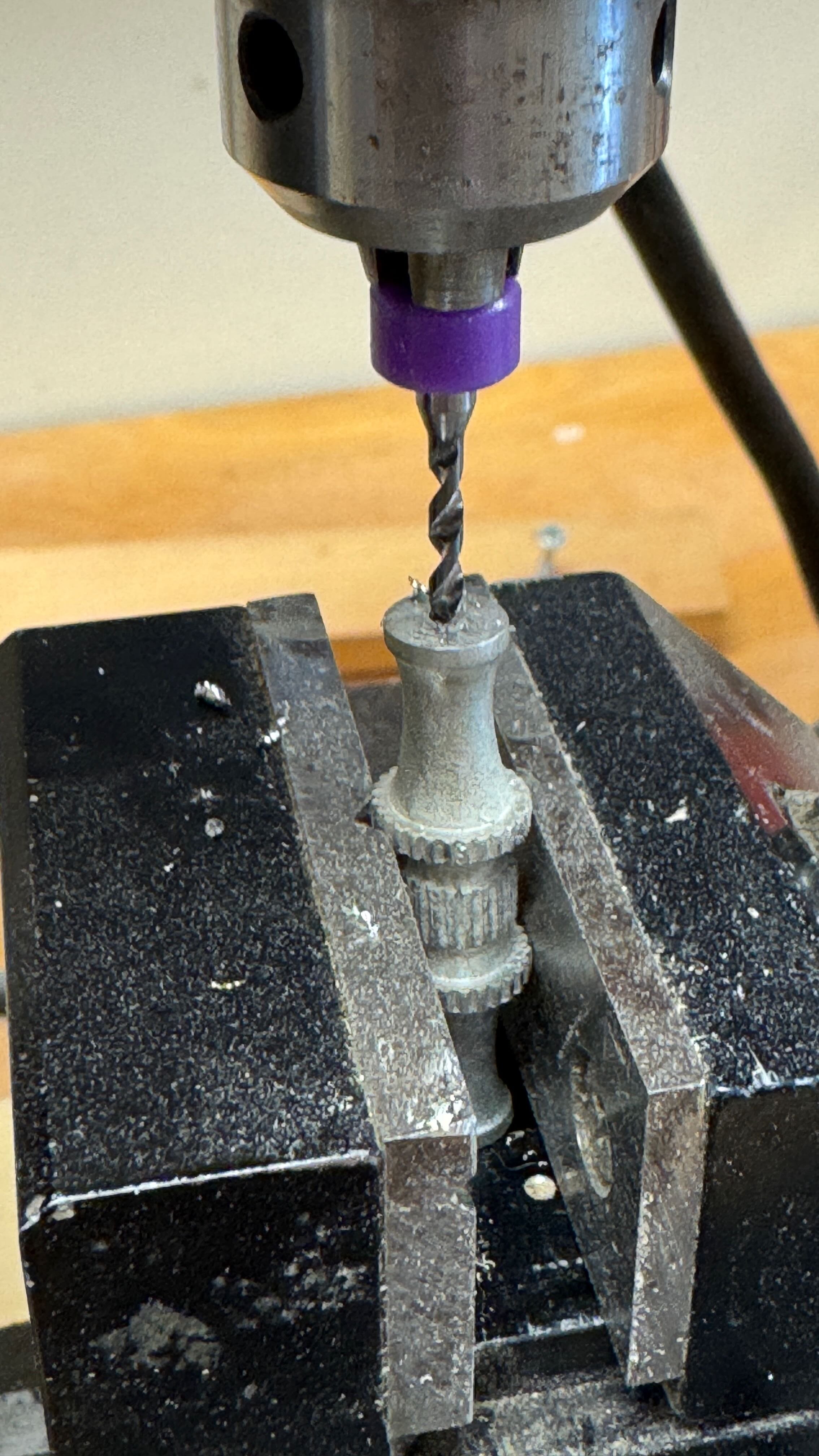

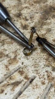

  • 1-4. these four view show getting replacement drill bits, so I can complete the last pintel, and the laying out of the tiller by scaling a drawing.  I have a few sheets of pear wood that are great for this type of detail work. The third and forth view show installation and  the trimmed-out transom. I keep learning the hard way how critical it is to stabilize things like brass strips when drilling tiny holes.  I have broken many drill bits.

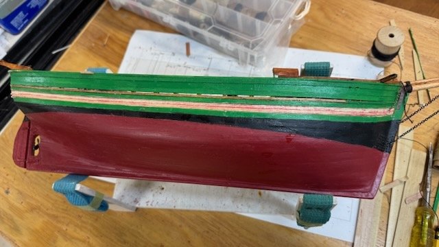

8 complete rails and plan deck work
Thank you everyone for your likes.  It helps keep the fire burning.  This is a partial update to record completion of the cap rails and this phase…. “ the hull”  .  It’s kind of like topping out of a building.  I suppose i could get a miniature Xmas tree and set it on the rail.   I had a nice glass of Single malt and now we move on...
  • 1,2,3 these images show the completion of the cap rails.  It was pretty straight forward, as I used the rest of the milled poplar and cut out three sections for each side.

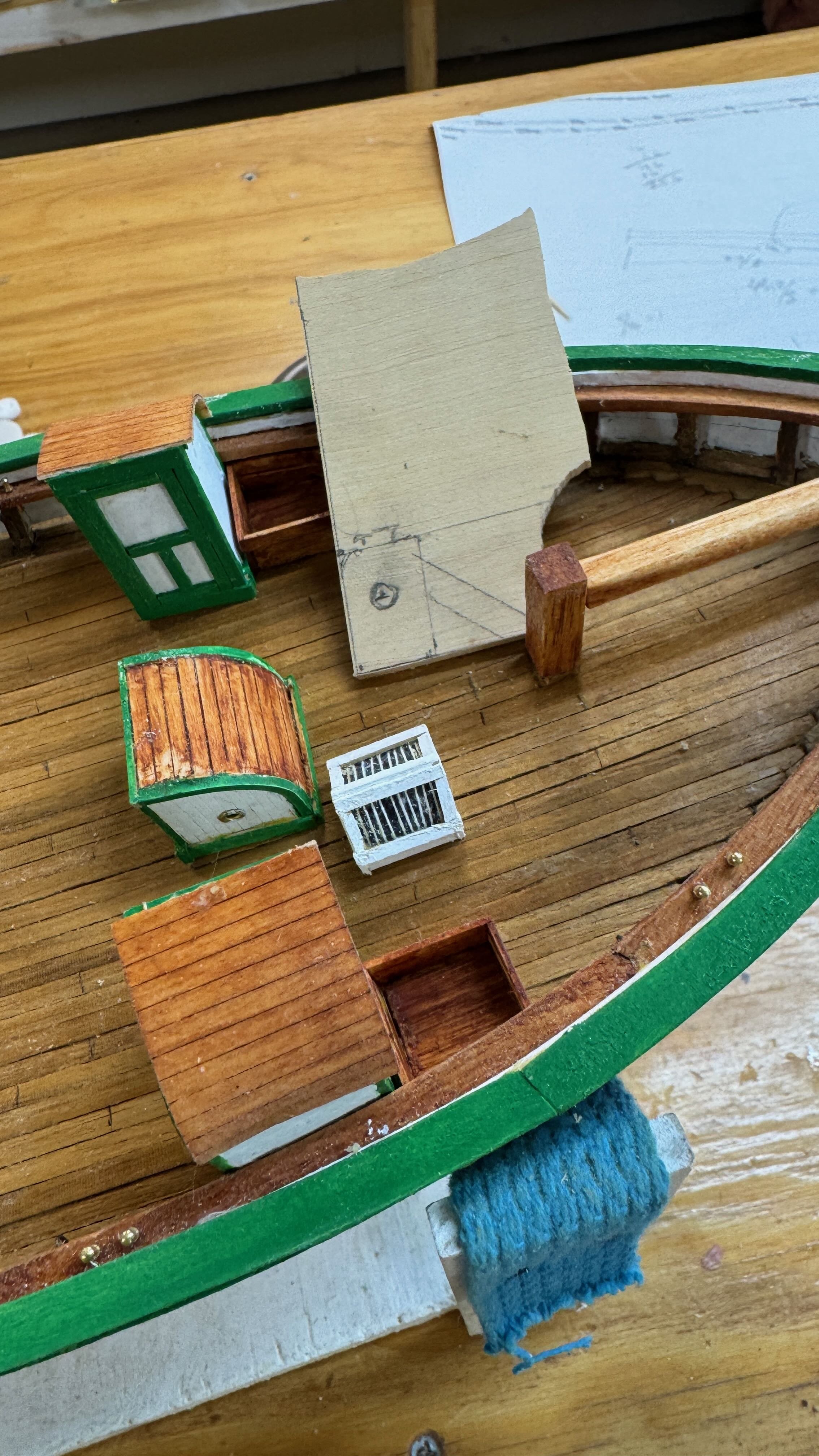

  • 4 I scaled the 1950 Model Shipway deck plan using TurboCad then cut it out to lay on deck. I then used light pencil lines to mark where things will go. I then will be using this plan and the long cross section to get dimensions.
  • 5,6,7 these views show the progression of making up blocks to represent the stationary element.  Some of these I will trim down build back up with cladding.
  • Gjoa-08IMG_2416.jpg.3ce6e71f21ad6c7445077cbae41751c9.jpgGjoa-08IMG_2418.jpg.a29aef74a8aaad1764d7b6273154fe39.jpgGjoa-08IMG_2417.jpg.065ebb569811d7a547ed06d4a7da9368.jpg
  • 8-9 are just further along as the cap rail is now all painted and the 10 stationary deck pieces are laid out with some early shaping. I see in the photo I have a few more of the iron brackets to add in as supports for the shelves too. I need to get them done before setting any deck stuff.  None of this first phase includes the mechanical equipment.  That is a tough phase to follow as I quickly leave my comfort zone trying to make chains to actually fit on wheels etc.  I am thinking about it though as I look for material.

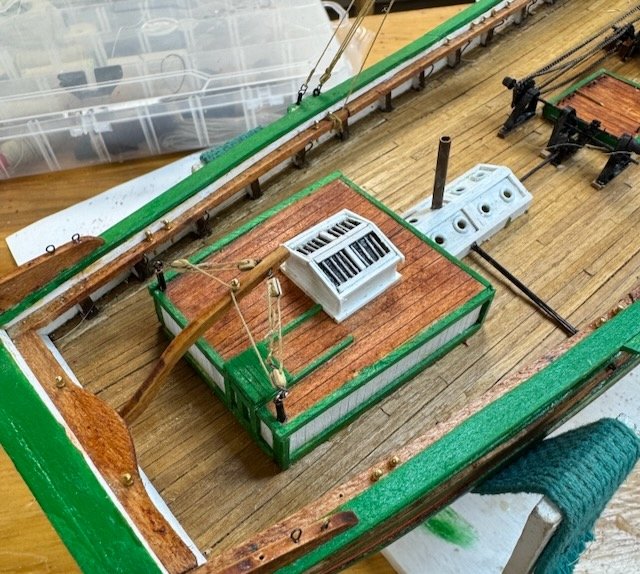

  • 1. I counted ten main deck stationary items including the skylights, and here 8 of them are almost ready to glue down.

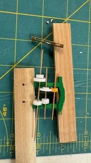

  • 2 ,3,4.   these three views show my experimental approach to make then main windless out of paper, a tiny wood dowel and plastic gears sanded down to size.  The two deck brackets holding the shaft coming forward from the engine room. I switched to brass.
  • Gjoa-09IMG_2444.thumb.jpeg.59066faf379a57bb818418ff77559d94.jpegGjoa-09IMG_2445.thumb.jpeg.431bc593339662b000d1a92239a300c4.jpegGjoa-09IMG_2446.thumb.jpeg.dfa4355a9edb273597586a293bb7bce7.jpeg

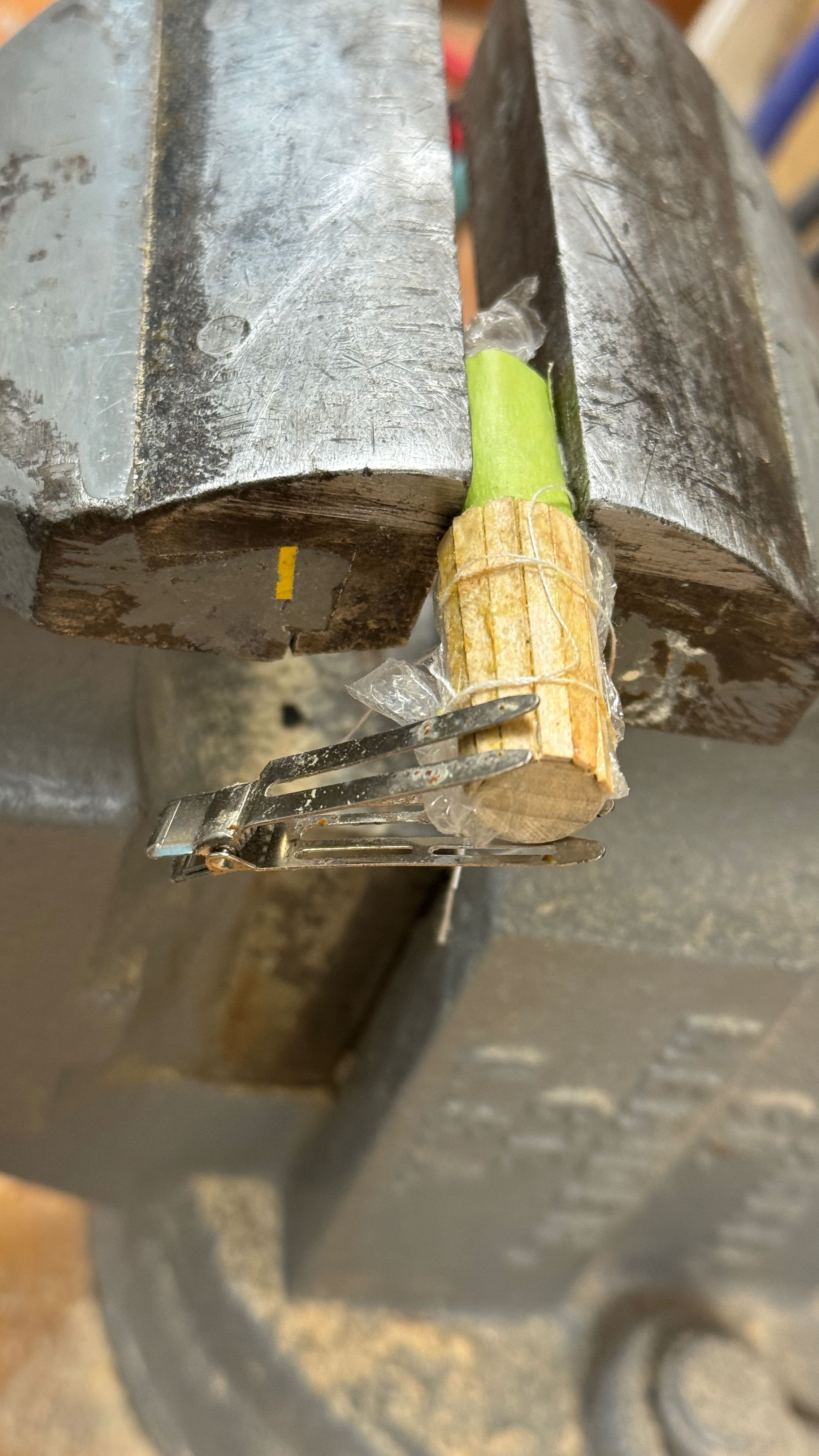

  • 5  I am using the old thread trick to try to simulate iron rods for the forward skylight.  I used pins on the aft cabin skylight.  We’ll see if It works here.

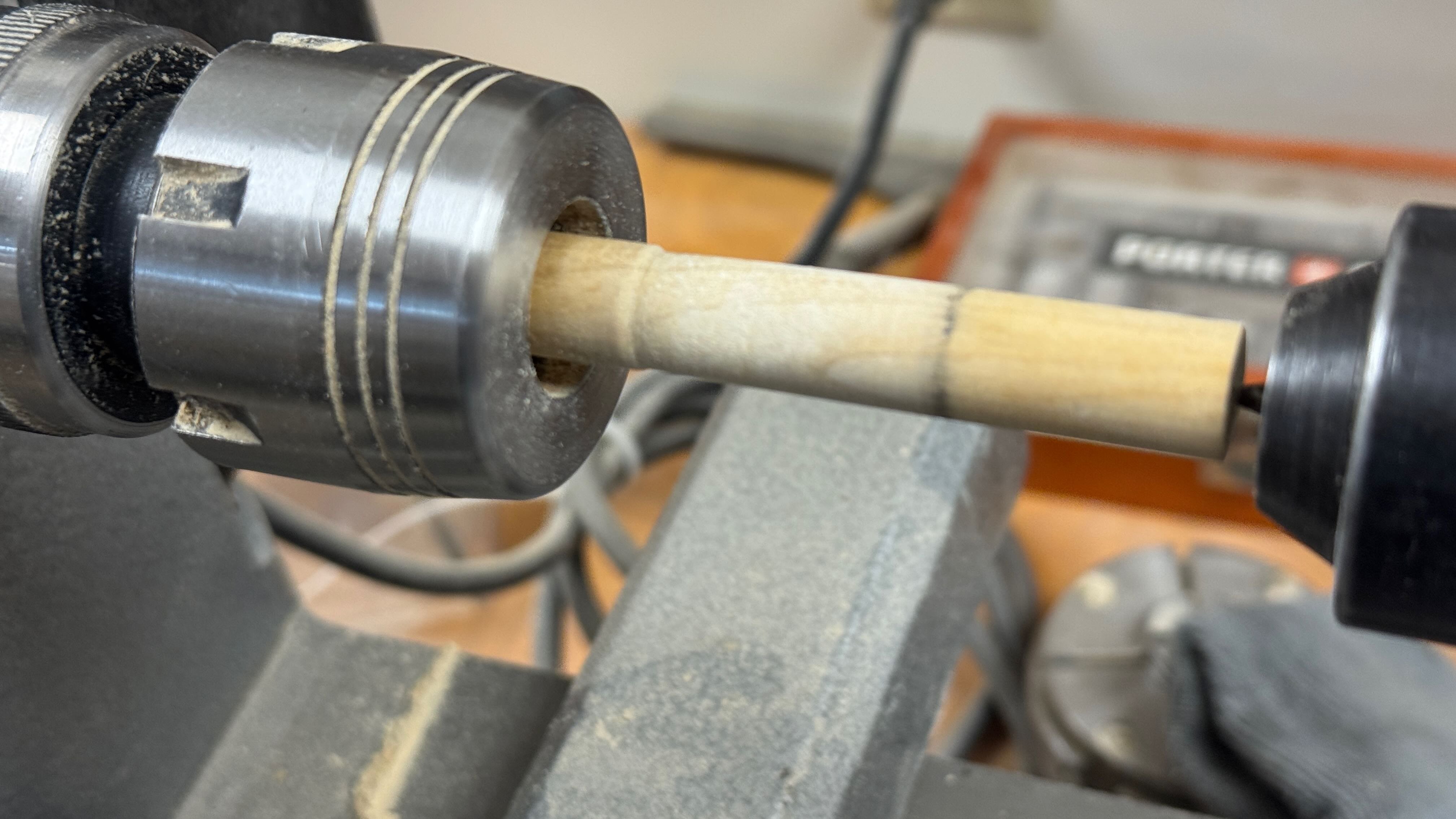

  • 7-9. here I show my rube Goldberg method of using my midi lathe to sand down to shape a mast that is longer than it.  The railroad rail anvil is a family heirloom. I then stepped the rough mast just to take a look.  It is shown to be absolutely plum in the drawings, so here we go.  The last closer view shows the pumps going in and the bow sprit in place.
  • Gjoa-09IMG_2450.thumb.jpeg.100d5b33aa6b945184ca0e3a66332b43.jpegGjoa-09IMG_2454.thumb.jpeg.eb23841c387b2dcc1a387906a979ae8a.jpegGjoa-09IMG_2455.thumb.jpeg.4691feeb540179cf095156ff20be50c7.jpeg
There is still much to do here, and I am unsure of the mechanics of the rest of the deck workings. I a using the drawing section which is reasonable, and I will do my best but remain unsure as the photos are not complete and the system is not like our new England set up.   It is fun to learn though

I have used similar setups  making masts with Sitka spruce up to almost 3 feet.  However masts or other spars over about 15 inches only come up from time to time and I somehow get through the challenge.  A more worrisome issue is the Norwegian rigging come straight at me.....Thanks to Harvey I just got a rigging book written by a Swede that looks like a whole new rabbit hole to descend.  We'll see how that goes.
cheers

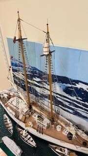

Before sharing progress. I want to share a news clipping I received just recently. A local retired Shipwright passed away and donated his library to the local library book shop. The volunteer there helps us at the historical society, She knows I am doing a multiyear study of our shipyards as well as the study of the Northwest passage and other related stories.  She showed me this clipping knowing it would fascinate me and here we are.
The online record states that the San Francisco park had suspended the repairs to Gjoa in 1939 but resumed them after the war, and completed the effort in 1949.  The clipping here is from 1957 and has a great photo of the deck.  This image agrees with a one other [ I posted it earlier] and I have followed it. The forward anchor windless assembly is black and the mid or Main windless is dark here, and green in a museum image.  So along with the enjoyment of hearing about unsuccessful engine pirates, we gain a tid bit of info to either use or not  I understand today much more of what is on board seems to be white. There are not however comprehensive images I have found and for a few issues, I hope to be more successful. Specially how did they rig the tillar?

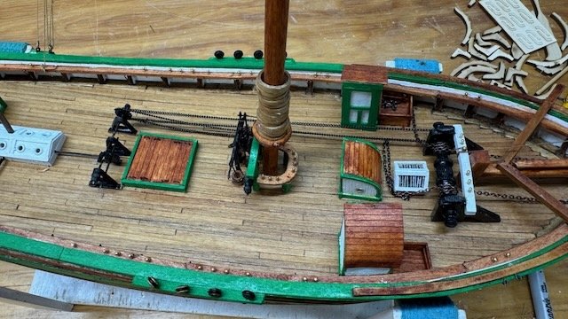

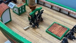

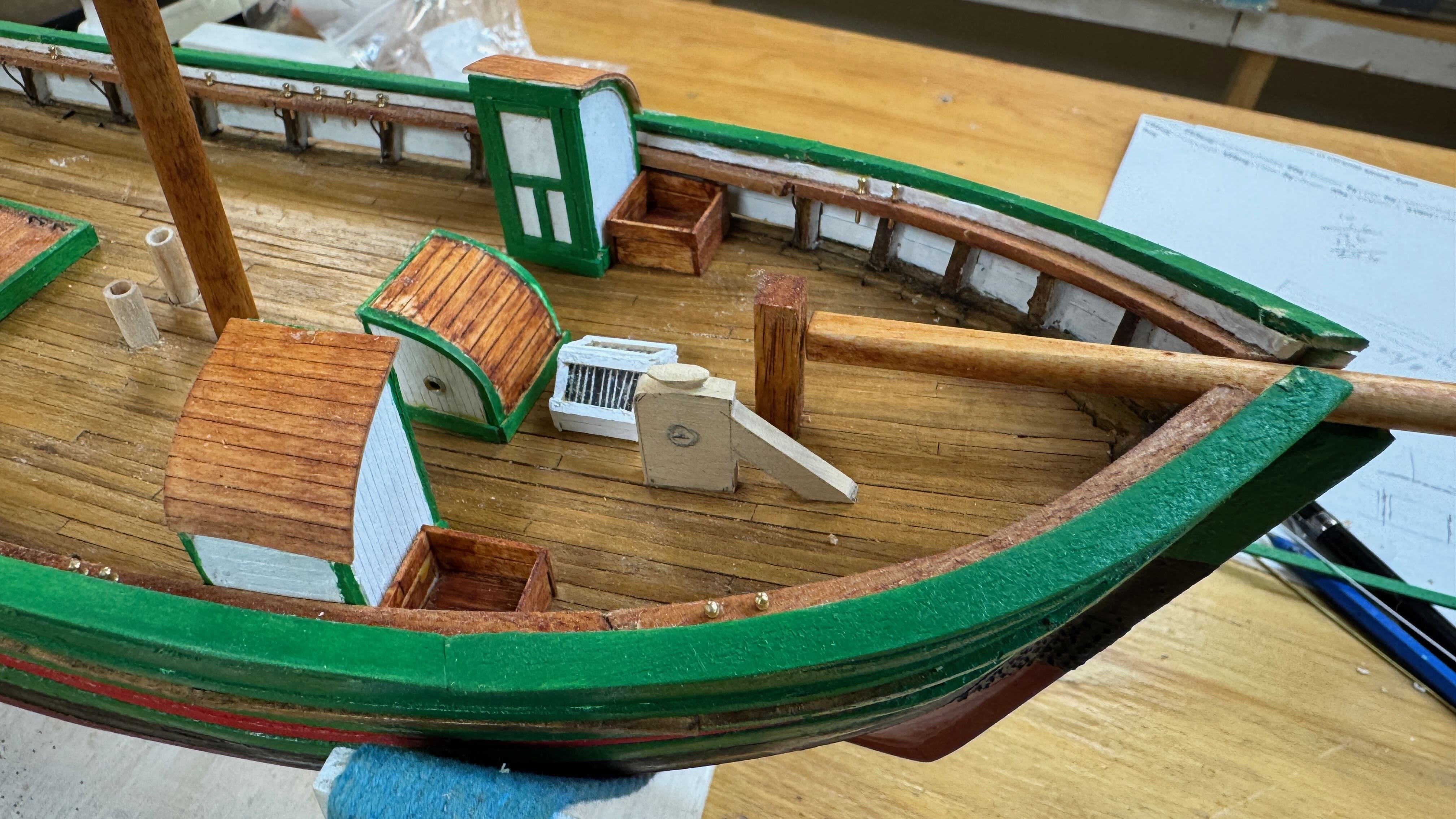

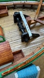

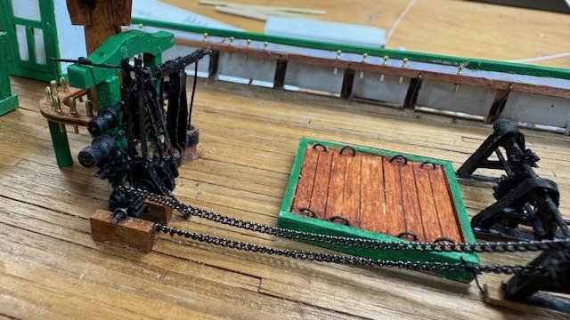

This partial update is to cover some of the fiddling to get the deck furniture done. When scratch building, we get to rummage through our stash of unused stuff.  Either unused kit material or surplus buying that now fills many plastic tubs. We also get to build stuff, and it can be a real learning curve.
A.    First up the anchor windless.

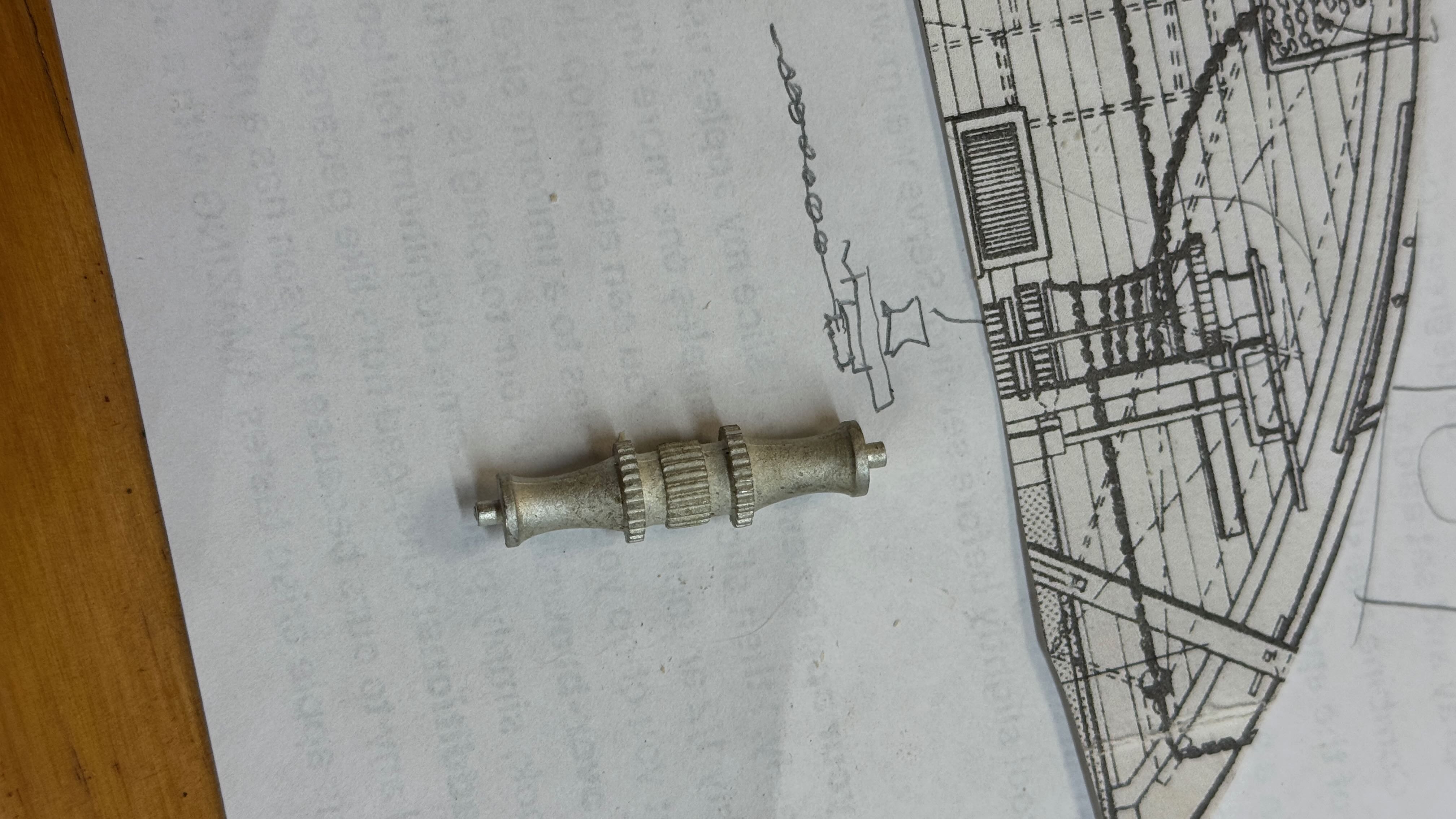

  • 1 -2 here I have taken an unused kit supplied windless that will need to be extended both for winches and gears for the drive chains.  In view 2 I  drilled holes for short extension shafts.
  • Gjoa-1001IMG_2438.thumb.jpeg.243df6a8cf6fd6e4aeee761738eef6f6.jpegGjoa-1002IMG_2439.thumb.jpeg.5ff9715b02570053d8c89cdaabc8f1d6.jpeg
  • 3-4. here I am used sheet pear wood to make up the windless stands.
  • Gjoa-1003MG_2480.thumb.jpeg.98653abc5725cd82736017c55f451cd2.jpegGjoa-1004IMG_2483.thumb.jpeg.b45dbd4e0befa292ccd25254e5f64e47.jpeg

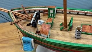

  • 5 and here we are finally set in place. I do openly admit the diameter of the barrels is a bit undersized, sorry……

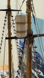

Ice Barrel....[ crows nest]
I have a question that I plan to ask Harvey….if the ice barrel is suspended as it is shown on the drawings all by itself.  I assume hung on some of those many mast rings. However, I ask……, with no extended climbing means, how did the crew get there if the wind and sea are a mess?
  • 6-7 show two images of the ice barrel on the schooner Bowdoin.  It sits on a spreader, and the ratline takes you right there.  Just a comparison and the basis of my rhetorical question.
  • Gjoa-1006IMG_2486.jpeg.00632e1bb7a44258b61b1f358f8545b2.jpegGjoa-1007IMG_2487.jpeg.3031fcfd8ce4d0ae50cfdd5fbb60d96d.jpeg

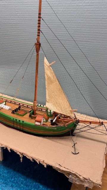

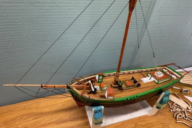

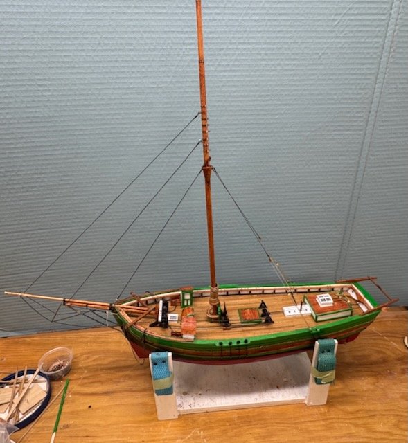

  • 10-11.  here is an overall view showing the anchors and some progress on the bowsprit. The second view shows the anchor winch with chain leading to the boxes and ice bucket sitting on the deck waiting for me to figure out how to attach it to the mast. The main winch pieces are waiting to be assembled with the pumps too.
  • Gjoa-1010IMG_2522.jpeg.e757270fa95b965b5071e41e70606391.jpegGjoa-1011IMG_2523.jpeg.4aa9f87f110bcbc4365bd94026e8d786.jpeg

Ice Bucket
I have a question that I plan to ask Harvey….if the ice bucket is suspended as it is shown on the drawings all by itself.  I assume hung on some of those many mast rings. However, I ask……, with no extended climbing means, how did the crew get there if the wind and sea are a mess?
Hi Jond!  I wondered the same about the crow's nest-- I'd never heard the term "ice bucket" before, but I like it!  It appears (on the old Model Shipways Plans?) that it had a 'Jacob's Ladder' (rope, with wooden rungs).  I still haven't found out whether or not there was a hatch in the floor of the ice bucket, or if one went over the top to get in-- the rope ladder seems to just go up to the bottom of the bucket, so probably it had a hatch floor?  Hope this helps, and hope someone who knows will chime in.
Best, Harvey
My bad....I should have written" Ice Barrel". not bucket.  Here is a picture from the biography of Donald MacMillan who went with Peary to the North pole and then led his own expeditions from 1910 to 1954. He designed and built the Schooner Bowdoin right here in our town , so I am quite prejudiced.    Bob Bartlett was with him too with Peary and again sailing Ernestina Morrissey. Their name for the barrel is what I latched onto a few years back.  Here is a photo from his book with the caption.  More important is to understand the ease of entry.  All the peak halyard blocks and lines are behind the mast making it easy to both hold on and climb in over the top. getting to the spreader is no big deal.  Perhaps when I get there I will find the same logic.
I don't argue the idea of a trap door, it just doesn't seem safe. Think of the thick gloves/mittens and bulky clothes being worn while climbing or worse descending. what is there inside to stand on while the hatch is open?  etc.   I am totally guessing at this point but would image the Jacob ladder SHOULD have gone to the top....😁.  I'll wait till I get to the halyard rigging.  I probably just leave it a mystery.
  cheers

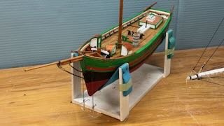

10b more on deck…not done yet

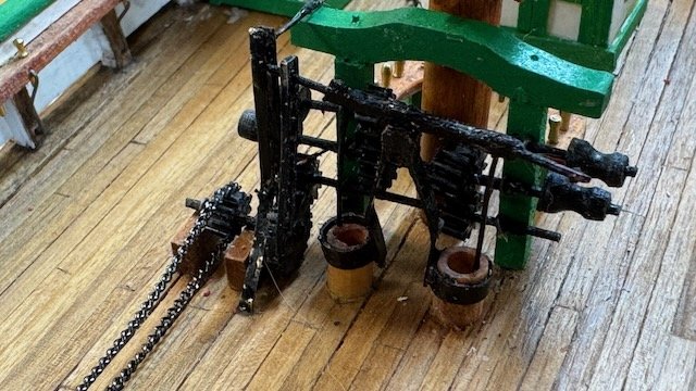

There really is a lot to do here on deck, so I better do an update.  We also had another critique at the local Modeler’s guild. Pumps and the fife rail/ winches at the main mast:  This area is truly a challenge to both understand and then to model.  I still don’t think I have it right, but at some point, we need to move on. The photos, thanks to Harvey’s log, of the real deal and added annotations help but they don’t answer it all.  I am still working away, so maybe a light bulb will turn on, we’ll see.

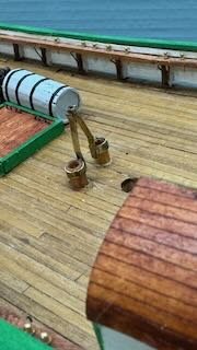

  • 1-3 is my low tech soldering to build the pumps and the “fulcrum”
  • Gjoa-10b-01IMG_2516.jpeg.47c32bbc6b71c58242613d126cb407c8.jpegGjoa-10b-02IMG_2517.jpeg.eaf4c86bd5f9960dcf647735350e1dac.jpegGjoa-10b-03IMG_2518.jpeg.31fdb6bffb8f9fc780979c15e4475586.jpeg

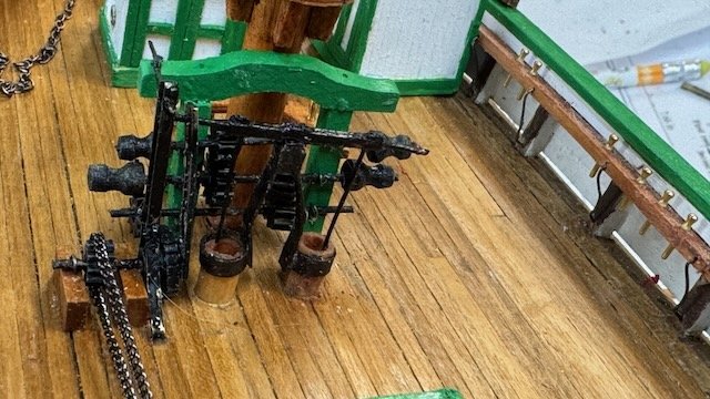

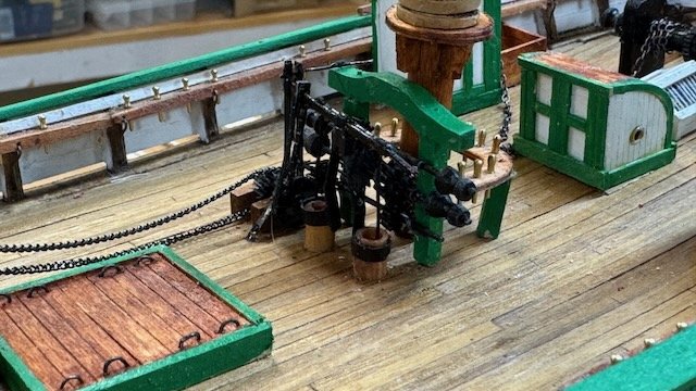

  • 4 5 shows building up of the central winches.  The issue I have here is that the three shafts all need to be driven I believe by one chain.  Then I assume they have clutches to engage the winches.   The pump and winch shafts don’t line up and I see no interconnecting way it all works……more in next post as I sort out what I am doing. Now it is a work in progress.
  • Gjoa-10b-04IMG_2542.jpeg.b6556d656ff5238b3ac31e1cbf26666e.jpegGjoa-10b-05IMG_2548.jpeg.91a80747cbbcca235f3819cf749f4bbb.jpeg

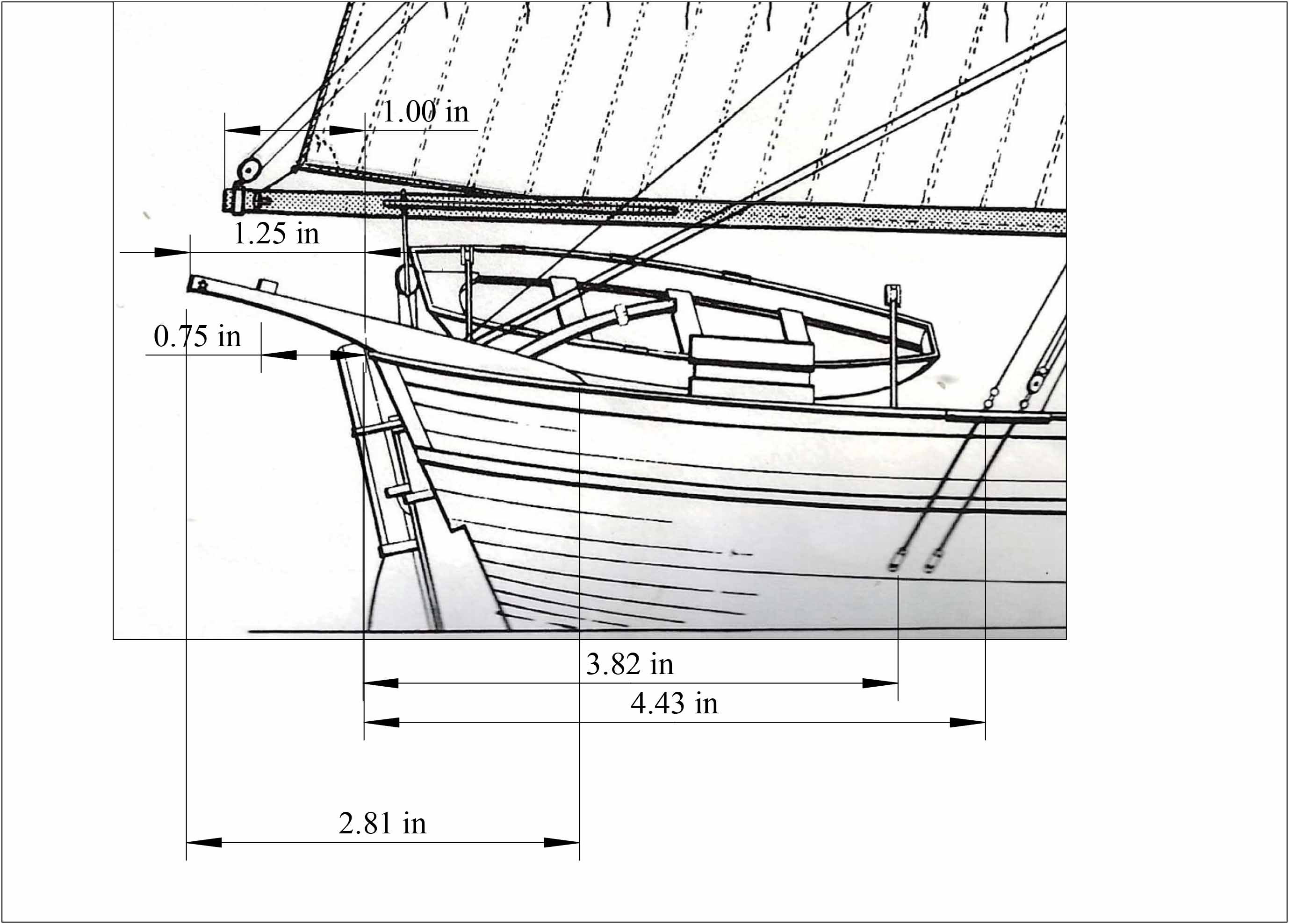

The stern area:

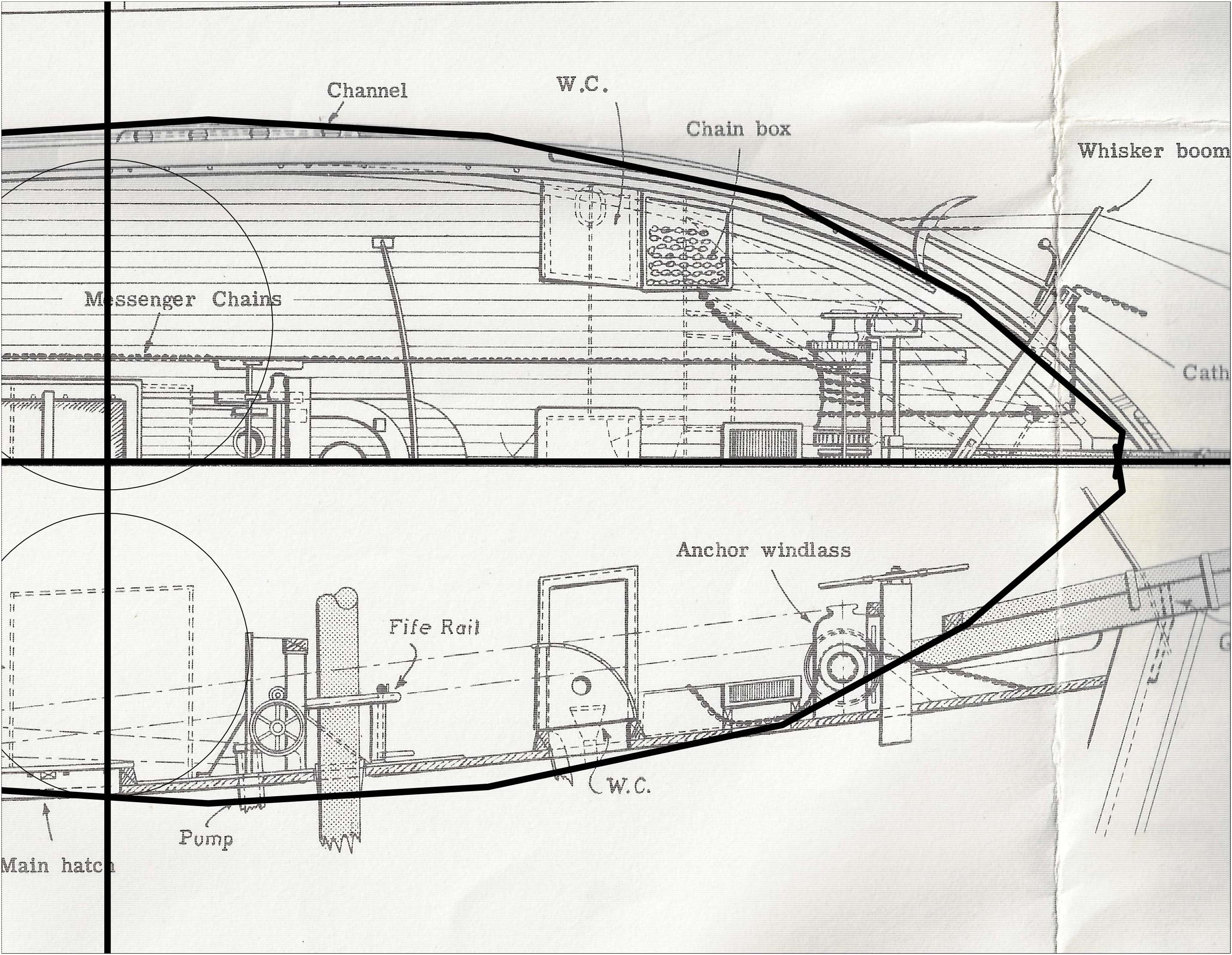

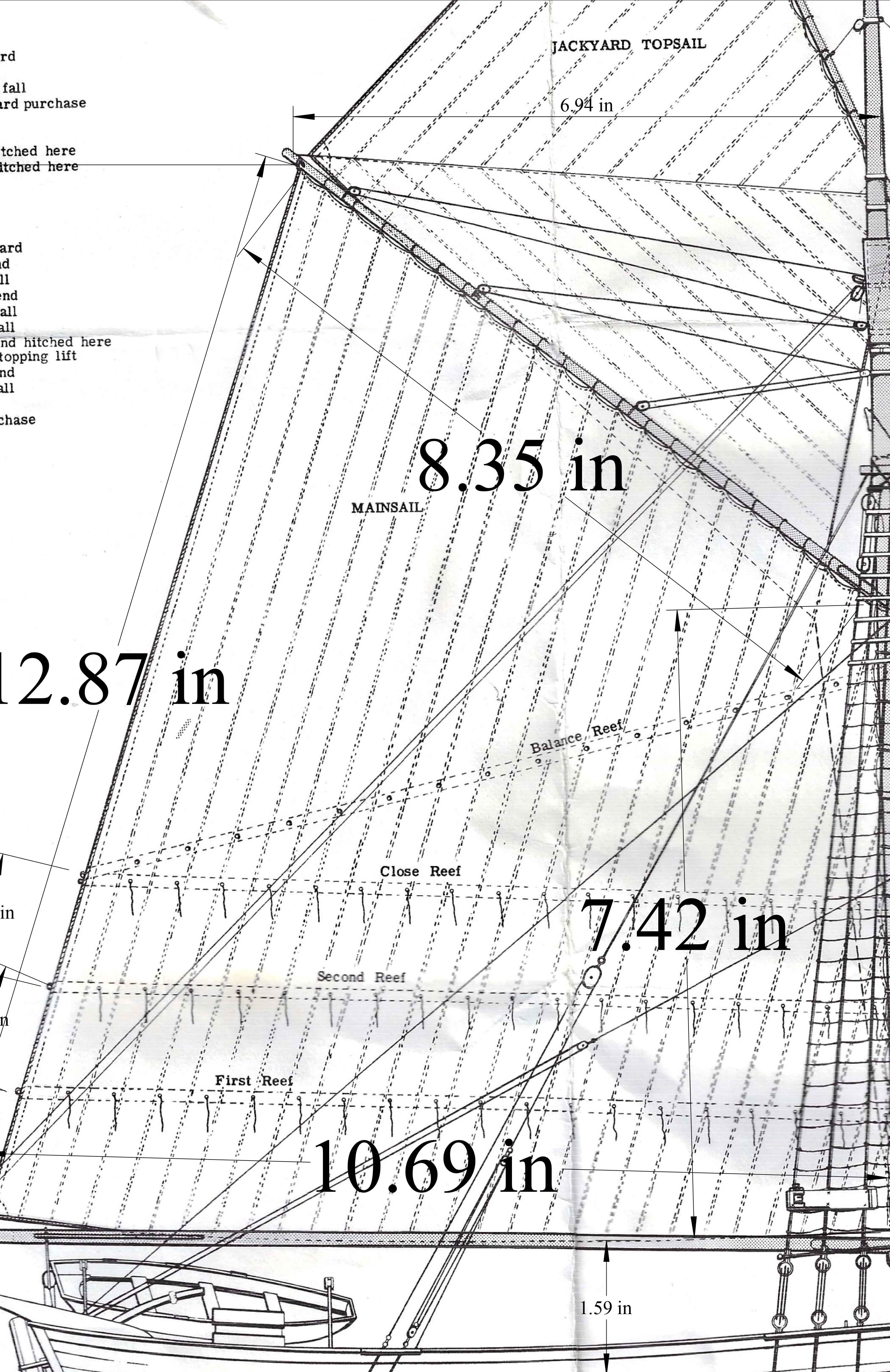

  • 6-7 show the beauty of simple Turbocad. One scans part of a plan and rescales it relatively easily and then either takes dimensions, or prints out the sheet and uses it as a template. For the aft transom davits, I did both, again using a sheet of pear wood for the piece.
  • Gjoa-10b-06gjoaaftraildetail2.thumb.jpg.2880cd27de71752f4b7bd4ecfef50691.jpgGjoa-10b-07IMG_2544.jpeg.78936f003401f614a70dbb0cd1edbeec.jpeg

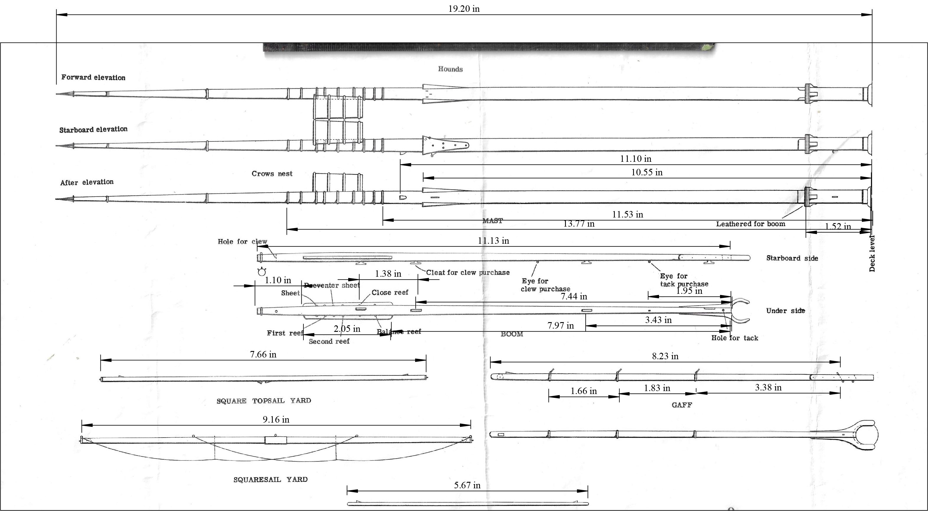

The mast:

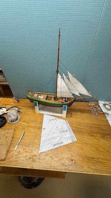

  • 8-9 again the use of Turbo cad and the layout of the spars.  Here I added hoops, sliced from rolled tape around a dowel, and the boom seat cut from thin plywood.
  • Gjoa-10b-08spardiemensions-1.thumb.jpg.a82b84ddaa824402072ef413bee3e79c.jpgGjoa-10b-09IMG_2550.jpeg.2a44ae853249de458279c291e0cecdad.jpeg
Next up.  a chance for our critique.

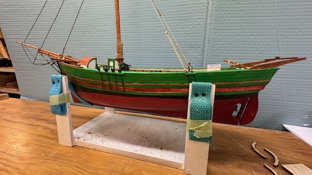

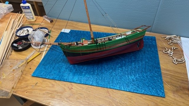

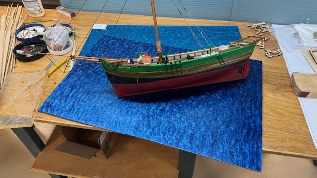

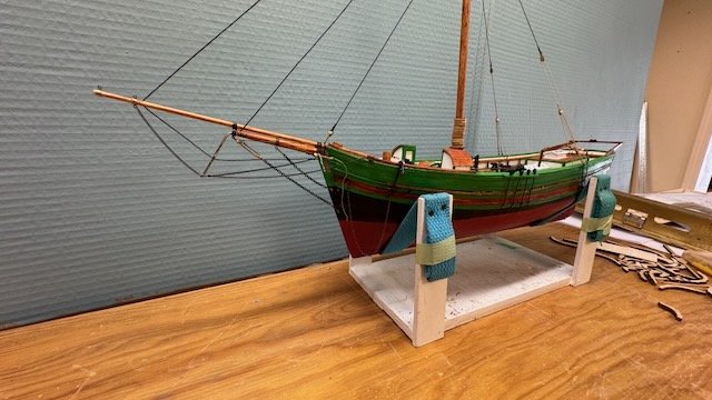

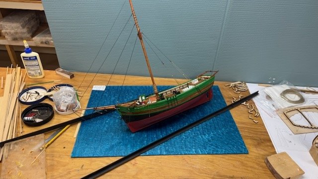

  • 10-12. Here I am off to the Downeast Shipmodelers Guild, and we all talk about our challenges.  The big subject this month was finding coal to be used on a barge.  Real coal from the famous Maine tugboat Seguin was brought to the meeting…kind of cool coal.
  • Gjoa-10b-10IMG_2545.jpeg.4a9434cc3f06bfa0149afcbb4c80d34a.jpegGjoa-10b-11IMG_2551.jpeg.19d4543516446dad6ca68c0db1588b18.jpegGjoa-10b-12IMG_2552.jpeg.f00b38d95b75242d2a9559e2abcc162c.jpeg

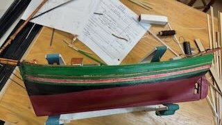

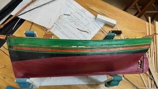

I asked the group to help me solve a problem.  I had studied paint colors and wrote about them in early posts.  I had come the conclusion that the thin strakes were painted red.   I have since changed my mind.  I believe they were oiled and in the museum photos, the lighting seemed to make them red.   Worse, the paint I had used, called Fiesta Red, is called artist enamel that can even be baked in the oven…wow.  It is hard.
So after dialogue with several suggestions, some type of stain wash was the consensus. In11-12 I scaped as well as I dared and then sanded with a cut down emery board.  I then did the first coat of stain and well I feel better even if it is not right yet.

Didn’t I mention in an earlier reply that those scraped and oiled/varnished strakes were common in N-Europe between the 1820s and 1860s, when all black became the fashion. Norway may have held on longer to the old fashion.
Dear Wefalck
I agree with your opinion that scraped and oiled is the way to go.  Thank you for supporting the decision to scrape off my red paint.  I believe your earlier comments suggested disappointment with the museum lighting.  It surely tricked me.  Also it seems they painted a bunch of stuff white that I did not follow as the older pictures showed more normal " darkness" in winches and the like.
anyway thanks for adding you advice
cheers
Harvey
you're too kind in your accolades.  My soldering is quite low tech.   As to the scraping of paint I suggest if you scrape off white it might be easier than my scaping hard paint on soft thin poplar. I won't photo too much of a close up as it does not yet look right.....work in progress ....but I think it was the right thing to do.
