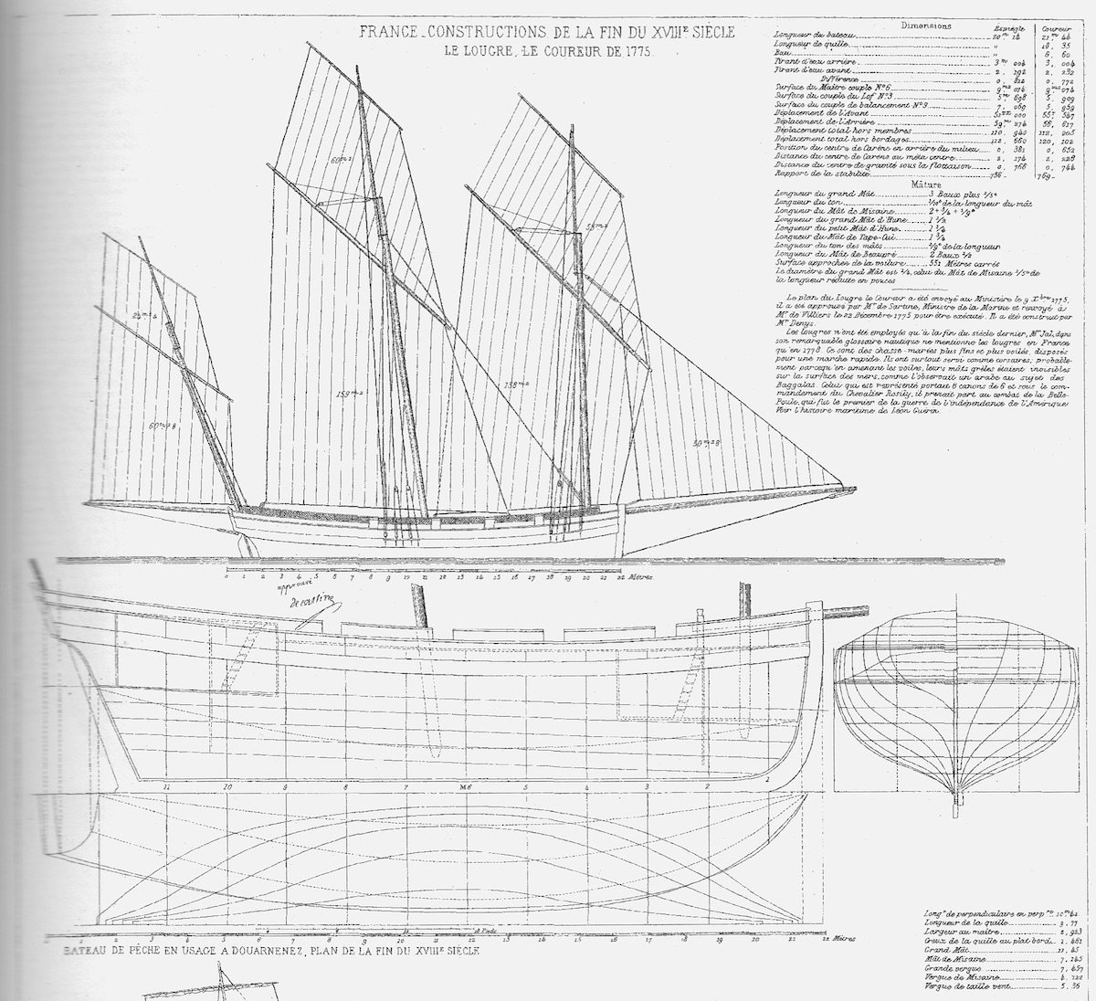

Only Shipyard can answer this, but the Paris drawings were pretty commonly available since the late 1800s. If you examine other older kits of Le Coureur, like Mamoli's and others, they all tend to be based on Paris, even down to the point of being seemingly based on the related AAMM model plans. Shipyard seems to have simply followed suit.
But, I'm glad you mentioned those drawings. My own interest is to take the Shpyard kit and make the modifications to make it closer to these, using the Boudriot/Berti monograph. It should make for an interesting project.

Hello,
Admiral Pâris relied on existing plans in the naval archives for his older ships. At that time, research on naval architecture was less advanced, and the drawings in his collection of plans are sometimes questionable.

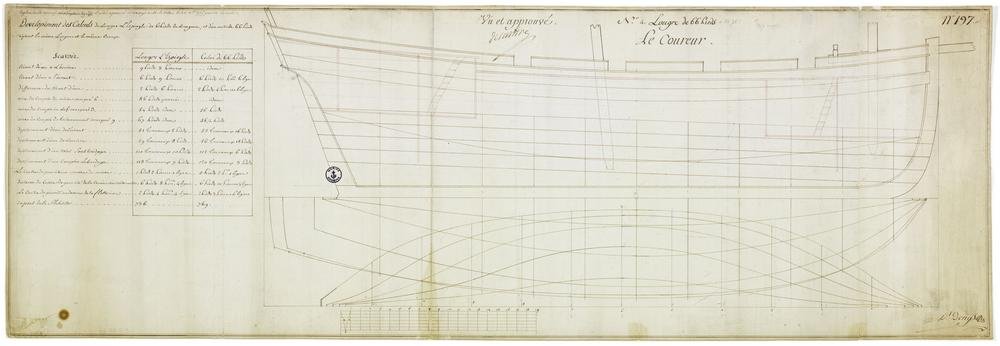

In the case of Le Coureur, he simply used the original plan referenced D1_63-13 from the archives (see below), adding the masts and rigging.
As for the AAMM plans, they were largely copied from Pâris's albums and made usable by modelers without further research.

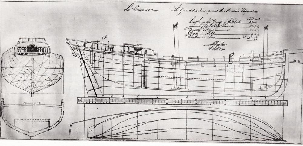

There is another explanation, even more likely. The differences in the hull shapes on both plans from that era are due to the fact that although the British were able to measure the hulls of the captured vessels very accurately, already when drawing up their plans, they were, in a sense, designing such vessels from scratch, but using different design methods, which inevitably altered the actual shapes of the hulls to a greater or lesser extent. Not to mention the natural deformations of the hull during the ship's use.
This is why today's French researchers consistently reject the lines from such plans of captured ships, preferring instead the original plans by the French designers (if, of course, they have a choice). And rightly so, and this is the first exception to this rule that I am aware of.
For the above reasons, the original French design plan should be considered more reliable in terms of the shape of the hull, rather than an approximation made after the ship's capture using other design techniques that are incompatible with the original ones.
Regarding the Shipyard cardboard model of the Coureur in 1:96 scale. I wanted to modify the model according to the English plans as taken. However, I noticed a problem with the dimensions.
I printed the English deck plan in length and width according to the known English specifications and placed it on the model. The length fits the model, but not the width, as you can see!
