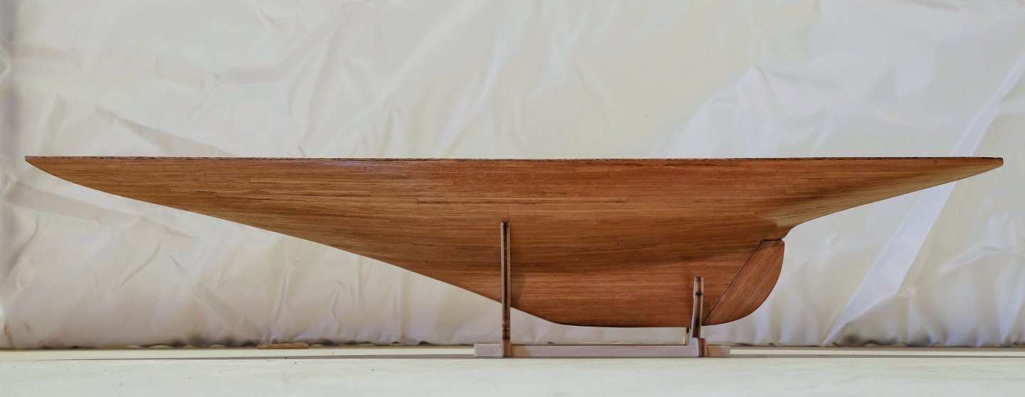

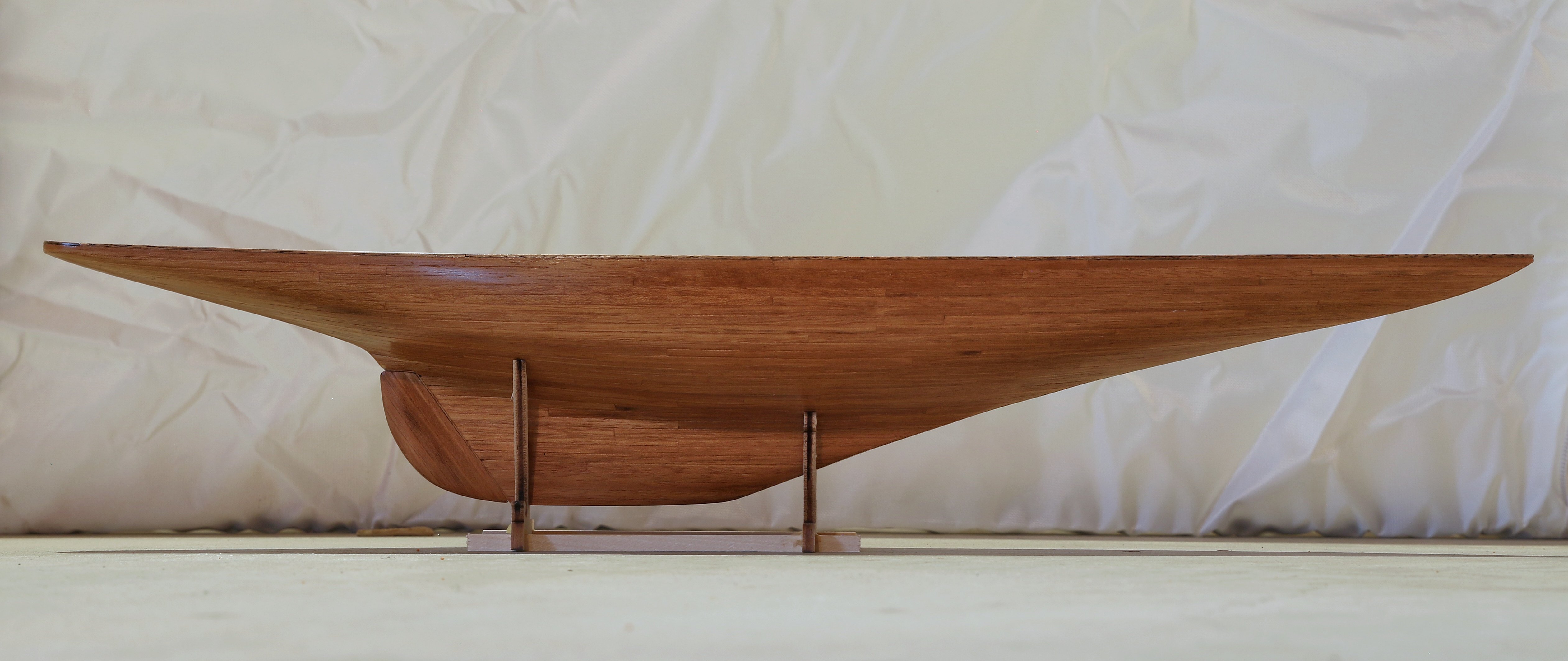

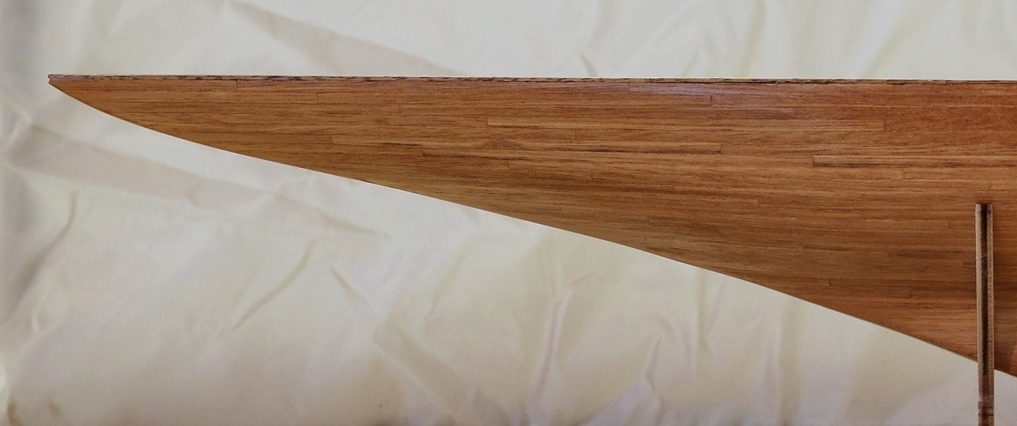

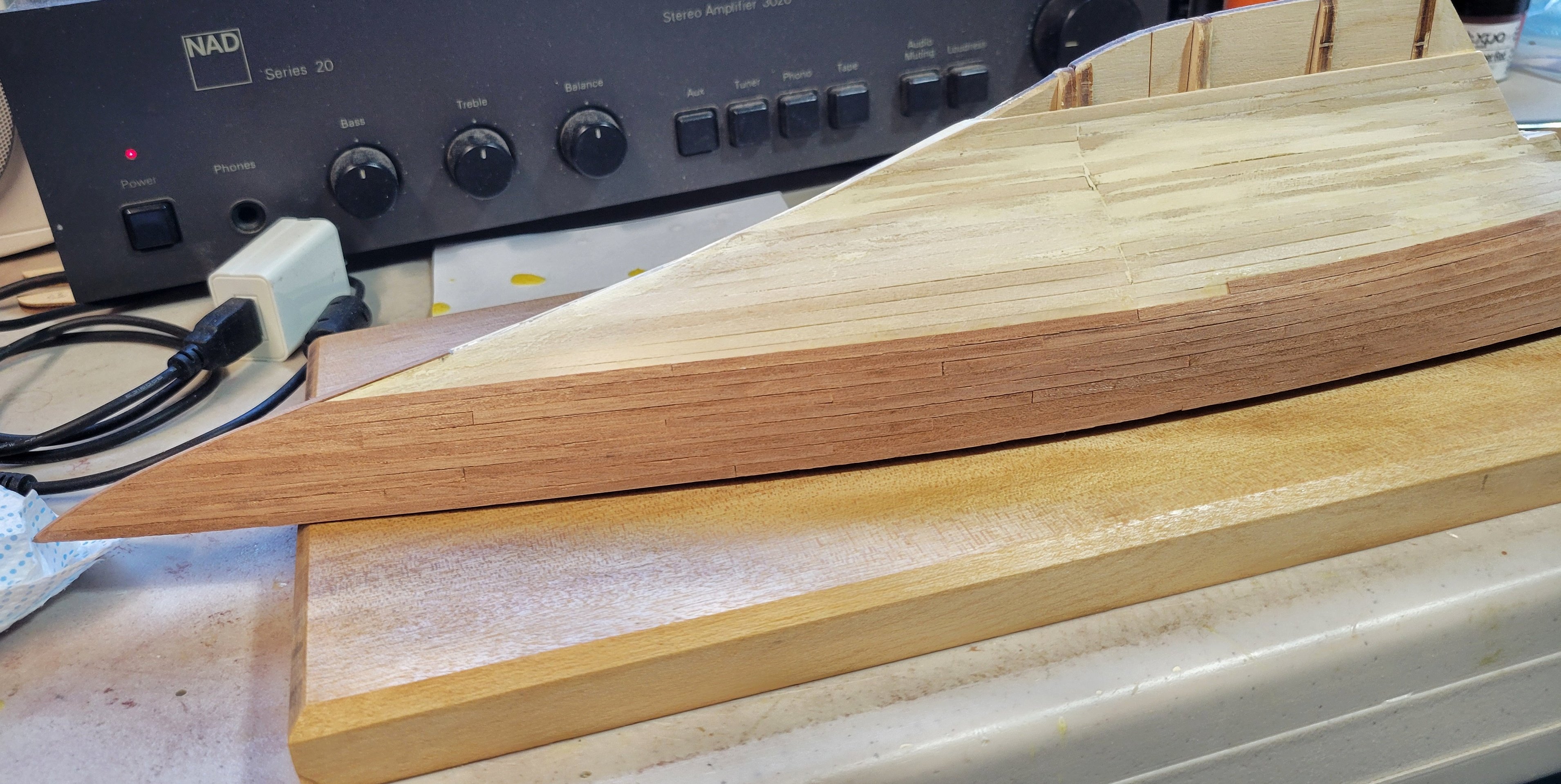

Also, about 30 plus years ago I built this half hull (photo below) from a solid hull kit that my dad started back in the 60's but never finished. I cut it in half and stripped off the paint. He had done a nice job scribing the deck so no need to touch that. I added the strip planking and mounted it to the maple "frame" board I made. Then finished it all with an oil rub. It has aged beautifully
So that has been my inspiration to build a full model. A tribute to my dad for allowing me to cannibalise the kit he never got to finish.

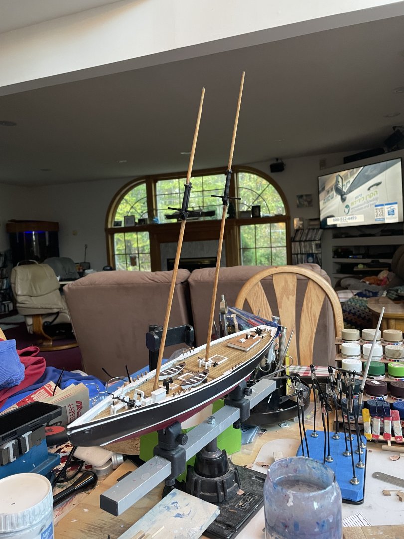

I’m rescuing an Amati Bluenose kit that was started 17 or more years ago and was listed on eBay . It is one that’s currently in progress and there is a log build (1900 -present). The planking was hap hazardly started , the decking was atrocious and parts were missing and broken. I offered the owner a very low offer and he took it. I am just starting the rigging and it’s turning out well. Amati kits are pretty good but in my opinion not as good as Model shipways. After I finish the Bluenose ( which will be soon) I will start the Endevour.

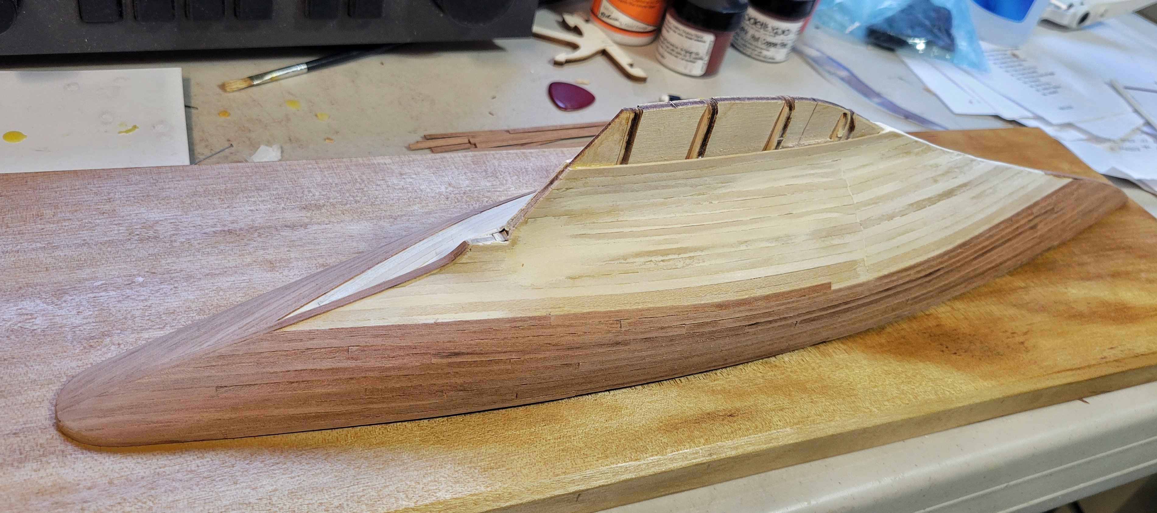

It's a very nice little kit so far. The laser cut plywood bulkheads and keel are very cleanly cut. No burns!!! No char, and no soot on my fingers. The tradeoff might be that the plywood is so hard it sands like rocks. I used a file for much the fairing which was no big deal because the fairing consisted of mostly easy beveling of the bulkheads and keel. The bulkheads slid into their slots on the keel without any filing.
The first layer of planking is going well. Haven't had to use any shims on the bulkheads so far.
I threw out the plywood stern blocks and made my own from basswood scraps. Much easier to sand and shape. I also brought the block up level with the top of the first planking instead of to the bottom of the first planking.  That way I eliminate their methed of covering the block with an alternate sort of fanned out short and bent planking.

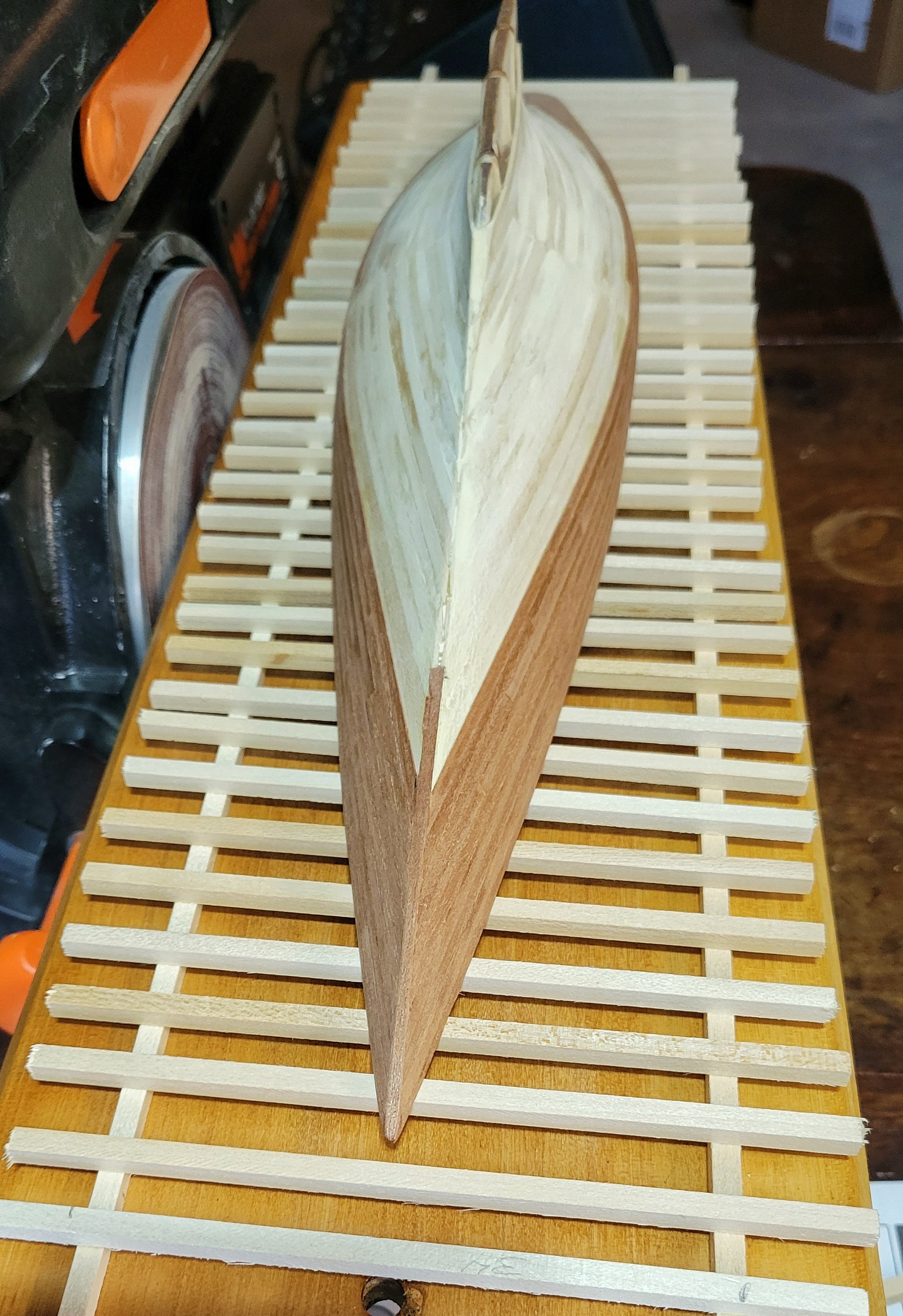

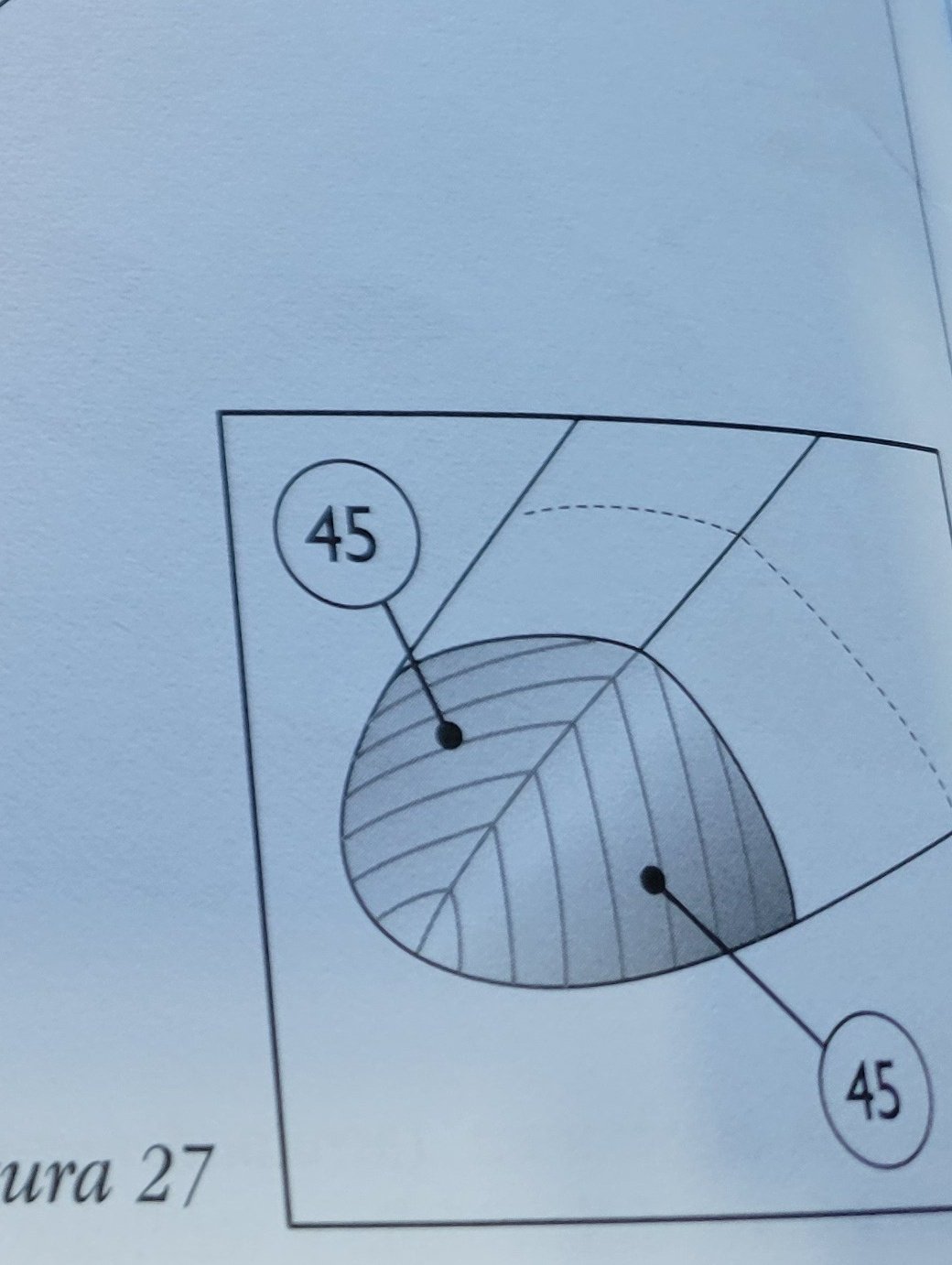

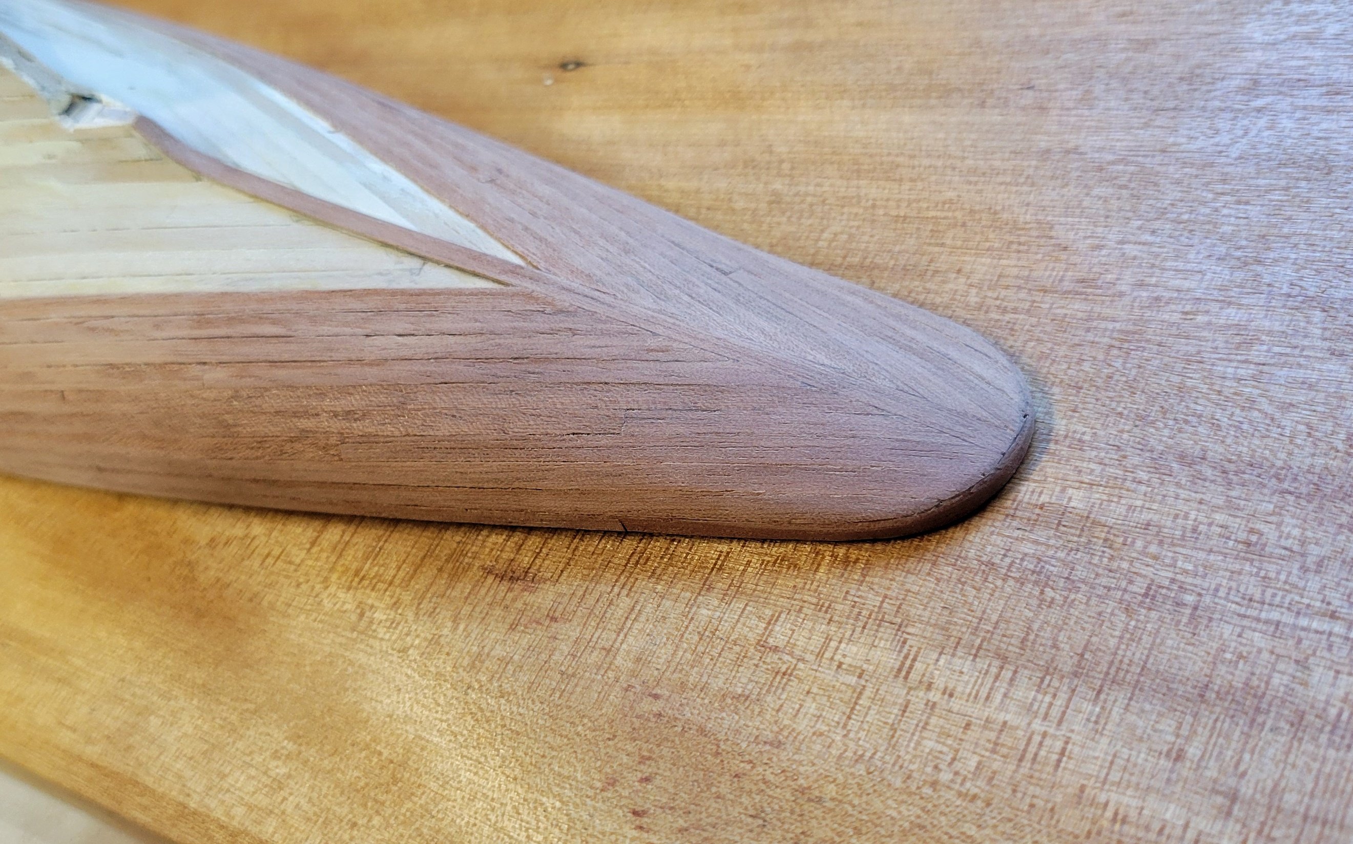

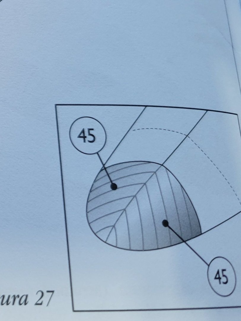

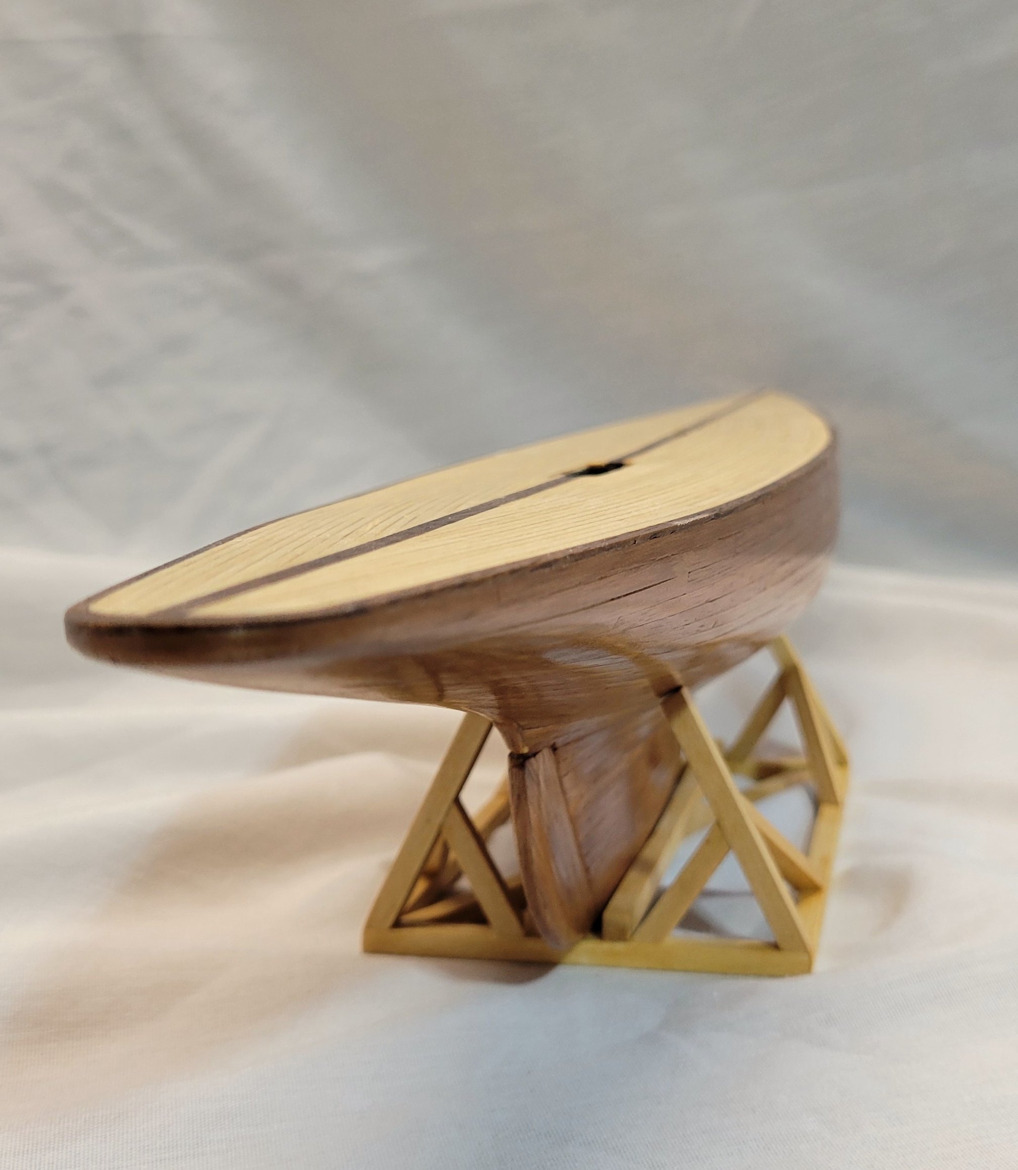

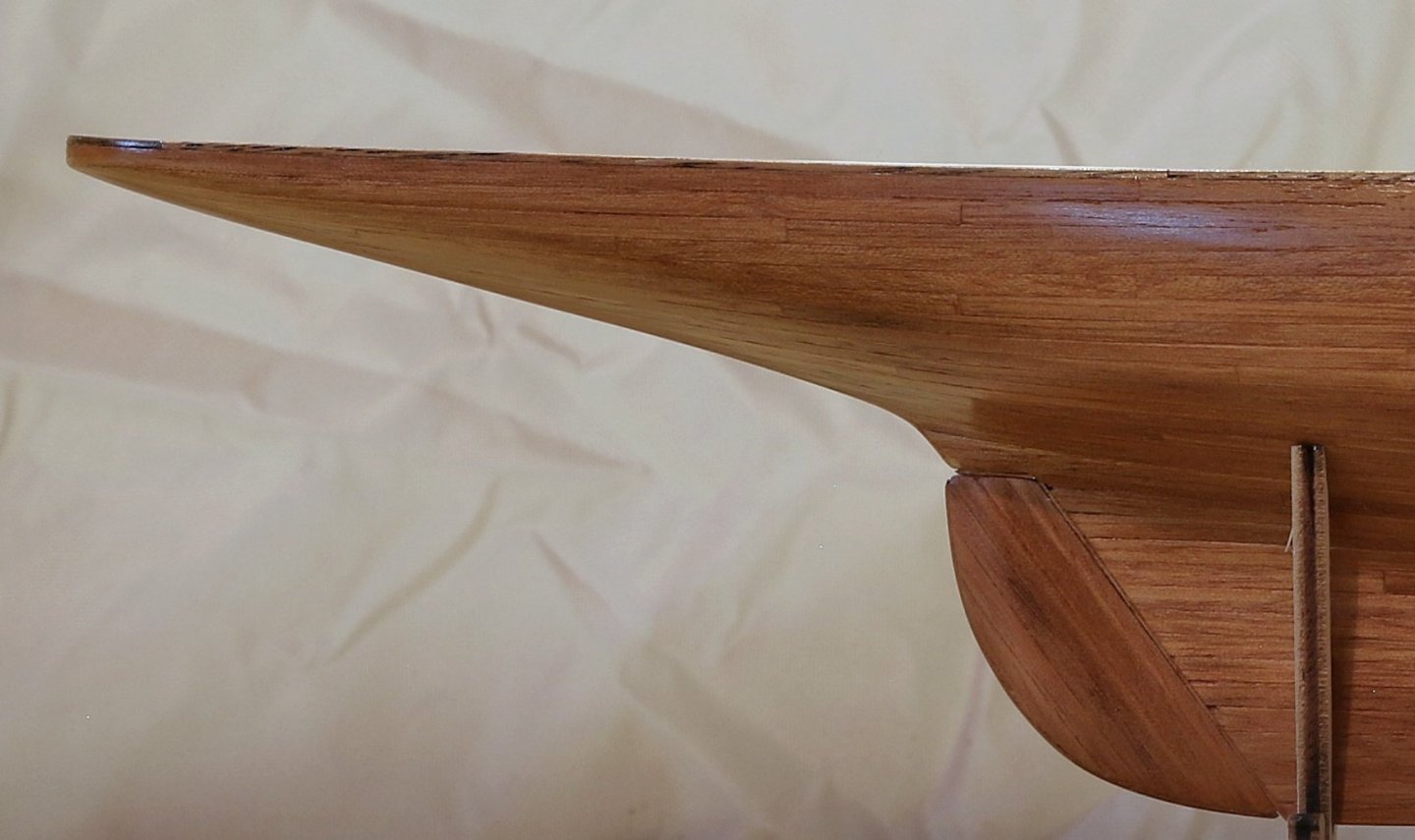

Started on 2nd planking. I'm planning to use a natural finish on the walnut planking so I deviated from the instructions and did a more conventional planking over the stern section. The instructions suggest a "fan-out" planking arrangement over the stern block for both base and second planking. I had to finesse things a little and I'm happy with the results.

I had often wondered why that detail was there when I fiddled with it during my build. Nice work around mate, she is looking nice. We are (finally) back from our Outer Banks trip. We decided to extend it until the weather started getting too cold for surf fishing down there. We had a great time and will be back down there for the whole month of March.

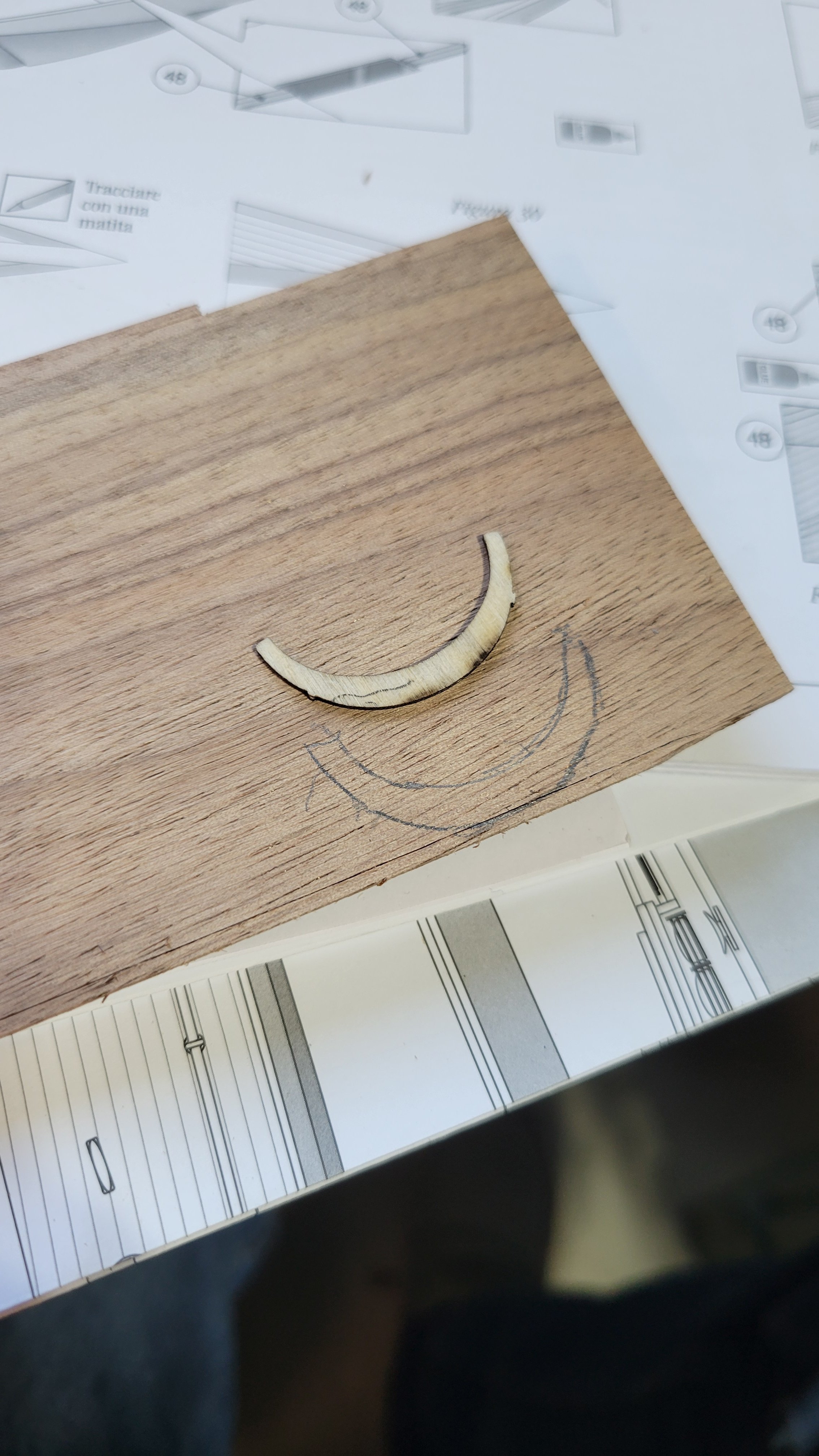

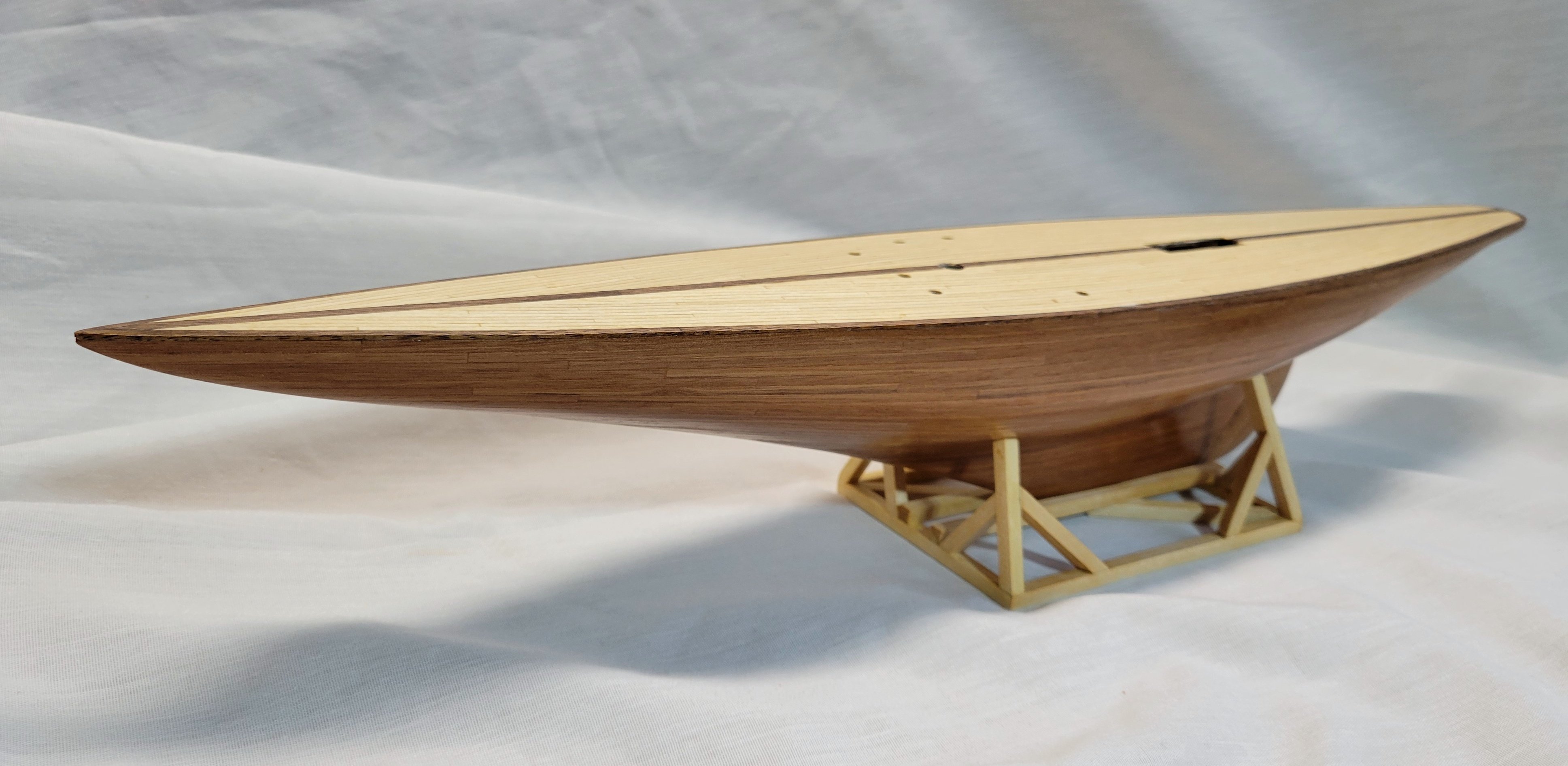

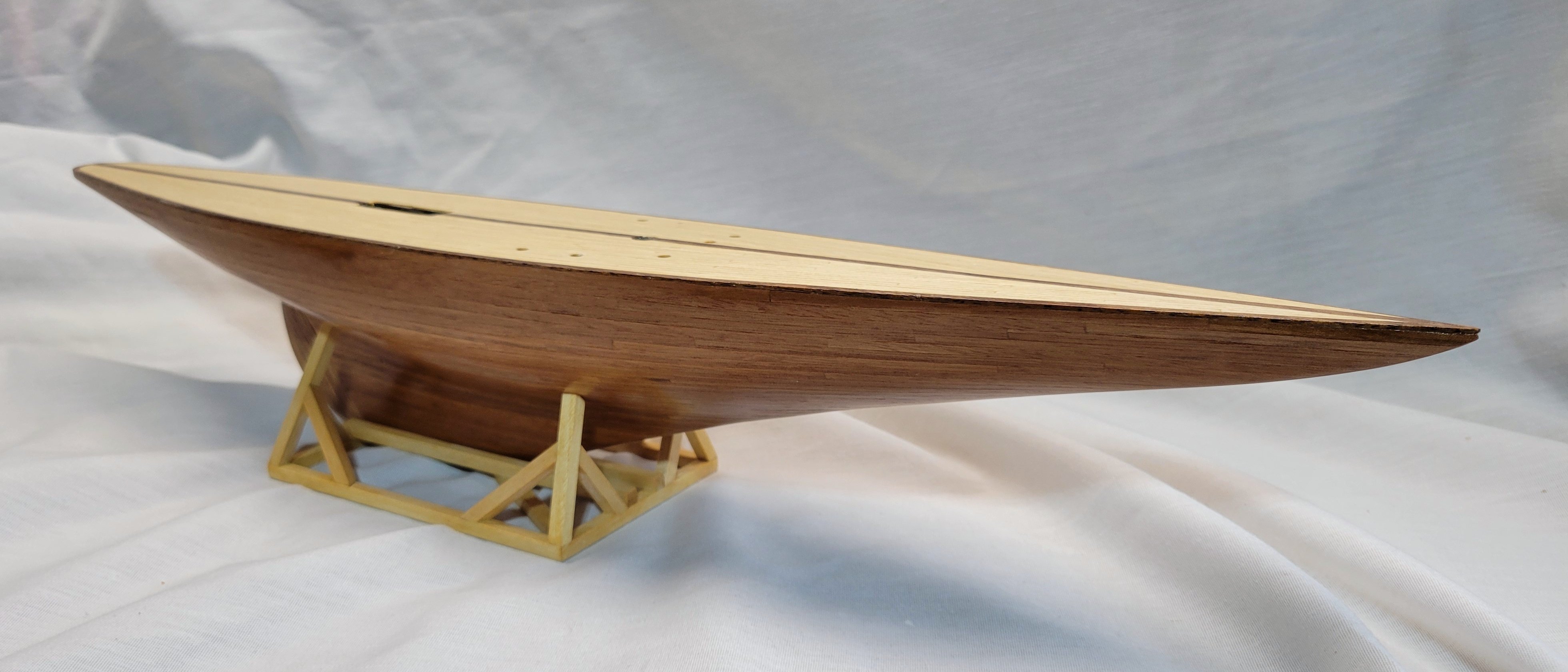

-The second planking is done.
-The deck perimeter planking is done. I didn't like the laser cut stern perimeter piece so I cut a new one from a walnut 1/32 inch thick sheet. From the same sheet I cut deck perimeter planks.
-Sanded the hull with 150, 220, 320, and 400 grit papers.
-It all got a few coats of shellac
Deck planking is next.
Edited by TerryPat

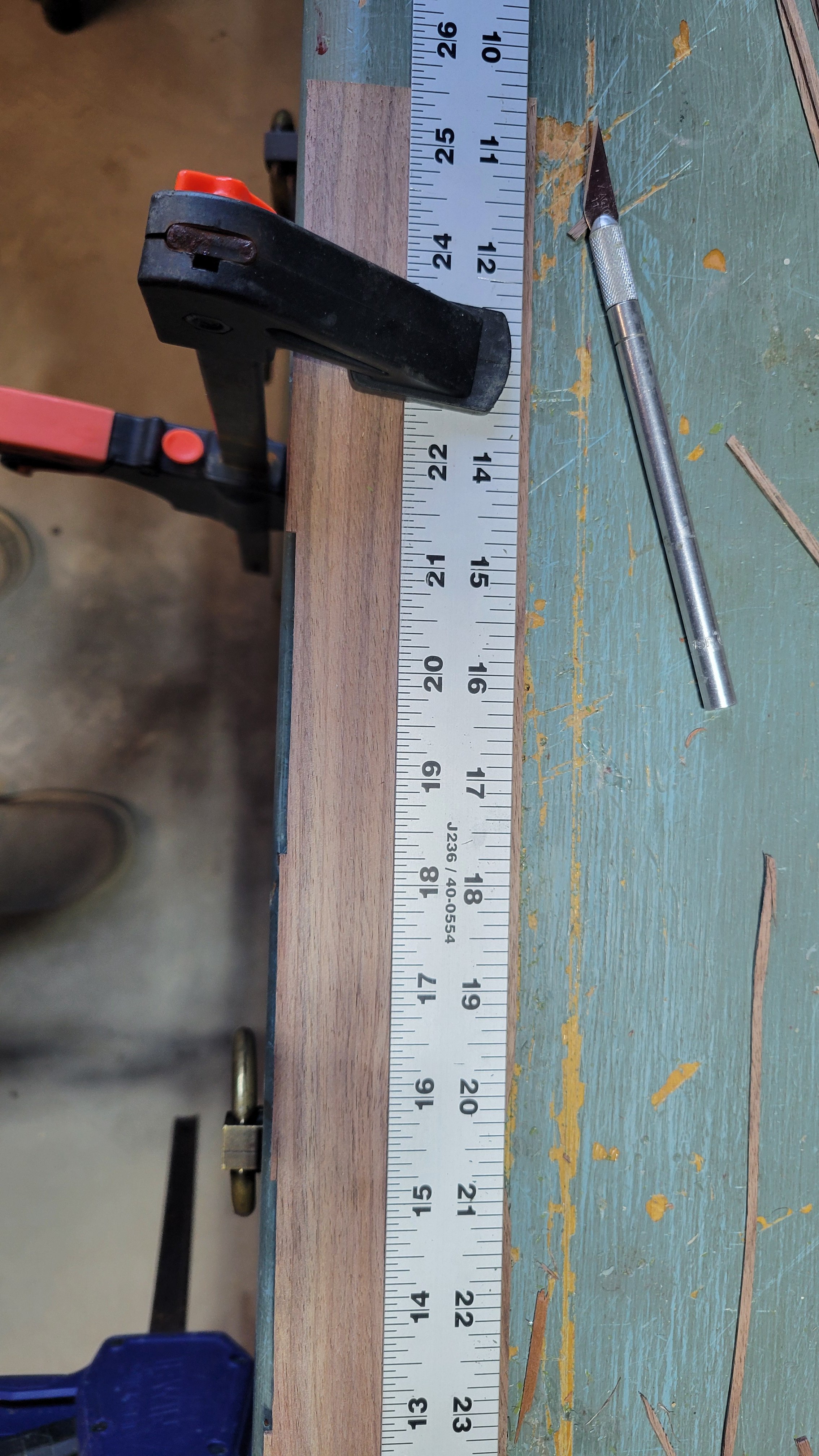

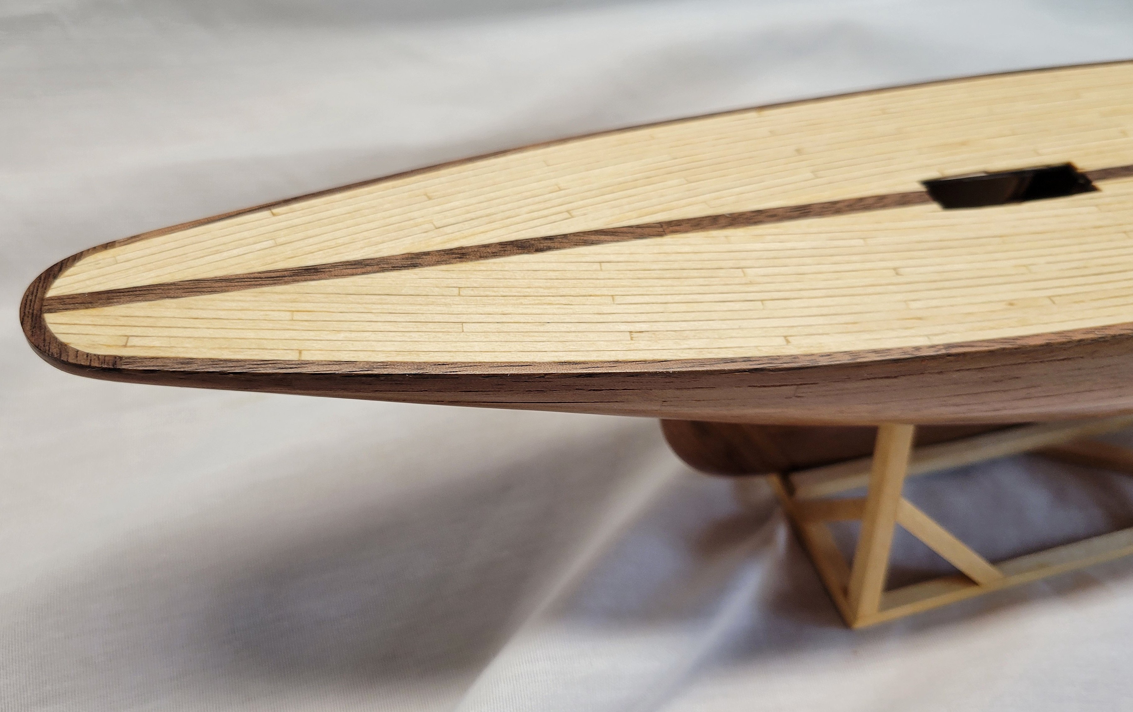

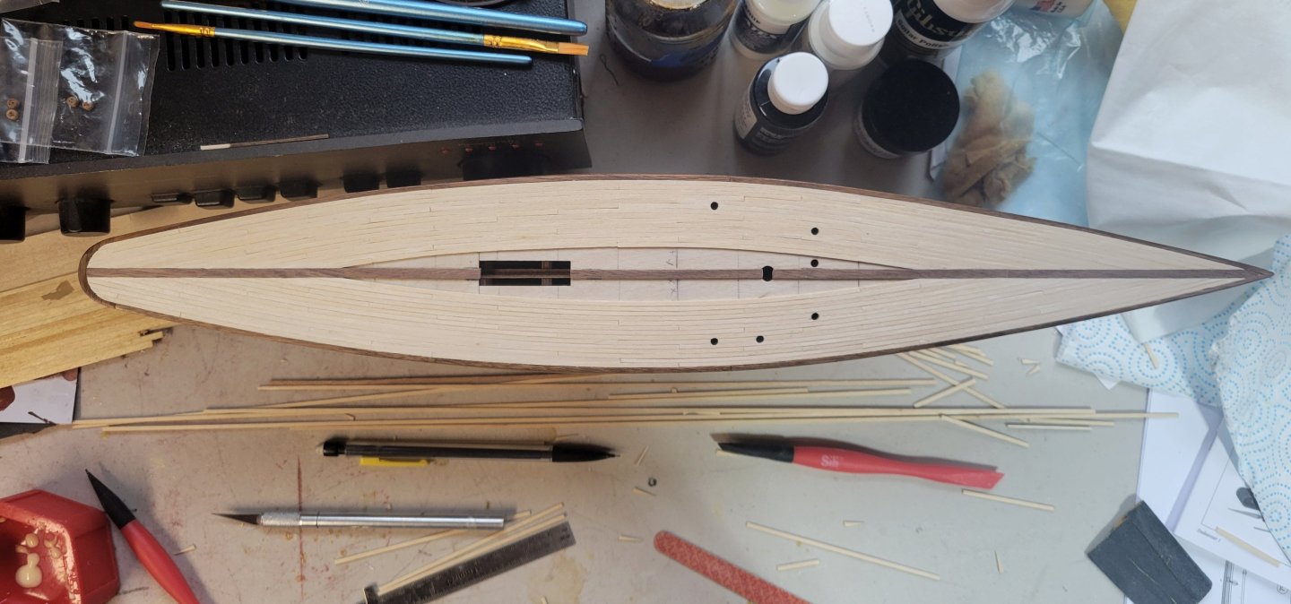

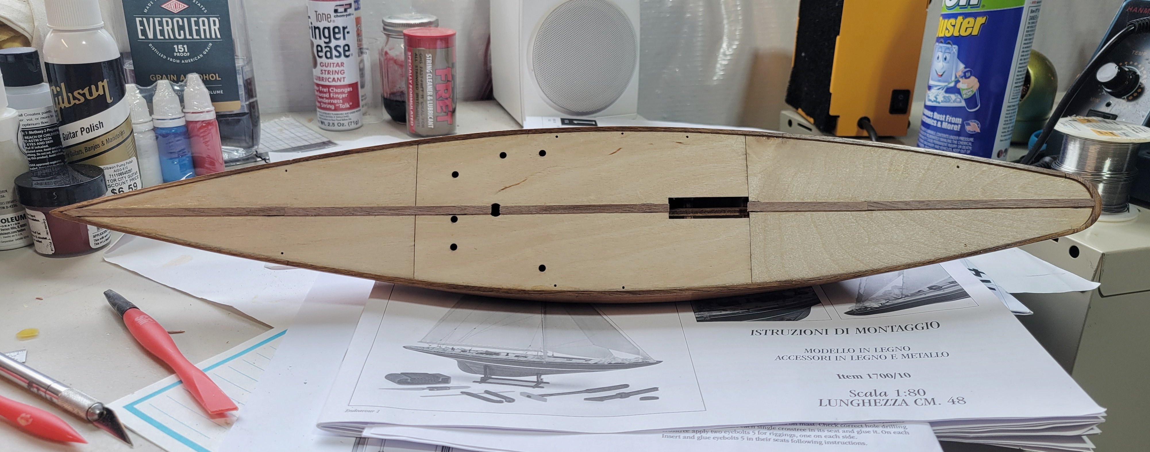

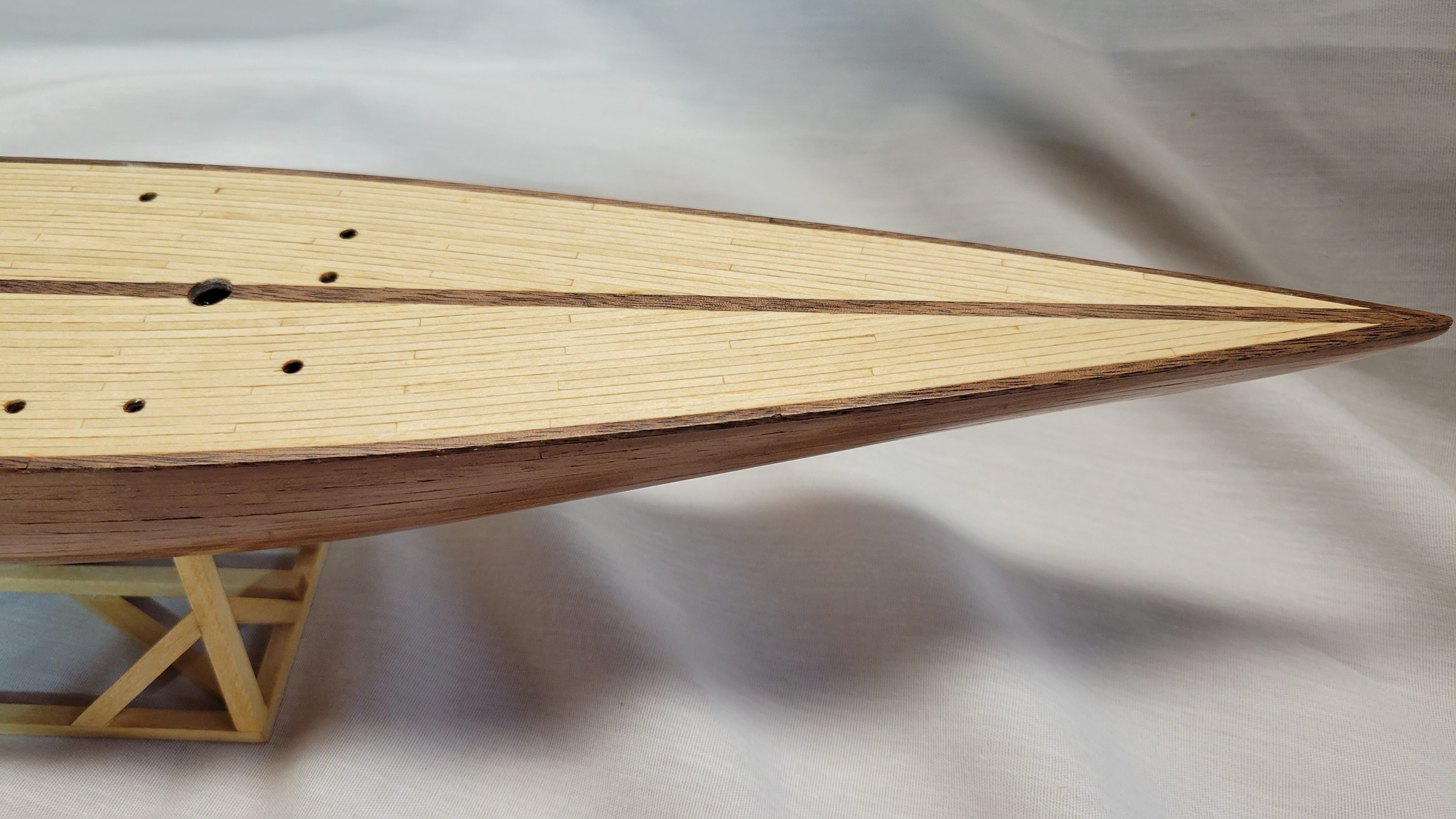

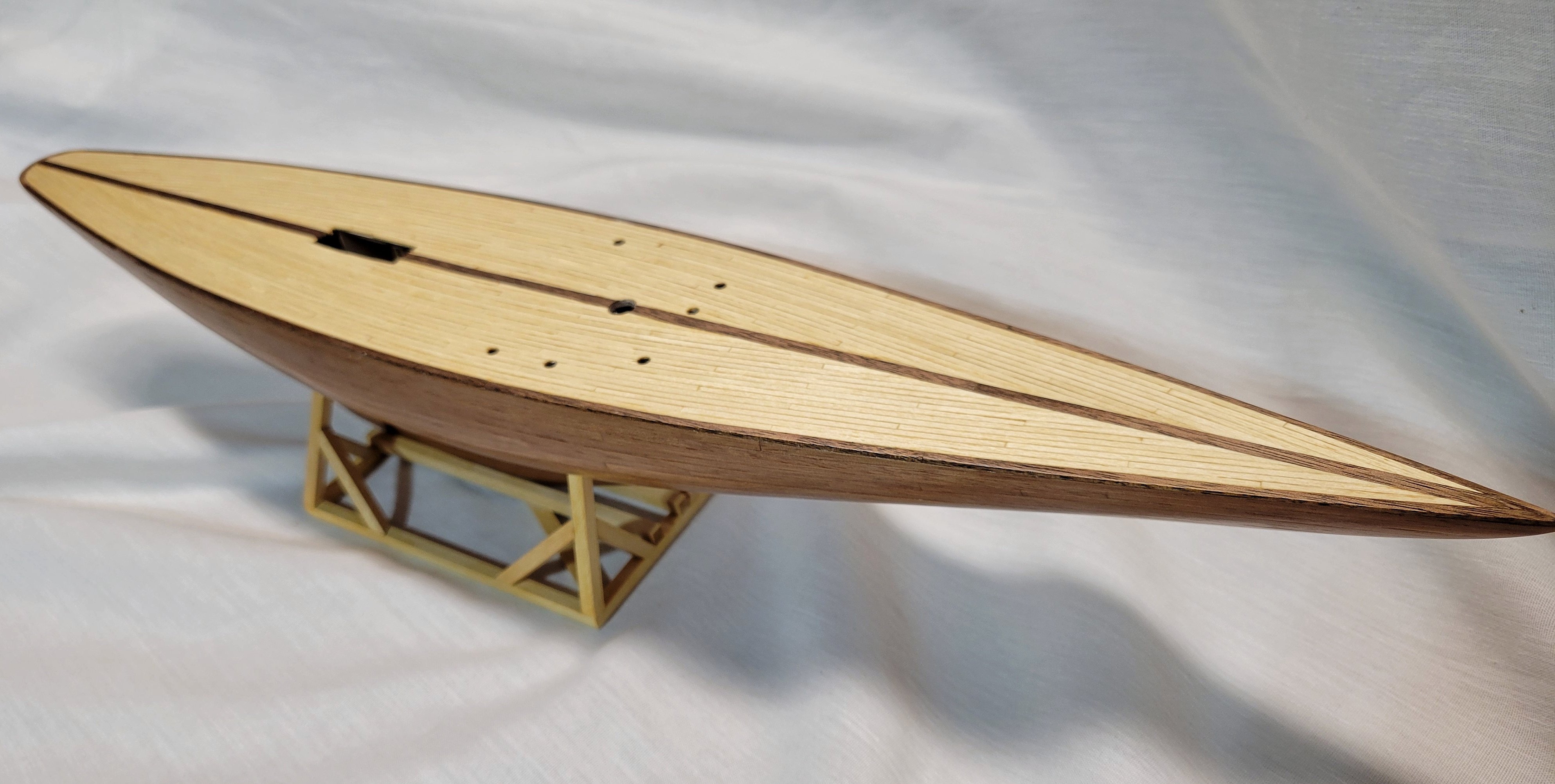

I started the deck planking by running a plank along the centerline from stern to bow. Instructions call for using two deck planks along the centerline. The picture of the model on the front of the kit box shows these planks as darker planks than the surrounding deck planks. But they didn't supply anything with the kit so I cut my own from my 1/32 inch walnut sheet.
For the remaining deck planking, I cut the supplied planking strips into 4 inch pieces for the individual planks. I started the planking in the middle of the model and staggered the planks by 1 inch which results in the pattern repeating every 4th plank row.

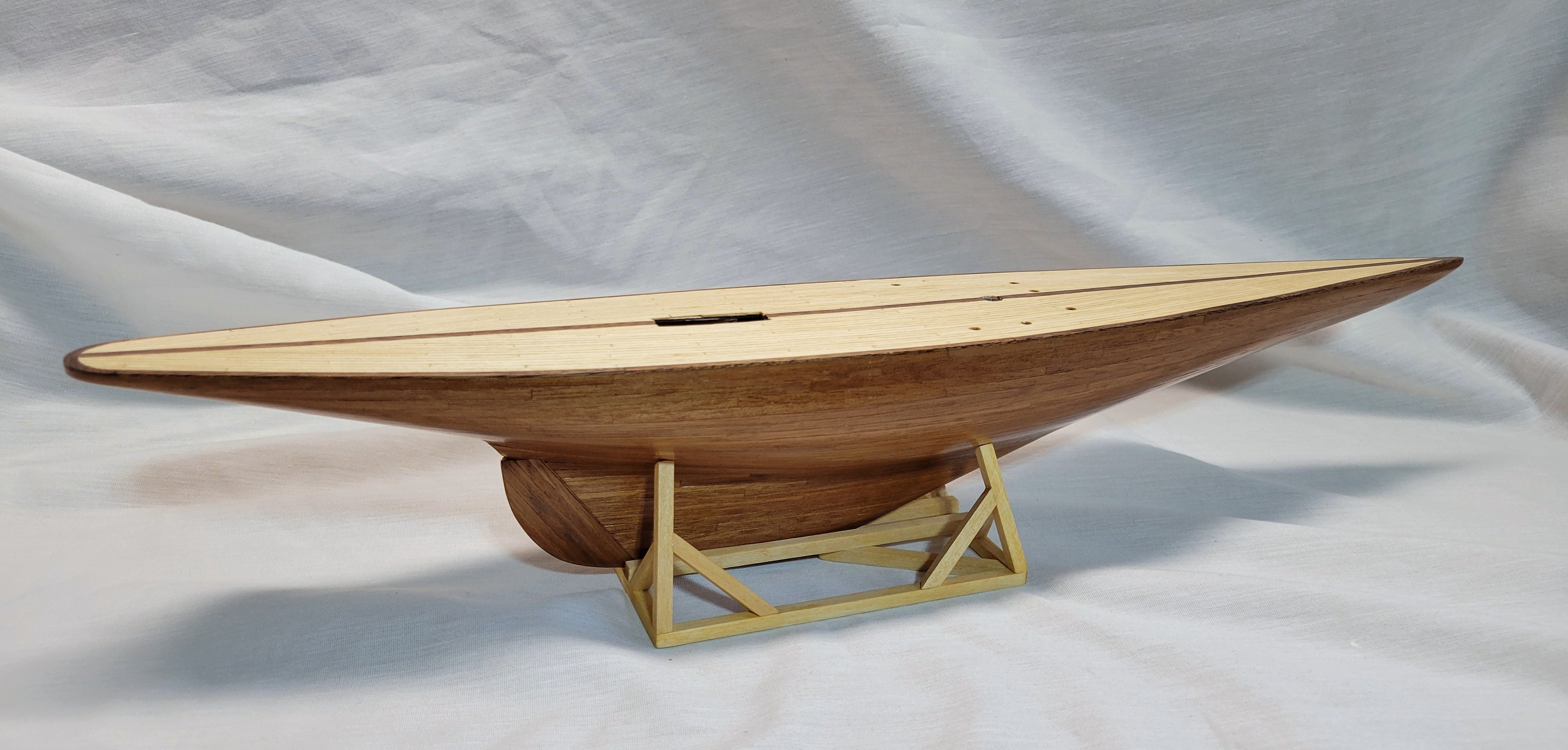

-Finished the deck planking.
-Sanded smooth with 220, 320, and 400 grit papers.
-Applied a few coats of Tru-Oil wipe on finish.

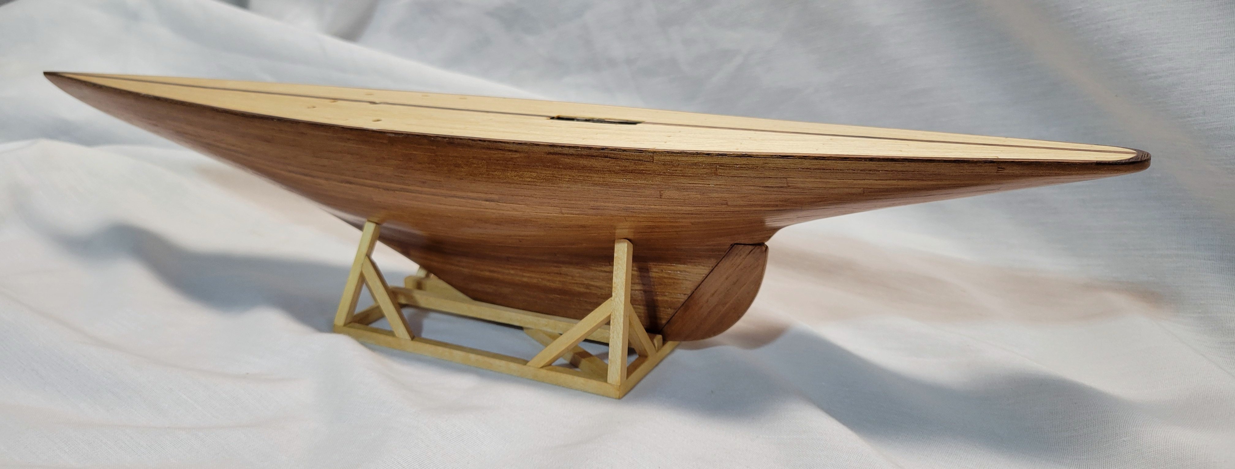

-I wasn't thrilled with the kit supplied model stand so I built my own which was inspired by @eki0813 and @David Lester J class build stands.
Both of my builds are at hull completion.
Next will be deck fixtures for both.
All for now.
Edited by TerryPat

Terry that stand is as impressive as your hull and deck planking. All 3 complement each other and significantly add to the beauty of the build. By the way have you heard how Ellie is coming on her Endeavour build.

Thanks so much, Admiral.
I have not seen anything from Ellie. I hope she's back to building soon. She has a great start going
