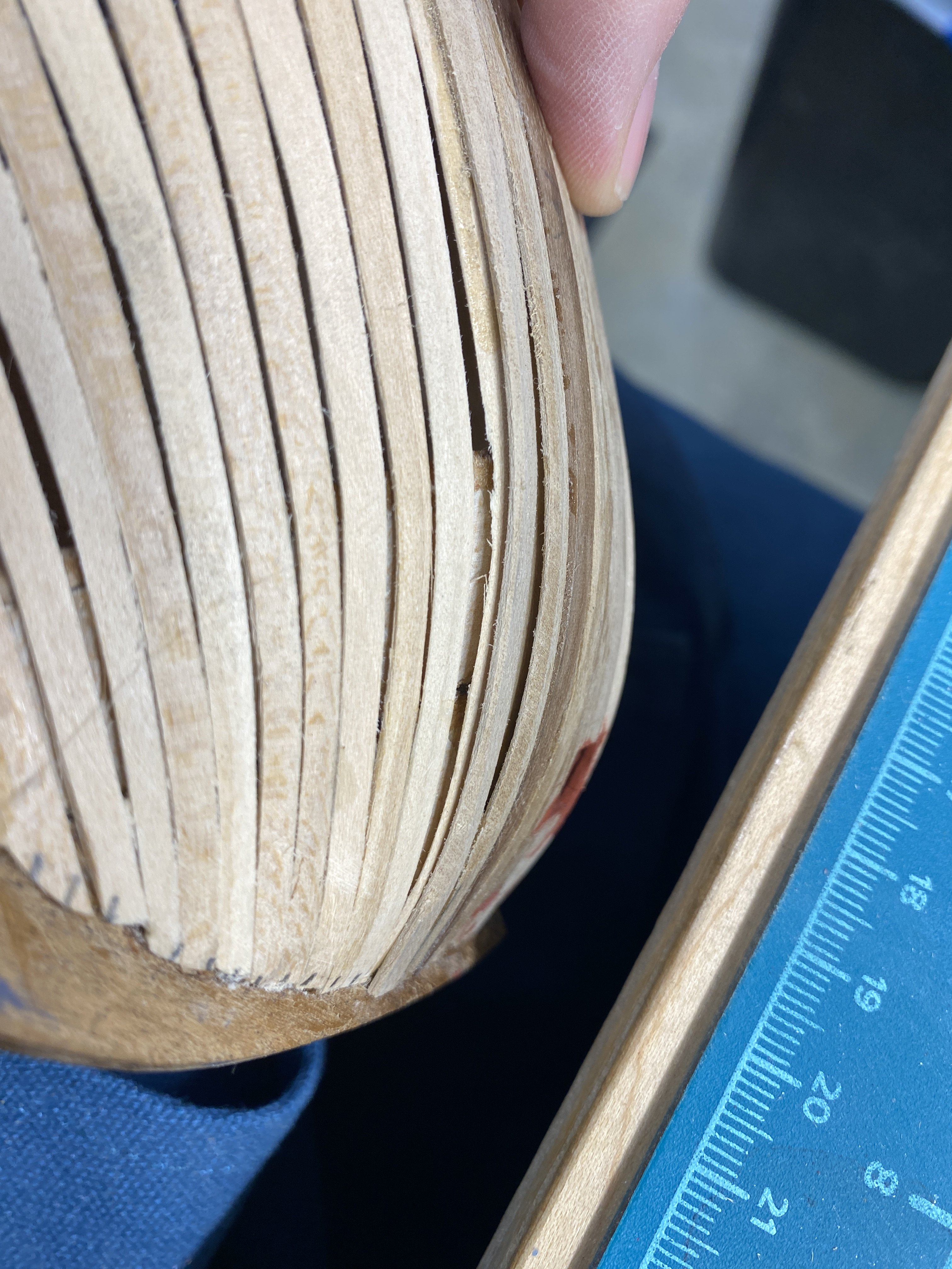

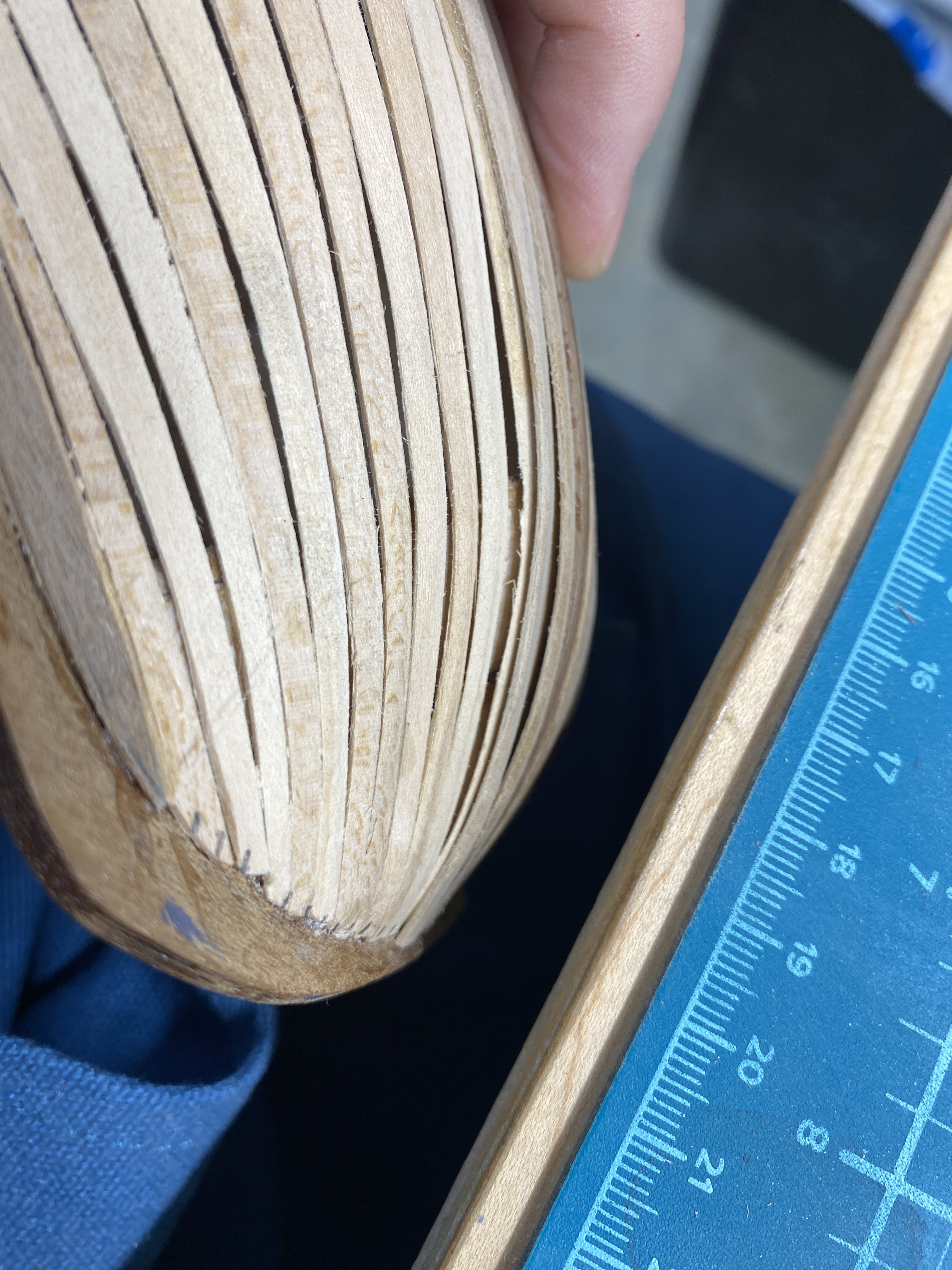

Here's an example of what I'm talking about.  I've sanded the edges smooth but you can see how the planks were standing off from the robs on the bottom edges resulting in the this profile after sanding.

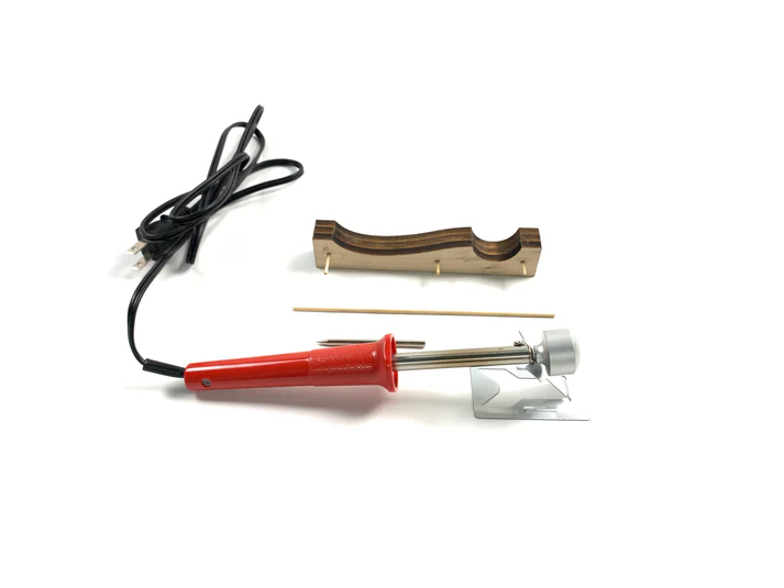

I haven't tried an iron - I know some some use that - I've used one of these plank benders:
https://www.amazon.com/Electric-Plank-Bender-Model-Shipways/dp/B01F0IEUTI/ref=sr_1_1
I just get the outside of the planks a bit wet before using the bender. Note that this plank bender is just a cheap soldering iron with a round head - and it's not really well engineered - but it works. Though nearly every time I use it, I get burned someplace out of carelessness.
As you probably say, there are two directions of bending. One is to bend to the natural curve of the hull, such as bending in from the side to the bow. The Amati plank bender comes with a form to help shape those bends.

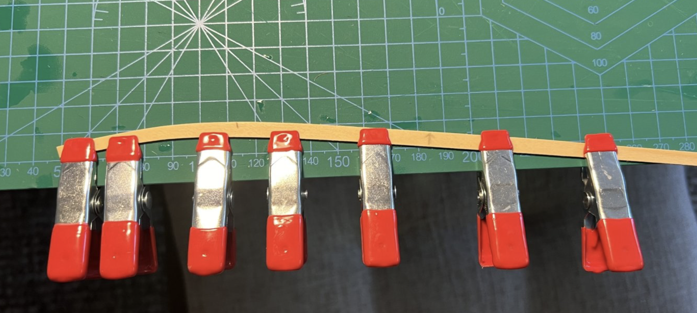

The other - more challenging - are the edge bends. Those are counter intuitive - at least they were to me - but once you get a few shaped right you begin to get a sense of what the planks should look like. The NRG Half Hull planking project also helped get the 3D shape in my mind - even though that kit doesn't use planks.  I've pasted how I first tried edge bending with clamps (from my Sherbourne build). I've seen folks who have made jigs and forms to help make it happen. In this example, I'm just clamping. There really should be a piece of wood between the clamp and the plank, and there could be pieces of wood to help with the shaping.
Note that I don't just hold the plank like this in shape. I use the plank bender between the clamps, and move the planks around, as I heat the wood. These clamps aren't the best since they have plastic covers and if you touch them with the plank bender they'll melt.
If you don't do the edge bending (and taper) you'll likely end up with having the planks lifted off the bulkheads.

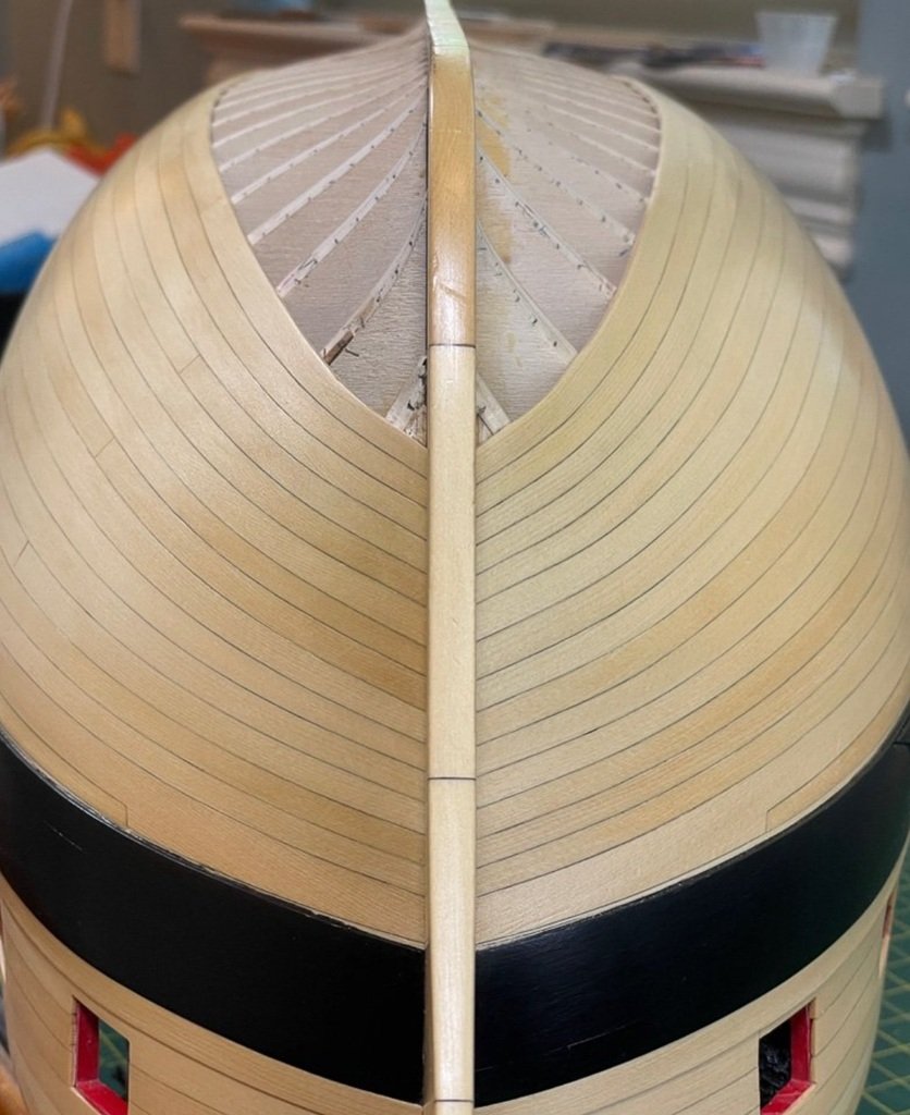

This is an example from Glenn Barlow's Winchelsea. It was all done with edge bending.   Glenn and Chuck use CA glue ; holding the planks in place with their fingers with no other clamping.

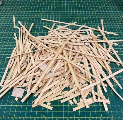

Here is a picture Glenn posted of his scrap pile.

I absolutely love the scrap pile. Now I don't feel bad about how much scrap I produce when I plank. One thing I really appreciated watching the Olha Batchvarov live videos is how long she takes to do the (seemingly) simplest thing to get it right, and she's been building these professionally for years. With my first model, I thought planking the hull was surely something I should be able to get done in a weekend. Now I know better.

Tapering the planks properly and cutting the correct bevel to fit the adjacent planks is the most important part of getting the planking to fit properly. However, as you noted, getting the planks to curve and twist correctly to fit on the bulkheads is the tricky part. I have tried several of the off-boat plank curving ideas mentioned on the Forum, but although they may get the curvature close they all fail to get that twist.

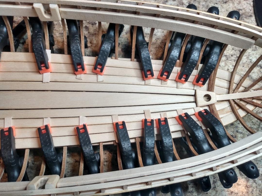

Here's a launch I'm working on. The three center floorboards are glued in place. The outer most floorboards are currently being 'wet-formed' to shape around the glued center boards, until tomorrow when they will be dry and ready to be glued down. This is soft wood with no tight bends so no heat will be required.
