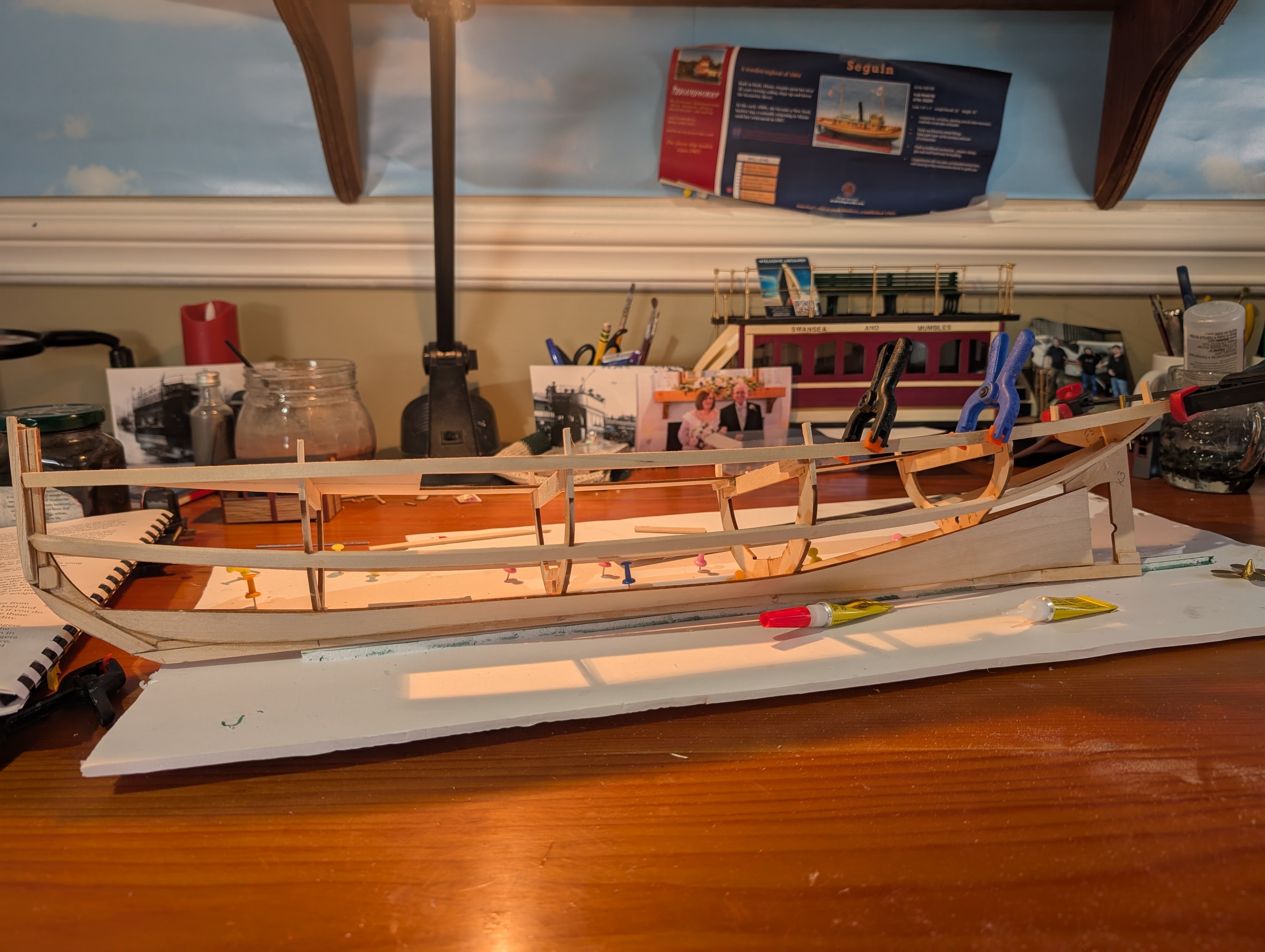

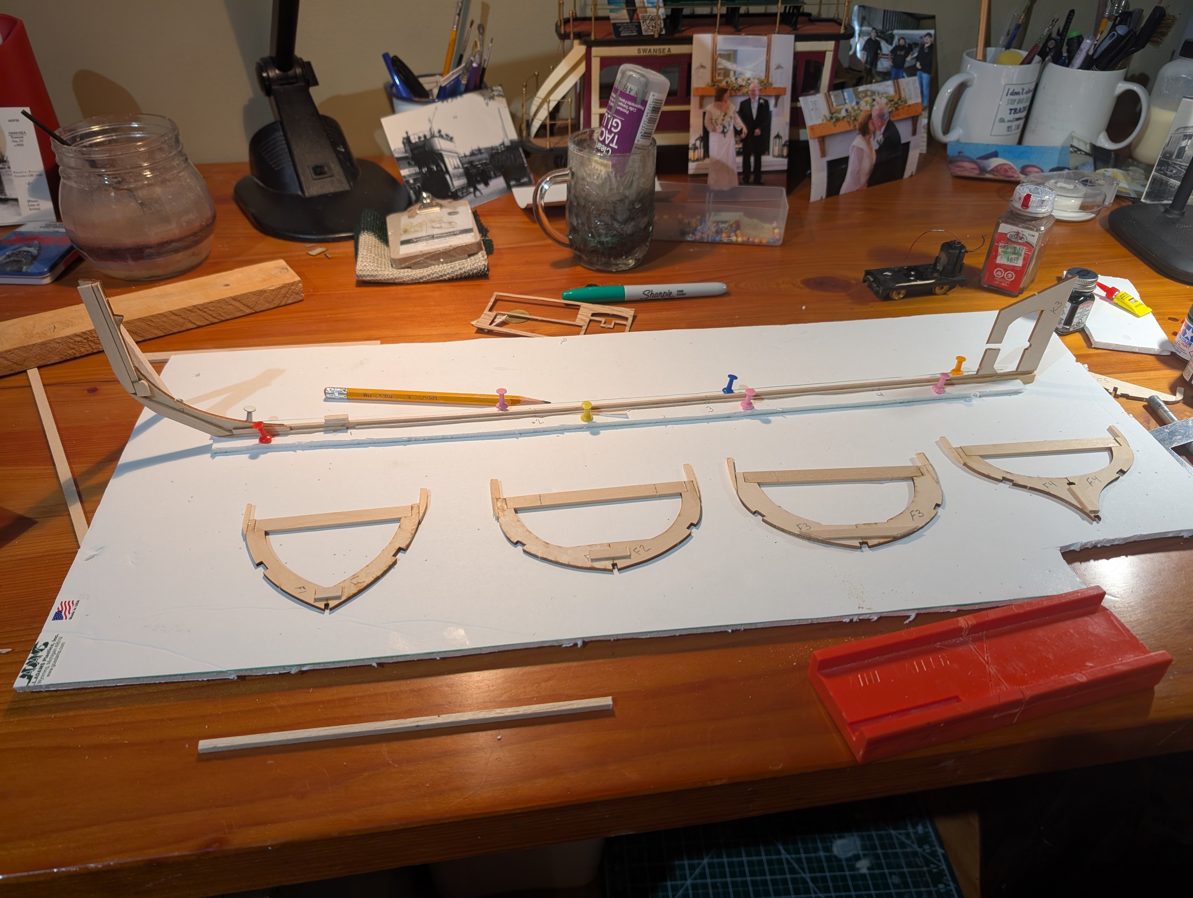

I started building my model of the Seguin a few nights ago. I read through Rods entire build that he posted a number of years ago. It gave me the courage to get this project started as I have had the kit for quite a few years. I remember seeing a built-up version of the Seguin in a hobby shop many, many years ago with my father and always thought that it was a grand vessel. So here I am taking a stab at it. I know some have failed but I do have some experience in building model ship kits and scratch building. So armed with Rods excellent build log I feel pretty confident that I can do it. Here is a picture after a few nights works. Wish me luck!
Good luck with your build.
Take your time with that stern post assembly - it is more complicated than it seems, it might be worthwhile to tape together the parts that make it up until you are sure you have it right before glueing it together. If you look at my build log bear in mind that my sternpost had to be heavily modified to accept a stern tube for an RC setup, yours will not need those modifications but it is still a bit of  a 3-D puzzle

Thanks Tim! I appreciate any advice anyone has for me.  I just finished reading through your entire Seguin build.  You did a fantastic job documenting the process.  It will provide a ton of valuable resources as I work through this build.  To be honest, I'm really a scratch builder and plans and instructions and nautical terminology is something I find somewhat intimidating.  But in spite of my "kit neurosis," I am am going to give this all I got.  With you and Rods builds I feel like I have a decent chance of completing the project.

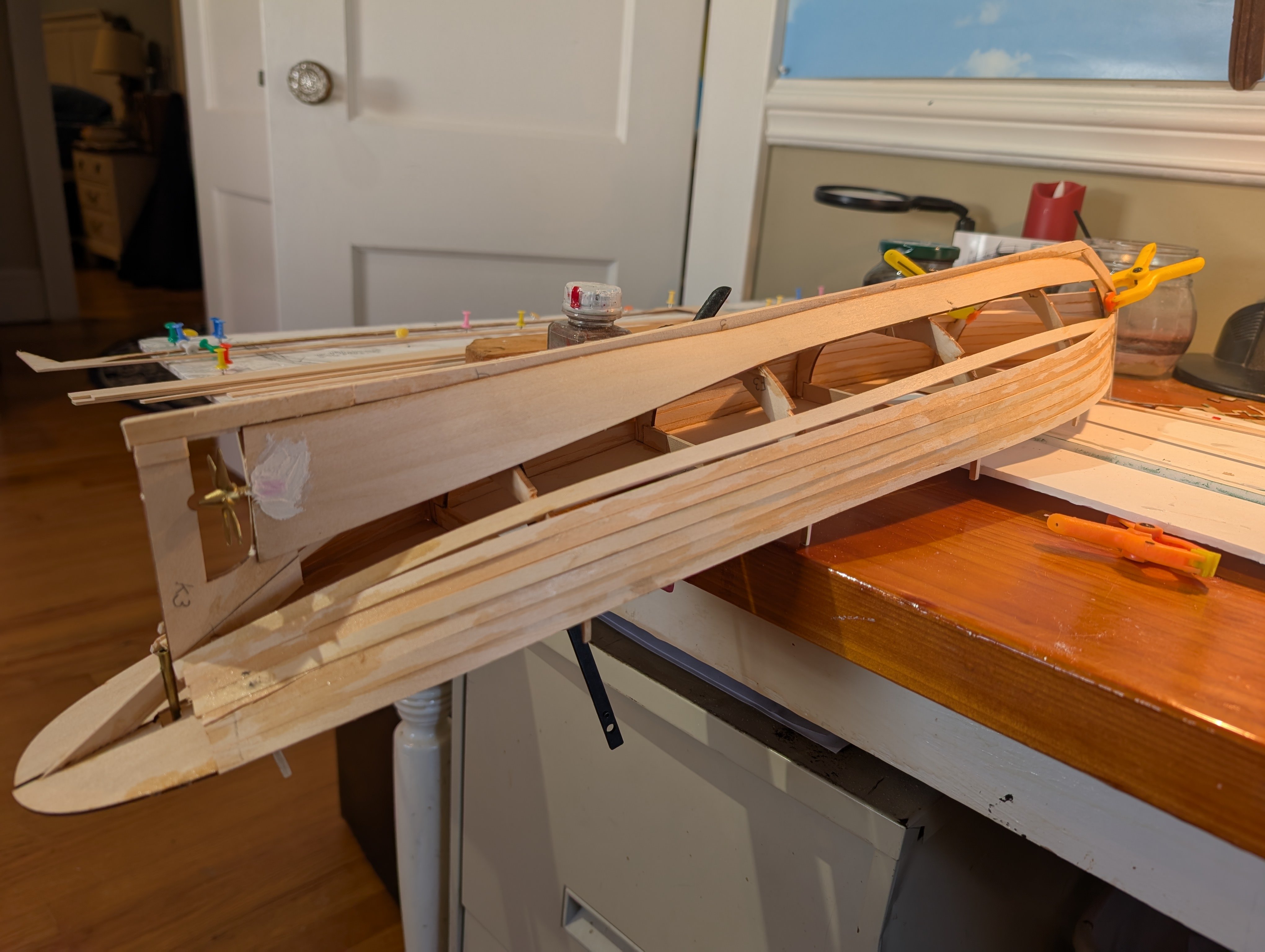

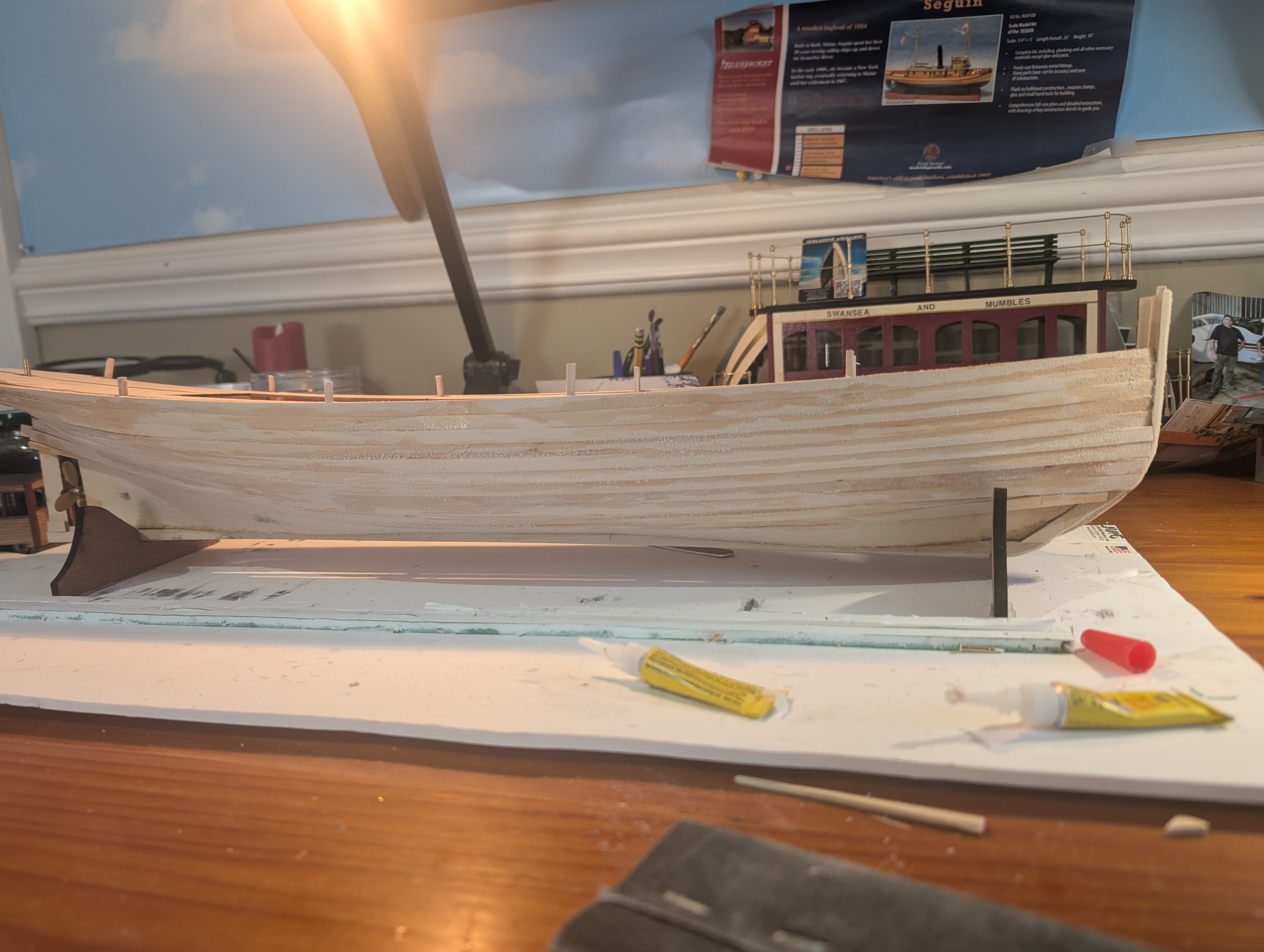

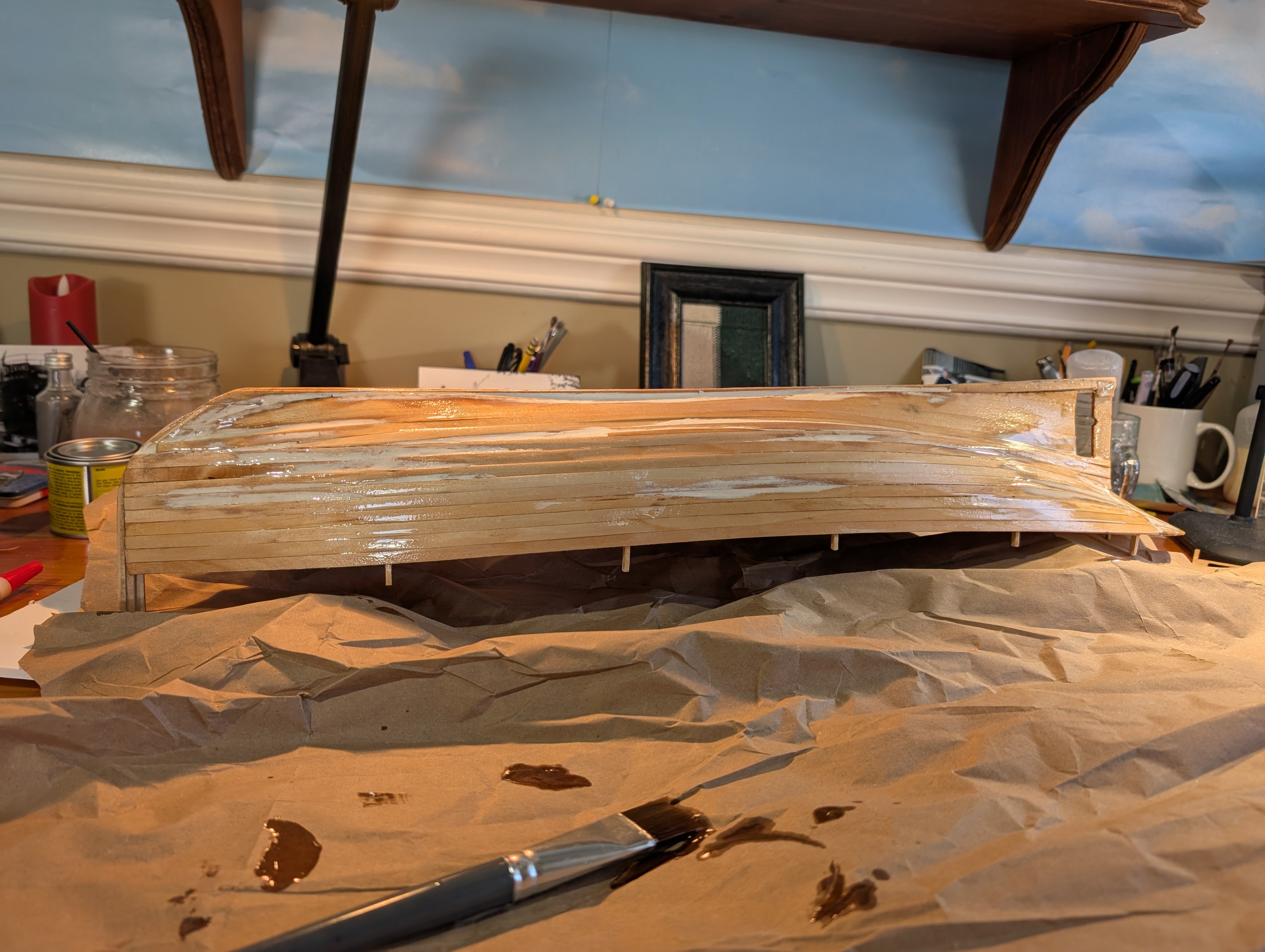

Here is the ship as she is looking this morning. I just started the planking process. Unlike some of the previous builds that did a lot of steaming and soaking of pieces to make them more pliable, I literally manhandled them into position and using an abundance of super glue and clamps was able to make the curves more or less acceptable
Thanks John. I appreciate your comment. Super glue makes everything go fast, sometimes too fast. Since the photo was taken. I've gotten half of the planking done.

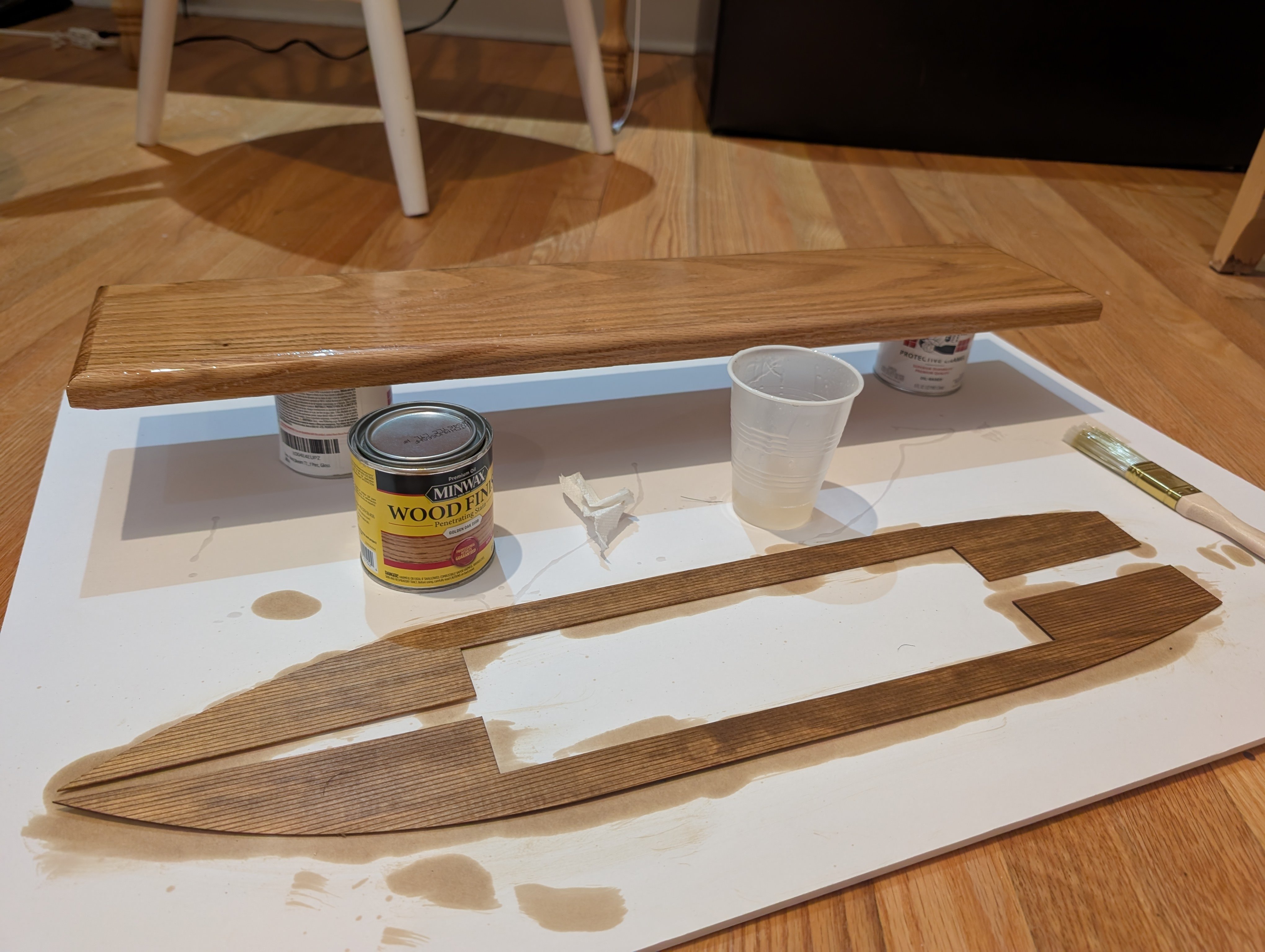

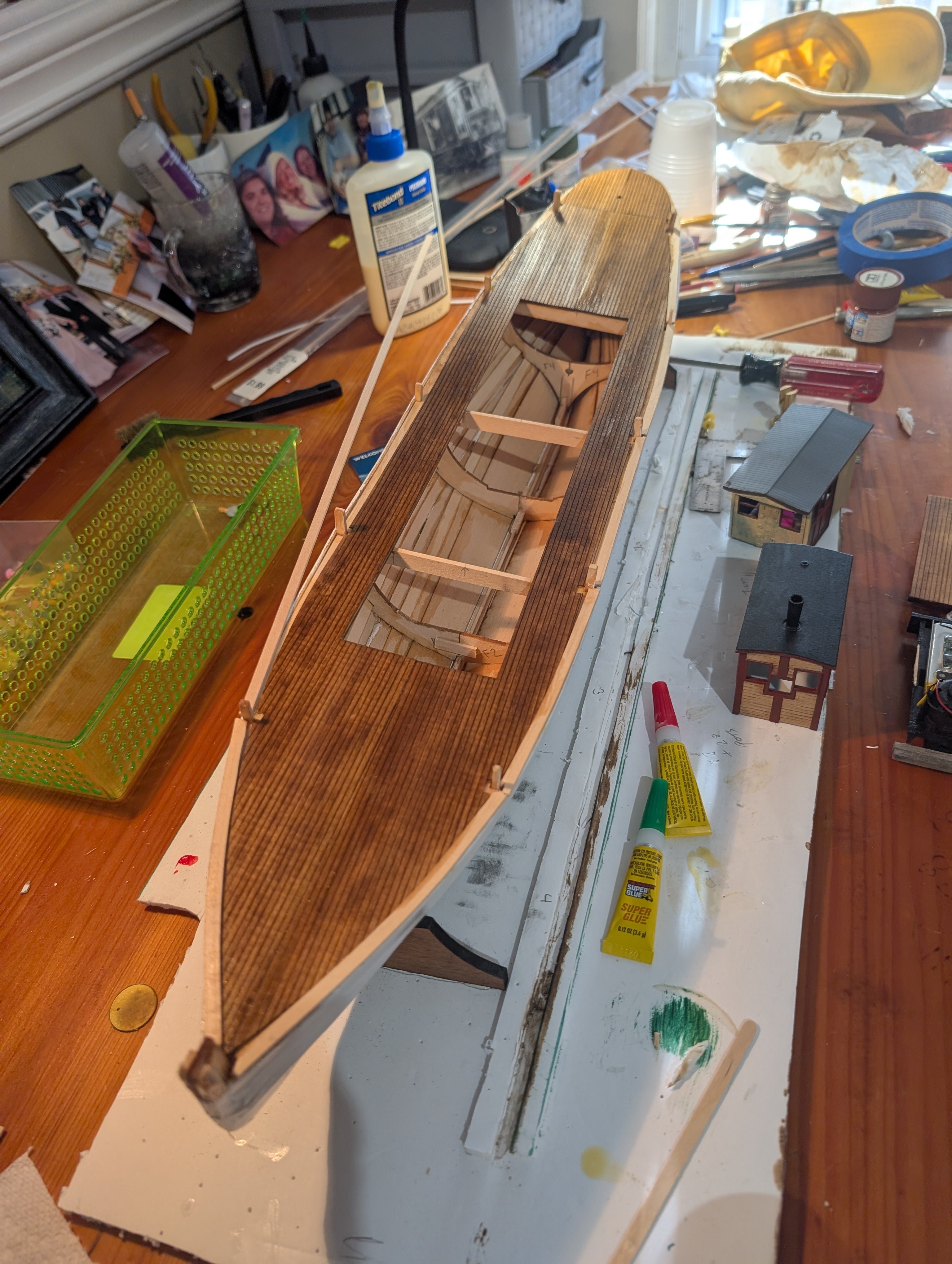

While waiting for the epoxy to dry I figured I would stain the decks. I used my trusted go to stain, Minwax Golden Oak. For some variety, i have a darker stain that can on the deck houses. I tossed around the idea of adding nail holes but I decided against that. Really not visible in this scale (unless they are bleeding rust).
  I also epoxyed the oak display stand that i put through Dad's old router table a few days ago. Pedestals were ordered yesterday. More on that when they arrive.

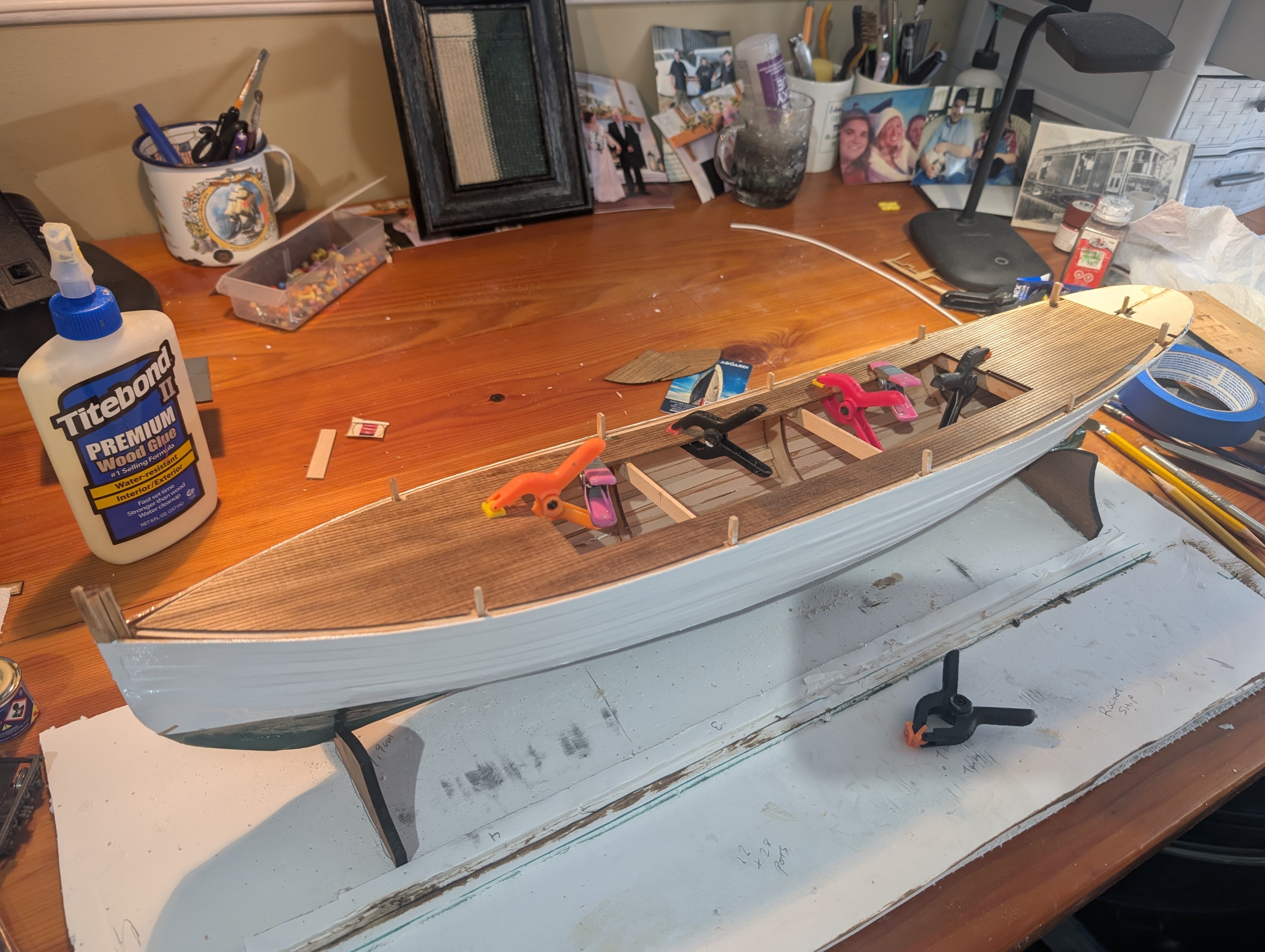

First coat of paint on the lower port side. I was intrigued by the use of green for the waterline paint. I believe it was Tim who used green. I usually use some version of red for antifouling paint. I dont know if the green is historically accurate, but its certainly a nice change.
Phil

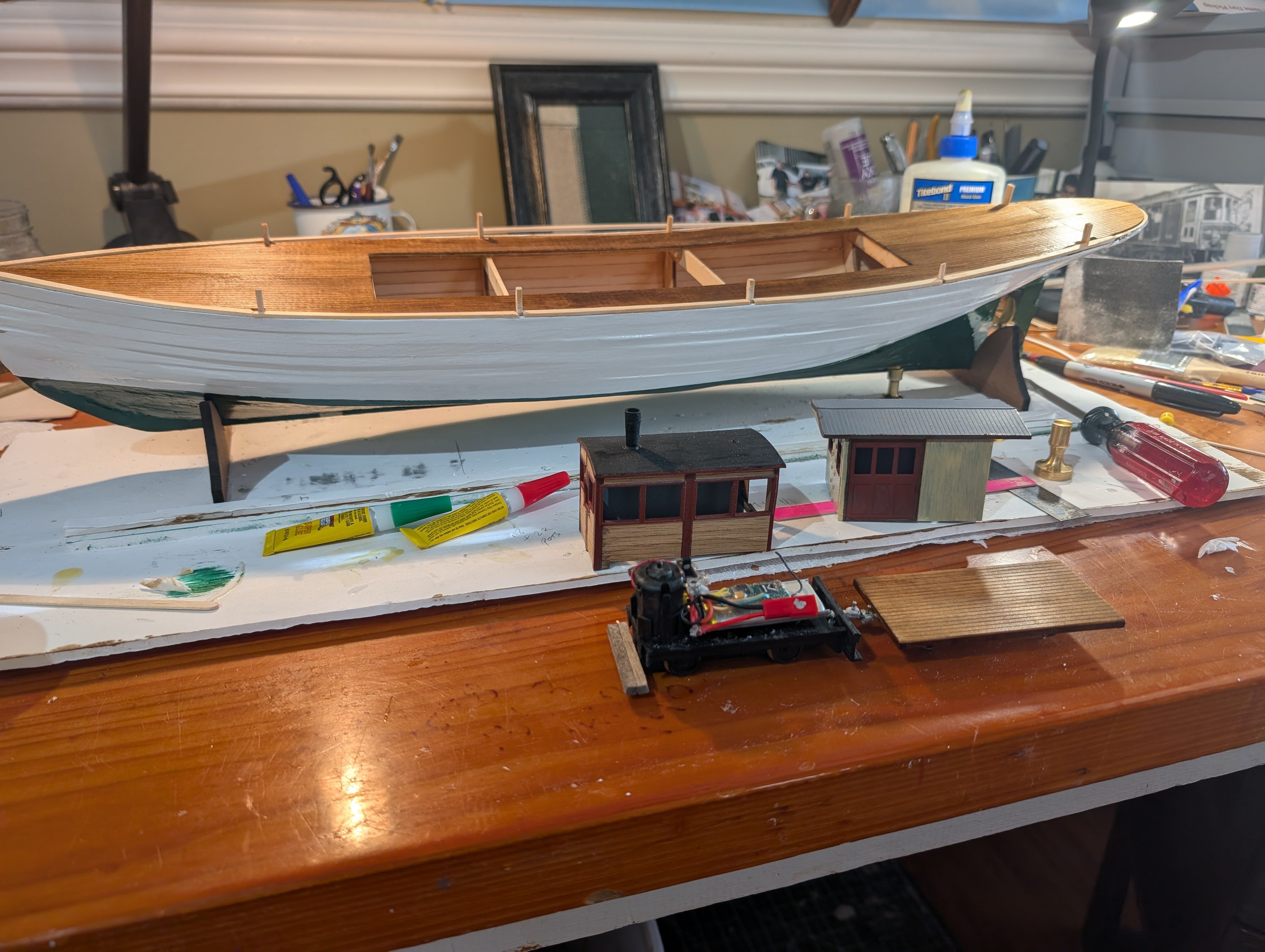

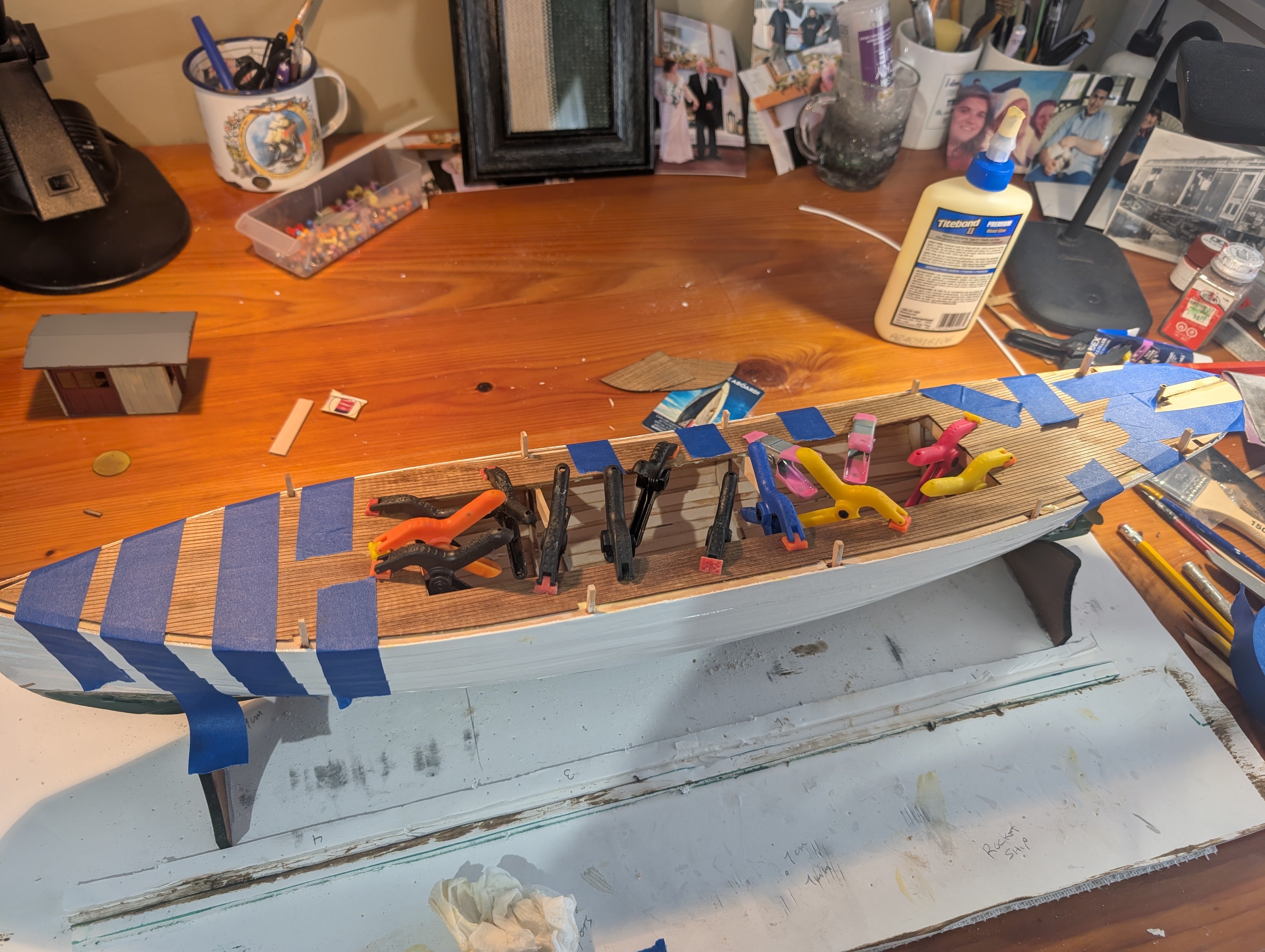

The painting is done on the planking. Now it is time to put the decking on which I think went fairly well. The scribed  decking was something of a challenge. To make the two edges meet up somewhat reasonably, I worked at clamping both of them down. When I had them butted up and in position acceptably I unclamped one side and then glued it down and put the  clamps back on it. Then I unclamped the other side, glued it down and put its clamps back on. It wasn't pretty, but I think it worked reasonably well.
Edited by Phil B
Deck panels glued down. Had some problems with adhesion on the aft section where the 2 pieces meet. Extra clamps and them some sanding after hides most of the errors. Restained the deck and am finishing up the waterways. While waiting for glue and paints to dry I do a little work on my On30 trains. Looks like a steam dummy and baggage car have snuck into one of the pictures 😁.
