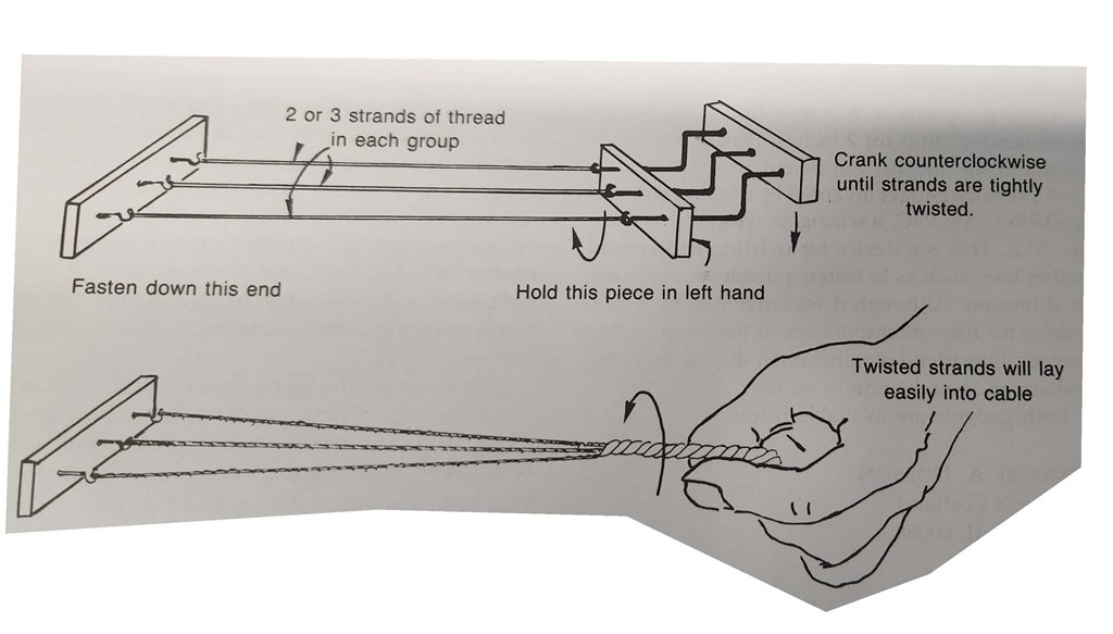

Just for fun, here is one of the the rope making ideas from a book - Ship Modeling From Stem to Stern by Milton Roth.  One of my go-to's back then, but I have since found it had a lot of not so sound information, mixed in with the useful stuff.
Here is some of the " Not so sound " information from Roth.  While the principle is OK up to a point, unless you were making rope out of rubber bands, this design would fail.
The upright on the right, which would be the ' looper ' on a working ropemaker, needs to be moveable, not fixed as shown here.  As the strands are wound, and the rope begins to set up, it contracts, and becomes somewhat shorter than the original strands.
I wonder how many people built this, and experienced the snapping of the strands.

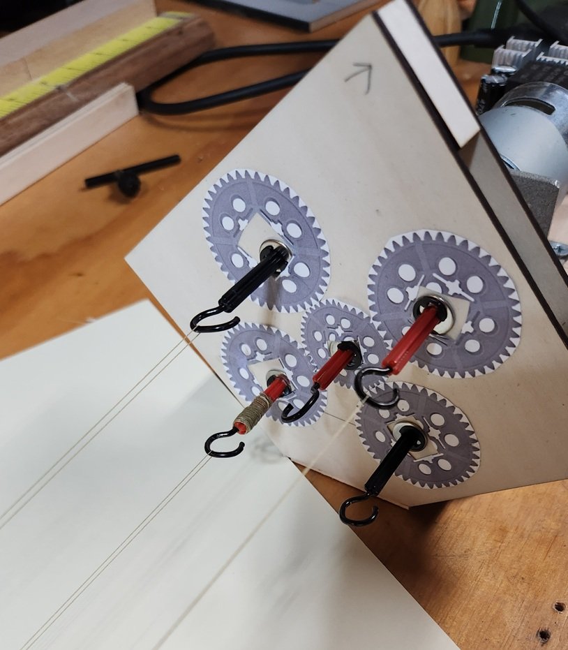

Here is the latest version of my Rope Maker.  ( Rope walk )  I believe this is what is called the Frolic style, but I didn't know that when I made it.
I put images of the gears on the outside, because they are sandwiched inside the framework I made of plywood.
I will explain the named components, then show a little more detail about how it works.
1. The Whorls.  The strands of thread are attached here. The whorls spin ( wind ) the strands to put a reverse tension on them.  Then, when that tension is released, the strands will twist together and lay up into rope.
This is the basis for full size rope making.   I believe the Rope Rocket has 3 whorls and of course makes great rope.   I added a 4th, which I rarely use, but it gives some flexibility with recipes.

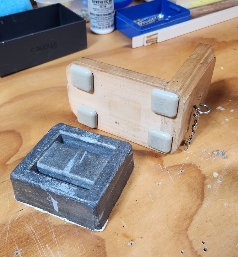

2. The Traveler.  The traveler for my rope maker is essentially a sled, to which is attached the looper.

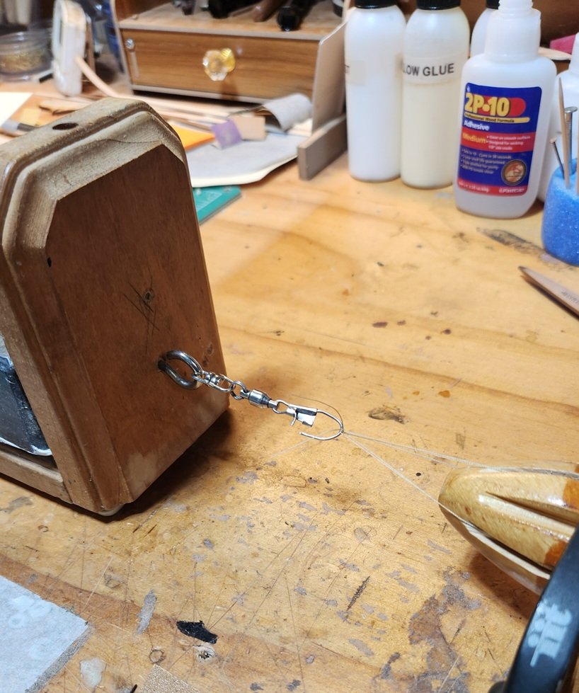

3. The Looper.  The strands are all attached together on the looper.   It will spin freely when the rope begins to lay up.  I'm using a little Fishing Swivel Snap Ball Bearing.

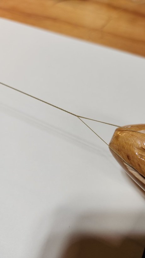

4. The Topper.  The topper keeps the strands separated while tension is put on the strands.  Once the rope starts to lay up, it will slide toward the whorls, with the rope coming after it.
Here is the driver for the whorls. It is a DC motor with a 20V power supply.  There is a variable speed, reversable regulator.
A good electric drill could be used, as with my original set-up, but I use this motor for other purposes.
My gearbox is made from Lego Technic gears. Those hooks (re-purposed eye screws ) have to be welded solid.  If they move in the shaft  you won't have even tension on the strands, which is essential for rope making.

The traveler is on Teflon pads so that it slides easily. The diver's weight is necessary to keep it from sliding too easily.  All to keep tension during the making.

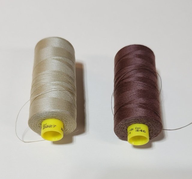

I use two colors of Gutermann polyester thread of various maras.  For light colored rope I use 2827 and for dark 446.
Here are the various sizes ( Maras ) I have for making different size rope.

This is the looper end. The topper holding the strands apart prior to laying up.

A shot of the rope starting to lay up.

One difference is that the gathered strands at the tail stock were on a 'swivel' that could also counter spin as the rope was laid.
image.png.786e67a683811d711d18cf0ed856dbe5.png,
Assuming the 'tailstock" is what I call my 'traveler',  There is also a swivel that I described above.  This allows the rope to twist and lay up in it's effort to overcome the tension of the twisted strands.
