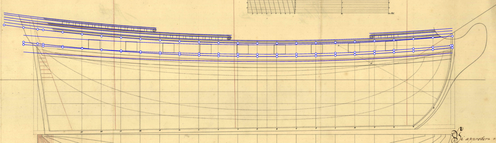

Above, the plans for Wildmanden. Although a fregatten by Danish denomination, her dimensions are more akeen to a british sloop of war, or a french corvette.

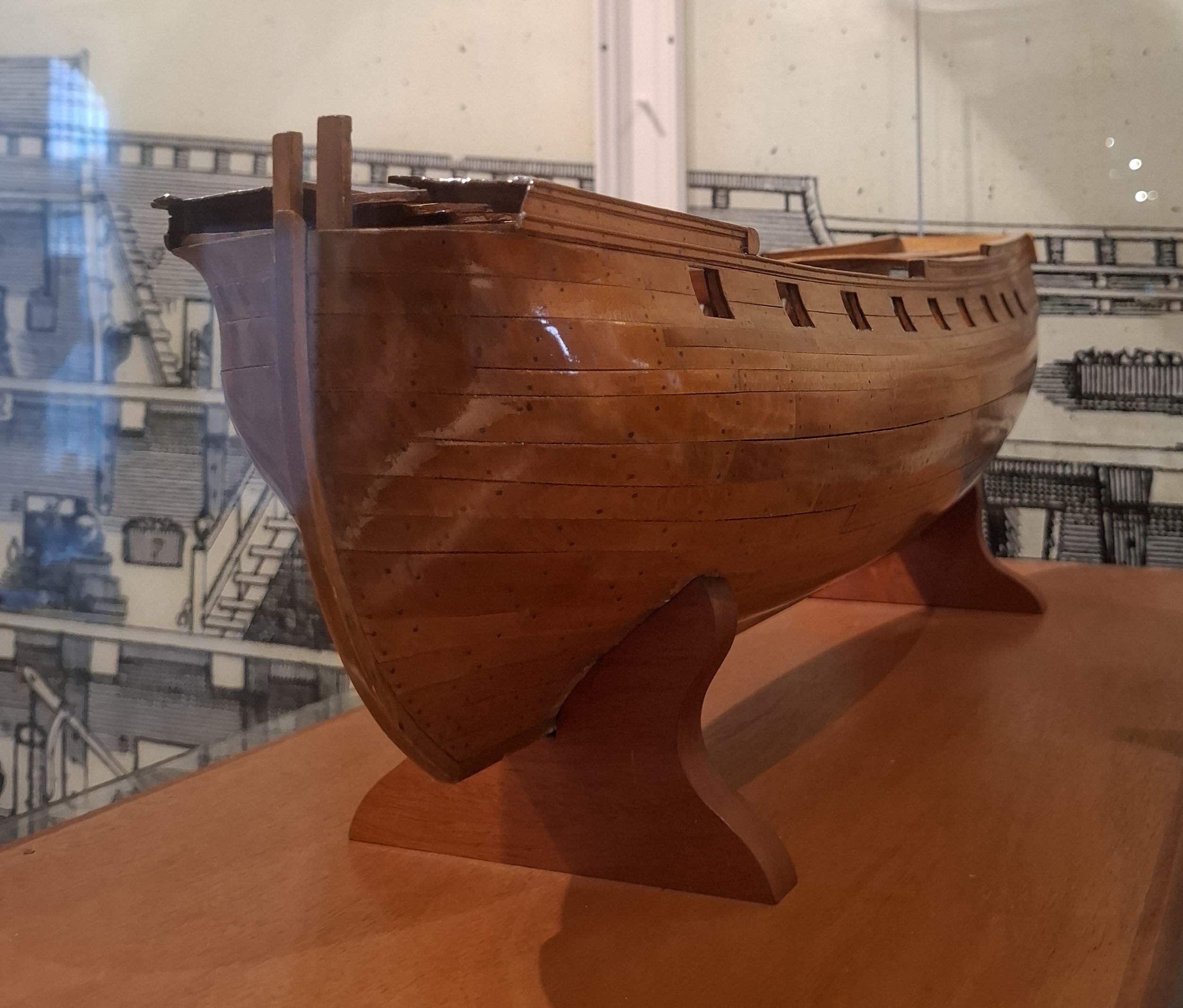

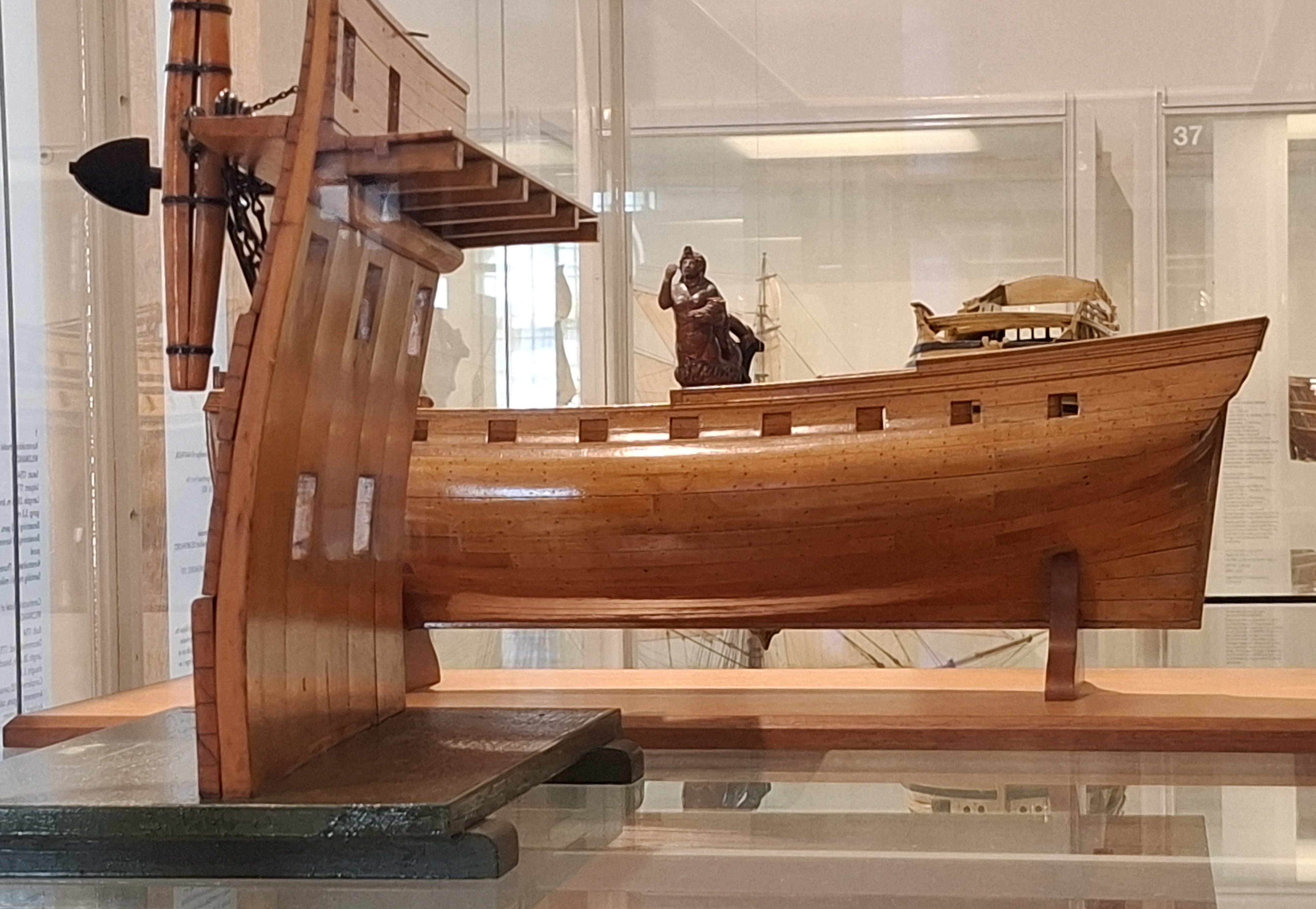

The Krigsmuseet holds a contemporary model of Wildmanden, unfortunetely, I could only find two photos of it. If somebody happens to have some more angles of the model or otherwise happens to visit the museum and would be willing to snap me a couple more images, it'd be much appreciated!

These old model hulls in museums look like they were tainted to look as dark wood and lacquered.  Is this correct observation? I am interested how these models were finished. May be they were not finished at all and collected and old look with time?
@Y.T., sort of. I don't really know of any examples where the wood was tinted per se, but shellac or plant oils were commonly used to finish these old models, and those have some color to them. The old look comes from oxidation, grime, etc., of the wood and finish.
Edited by Arthur Goulart
I also enjoy how the planking was done at the bow. Looks like planks were cut out curved off the sheets of wood rather than force bending the straight ones. The planks lay out so naturally and almost perfectly parallel to waterline even at the bow.

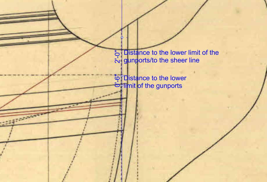

I always enjoy a more unusual subject! Wildmanden certainly shows nice lines. One curious point: the line of the wale looks to be conventional on the draught, but the last photo of the model appears to show this rising aft in a very odd fashion.
There are some outstanding contemporary models for sure, not surprisingly, when you consider some of them were made for the royal, some were made on comission by important people, some were prized gifts. @Beckmann a couple days ago linked me to an article of his that showcase some of the finest Danish models:  https://www.arbeitskreis-historischer-schiffbau.de/mitglieder/ontour/schiffsmodelle-in-daenischen-museen/ .I take it you're probably already familiar with the models on RMG's website, besides that, I'd suggest you check out the Roger's Collection, the collection of the Musée National de la Marine, the Museo Naval de Madrid has a lot of their models on their instagram page, be aware though, that is one rabbit hole that you can't get out of 🤣.
Happy to have you here @druxey! You touched on a good point there, the sheer plan is deceiving with regards to the wales. The 'midship section plan' (or however I should call it lol) suggests the ship wasn't built with two standing out wale strakes, rather, a more french approach was taken. The space between the lower and uper wale strakes is filled, and the planking gradually diminishes from the lower strake towards the rabbet:

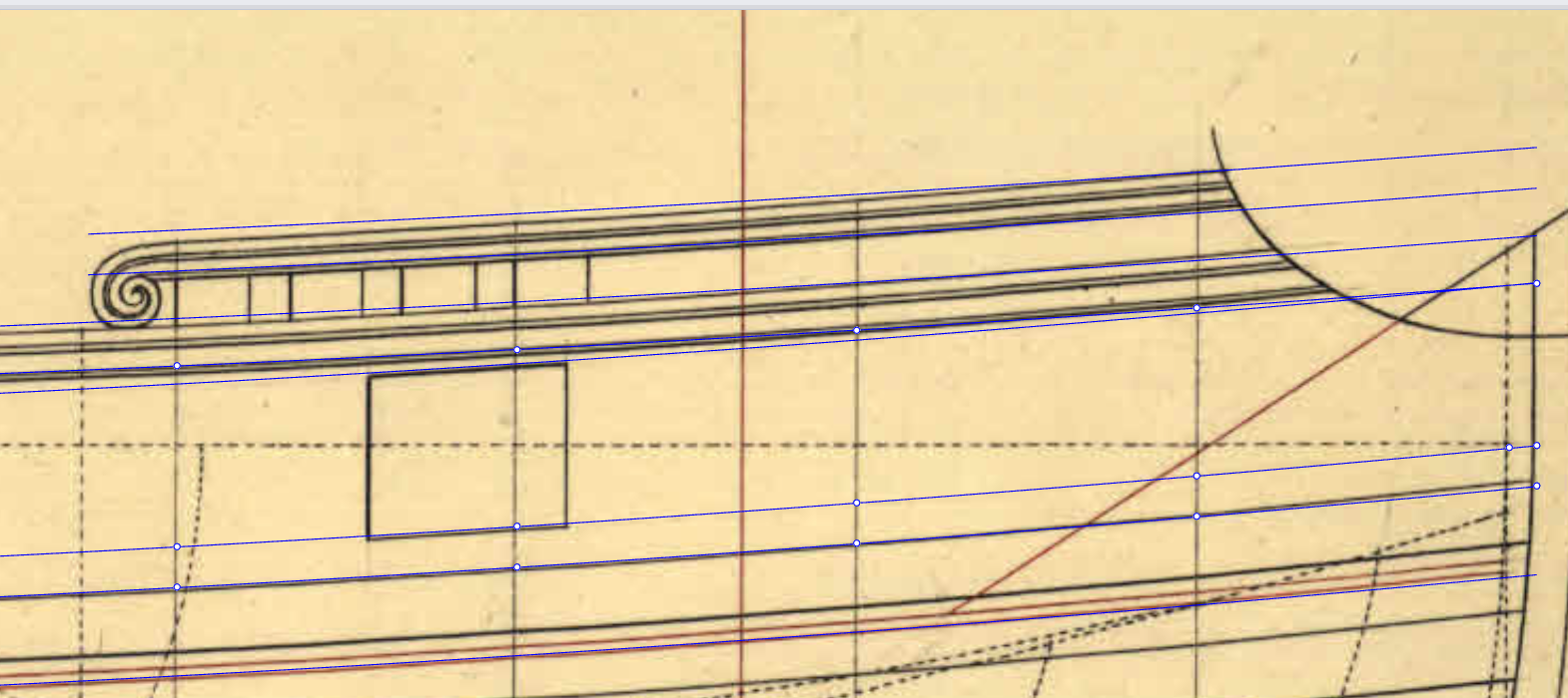

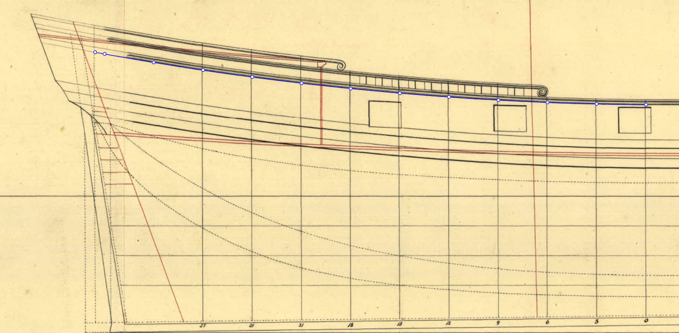

So, what I'm making of the model is that the wale line is actually here:
But then again, very hard to tell. Hopefully some better photos can clarify it in the future.

Regarding the wales, I think you have it right. The drawing clearly shows the upper edge, just below the gun-ports. The middle frames for (almost?) all Danish ships after around 1730 does not show the thin double wales of the previous century, but rather these thicker ones, or even as this one just thicker planks that get progressively smaller further towards the keel.
However it is puzzling, as the contemporary paintings often still show two thin lines for wales all the way up to Gerner's time in the 1770's! Perhaps they were just painted this way at this point in time?

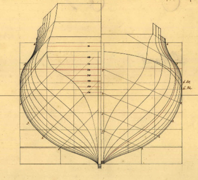

Note that in Danish practice it was common to position the frames perpendicular to horizontal waterline, and thus in a kind of ladder on an inclined keel, so in this case the stations on the plan do represent the shape of the frames.
see A 1126 b inboard view
https://arkivalieronline.rigsarkivet.dk/da/billedviser?epid=17149179#208246,39521729

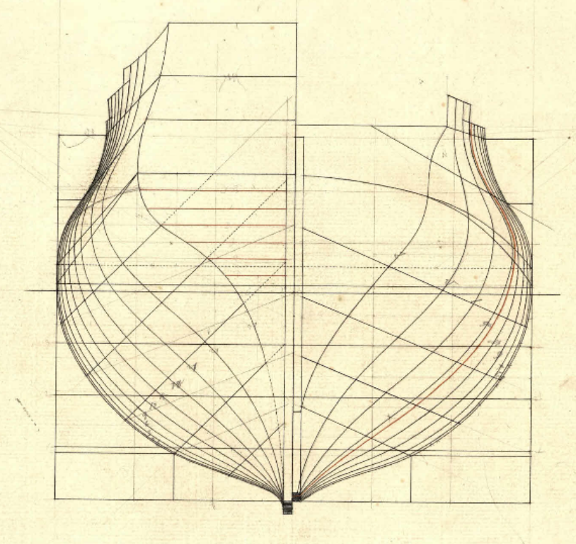

Also note that both A1126 e and G 2793 plans show an apparent correction or some auxiliary line at the 4th station that would likely require an explanation (in red)
image.png.b27b453b799a006cb4c554eae5c78fd6.png  image.png.2fdb3e5623f2324151b1ebfff3cea4c0.png
Edited by Martes
This must be the outline of the fore quarter frame, which has special significance in the design. The set is completed by the aft quarter frame, but this almost coincides with one of the regular bends and has not been drawn separately.
Do you think it could be a difference between warship and merchant ship practice? And so painters would eventually get it wrong? The models seem to agree with what we see on the plans. Take a look at this illustration, the ships have their wales outlined with black lines, but the wales themselves are wooden in color:
The image deviates from the gradually diminishing wales we see on the plans, yet, it suggests that what is seen on other illustrations isn't a matter of how the wales were painted.

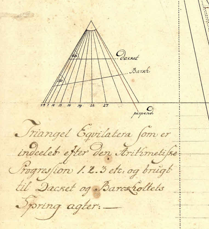

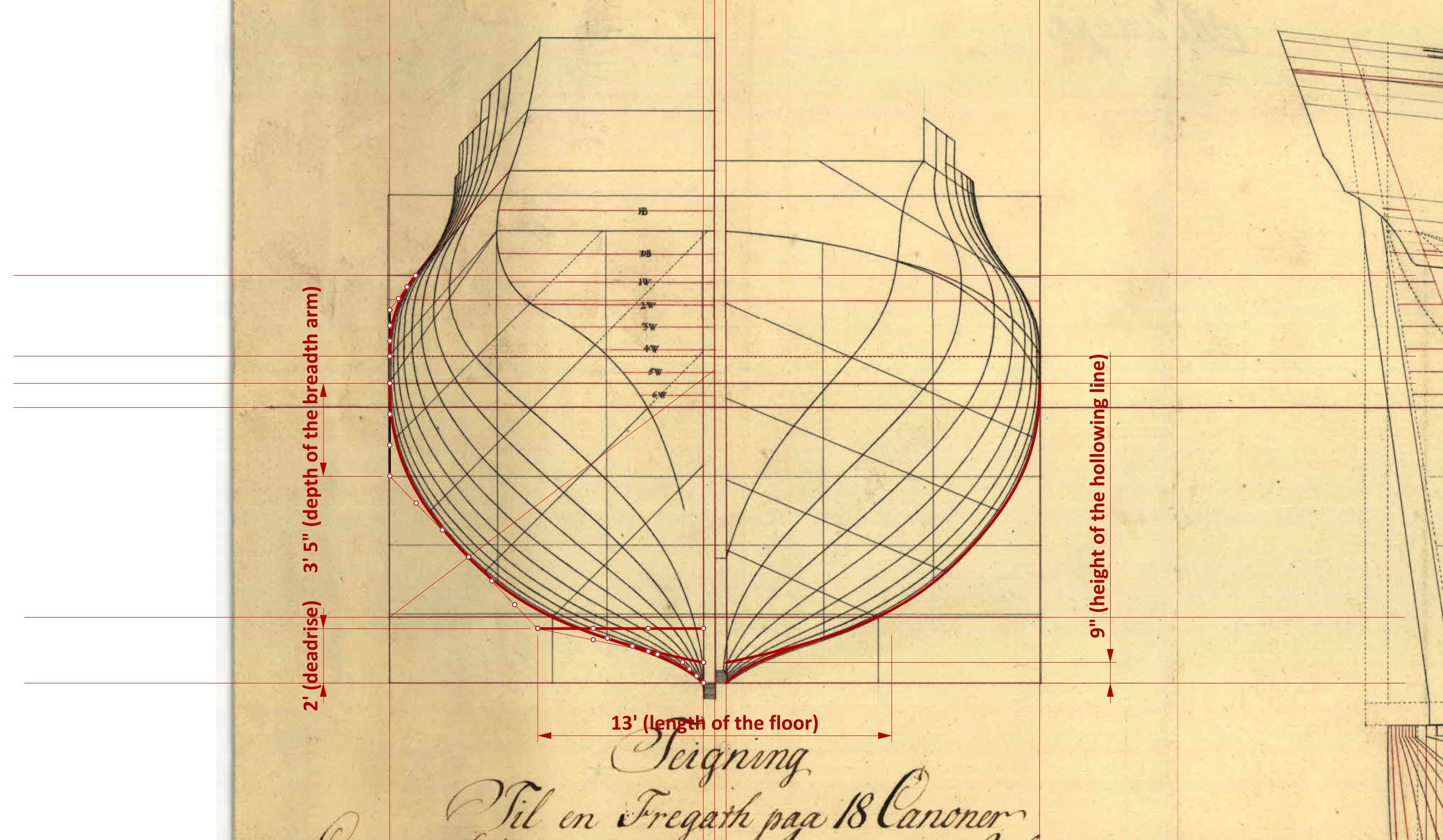

However, Turesen gives instructions for the midship frame on A1226e it is made by only two arcs below the breadthline, a smaller one tangent to the breadth, and a larger one, that starts tangent to the smaller one and intersects the end of the floor timber. Above the breadth, two more arcs, again, a smaller one tangent to the breadth, and a larger one, tangent to the smaller one that ends on a point at the sheer's height that has 4/5th of the midship's frame half breadth. All radii are some proportion of the breadth. That's what Turesen describes:
That leaves the hollowing curve unexplained, hence the other topic I started. I haven't yet looked into what you pointed me towards though, the Boudriot's articles.
The reduction of the frames is done by the french equilateral triangle method, aided by a Luff frame, which I think I've seen in english as a quarter lenght frame, something of the sort. It's an intermediary frame (in red on the figure above) that defines the angle by which the ribbands are applied on the equilateral triangle.

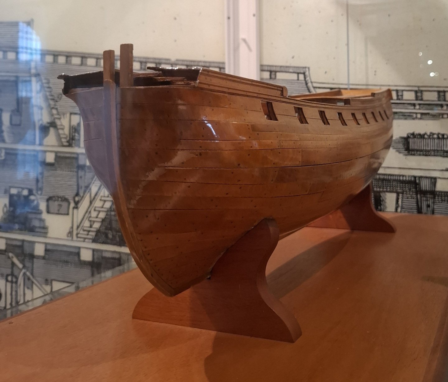

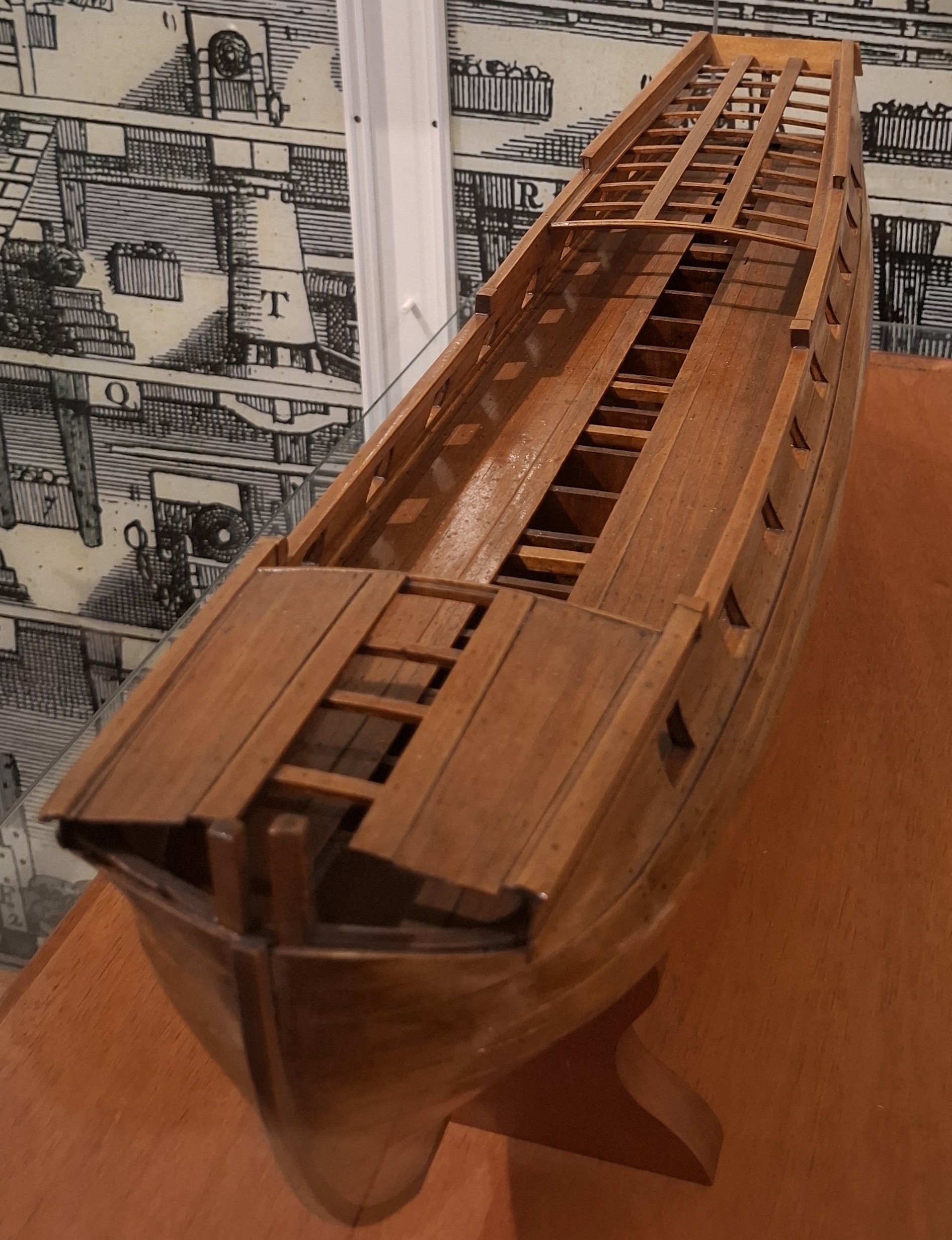

3 hours ago, Beckmann said:
I looked up my photo archive, here are some more photos of the fregat Wildmanden.
Matthias, thank you very much! Those are great. They confirm my suspicion about where the wale line is on the model. There are some very weird wide planks on it though. Do you guys think that could be a correct representation of how the real ship was planked? Surely not, right?
Correct! On A1226e you can see it separately. The aftside should have a quarter frame too, but it's too close to one of the actual frames, hence why I think it was not represented.
Well, painting of ships was always somewhat fluid, subject to paint availability and all, and not necessarily coinciding with the run of the planking at all.
From construction point of view, at least in 1807 it was observed by the British (Naval Chronicle article about the captured ships) that on the Danish ships the wales are blended into the planking, thus preventing accumulation of filth.
The decoration plans follow the French practice, that usually shows the uppermost and the lowest planks of the wales, creating an illusion of having two. It's purely a drawing convention, however.

Yes, and yet in this case, it is the harmonious division of diagonals, as described in French works on naval architecture, and not the parabolic method of shaping frames. I admit openly that in this case I made a mistake in identifying the method, and my only (un)justification is that I unforgivably jumped to conclusions without a complete analysis of the case, as should be done and as I usually remember to do. Sorry. However, the other comments remain valid :).
At this moment, I am able to relatively quickly explain the issue using the sample of an American frigate proposal by Humphreys, since I am working on it just now. However, different design specificity can make it not quite valid for your particular project by Turesen. I need some time to try to resolve this issue using the case of Wildmanden

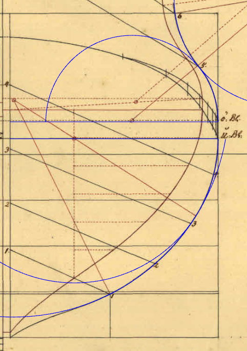

I think I've found a way to generate hollowing/bottom curves that works for Wildmanden. Take a look at the diagram. The yellow lines are hollowing/bottom curves generated in a geometrically consistent manner, according to the progressive scale for the fashion piece from Turesen's plan. The thick red lines are auxiliary construction lines defining these curves.
If you are interested, I will be happy to explain the details that may not be clear from the diagram alone.

GUNDECK, SHEER LINE AND WALES

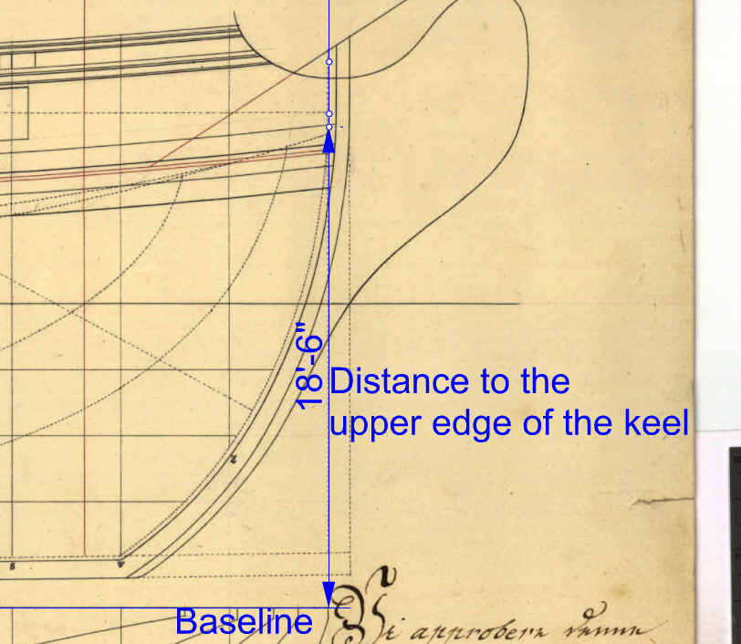

As already noted, Wildmanden, was designed leveled to the waterline rather than the base of the keel. That's a method that is never seen on English plans of the period, that isn't the most frequent with French ones either, but that was common in Nordic practice.
What it means for this chapter of the Wildmanden reconstruction is that all measurements make most sense when taken not from the rabbet and up the perpendicular, but rather from the waterline, or, better yet, from the line that is paralel to the waterline that starts on the lowest edge of the keel aft, henceforth I will be calling baseline. From the baseline up the perpendiculars, the heights for the ends of the curves that form the lower and upper limits of the gunports, the wales, the sheer are the rounder, and I mean, so neatly round it can't be a coincidence, and I'm convinced I got the heights chosen by Turesen right. Let's see:
The lower side of the gundeck is offset 1'7" relative to the lower limit of the gunports. The upper and lower gunport limits, as well as the deck, ends at the same height aft relative to the baseline as fore. The sheer line drops 1'6" in height amidships, then rises 3'0" aft. The upper edge of the wales ends aft 2'0" above the lower side of the gundeck. The freeboard amidship is given by Turesen as 5'6". I think that shows the point, except for the lower side of the gundeck (which makes sense), all dimensions can be explained with a 0.5 feet precision. Interestingly, a proportion can also be observed when comparing Wildmanden to the unbuilt A1246c brig. On both cases the deck/gunports line rise fore and aft 1/3rd of the freeboard.
Now, to the more interesting part of today's post, how these curves are formed.
The shipbuilding manuals of the period I've read so far really overlook the description of these curves. Not only the shipbuilding manuals, I was overlooking the lines myself, I had a sort of working solution, but without a basis in literature or something else for it. That's when I stumbled upon a specific plan, G1228 (which, by the way, lovely looking ship, I'd love to reconstruct it in the future too). That plan is for 60 gun ships built based on Fyen (1749), that TJM taught us about. On G1228, the method for forming the deck and sheer lines is represented:
The plan, is unsigned and from 1758, by then Turesen had died. However, the plan also informs that the Storman, the Island, and the Seyeren were built to its lines, ships that went through Turesen's hands. The previous plans for the type available on the archives are all from 1750, before any of the three ships was finished (and maybe even started, I'd have to check). The older plans show a different deck layout, and don't demonstrate its forming. The fact is, even if Turesen wasn't responsible for showcasing this progression based method for drawing the decks, he certainly was familiar with it, and I think, that is the practice behind Wildmanden's lines.
It works quite simply: a progression is made by setting whatever length, let's say 1 inch; from the end of this first length, 2 more inches are set off; then 3, and so forth. As many lenghts are set as there are perpendiculars from the master frame to the stem or sternpost. Connect it all to the apex of an equilateral triangle, as seen above. That forms a ratio that is applied to the amount the deck, sheer, wales rise. In Wildmanden's case, for example, the deck rises 22 inches: 15'7" is its height from the baseline amidships, and 17'5" on both extremes. That ratio determines how much the curve rises on each frame. I hope that makes sense to everybody reading.
But, the only way to know if that was indeed what was done on our ship, is of course, to try it out. And that I did, but not only on Wildmanden, but more importantly, on the unbuilt A1246c brig. Any variation of the method I tried was kinda good enough for Wildmanden, since the curves on it don't rise all that much when in relation to the frigate's lenght. On A1246c, on the other hand, the sheer skyrockets (technical term 🤣) up aft. So, I tried using a 1,3,5,7... progression, I tried applying the sheer rise to the equilateral triangle on different angles (as is seen for the sheer line of the 60 gunners above), I tested different progressions fore and aft, I tested the progressions on the wales, and so on. The conclusion is that the 1,2,3,4 explained well enough, actually, more often than not, explained the best, all the different curves. 1,2,3,4 progression applied on A1246c:
Pretty good, right? There is that principle where the simplest explanation is the most likely, I think it applies well here. No need to go extra with it when 1,2,3,4 is enough.
That's how it looks on Wildmanden:
There is one spot where my curves don't line up so neatly though, the fore part of the sheer line and its parallel rails:
I could have the sheer's curvature align better with the plans by changing my method up, but that feels criminal. I mean, what that would imply is that Turesen used one same method for the wales, for the deck, for the gunports, for the aft sheer, but for whatever reason he decided to mix it up to get a very slightly different result on the fore sheer. Also, the upper forecastle rail seems like it should be half an inch narrower. Which, also, I find unreasonable. The correspondent quarterdeck rail is 6 inches wide, what's the point of making the forecastle half an inch narrower? What seems to be at play here are some more sloppily drawn curves rather than an intentional variation of technique.
What do you guys think?
That is very neat and clever, Waldemar! Those were the lines I couldn't wrap my head around. You've arrived at an explanation that produces a very spot on result and that makes sense. The one thing I didn't understand is how you came up with the position of the thick auxiliary construction lines. Could you elucidate it? Thanks a lot!!
I used to think that I understood pre-modern ship-design methods.
And now you show me how wrong I was!
Time to go back to the elementary class and start over.
Trevor
