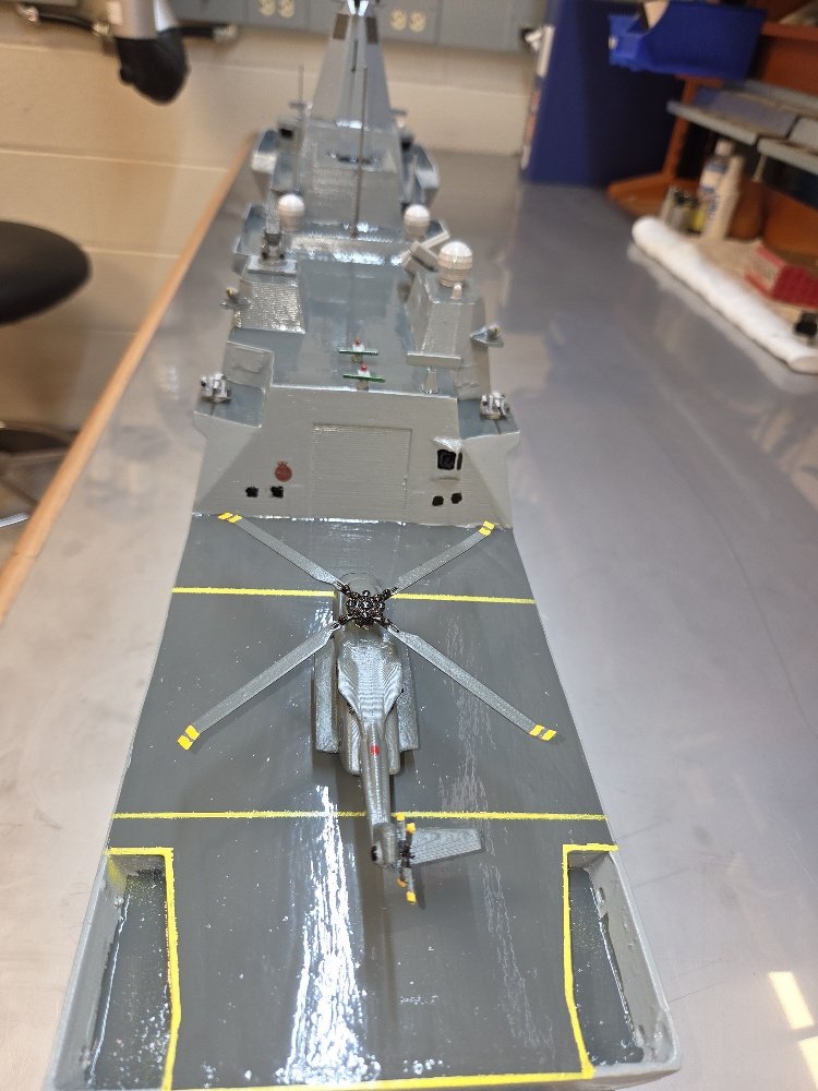

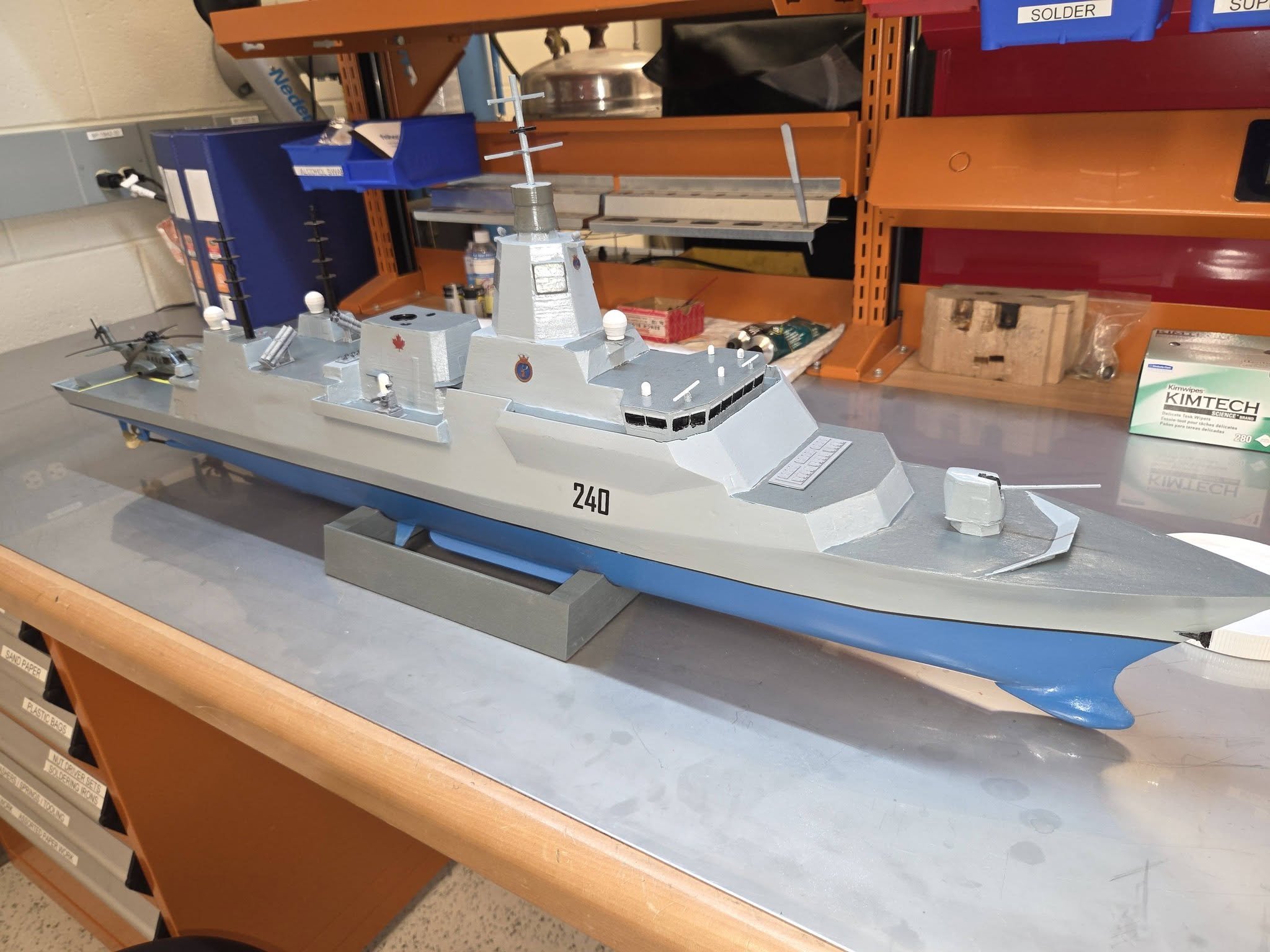

And here we are, HMCS Fraser DDH 240 is complete.
Decals are applied and clear-coated.
I'm generally pleased with how she looks - hull #2 will be better - second coat of putty was just applied.
Hull #2 will also have a more accurate weapons loadout - I've made a model of both the SEA RAM launcher and the NSM, so CIWS and Harpoon will disappear on the next version.

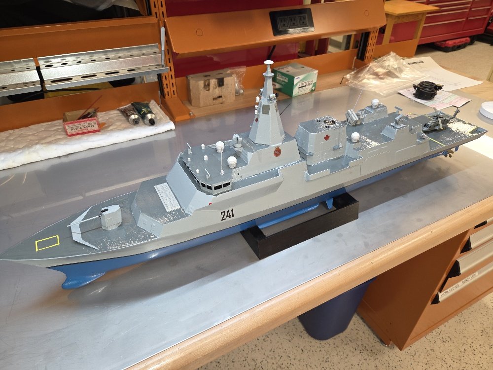

V2 is ready for decals, and some of the 'detail bits' have been glued on.
Brad/NavyShooter

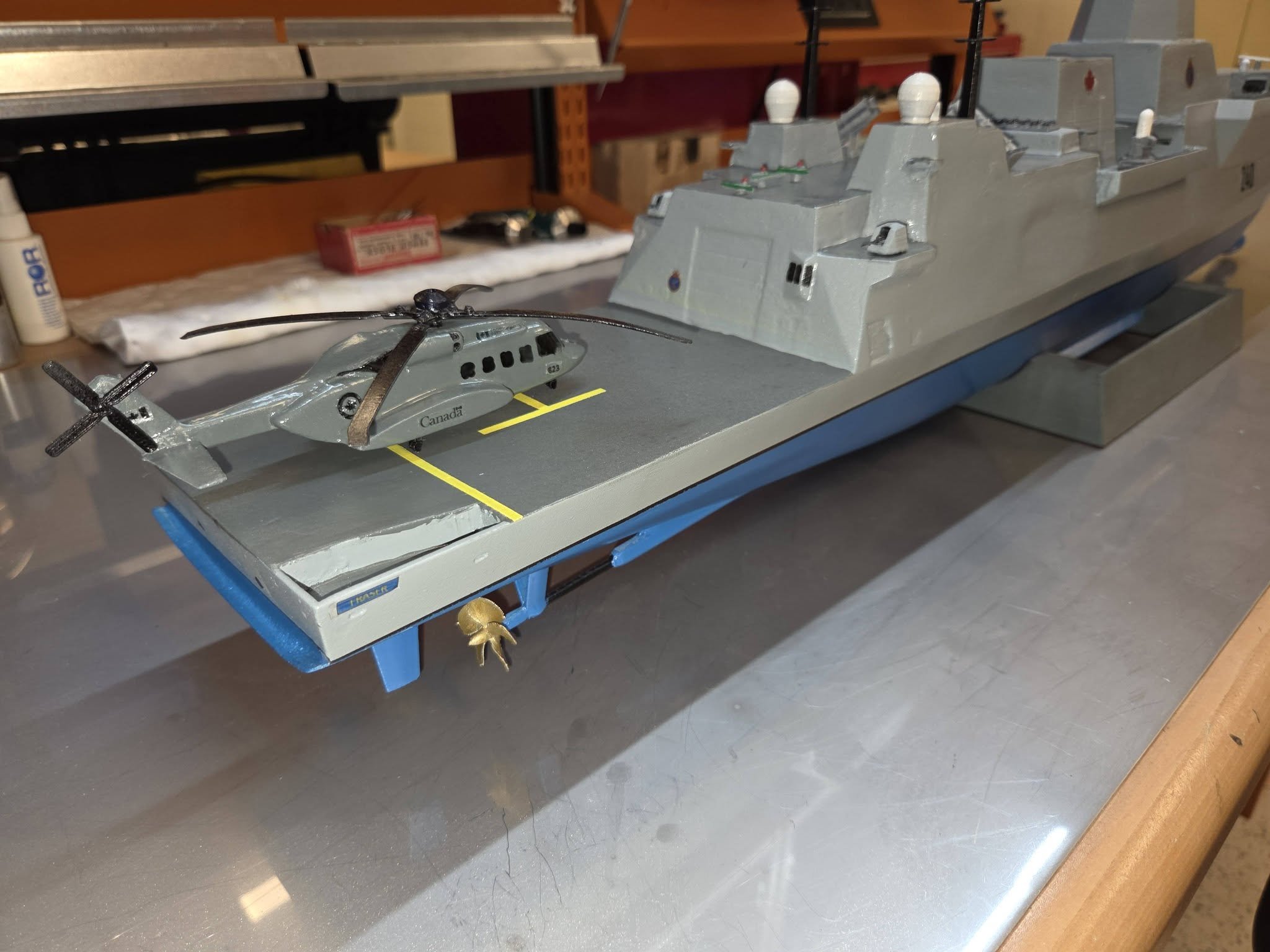

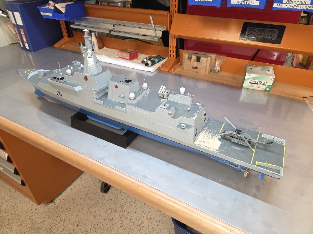

Hoisted a flag (ok, it's glued in place...whatever....) and am calling V2 complete.
Here we have DDH 241 - HMCS MacKenzie
The next one will be the first of the R/C version(s?) - we'll see how it goes.
I'm quite pleased with how this is looking. I understand that this is closer to the 'actual' look, but not quite correct - V3 has further revisions to the superstructure to match the RCN version more closely.
Brad/NavyShooter
Is the RCN weaponry, more specifically the SSM and RAM equipment supposed to be installed in these positions? The RAM not being centered I can understand, but I'd at least have expected the SSM (Kongsberg NSM?), to be devided between Portside and Starboard side?
Roel
I have no formal confirmation as to exactly where things go, so this is my 'best guess' based on some informal chats with some friends.
I'm open to being incorrect....in fact, I know there's parts of this model that are wrong, but that's OK since the ships themselves don't even exist yet.
Nice thing about it being a 3D design is that I can adjust on the fly, and V3 will be closer than V2....and V4 will be even closer still.

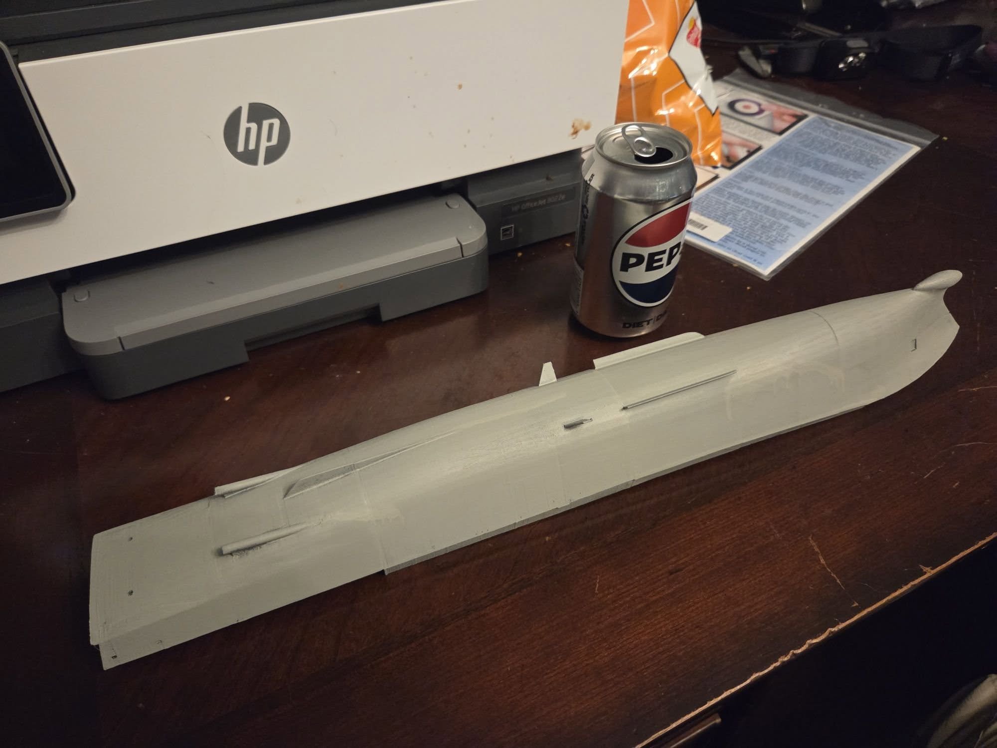

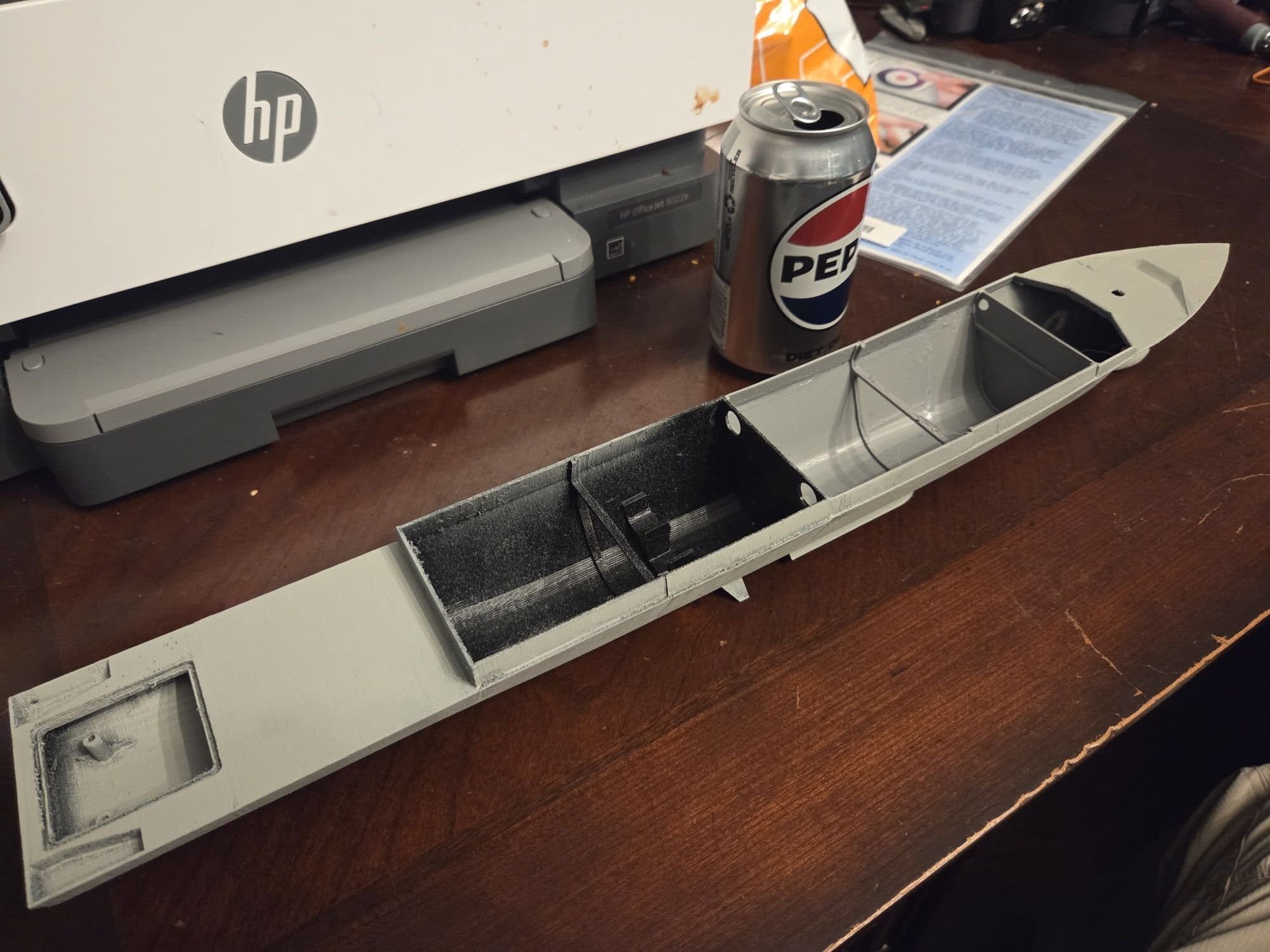

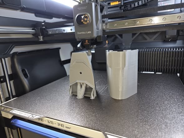

OK,
New printer (Bambu H2S) is setup and running now.
I've got a re-do of the hull for the R/C version printing at 1/288 scale as a test, and if that goes well, I'll click 'print' and on Monday I'll have a 1/144 sample hull waiting for me in 4 segments.
Brad/NavyShooter
Here's the forward half of the ship - printing at 'ludicrous' speed now.  It'll be done in...17 minutes.
Wow.
