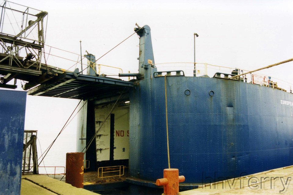

The website "CGTRADER" has several very nice candidate 3D builds, but I settled on this ferry named "MV Europic Ferry" which was built in 1967 and plied the North Sea initially between Harwich and Rotterdam in the 70's. Her capacity was 60 passengers in cabins, 50 cars and 60 commercial trailers, or 295 metres of cargo.She had all superstructure forward, and two vehicle decks aft; one on the upper deck and one on the deck below. It seems there was a hydraulic ramp between the two vehicle decks. Interestingly, apparently, she only had a stern vehicle door so somehow they had to turn around while aboard......not sure how that worked!

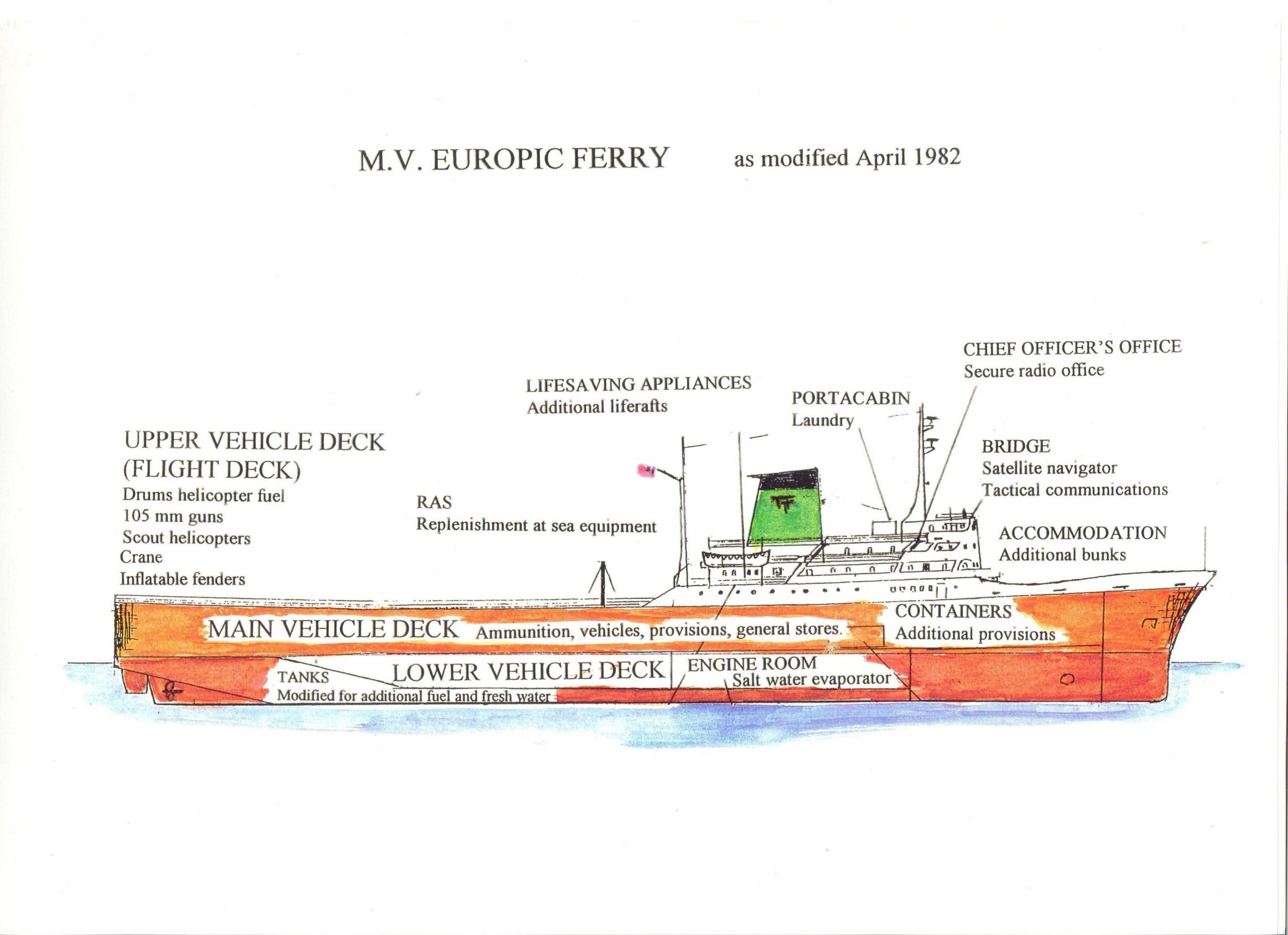

As an aside, she was actually expropriated by the UK government in 1982 for the Falklands war, sailing with the fleet carrying stores, troops, and equipment such as helicopters to the south Atlantic. She returned with  grey paint blotted all over her as a home-made camouflage scheme.

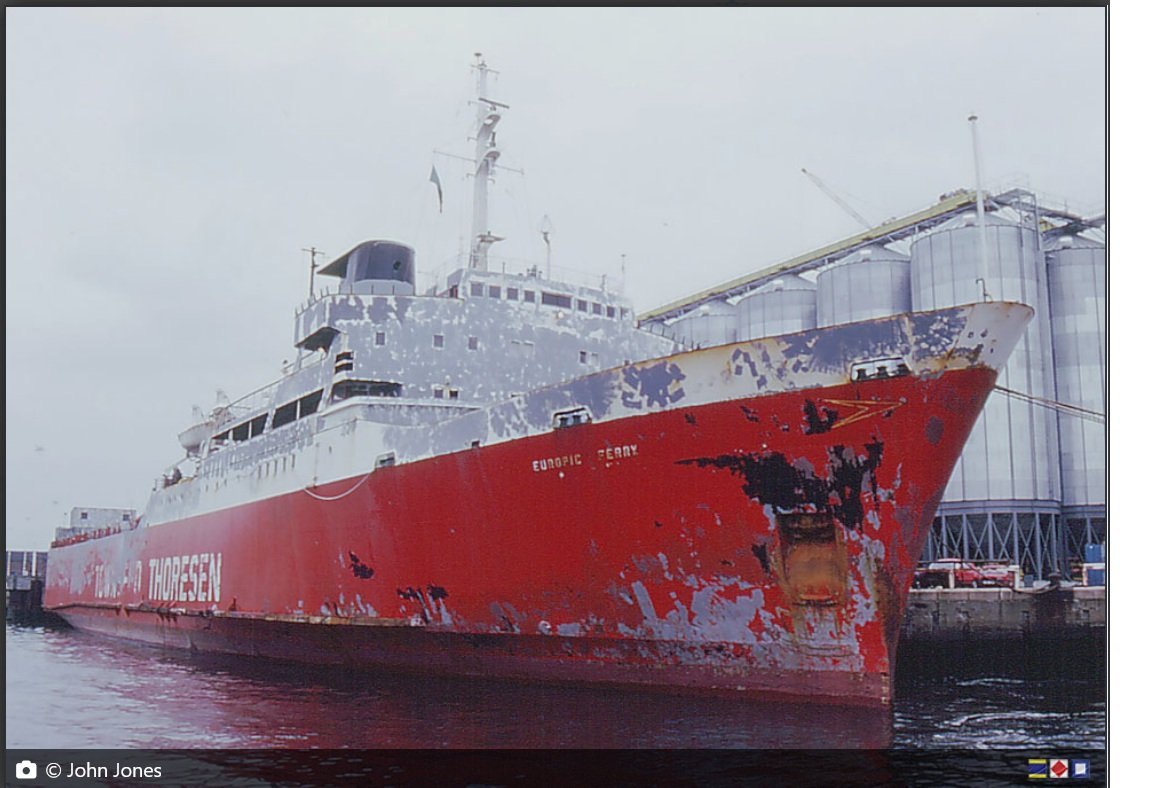

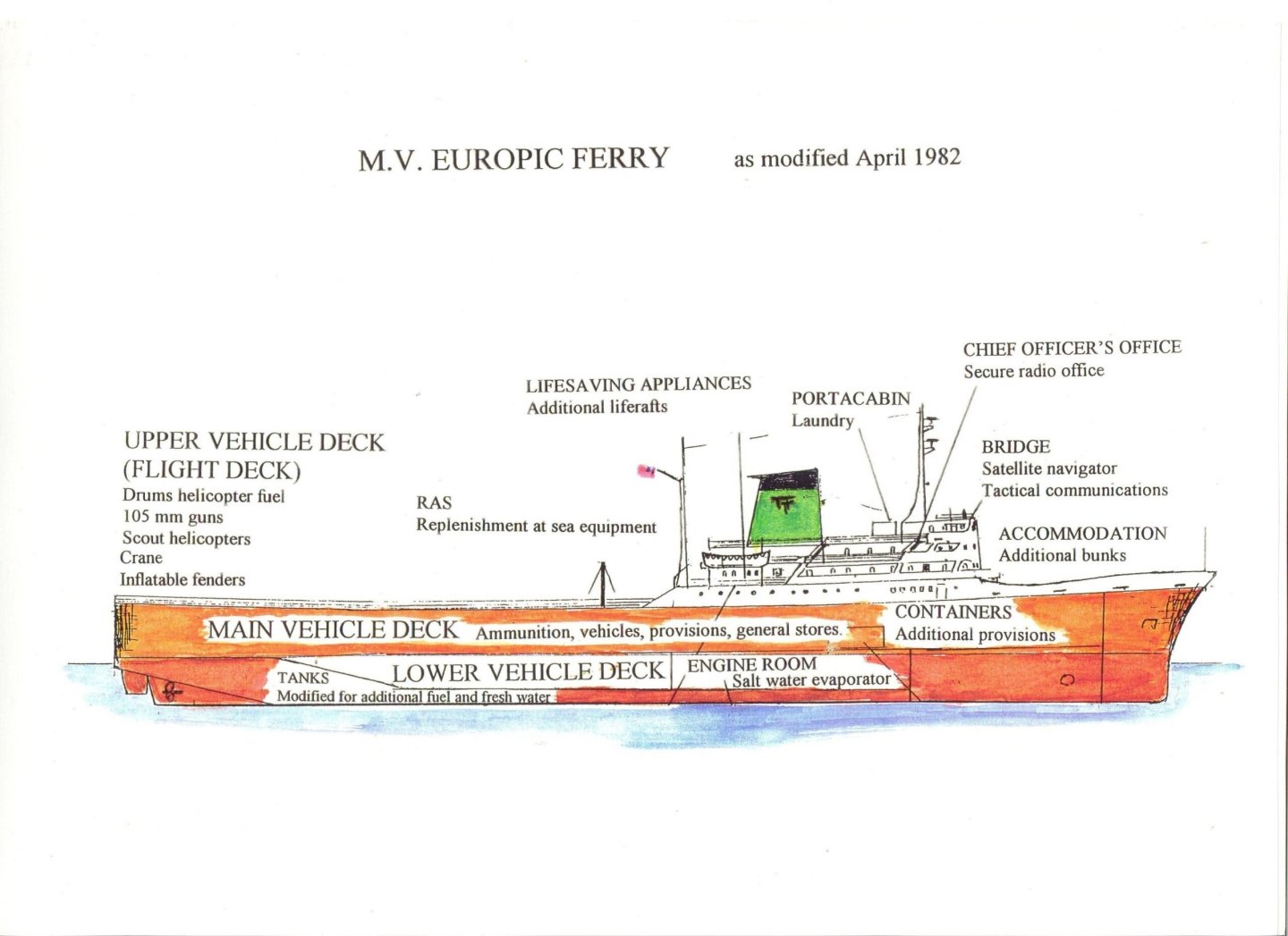

Returned from the Falklands with home-dabbed grey camouflage -
In later years after being sold, still operating in the Channel.

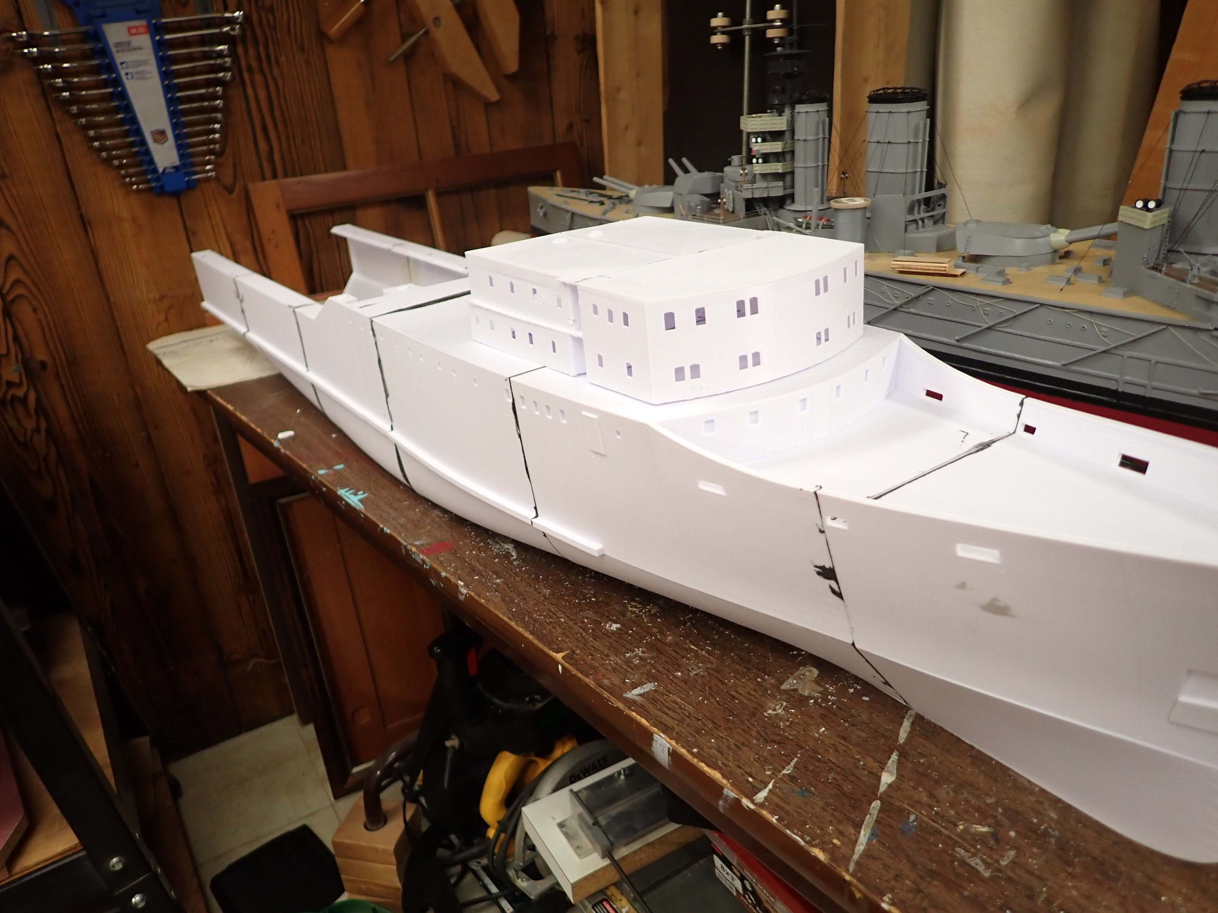

I've had my Bambu A1 printer for a year now, but up to now I've only printed various small bits for Lion. So far I have printed four hull sections of the eight required, the first three at the bow and the last piece at the stern.; it's a new experience for me as two of them took more than 20 hours each to complete.

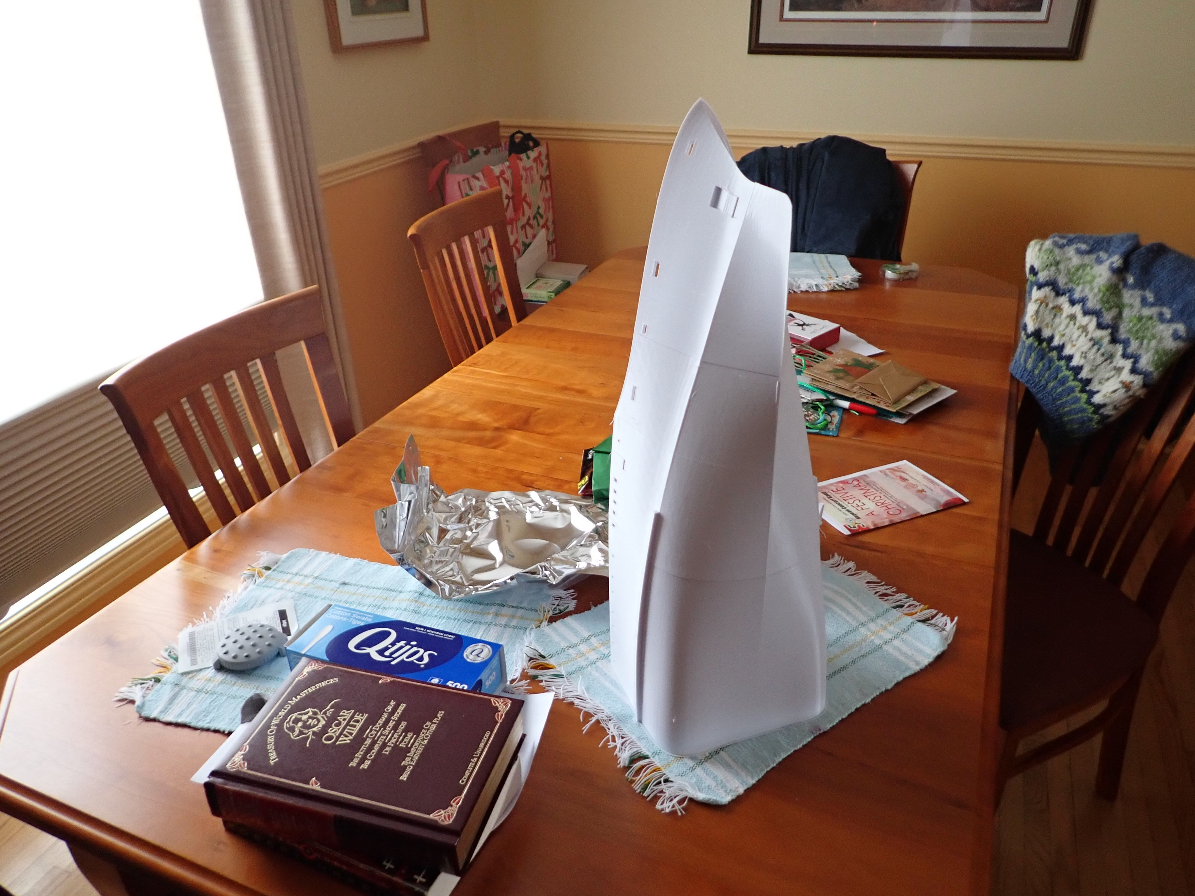

Here are the three bow sections just dry assembled.

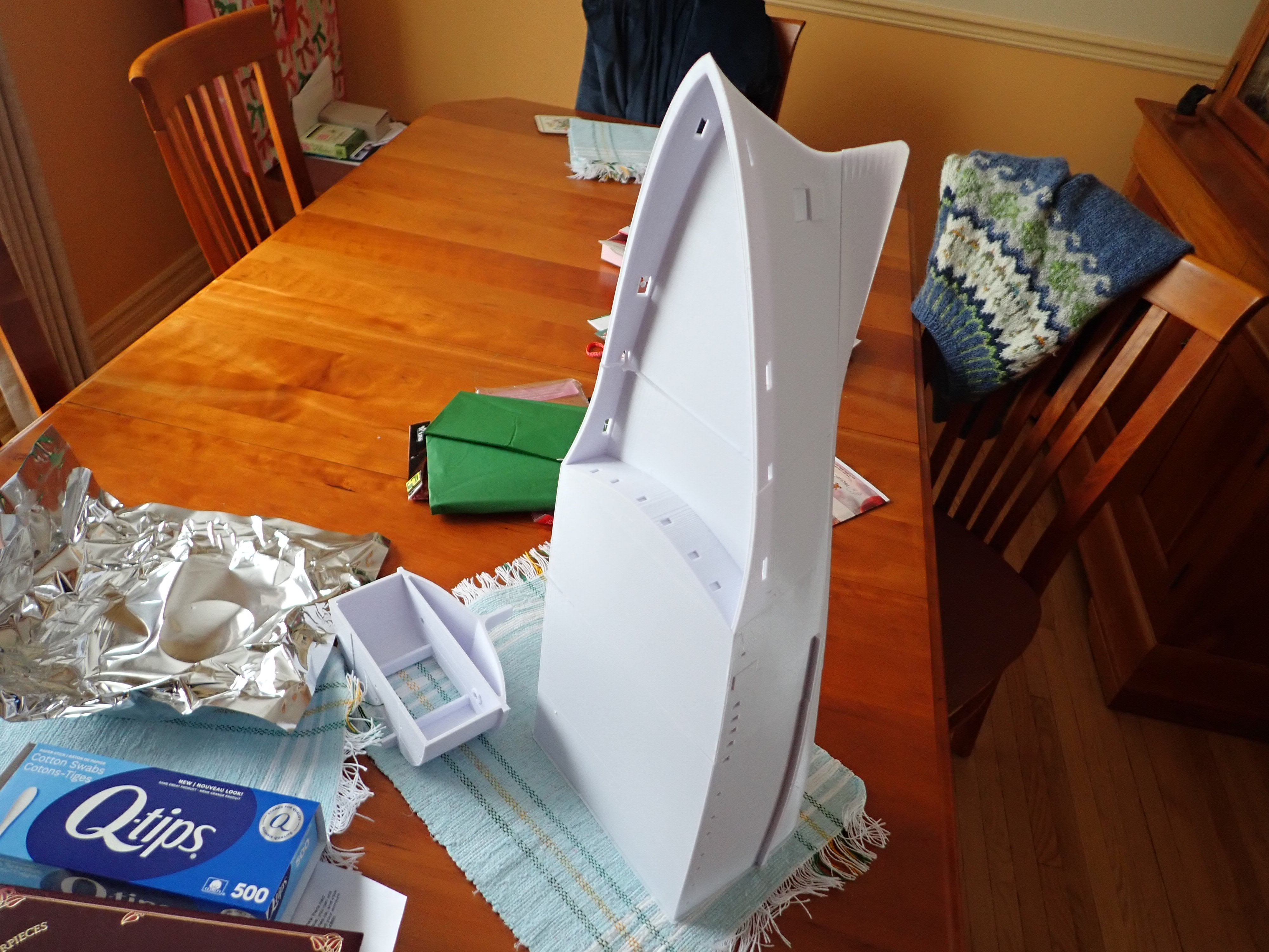

In this second pic the stern section can also be seen, with the opening for the vehicle door.
 The printed surface is pretty good, no large "waviness" but I will be using Bondo spot/glazing putty to fill in the minor ridge line artifacts.
According to the slicer, the finished hull should consume 7 pounds of plastic; that's without the superstructure. She'll have twin motors and twin rudders.
Finished length is 1470mm, beam 200mm, height 400mm (don't tell my wife!).🤫 I plan to illuminate her, and have not yet thought about storage implications. 🤔

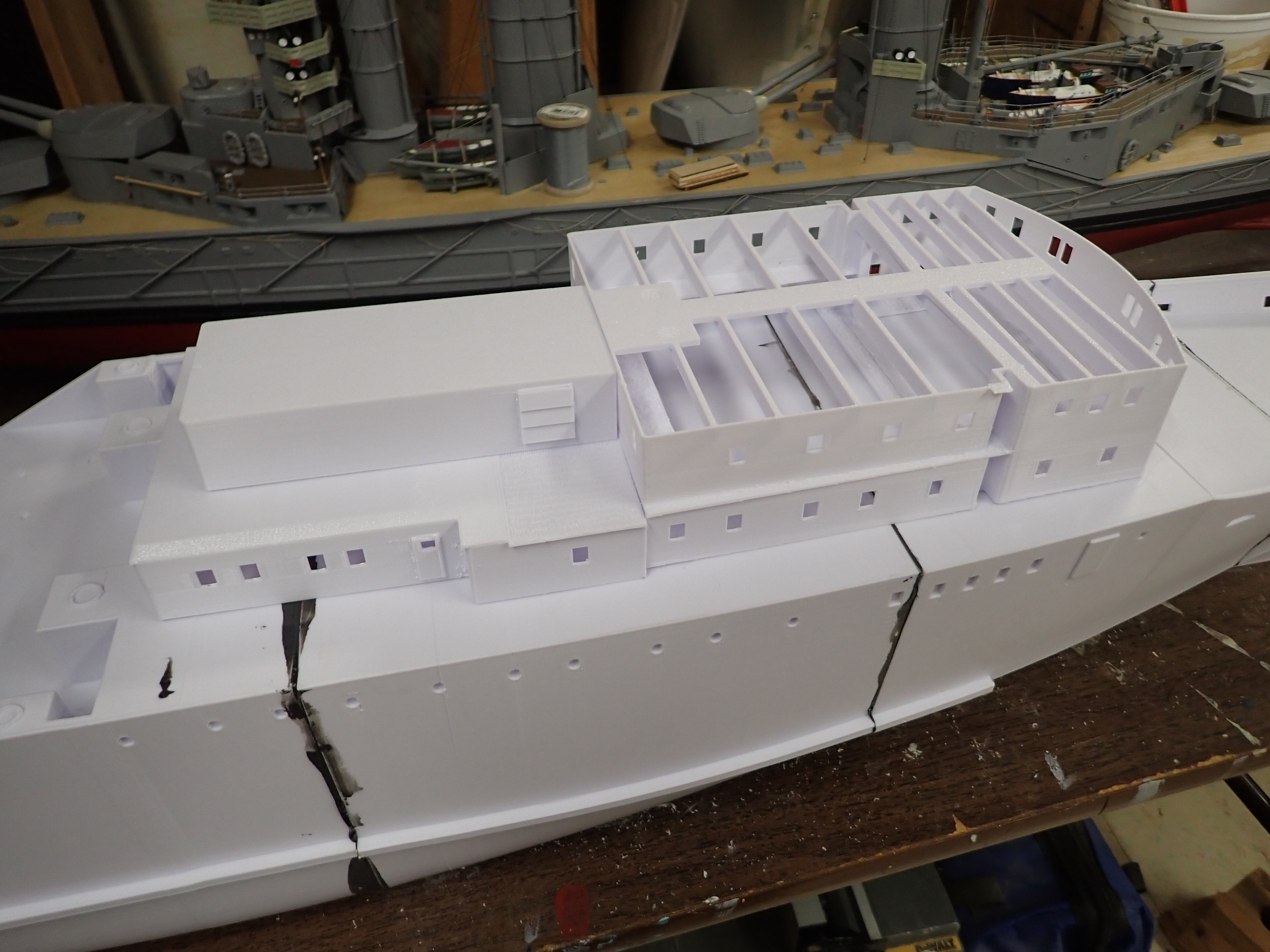

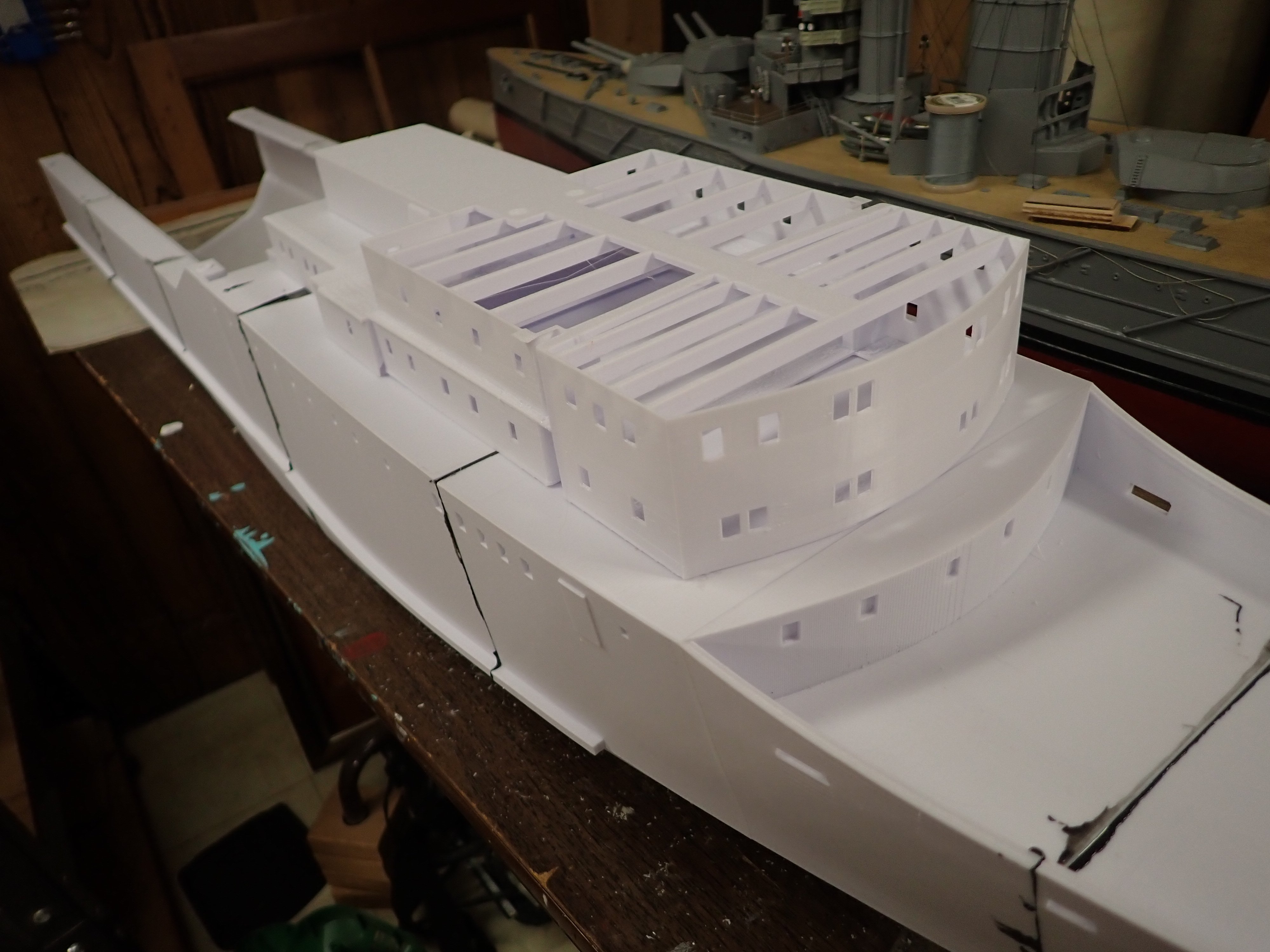

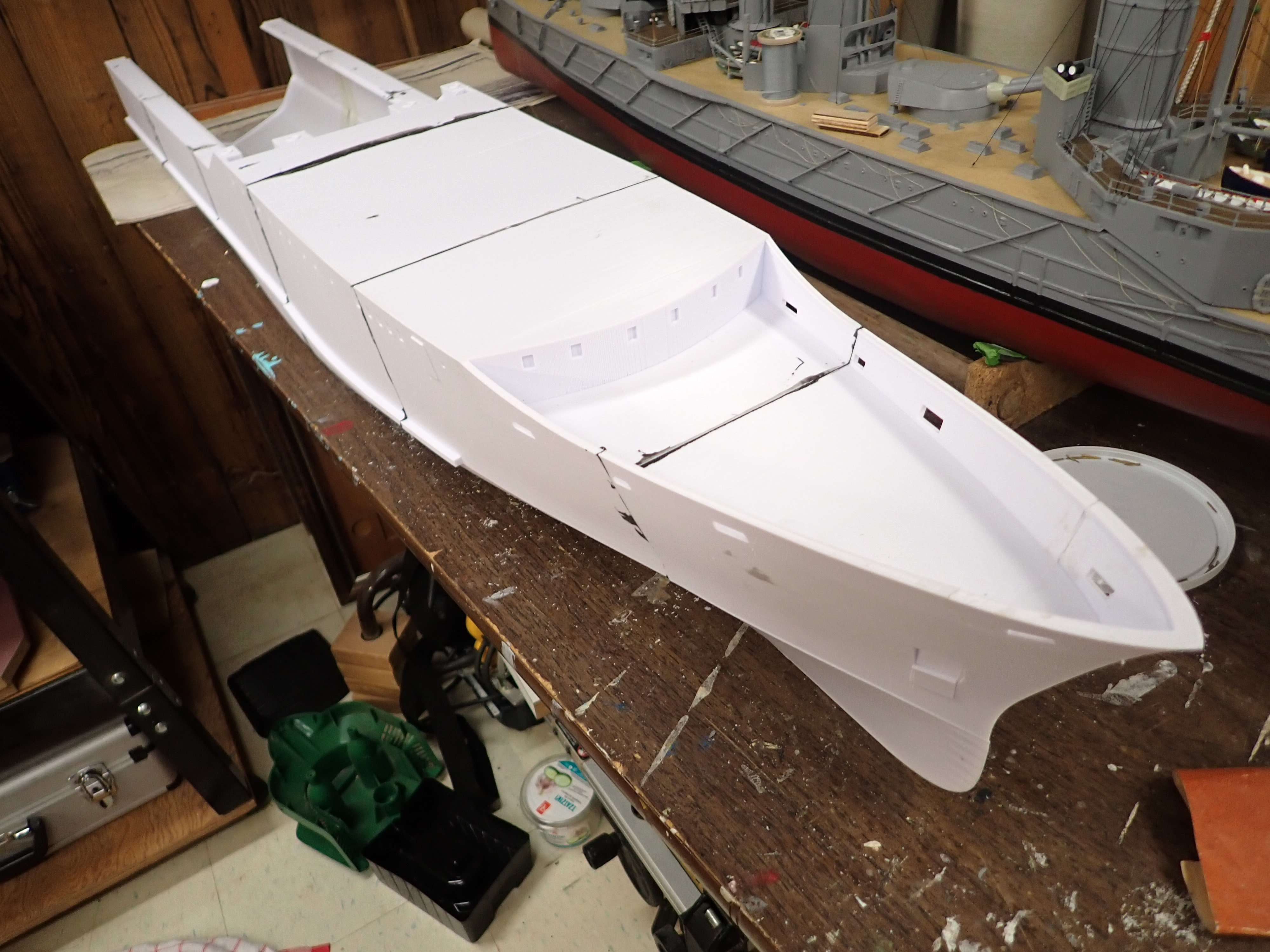

All eight hull sections printed, consuming over 100 hours of print time. And nearly three reels of filament. I've epoxied together only the first two thus far, using JB Weld which is my new favourite epoxy despite its black colour. I'm waiting for some fiberglass cloth seam tape to arrive to put some more epoxy inside this joint before adding more sections, because the enclosed front half would quickly become unwieldy to access for joint reinforcement.
The design is such that the superstructure is not removable if built according to instructions. I'm not sure I like that idea as that's a lot of hull interior that can only be reached by sliding your arm in from the admittedly large opening when the removable upper vehicle deck is removed. The designer's goal was to prevent superstructure damage due to handling, were it removable. I'll have to print some of the superstructure parts before deciding what to perhaps have removable, if only to be able to fiddle with any ballast in her front half.
I also had a look at some of the superstructure files. They surprised me with the time and plastic they will take to print too. I was thinking after the hull things would move quickly but there are more 12-hour prints ahead. I also discovered I don't like the lifeboat file; I will try my "Titanic lifeboat" file when I reach that point.
Here she is sitting in front of the nearly-completed HMS Lion. That's a 12" ruler sitting in front.
