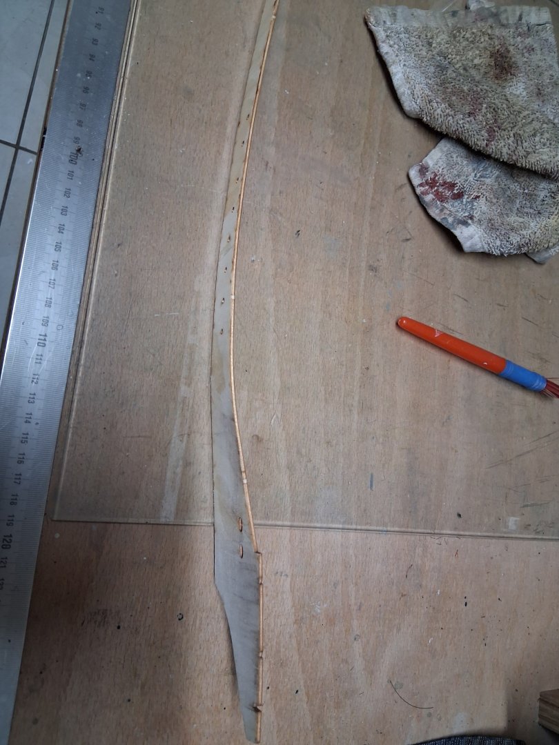

Hi, just starting my next large build.
I intend to go quite off script with this build. But first I need to start the basics
1. My building rig was too short
2. I found it had warped so added some angled metal straps
3.jury rigged the ends to make it fit.

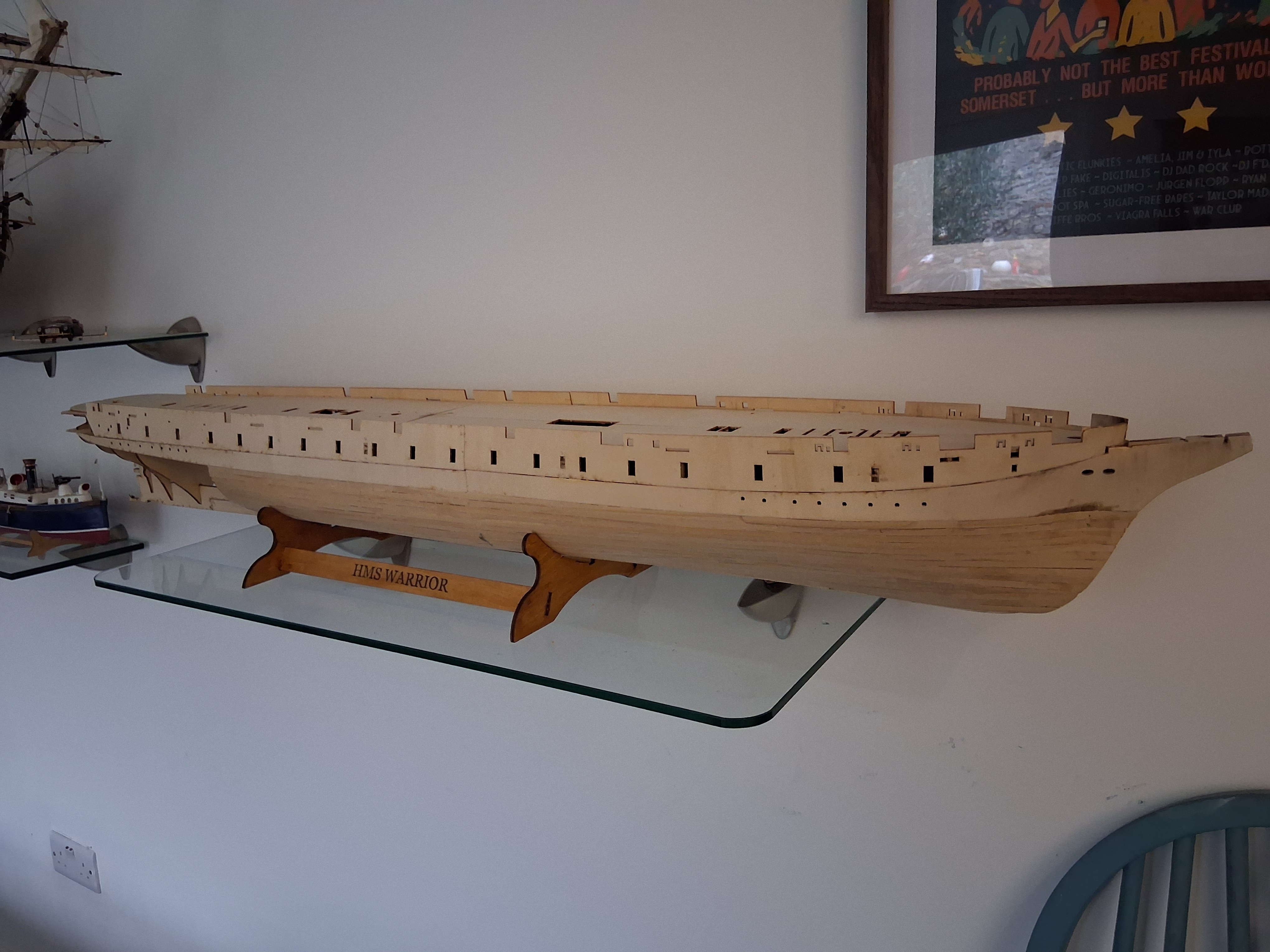

At last it's underway

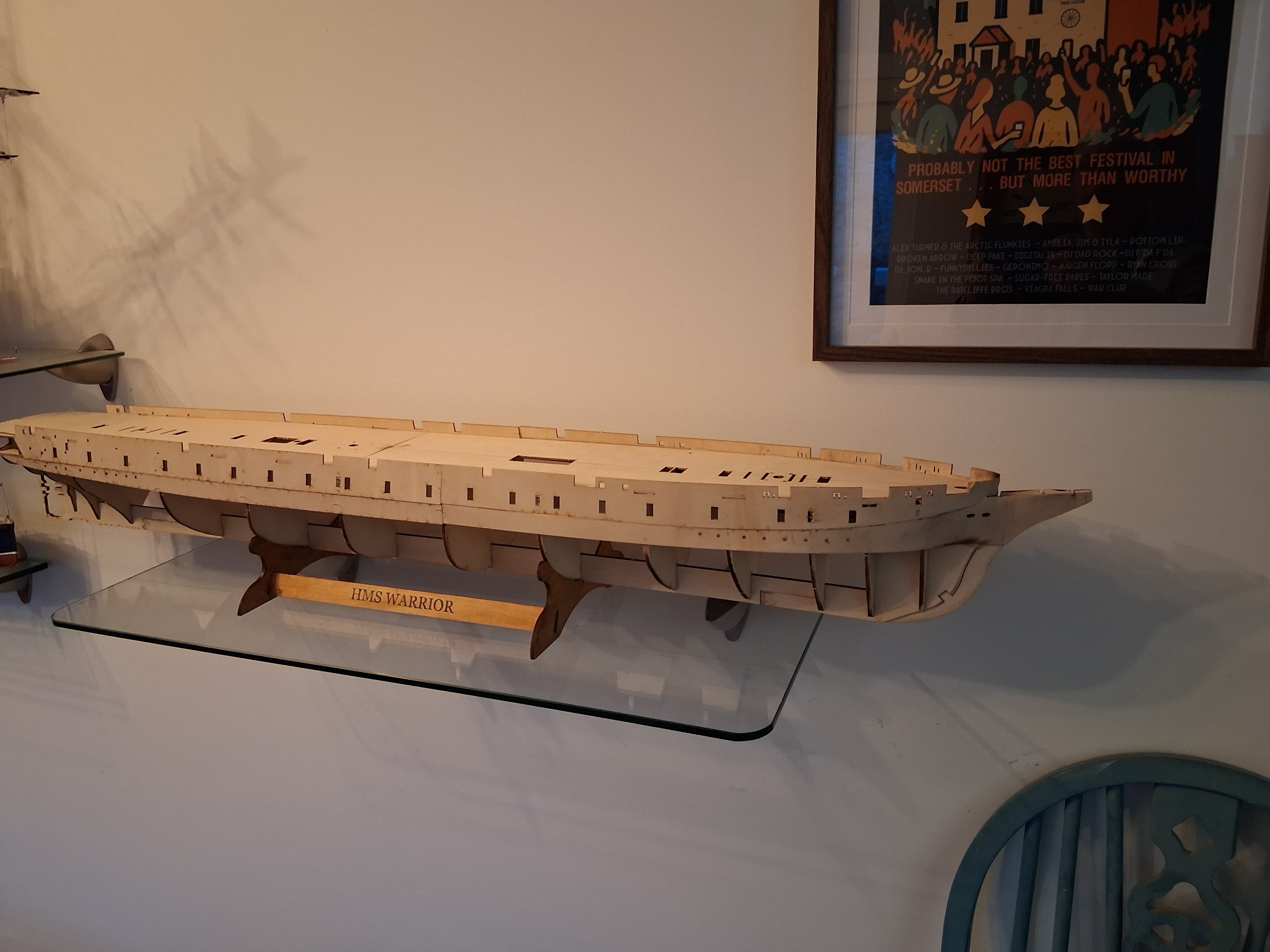

Its starting to look like a boat

Hi Ian,
That's a rather large Hull!!
Several years ago, I remember a build Log for this. (Can't recall where, sorry.)
Anyway, the builder ran out of Decking Planks/Material.... I guess be judicious with the "Waste."
Cheers....HOF.

Hi Hof
It is a seriously large block of wood lol
Once it gets a bow sprite and rigging it will really dominate the wall!!

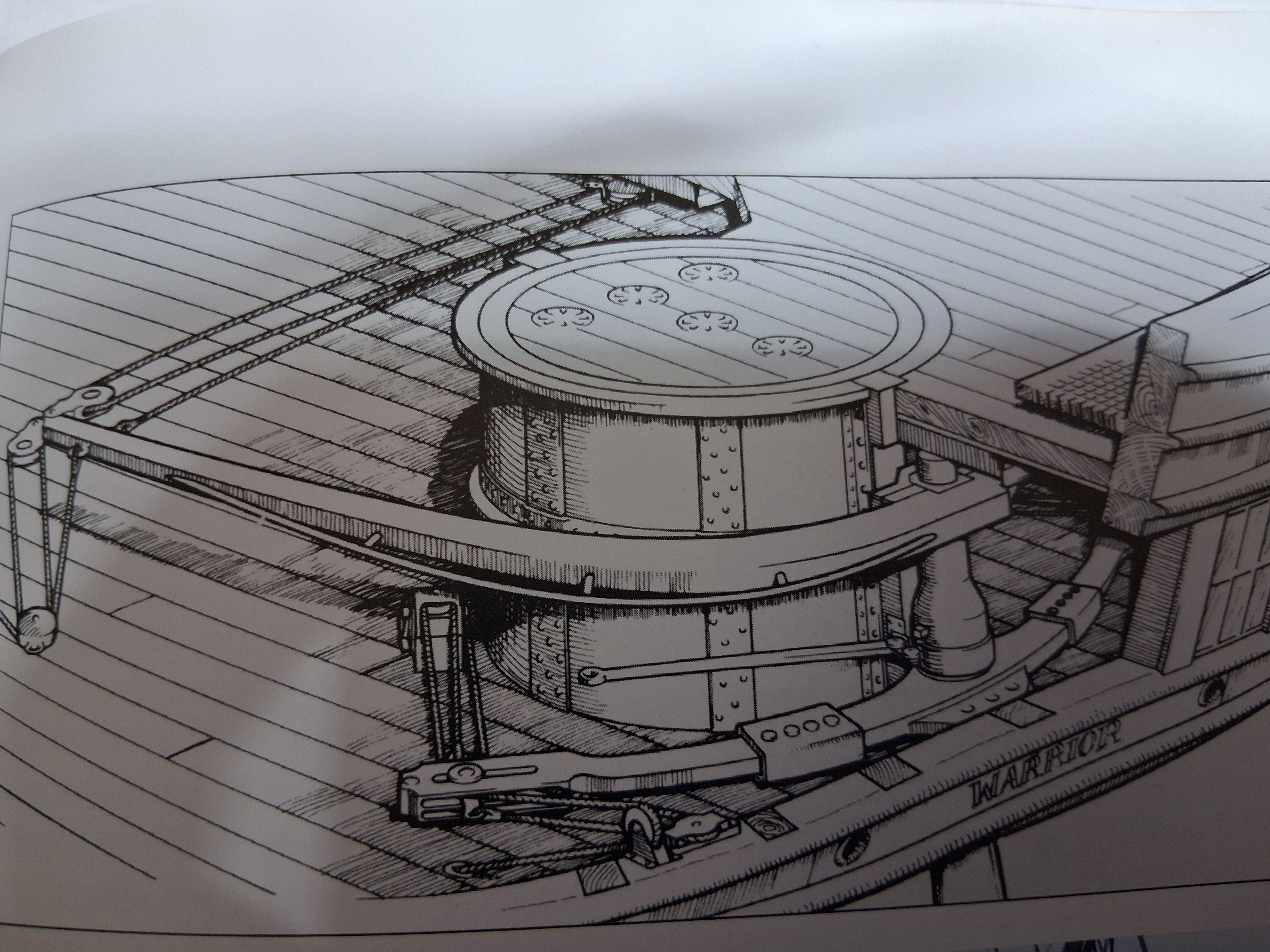

The whole propeller area for very expensive kit is really poor. So i am going to be very ambitious and build the model with the raising of the propeller in progress..I have not seen this on any Warrior build..so if you know of one point me in that direction

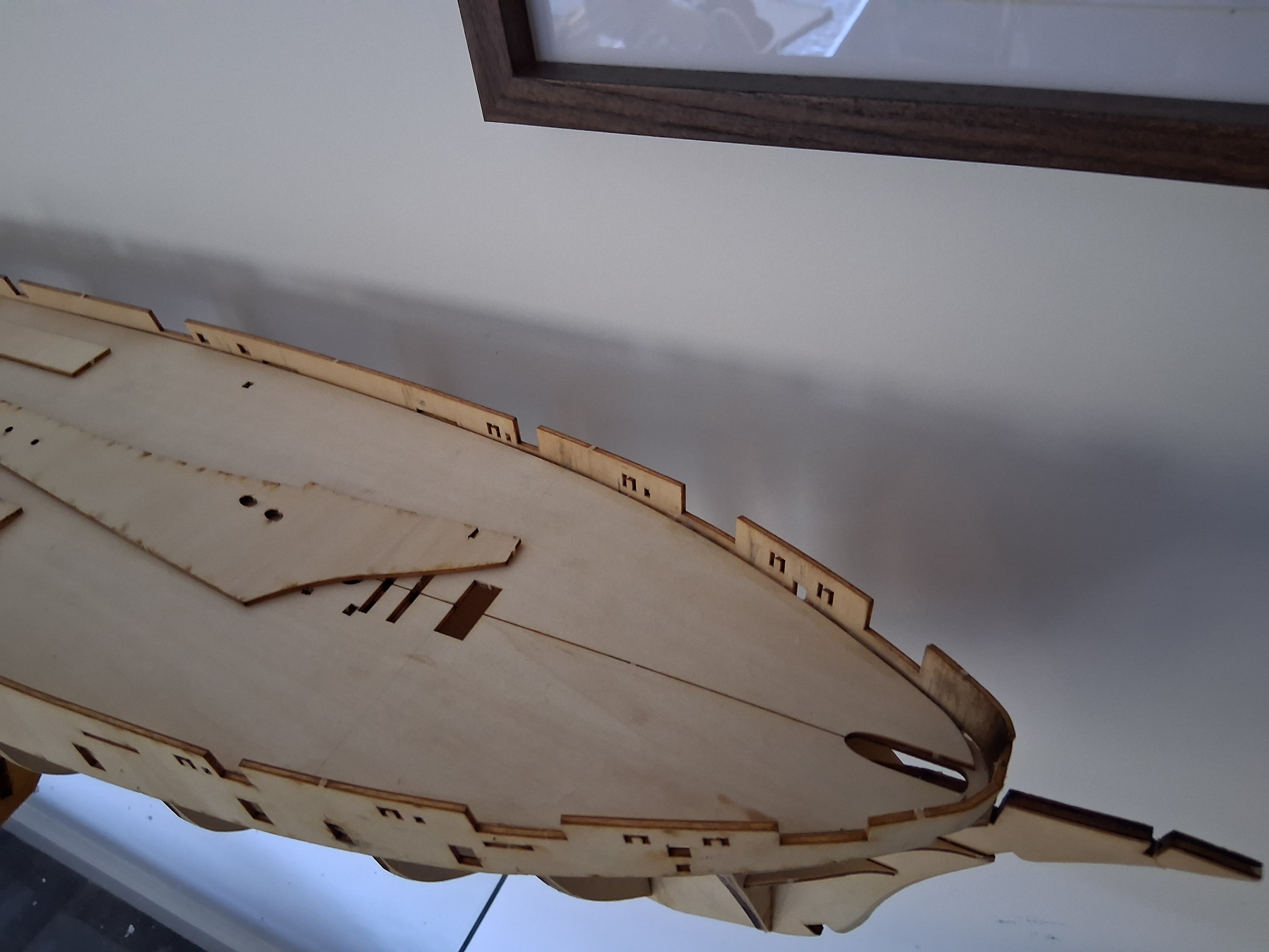

Well whilst still trying get get myself 3d printer trained  I planked the front section of the hull. It will need some serous filling and sanding to get the metal like finish .

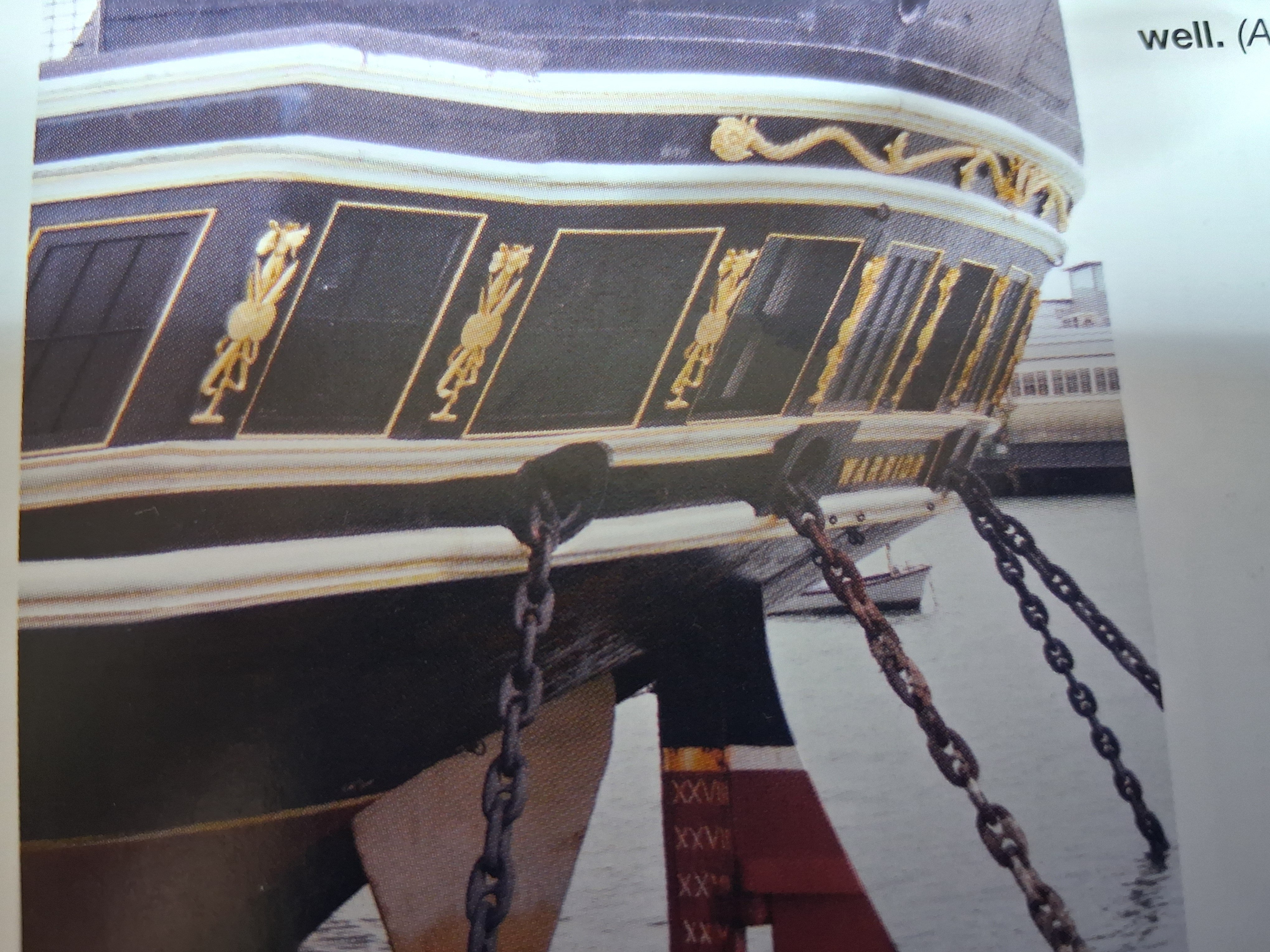

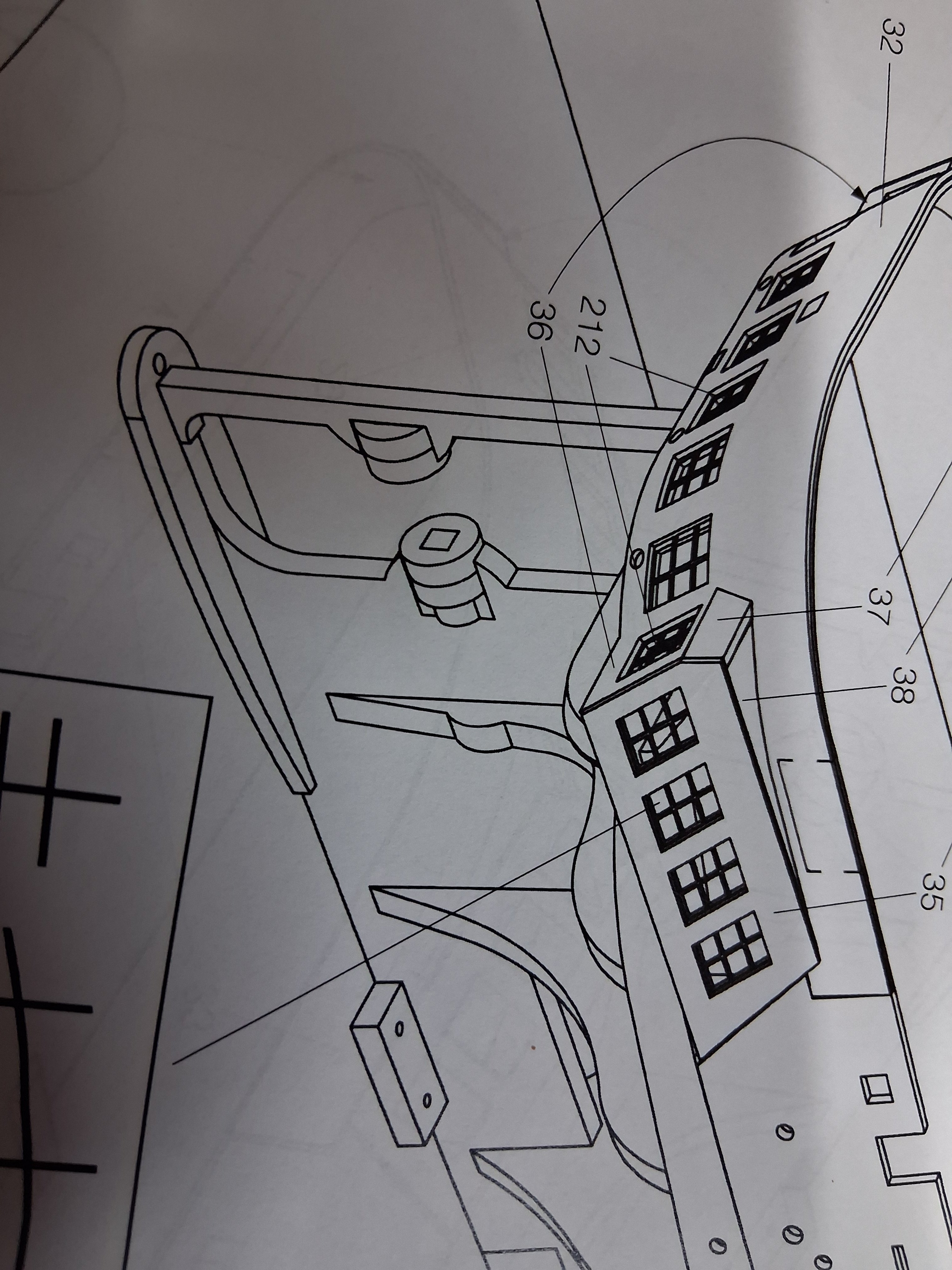

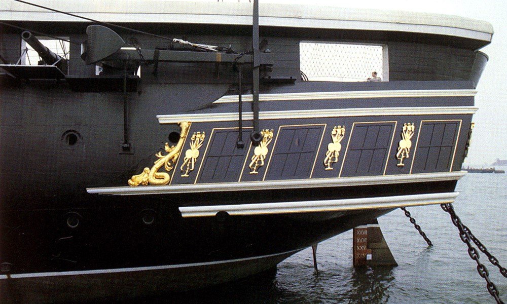

i have been doing some more investigation regarding the stern, the model needs some changing about
The stern looks like any ship of the line except a lot of the windows are false-- just for show and there is no great day cabin behind it.,
https://live.staticflickr.com/65535/55049909403_dfa49f1cfa_w.jpg
Its full of steering gear and the large tube for the propeller lifting

With the windows not being too large but still large enough people will look in, I shall  cut away more bulk heads and create something that looks right. I wont add much detail just a couple of walls and doors, the propeller tube will be there anyway https://www.britmodeller.com/forums/uploads/emoticons/default_smile.png The rudder mechanism is hidden behind the false window so i can leave that out

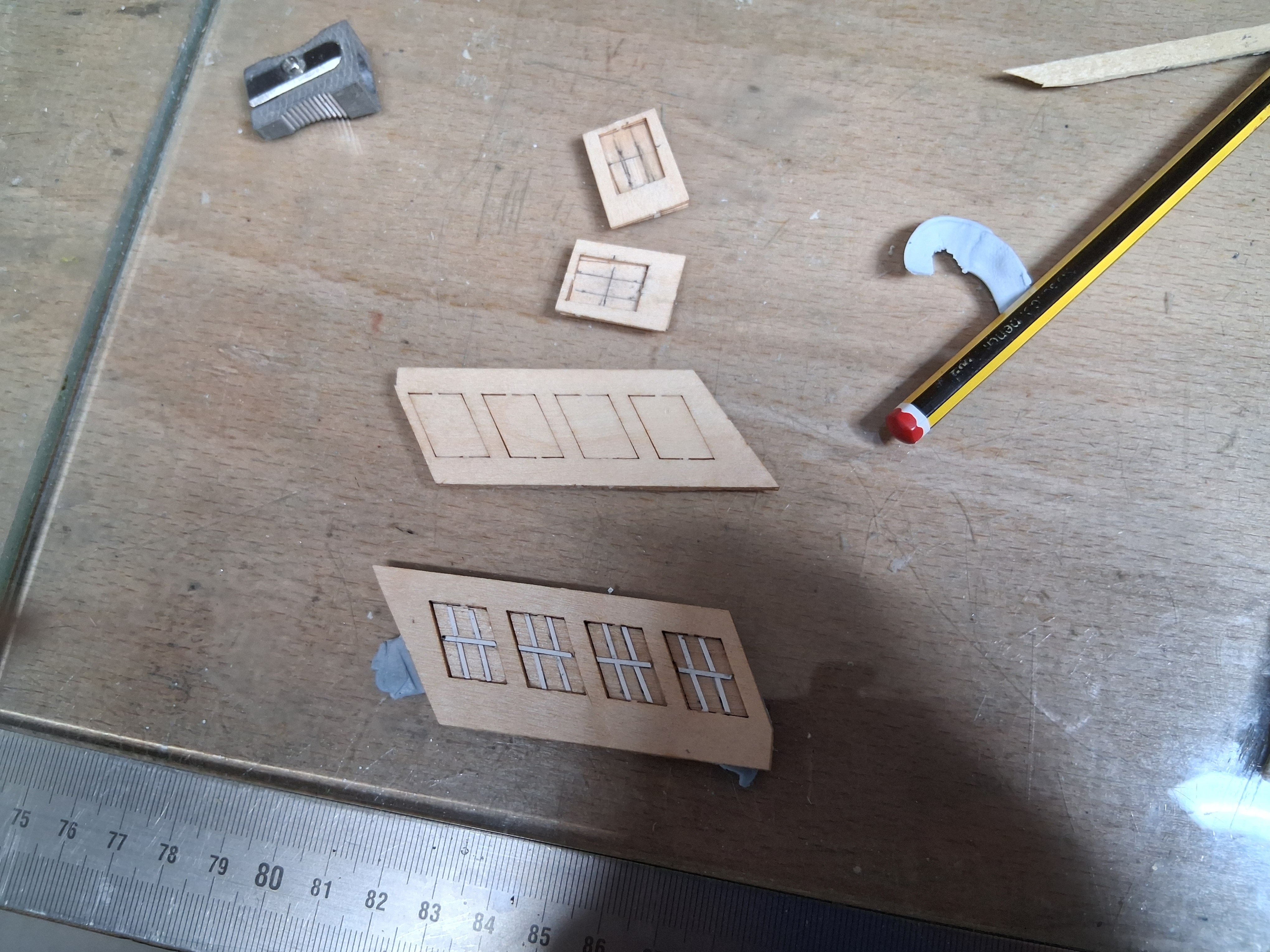

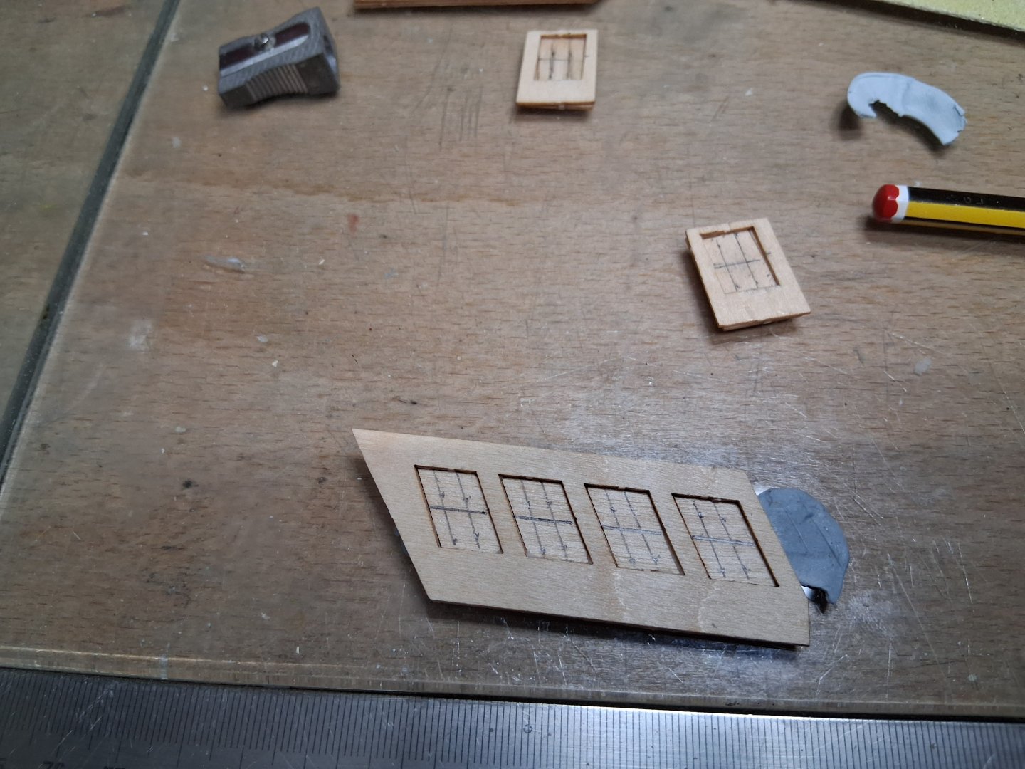

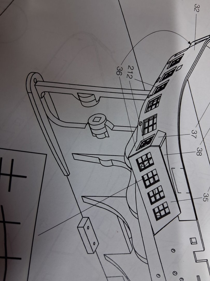

Started on the rear windows  only 3 of the 17 windows are real :) this picture illustrates it well on the side ones.
The kit and two pieces for each section, you cut them all out and put clear plastic between the sandwich's -and hay presto windows!  well in a nut shell..
sidewindow1.thumb.jpg.5f0931ee35c7bd1e69262984d3bc3995.jpgsidewindow2.thumb.jpg.ef4149365cad8ee121be02d3e210a118.jpg
I kept the blanks in the 'non' windows and with some fine strips made the window frames.

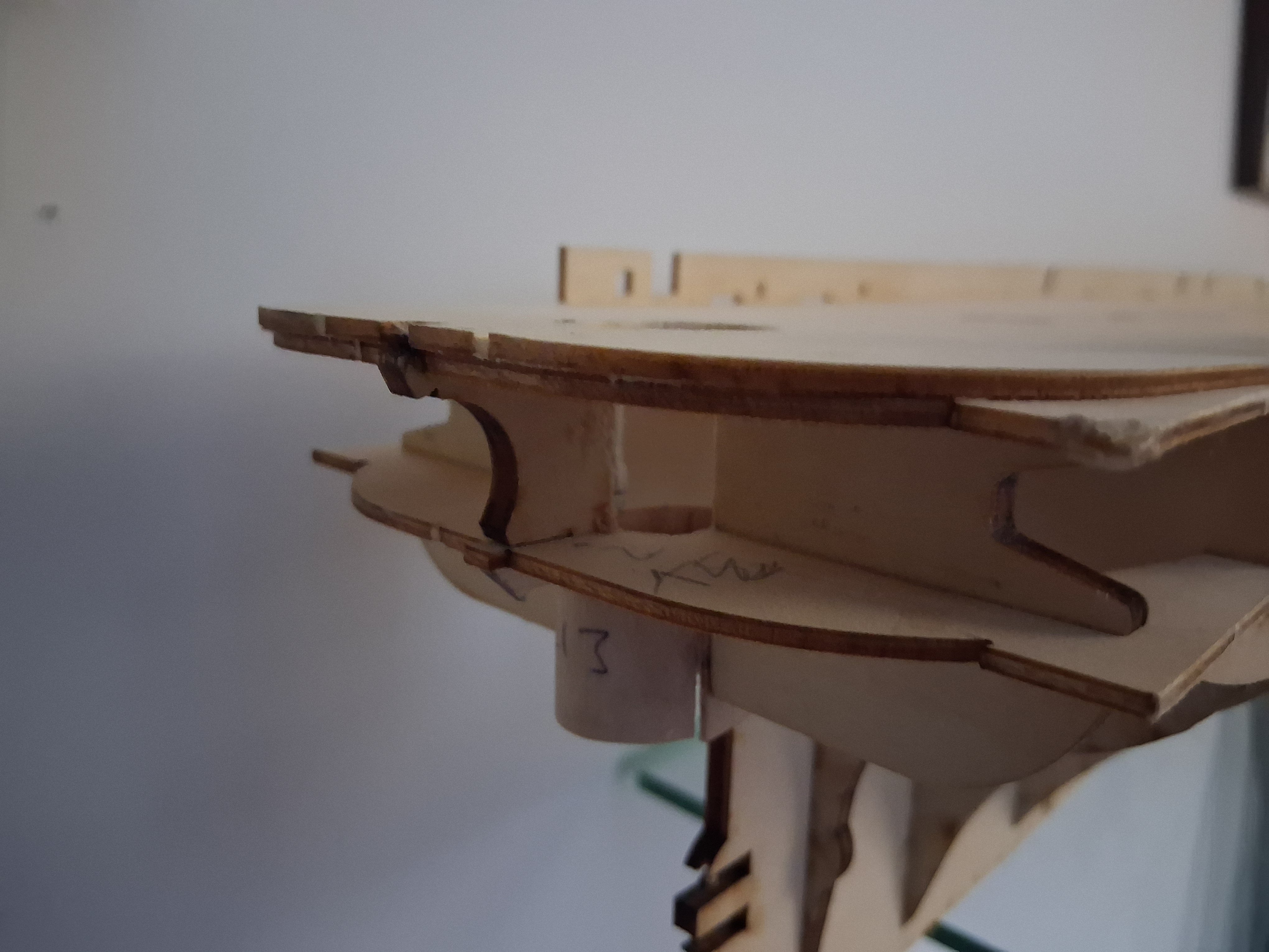

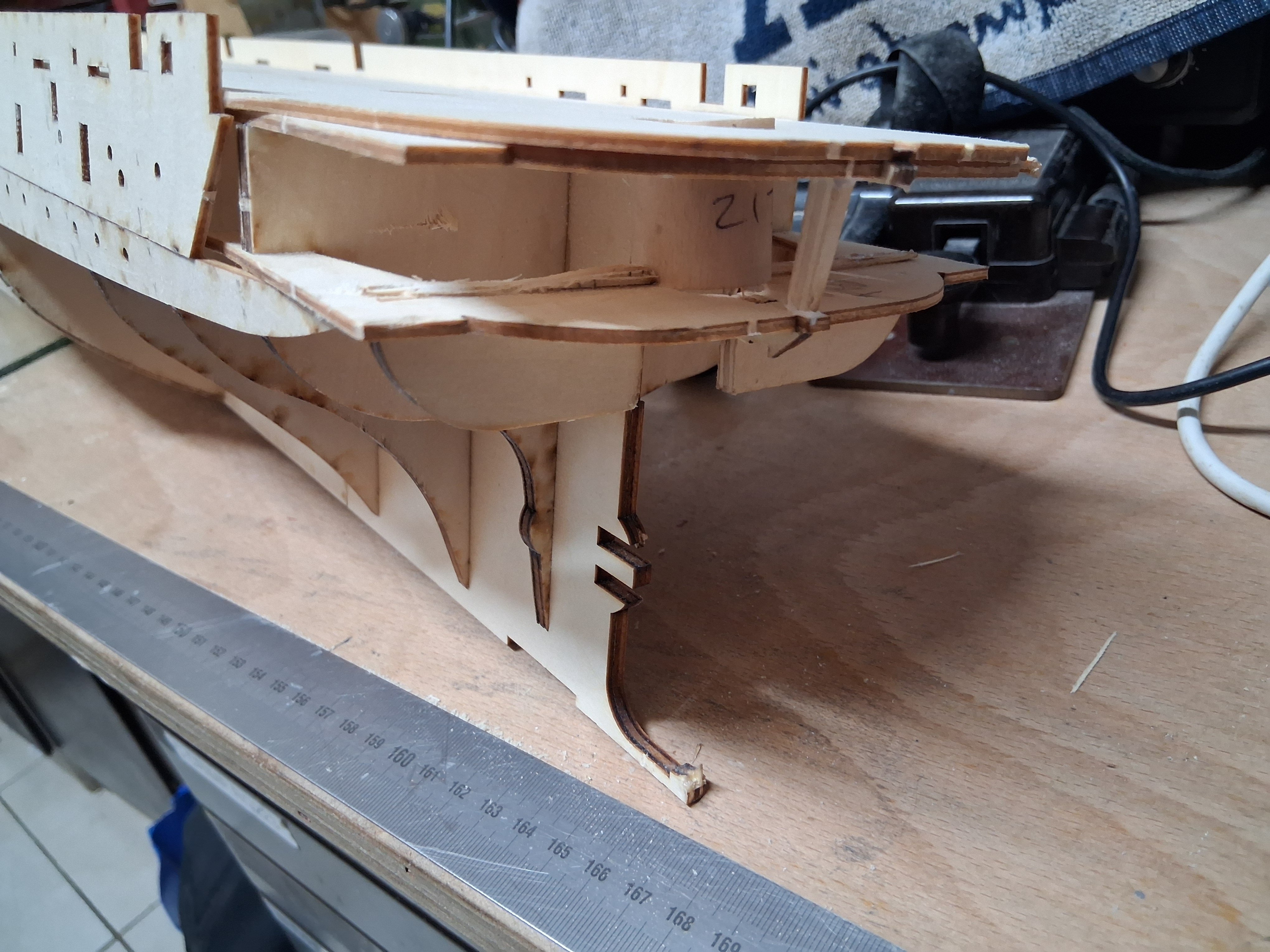

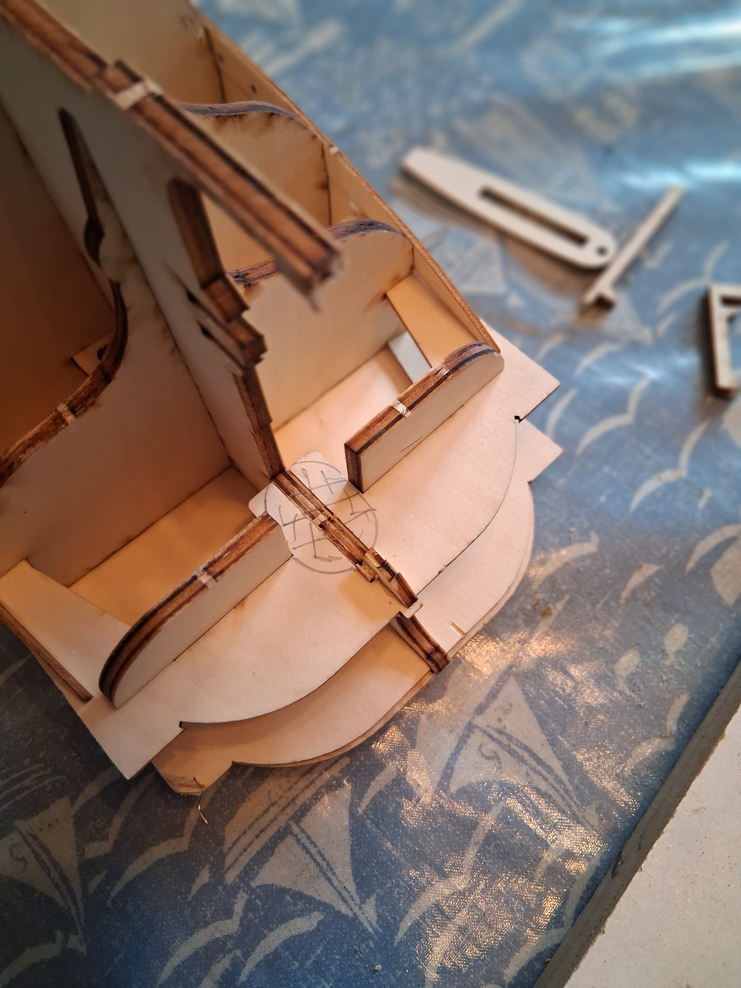

The stern gallery area is now totally gutted apart from one centre support which will come out later as it is in front of one of the remaining windows https://www.britmodeller.com/forums/uploads/emoticons/default_smile.png  The tube marked '21' is just there ready for when ever I can make the proper lifting tube section. You are going to see very little from the 3 stern windows.  Its just a white interior, ill see if I need some rudder mceh detail later
