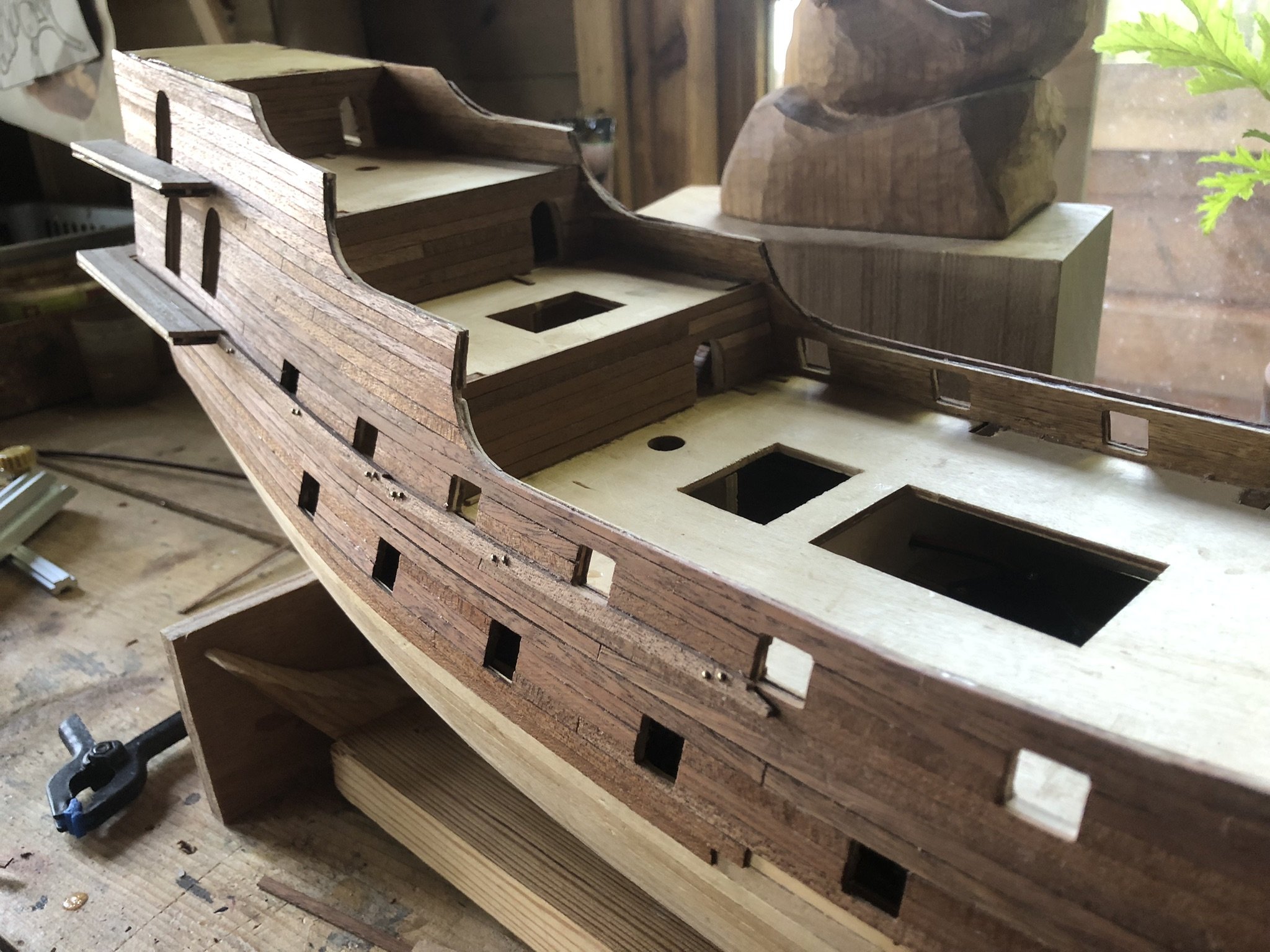

Comparing my model with a painting of similar period galleons, mine didn’t give the appearance I was hoping for. Poop deck too low, my fault as the balconies were slightly too high and in effort to get window shape right they ended too high up. Decided to add a bit on top. Quite pleased with result. This is the sort of thing Baker does so well, mind his are the result of meticulous research. Mine a gut feeling.

Slow progress I’am having to glue a plank wait for it to dry before doing the next one. Light oak stain on the supplied balcony pieces is quite a good match. There’s a few of us doing the Apostle Felipe and all going to look different.. Anyway glad I didn’t install the windows I’d made as there was a bit of sanding involved with balconies. H

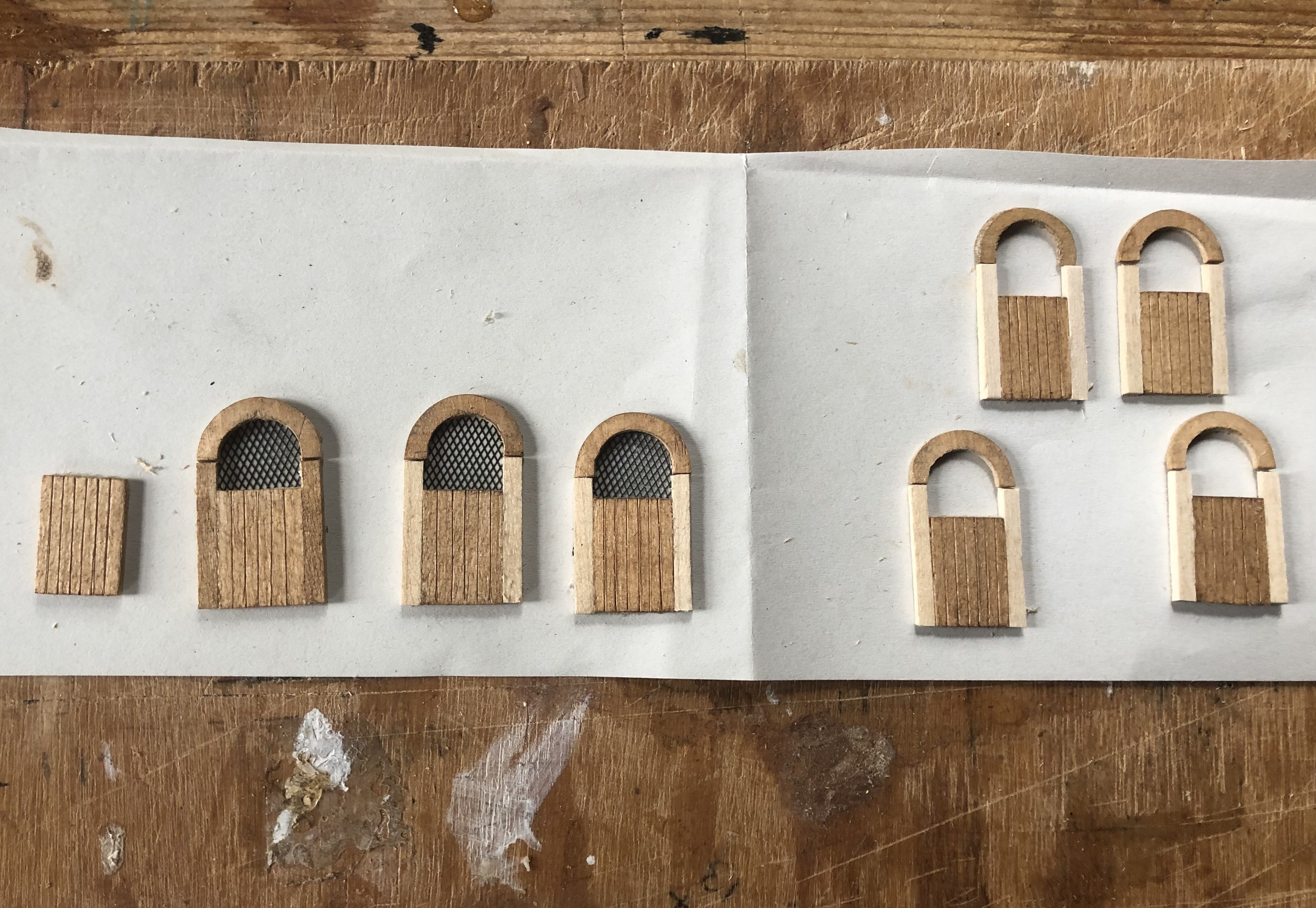

I began to worry that windowed doors would be the downfall of me as unsuccessful in bending wood even thin stuff and nibbling was too obvious. Decided to carve top arches and stained with light oak. Anyway quite happy with the outcome, found a model railway diorama shop to supply the leaded glass as plastic sheeting.

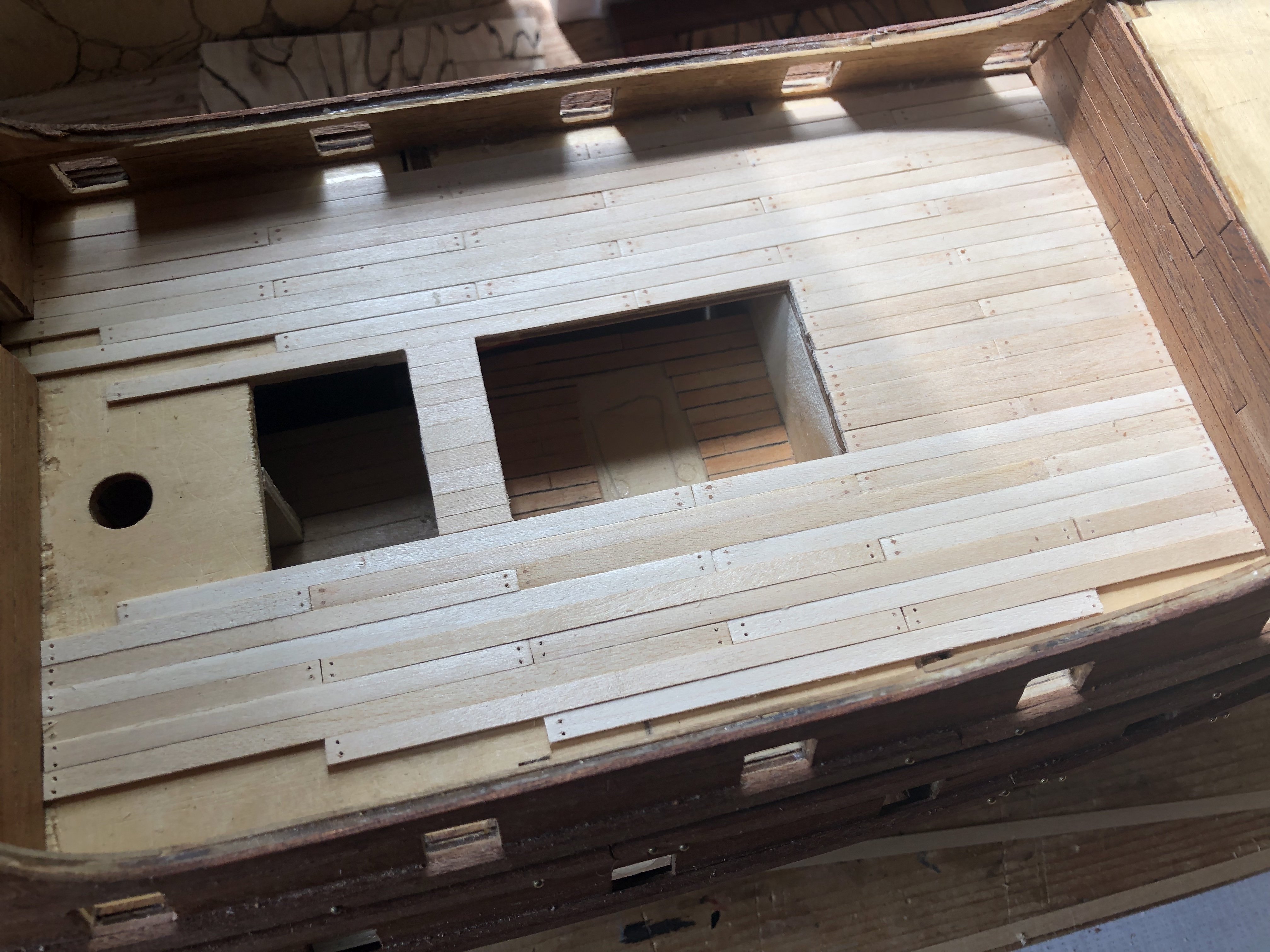

Finished planking lower hull, more planks used than expected and second batch of pseudo mahogany ordered was markedly different to what I had in stock, bit of a sickly orange but decided to use since if I reordered would new be any better? Anyway planking was acceptable not my best work mind. Bearing this in mind decided to paint bottom to represent white stuff. I have seen images of Spanish galleons painted with it. After much filling, sanding, painting, re-sanding quite pleased. Sure it will need redoing later after working on ship, but anyway shows hull is ok.
