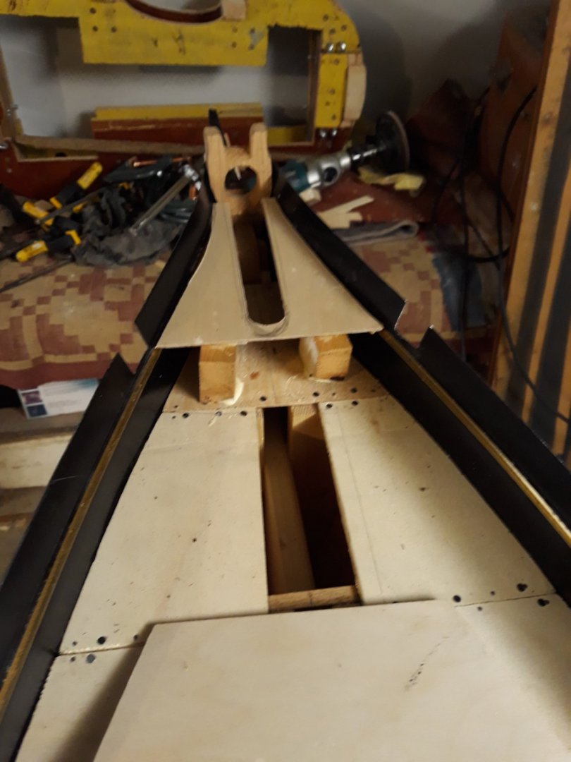

  12. Good day everyone, chapter 11. rework. Hope everyone is looking after themselves in these times... I spent whole day reworking on bow part of ship. There was mistake I made when assembling steel sheet of bulwark attaching to the knightsheads, ....and not twisting sheet enough to make proper curvature of ship. I did not pay enough attention to that as I focused on building ship further. But...than I installed foredeck , etc.....and all the time I had strange feeling I am not building cutty sark but she has kinda of Titanicish nose,..I can live with many failures or ommitions, but .bow curvature is important part of design I couldnt take it anymore so I decided I had to remove knightheads and install smaller one to make correction on curvature . I used piece of well seasoned maple from violin neck / very stiff - to make sure it will handle pressure even thin, and fastened it with screw throughout after glued. I can live with it at this point., and at the final surgery went smoother than I thought. what is corrected good is that bowsprit is now not drown deep into deck but short in deck as supposed to be.... at the price topgallant rail ends a bit front of knightheads ... that is unfortunate but I dont care for that. thanks for any comment. V. old bow curvature vs new proper bow curvature
  13. Good evening Everyone, no 10. Machinery and bulwark stanchions and windows. There is no plethora of eyes or iron parts on Cutty, but what it is is marvelous piece of vintage casting industry glamour. Unfortunately I am really beginner at iron work, but I did try my best , with an window that I could possibly rework some of it. I would like to learn specially how to blacken or burnish brass, as I did not find any cloloring or spraying satisfying enough to be acceptable. If someone has a tip or can lead me to some tutorial on web on that topic i would be really thankful. I did mix iron with some wooden parts to easy an effort....thank you for any comment etc...I have to highlight one piece that I like most . Bilge pump with its vintage S wheels is an eyecatcher and really characteristic on this ship. I decided to color S supports parts black but left wheel frame on its brass color. I find it pleasing to look at. what I have dilemma are the actual eyebolts going into deck. sould I make original simple round eyes as on actual ship? I have those modern eyes at hume with pins already installed, but seems weird a bit from aesthetic point. what do you think? For the winches or how is it called I used most parts from old bolts and rivets I found at home, also for various size bollards. I put brass nail with cap into bolt to replicare brass ending on bollards. There is still many parts missing on boat like sheaves, and small bollards on rails, I am not going to make now intentionally, as Lifeboat and lifeoats elevation ramps.... I intend to make after I decide whether to rig the ship or not ...and Capstan is out of scale slightly. Catheads are not yet completed so I will post those later on. tomorrow I will post decoration and that would be catch up to where I am about to be now. From now on it will be sparer posts depends what progress do I make. well, if not rigging, only muntzter sheathing remains rudder,, two parts on back deck with window, installing doors and that would be it I wont post decking capitol as It is nothing to write home about. as I am not at decking yet, I will probably include some pics, I did install individual planks around hatches , building ,rest is from lime wood strips 70 mm wide. I can make individual planking later any time, and this would provide solid base especially as original decking is elevated a bit with metal ending frame ....
