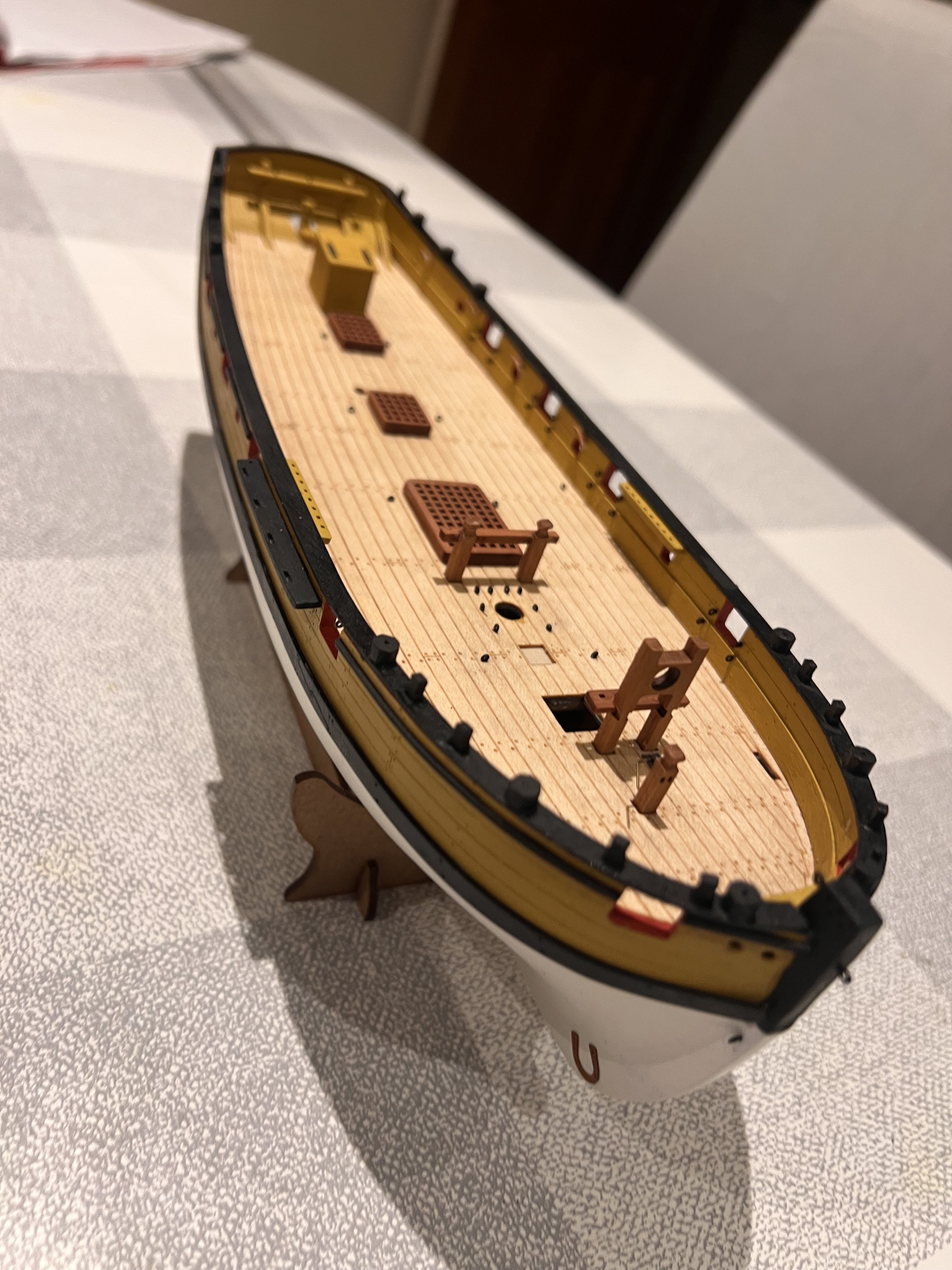

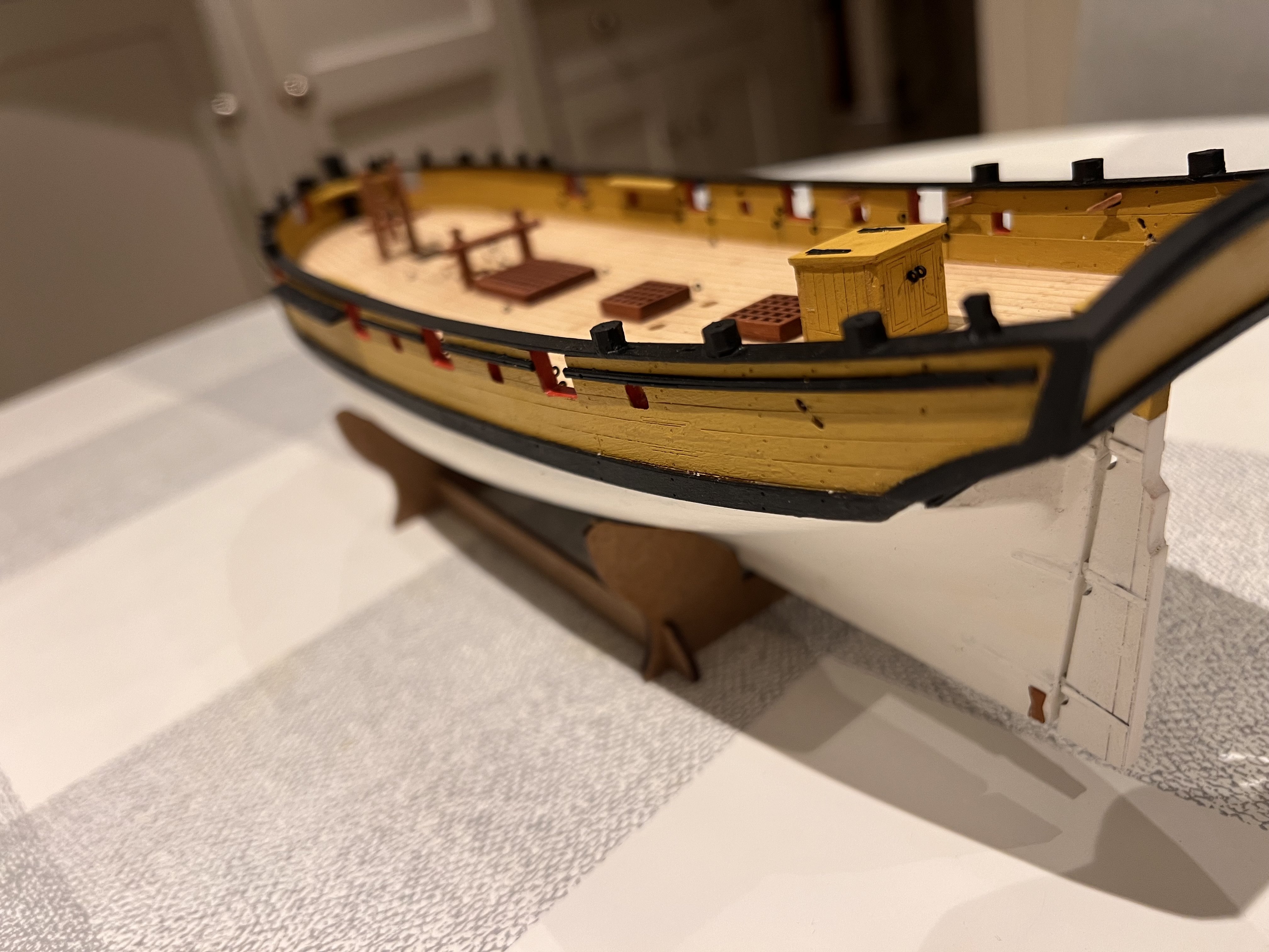

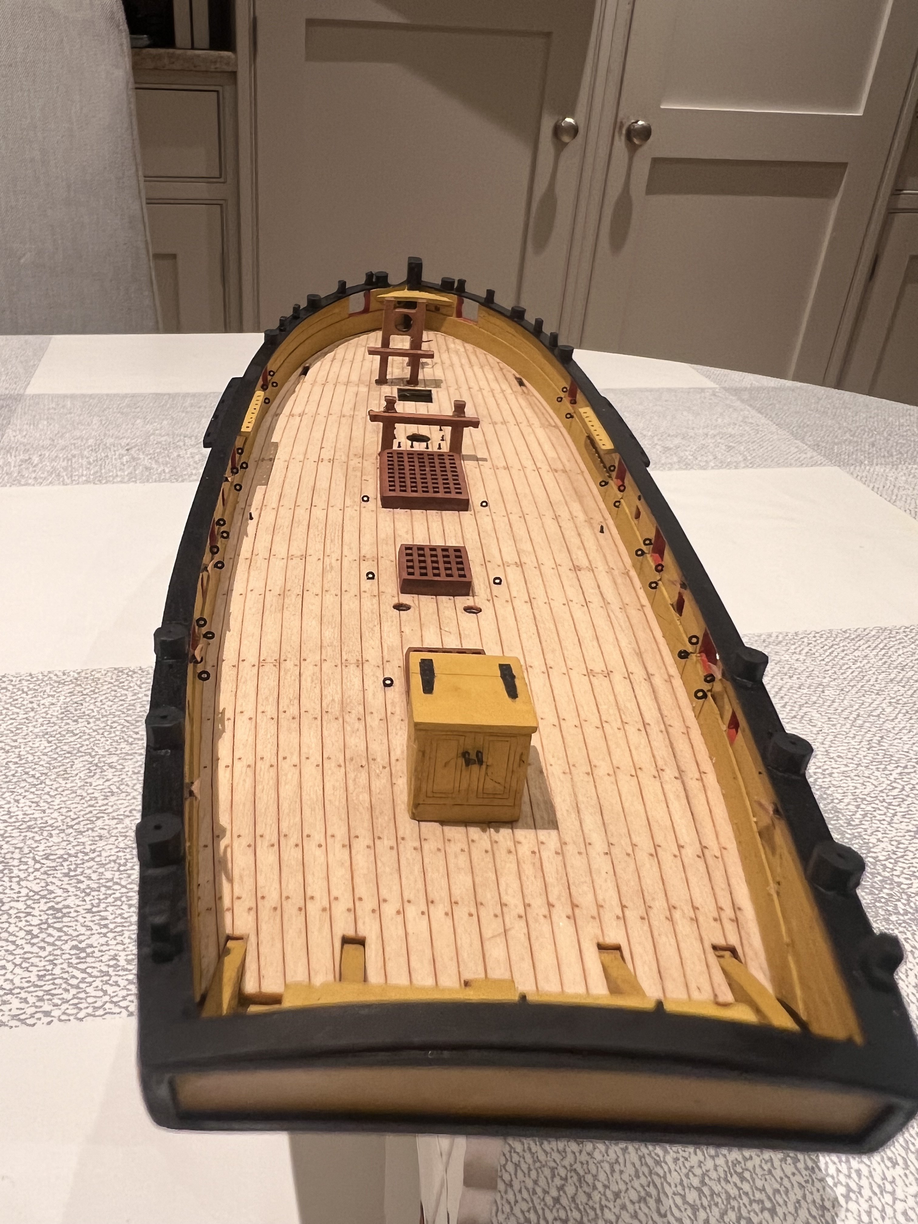

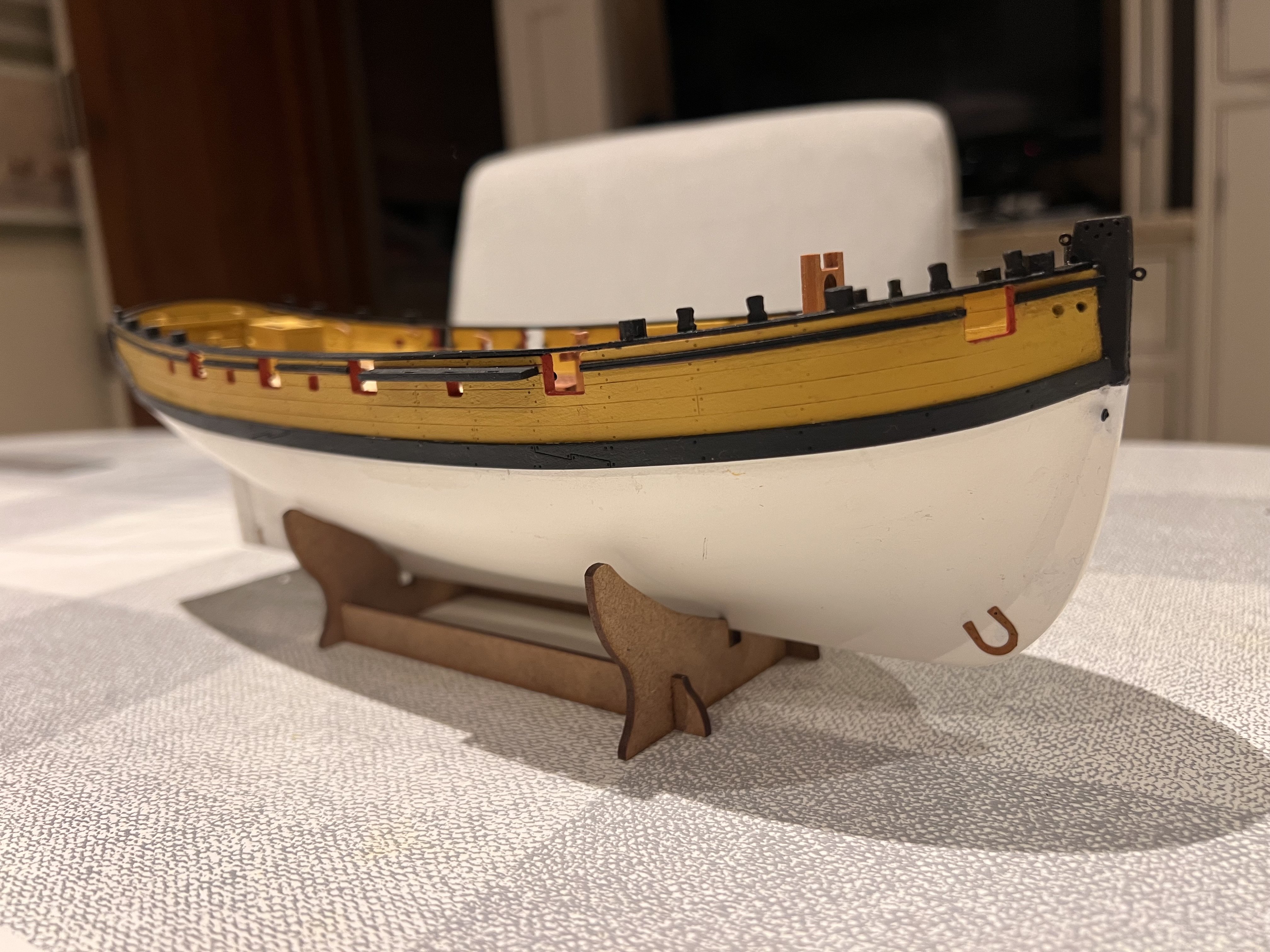

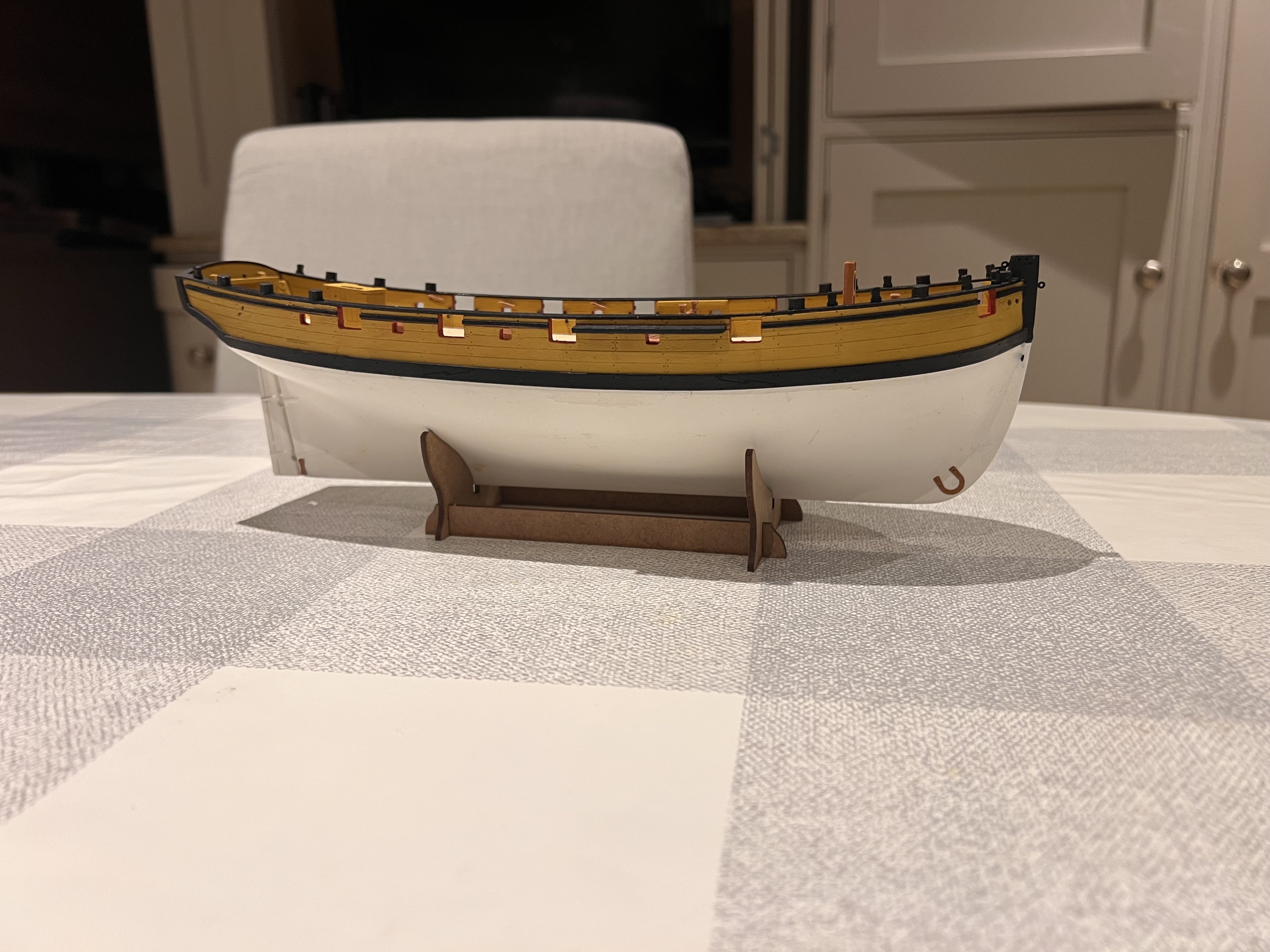

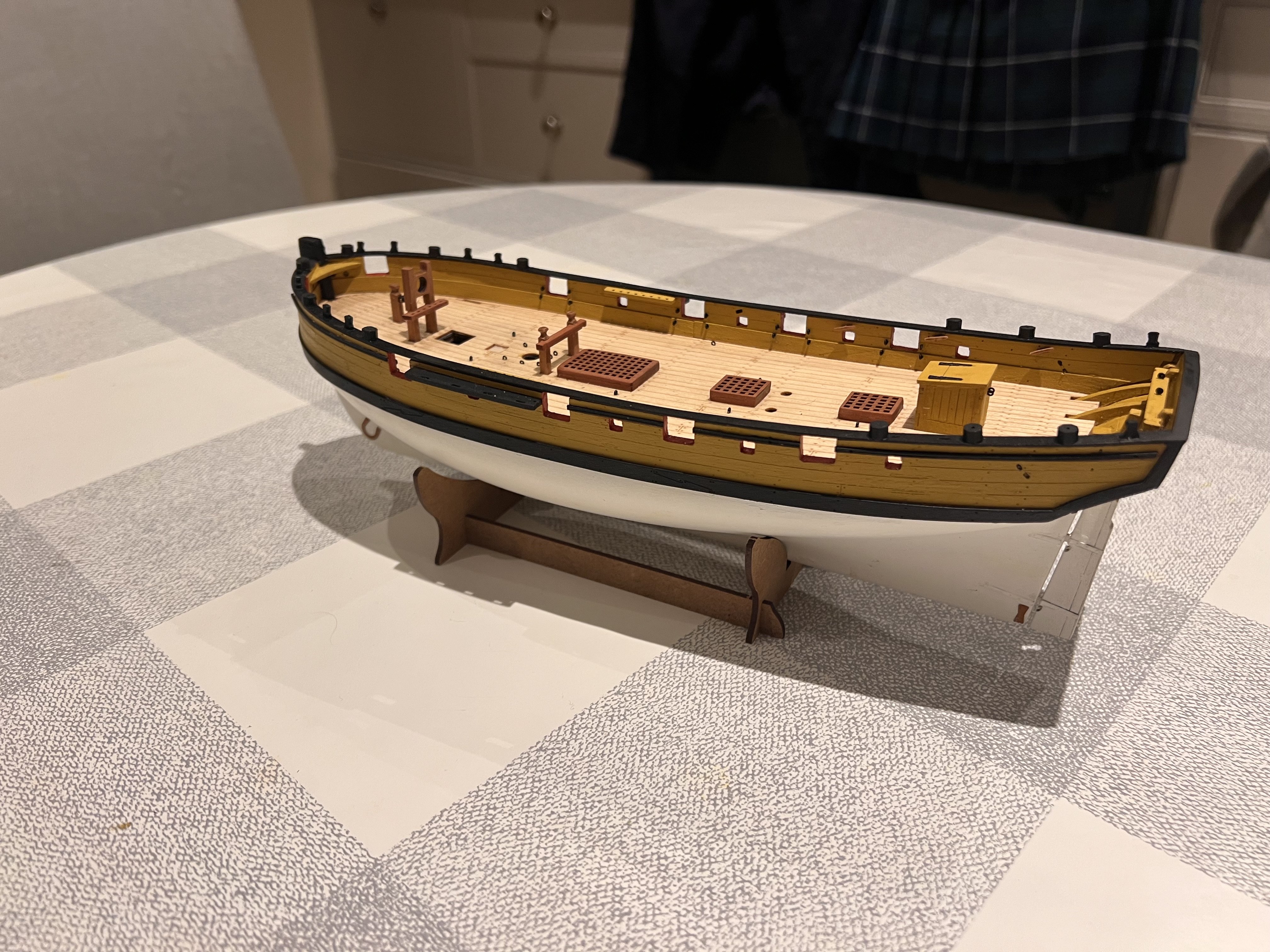

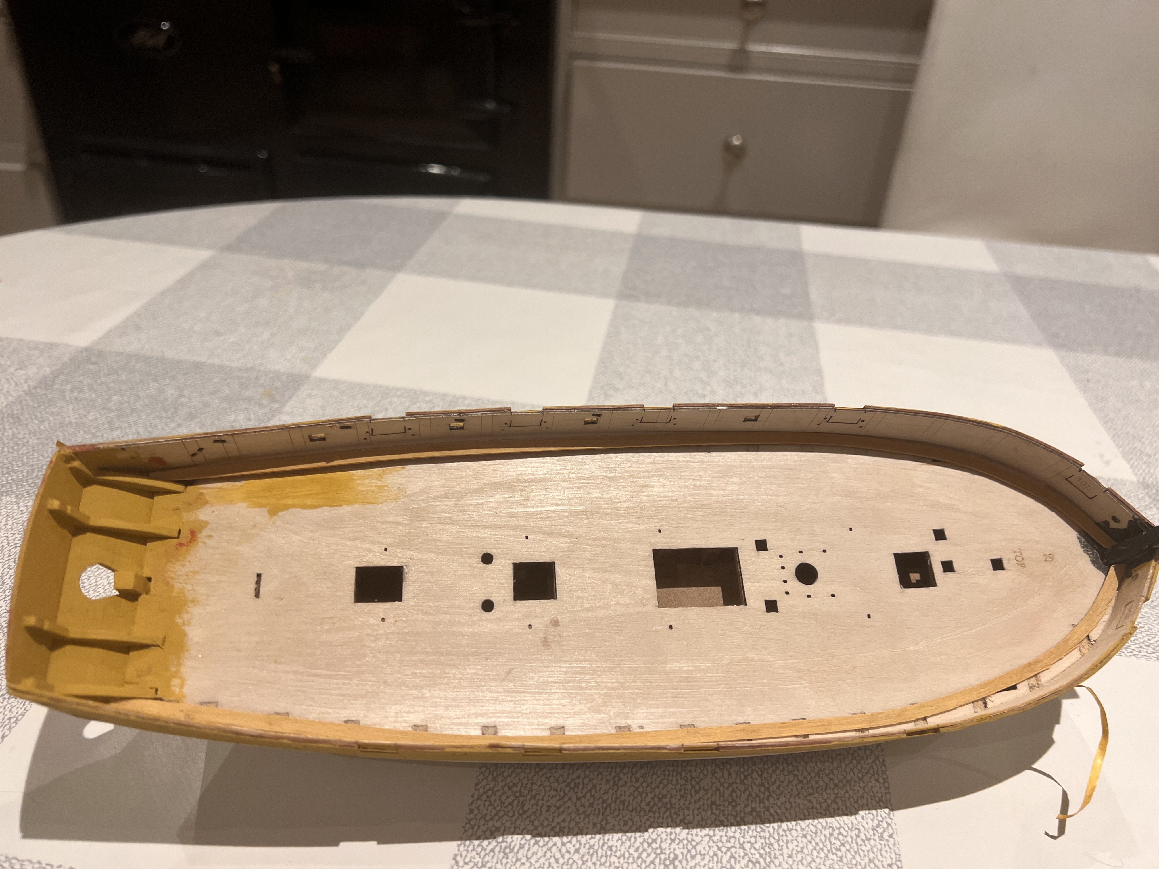

Hull now fitted out except for anchors and swivel guns that will be in the way of rigging. Pretty little boat. I like the yellow ochre, makes a nice change.

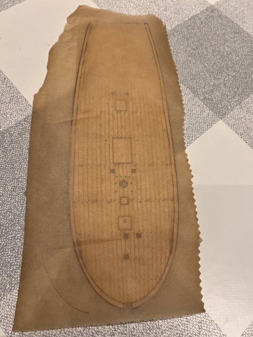

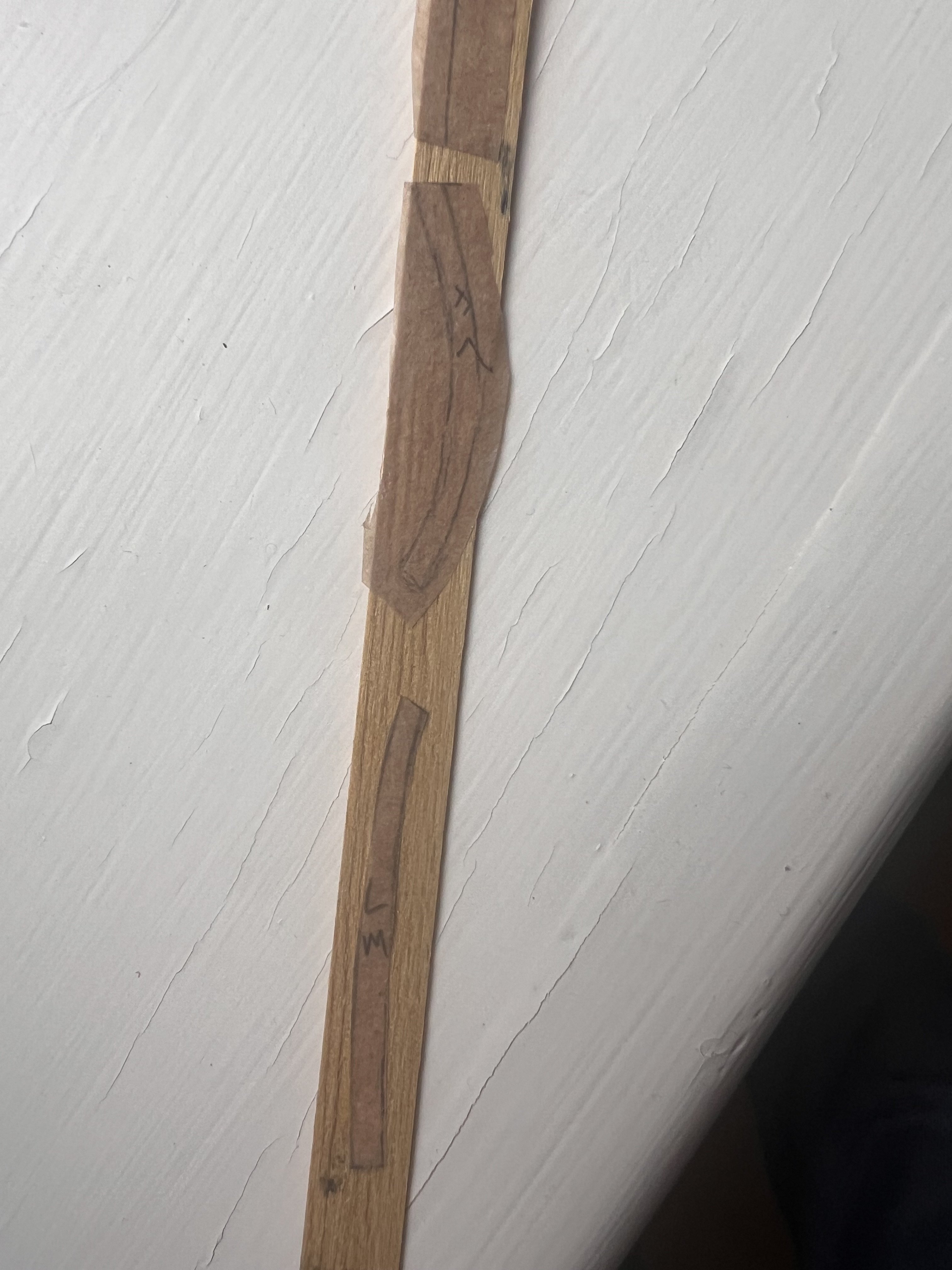

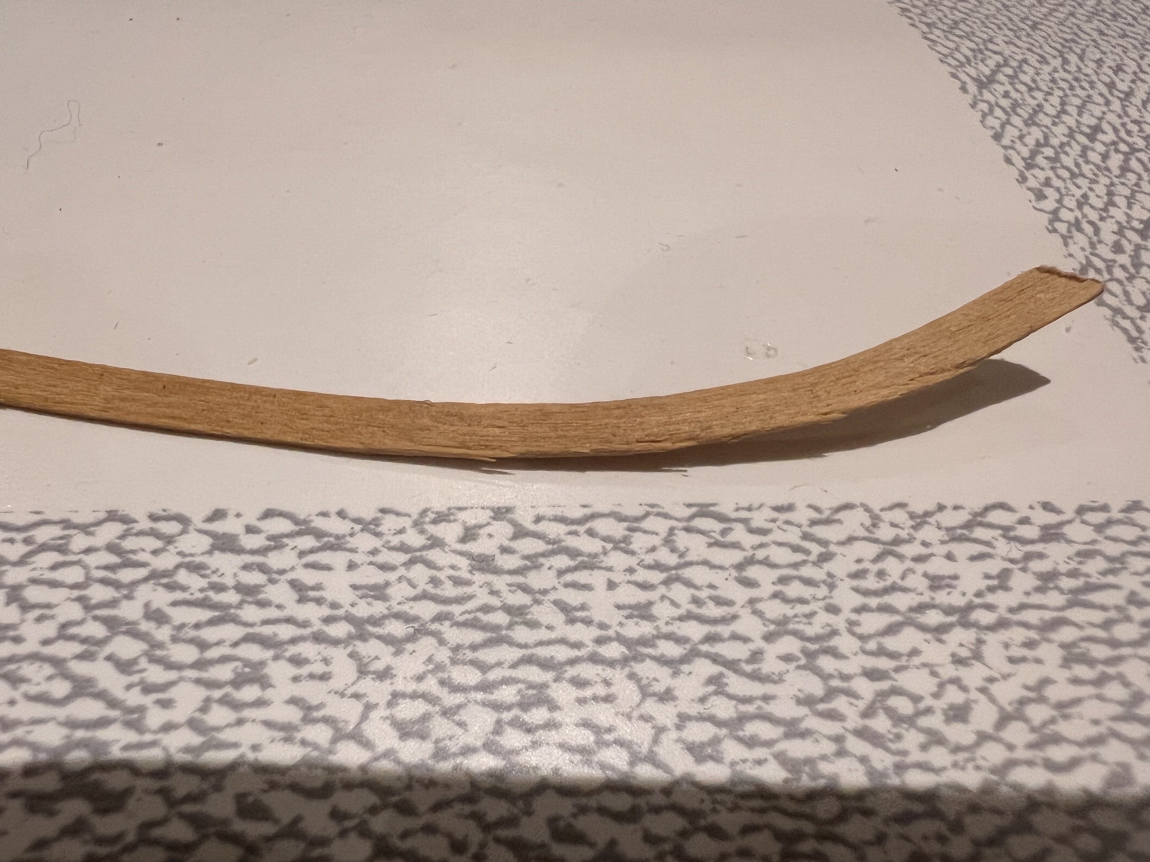

I’ve not had much time for shipbuilding recently, but I’ve managed to progress on Sherbourne slowly but not keep a full build log. My intent with this build was to work on three areas: 1. Learn to plank the deck. This goal failed. I ordered some expensive boxwood from a cabinet maker online. The strips that came were a deep yellow colour (apparently Boxwood can be). The real problem was that they splintered when I tried to soak them, bend them, cut them, etc. I started out using tracing / baking paper to trace the outlines of the margin plank from Chris’s engraved deck then glued this to a 1cm wide boxwood strip. Then tried to cut the shapes out but they splintered into pieces. I then tried soaking a strip and bending it to shape. I could just about get the shape, but the wood splintered in doing so. Clearly the wrong wood for the job. I got fed up so I reverted to the engraved deck rather than order a different wood to try. I really like the Vanguard engraved decks. I’m less keen when they’re cut away to show the interior as they are on Sphinx and Surprise. The cutaway deck works really well on Harpy as it makes the model much more interesting, but in my opinion detracts from the small frigates. It’s entirely a personal preference but I’d prefer they weren’t cut away as standard. I’d like to have had the option to fully deck Surprise myself so I can choose whether to have the cutaway engraved deck or not. I may have another go with deck planking on my next build (Speedy). 2. Paint the hull yellow ochre and see how it turns out. My planking can be messy so it’s nice to have the option of a fully painted hull. Sherbourne was one of my worst yet planking jobs, not that it mattered as everything that is planked is below the wales and painted white. I’ve been short of time and may have rushed the fairing so the planks didn’t lie as well as they should. Entirely my mistake. Some photos of the first planking below. It was worse than it looks here! I also snapped the inner plywood bulwark and am eternally grateful for Chris’s superb customer service at Vanguard. He very kindly sent me a replacement. 3. Mix and use wipe-on poly. You can’t easily buy wipe-on poly in the UK. I used the Blackfriars oil based polyeurethane varnish clear satin that BE recommended and mixed it with white spirit 50:50. Seems to work well. The effect on bare pear wood is almost identical to the finish I’ve achieved on other boats with Danish oil. Being a varnish I guess it seals and protects the wood better. The latter two have been a success - some progress photos below: There’s still work to be done to the hull before starting the rigging. I’m not going to put any ropes on the cannons on this build. I forgot to do so before fitting the ring bolts to the bulwarks and they’re so small on this build that I’m not going to try and add them later.

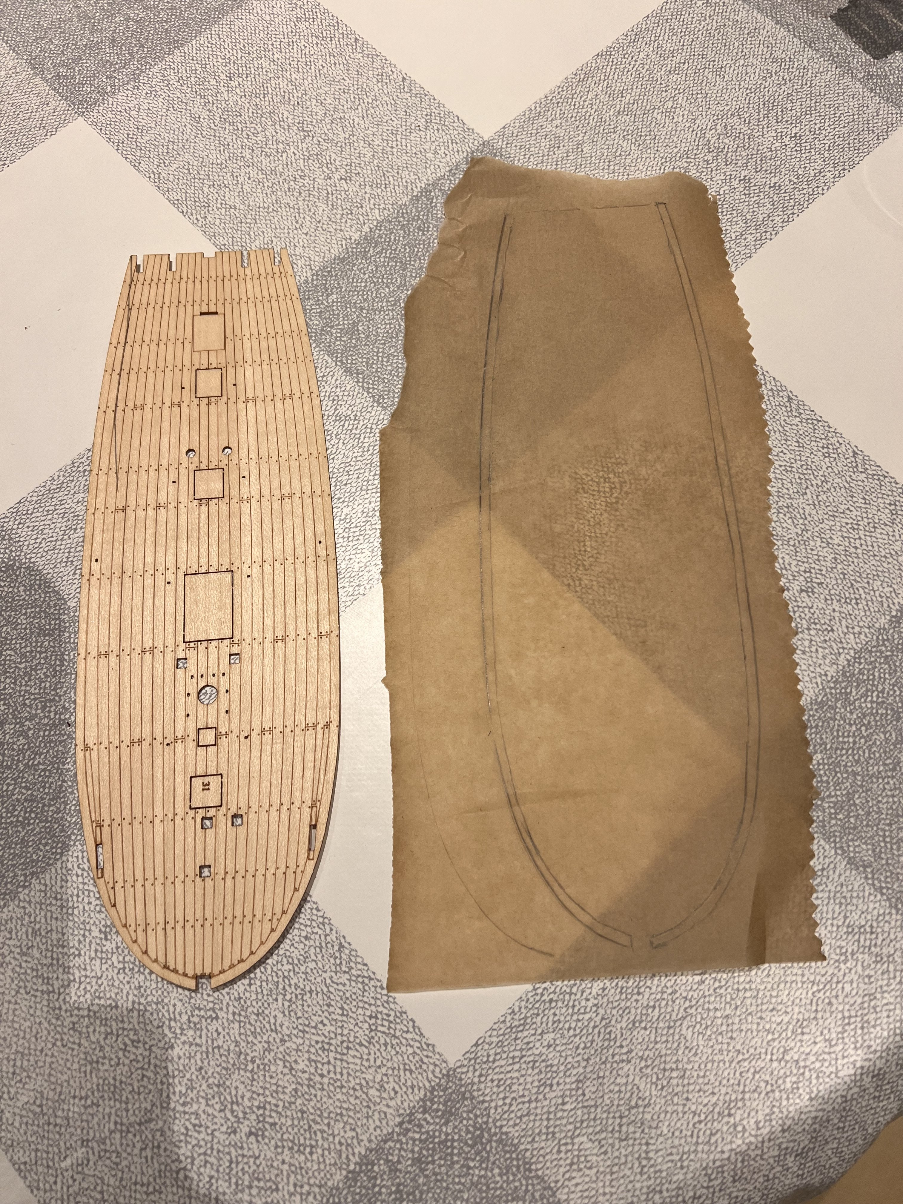

Please could anyone point me towards some materials that advise how best to do deck planking. I have never done this before. I can’t find information on MSW but I’m sure it’s there somewhere?! Thank you. Any advice on what wood to use (bass seems popular for decks?) and width (3mm?) and thickness (1mm?). I’ll likely use a pencil to simulate the caulking. Even better where to get the wood from in the UK, doesn’t look like Cornwall Model Boats where I usually buy model supplies has anything suitable. I’d like to get the materials Thanks so much. Dan

Thank you very much for the comments and likes! Really appreciated. I have been trying to research how best to do the deck planking for a kit on MSW, particularly the margin planks. I can’t find anything as it gets caught up in the search with hull planking. Does anyone have any resources on this that they can recommend? Thanks.
