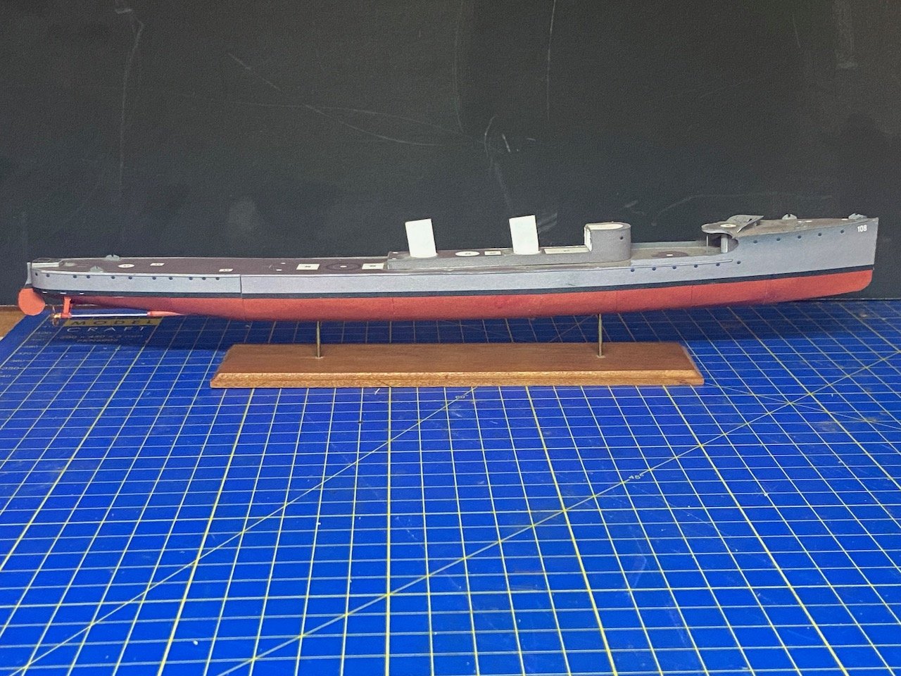

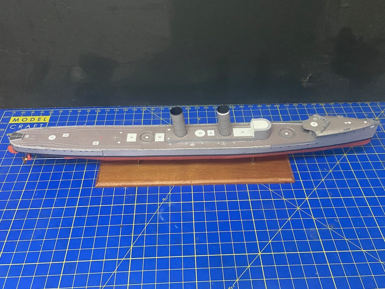

 Yesterday, I pulled out my V108 model from storage(!), and decided I needed to do a little paper modeling in between other projects. Part of the reason for this, is that the other work I'm doing right now, requires me to be out in the garage workshop, and it was just too hot in there this week. A paper model, I can just work on in the living room.
First, here are some photos that I took after my last post, which was...uh... close to 5 years ago...
IMG_5238.jpg.7babbd941626e7ccf661407f4aa0e259.jpgIMG_5239.jpg.4ca3e0ec5f24892d00aad6a7eb7500dc.jpgIMG_5241.jpg.c19835e87f8017bbb1c47e72daea4535.jpgIMG_5243.jpg.049486f6bdaefef36f5871fd092807a2.jpg
Then, yesterday, I pulled the model out of storage, dusted it off, but couldn't find what I did with the part sheets and instructions. Fortunately, this is a downloaded kit, so I found the files on my computer, and just reprinted them all. I was a little concerned about variation in color, after all, I don't even recall if I had the same printer at that time. But, I think I did, as the colors look spot on.
So, I spent a little time re-familiarizing myself with the model, and what needs to be done next. The obvious step was to do a little work on the superstructure, so I went ahead, just to make some progress...

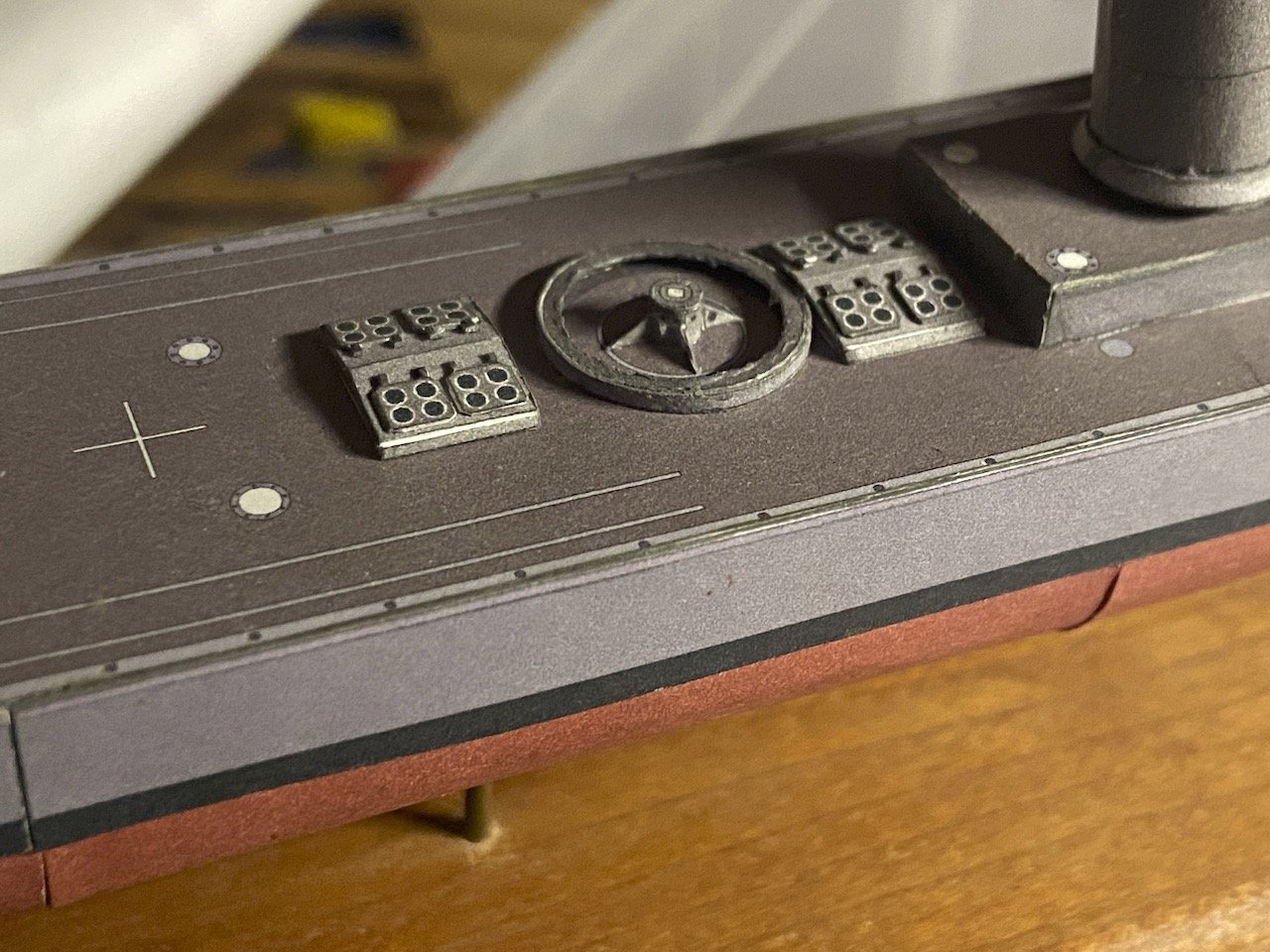

The basic superstructure was a nice re-intro to this model, as it's a major part, with no fiddly small parts to worry about, though I think I'll go ahead and mount the hatch that's outlined in the forward part of the superstructure below.
Then, I forgot what you call these little connecting tabs that help to hold assemblies together. I glued them down to the deck first, as this should keep the part from causing the superstructure to creep up from paper "bendi-ness". Test fitting showed that some of the white of the deck piece shows a little, so I ended up painting areas where the white seemed to show. Managed to paint part of those tabs as well, but that shouldn't be too much of a problem.
Finally, the superstructure is shown in test-fit. That's why it's not entirely flush with the deck yet. But, it will be, once I glue it into place.
On the other side, you can see some of the white still visible. I'll touch this up before the superstructure gets glued into place.

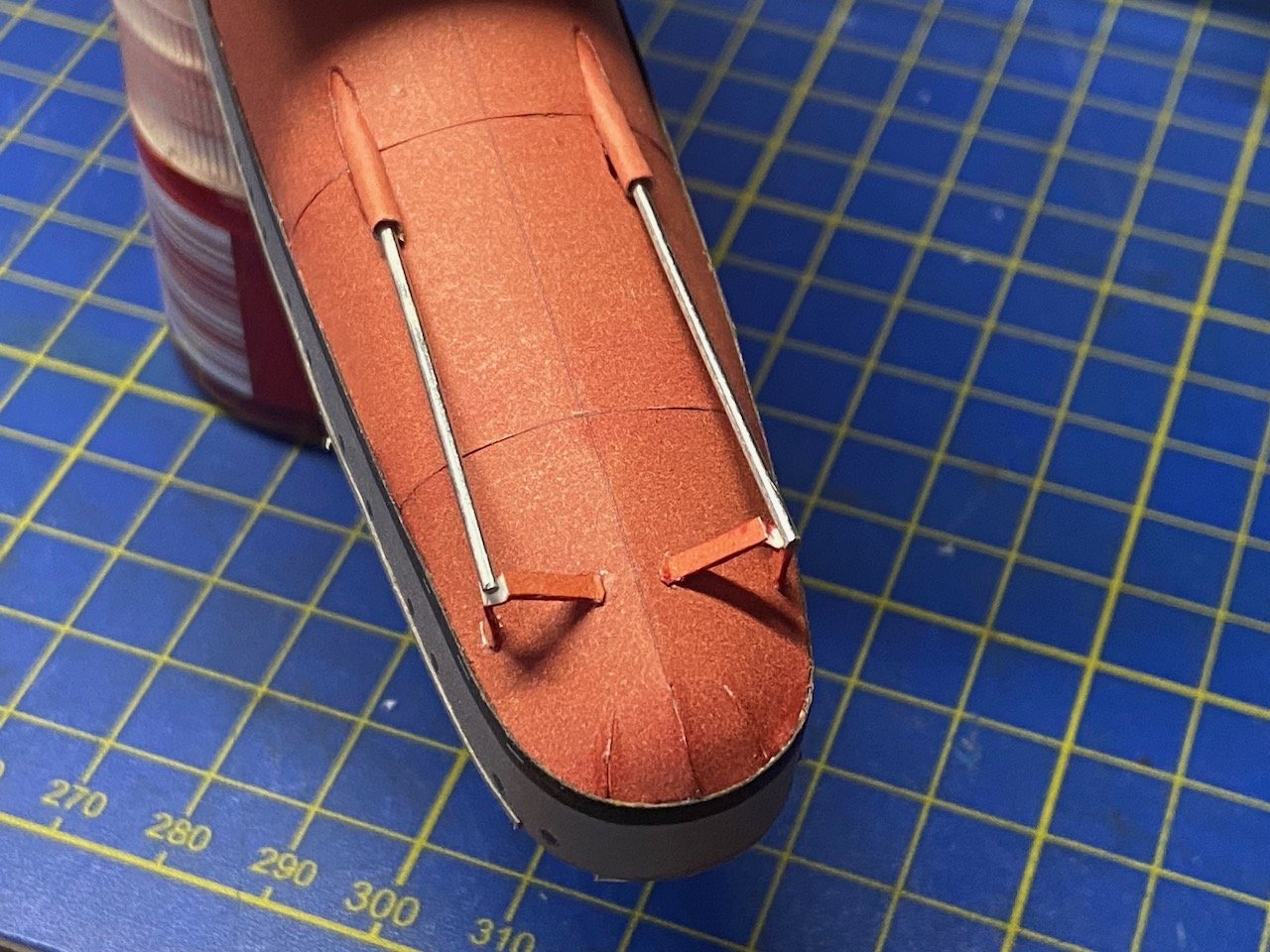

I decided it was time to deal with the ship's propulsion. Looks like I'll just use brass rod for the shafts. That's actually indicated in the instructions. But, first, I needed to make the extensions that come out of the hull and partly house the shafts. I don't know what the correct term is for these.
I tried to roll the printed paper, but had a very difficult time getting not only a tight roll, but also a difficult time getting the pair to match. That is, they were slightly different diameters. It has to do with the difficultly of rolling the paper.
I decided to reprint the parts on thinner stock paper. To save on ink, I copied the parts sheet pdf, and managed to crop the parts sheet down to just the area on the sheet that I needed. This printed out fine on the thinner paper, in my case, 28lb, instead of the 65lb card stock I used for the main parts.
I rolled the tubes with the help of a piece of thin brass rod, and the pair seemed to come out just fine. Here they are with some of the parts I started pre-assembling...
But, looking back, I noticed that printing on the thinner paper was actually what the instructions said to do. In the future, I might just make several of them, then pick out the best looking pair.
Finally, I decided to tackle what I considered to be the most intimidating assembly of ship of this type, the screws. This entails rolling a piece with petals, then  gluing together the petals to form the hub of the propeller, then gluing on each of the propeller blades at an angle. But, the process ended up being far easier than I had anticipated.
I formed the rolled hub on the end of a small dowel. When dry, I put glue on the petals and then carefully rolled the end against the cutting mat. The end results were actually pretty good, and I ended up with the ends nicely rounded.
Gluing the blades turned out to be pretty much a non-issue. I made sure to angle them differently for each of the screws, as they would be counter-rotating on the real ship. Then, I touch each blade with a tiny amount of thin CA. This made the screws very sturdy.
As the printing on the blades are only on one side, the screws are going to have to get painted. Now, do I go with matching the color of printed paper? I do I break out some bronze paint and do the whole thing?

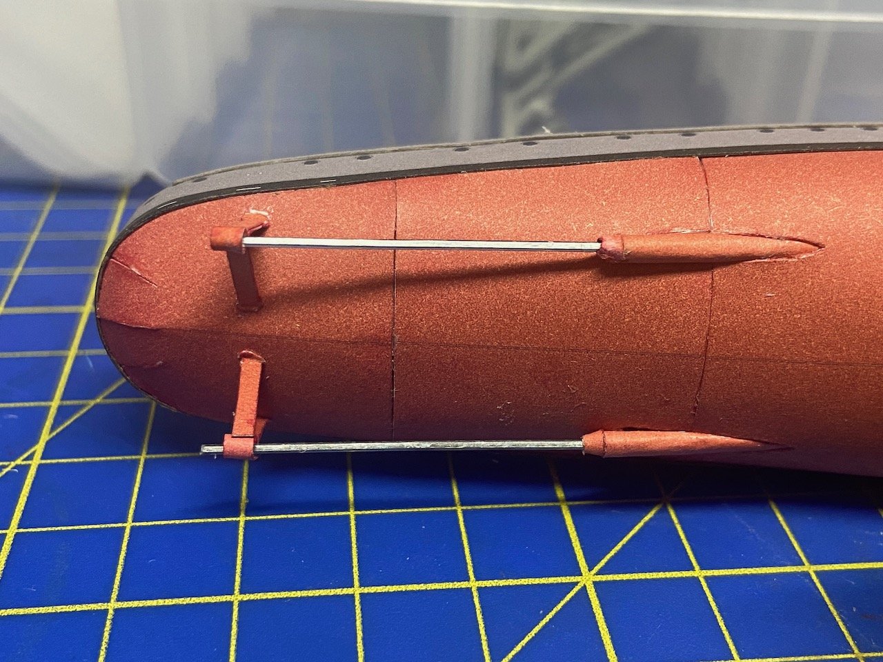

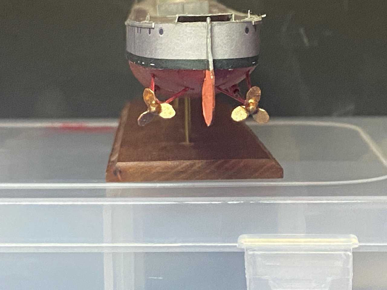

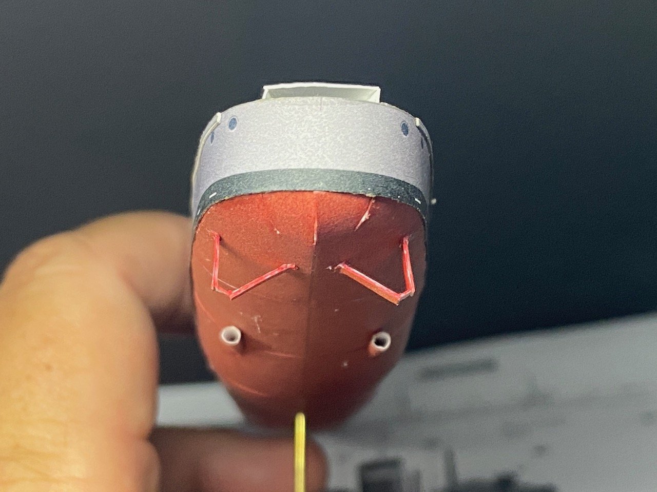

The propeller shafts and struts kind of stopped me in the tracks, and I was reluctant to look at them again. But, I just put my head down and pushed forward. Managed to build the support struts, even though I found their construction particularly confusing. Did I build them correctly? I don't know, but I'm pretty sure what I have will work.
IMG_1801.thumb.jpeg.ab62225bbbe95ea25b9774913fef98d4.jpegIMG_1802.jpeg.d3595cbf5aff2f14e0af6c548025a263.jpegIMG_1804.jpeg.6e2932ec0cb326c6297978c705f65b02.jpegIMG_1805.jpeg.0e65f65637990a676264fc0f213a2efe.jpeg
For the propeller shafts, I wanted some steel rod, but couldn't find any in my stash. I ended up improvising, as I don't want to order parts and wait for them to show up. I found a large. paper clip, straightened it out as best I could, and cut it to size. I think it works pretty well. These aren't glued into place yet. I need to make the various fairings for the shafts first.
I'll try to take less than another 8 years to post progress on this...
You know, sometimes modeling in paper makes a ship seem to progress so quickly.

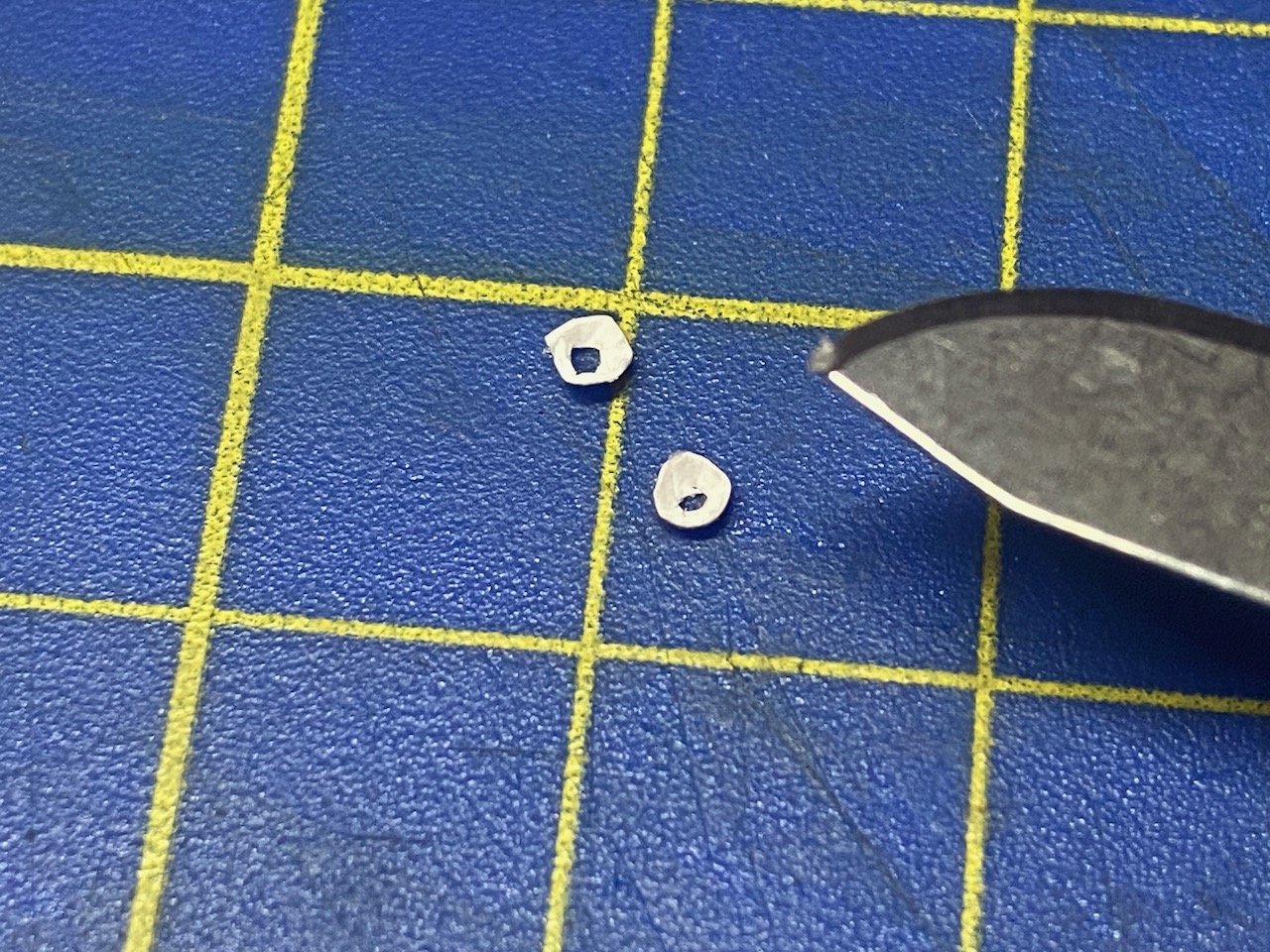

Then, there are those items which make you feel like you're doing eyeball surgery on bugs.

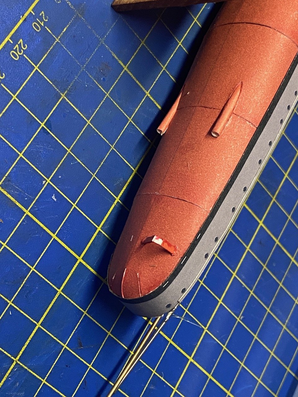

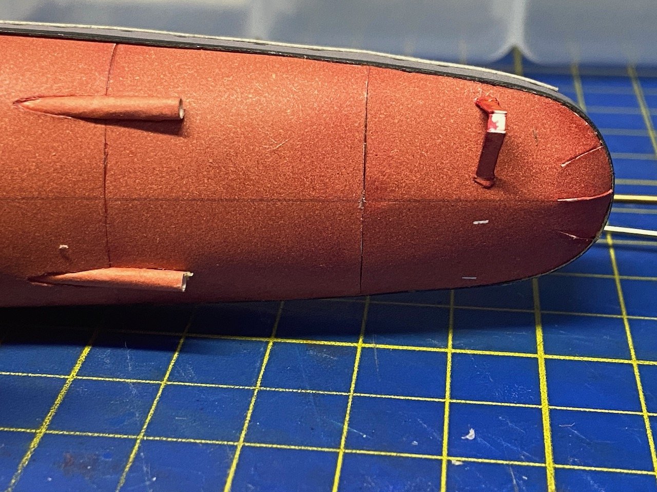

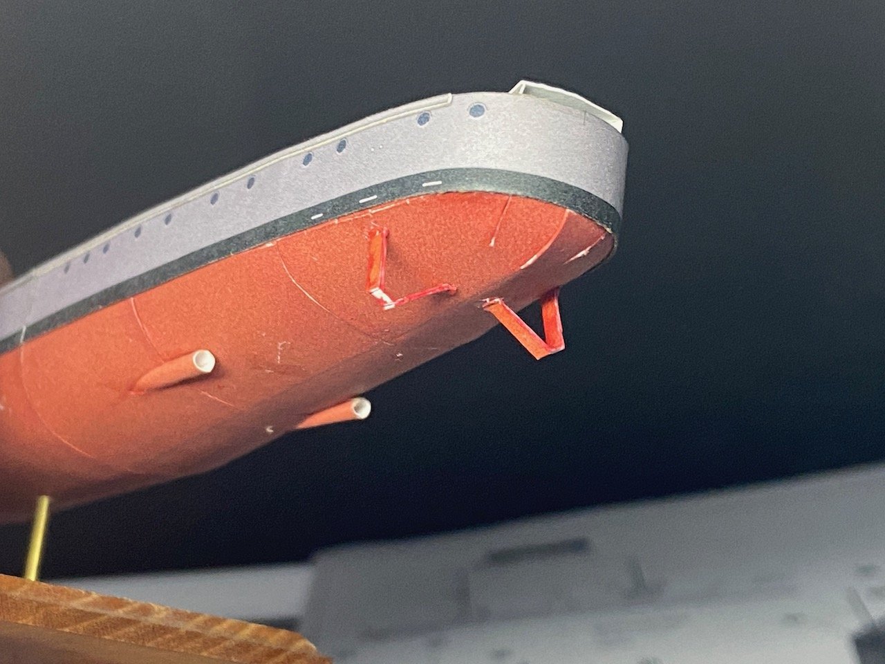

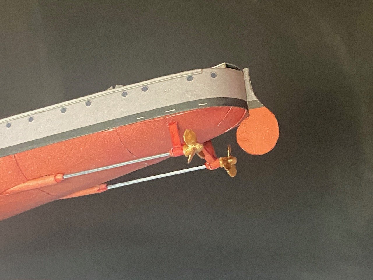

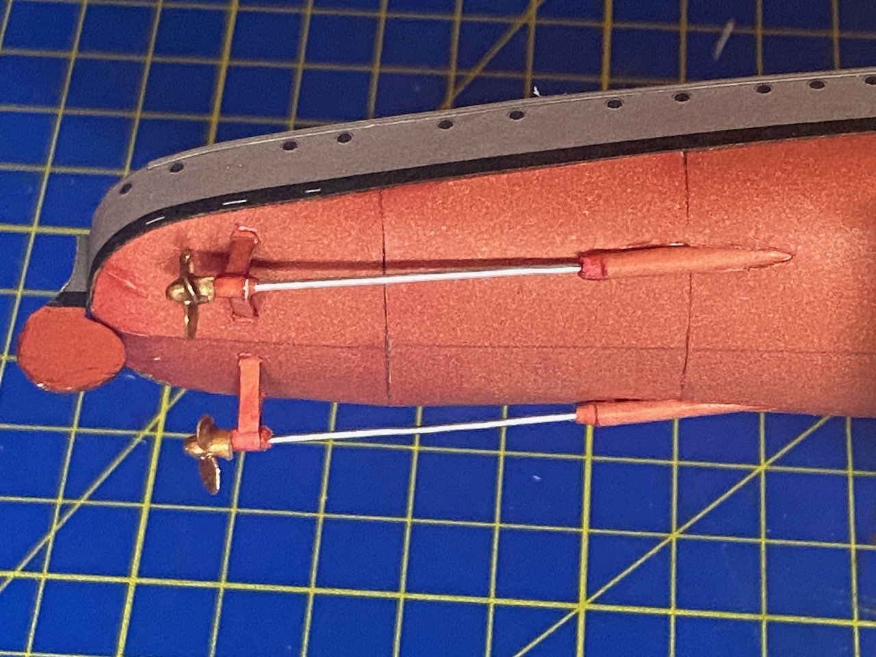

Adding fairings that fit around the propeller shafts. I've had to remake parts about four times. Fortunately, I had printed extra parts sheets.
I discovered that my propeller shafts were too big, so I went the next size down on the paper clips. The first shafts were about 1mm diameter and the new ones are 0.7mm. These tiny fairings wouldn't fit around the larger shafts, but the should fine with the new ones. Hopefully, I don't lose any more of these little parts, after it took so much effort to cut them out, roll them, and glue them up properly. The shape looks a little rough, but I'll bend them more nicely after the glue dries.
I have to admit, I started wondering if I could just leave these things off. Would anybody notice?
And... Finally done with the underwater portion of this build!
That part of the ship doesn't look too bad now. Adds a lot of detail. But then, at this stage, anything will add a lot of detail. Still, this is the part that made my head hurt the most, and it's over.
I do feel I spent way too much time stressing over this part. But, I also spent a lot of time on it today. I'll consider next steps.

Propellers and fairings... It's enough to make you want to stick to waterline models! 😀
But, now that these are done, I like the look, just not from TOO close!

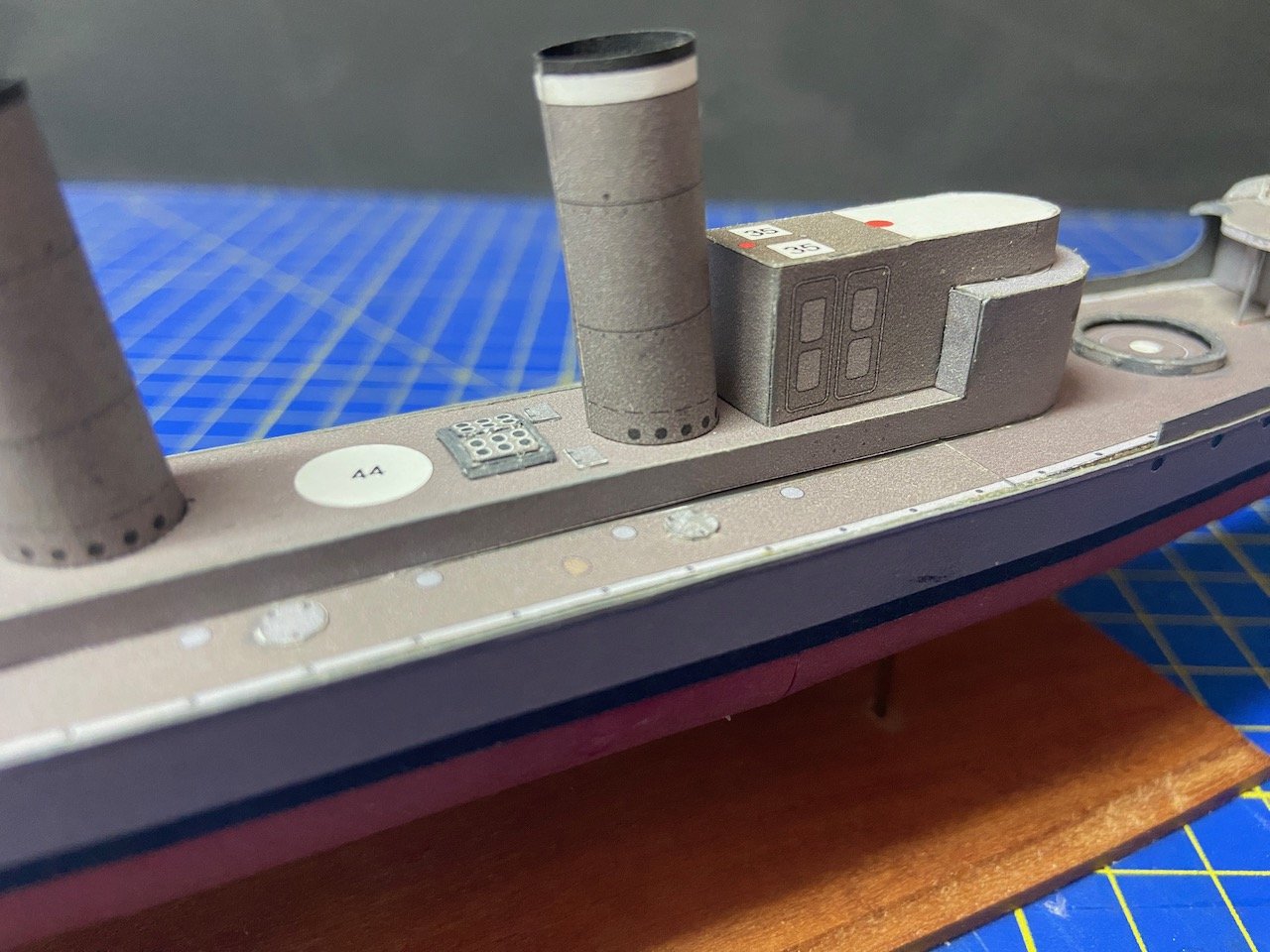

For the torpedo tracks, I built them before I looked again at Chris's build log and his idea for making construction easier. Mine turned out okay, but I just had to glue the outer edge of the ring on, little by little, to keep it straight.

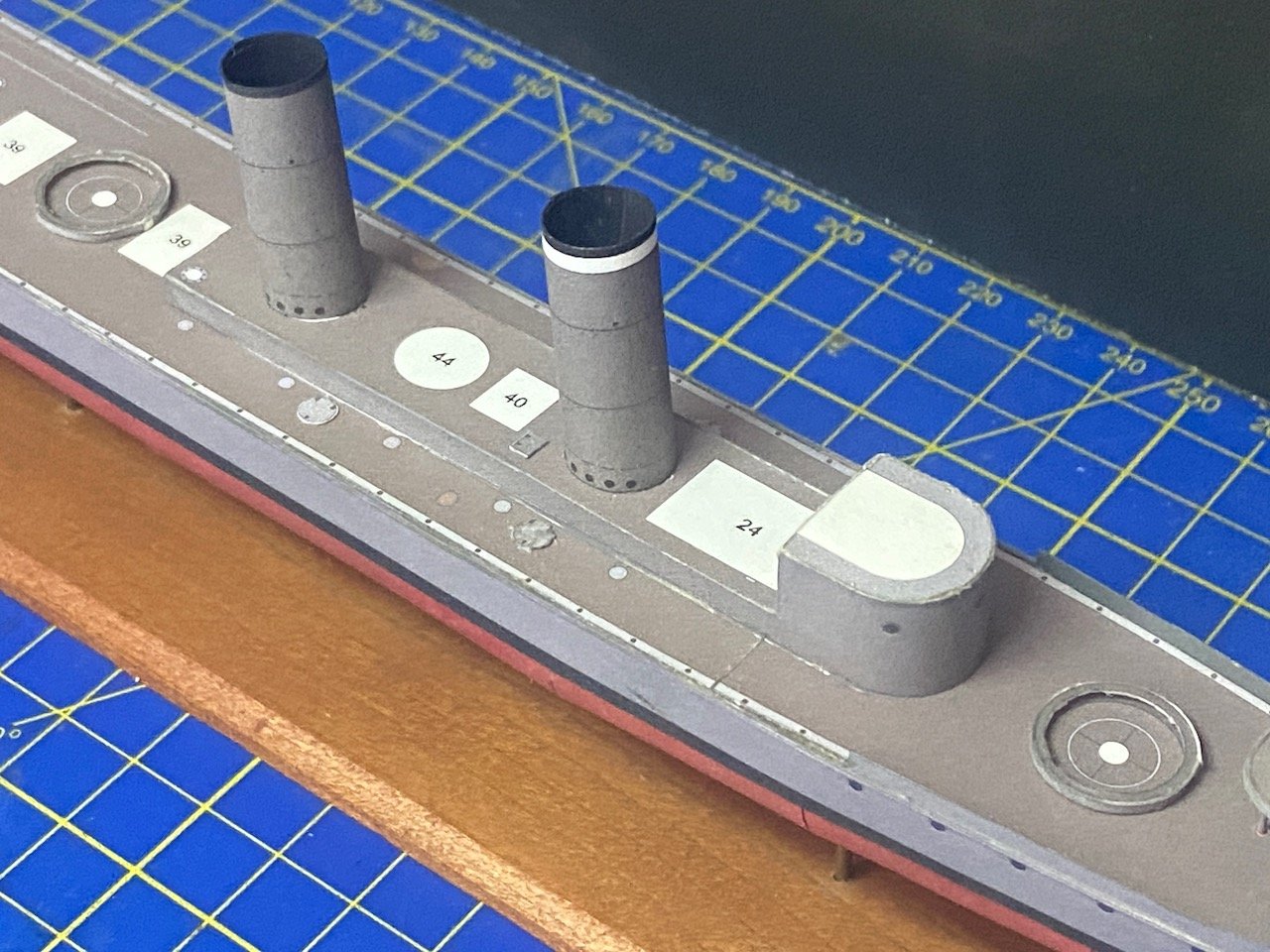

The funnels are nice, large parts, changing the look of the slowly evolving model. I painted the interiors black, but you can still see he white areas of the superstructure. I'll finish that painting after the funnels are glued into place.
For now, the torpedo launcher tracks and the funnels are only dry fit
IMG_1818.jpeg.7eaa4b06906bc4f07836739bd925747d.jpegIMG_1819.jpeg.84b8d34ade49e721fdf5d1417715827e.jpeg
I still need to clean-up and paint the insides of the torpedo launcher tracks, but then I think I'll glue them into position. I think I'll leave the funnels unmounted until I decide if I'm going to try to detail them any. For now, they're pretty safe like that, and they make the model look more like a ship.

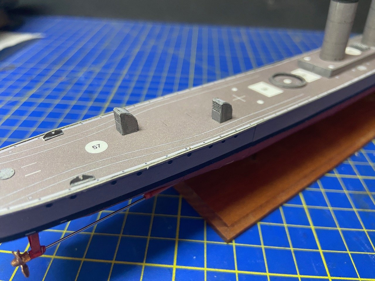

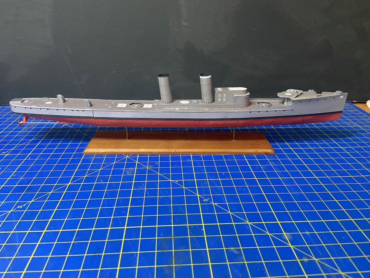

I had a little more time to work on my V108 yesterday. It doesn't really look much different, but I managed to add those cowlings on the af deck, and added the next assembly to the bridge superstructure. And, while I'd added the rudder last time, I managed to knock it off, so I'm leaving it off until a later stage.
Chris, in his tutorial build log, mentions not knowing what these things are for. I don't know either, but I'm wondering if they could be smoke generators? Or, maybe they're just exhaust vents for blowing the hot air out of the engine spaces?
Added to the bridge superstructure and added one of the skylight hatches. For mounting the superstructure assembly, I followed Chris's example of adding some guide strips to the deck. This helps align the parts and gives the glue a good surface and makes the added assembly pretty solid. IMG_1830.jpeg.1802a59253b5239a1920fc4db6f318e7.jpeg
And, finally, I added the little bollard or capstan assembly on the forecastle. There were too many little rings for me after making other parts, so I just cut some thin slices from a styrene rod instead, and painted it all black.
These close-up photos make the model look so much worse than it does in real life. Or maybe my eyes are so bad, I can't see the missing paint, etc., except in close-up photos.
