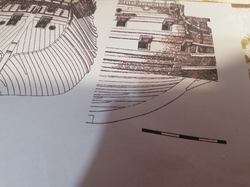

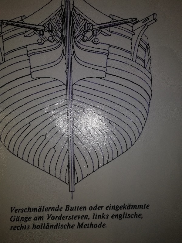

Hi.
Planking second layer, this time on the broadsides.
Hollandisch base.

Hi.
I encounetred a mistake. First time i regret i did not do it in the instructions. Planks system was spoils
http://www.koga.net.pl/phpbb3/bridge/file.php?id=55941&t=1
http://www.koga.net.pl/phpbb3/bridge/file.php?id=55882&t=1
Make that formed whatever be like http://santisimatrinidad.jun.pl/viewtopic.php?t=2039&start=0
This on my base is not correct, i know it has to be arranged as it want.
What i can do? 100% i pluck one plank because it 3mm incorrettly set, and after fenders willl cover badly planks, and after paint the subwater part of the ship? (ONLY SUB WATER, HIGH LEVEL IS IN NATURAL WOOD).
I wanted to work well, as always... What do you think?
