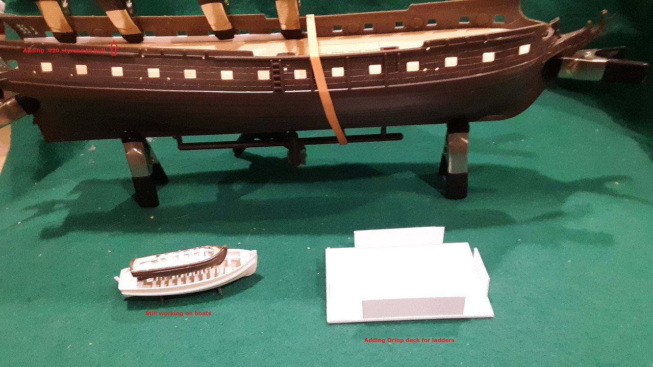

Well I am going to try 'Start a model and finish it'.  I got the Lindberg 'Jolly Roger' at Hobby Lobby with a coupon for $17.
I will make some changes to the kit, add details to the gun deck, improve the masts and spars, make my own sails, and decide on which color scheme use.
Improvements:
add birth deck under ladders
add hawse holes
add gun deck capstans
add officers quarters
add galley stove
Hope to make some progress soon

I kinda chuckled about the hawse hole........I've built this model already.  another person was building it and asked the question about the hawse hole,  and I told him the same thing :D
I built mine as the Jolly Rogers,  but it can be morphed to be the Le Flore,  just like the Capt. Cook kit can be morphed into the Warppen Von Hamberg.
    there are a few flaws with this kit.....the biggest one is the gun deck not lining up to the gun ports exactly,  when the two decks are assembled and fitted into the hull.  I think I did a log on her......not the Le Flore,  but the assembly is the same.  I also have the Flying Dutchman glow in the dark model......not that big of a hoot  ;)   other than the deck issue though,  it is a fun model to build.  are those 1:96 scale blocks?  I did the same thing :wacko:   you'll like the way it comes out  ;)

Thanks for the info Denis, I have followed your build from the beginning and purchased the kit because of it.  I will build it different than the instructions show by installing the the gun deck first, like the Revell Constitution kit, and the upper deck later, we'll see how that goes, wish me luck.

doing that,  the only thing you'll find tedious,  will be the pillars.    for an easy out,  trim the pins off the tops of the pillars.  cement them in place so they stand perpendicular and straight.  when you add the spar deck,  just glue around the edges of the deck....don't worry too much about the pillars {unless you want too}.  you won't be doing anything too stressful on deck to matter much  ;)   it does build into a nice model.
