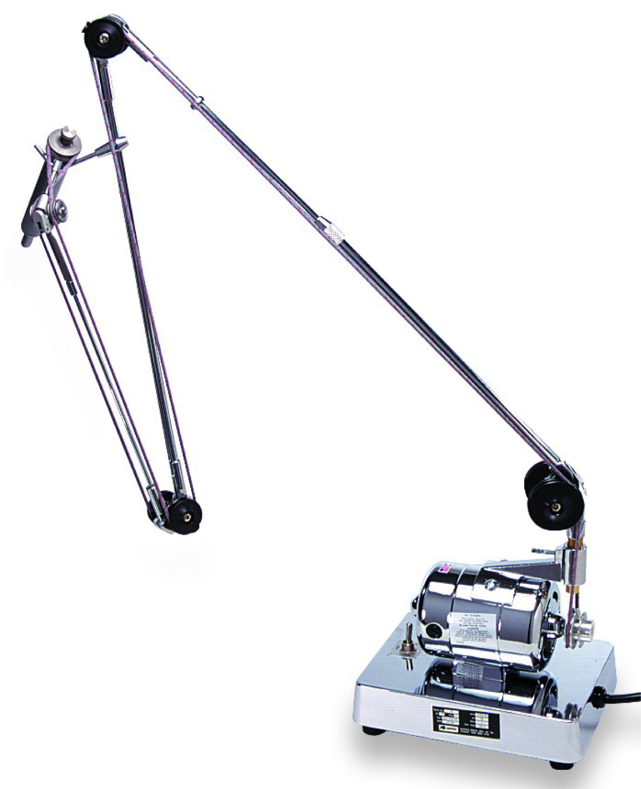

As it turns out, I scored a brand new Buffalo Heavy Duty Bench Engine and handpiece the other day on eBay for seventy-five bucks. Retail is around $750 for the motor and arms and another $200 to $300 for the handpiece selected. Amazingly, it was being offered as a "non-operational steampunk decorative piece!" (Sometimes eBay's algorithms screw up and stuff gets listed where you'd least expect it and is overlooked.) Careful examination of the photos revealed it was in pristine condition. After a quick call to the manufacturer, which confirmed all parts were available for that model, I figured it was worth $75 to try to make it run. When it arrived, it took me about five minutes to realize it was of recent manufacture, had never been used at all, and was in brand new condition, but only missing its belt, a pulley sheave (wheel,) and its  motor brushes, with one brush holder socket broken. I have no idea how the seller came by it. So, once I get the parts ordered and received, I'm good to go. My Foredom flexshaft may be gathering dust soon!
My new Buffalo Dental Manufacturing Company Heavy Duty Bench Engine:
