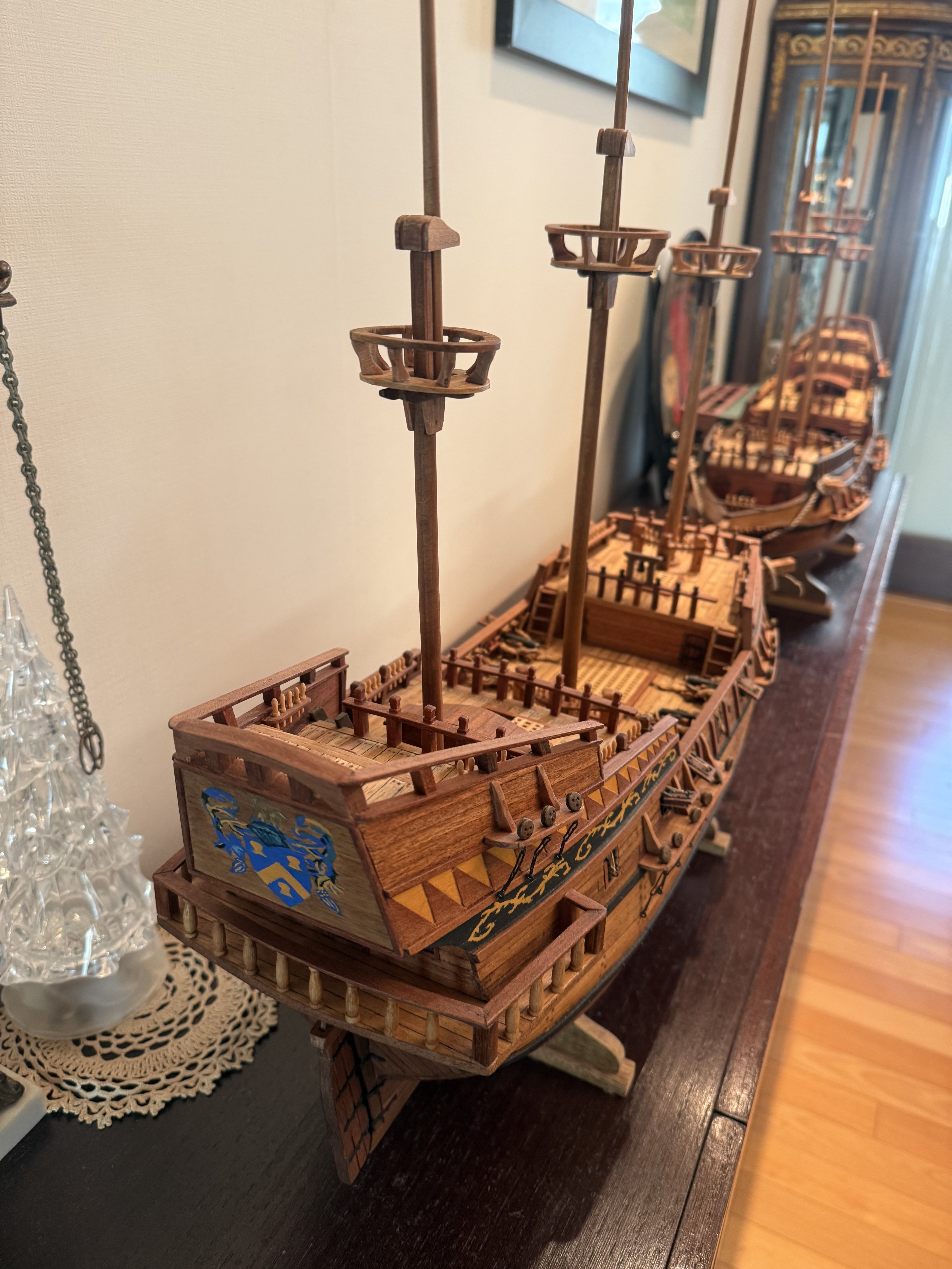

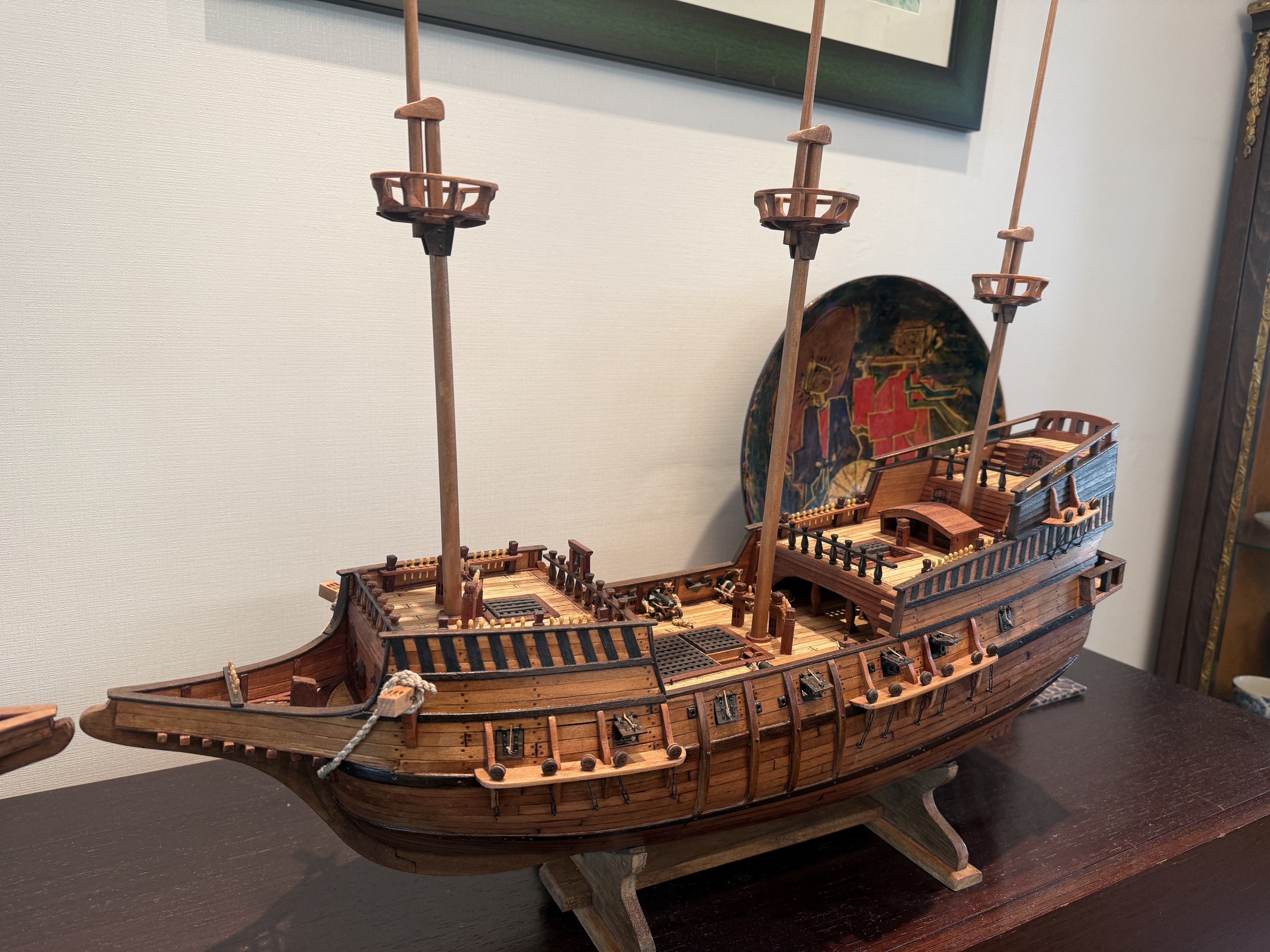

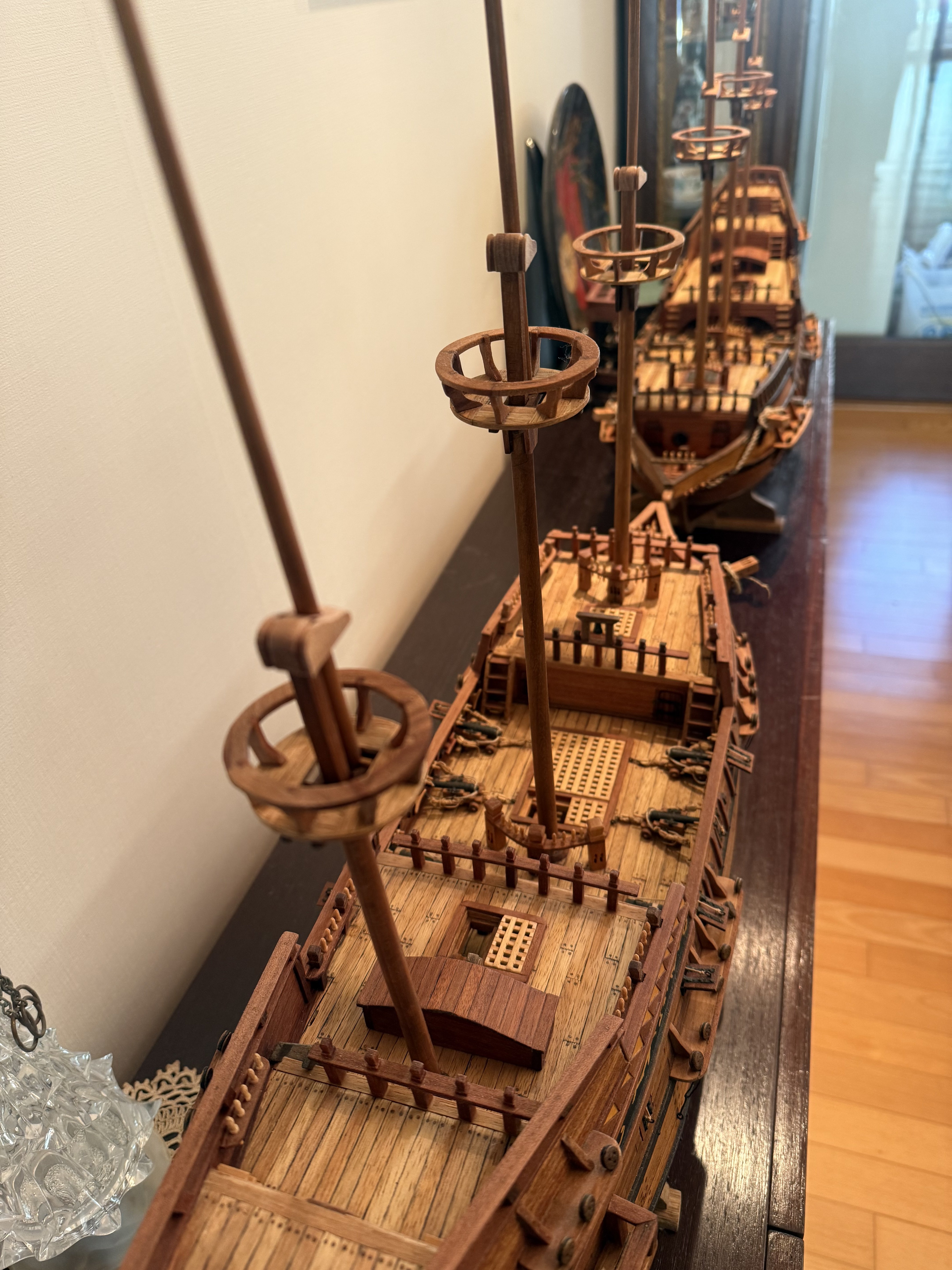

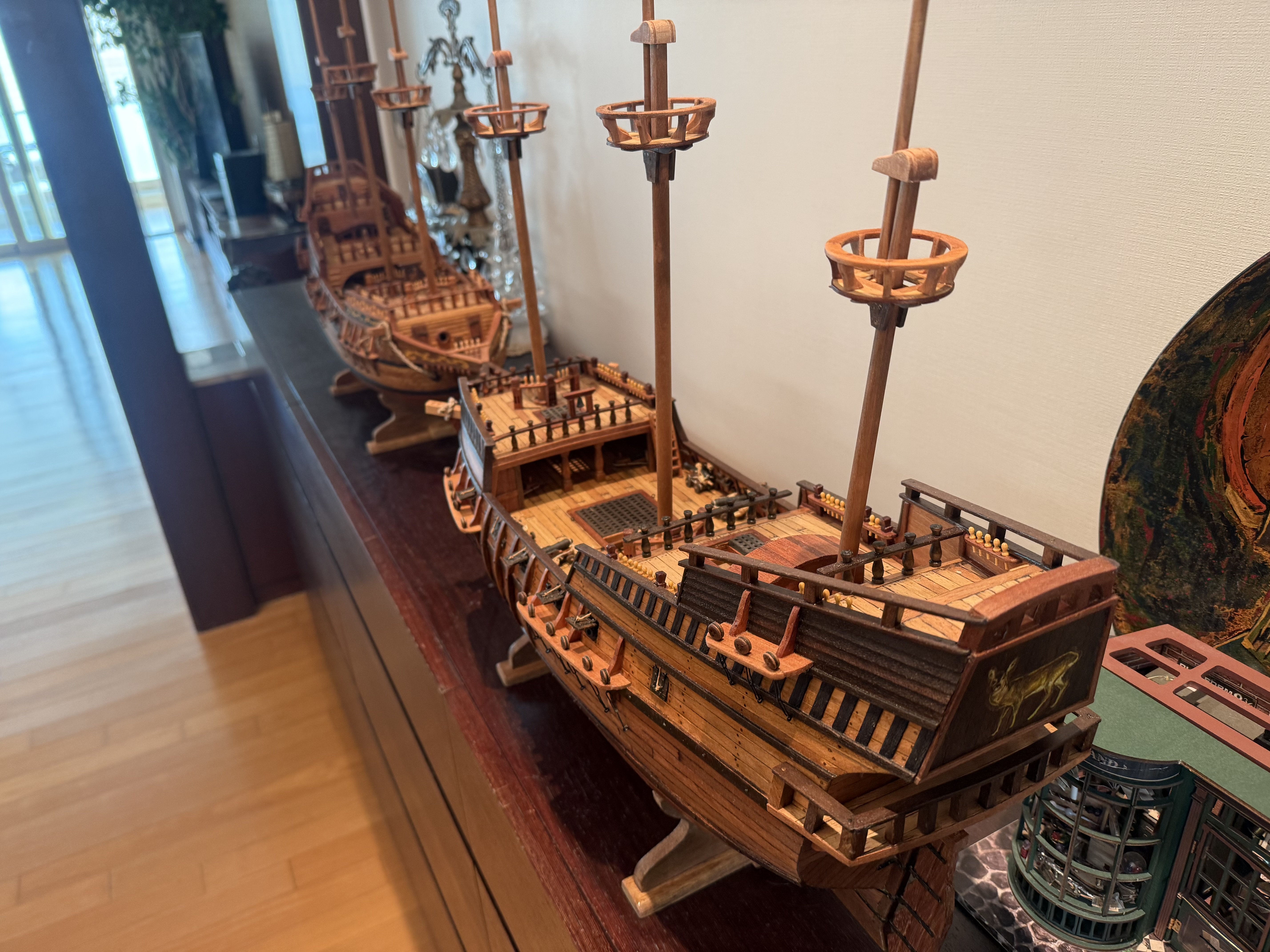

Just a quick update on GH1 and GH2 shipyards. The fighting tops are finally all done~ I am posting some pictures of these below.

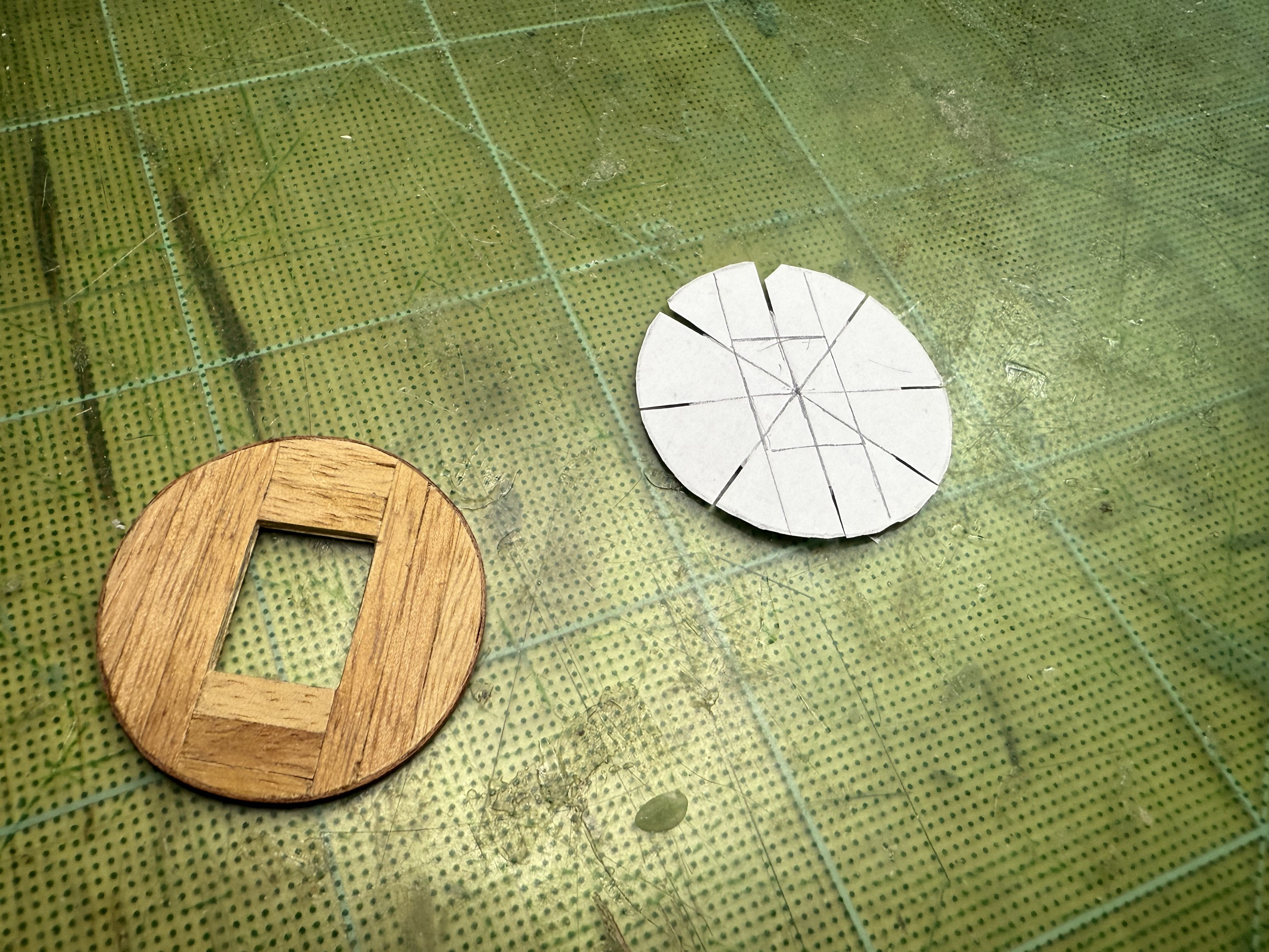

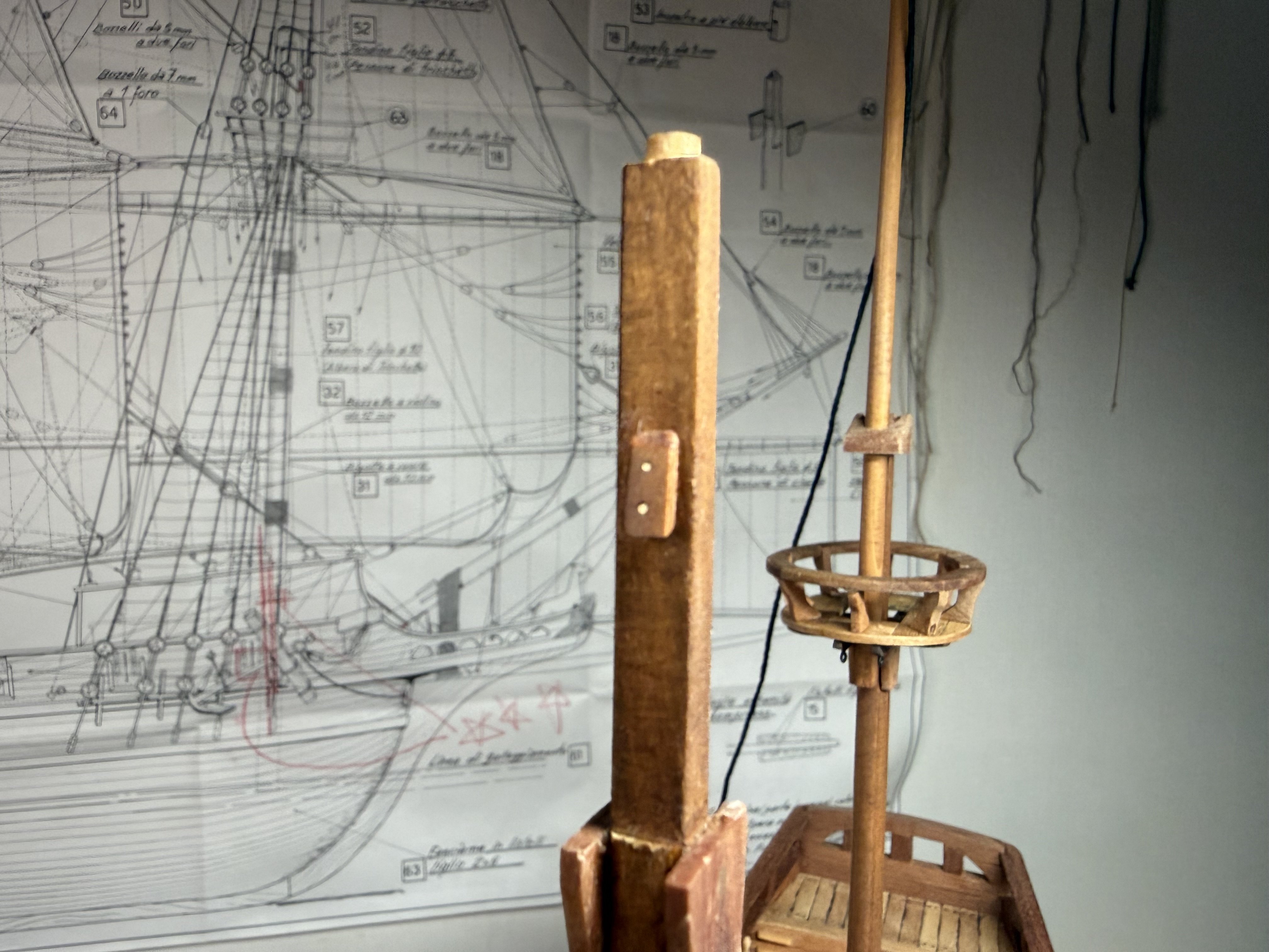

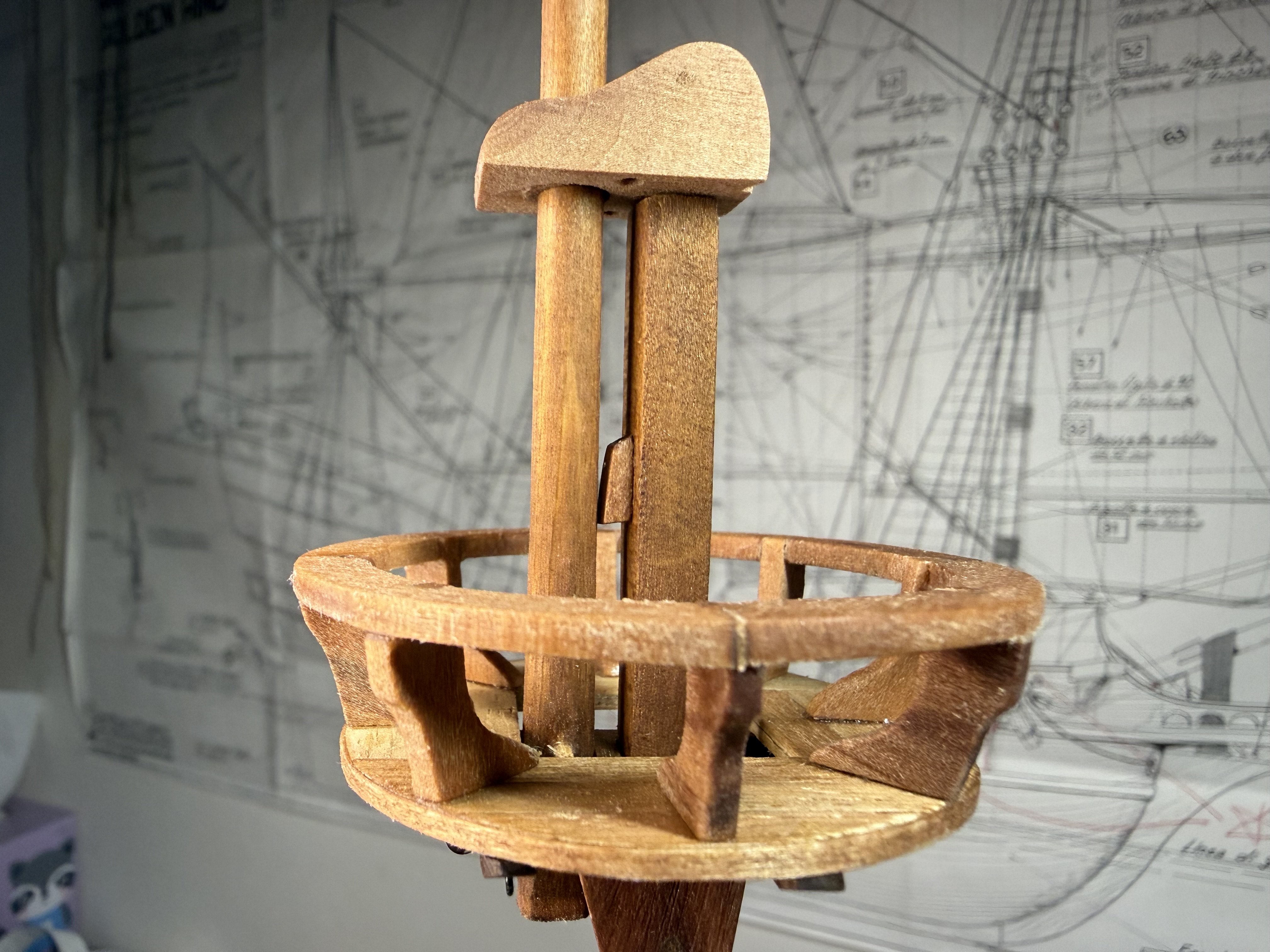

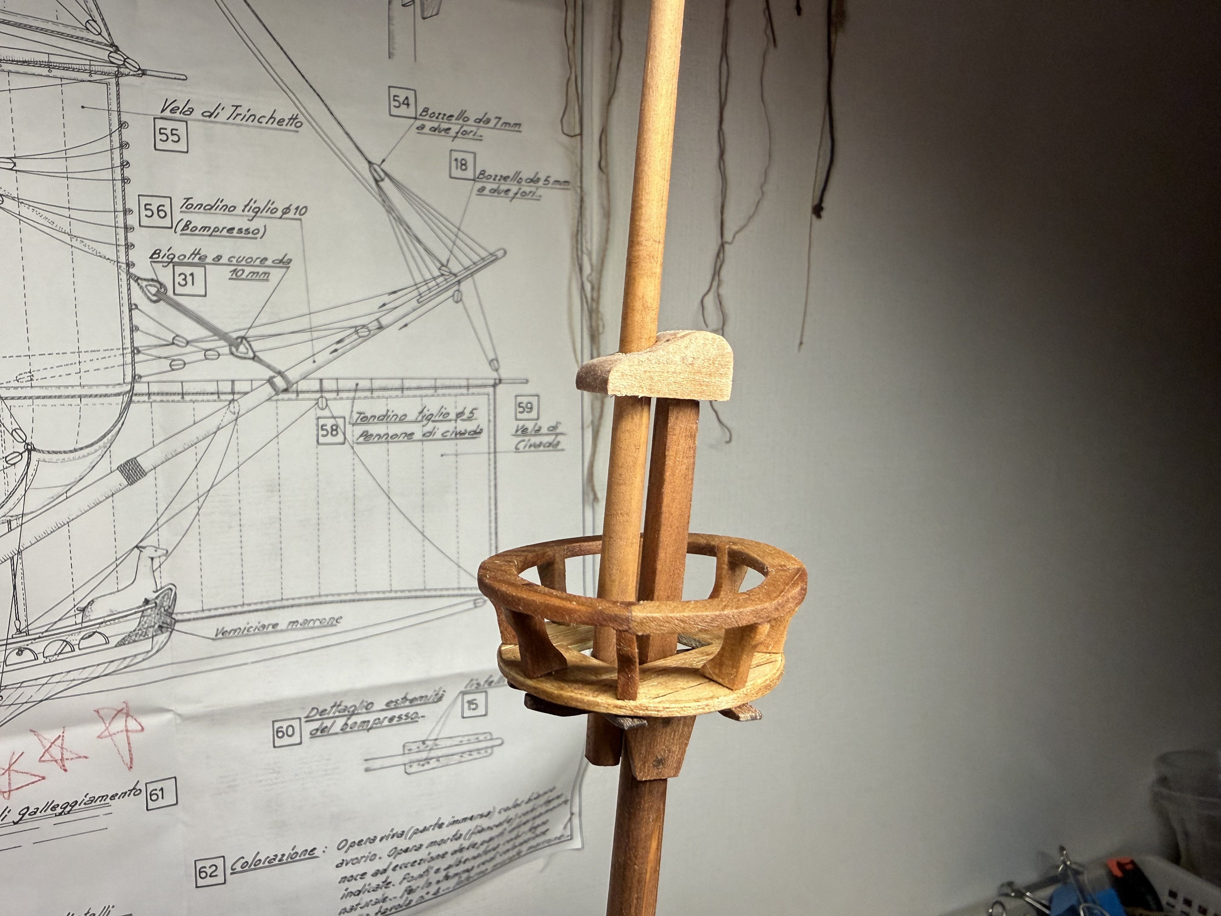

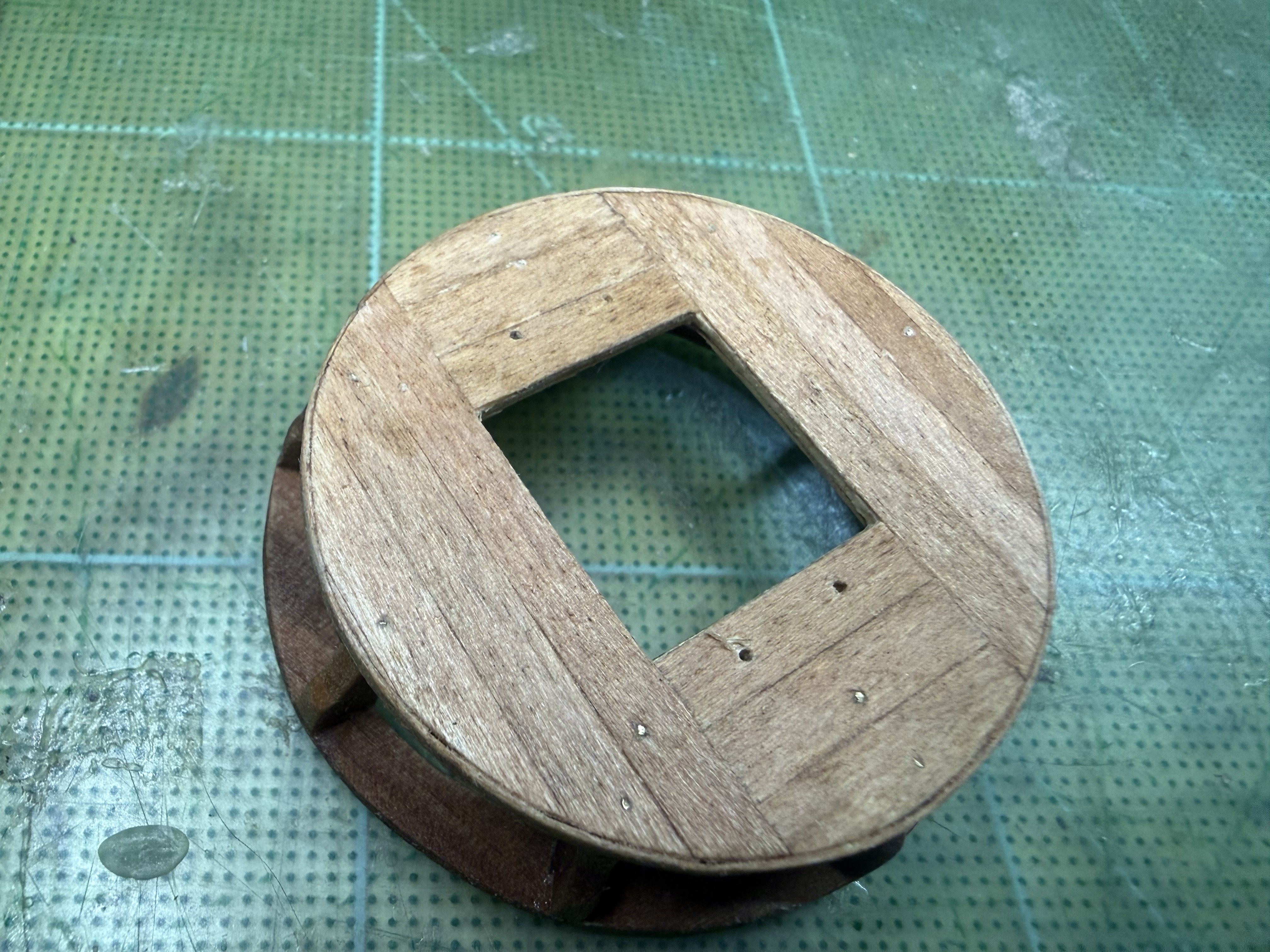

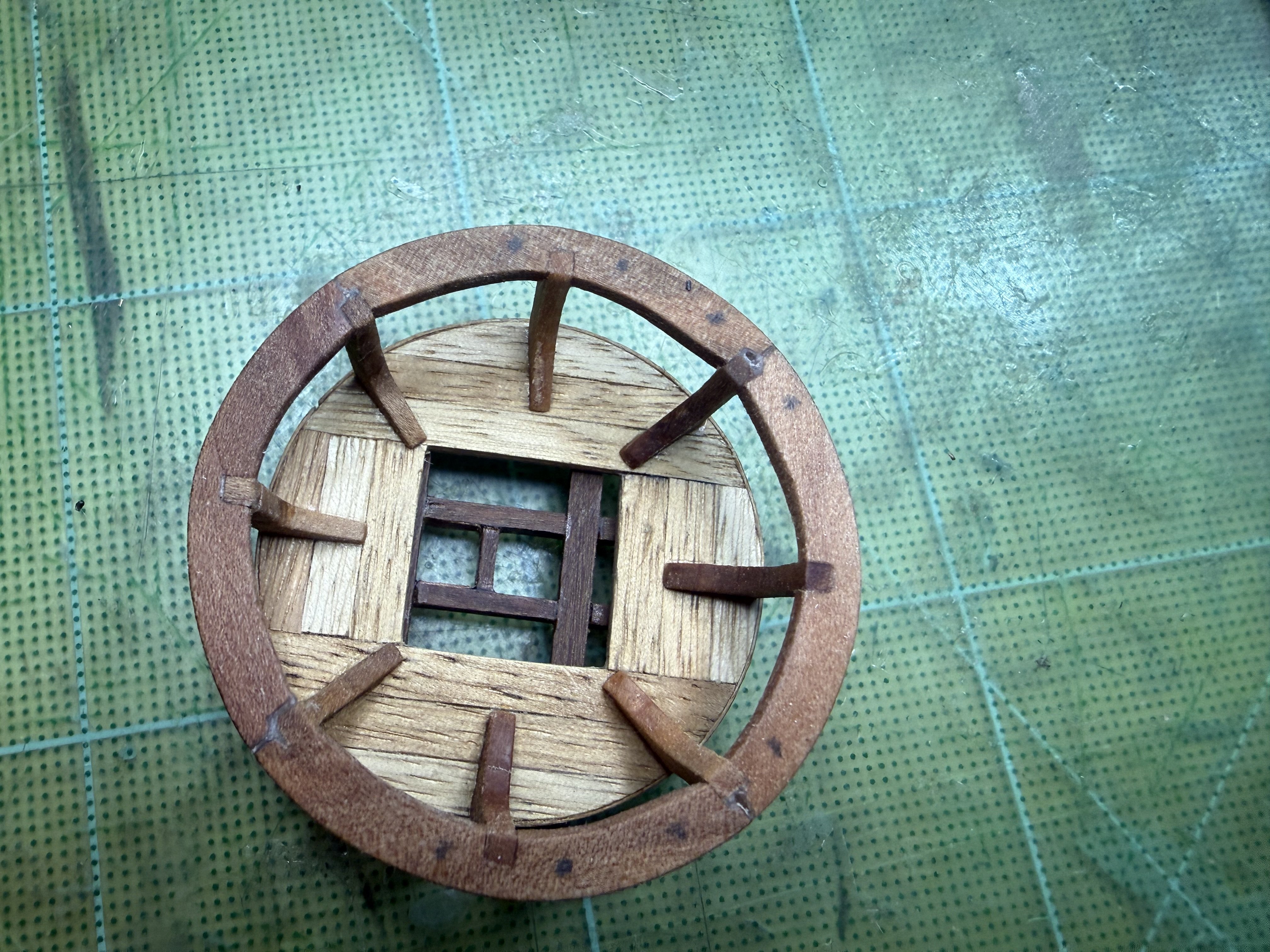

First up are the photos on the fighting top on mizzen mast. Significantly smaller than the fore and main mast fighting top.

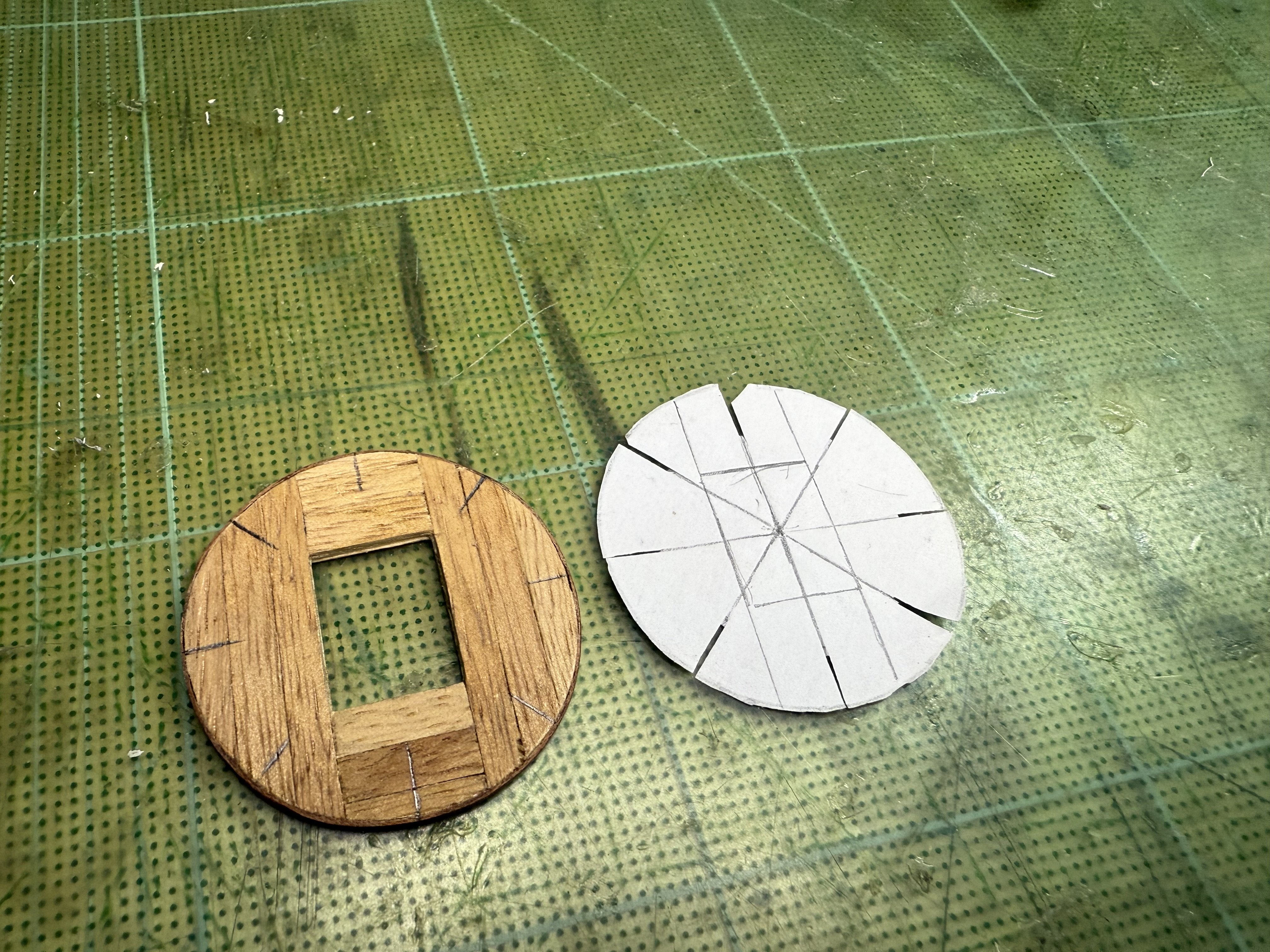

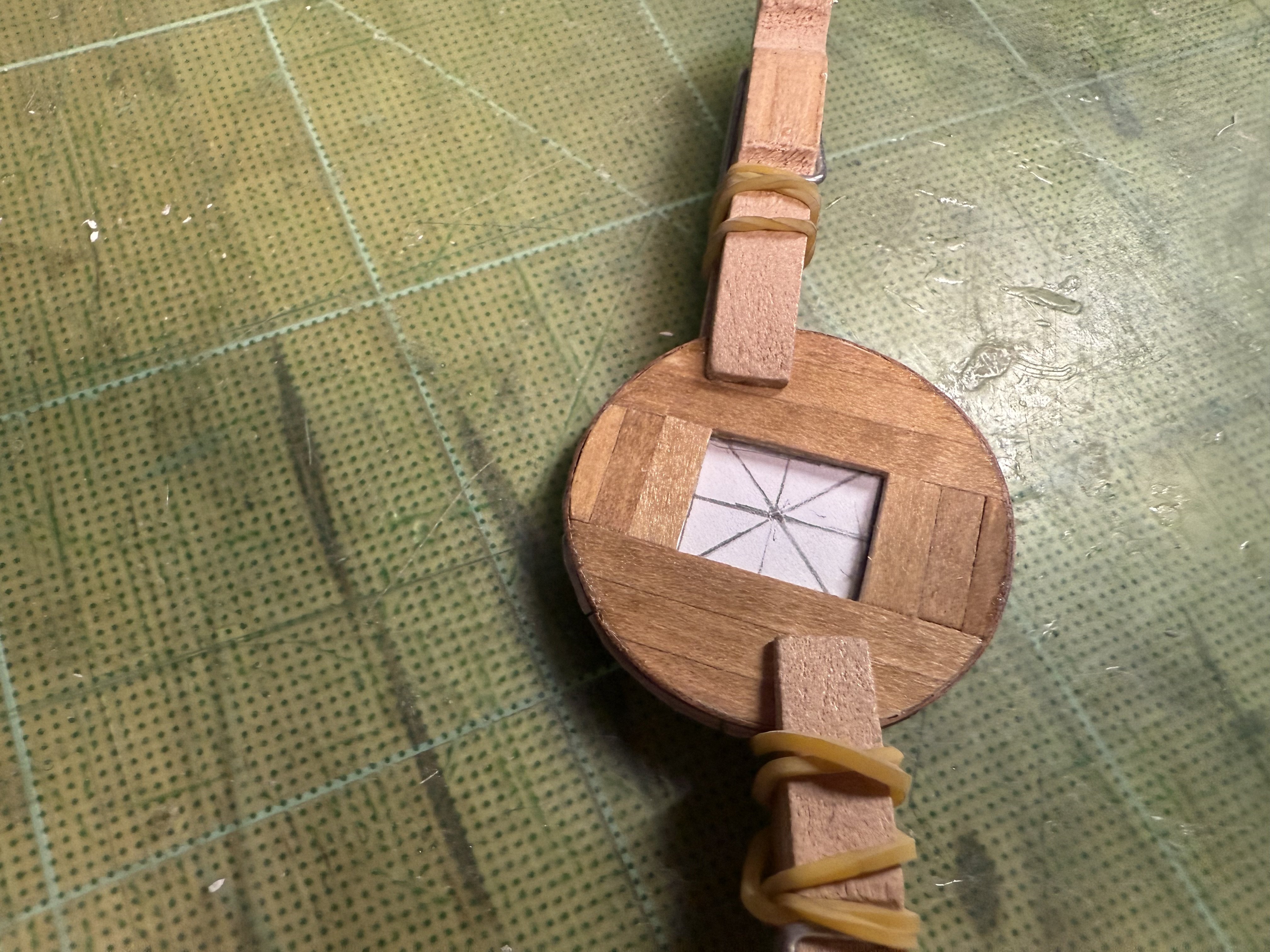

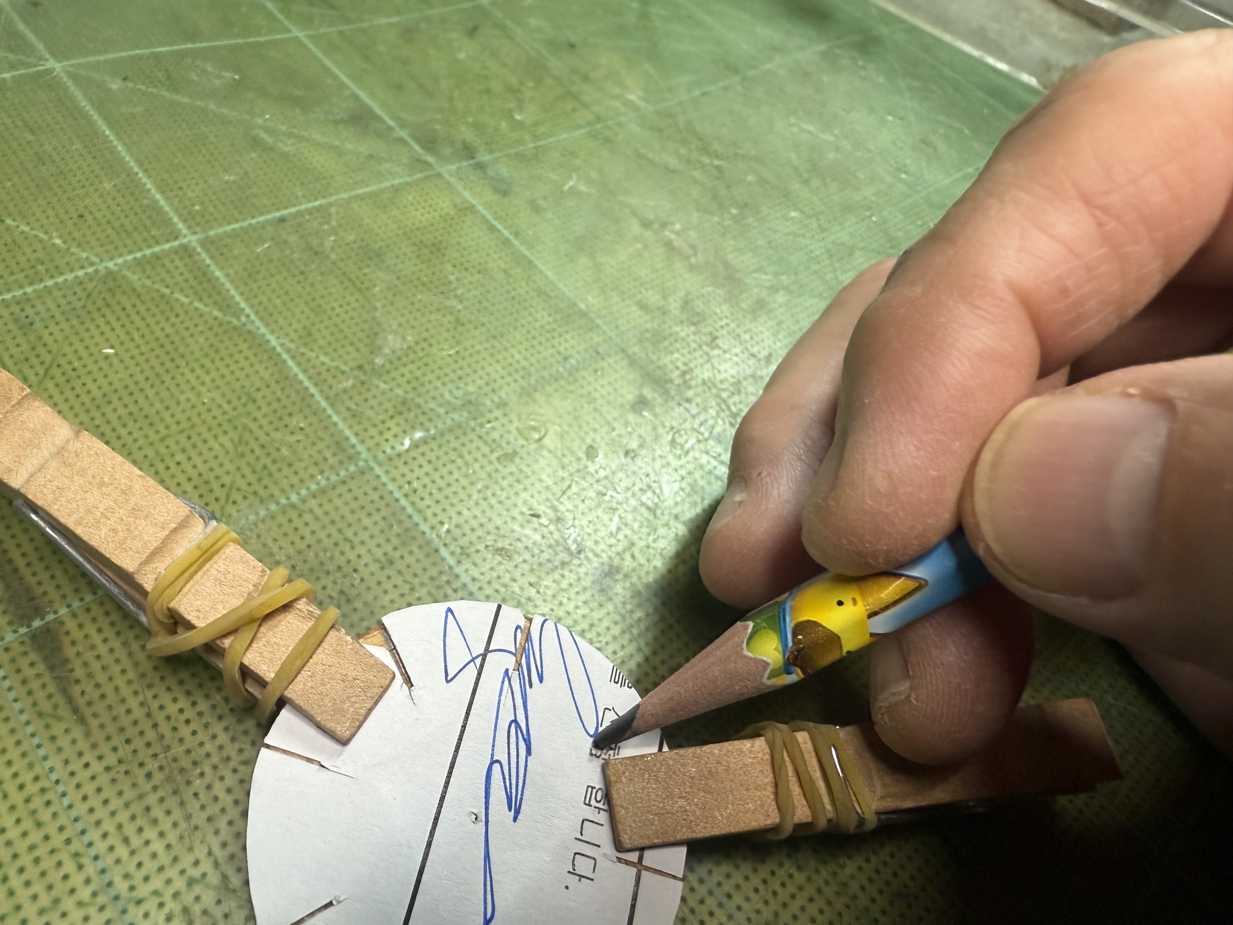

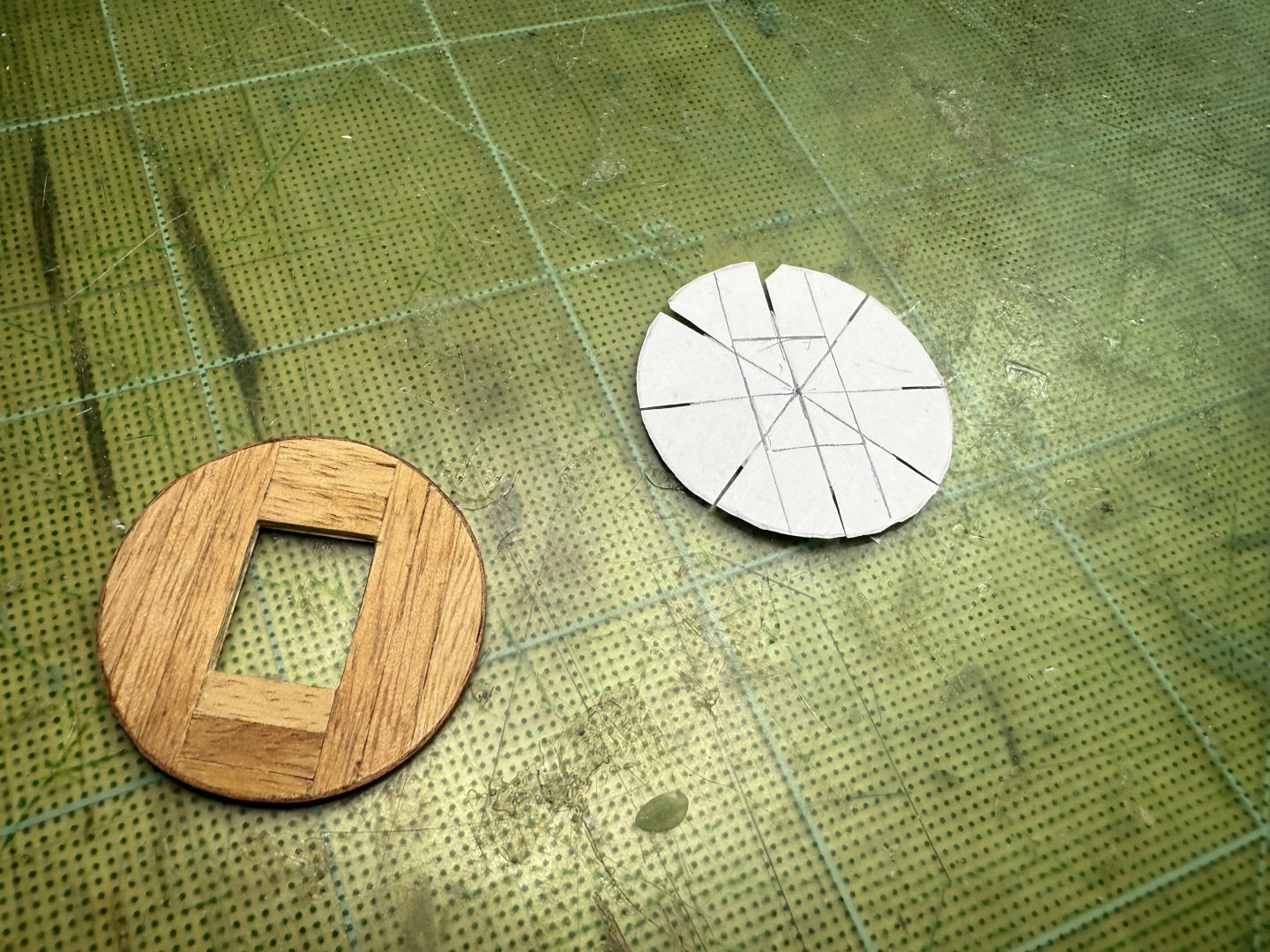

While working on the fore and main mast fighting tops, I devised a method for a quick marking of the 8 pillar positions.  And when I started to work on the mizzen mast fighting top, I kind of forgot this method. Fortunately the memory came back quickly. So, I decided to document the methodology so that I don’t forget it next time.

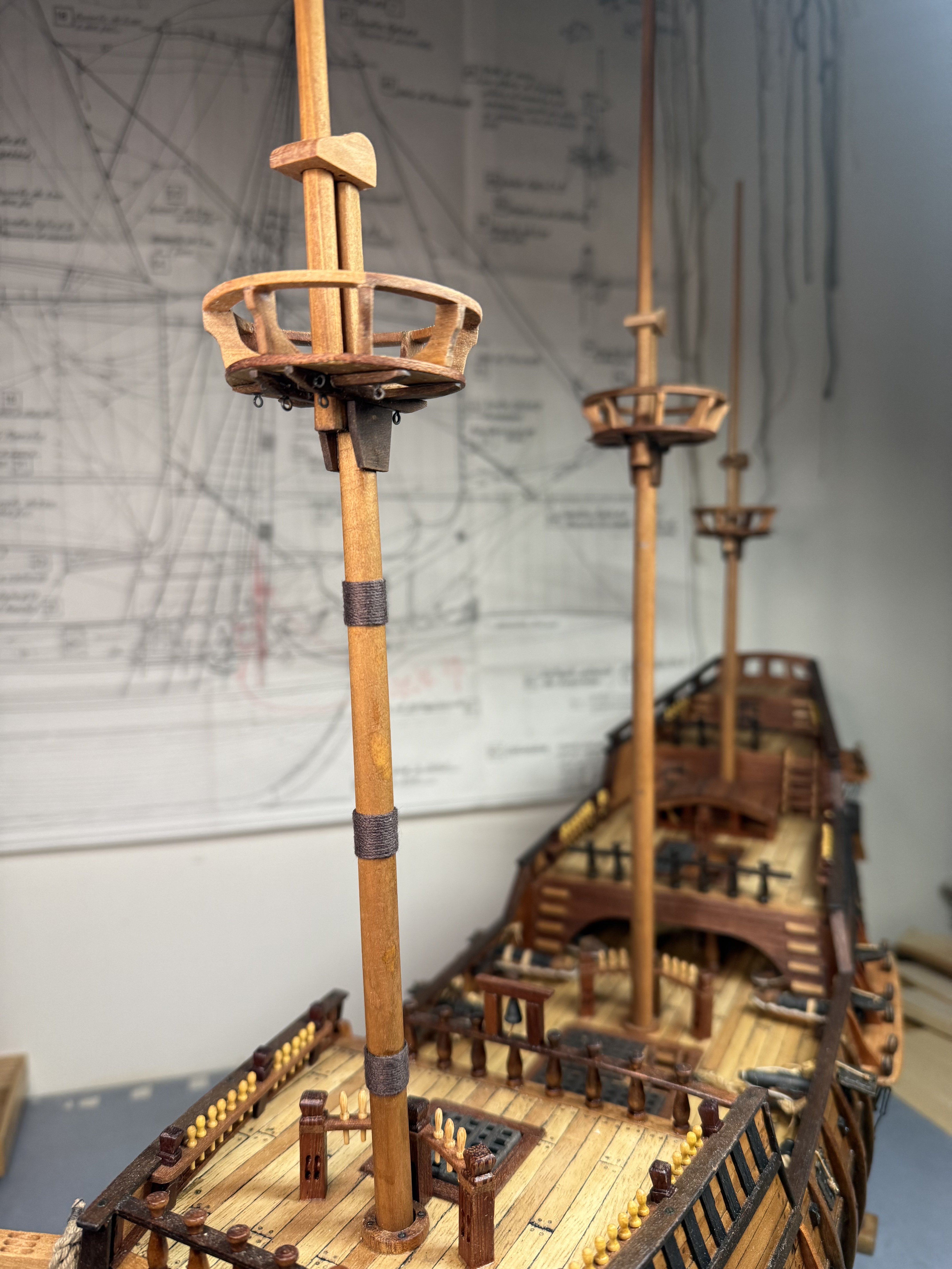

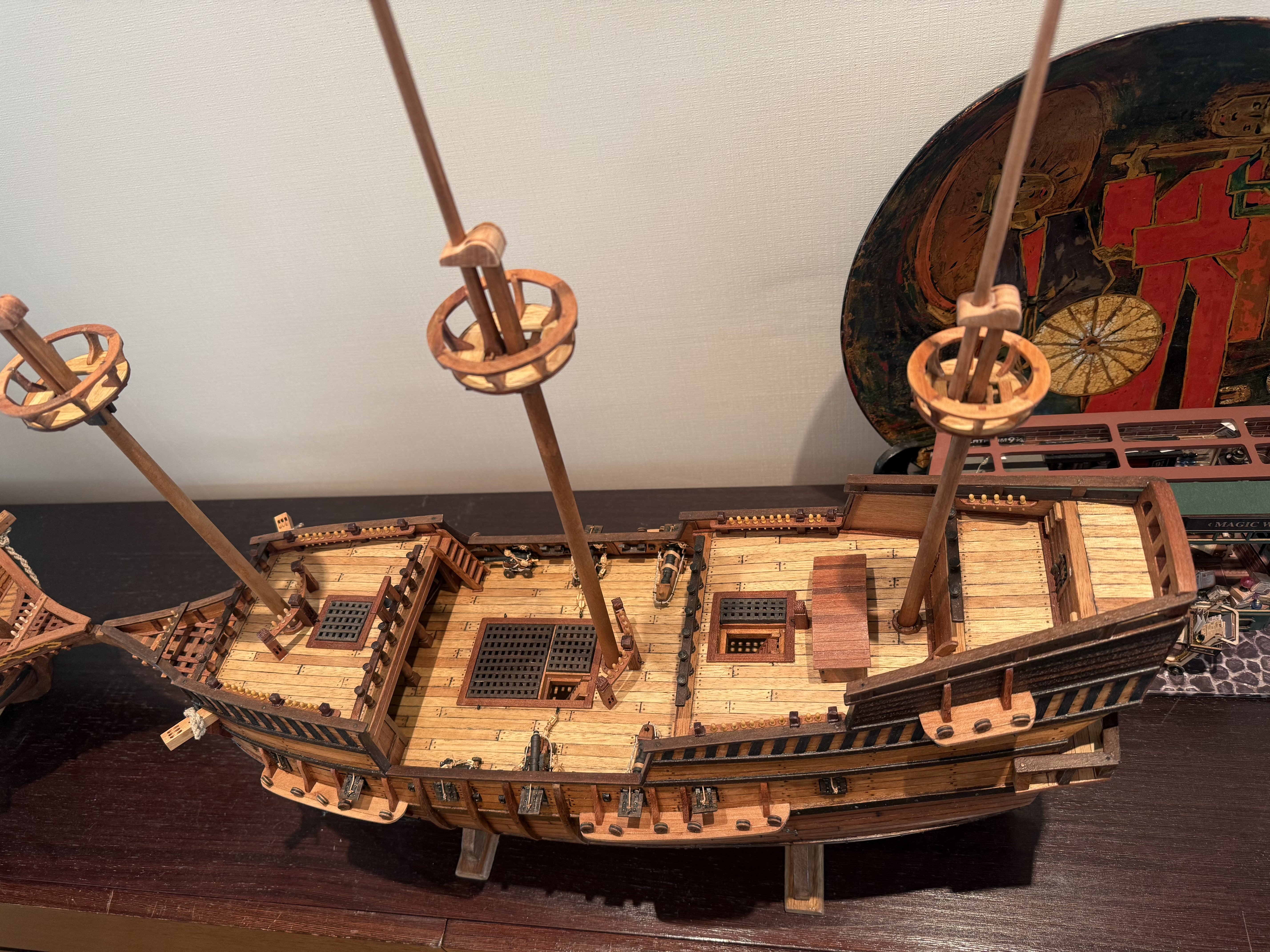

The mizzen mast fighting top on GH1 done and moving on to GH2.

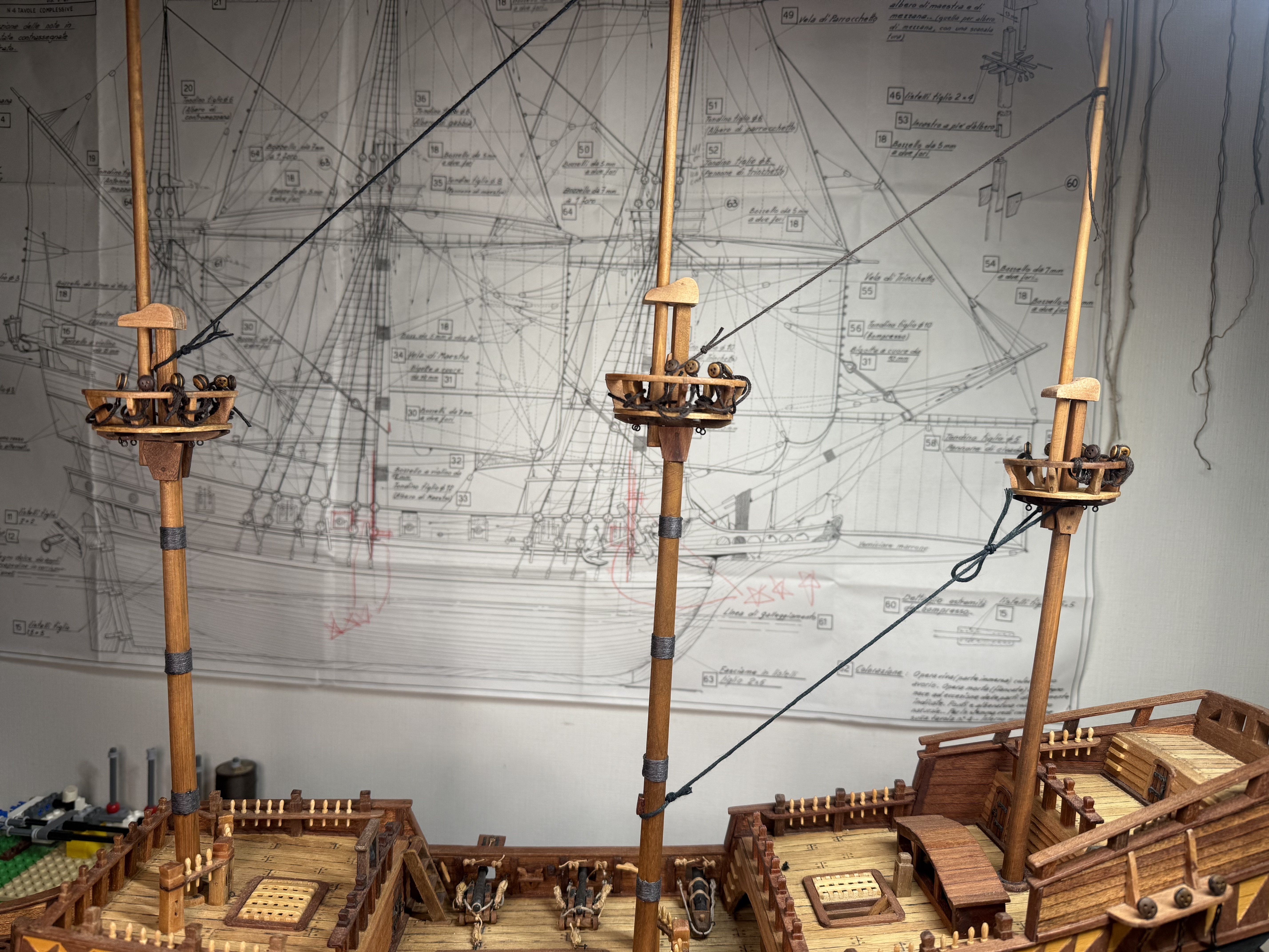

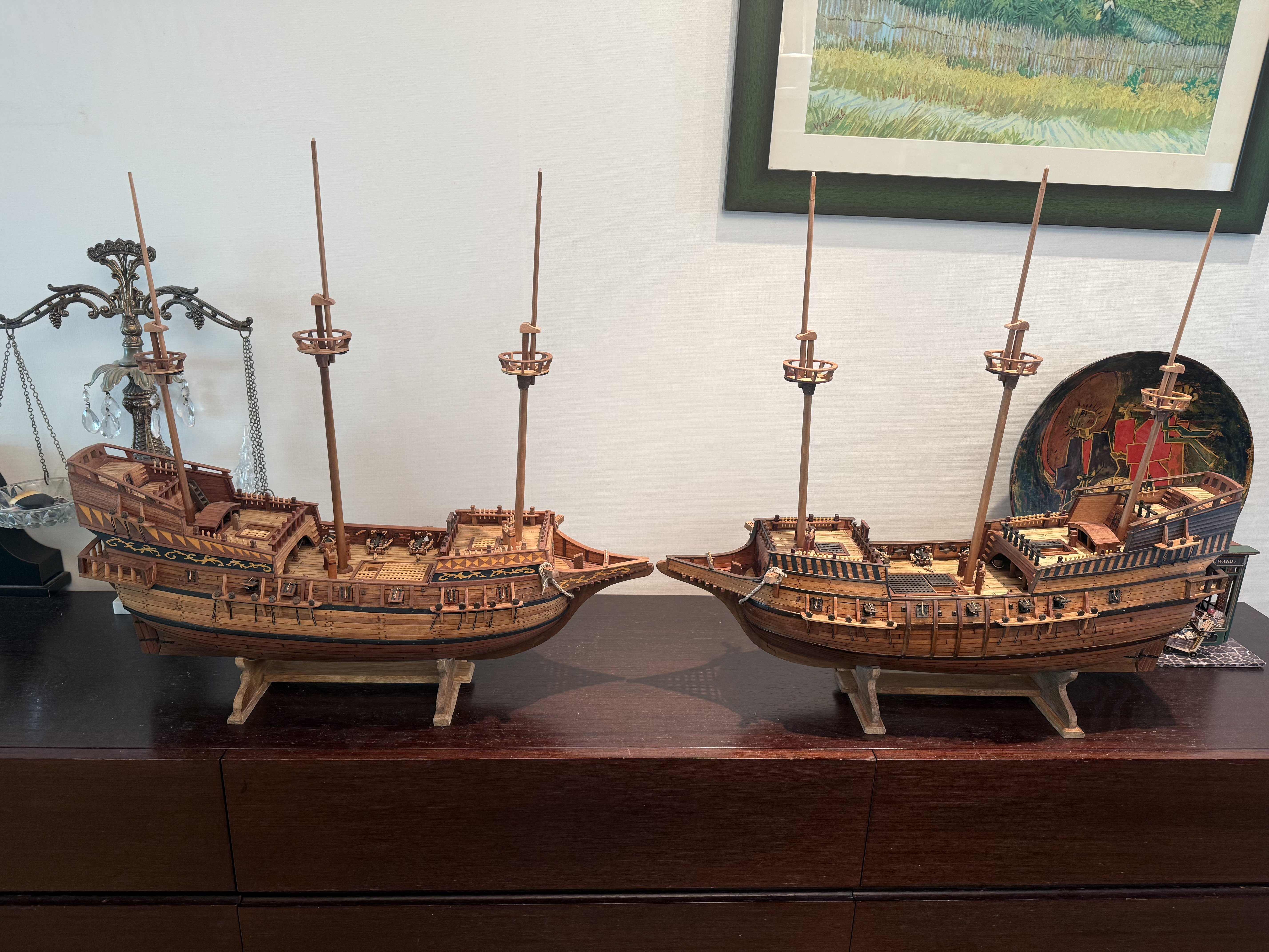

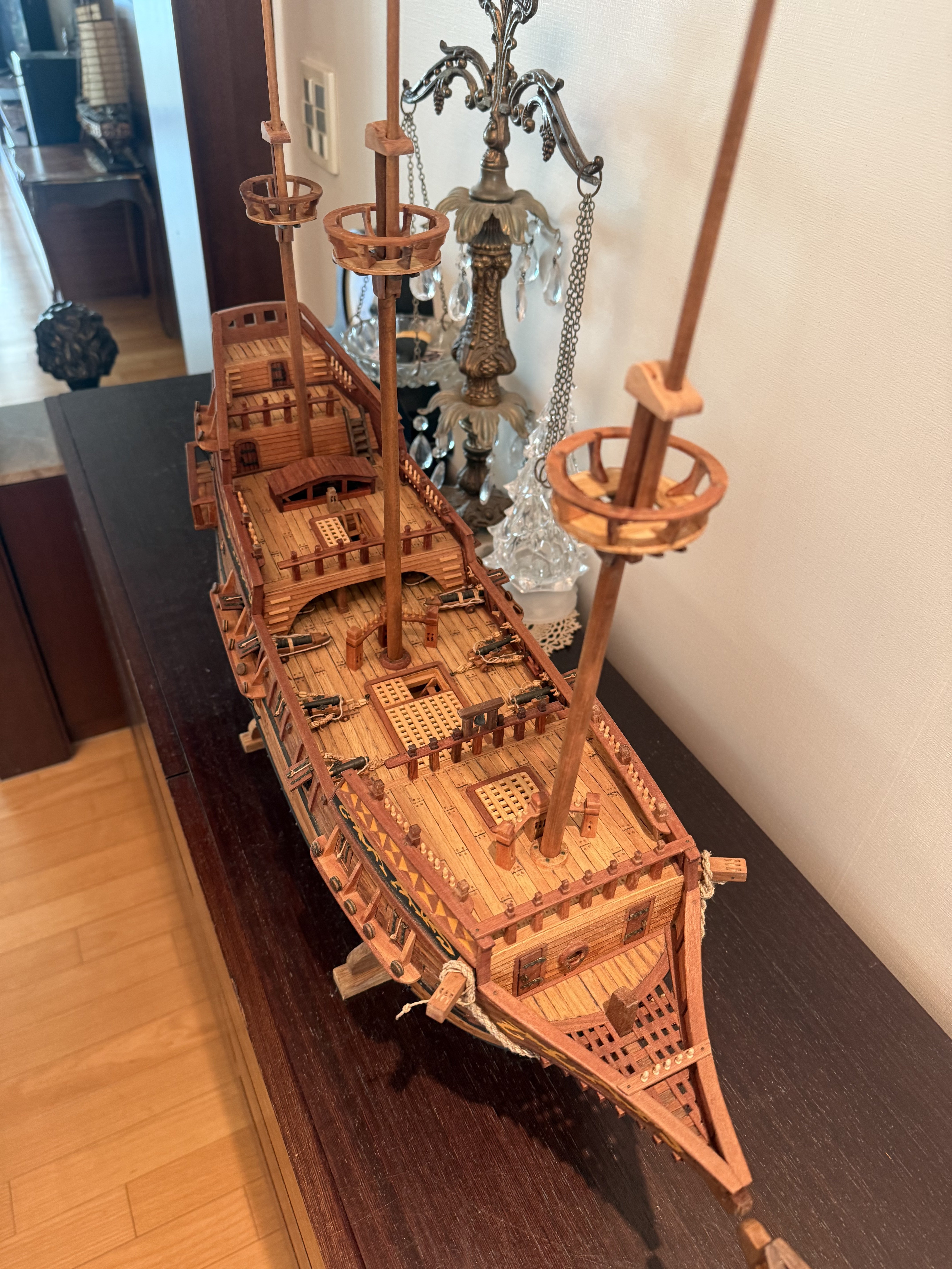

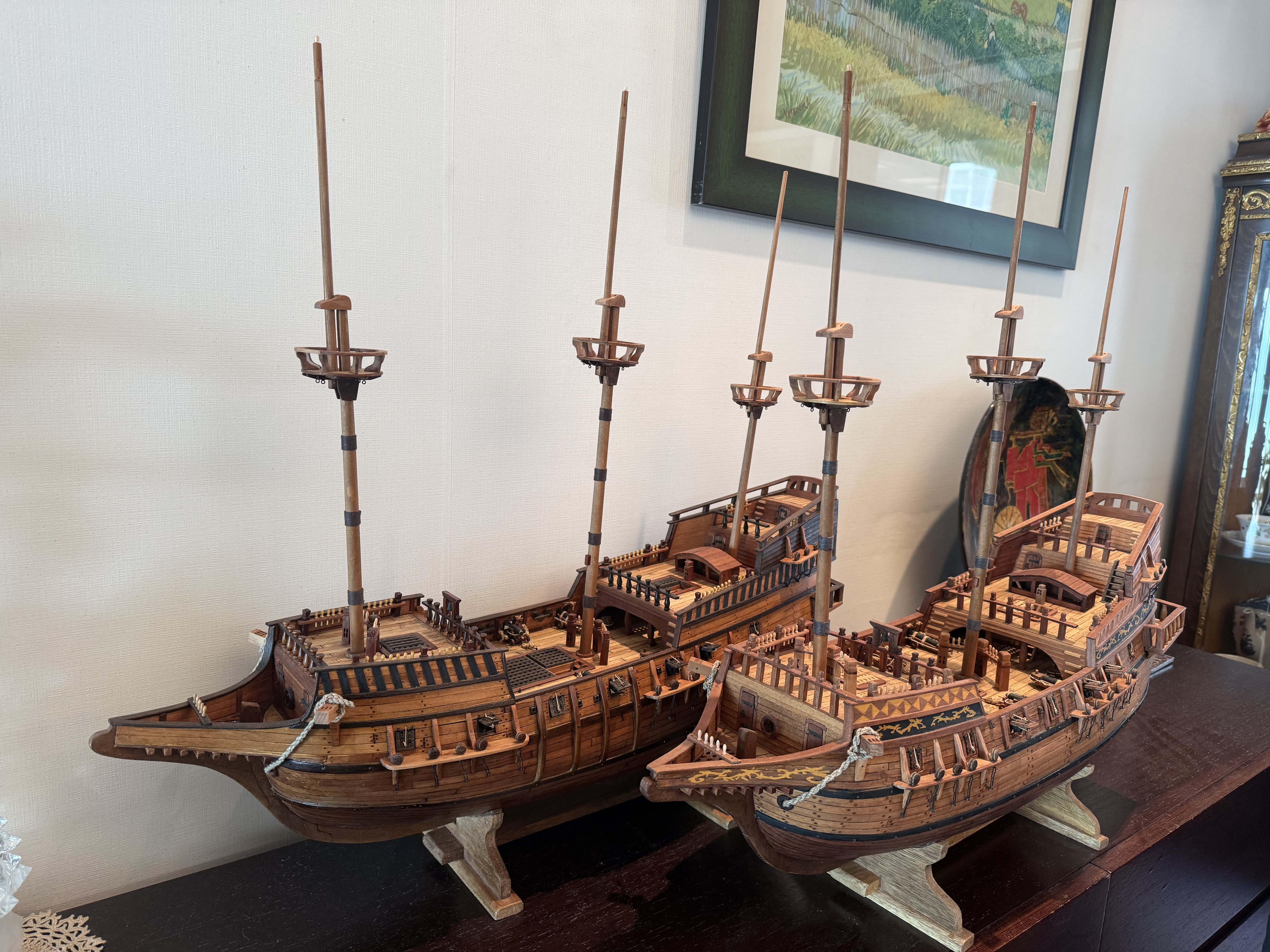

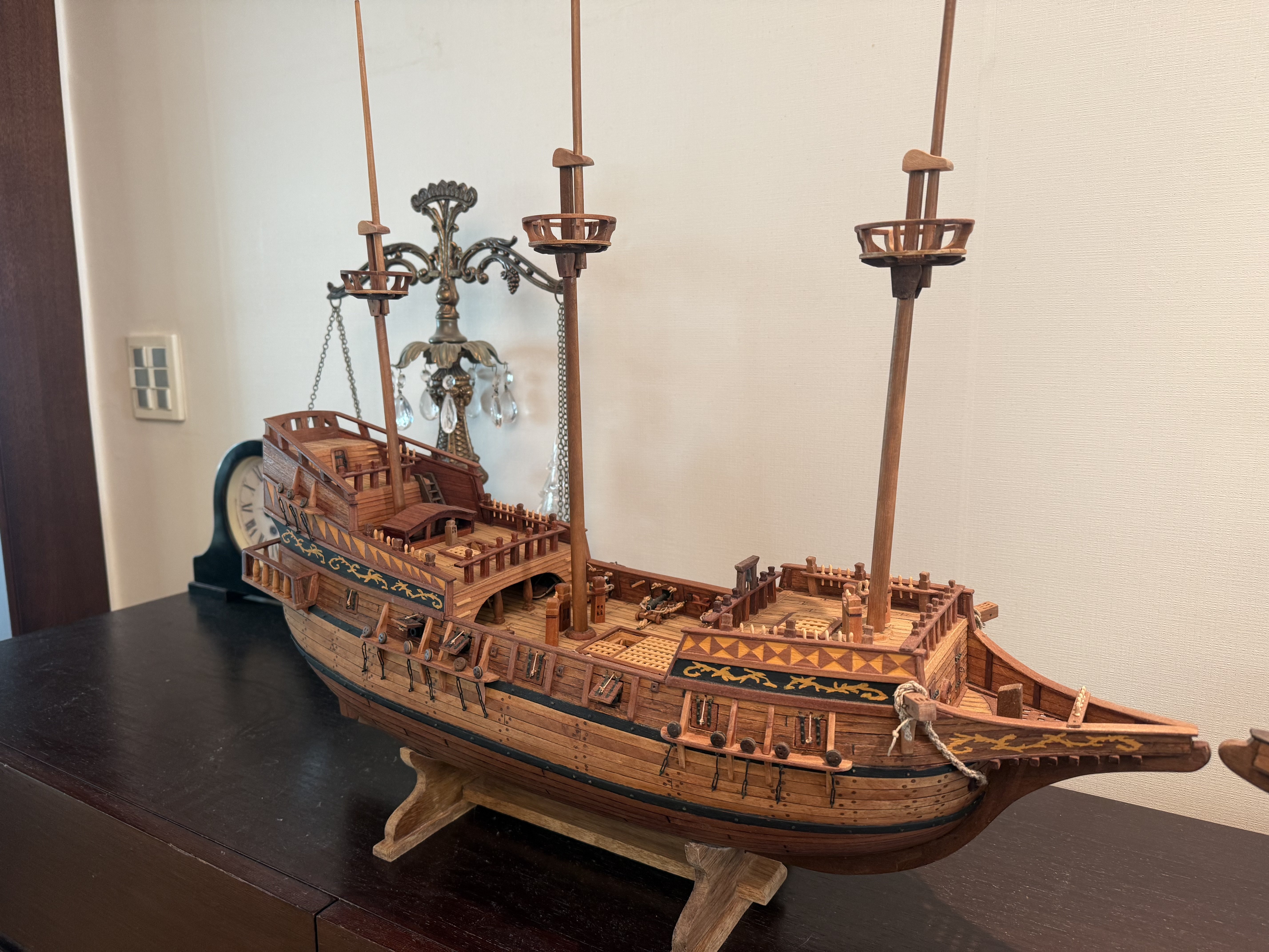

Pictures of both GH1 and GH2 with all the fighting tops done and put in place but not glued or fixed yet.
Next, I am planning to put blocks under the fighting top  structure before finally glueing things together. But, the Aeropiccola plans really lack details on rigging . Does anyone have a good picture of plan on fighting top block rigging please?

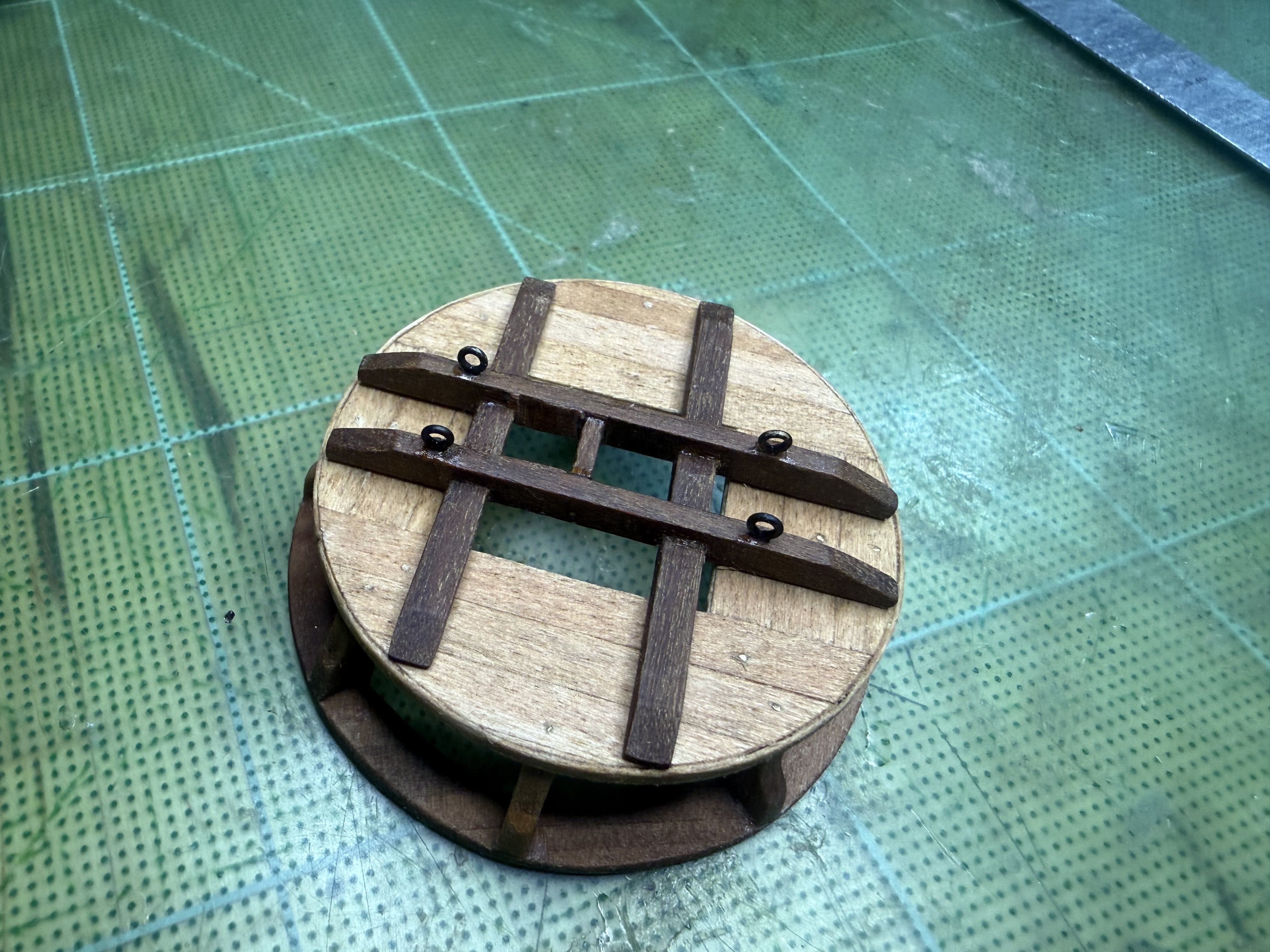

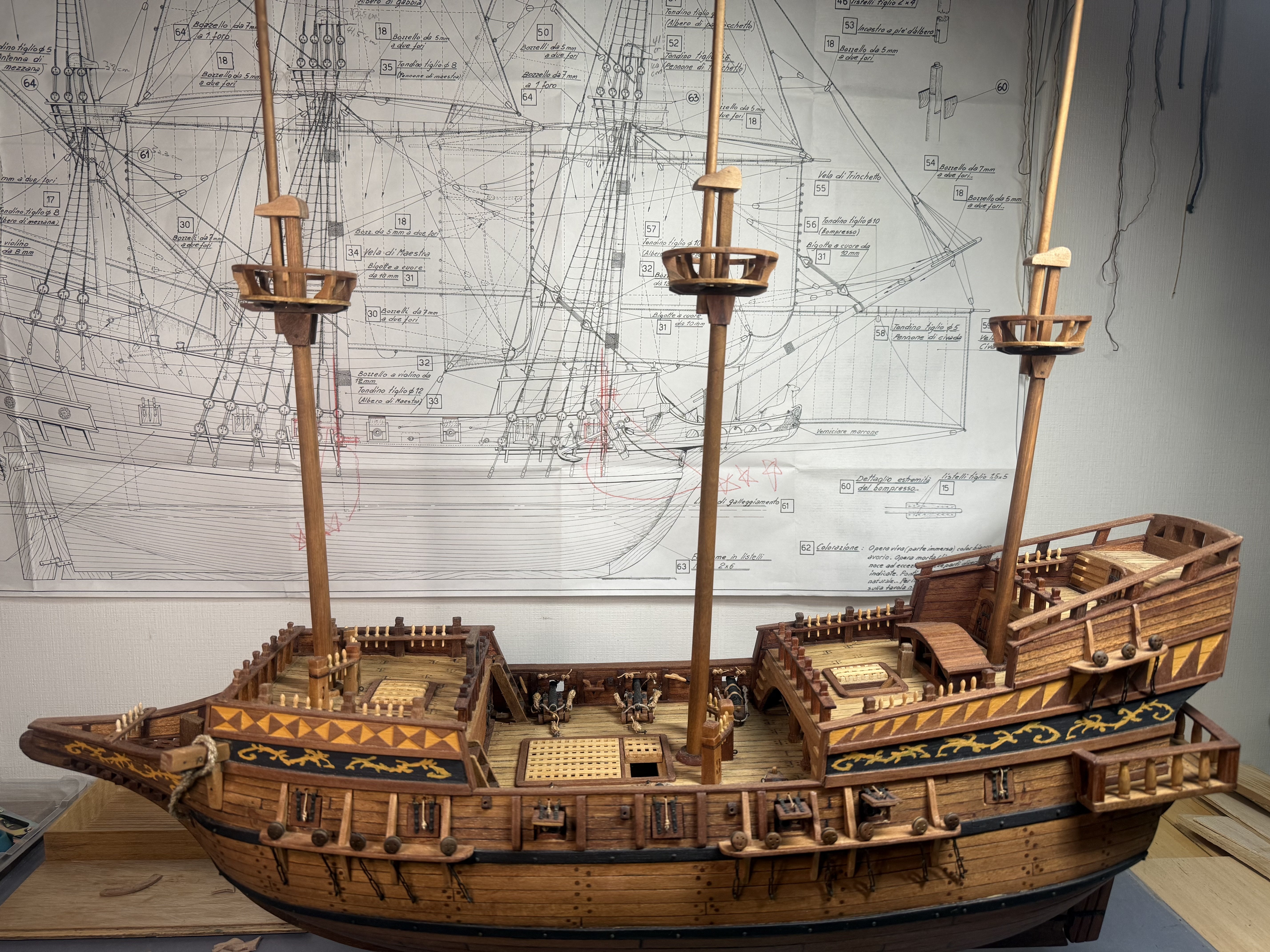

Hello shipmates!

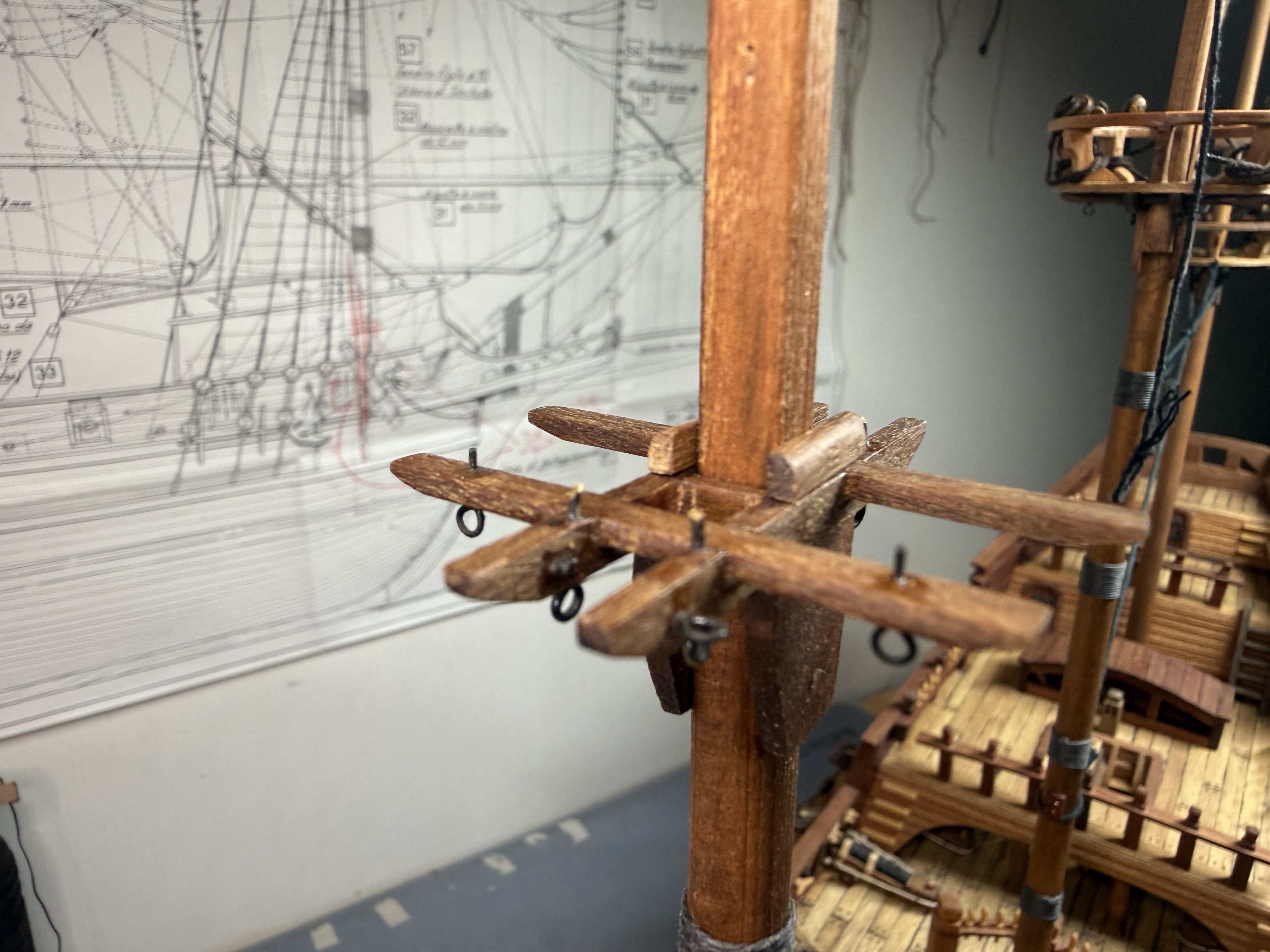

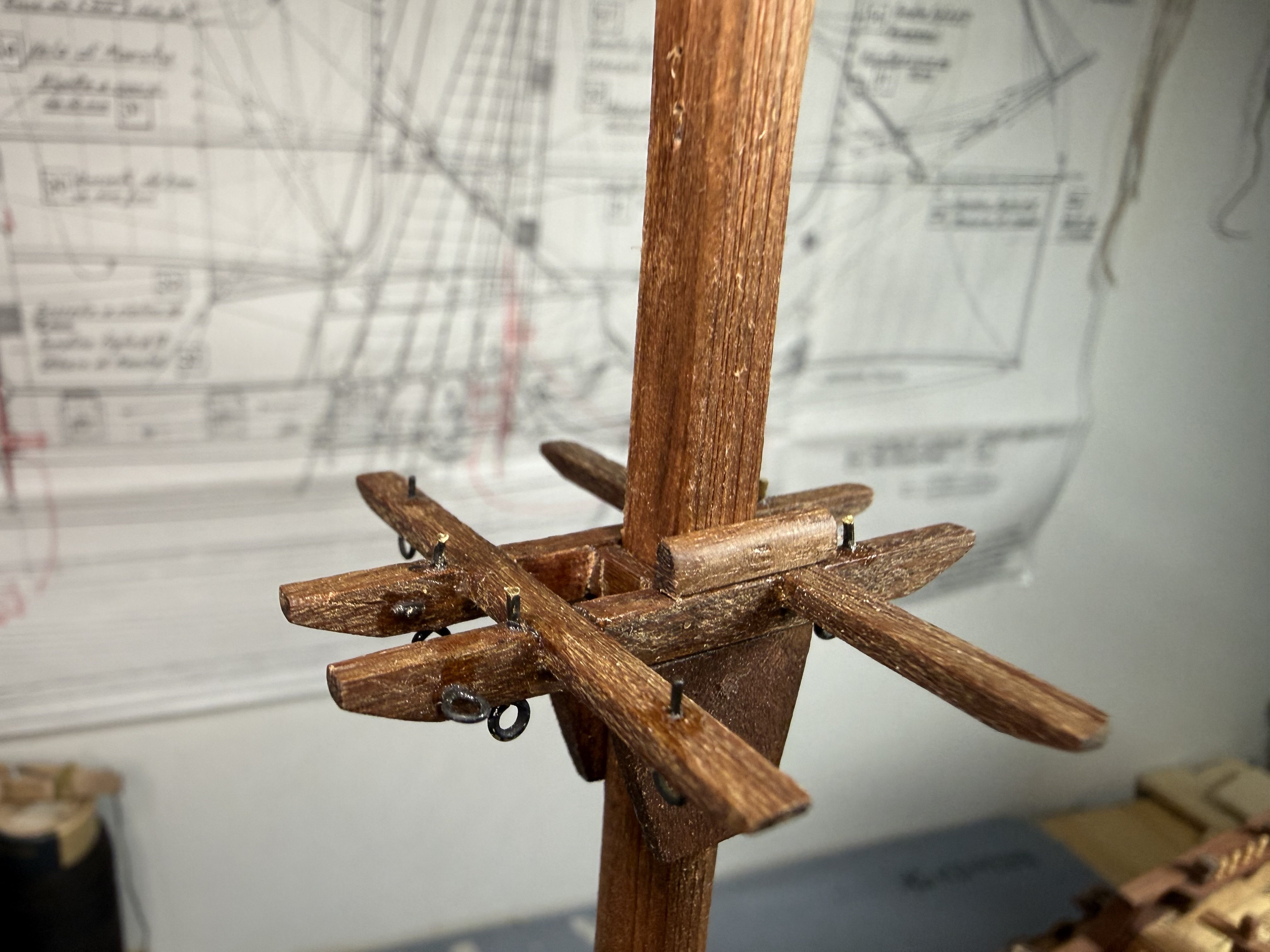

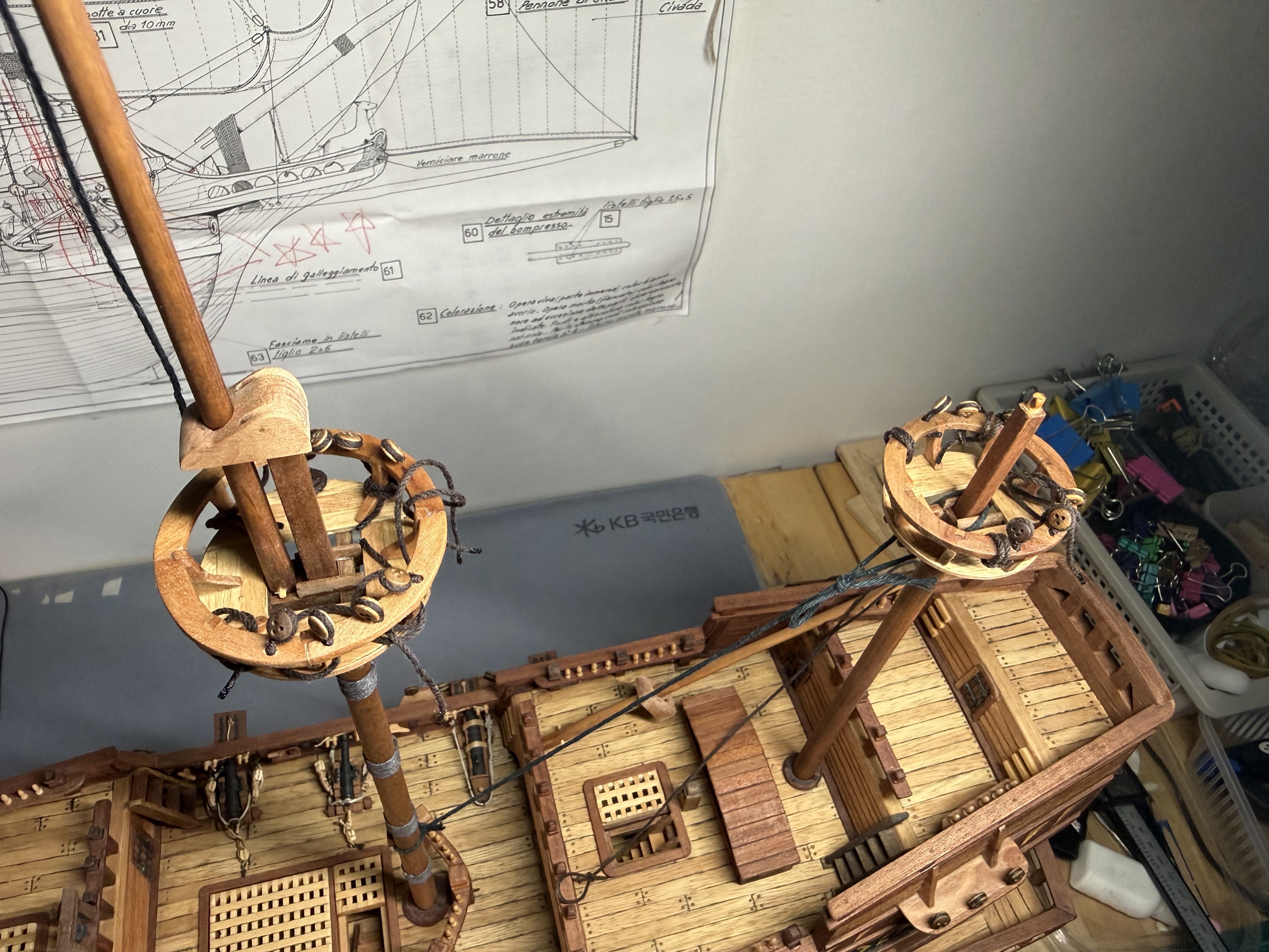

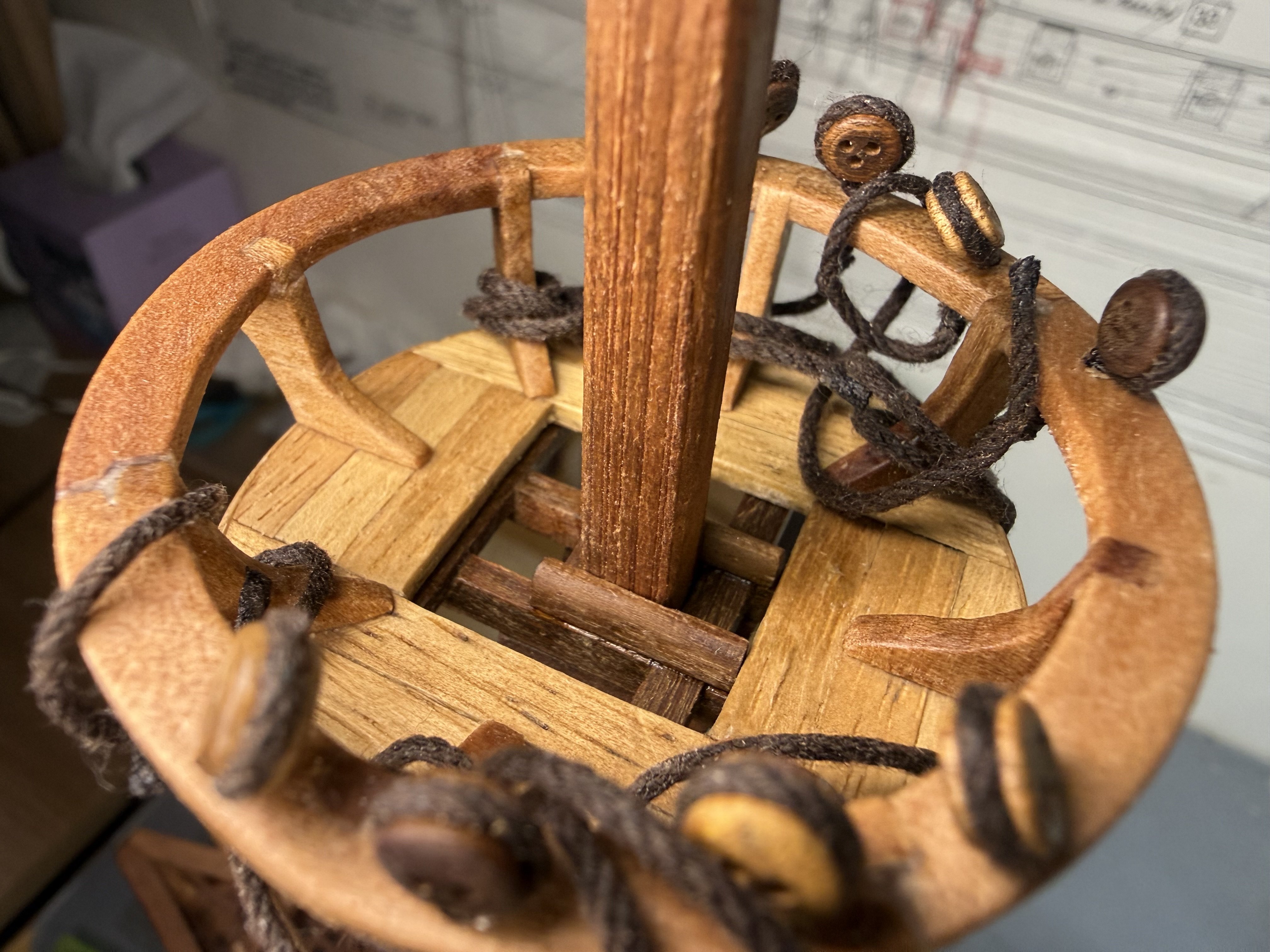

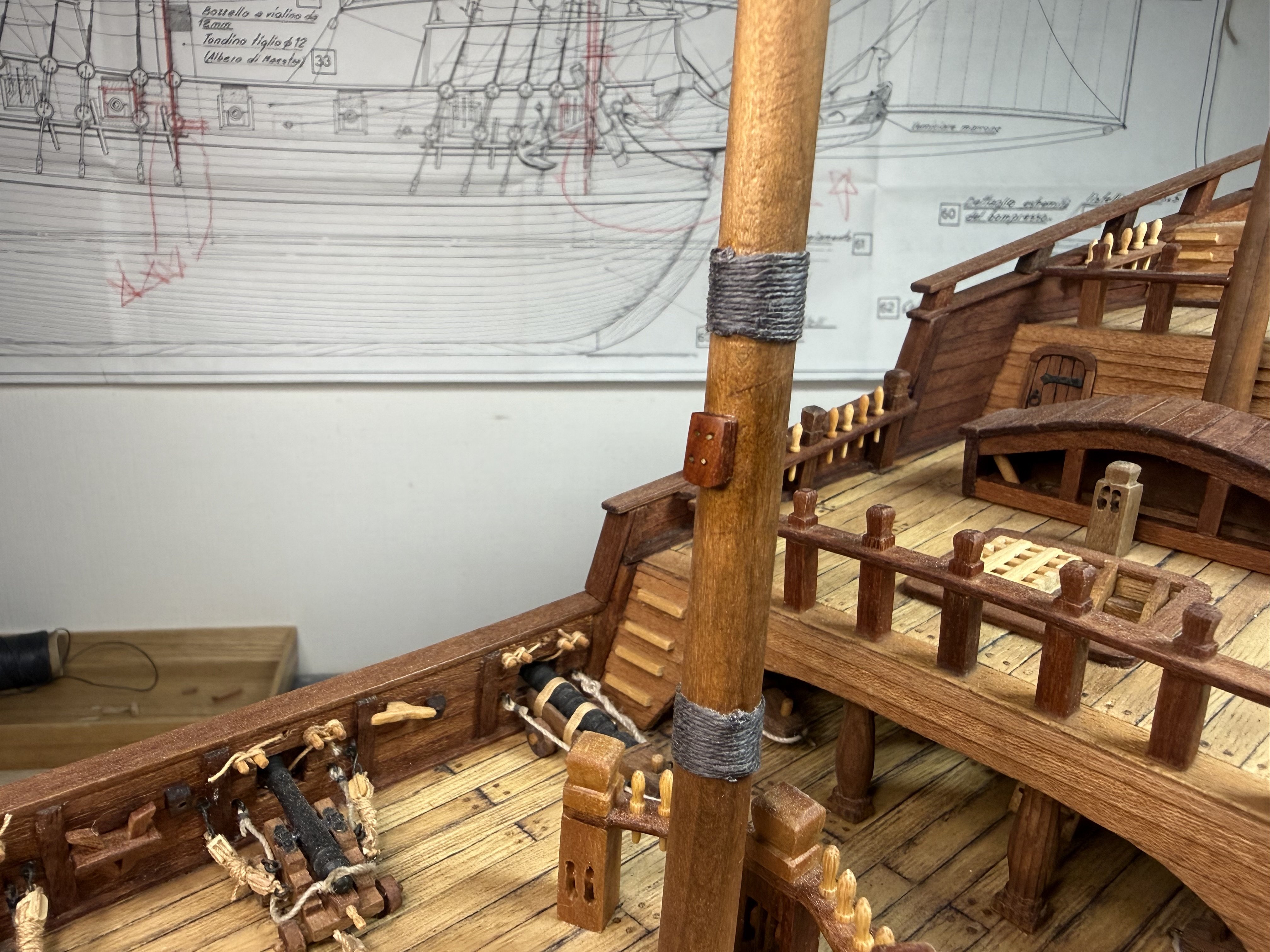

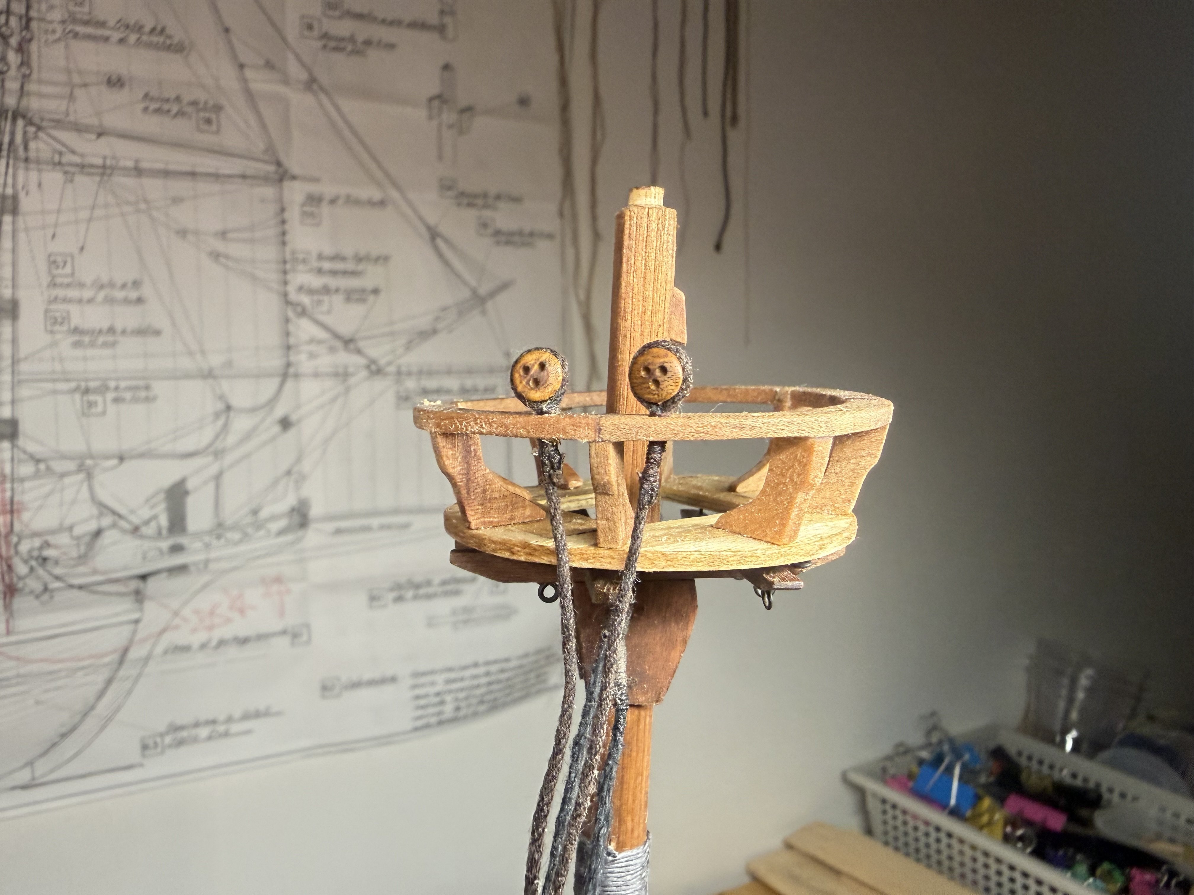

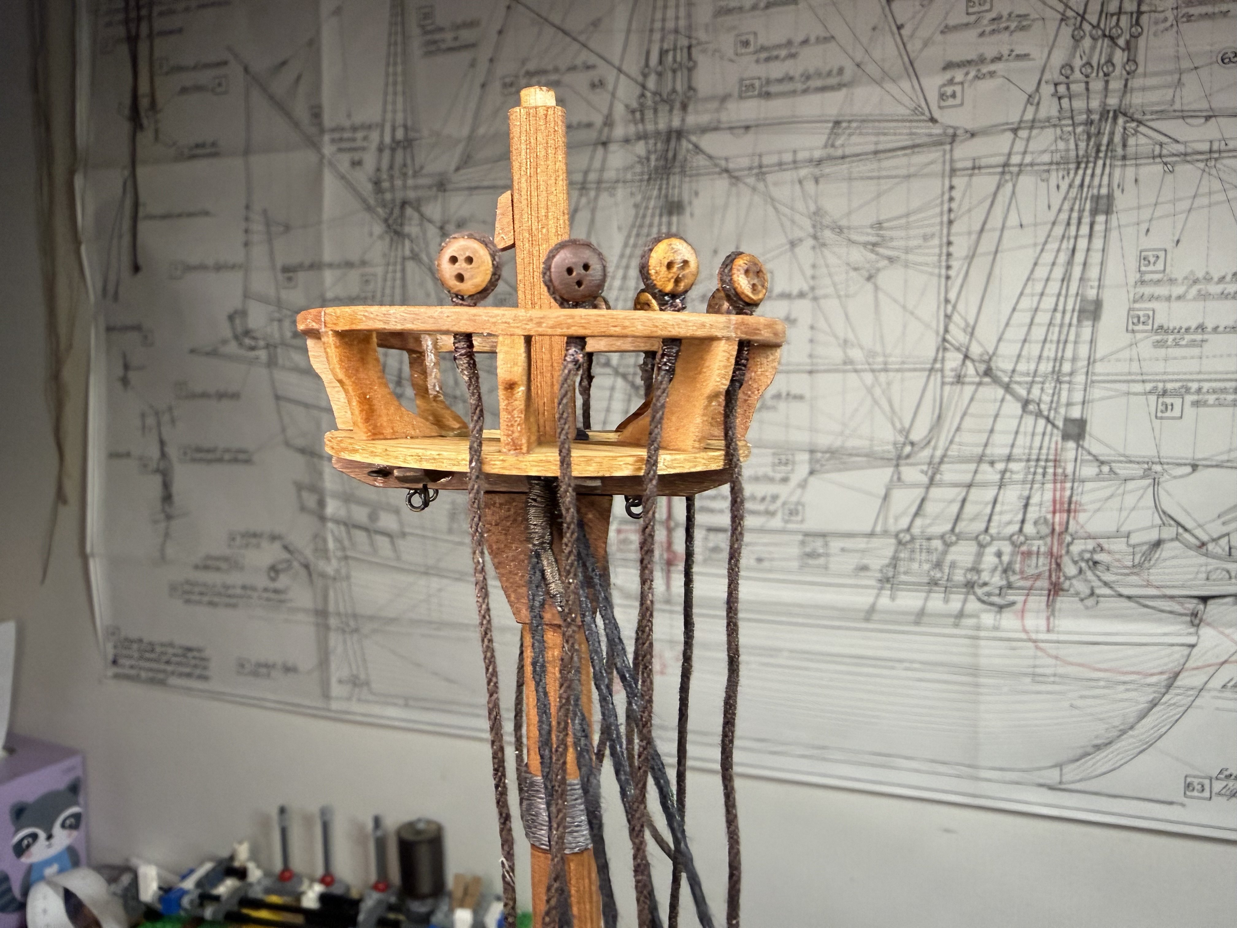

Latest progress report on GH1 & GH2: prep work for crow’s nest underbelly rigging (installing bolts for block attachments),  installment of stoppers for stays, deadeye fixture on the crow’s nest, and some other minor additions.

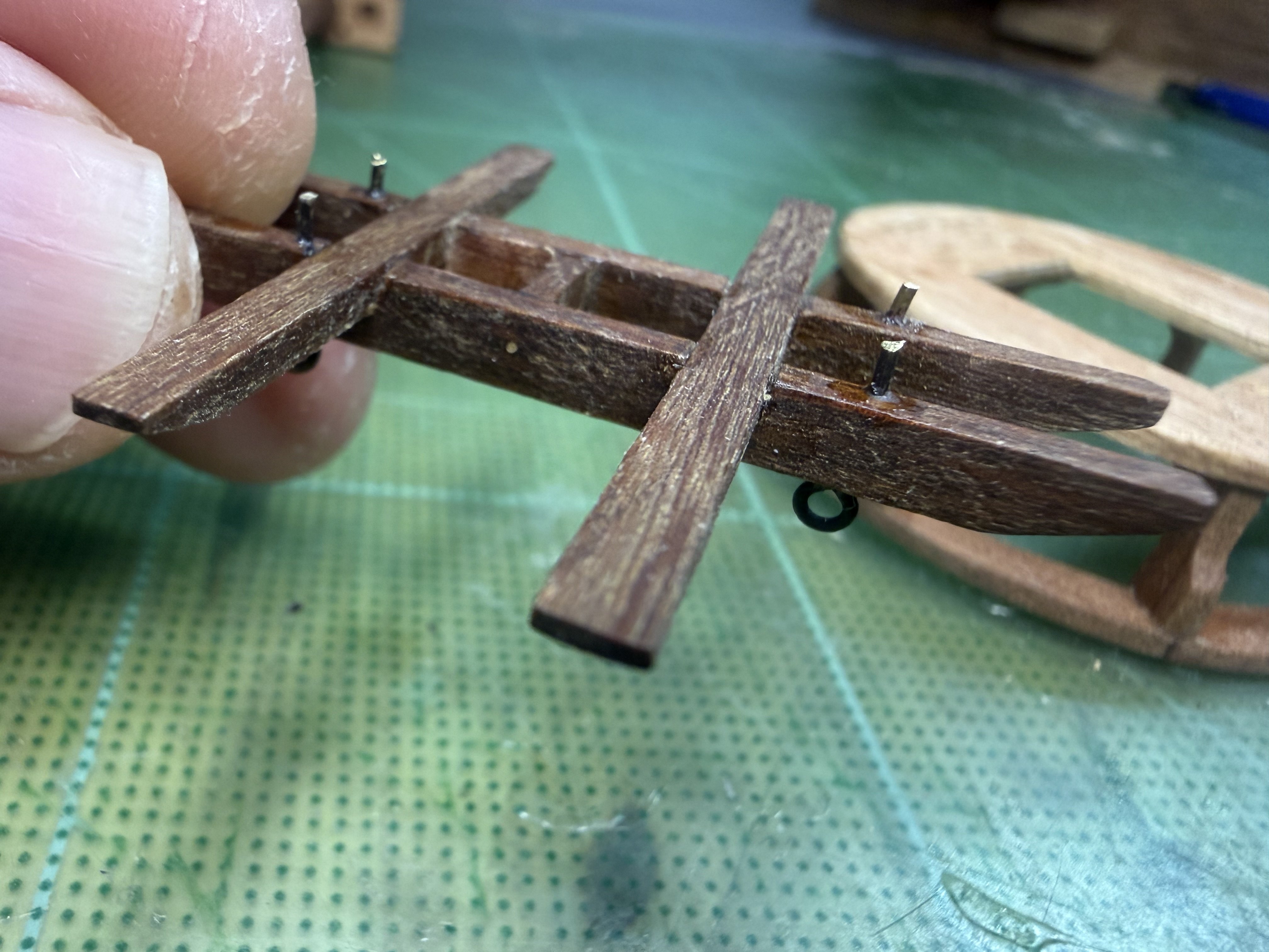

First the bolts on the underbelly of the crow’s nest. I started our with 4 (2 on the front, 2 on the back), but later I decided to add 4 more bolts on the front side (just in case).

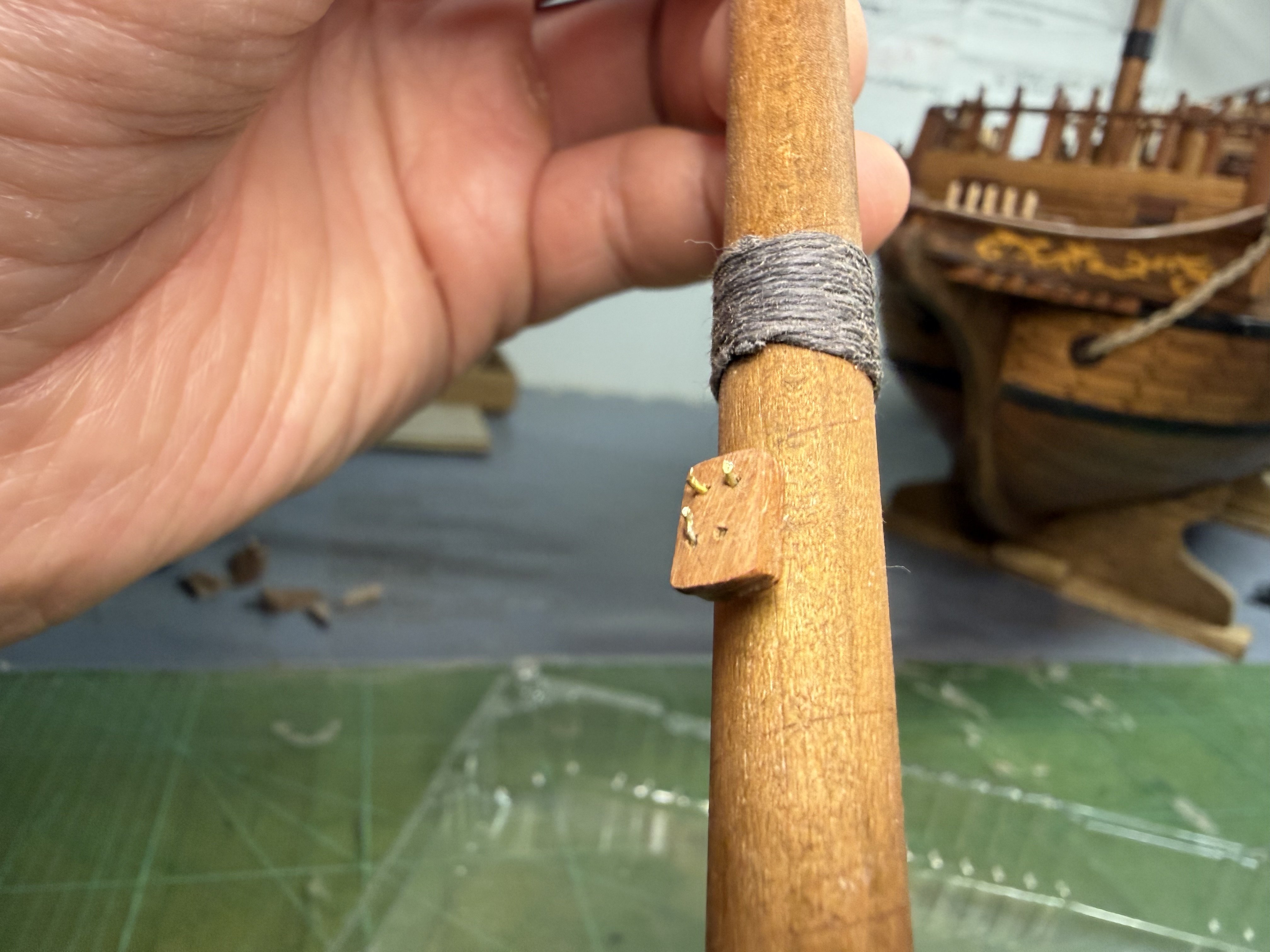

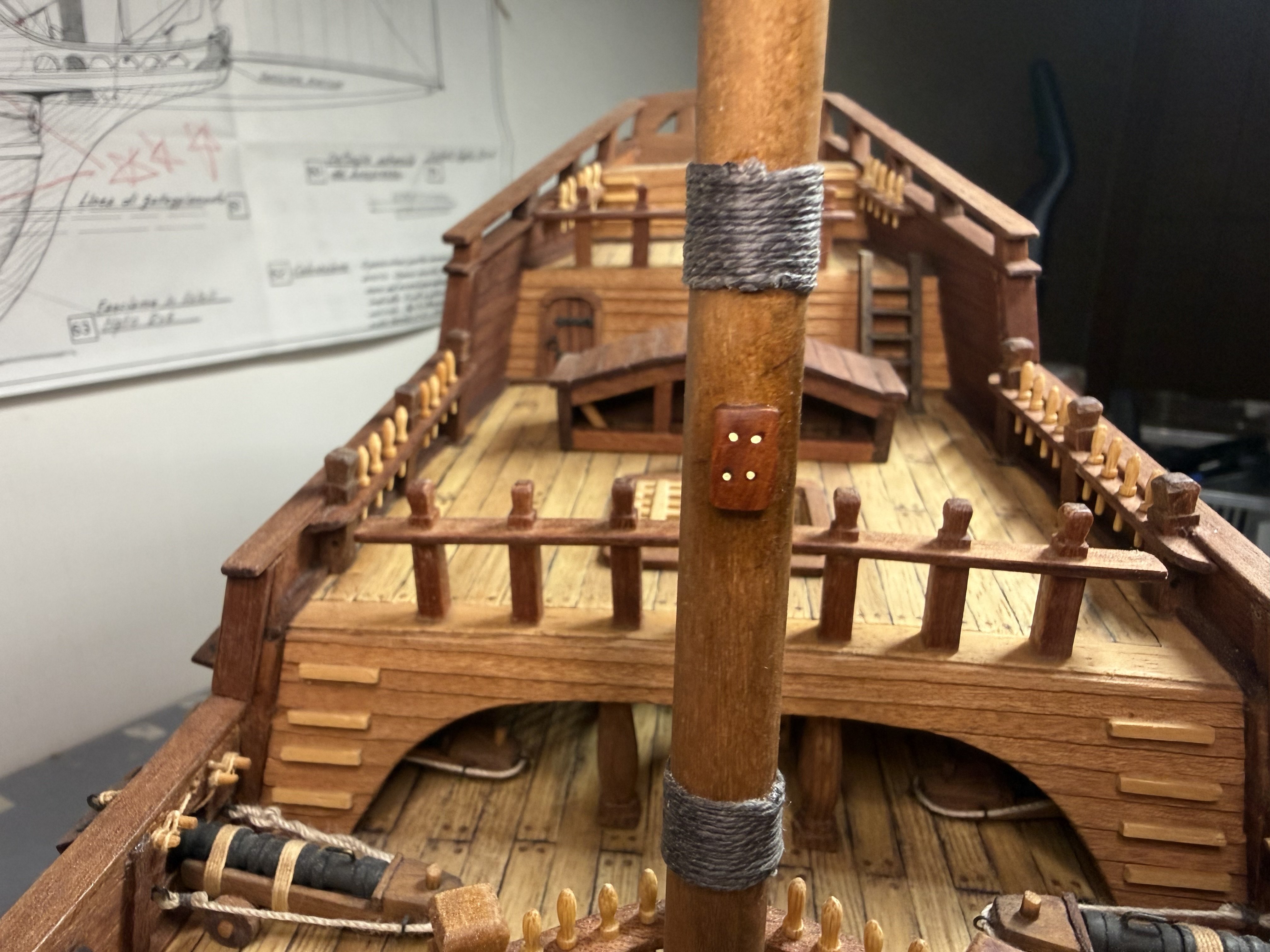

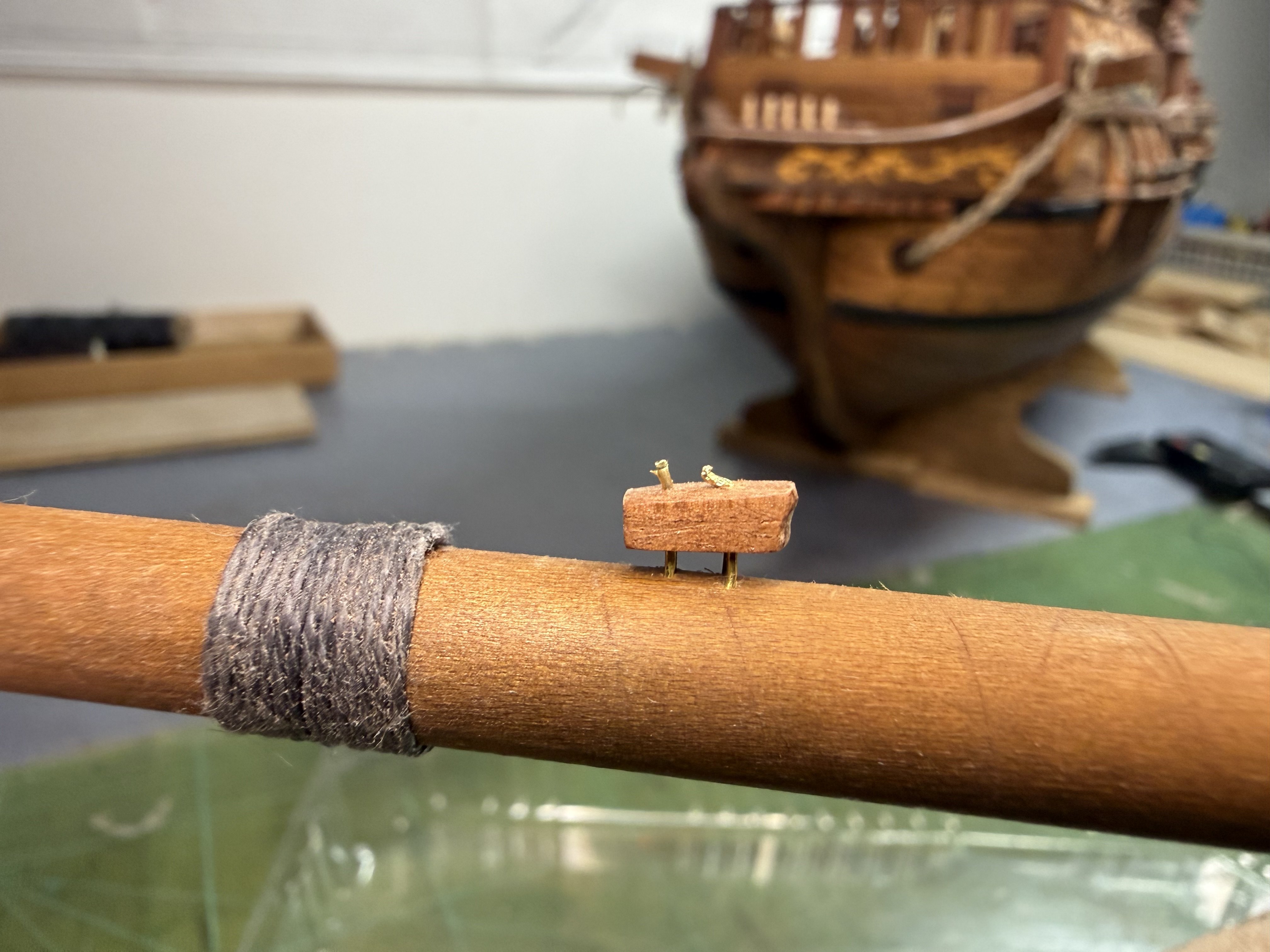

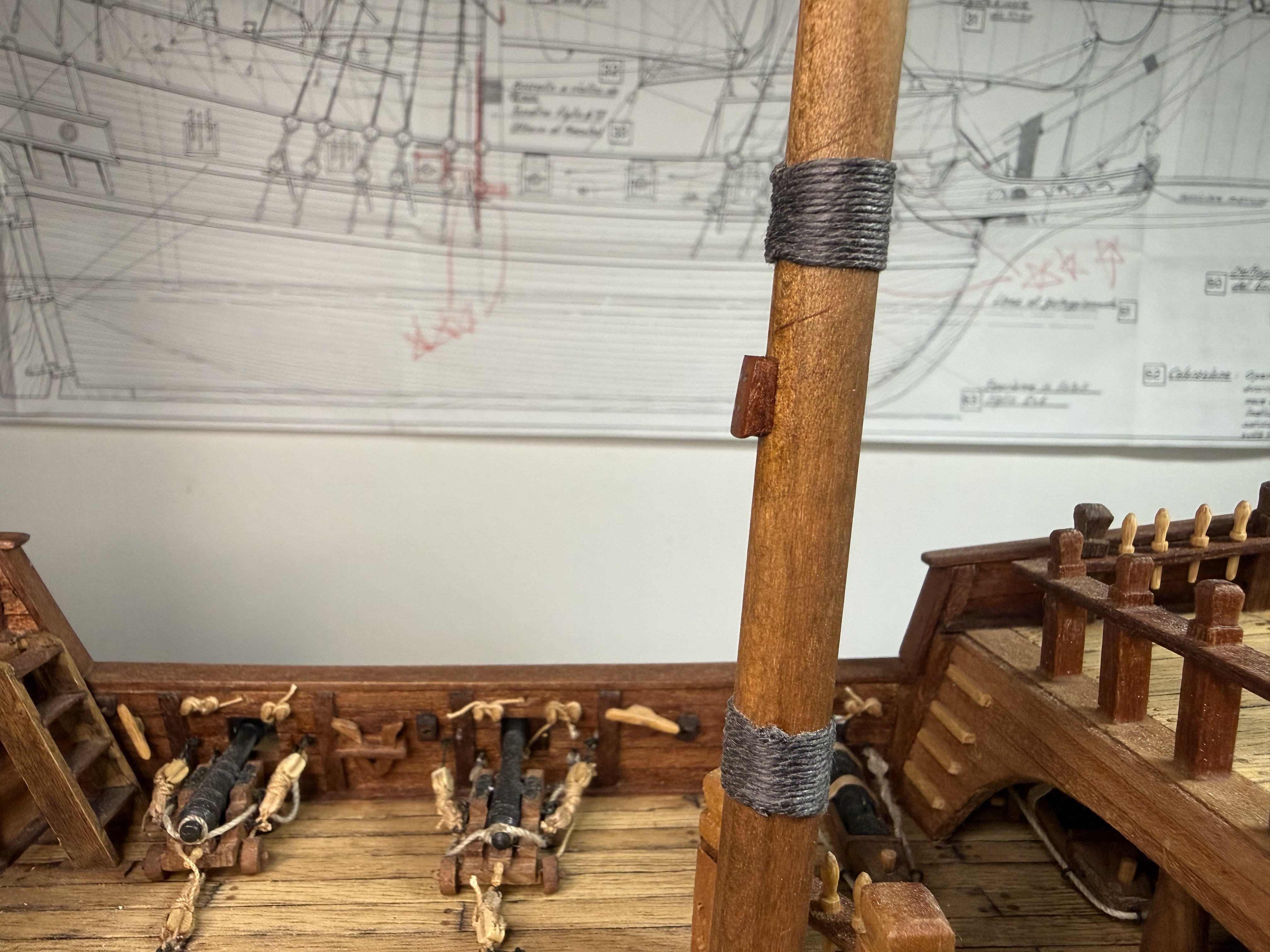

Next, the stopper for stay (between lower part of main mast and mizzen mast) For this one, I devised a larger and wider single design instead of applying multiple small stoppers.
Same procedures applied to all masts for both GH1 & GH2.

Next, the fore and main upper stay stoppers : small single stoppers applied.

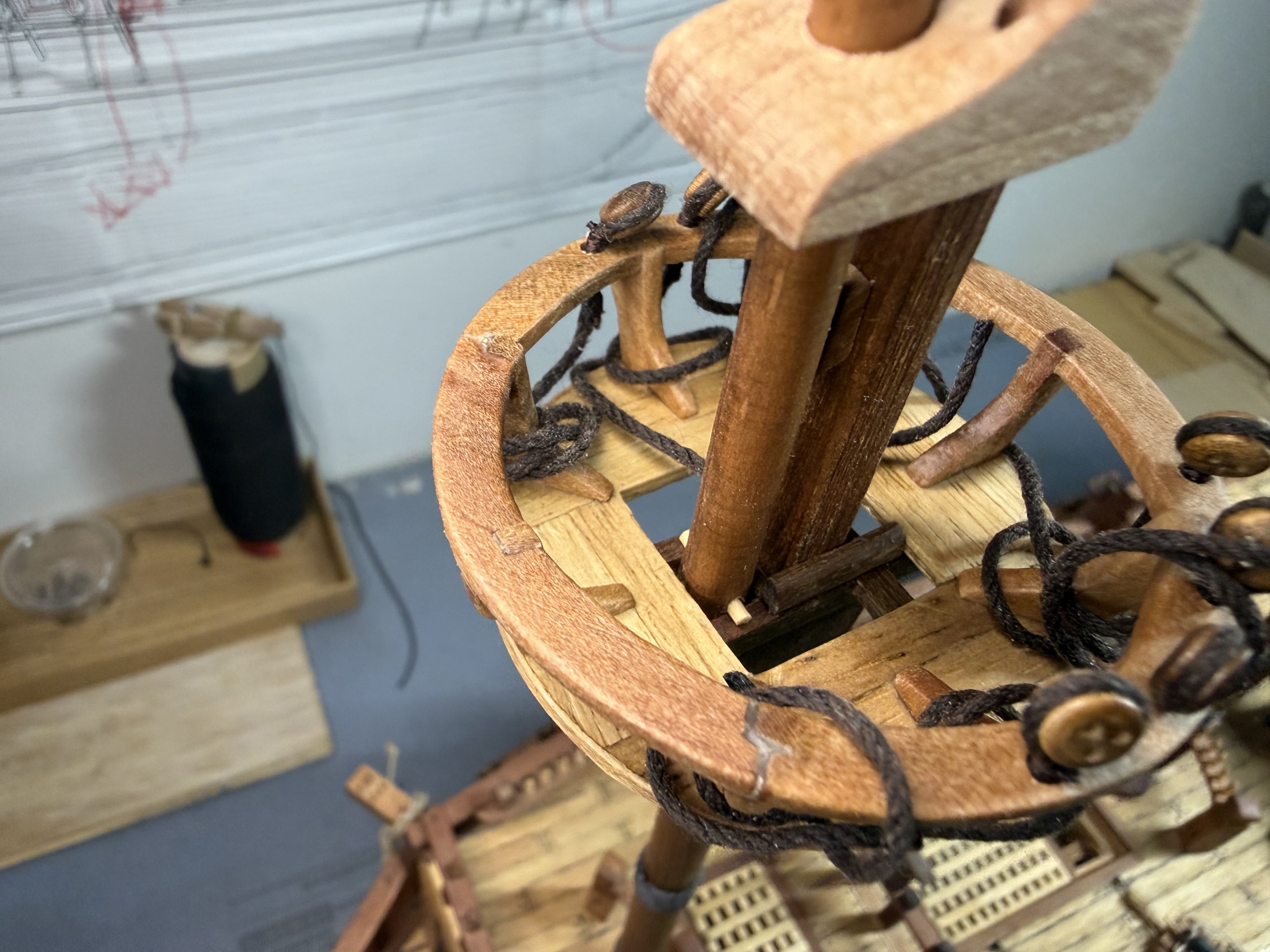

Now the dead eye fixture on the crow’s nest. I decided to follow the original plan - fixing the 5mm dead eyes with cotton thread instead of bronze.
Finally, minor additions to crow's nest supporting structure.

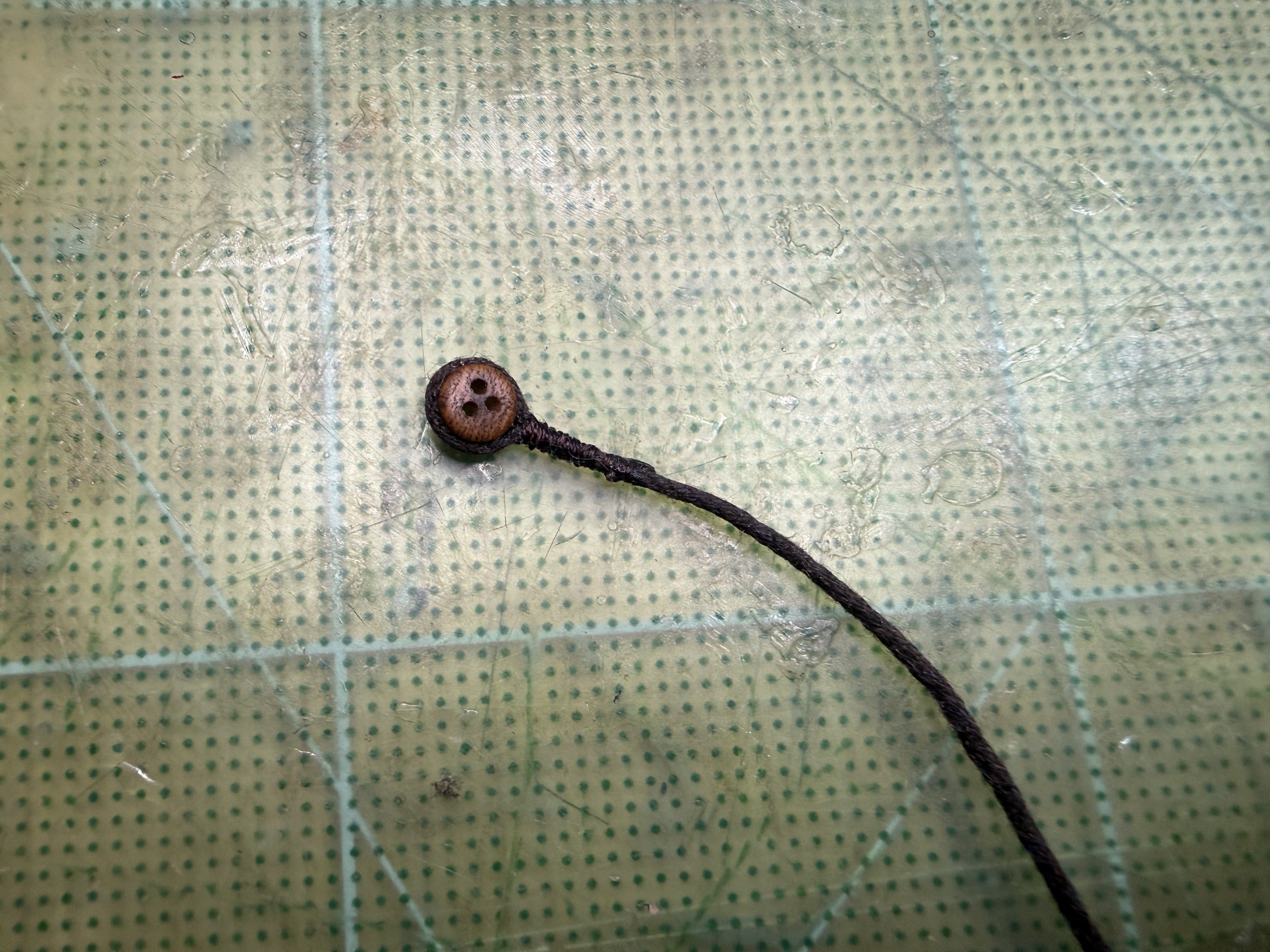

Progress report on GH1 & GH2 : quite a lot of testing, trying out various stuffs, proof of concept kind of activities were carried out since my last update. These include 1) trying out pine tar treated threads for stays and shrouds (vis-a-vis the appropriateness of color, thickness and ease of serving with my newly procured dark brown polyester thin threads and etc.), 2) trying out various methods and positions for the stays and shrouds, 3) dry runs in regards to the rigging of some sheets for the purpose of pre-determining
 overall belaying positions and also to assess (to some degree) if the current number of belaying facilities are enough or not.
The below pictures show the end results of pine tar dyeing of two types of threads. Thinner one (about 1 mm in diameter, for shrouds and upper mast stays ) was originally light brown cotton thread - dyed using 1:1 (pine tar : thinner) proportion. This one took about a week to touch dry. The thicker one  (about 1.5 mm in diameter, for lower mast stays ) was originally white cotton thread - dyed using 2:1 (pine tar : thinner) proportion. This one took about 3 weeks to touch dry.
Testing serving on couple of samples (shroud lines and stay related blocks) on my Lego serving machine- to which I added more function to enable other tasks.
First try-outs of the served threads.

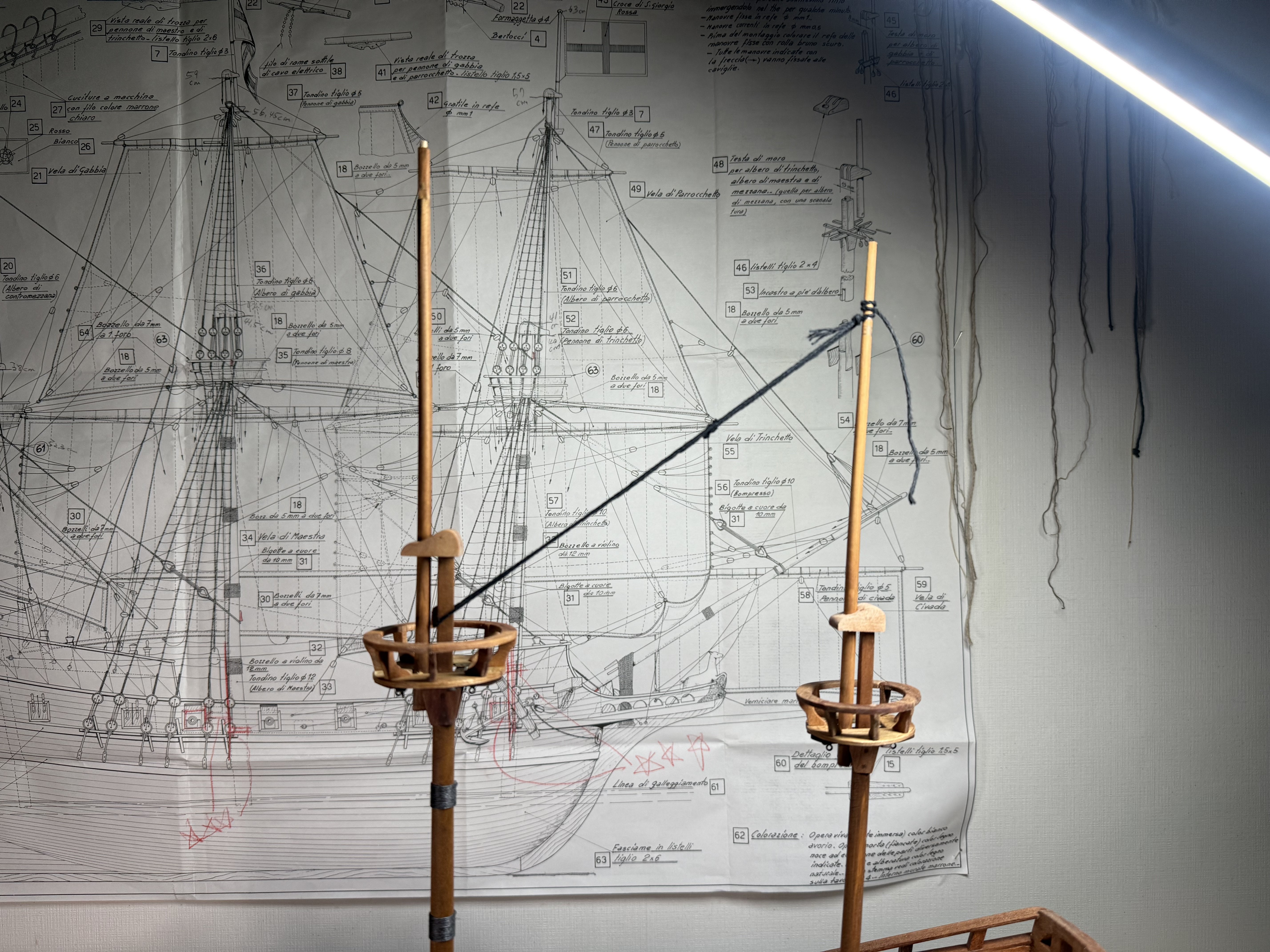

Continuing with the shroud and stay try-outs. I decided to deviate from Aeropicola’s topmast stay related plans as they do not seem reasonable. For this change, I had to reshape and rearrange the topmast stay stoppers. Below are the pictures related to these work streams.
