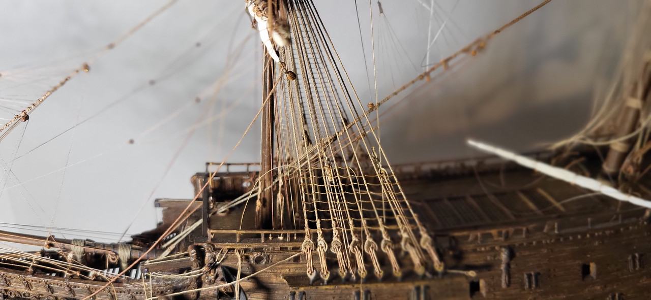

I finished rigging the Fore course portside bowline, sail clew, clew line, sheet block, tack , buntlines and about 1/3 of the ratlines, these I just eyeball the spacing, I do however slide some white paper behind the shrouds as I near the futtock shrouds to avoid securing the upper lines that run close to the inside of the shrouds. As always, I appreciate the complements and likes.
Michael D.
Thank you for the kind compliments gentlemen. Ian I'm using 100wt silk thread, the same stuff I've been using for all the lighter lines, I find with the silk thread I can create a natural sag in the line when needed without really any effort, it measures out at .0004" or 0.1mm, maybe a hair under but in reality still a bit overscale for this build but still looks okay, it would however be perfect for ratlines on say a 1:96-1:100 scale model. I will say since it's a 2 ply thread I did attempt to separate the 2 but in the end it was too maddening and not worth the effort for something that would be almost invisible on the model.

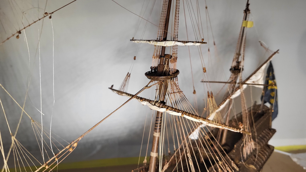

With the lower Fore ratlines completed, I finished mounting the spritsail topmast flag, the lower line is secured at the trestletree and the top line with a knot simulating the toggle is led down to the top. Now I'll focus my attention on the main topsail and lower course yards. Thanks for looking.

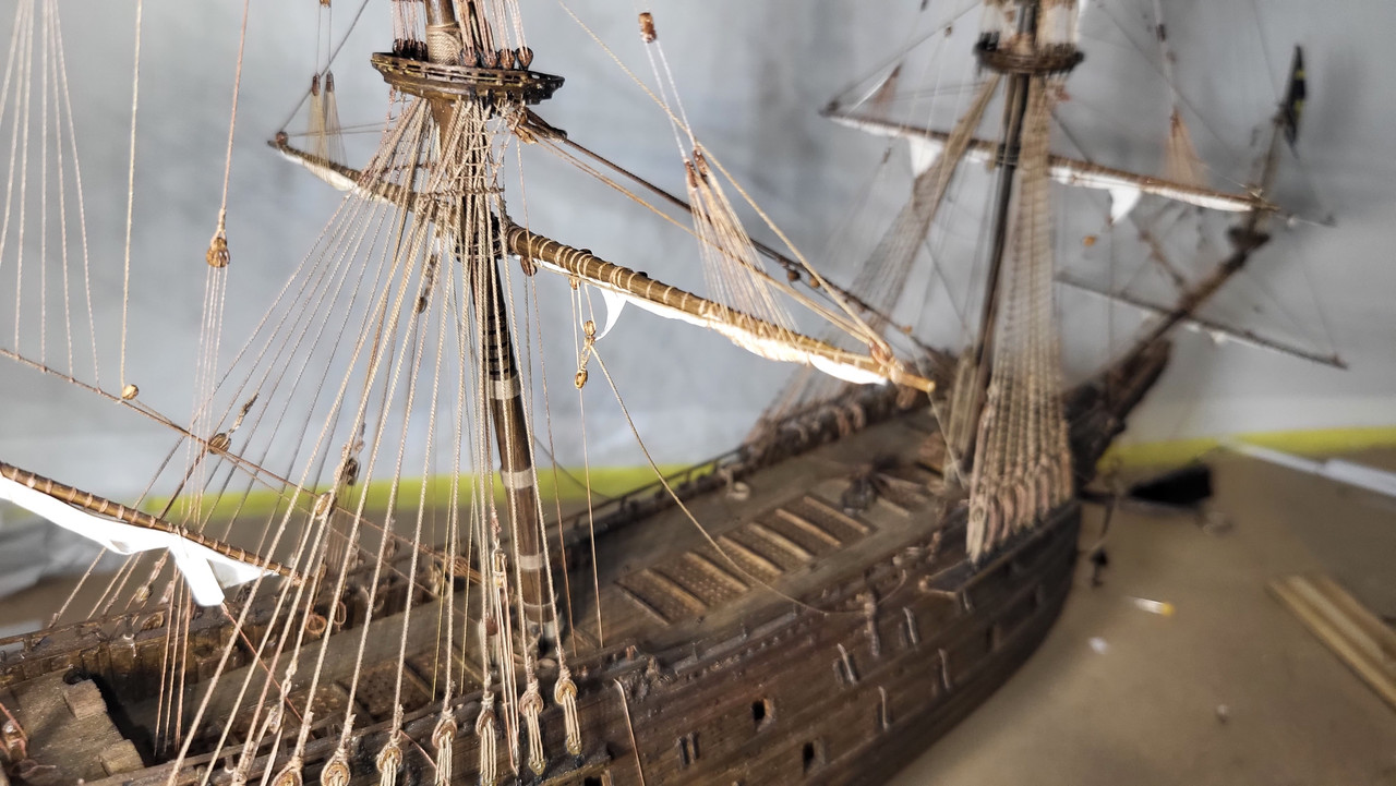

Not much happening in the shipyard lately due to adding a new member to the family, meet Houston a 13-week-old Redbone Coonhound, yes, my neighbors will love me for this!..hehe. Anyways I managed to mount the main topsail yard, tie, lifts and the pendants for the martnets, currently working on the main course, at this point the sail is ready to be furled then I'll attach the martnets and buntline blocks before securing it to the yard.

Thank you, Frank. I was able to find some time to install the main course yard, parral rope and martnets, up next will be the main topsail clews so I can complete the topsail sheets and the pendants for the lower course lift blocks and lower course clews. As always thanks for taking the time to look.

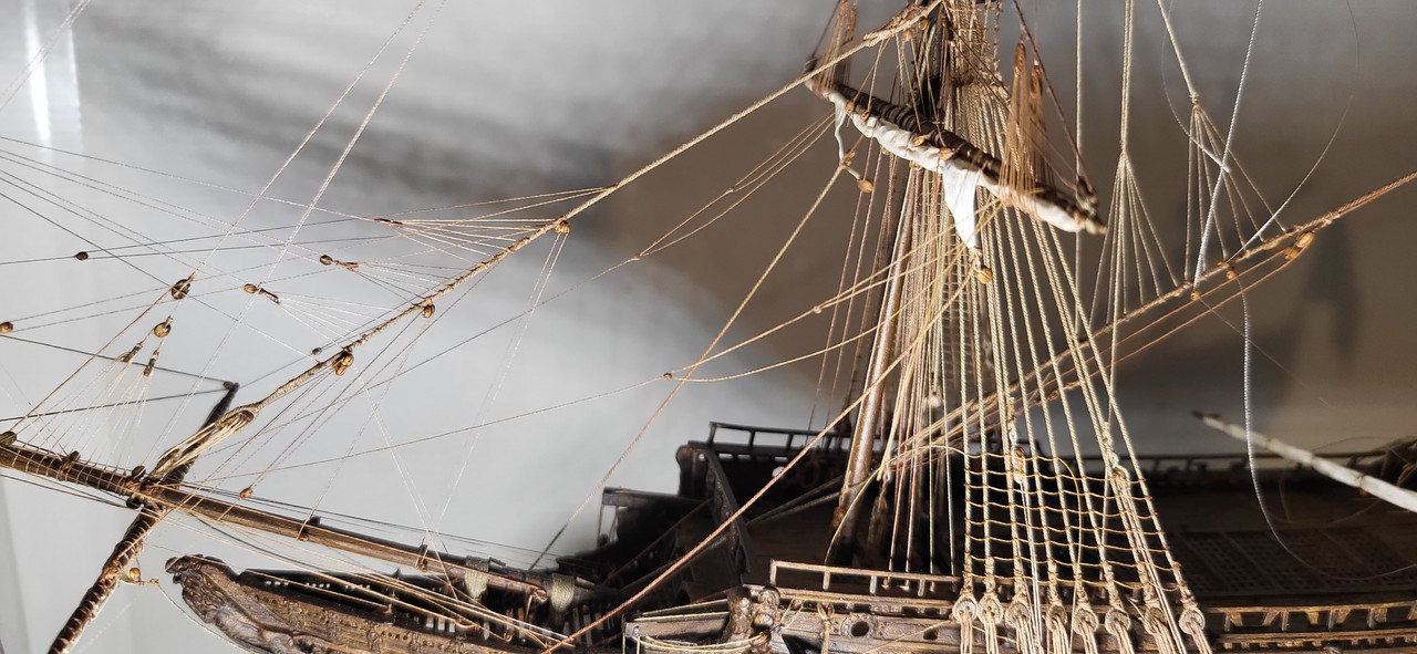

The main course is nearing completion with the buntlines and bowlines still left to do then move on to the Mizen mast, once that's completed then I'll go back and rig and rig the main ratlines all the braces and lower sheet lines.
