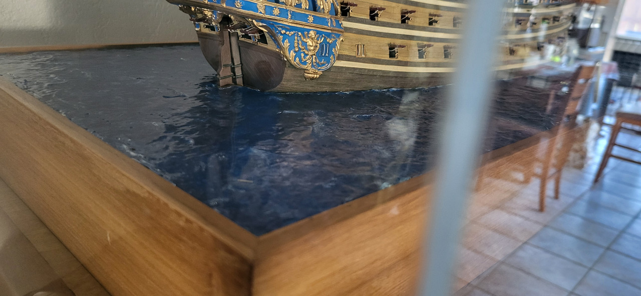

Hey Bill, I too decided to set mine in a waterline after completion, unfortunately all my in-progress pics got lost through Photobucket but I traced the hull profiles in cardboard then transferred to 1" Styrofoam and set into the new base, fairly simple task. A couple of photos (if you don't mind) to show the result, somewhat generic for my only attempt.

Thanks Michael. I like it. Do you remember how you traced the hull profile onto the cardboard?  That is the one part that I am debating best process. I can definitely use your photos to determine a good waterline. Is your’s basically 1” up from the bottom of the keel since you used 1” styrofoam?

I used a contour gauge, I think the one I had was 10" so I had to do it in a few sections, first attempt gets you real close then you fine tune the next template to where you want it then transfer to the Styrofoam.
I'm not sure how far up from keel but that doesn't really matter, I used 1" foam basically to carry the weight of the model without flexing. I'd get the contour of the hull right at the bottom of lower wale at midships, mine sits up a little high so that would look about right. Hope that helps Bill.

That is an easy fix. You think up a little closer to the bottom wale?  Maybe one more plank?  I just kind of went with how Michael did his. I noticed where his water line was on the rudder hinge and set mine at that level.
Thanks guys. I will trim my template so my SR sets in it to around the 1st-2nd plank below the bottom wale. Ian , like Marc said, you know you are itching to start your’s. I am as well to see what ideas you go with in your build.
