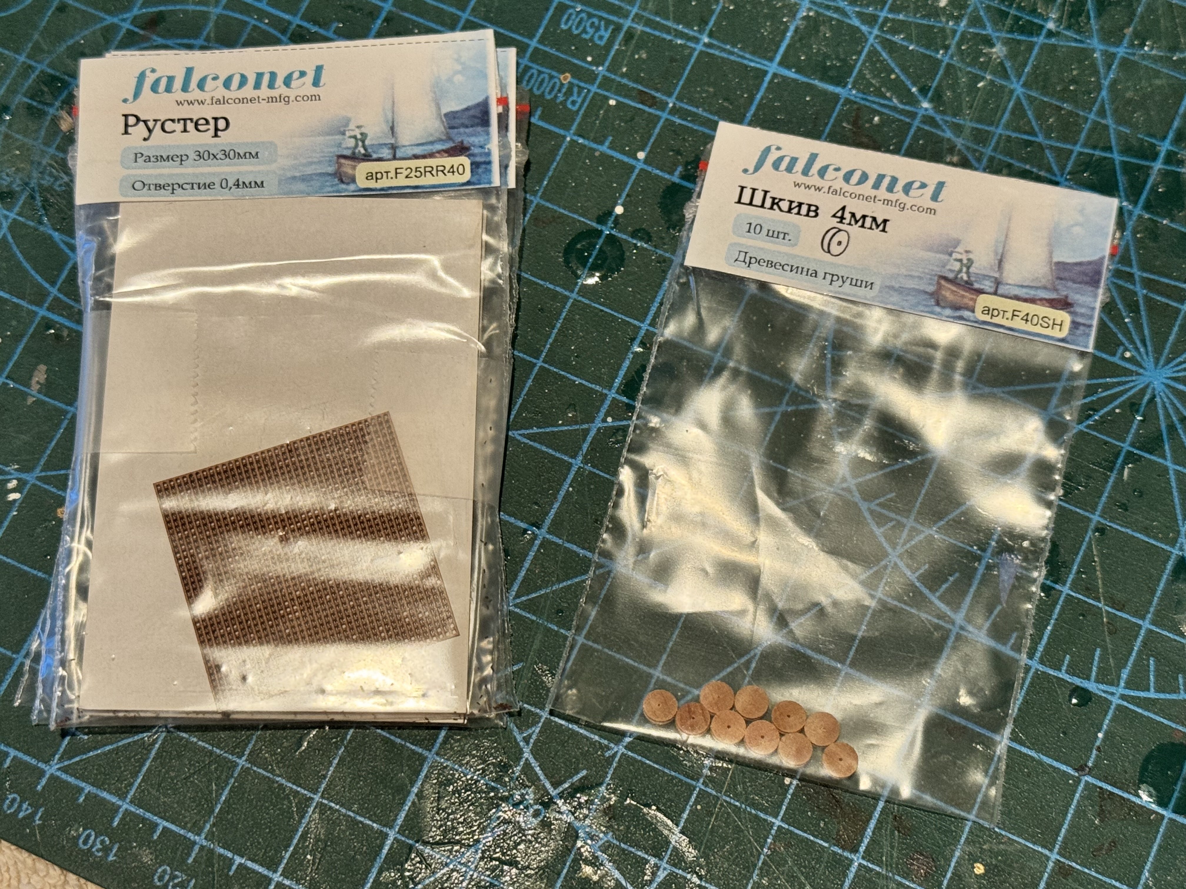

Daniel I spend a lot of time perusing your build to get inspiration and ideas. I am curious, maybe fascinated, by this floor. What did you do to make it?  Looks so similar to the original on the ship.
Good morning Bill. This is not included in the OcCre kit. I made it by using laser cut 1mm square prefab grating that I purchased from a company in Canada along with a bunch of very small wood pulleys so that I could make the AM specific running rigging pin racks. I’ll try to remember to take a picture of the packaging when I get home. Great product but very fragile due to the small size.
Bill, here is the 4mm wood sheaves and the 0.4 mm x 0.4 mm x 30mm square grid material that I’ve used all over the ship. Places on the deck, on the floor in the bridge, the floor of the sky bridge, and the captain’s deck at the stern.
https://falconet-mfg.com/collection/rustery?lang=en

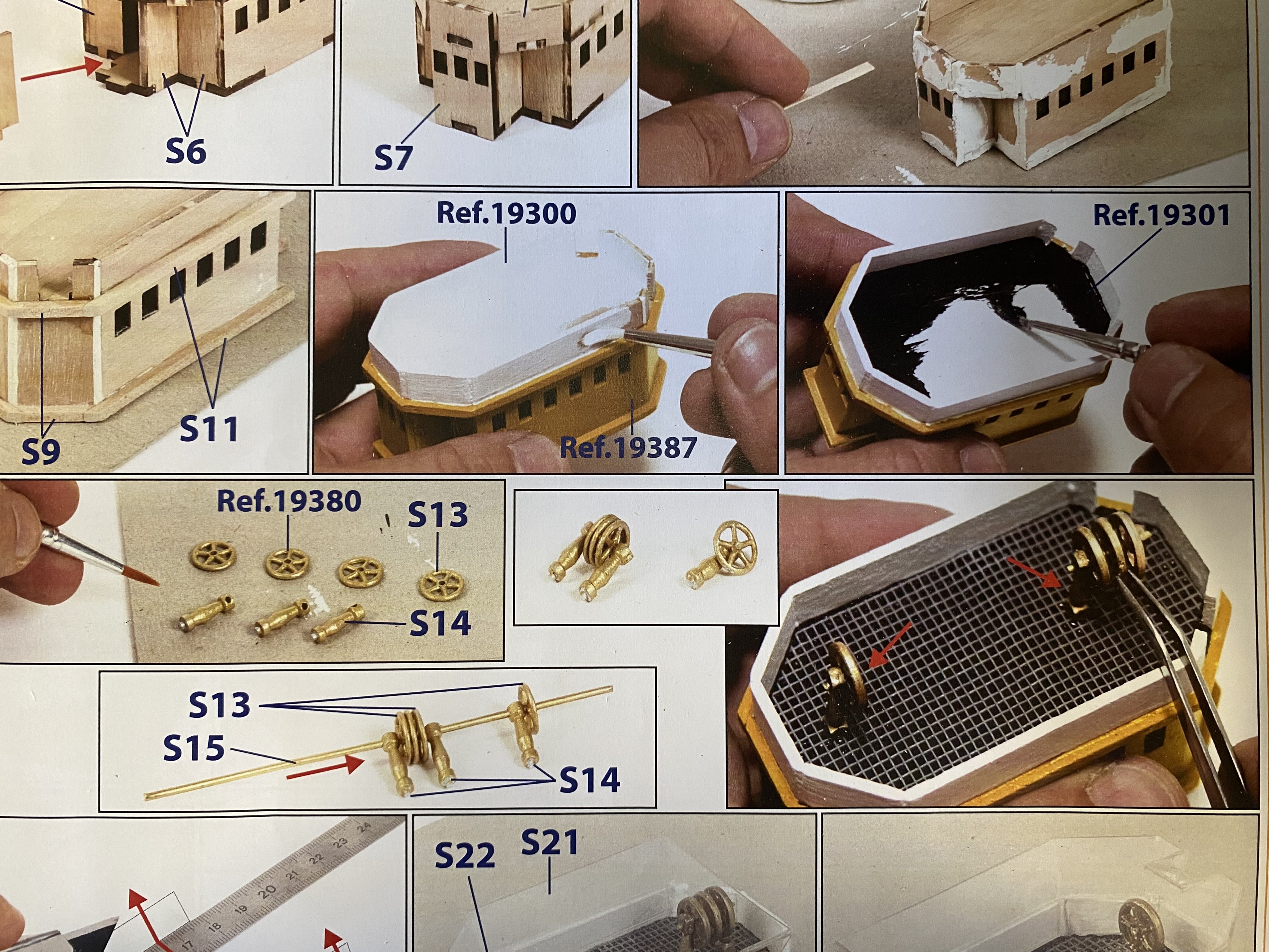

Daniel I am working on the helm and referring to your work here as well. As you are aware the OcCre instructions are very limited as to what to do with the inside, even if I just wanted to follow the basic instructions. As you mentioned the included wheels are kind of sad and I know I will need to do something differently there.  The instructions don’t even show how to mount them if I were to have wanted. But were there any parts included in the kit you did use to make parts B and C in the photo?  Or did you purchase and or fabricate the entire mechanism?
On 5/29/2025 at 2:05 PM, Bill97 said:
Beautiful job Daniel on the bowsprit netting. More for me to try to use as reference.
Hi Bill, I basically didn’t even look at the kit instructions for the inside of the bridge. I made everything from scratch to emulate the virtual tour as close as my skill level allowed. I made the telephones, the gauges, the supports for the helm, designed the floor based on the actual ship, lights, etc.

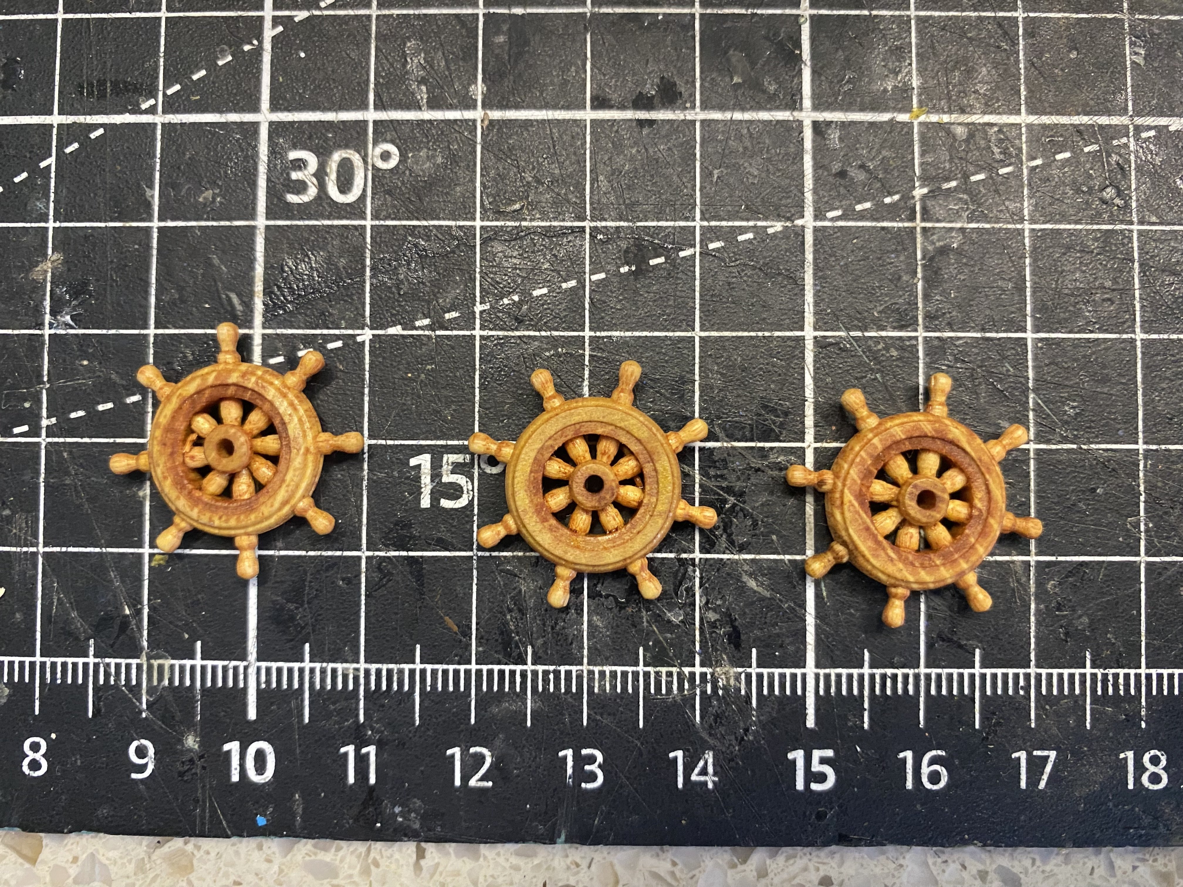

Daniel I too did not like what I thought OcCre provided for the wheels at the helm. I see later in the instructions that those wheels are intended to be used on the area with the clear top on the structure that sits on the fire control structure.
However since I am going to have the helm open so I can see inside it I did want more authentic wheels. I found these. They are a slight larger than I hoped for but will fit. I purchased 4 as in the actual ship but may only to use 3.  I too am struggling with if to put the windows in or not.
Edited by Bill97
