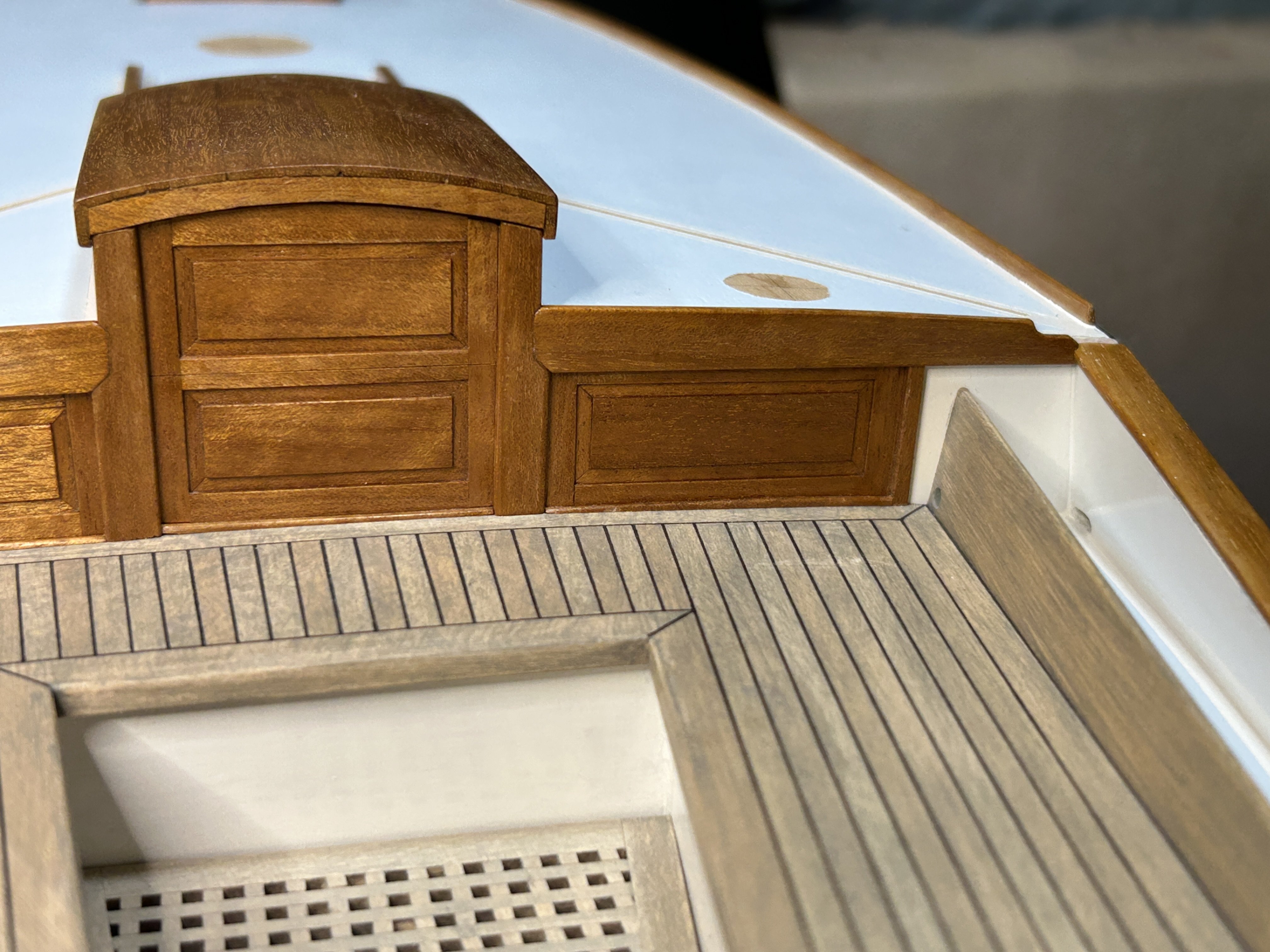

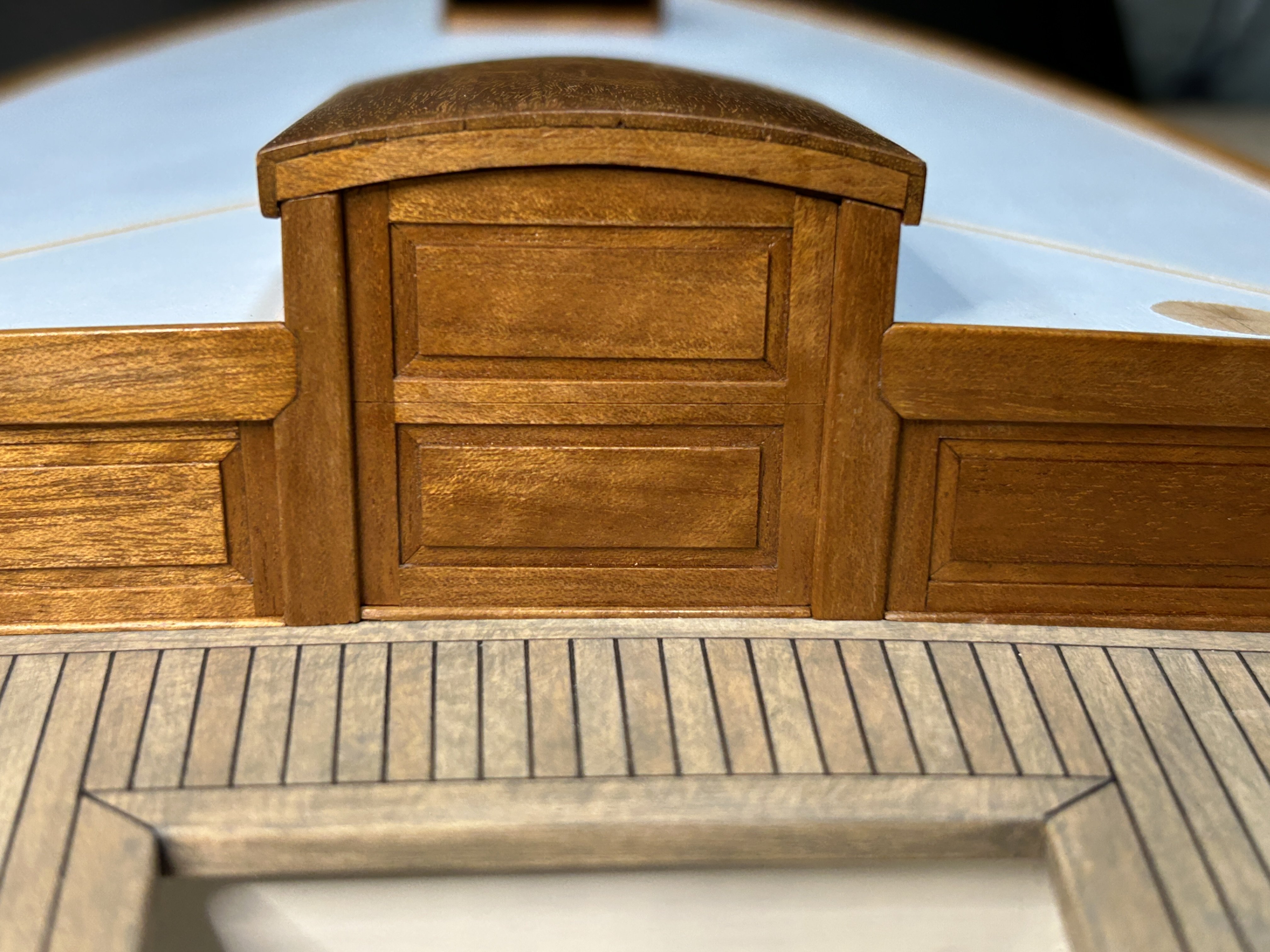

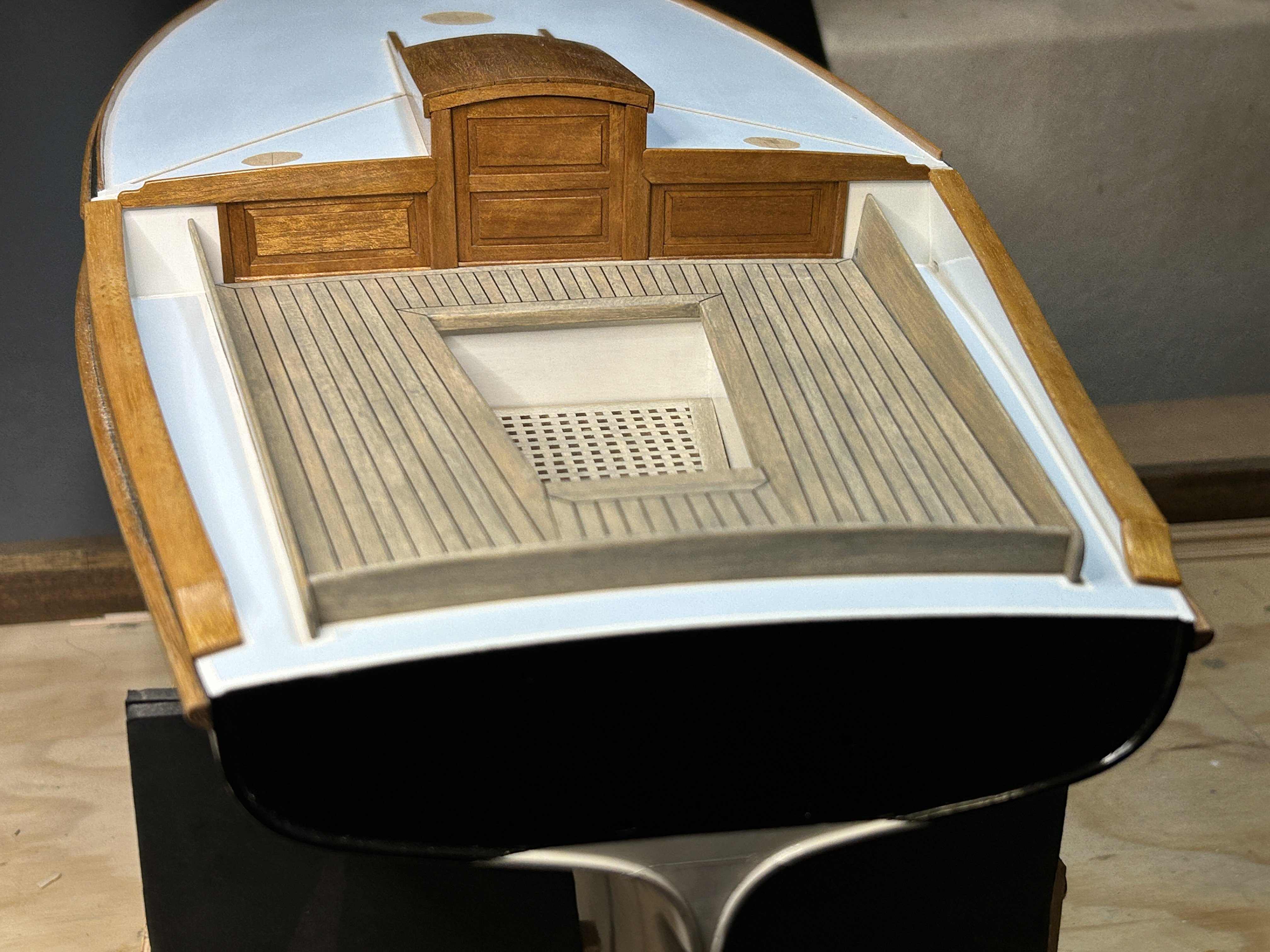

I'm now back from a Nordic trip in the northern hemisphere summer, & have now finished & assembled more of the details around the cockpit & face of the raised deck. The horizontal varnished trimming pieces both sides of the companionway, which insect with a vertical varnished piece each side; & the weathered teak cockpit seat backrests.
Overall view:
Detail, & I can see the pencil alignment mark needs to be removed:

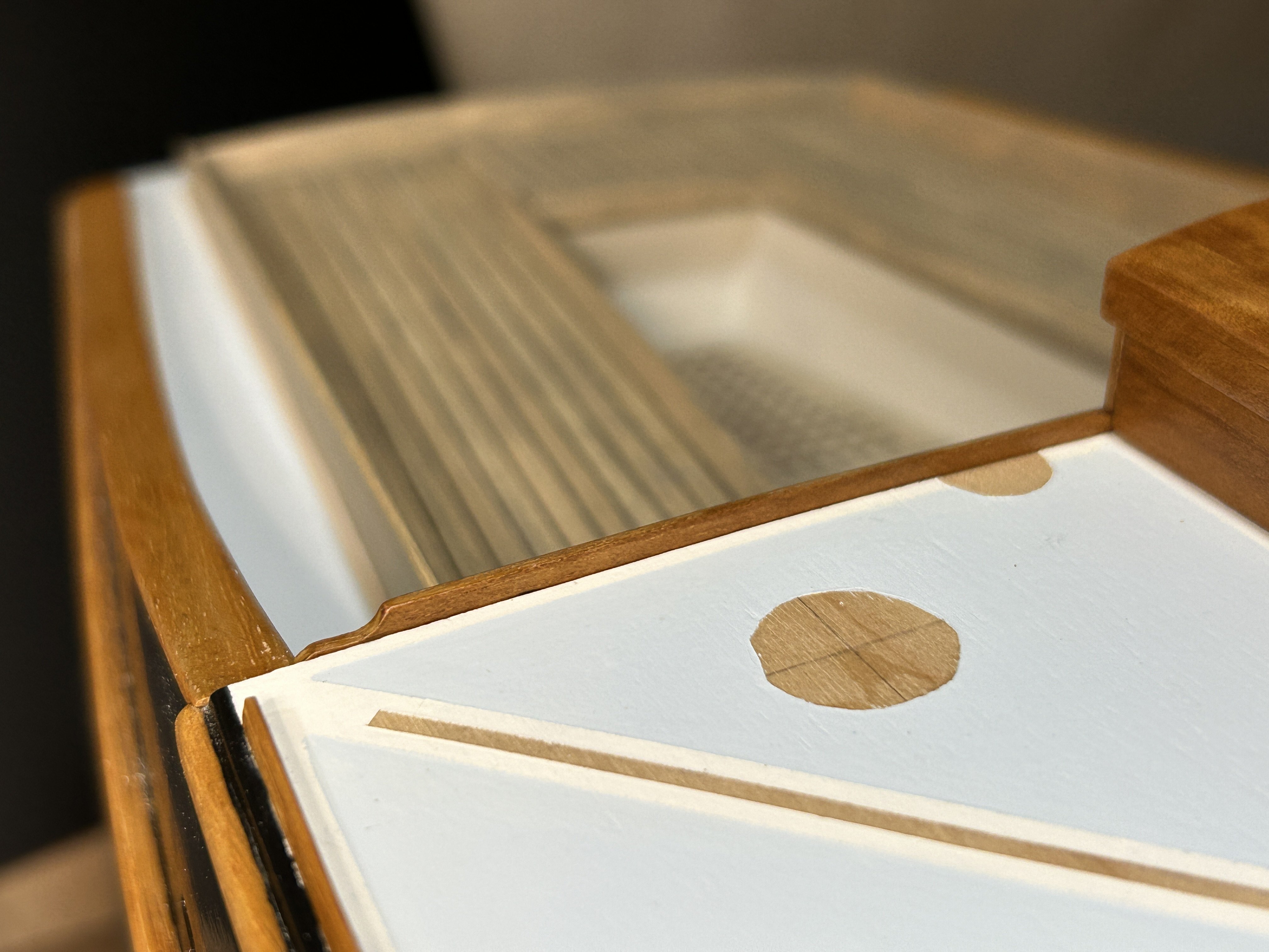

The junction of the strips was difficult to get, but happy with this:

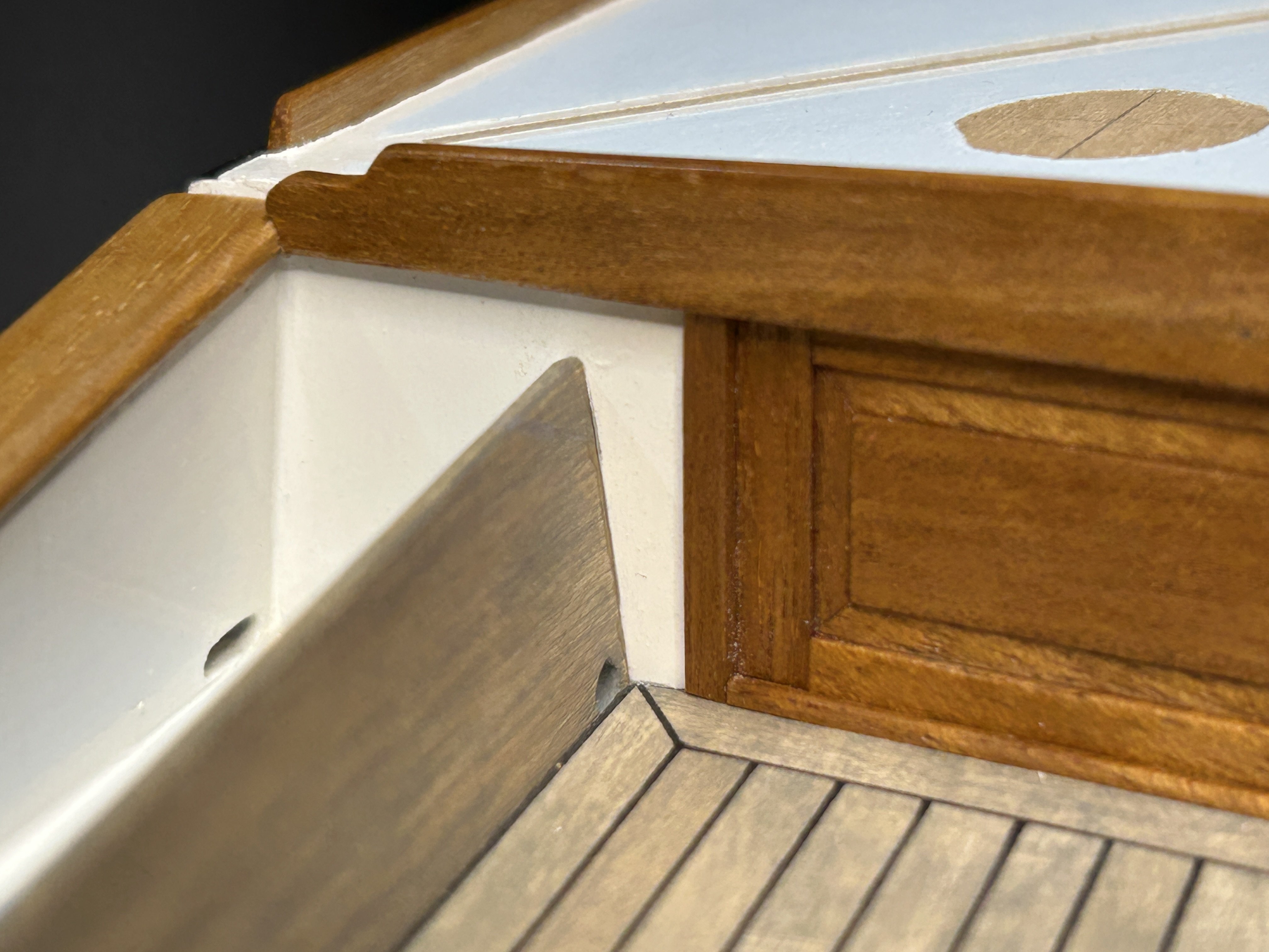

Detail, showing the drain openings & another pencil mark to be removed...

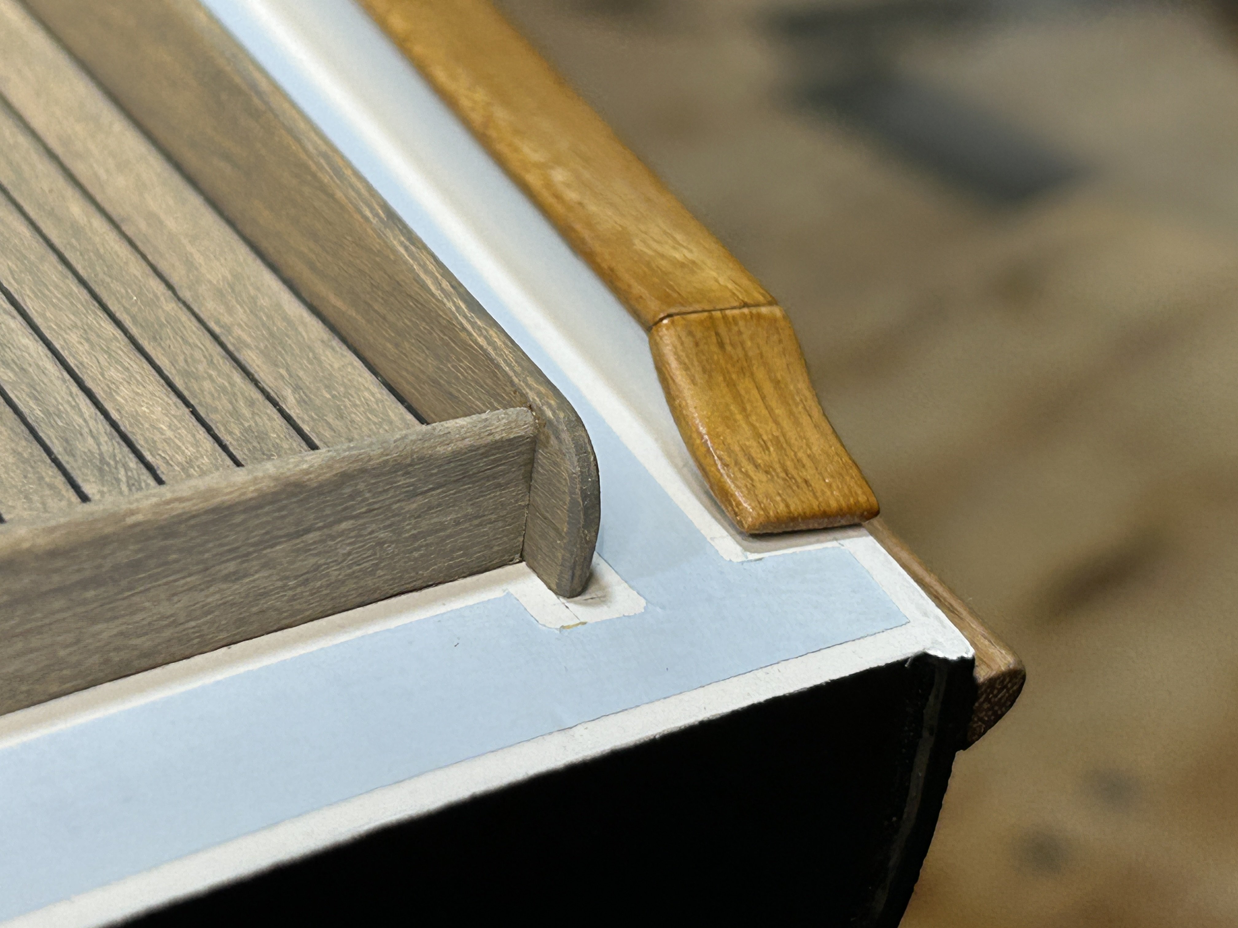

Trimming piece, against the deck.

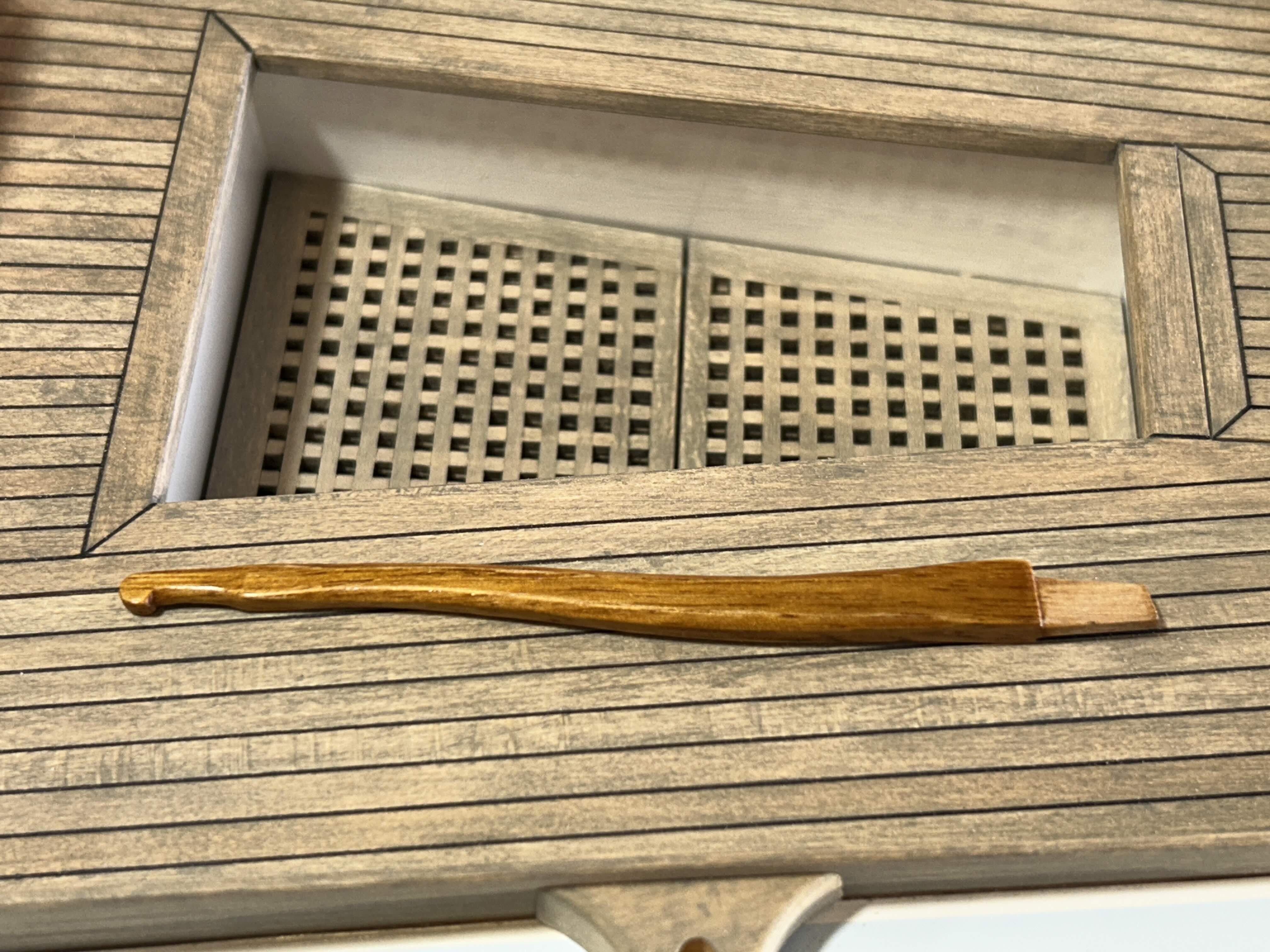

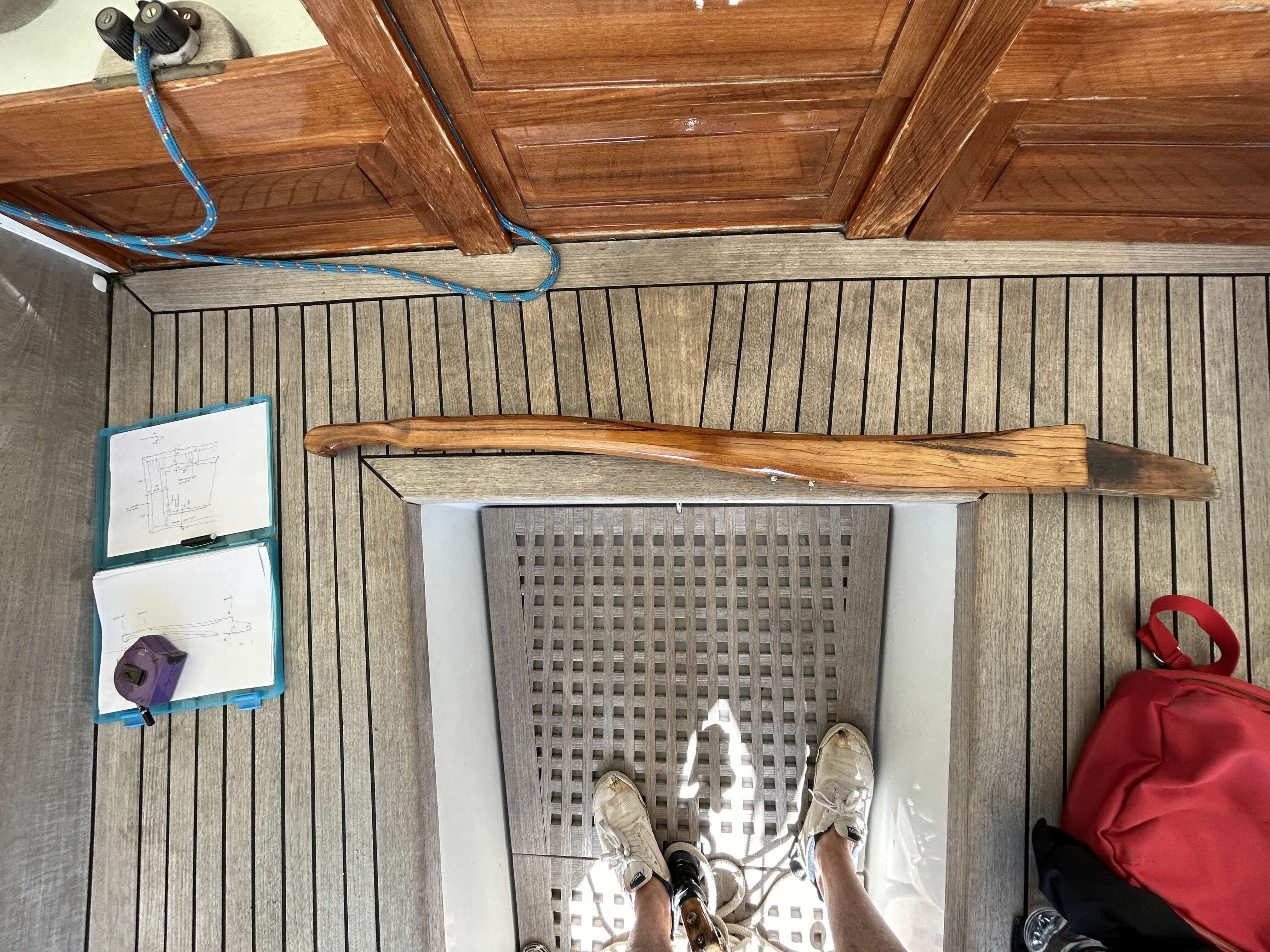

The tiller is underway, & either finished or nearly there. Possibly another coat or two of shellac, the actual tiller is an aged piece of hardwood, so would be good to give it some of that character.

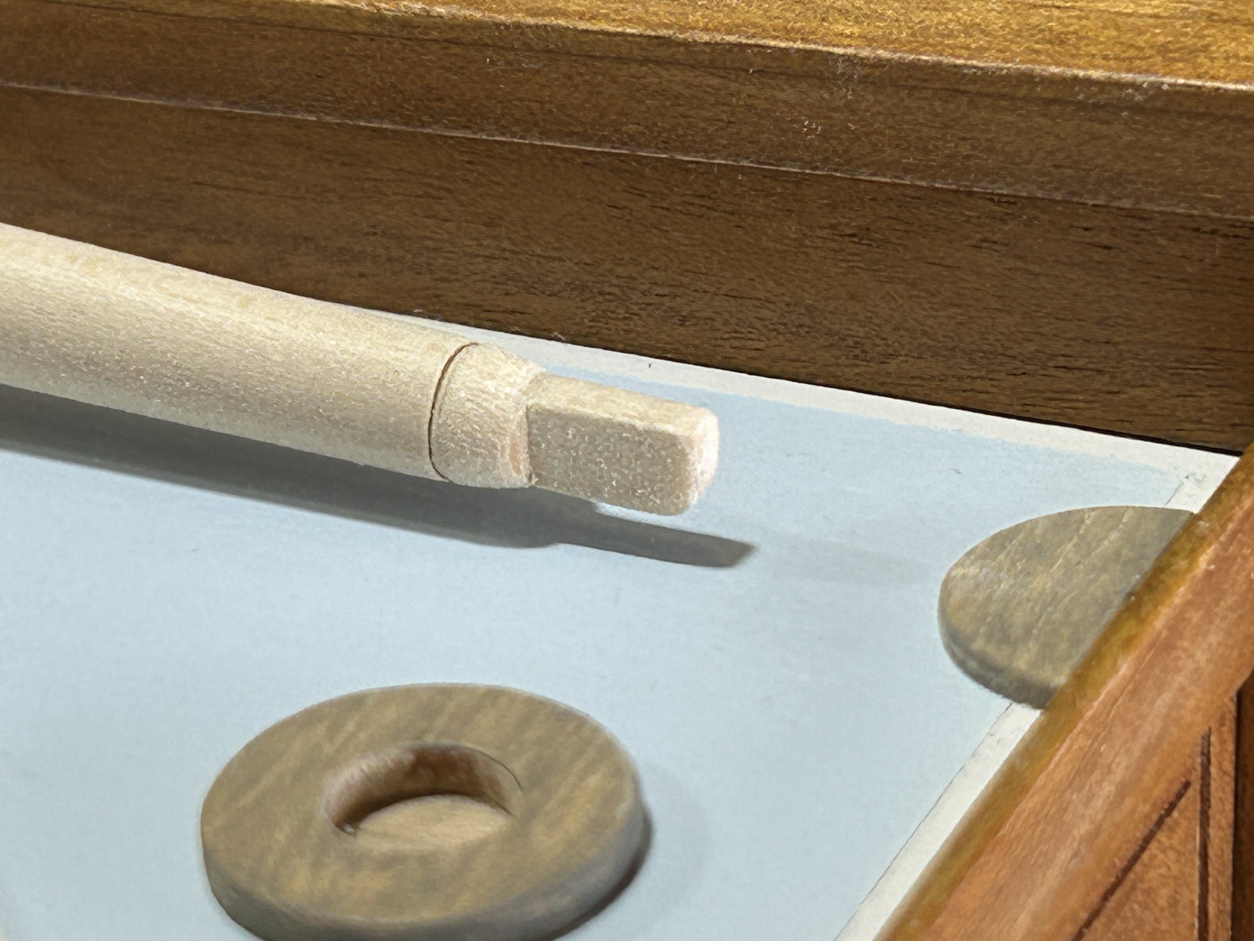

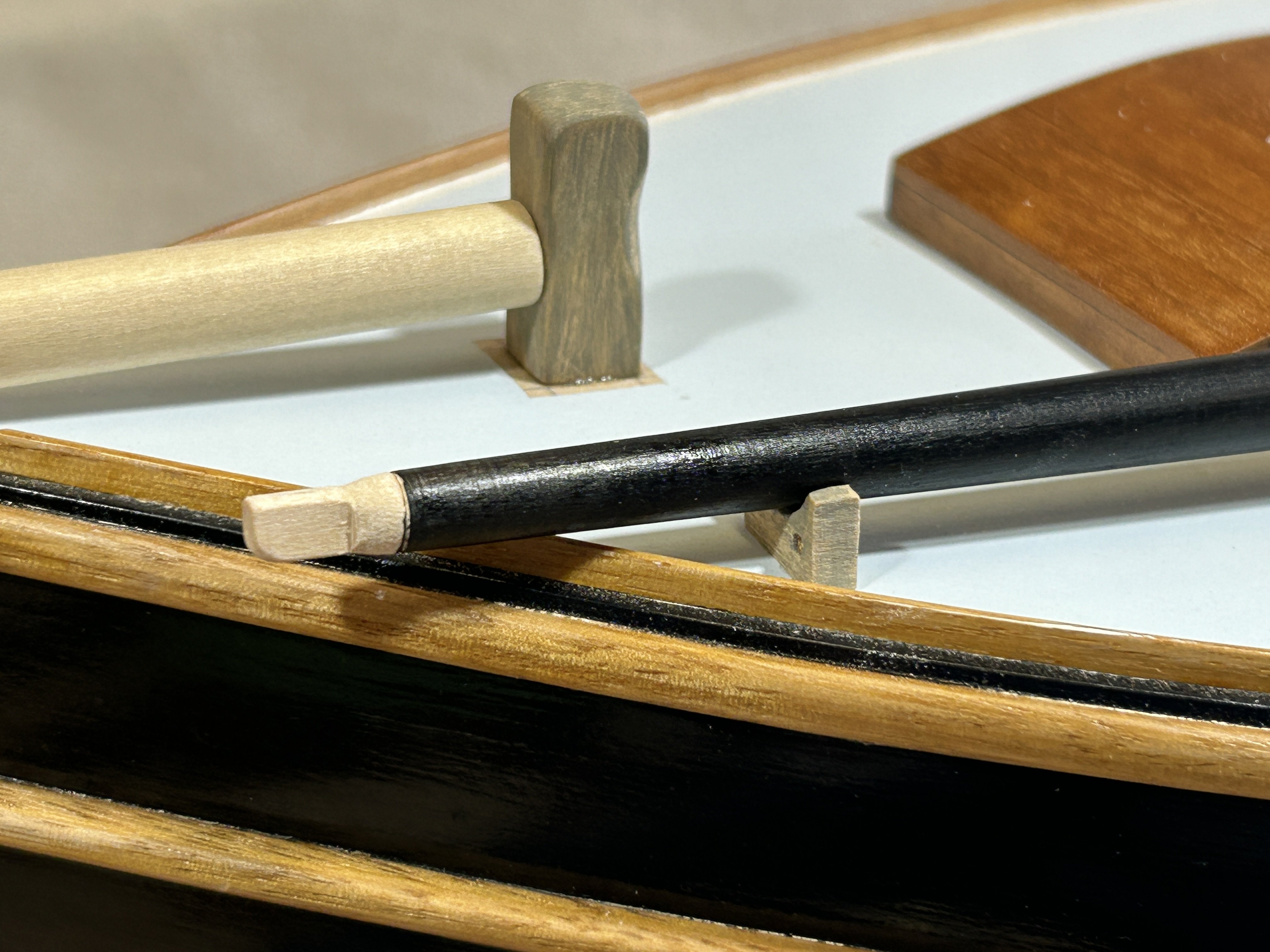

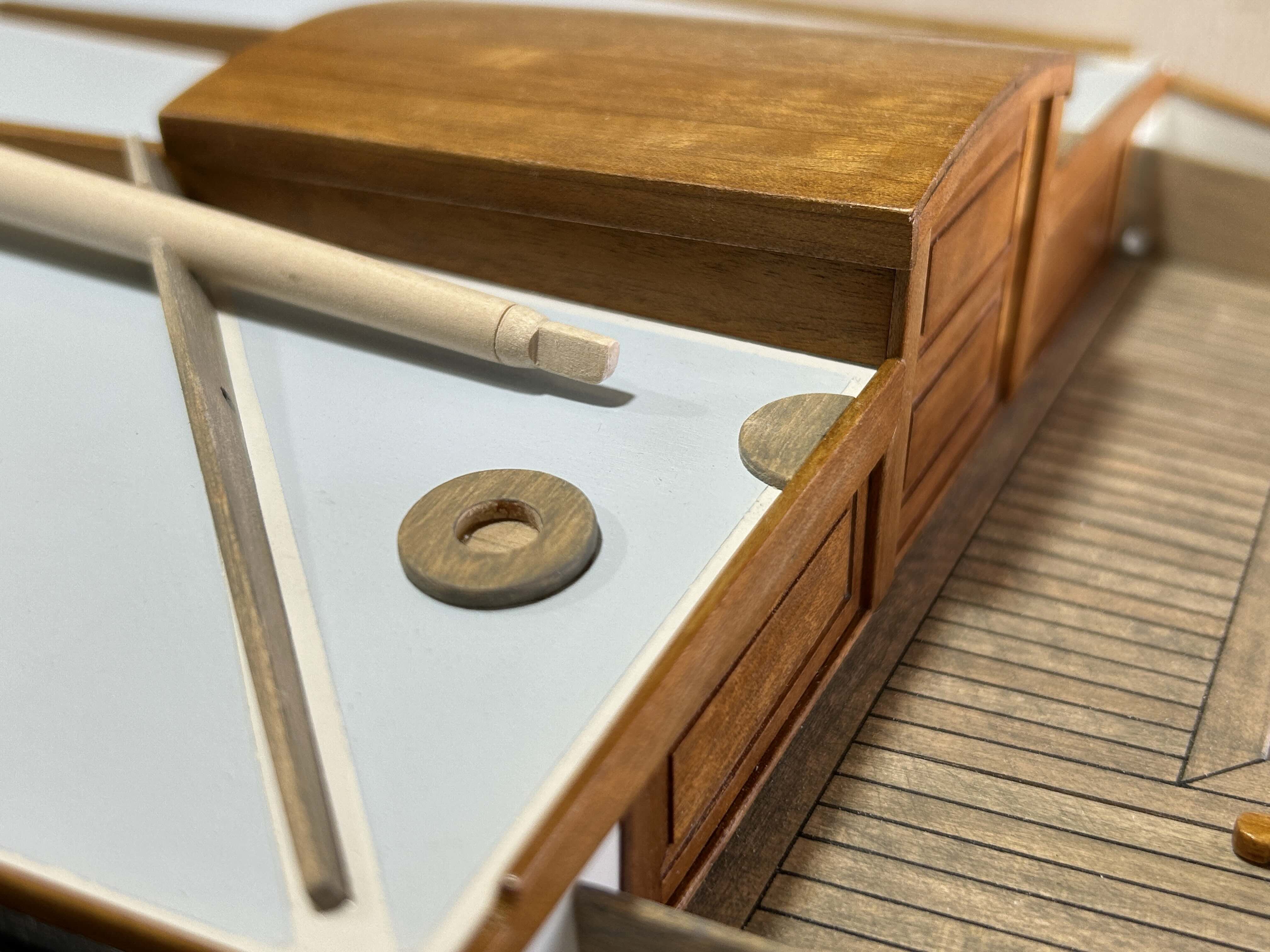

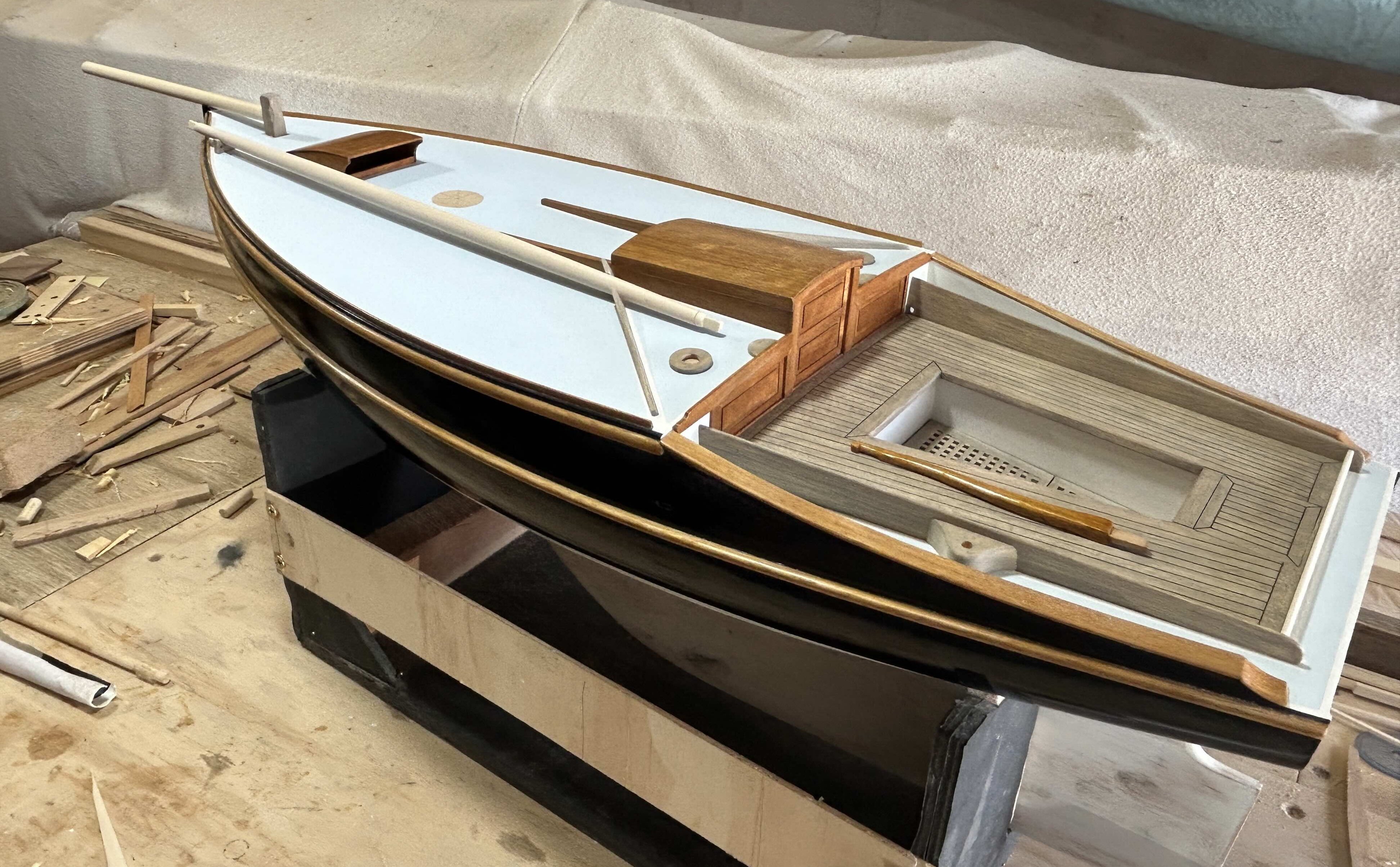

The bowsprit & spinnaker pole are underway, here they are tapered & cut to length:
I will do the pole, including end fittings primarily in timber. The actual pole is unfinished carbon fibre , so satin black, & the ends unfinished cast alloy of some sort.  The basic details of the end fittings are roughed out, & since the photos the ends were treated with some CA glue to harden the timber & avoid splitting when cutting the beaks. To replicate carbon fibre, I rubbed the pole with black paint, with no undercoat. It's looking ok, so a gentle sand & another coat might do the trick. To help articulate the joint at the end fittings of the pole, I did a groove by rolling the pole under the blade of a craft knife, they have a nice straight long blade.
