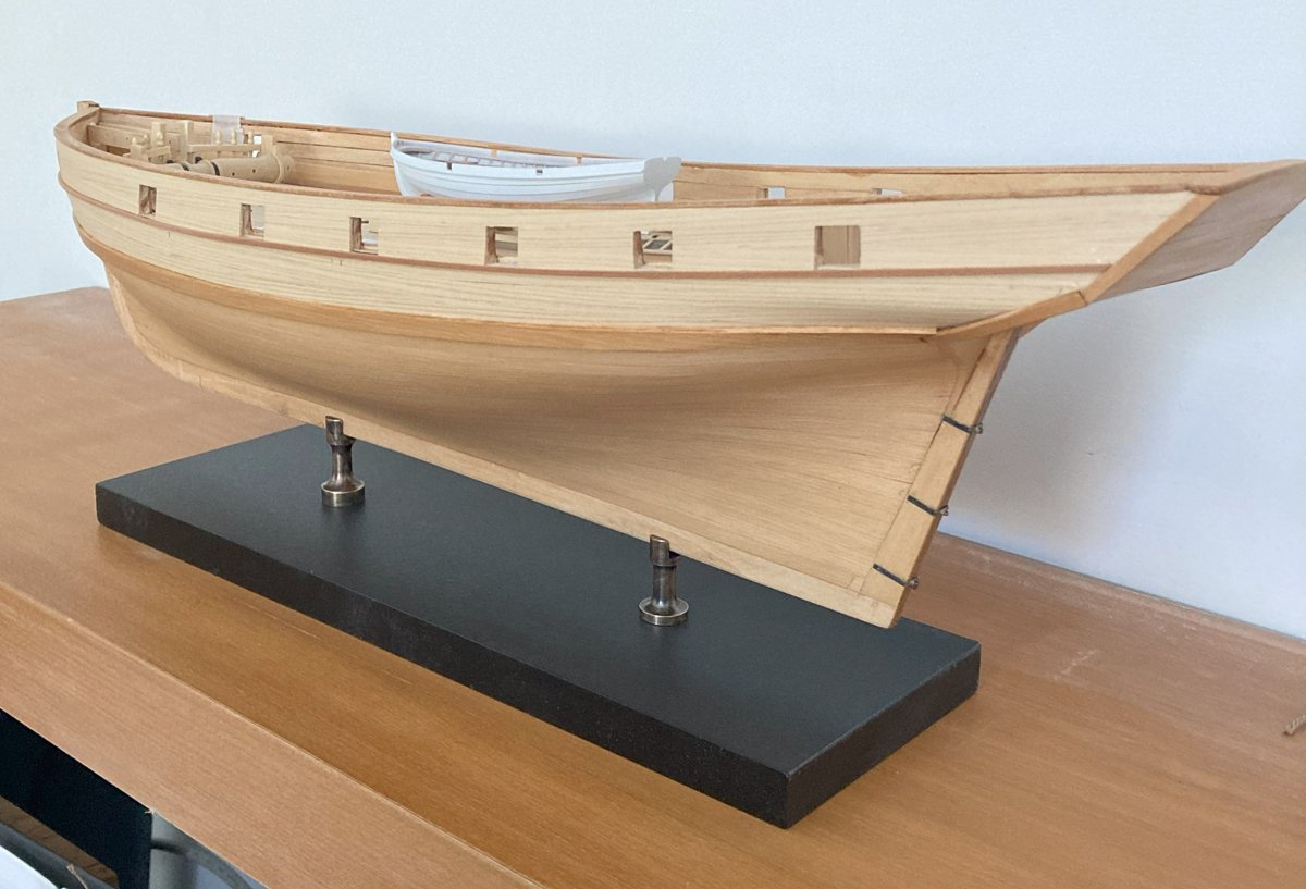

After remodeling the kitchen over winter now the garden has started up again.
I did manage to get a stand made from a bit of mahogany I had, not sure if it works?
It's a lot redder in real life.
standsternview.thumb.jpg.f2c45b54c53db41259c54ca5852a8ba3.jpgstandcu.jpg.9b8000f906e8eef5f8af53301cad92b0.jpg
pleased with the brass fittings from Cornwall Model Boats, dulled down as they are bit bright otherwise.
Comments please.

1 hour ago, oakheart said:
Comments please.
That's a tough question Tim, it all comes down to taste but it sounds like you're not convinced.
Myself, I feel that there's too much wood and too much straight grain. I think a black marble (or faux black marble) would add elegance and contrast.
Otherwise a heavily figured wood, something complex and contrasty.
My tuppence anyway.
Thanks for the feedback Craig, I agree about the straight grain, its what there was ........
Will search my wood pile for something more lively, I did not want to dominate the model.
maybe a paler wood with some nice grain.

As previously noted this is really a personal preference qurstion. If I was nitpicking I feel like the two keel holders are too close together.
But overall it looks good to me.
Edited by Thukydides
Hi @Thukydides thanks for the positive feed back, I would have to agree on the spacing.
I will have to do something about the heights of the pedestals to get the model level if I move them wider.
On the wood front, I did find a bit of wildly grained parana pine but it looks a bit too goofey.
Might even do a painted base.
Tim
You can try sitting her on coloured paper to get a feel for how it looks.
If you go high gloss it's going to have to be perfect, if you go satin finish it will be more forgiving.
That said, I'd probably try a gloss black.
Another option might be a diorama type sea (just the top of the plinth) with her floating above.
Craig.
I do know, that I don't know, a whole lot more, than I do know.
Current Build: 1:16 Bounty Launch Scratch build.   1:16 Kitty -18 Foot Racing Sloop   1:50 Le Renard   HM Cutter Lapwing 1816  Lapwing Drawings
Completed....: 1:16 16' Cutter Scratch build.
Discussion....: Bounty Boats Facts
10 hours ago, iMustBeCrazy said:
on coloured paper
I like that idea,.
Had considered the diorama idea, with the base a lump of rough stone / rock, could be a bit 'twee' if not done right.
Could even be sandy like the seabed.
Endless fun could be had. I could play all day, better than doing any real work on the ship.
Tim

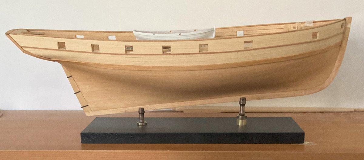

OK. I have gone for a satin black base. I think this works, some of the contemporary models at RMG have black stands.
@Thukydides Thanks for the comment,  I have spaced them out further and the model is then not level, is that important?
I suppose the mast needs to be vertical, but as its not yet fixed in place, difficult to tell
as you say this is all down to a personal choice.
I think it looks much better.
In terms of the angle, that depends on the waterline. Cutters had a keel drag so you need to look at the plans and make sure the waterline is level with the base. It looks pretty close to my eye, but without looking at the plans you don't know exactly how much keel drag there was.
The mast on cutters is not straight, the exact angle to the keel you need to figure out from the plans. For example you can see below a picture of my alert (an earlier cutter), but you can see how far back the mast is angled.

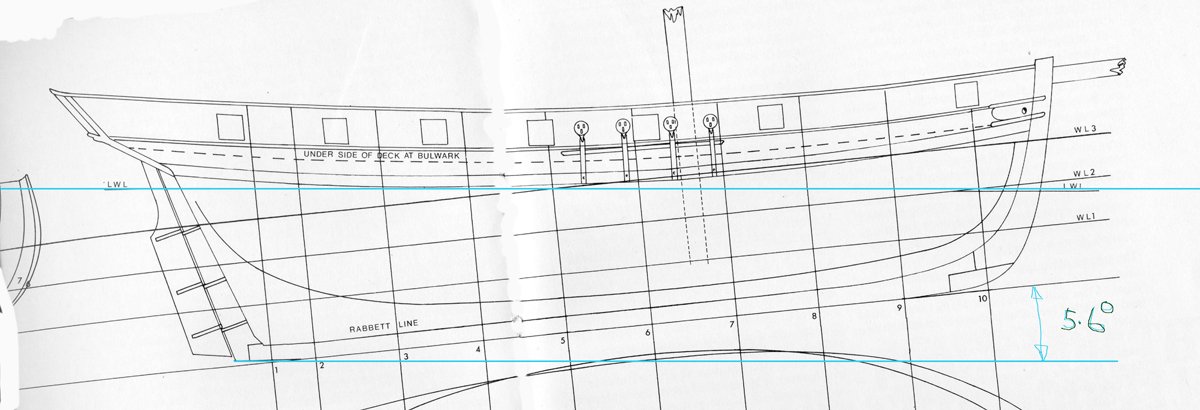

Thanks, I will check Bills plans to see what angle the mast should be.
Much happier with the look of the base now.
I can hopefully also adjust the pedestals to get the keel at the correct angle to show the drag.
Tim
So I took a quick look at the plans on RMG and it may be that the speedy mast was perpendicular to the keel, you can print off the plans and measure the angle. Though the waterline is at a significant angle.
https://www.rmg.co.uk/collections/objects/rmgc-object-86216
2 hours ago, Thukydides said:
measure the angle.
So I measured the angle on Bills drawing and as far as I can tell its the same as the RMG drawing.
That's assuming LWL means the water level.

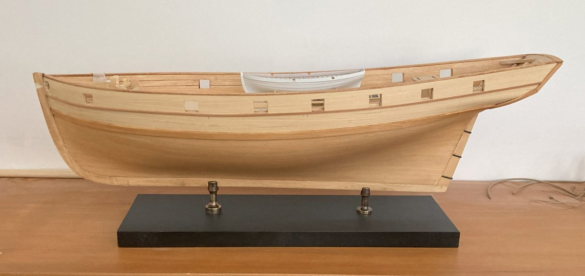

Here is my stand with a 10mm spacer that brings it up to the correct angle, I think this looks too steep.
Probably half that would do it, I love tinkering until it looks right, all part of the build for me.
Tim, I get it as 89-90° to the keel (leaning aft if 89°).

8 hours ago, iMustBeCrazy said:
leaning aft if 89°
Thanks Craig, I need to make sure my mast is held tightly, at the moment it wobbles about all over the place.
