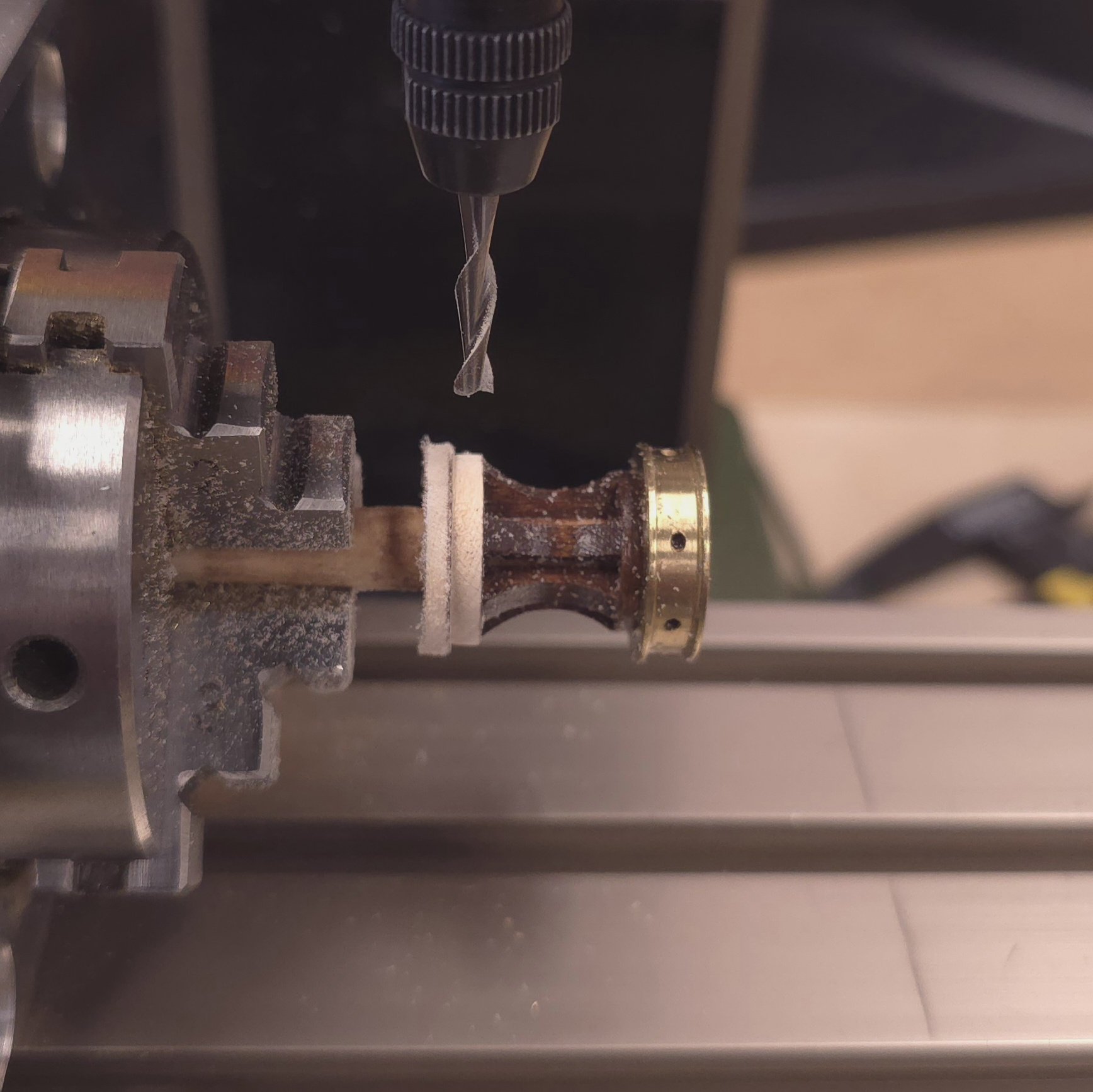

I was wondering how you would made the square holes for the capstan bars, but I assume you're leaving them round, or will they be square?

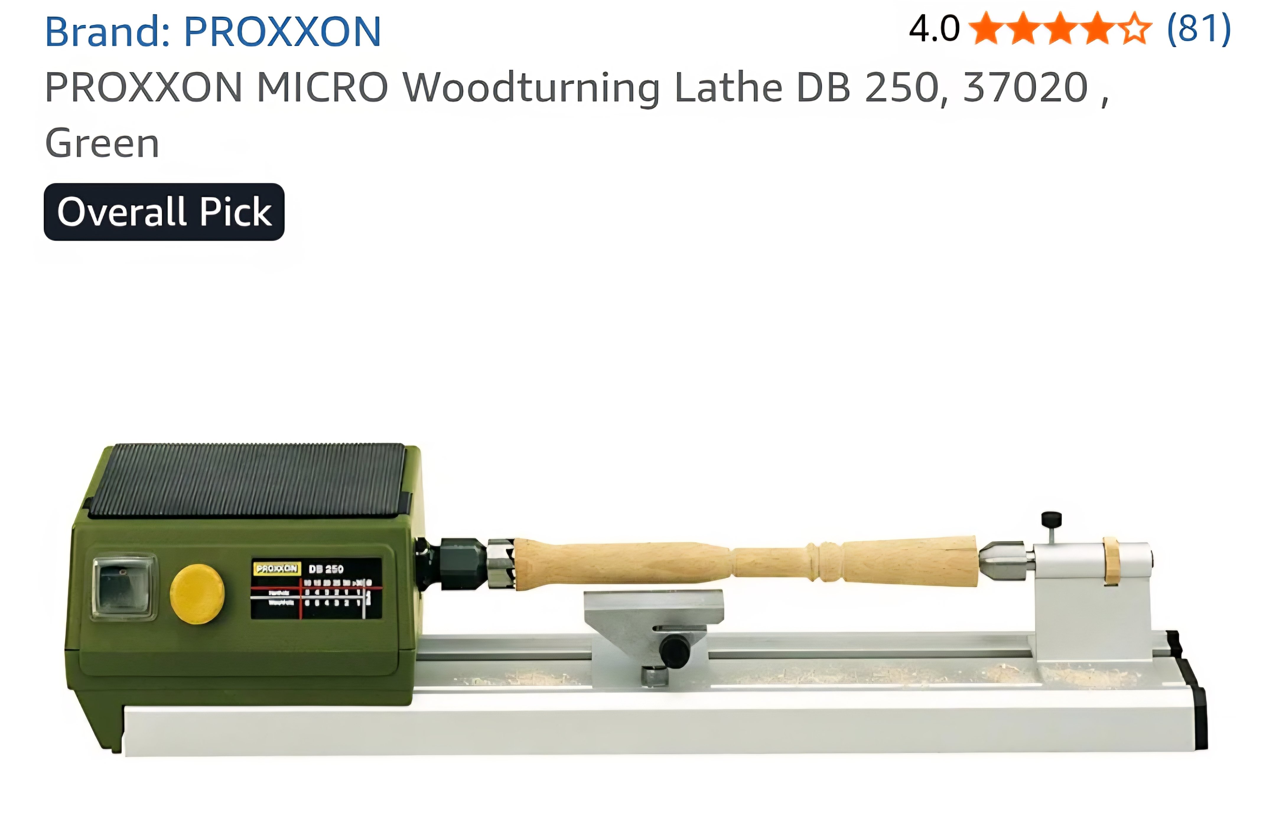

What exact models of lathe and milling attachment do you have?
Cheers
Haiko
19 hours ago, The Bitter End said:
And normally the bottle neck to the results is the ability of the user. So congratulations, good tools or not, you are the one steering the ship.
Cheers
Haiko

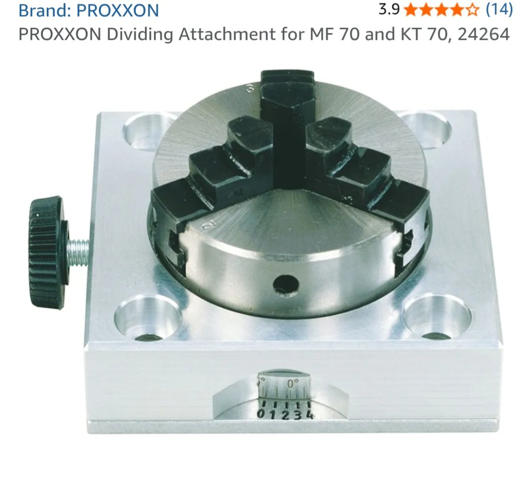

Both are Proxxon products.
The lathe is the DB 250.
Screenshot_20250822_091027_AmazonShopping.thumb.jpg.ef7d7ede3a196ce39f92ebb6d2d4511e.jpg
The dividing attachment is this.  Part 24264.

I did attempt to use a square file to make the square openings, but the amount of pressure I would have had to apply risked damaging the brass band.  What I may do at the very end, is to manufacture the poles that go into those holes and show the capstan ready for use.
But at this scale, with naked eyes, the difference between round and square is barely noticeable.

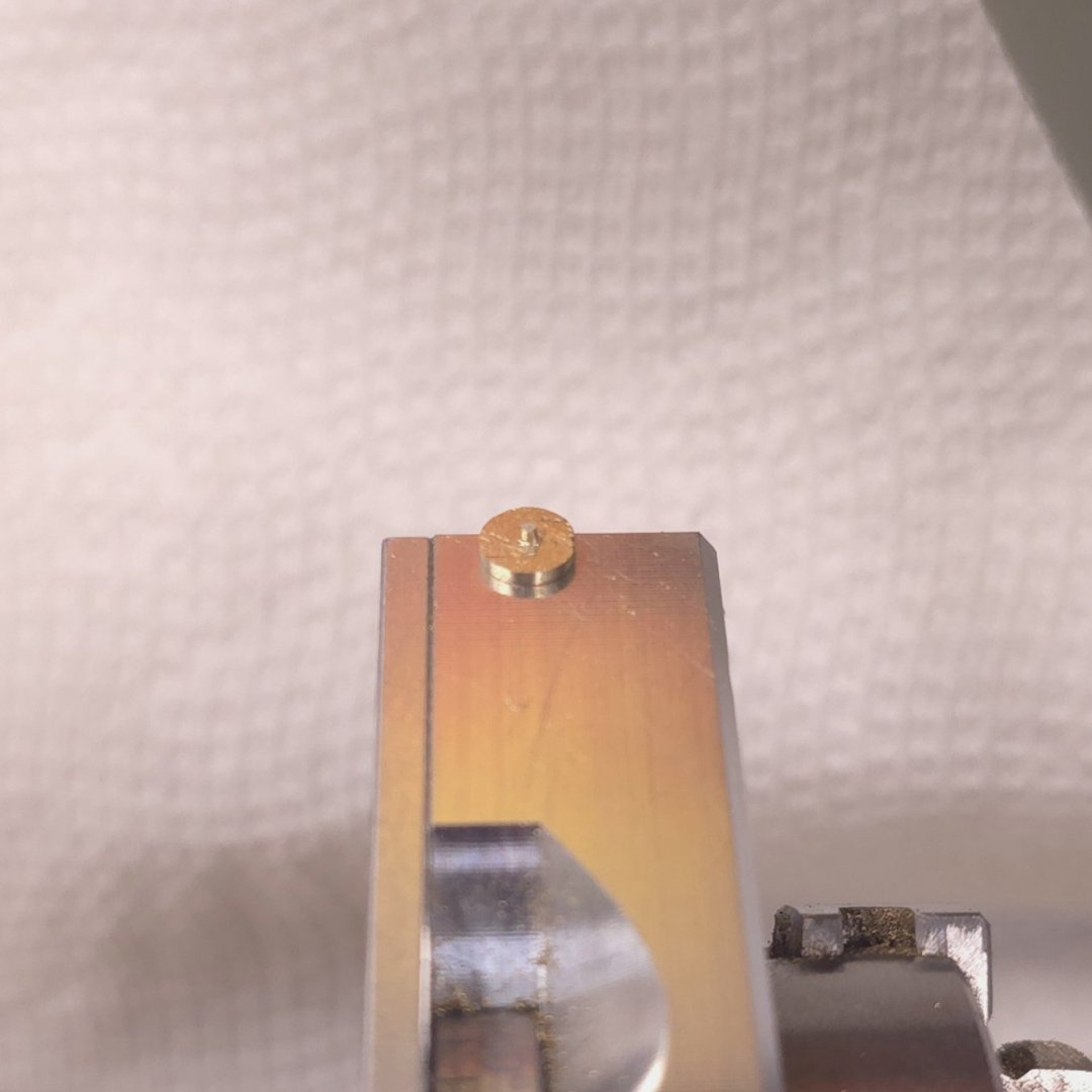

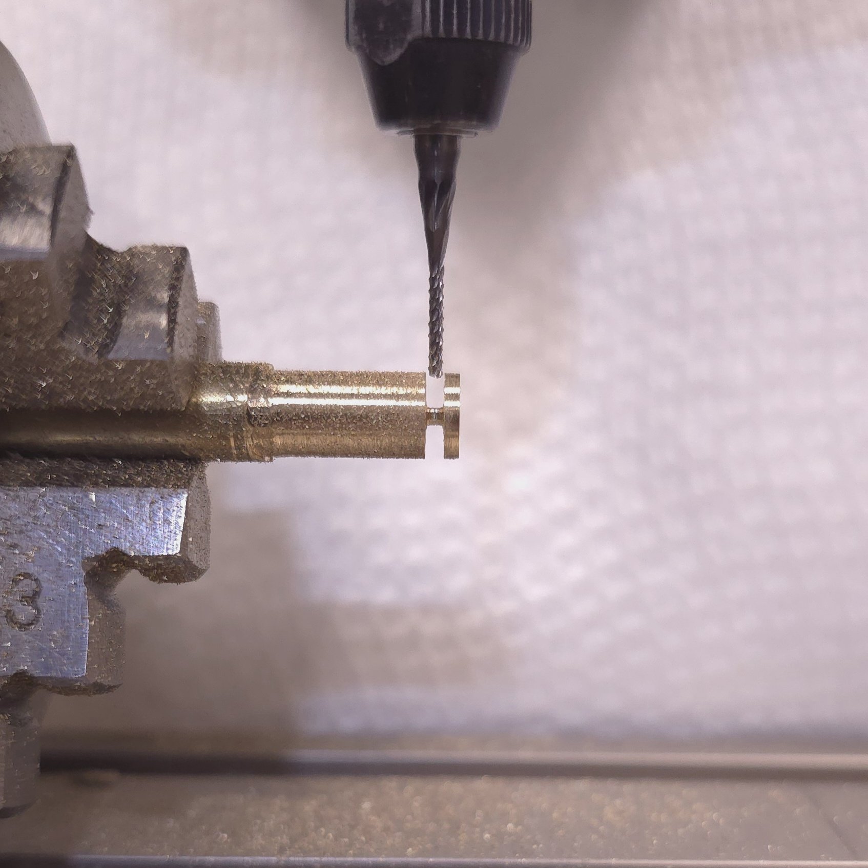

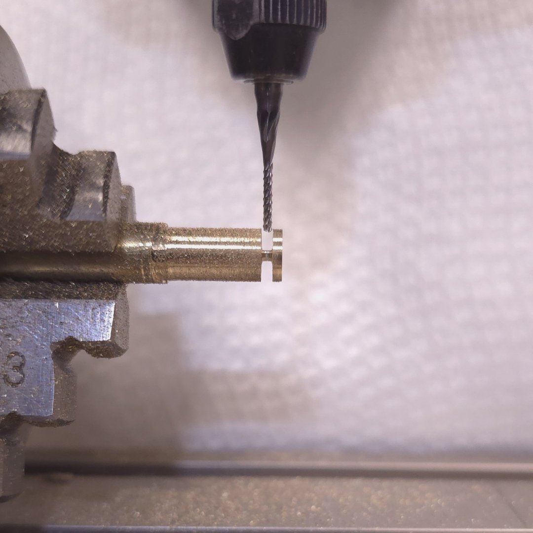

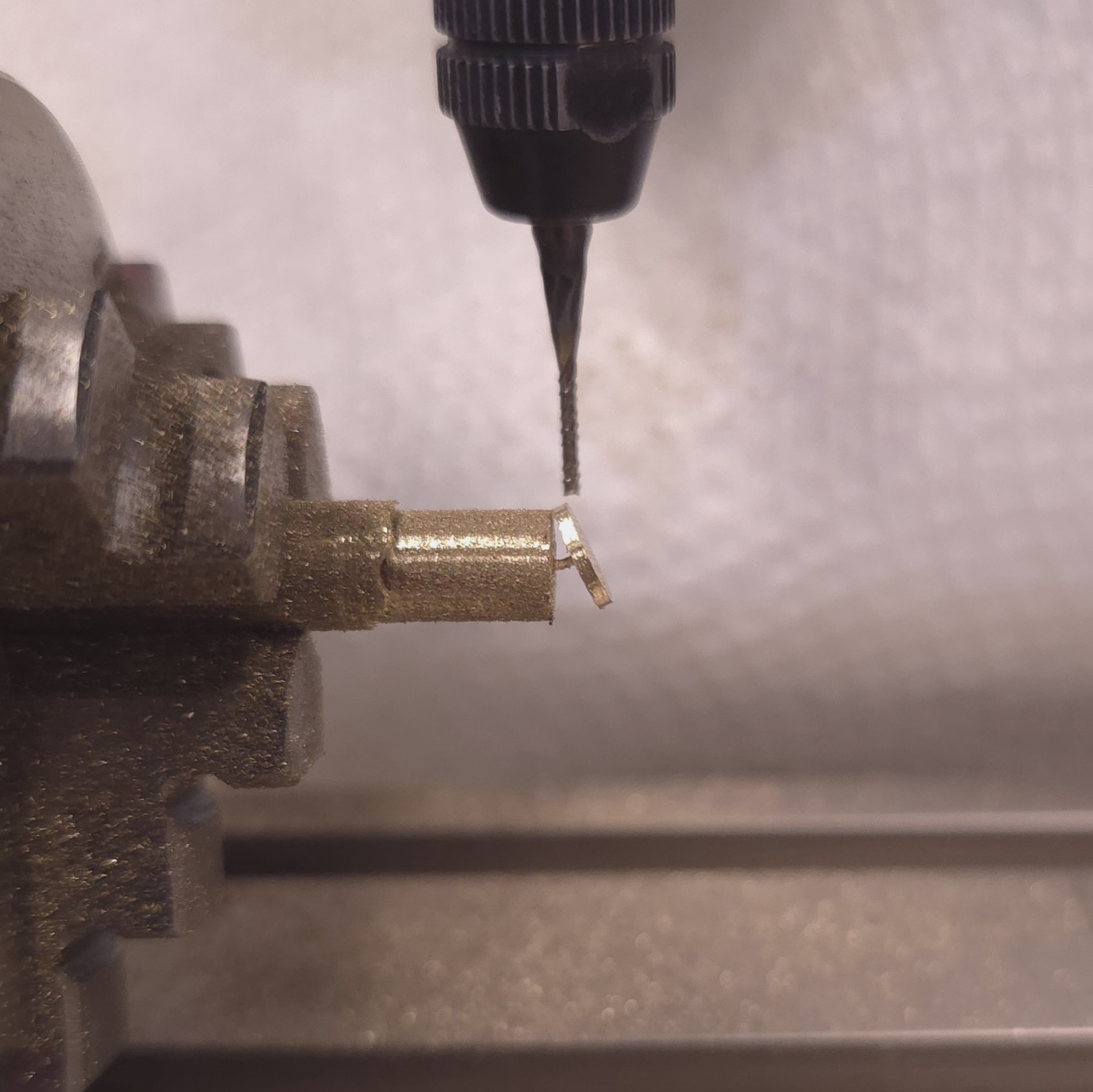

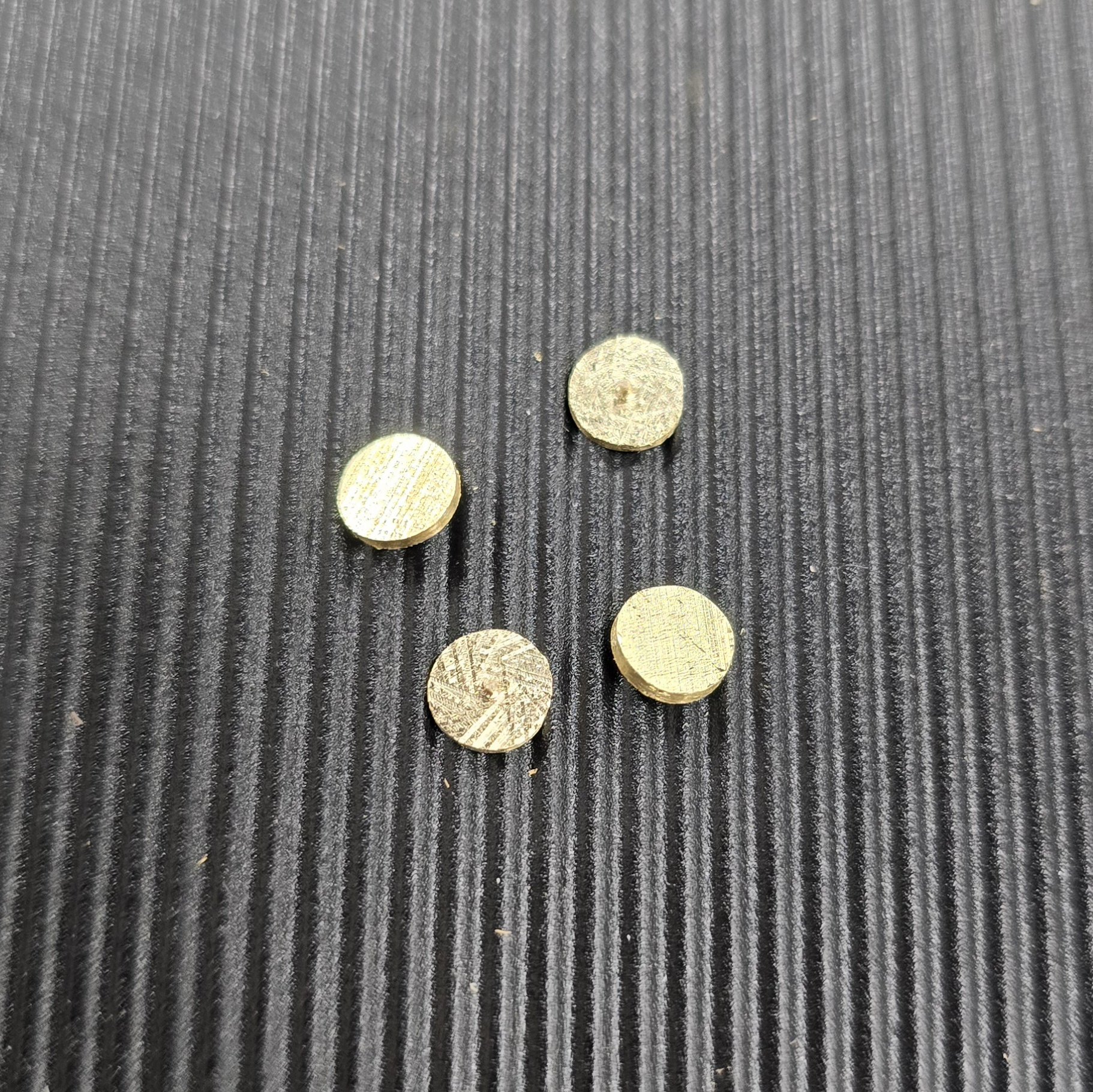

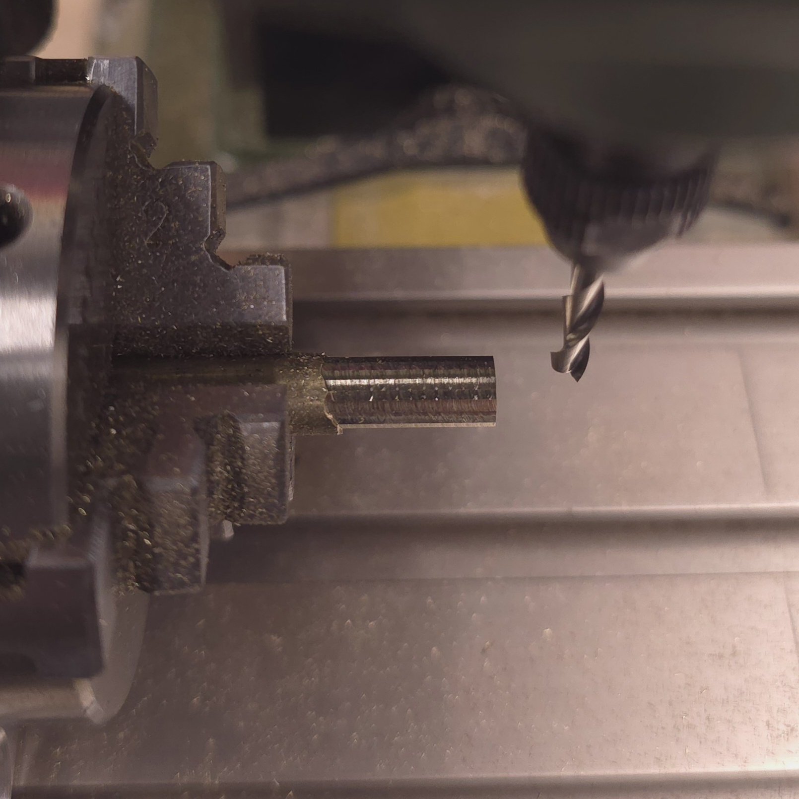

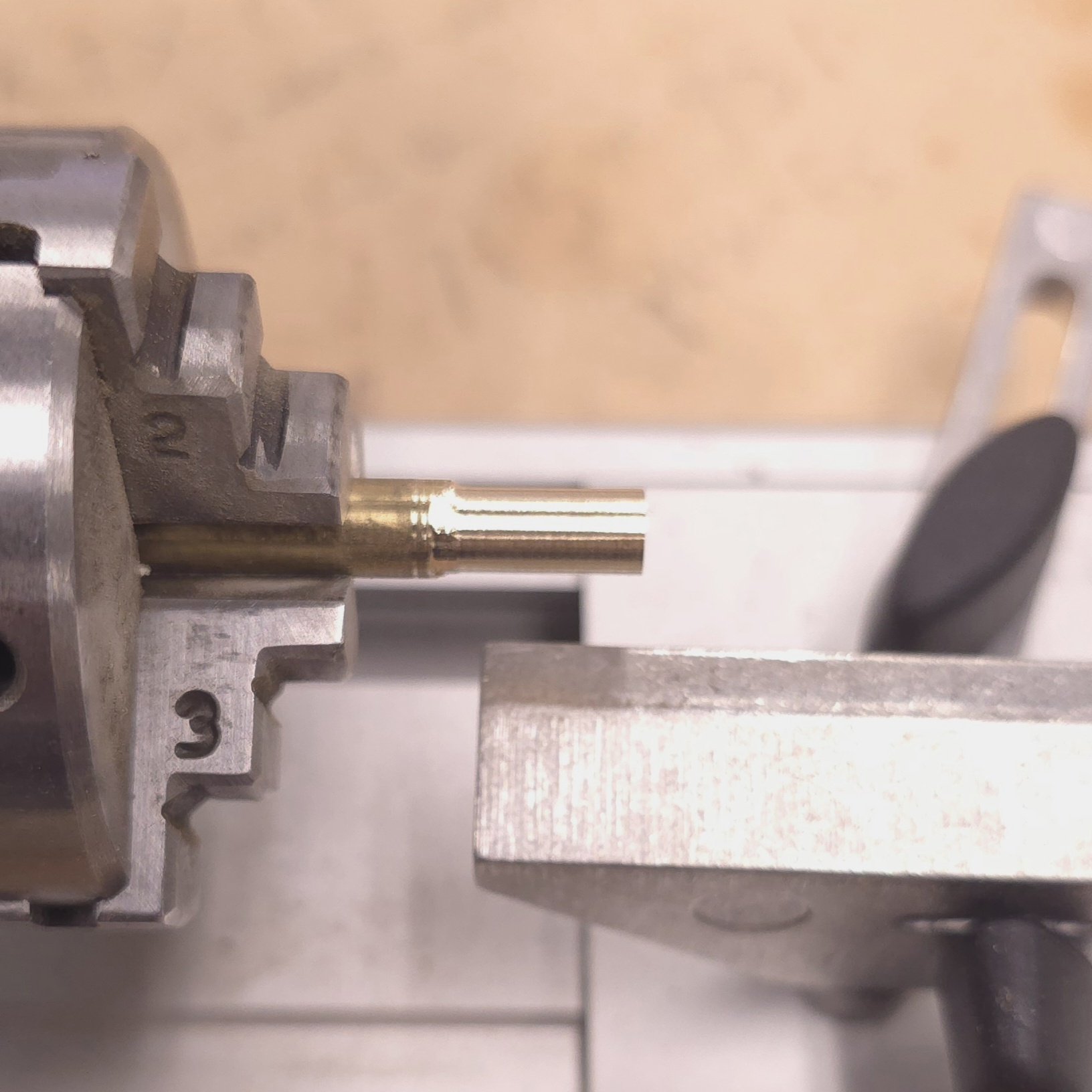

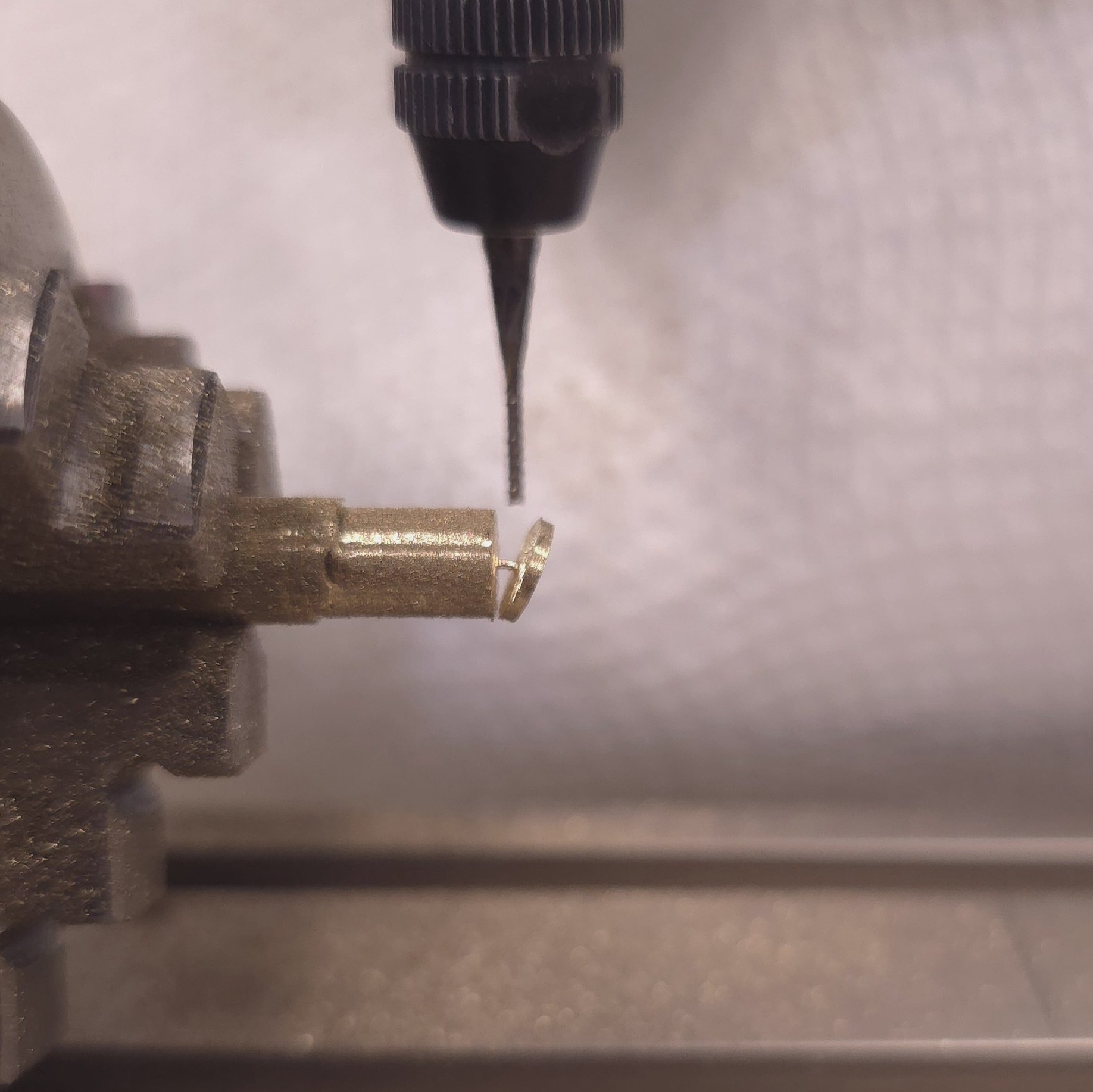

I just packed up my lathe, thinking I wouldn't need it for a while. Wrong! Ammo scuttles.
Fortunately, my dividing attachment was still mounted to the proxon mill. This was my starting point. I reloaded some quarter inch brass stock, cleaned off the end, then milled the diameter down to roughly 7/32" from 1/4". Using multiple passes right to left, I rotated the dividing attachment roughly 30° at a time, locking the chuck down after each rotation, while I milled half inch long segments.
Transfering the stock back to my lathe, I used files and sandpaper to smooth out the rough edges, checking the diameter frequently with my Vernier caliper to make sure I didn't stray from the 7/32" diameter.
Then back to the mill to slice off 1mm thick rounds.
I left roughly a .5 mm diameter axle, which was strong enough to keep the piece intact while milling, but malleable enough for me to break it off.
I left the little nibs alone, and plan to use these as locating pins when gluing the scuttles to the spar deck.

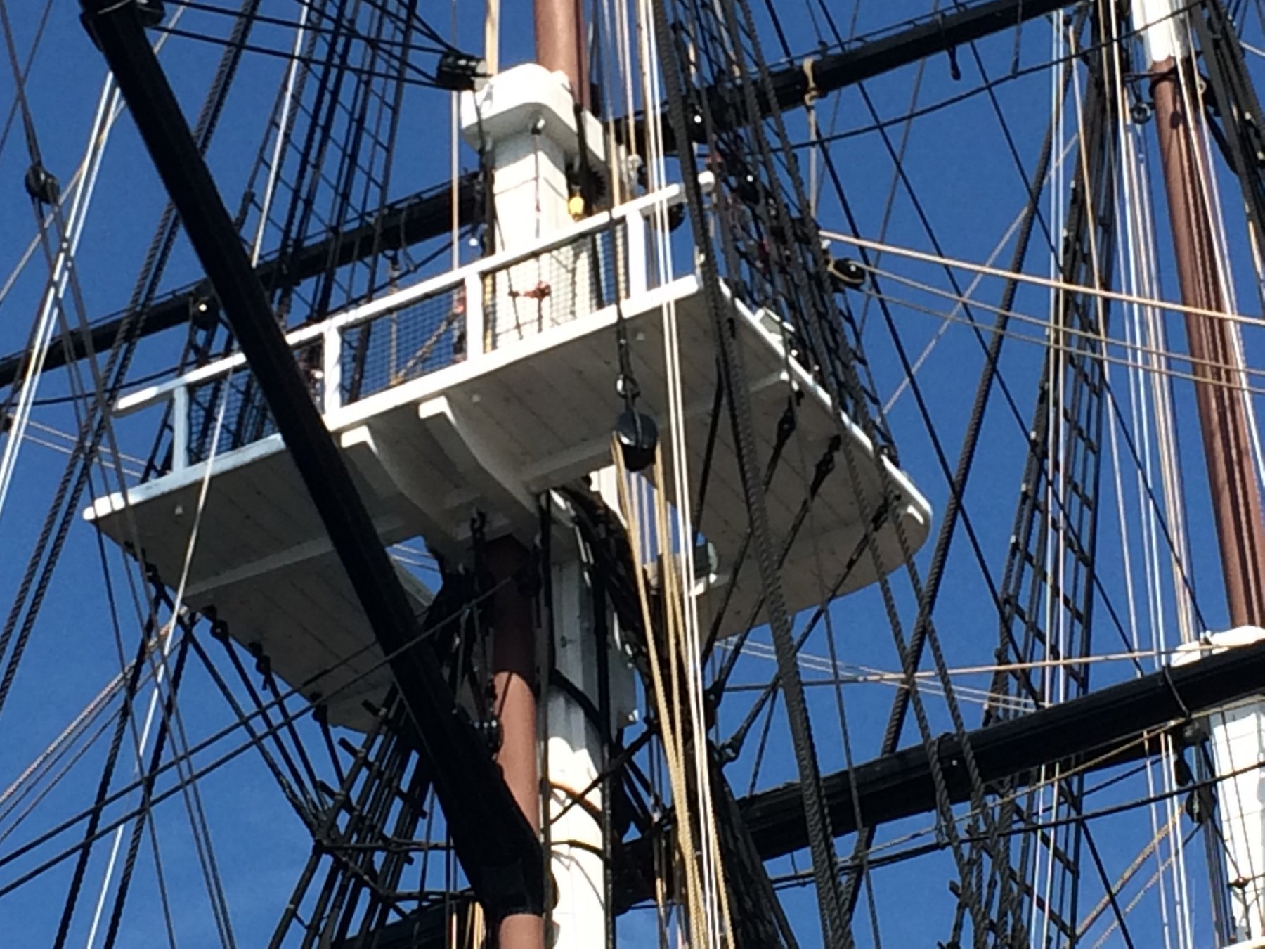

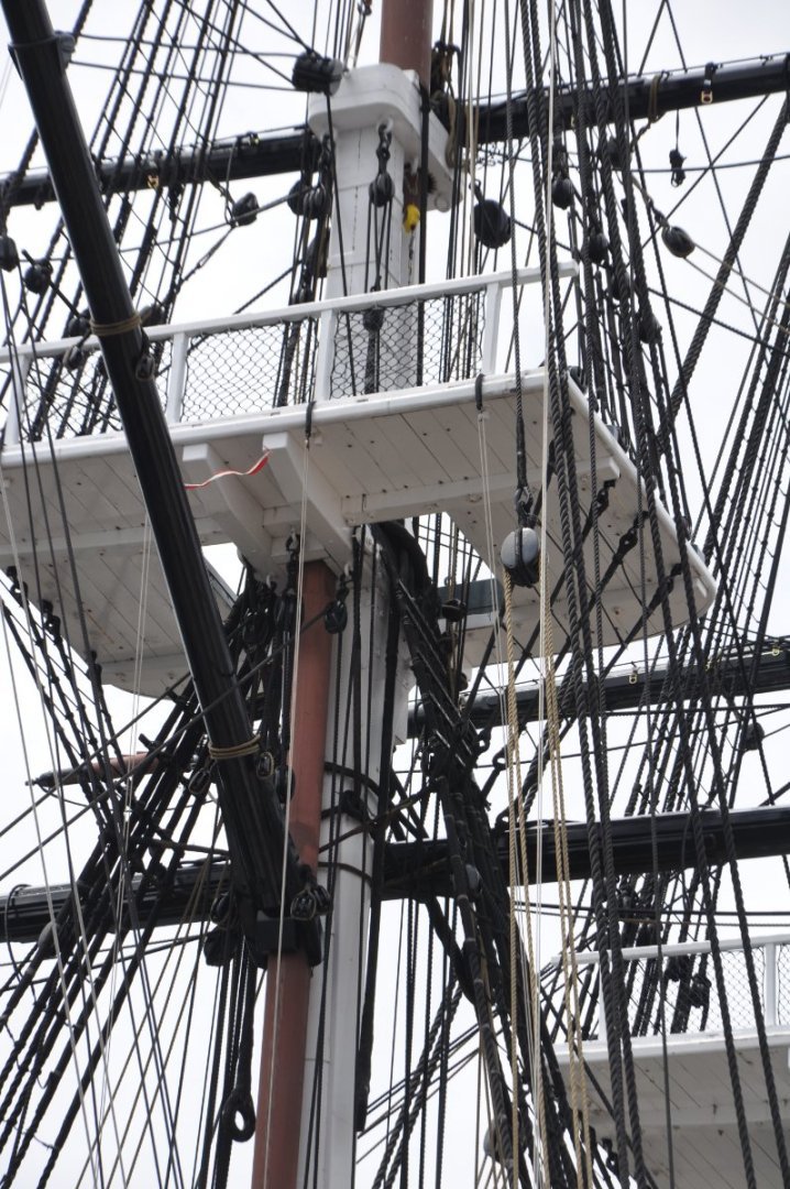

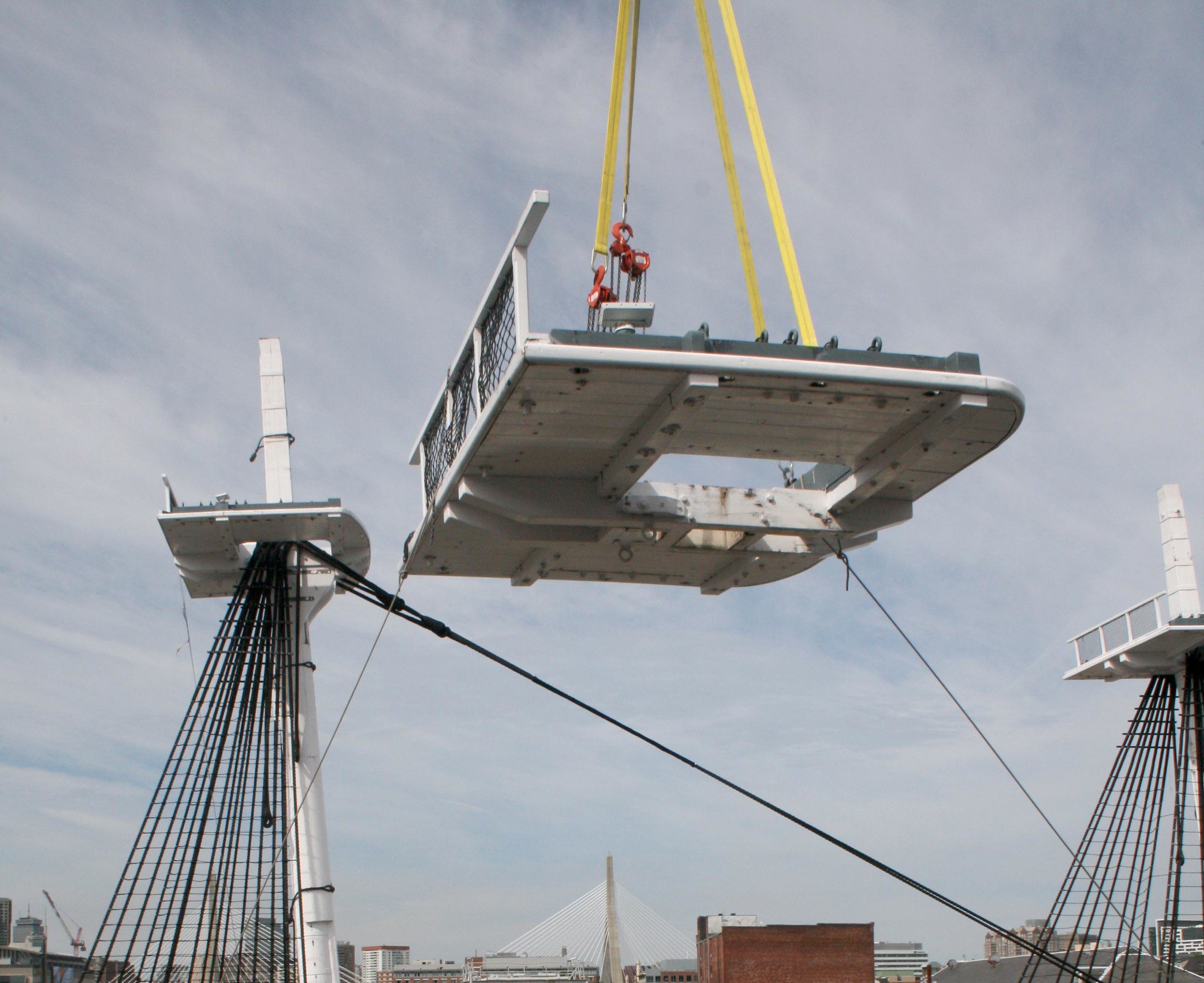

About the mizzen platform, I assume you mean the fighting top on the mizzen mast. If so, here are a few images of the platform where you can count the number of planks. I hope this helps.
Jon

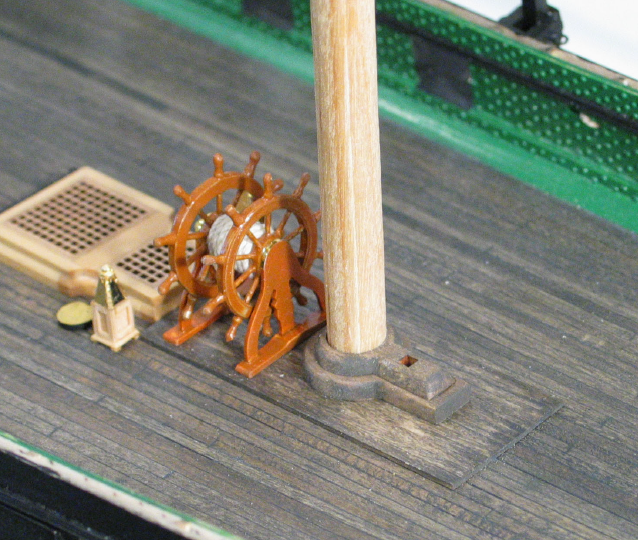

Ha!  Sorry, no.   I was referring to the extra layer of decking on the spar deck, at the mizzen mast, on top of which the wheel resides, at least according the the MS plans and the Bob Hunt Practicum.  I took my lead from XKen, and opted to omit this "feature".
I'm still a few weeks from starting the masts and "fighting tops" you so thoughtfully provided photos of.  First, I have to populate the spar deck with sundry furniture and fixtures, then on to the channels and chain plates.  (I can't wait to see how Mustafa tackles those).

Nice work, Peter!  I just picked up the Proxxon DB250 lathe, figuring I'd have plenty of opportunities to use it on my Constitution.  Love to see you using it on brass.  Thanks for sharing.

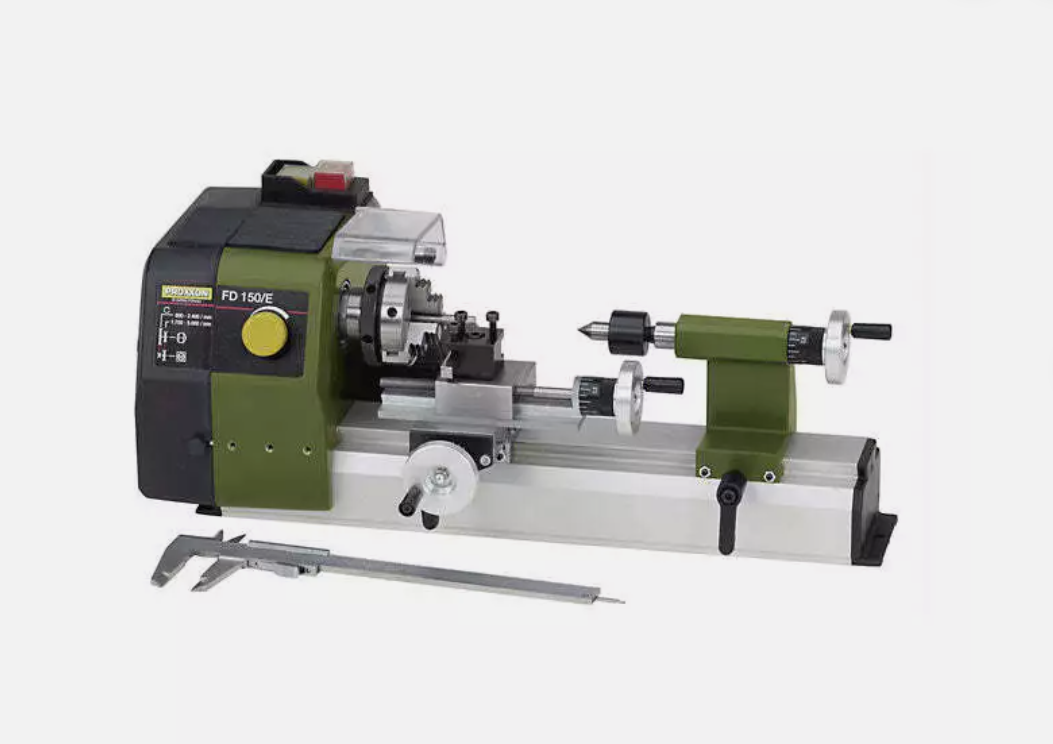

I think the lathe will really pay off when it comes time to taper the spars.  Be aware though that you'll probably want to also purchase chucks for the lathe, and these aren't cheap.  The DB 250 doesn't come with them.
In retrospect, I might have been better off spending just a few more dollars and gotten the FD 150 instead, which seems to include the chuck and has indexed feed controls, which would be better for working with metal rods.  FYI, the three jaw chuck that Proxxon sells for the lathe LOOKs to be the same as the one that's part of the dividing attachment for the mill.  It is not!  I thought I could spare myself the cost of the the second chuck, but noooooo.
Thanks for the info, Peter!  Yeah, once I get proficient with this DB250, I may decide to upgrade.

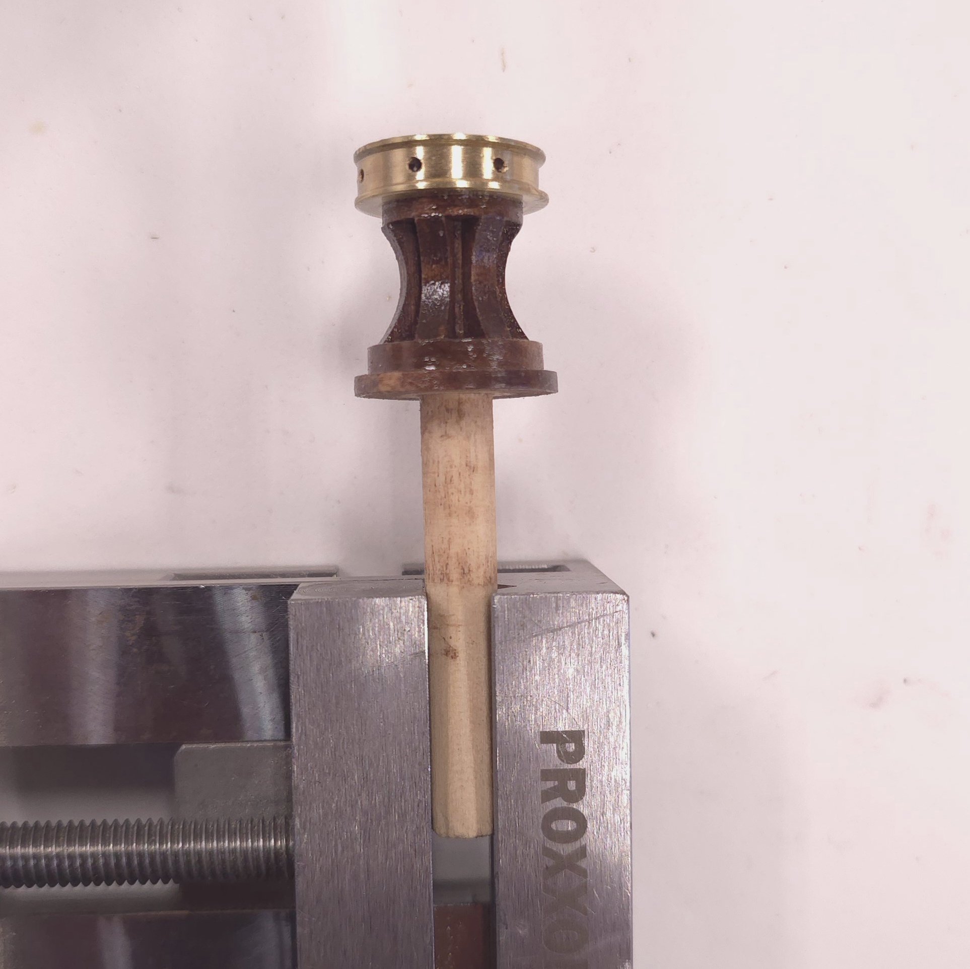

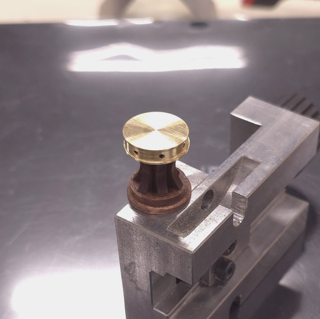

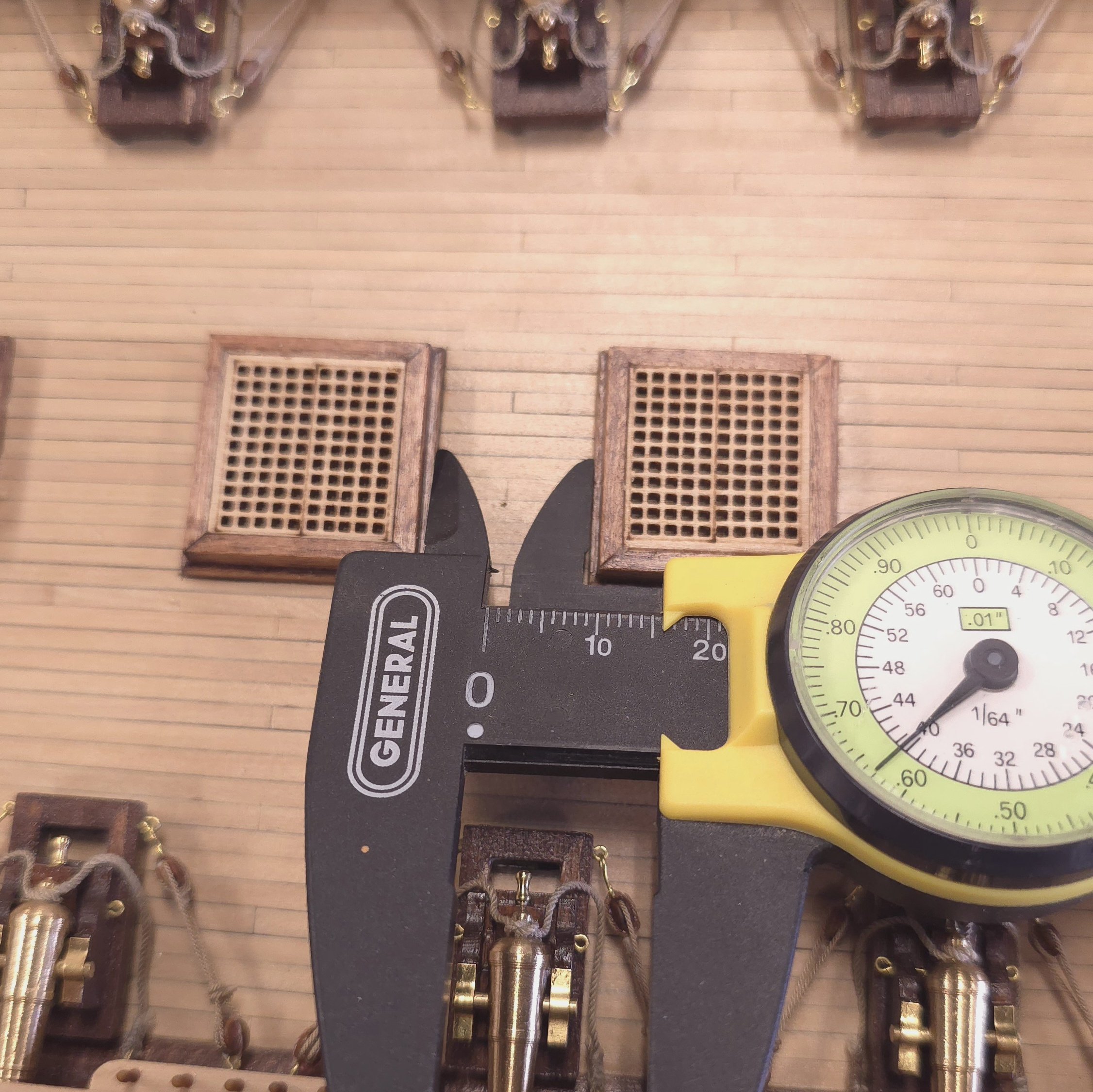

Oh snap!  How on Earth did I miscalculate the distance between the two harches when I installed them on the spar deck?  The gap between them is supposed to be 3/4 of an inch. I've got 5/8 tops.
I'm glad I didn't cut off the excess dowel on the capstan. I can still mount the assembly on the lathe and reduce the diameters of the disks that comprise the base.
Rather than unpack the lathe, yet again, I used the milling machine to reduce the diameters of the base - just enough to be able to squeeze the capstan into the gap.

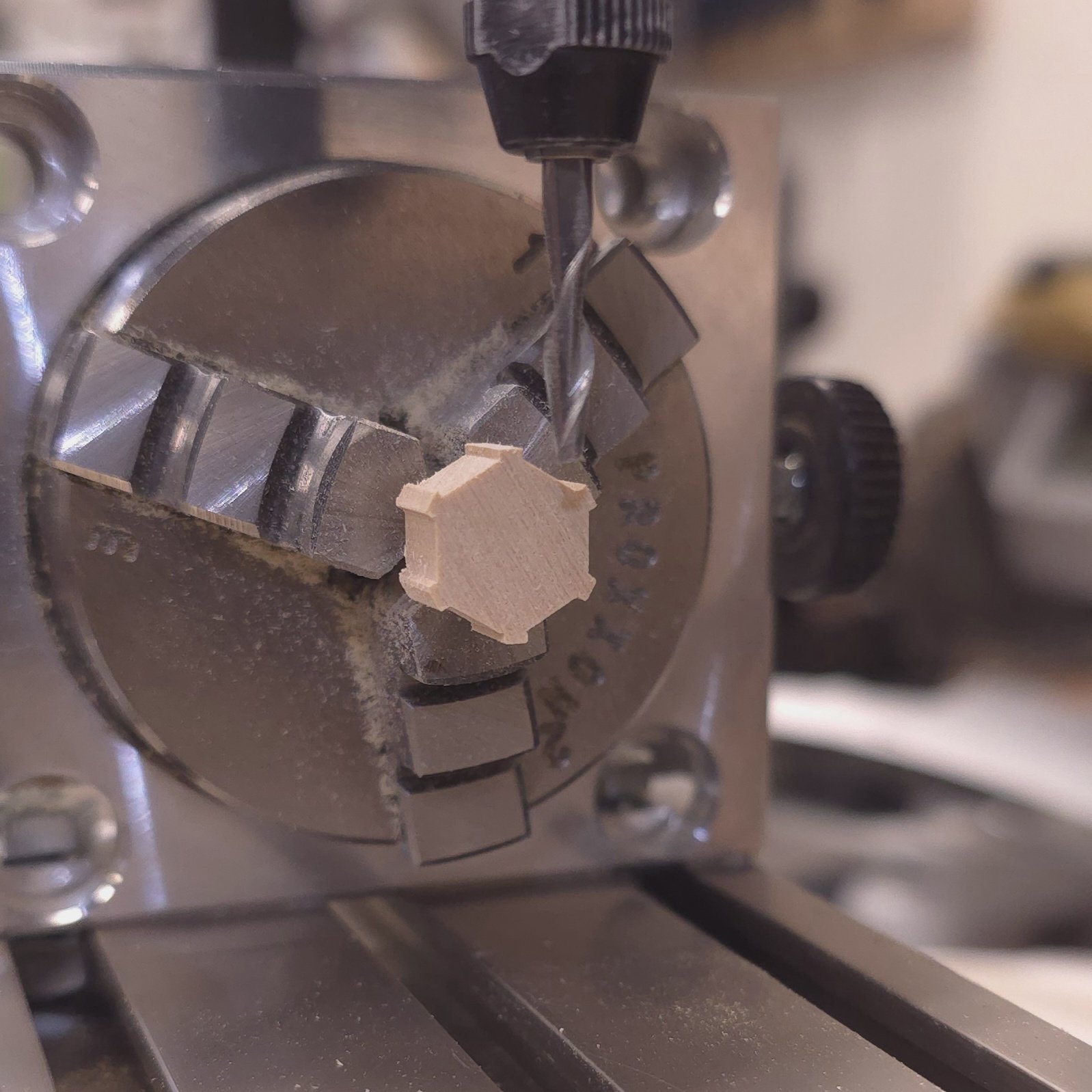

As long as I've had the milling machine going, I started work on the bottom half of the skylight. Gotta love the dividing attachment!
I started by centering a dowel into a half inch square chunk of quarter inch boxwood. Then I worked myself from the outside in, rotating the dividing attachment 60° at a time, until I arrived at a width of 7/16" across the flats.
Repositioning the attachment vertically, I carved out slots, flattened the points, then did some fine tuning to get 90-degree angles at the points.

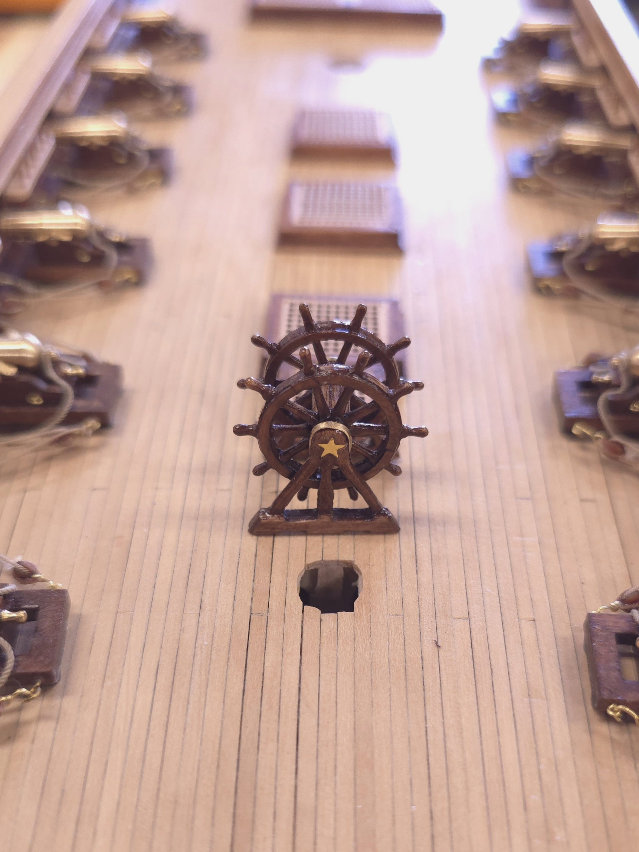

To all, I wanted to get that little detail on the steering wheel supports, but was dreading the thought of trying to hand paint or cut two stars out of brass foil. I found just the thing on eBay.
I wish I'd found this resource earlier, because two of the available sizes of white stars are a perfect match for the stars on the transom. I could have spared myself the fiddly work of fashioning those out of styrene.
Edited by Der Alte Rentner

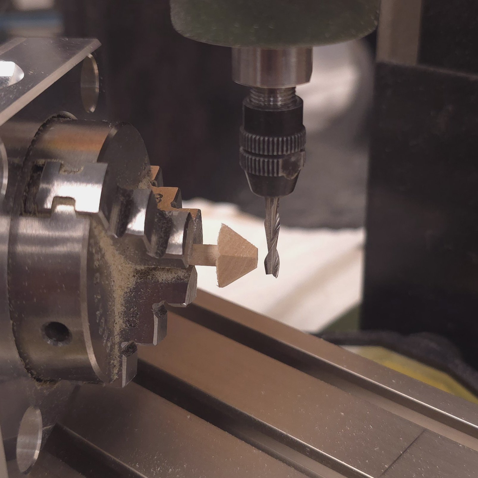

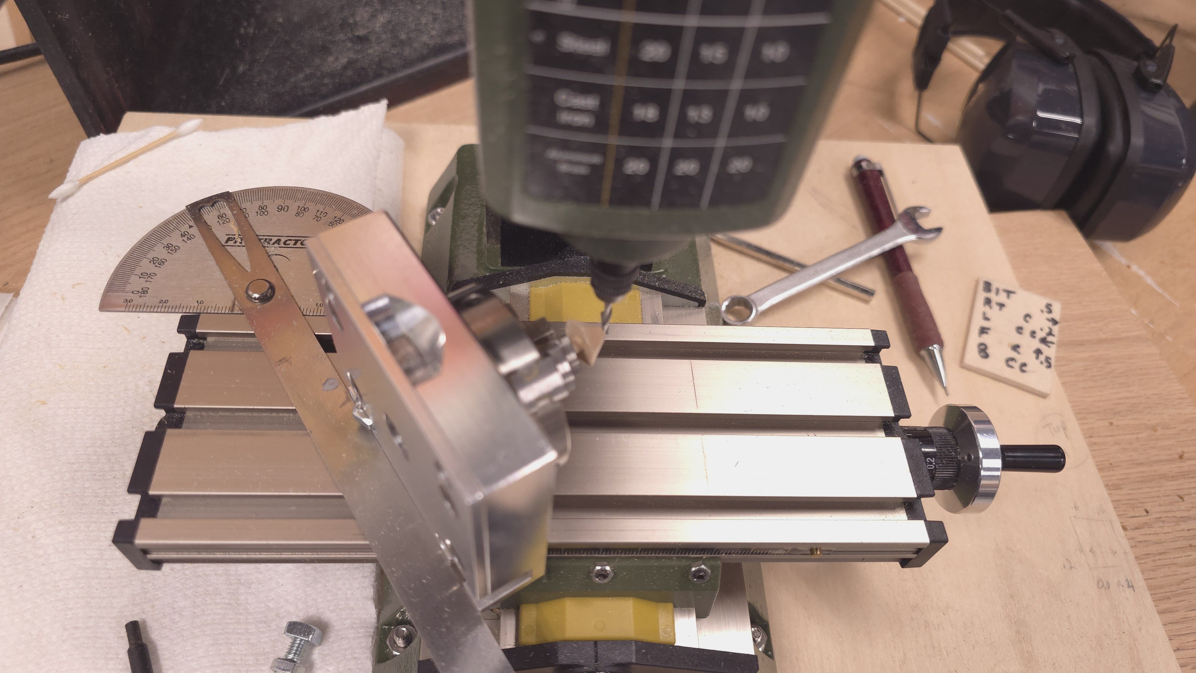

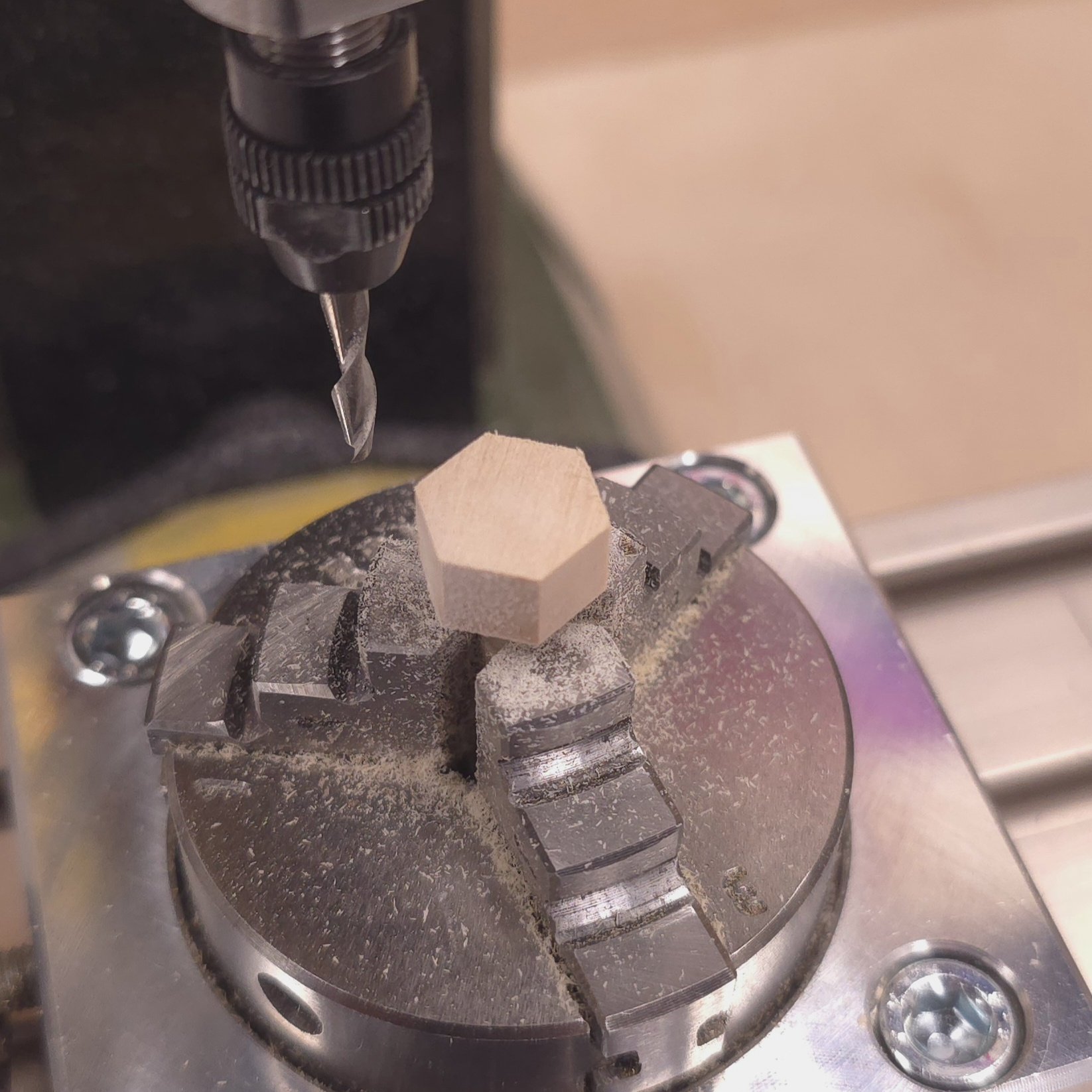

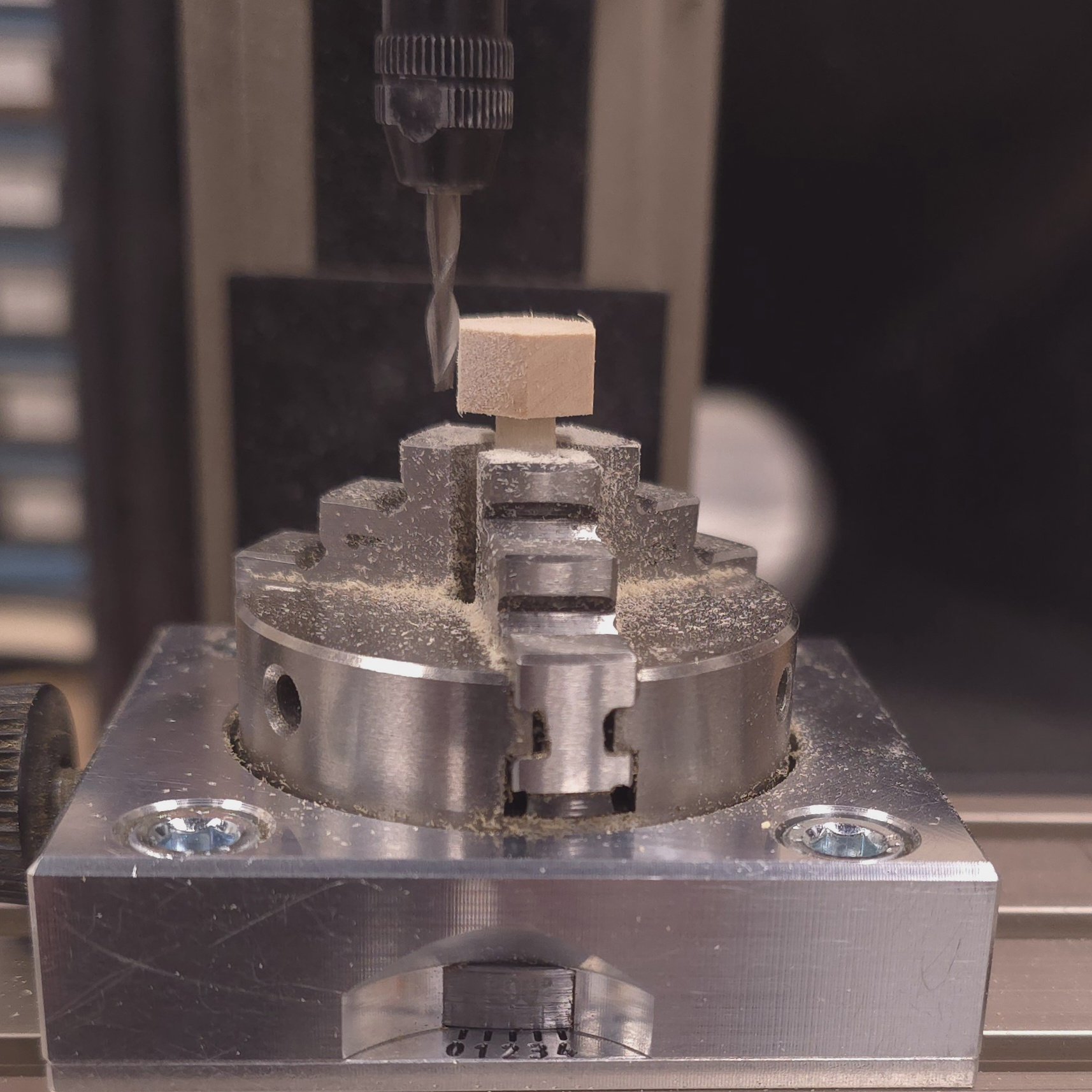

Getting closer..
Compound angles are proving to be a small challenge. Yet I managed to overcome the first obstacle.
If anybody is wondering, I started by gluing a 5/32" dowel into the center of a 1/4" tall by 1/2" square blank of boxwood, after first drilling a 5/32" hole into the center.  I then used the dividing attachment on the mill to turn that square into a disc.  So then I had a 1/4" tall cylinder of 1/2" diameter.   Consulting an AI agent (Grok) on the math, and learned that I needed to whittle off 57° to get the correctly shaped facets.
Now I have to figure out how to angle the dividing attachment 33° with a wedge, and fasten it securely to the mill's table, so I can mill down into the facet to rough out the space for the window panes.  Plan B?  Paint black trapezoids instead.
Note: This milling was dicey work.  I had to make many shallow passes coming down from the top to avoid vibration that caused the bit to gouge the facet's surface.  In retrospect, had I figured out how to attach the divider at 33°, coming straight down with the bit would have been a better proposition.
