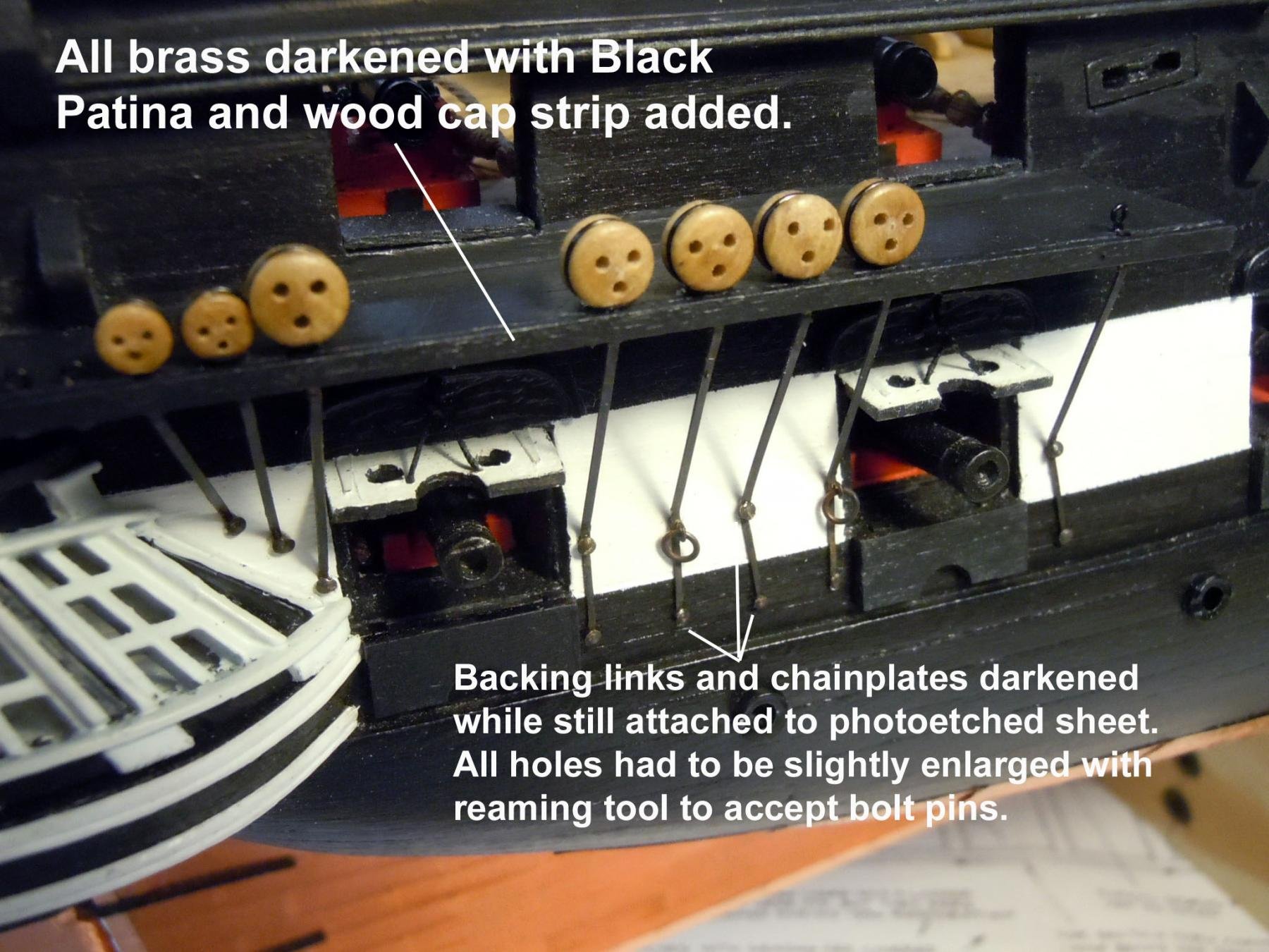

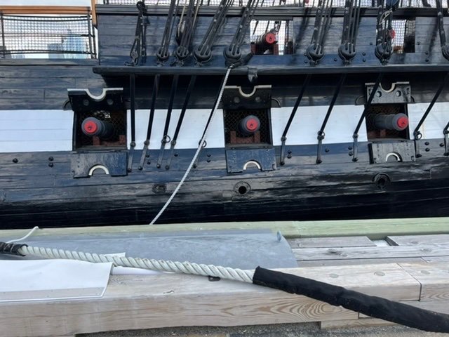

XKen didn't explain how, or even IF, he attached the deadeyes to the chain plate, so I had to look elsewhere for ideas.  Mustafa's approach certainly looks great and will make adjusting the length of the chain plates easy.  KMart and Tom (used to sail) used a different technique, which may (or may not?) be easier to do.  I'll have to do some experimentation to see which works best for me.
For what it's worth, the closeups provided by Jon suggest that I should double wrap a smaller diameter wire around the deadeye instead of using a single thick rod as all three of the above have done.  How to do that and fashion an integrated pin at the bottom of the strop?  Back to the bicycle!
Quote
From what I surmised from the images Ken provided, he did not attached the deadeyes to the chain plates. He twisted the wires stropping the deadeyes creating a tail which was then inserted into the channel. The chain plates were laid on top of the tails and extended to the hull. The "joint" was eventually covered over by the channel cap hiding the false connection. A little bit of modeler's sleight of hand.

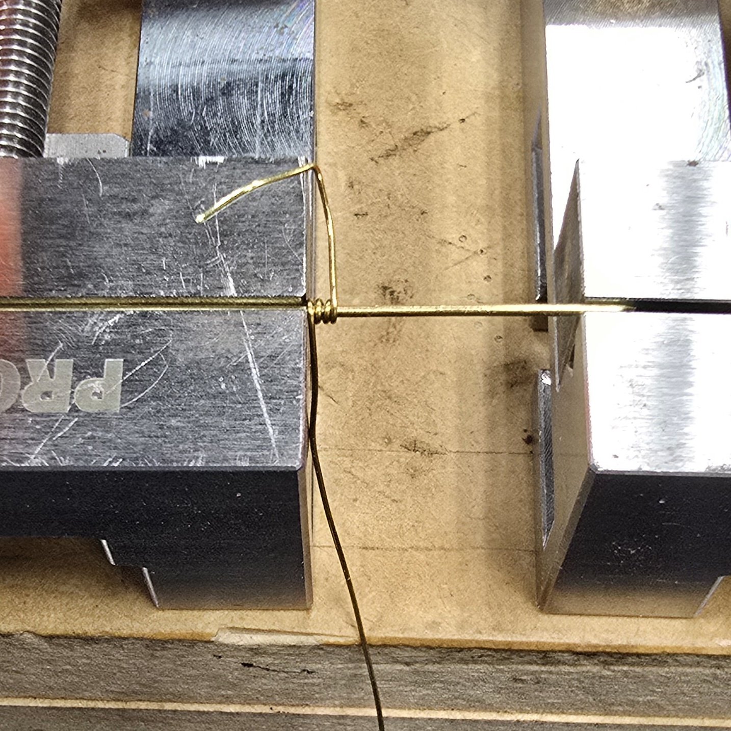

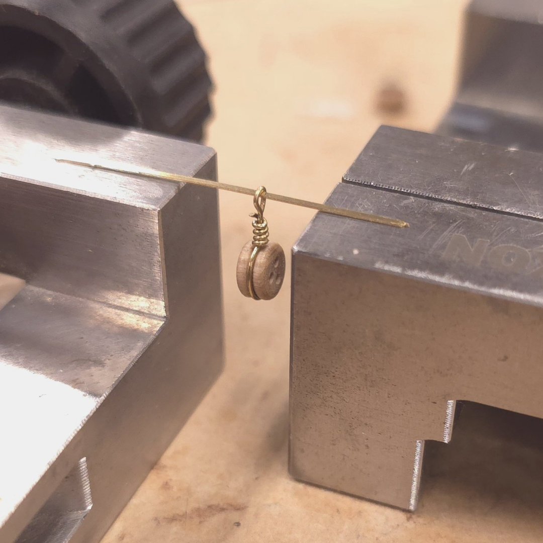

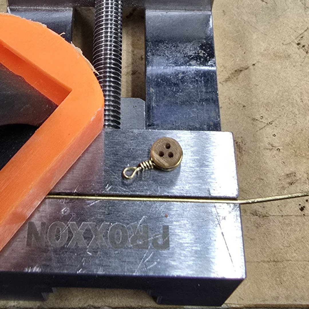

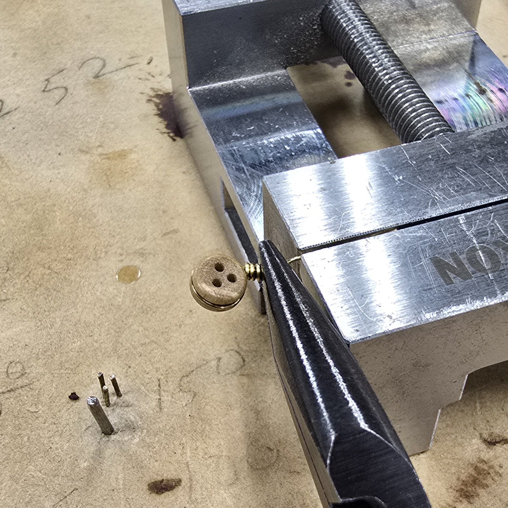

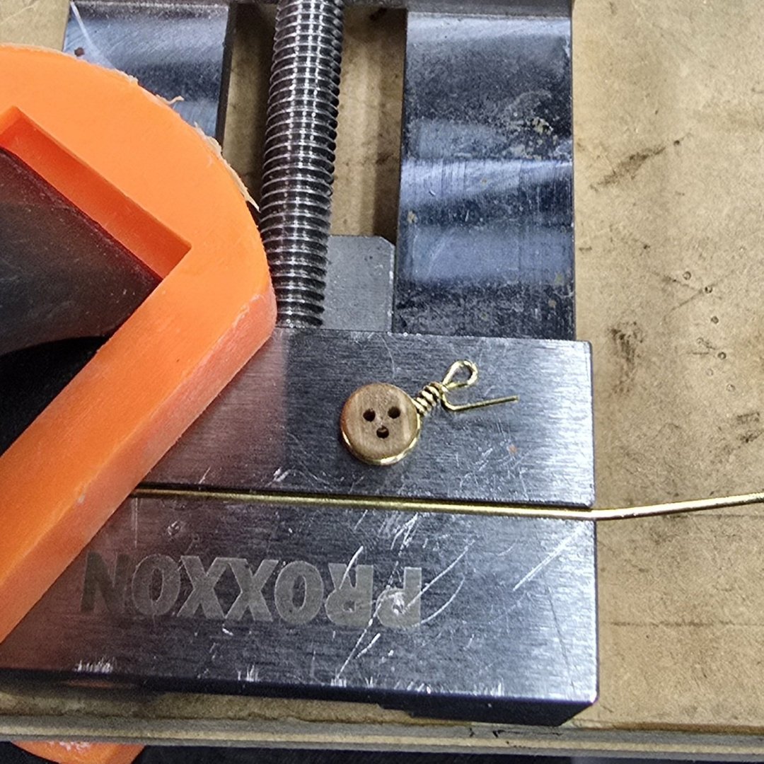

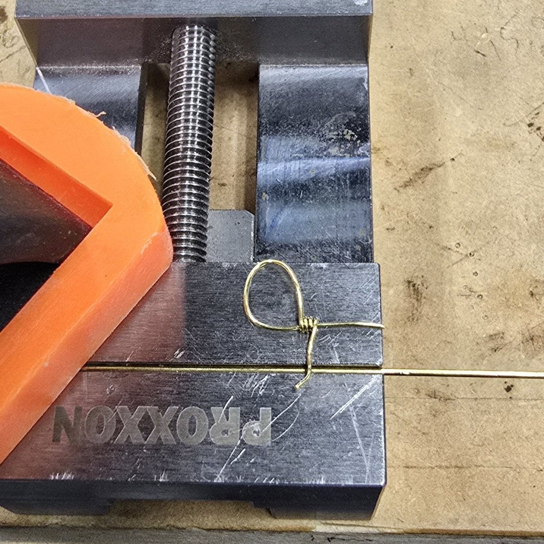

So, I've been experimenting with methods of stropping the deadeye with brass wire, and ending up with a loop for the chainplate to pass through later.  I won't show you the failed or less than desirable results, but I think I'm on to something:
The diameter of the brass rod clamped between the vices is .8 mm.  The diameter of the wire that I'm wrapping around the rod is .44 mm.
I think if I had some .6mm rod on hand, I'd have even better results.  I should be receiving some point .7 mm rod tomorrow. So, I won't be doing much more than this trial run today.
Wrap brass wire tightly around a secured rod of diameter slightly larger than the wire.
Bend the wire into a loop and pass the end through the coil.
Snug everything up with pliers
Form a tighter Loop at the other end.
Clean things up with snippers and needle nose pliers
One down.
Before anyone asks, I tried simply twisting the wire like most others have done, but doing so weakened the thin brass which resulted in the occasional snap while forming that final loop for the chain plate.
Frankly, I think this looks better too.

A single wire around the the deadeye should work perfectly fine. No one will aware what is stropping the deadeye or notice, much less know, that it is not a double wire like the real ship. There will be a whole more interesting things to look at on the model when you are done. You are making a model, not a miniature replica. You've got s good design for your deadeye to strap connection. They will be very pretty when done.

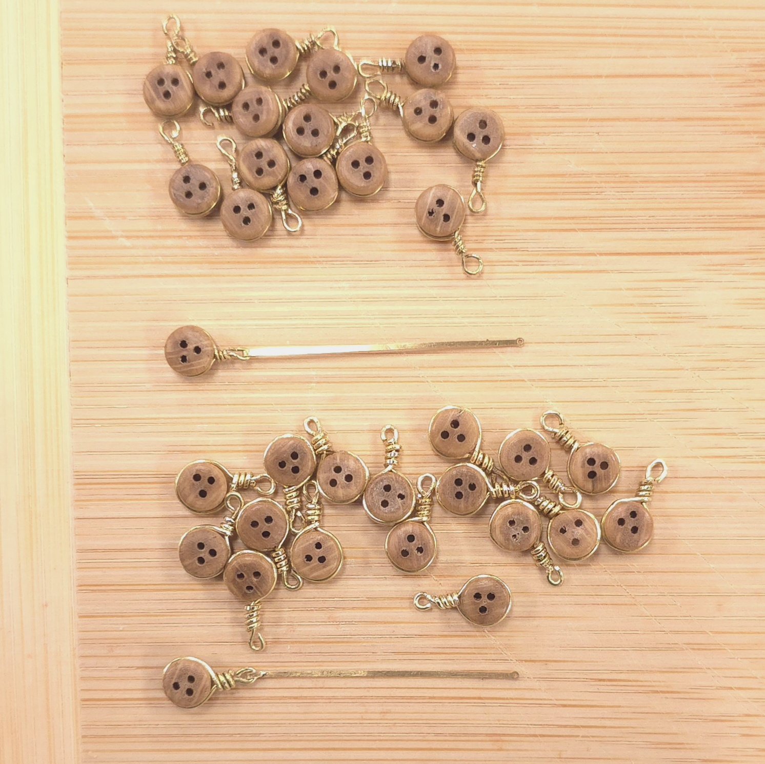

On my first go-around I wrapped .45 mm wire around a .8 mm rod.
I purchased some .6 mm rod, that I intended to swap the .8 mm rod out with.
Forgetting my intention, I wrapped the .6 mm rod around the .8 mm rod and liked the result so well that I made 18 of the 5/32" dead eyes for use on the channels and chain plates for the main mast.
Since I already had 10 of the 5/32" dead eyes from the first attempt, I wanted to finish that batch using the same .45mm wire.  To reduce the amount of tweaking after the initial wrap, I swapped the .6 mm rod for the .8 mm rod and wrapped the .45mm wire around that.  I now have 16 of those, which I will use for the foremast.
My concern in using the .45 mm wire was that the loop, which would attach to the chain plate, wouldn't hold up under tension during rigging. After some experimenting, I realized this was not really an issue.
Bottom line: it's easiest to work the .45 mm wire then the .6 mm rod.
For the remaining smaller diameter deadeyes, that's the option I will go with.
I don't think the casual observer will notice a difference.

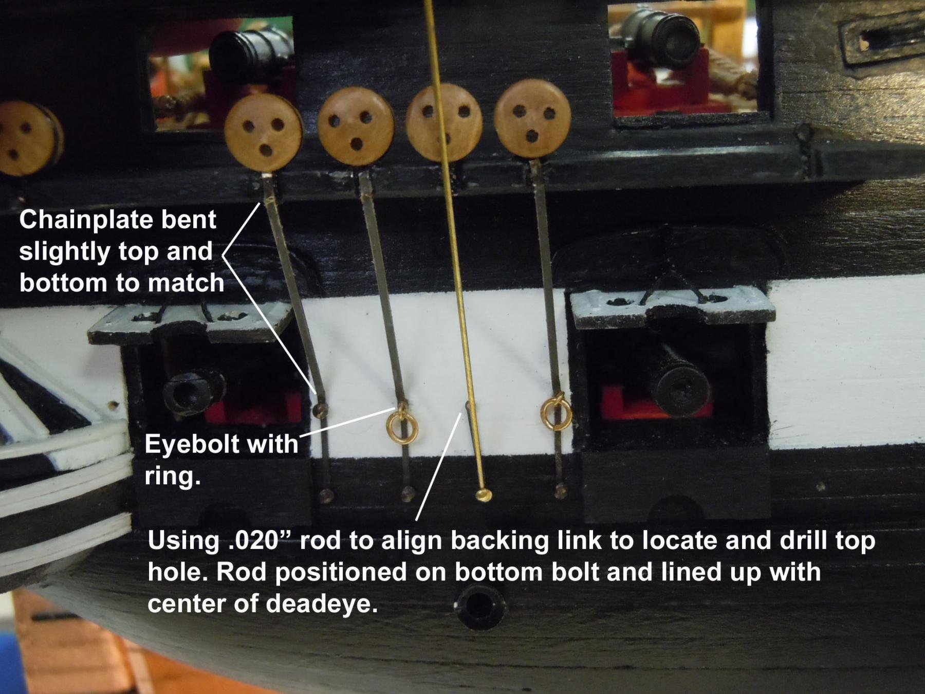

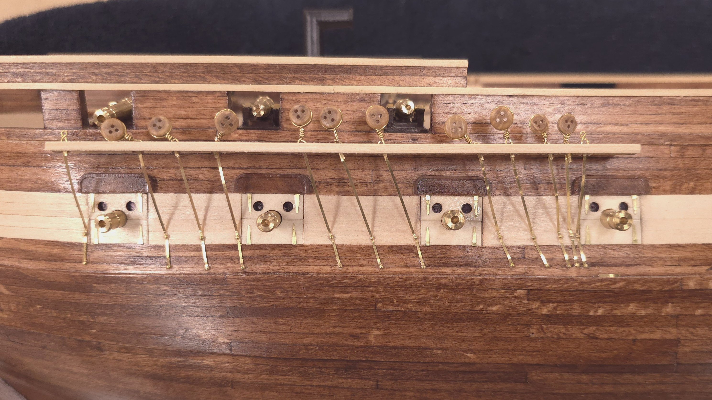

That had occurred to me.  The channels are marked to indicate fore and aft, top and bottom.  What I am thinking about is whether to try to angle the slots for the chainplates in the channels.  I could just fudge it by making the slots wide enough that there's plenty of wiggle room to maneuver.  If I make them as narrow as Hunt did, they're barely wider than the kit provided channels - no fudge factor there..  And my perfectionist side is nagging at me about the length between the deadeye and the loop.  Remake them with two fewer twists?  Back off bro!  😁
For the most part, the chainplates are aligned and angled as determined by their attached stays. This means they are not necessarily perpendicular to the chanels. Each angled chainplate has a slightly different angle from its neighbor. IMHO, "fudging" the slots to allow angling of the deadeyes should not be noticeable provided any slot widening is done on the bottom side of the channel where it can't be seen. Unless you are trying to be super realistic, which you are not, the slight inconsistencies created by the model maker with the real world are acceptable in a model.
Jon
Edited by JSGerson
very good point.  I'll see what I can do about that.
..and, the photo above clearly shows that the chainplates attach to the deadeyes above the channel.  I may have to both angle and widen the slots so the attachment point is in the channel, assuming I don't redo the stropping - eliminate a couple of wraps and shortening the distance between strop and chainplate.
I angled them with a small file. You either have to make the slots angled or too wide. There's no other way.

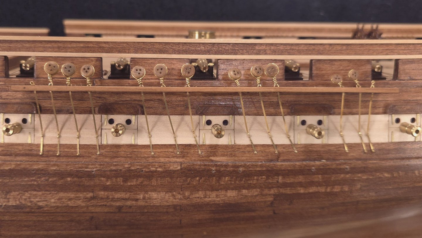

It's been a while since I've posted. I feel like I've been busy, but I don't have much to show by way of results.
The fore and main channels have been fabricated, and installed.
The hardest part of this was not breaking belaying pins, rails or disturbing the carronades while holding the channels in place long enough for the 5-minute epoxy to dry. Try as I might, I could not find a way to clamp these in place with the tools I have at hand. So my hands were the clamps.
A close second in terms of difficulty was marking the holes for the pins correctly, so that the channels rode evenly below the outer planksheer.

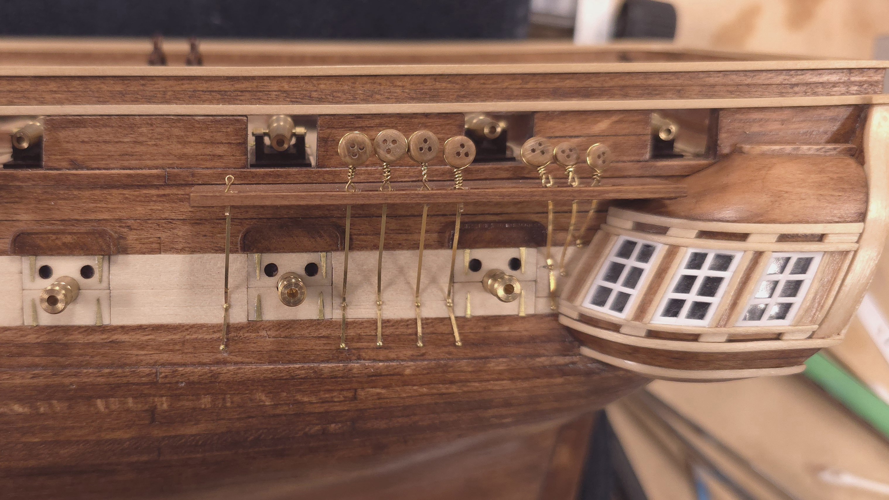

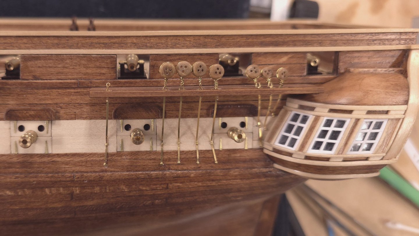

Port side main channel chain plates, deadeyes, and eye bolts installed...
Mistakes were made but I managed to recover from them. The lessons learned should result in smoother sailing for the remaining five channels.

Nice work, Peter!  I was trying to analyze that first picture and what you had done, and finally realized that was probably an edited picture from earlier in your build that you used to draw lines and circles on for placement purposes, and not an actual picture of your ship. 🤷‍♂️🫢DOH!  Channels and chain plates look great, sir!
Gregg
Gregg

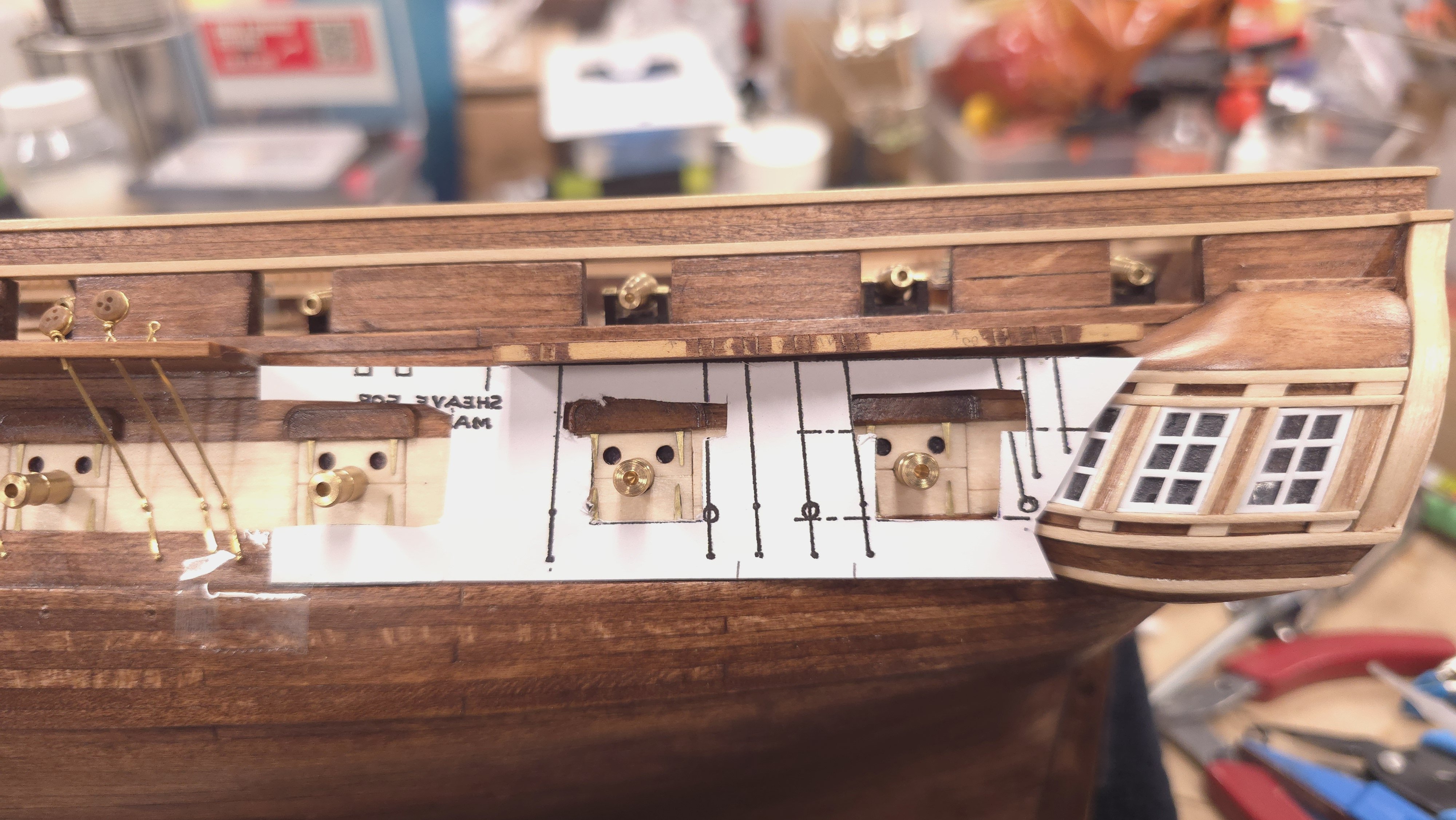

That first picture is actually of my ship. What I did was cut a copy of the plans and taped it to the hull so I knew where to place the holes for the chain plates.
Sounds like a great plan, yes?
Not so much...  here's the picture of the port side stern chain plate pattern.
If a picture is worth a thousand words, I can think of just two that describe how I feel about this
Here's a third, more civilized, word
Sigh
Ahhh, ok!  I can see the cutout now!  Sounds like a viable plan, Peter!  I'd have done something similar. 👍
Gregg

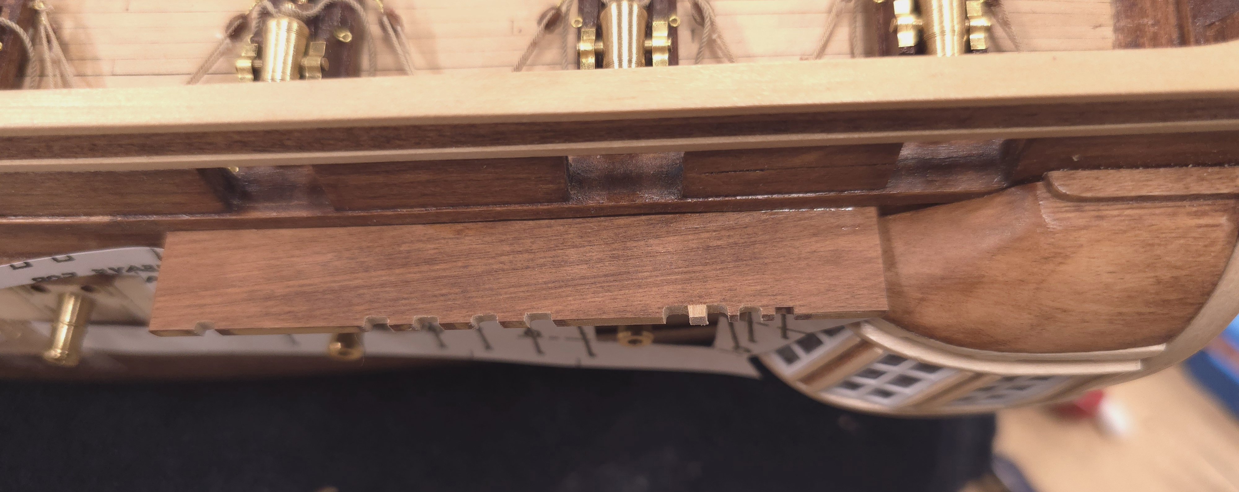

Where you need to be careful is when you construct the galleries. It turns out that mine are a little too long from stern to bow. As a consequence of my not catching that much earlier, I have to move one of the cutouts for the chain plate/deadeye combos forward.
Of course, in attempting to simply carve out an extra slot, I broke part of the channel. You can see the repair clearly in this photo. I need to get back home to deal with some maintenance people, so further repairs here are postponed, at least until tomorrow.
Again, my advice to you, be very careful where the forward end of your galleries meet the hull when you construct them.

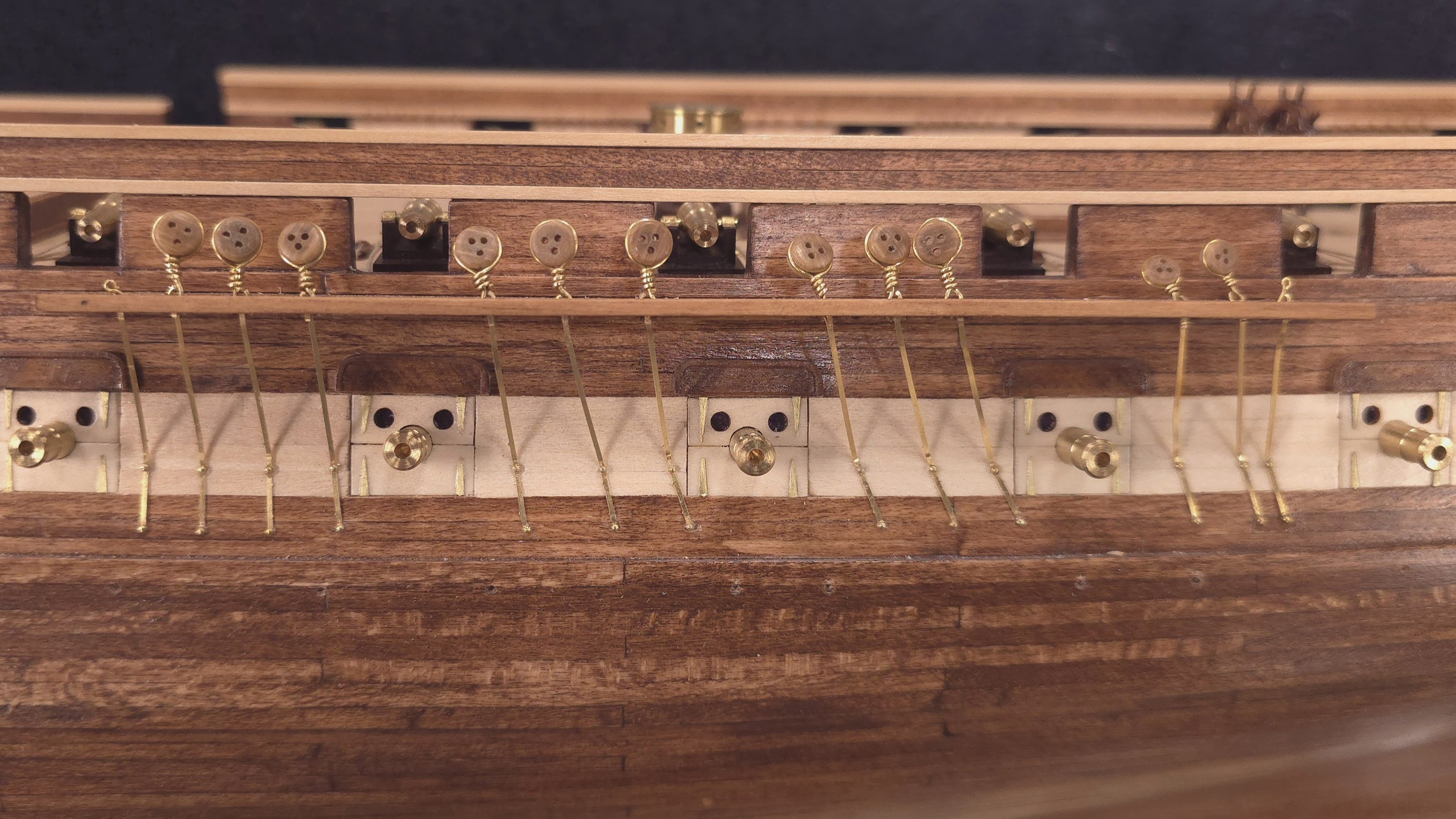

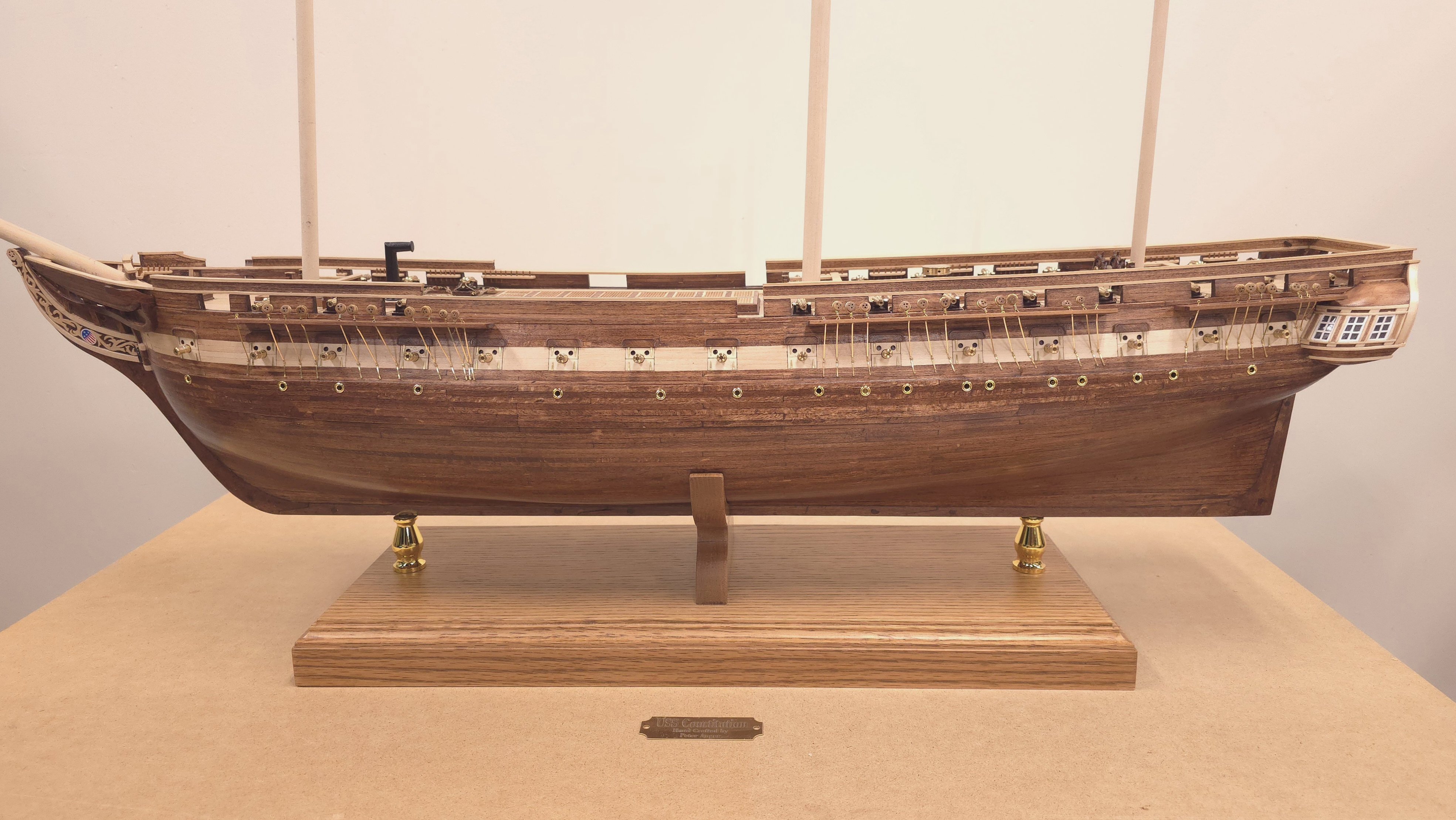

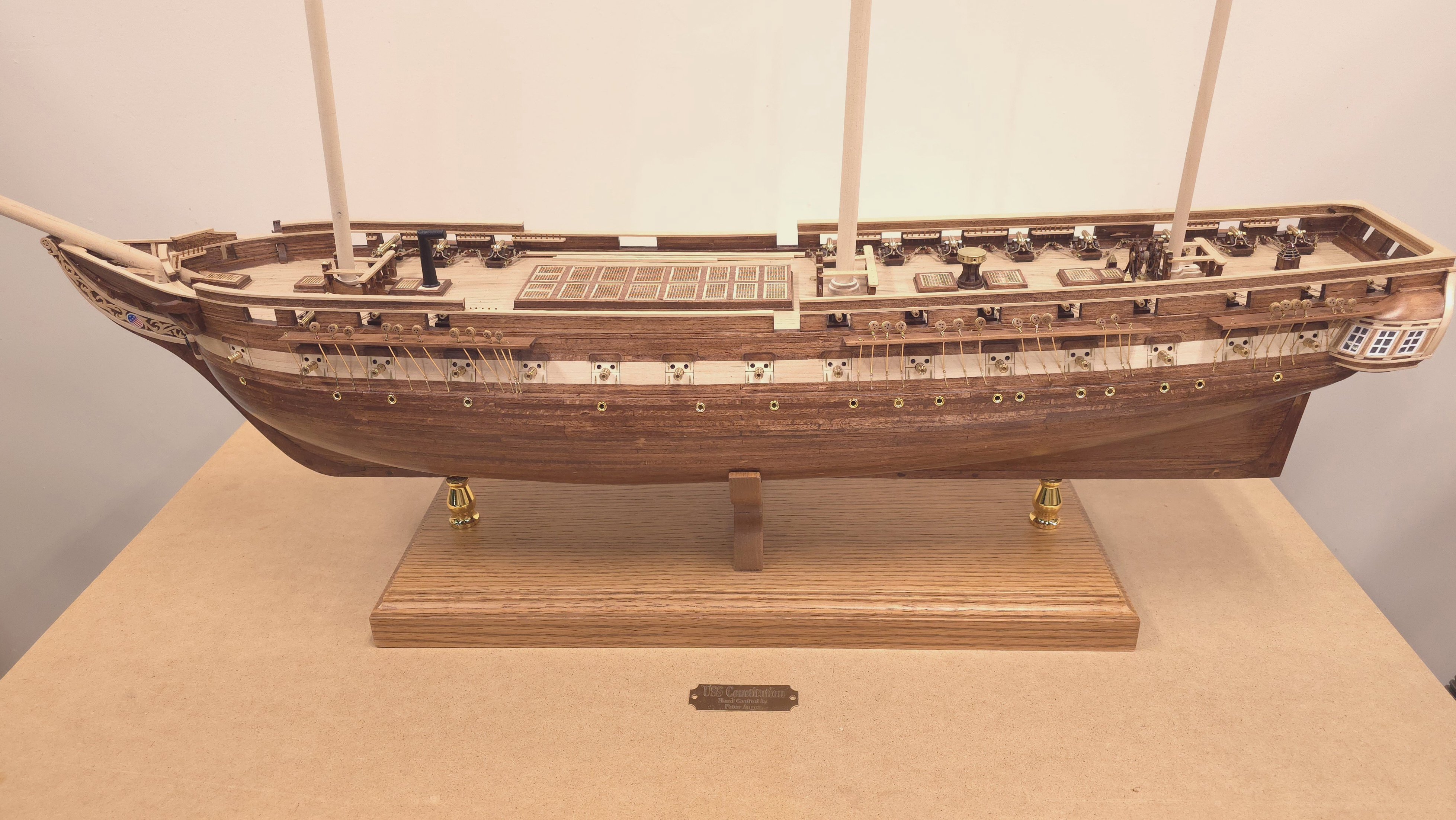

Slow going here, but save for stain on the fore channel cap, port side channels and chain plates done.
Pro tip for other builders, do not glue in any belaying pins. You're going to break a number of them when you're gluing in the caps and messing around with the dead eyes and chain plates.
Also, be aware that mizzen channel sports the two smaller deadeyes (5/32" and 1/8" vs 3/16" and 5/32" on main and fore mast channels).  I was wondering why I was running low on the 3/16" deadeyes, and noticed only too late, that I screwed up on the mizzen channel.  My mistake was that I referenced the kit's plans instead of the Hunt practicum specifics in chapter 10.2 - pages 28 and 29.  I guess too many days had elapsed between construction of the dead eyes and that of the chain plates and channels.  Oh well.  (How many times have I said that over the course of this build? 🤔)
I'm going to live with the difference rather than try to pry off the mizzen cap.  It would appear that I will be making more dead eyes in the immediate future.
