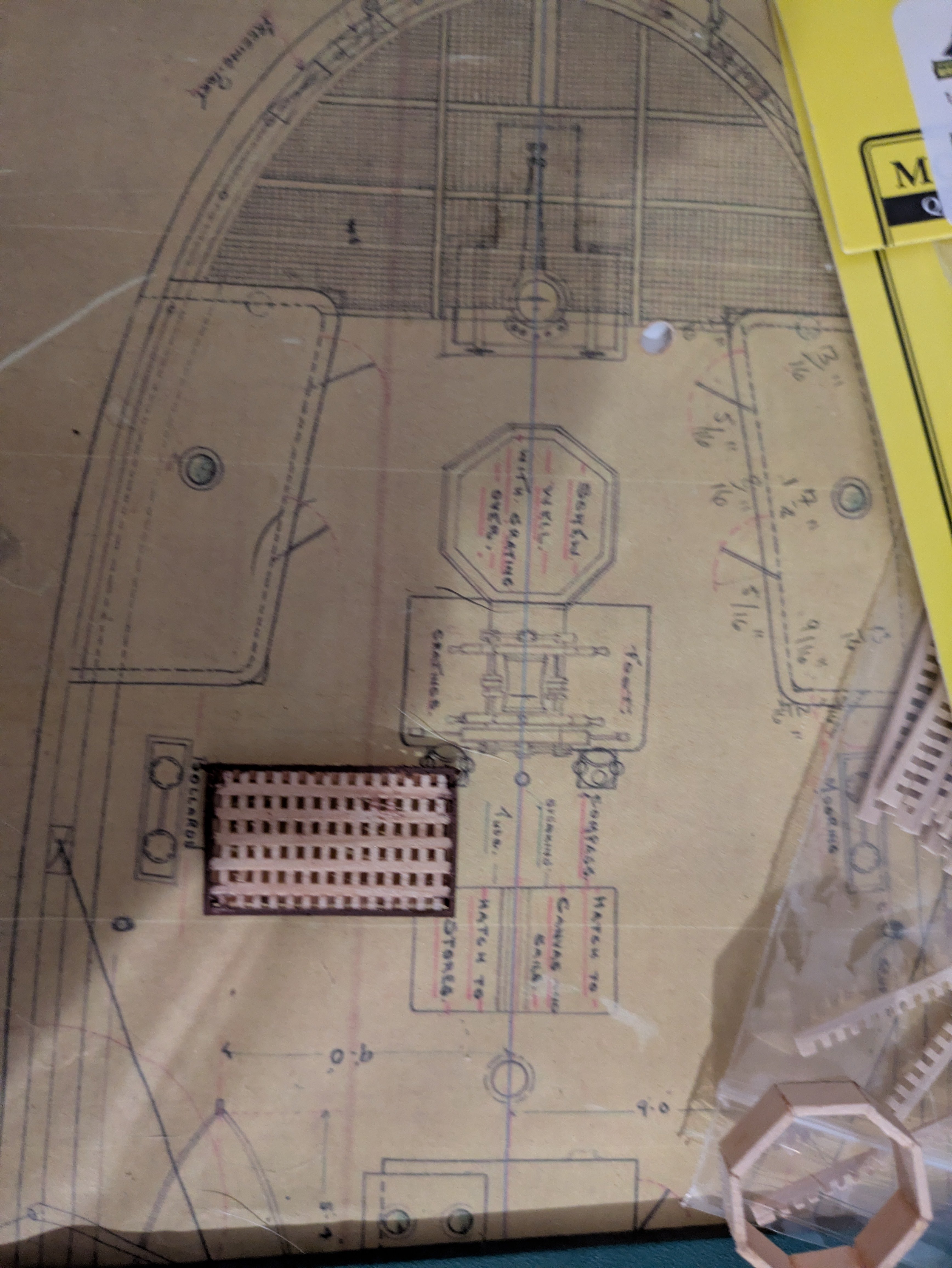

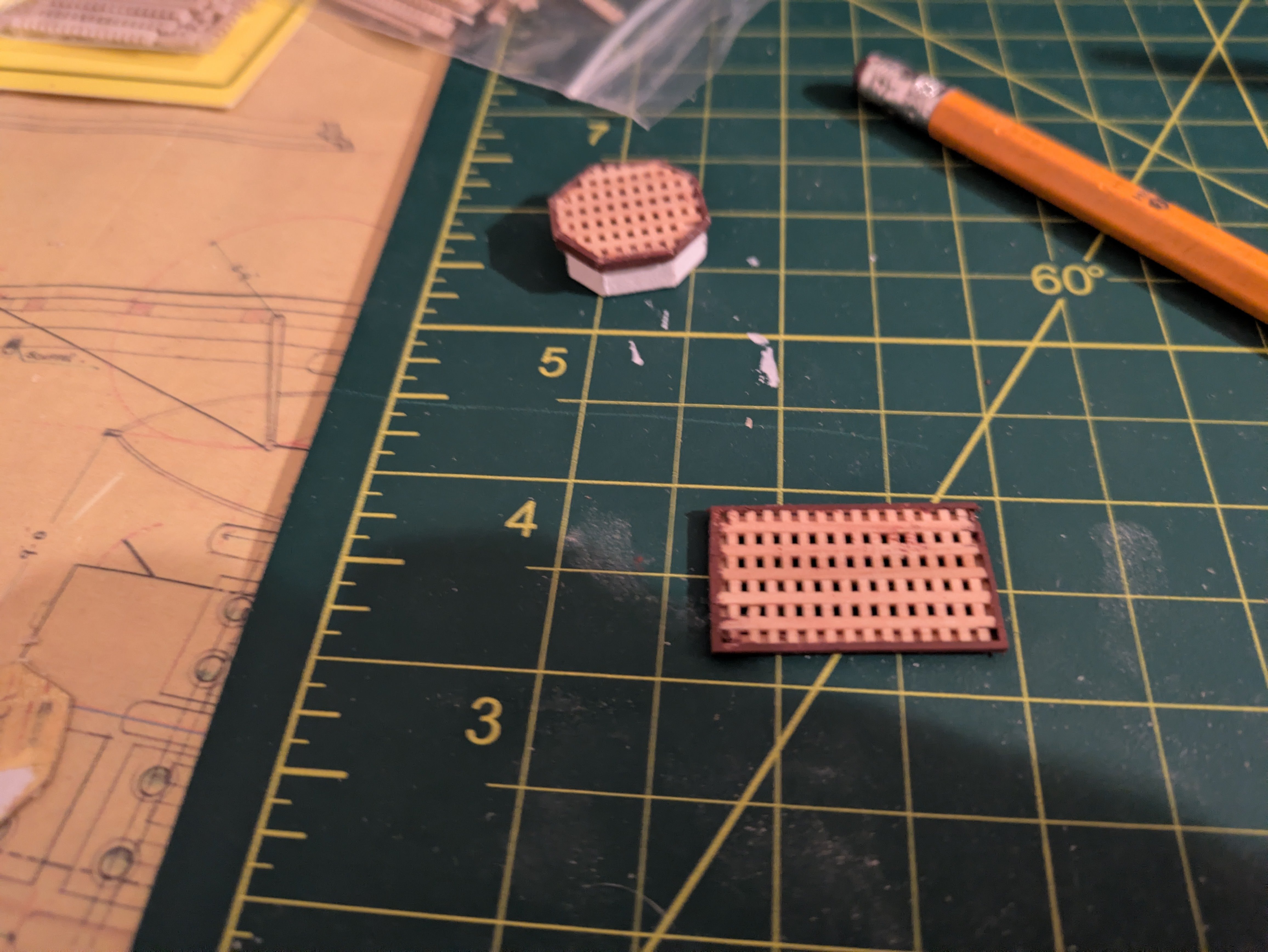

Last update on the Discovery for 2025 as we are headed back to DC for the last 2 weeks of the year tomorrow (a little early, as one of our dogs is getting surgery Thursday morning to remove a mast cell tumor). Before turning to the monkey poop, I decided to do some of the deck furniture in the after part of the ship. The two items I worked on were the gratings that the ship's wheel is mounted on, and the well that allowed access to the propeller. The latter is an interesting feature, which in theory meant that they could pull the prop out of the way to prevent damage, and I suppose repair/replace it if damaged. I tried many different ways to make scratch gratings. I can see how to do so, but don't have the tools, and in the end, just broke down and bought the grating strips from ModelExpo. The wheel gratings are just a rectangle sitting on a very thin platform around the edges. It's shown in the photo below.

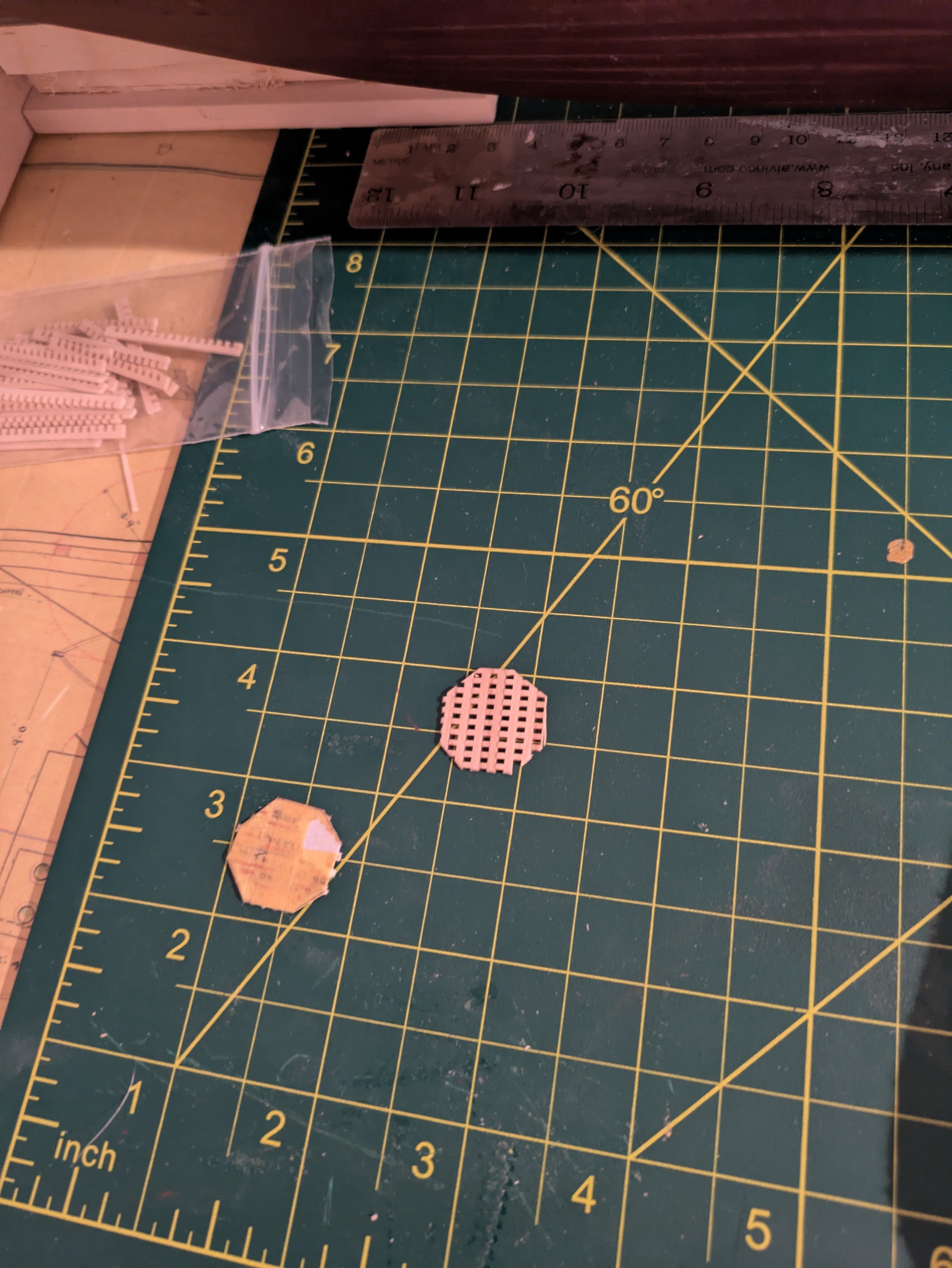

The well is more complicated. If you look closely at the plans, you will see that it is an irregular octagon with 5 identical sides and one shorter and two longer sides. The shortest side is the aftmost face of the octagon. Ultimately, I built out a rectangular grating using the ModelExpo strips, cut out the octagon, centering it as best I could and stained it as per below:
I then took a 1/32" by 3/64" square piece of painted basswood, and wrapped it around the octagonal grating. The painted piece became the part of the lid that fits over the octagonal well. The rest of the well was made for 1/16" by 1/4" basswood, painted white. I cut out each of the well's sides to fit, trimmed the edges to approximately the correct angle to fit, and glued it onto the underside of the well grating, until I had the full octagon. A little touchup and you get the following:

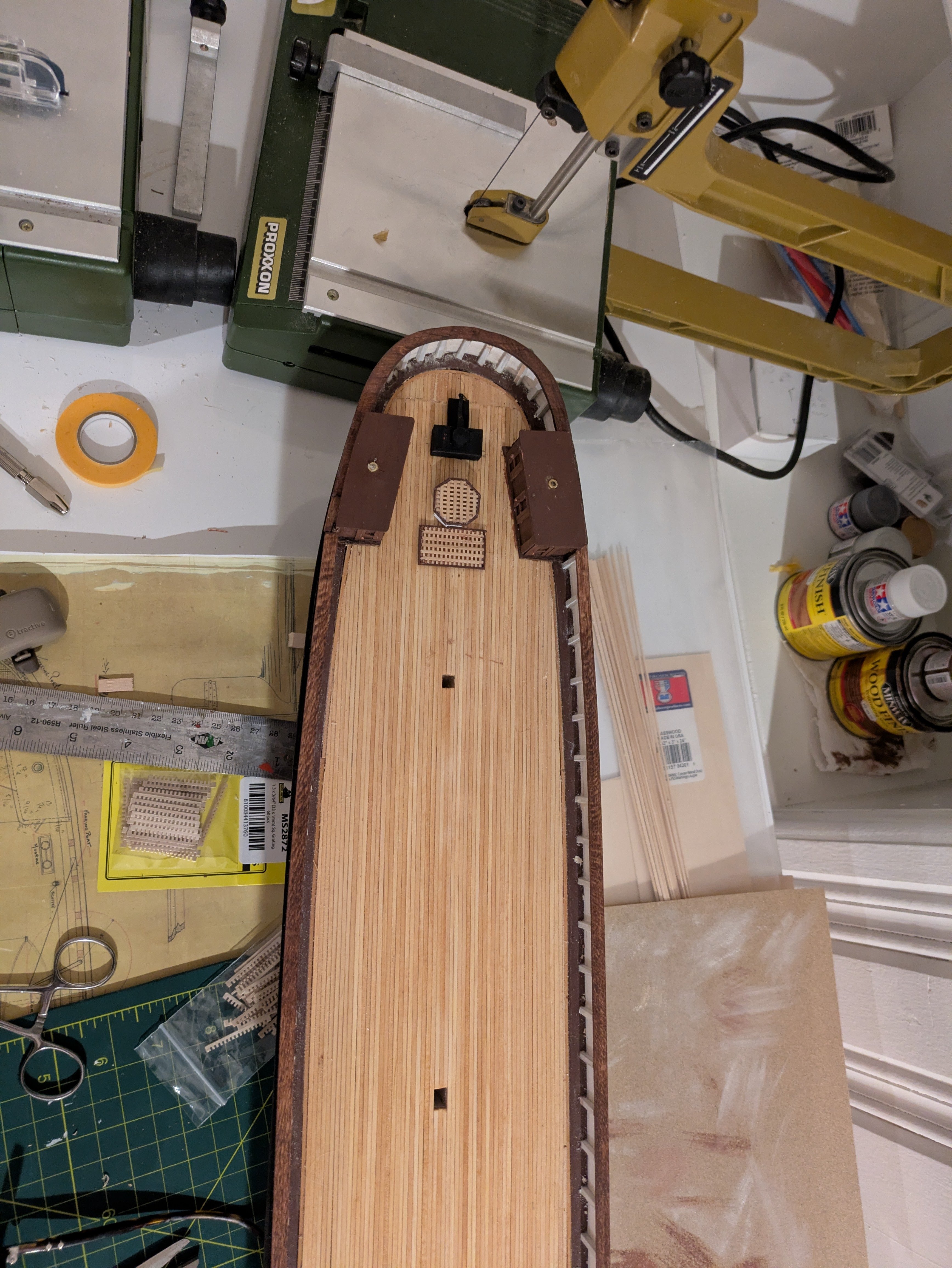

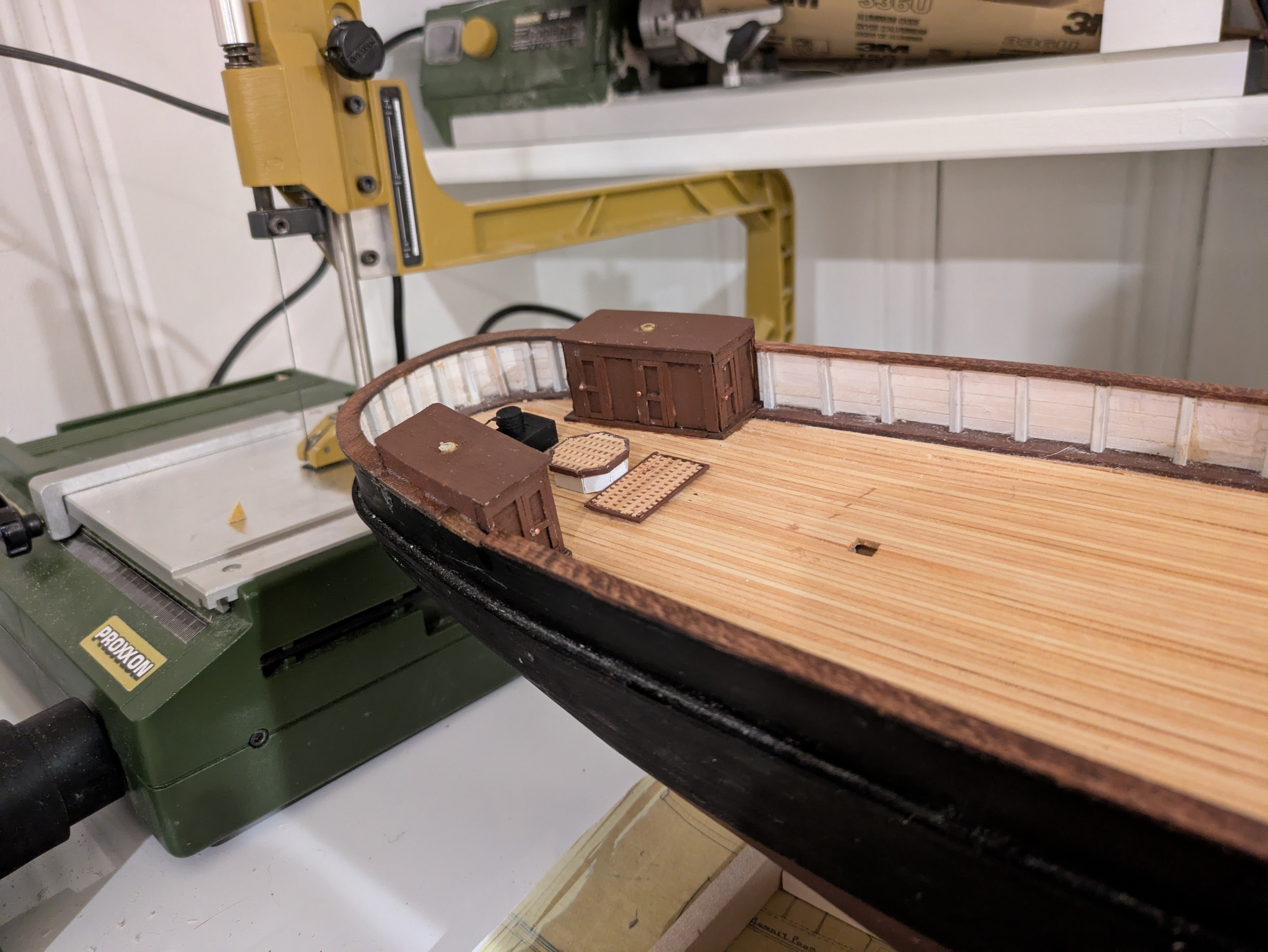

I then mounted the steering box (black), the well, and the wheel gratings onto the deck. Here are two views. The first from above:
And the second oblique from the starboard side:

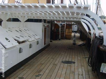

Something to understand about this structure is that it is not symmetrical. The starboard side is not the same as the port. The aft port side has a stair down to the engine room from the deck and aft starboard side has an angled surface with a vent (here is a photo from https://aboutaberdeen.com😞
or you can take a look at this video tour (https://www.youtube.com/watch?v=VsotxBpE0Mg).

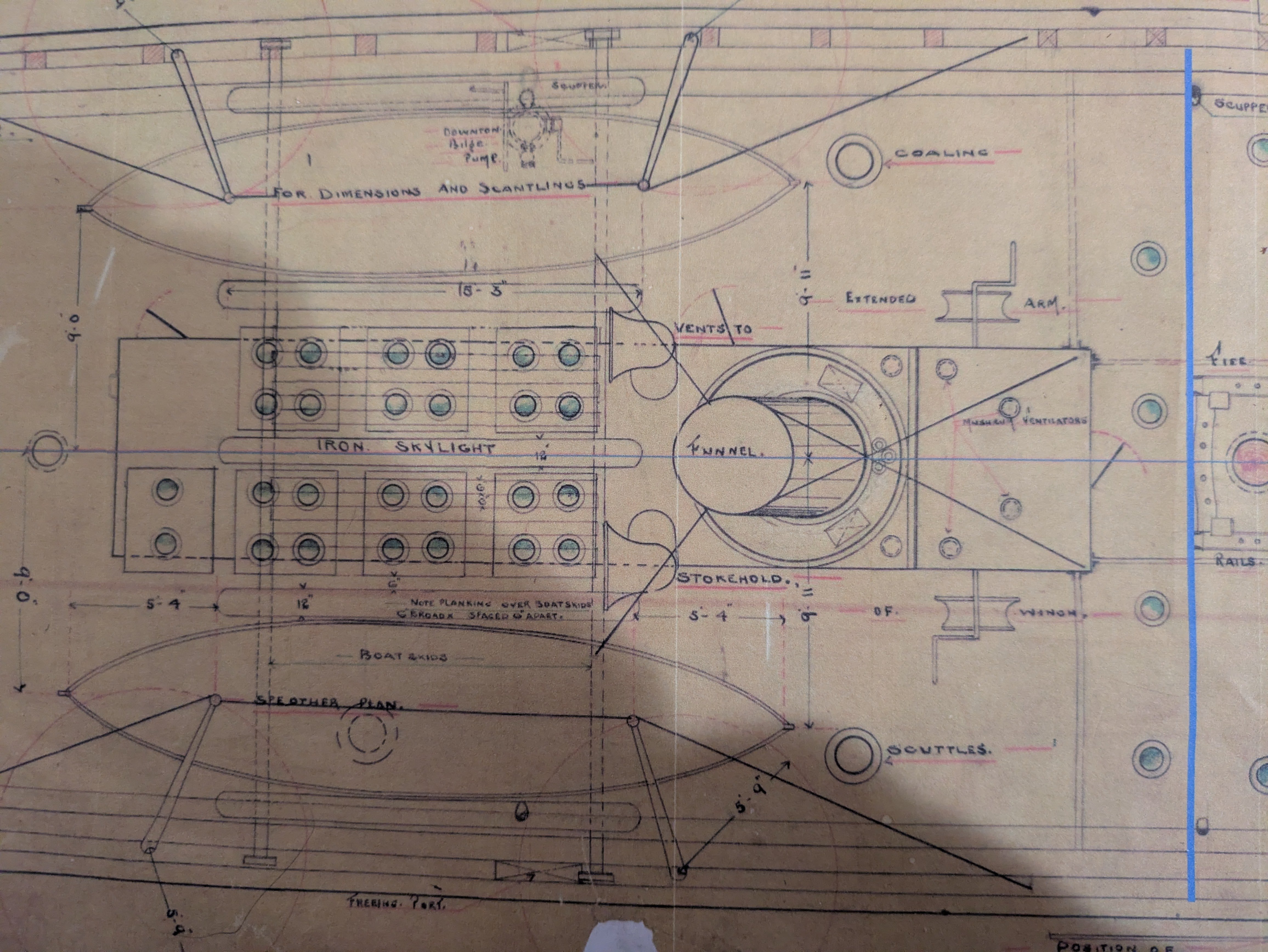

Back to the ship. I was working on the cover for the engine room. Just a couple of quick pics to remind you of what it looks like. Here are the plans:

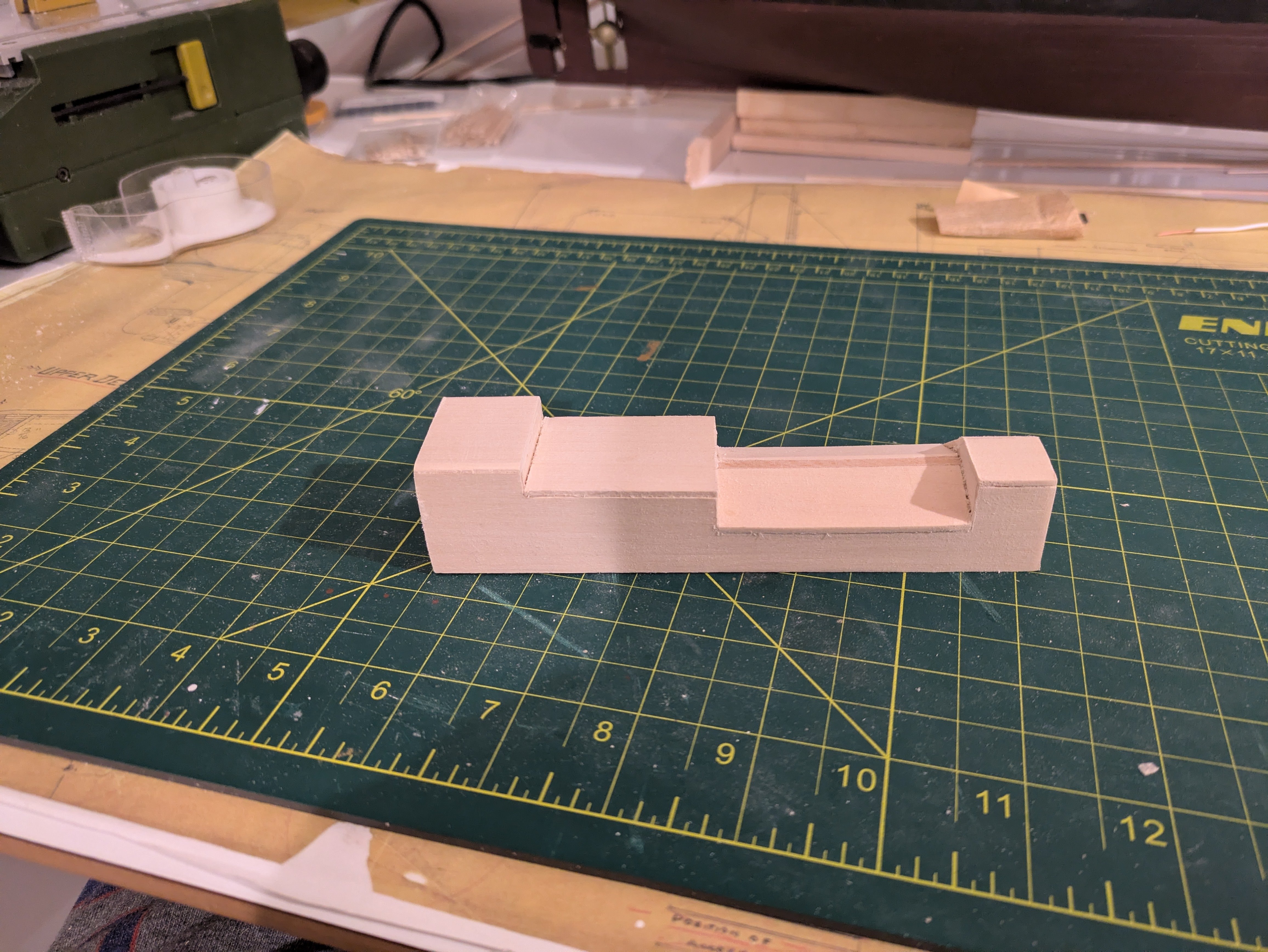

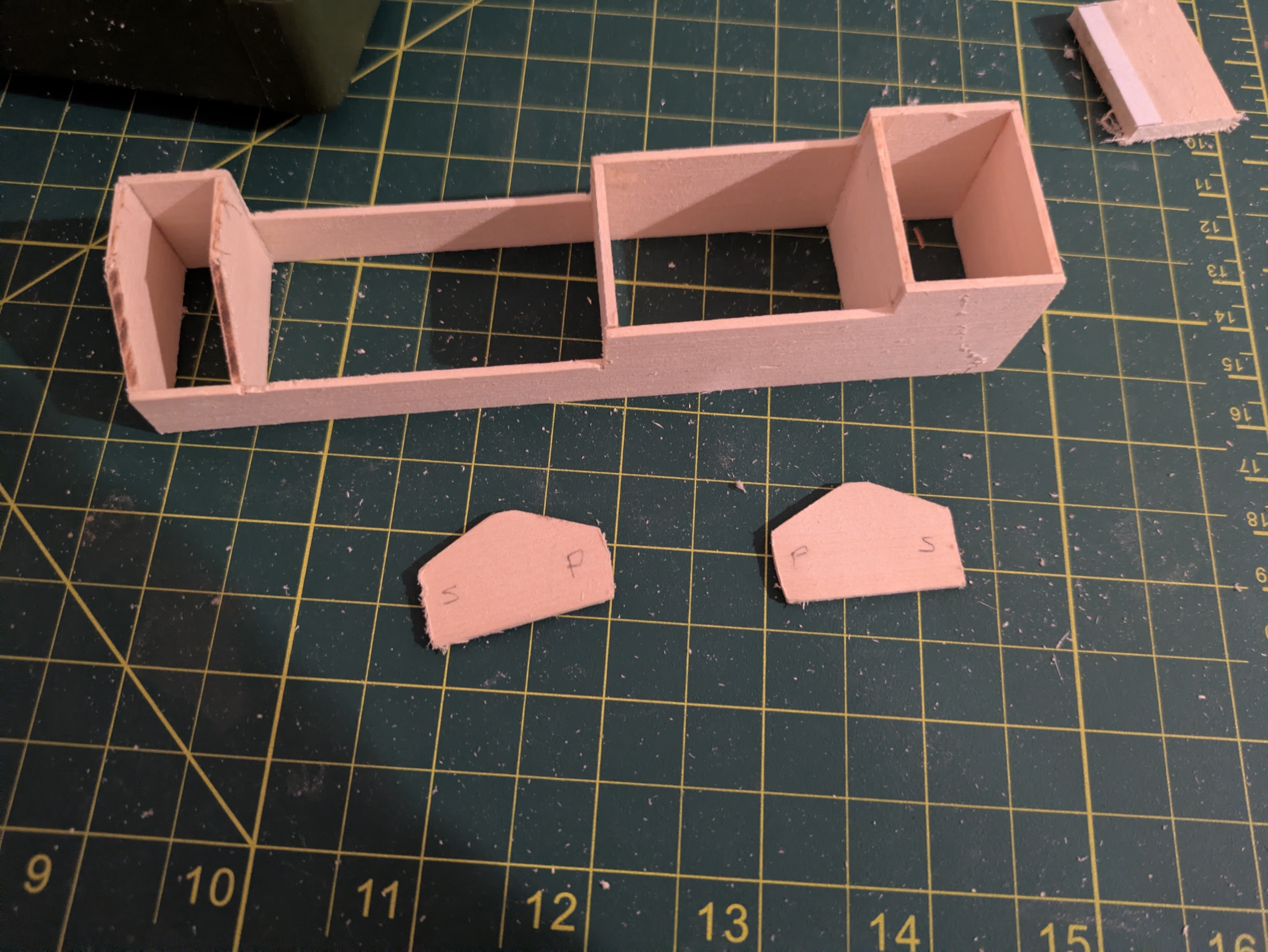

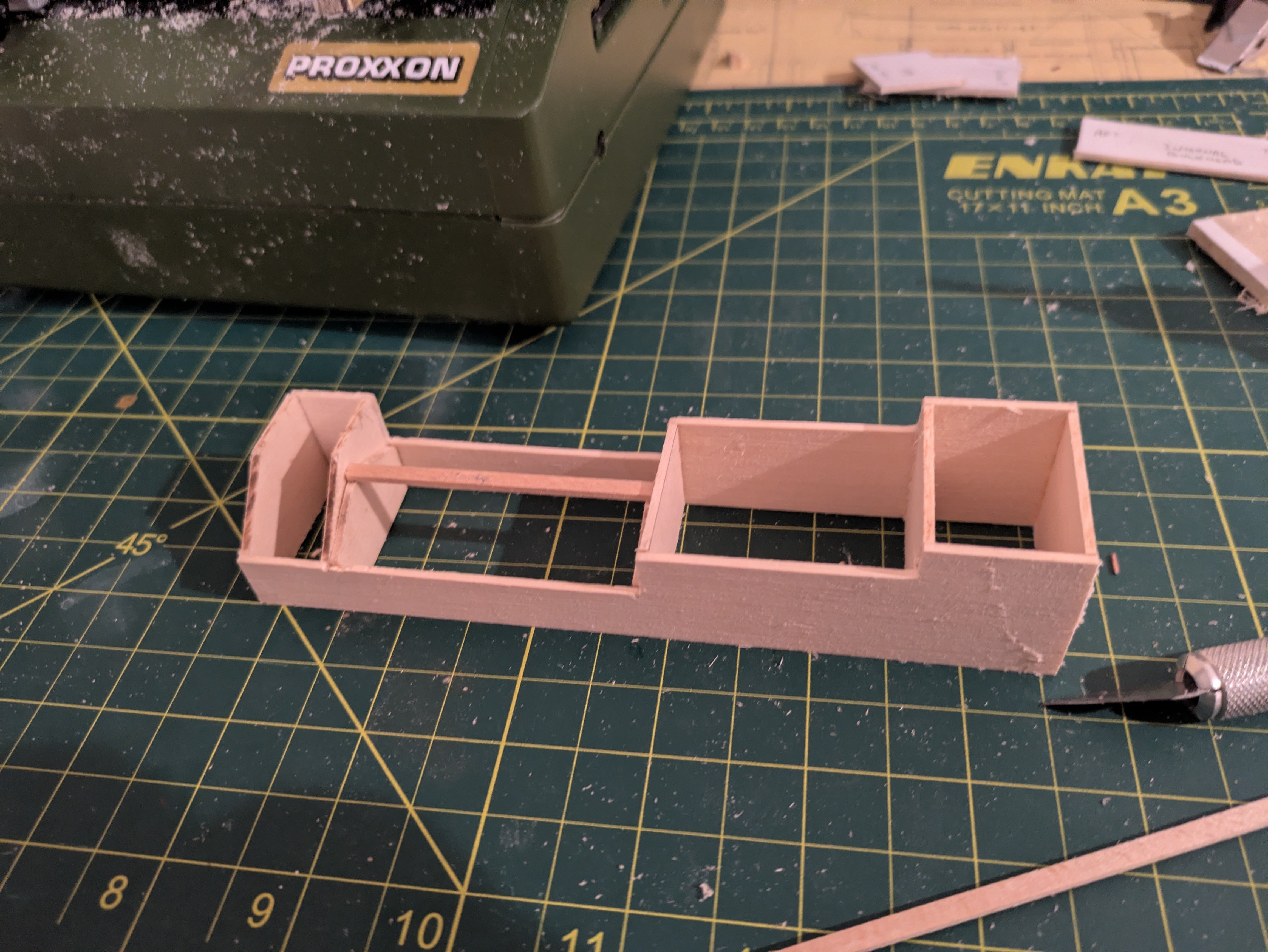

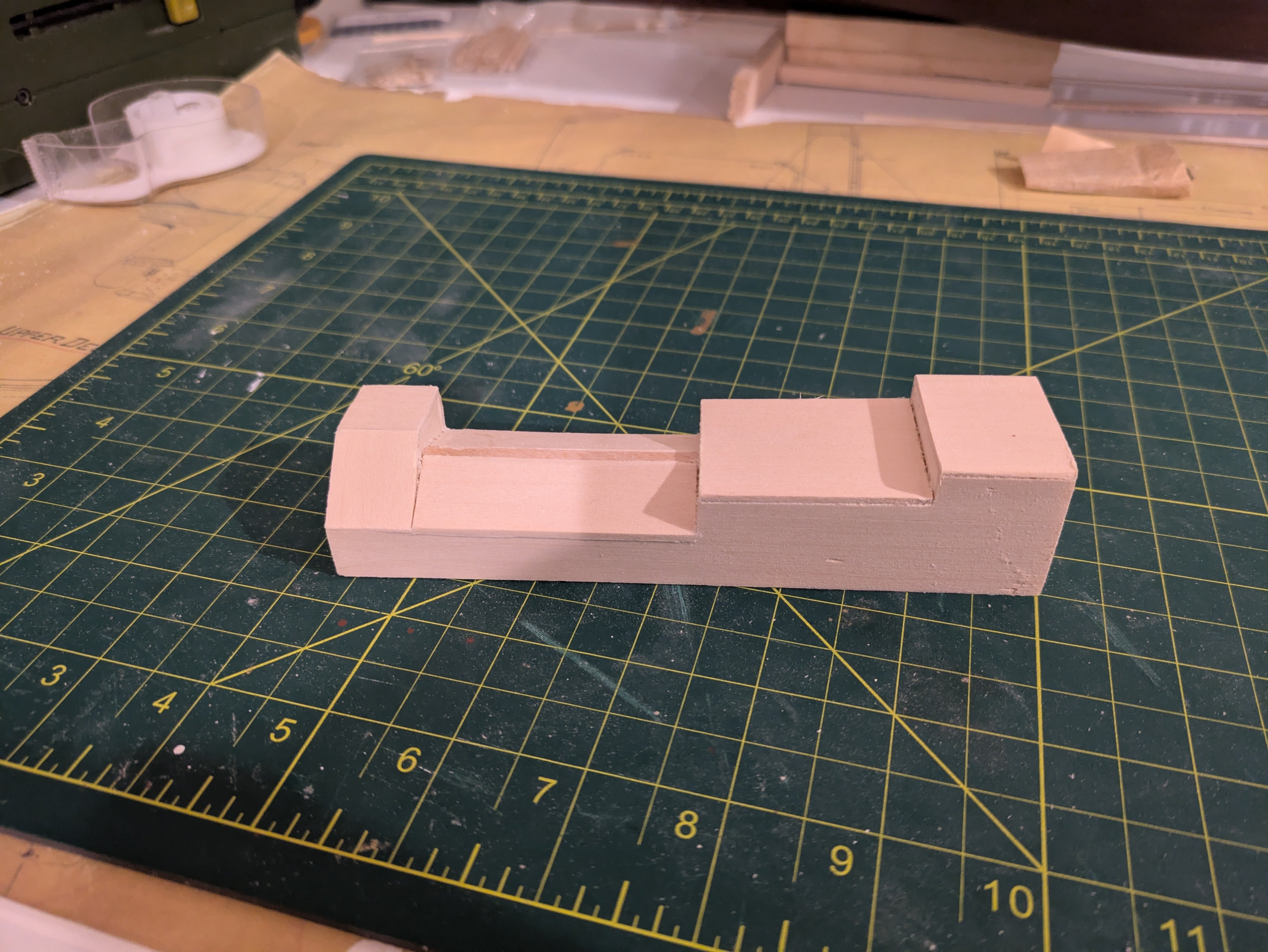

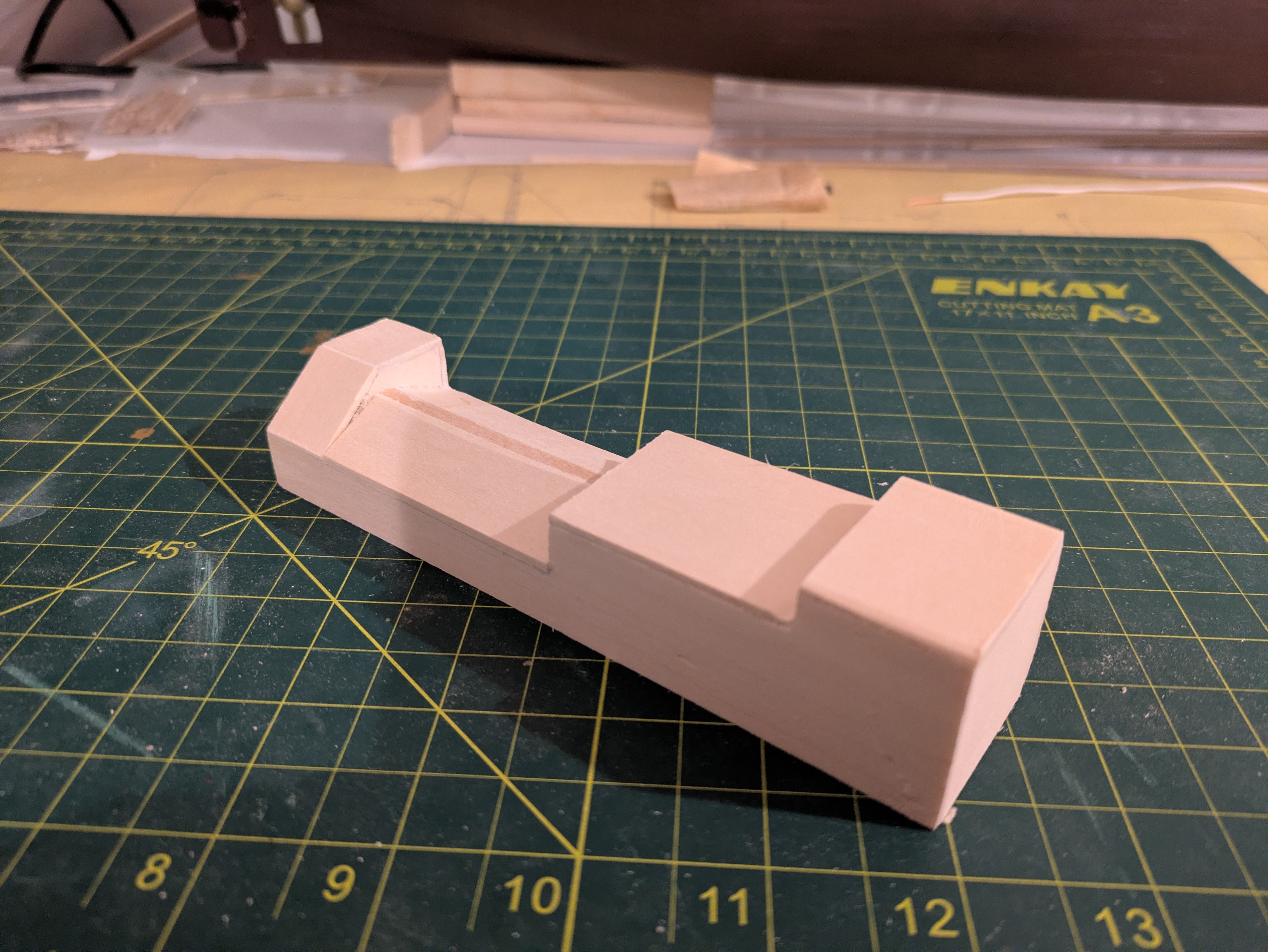

I cut out the pieces that were shown in the previous entry. Here is a brief overview of the construction process so far.
And the basic structure completed. From the port side left is forward):
Starboard side (right is forward):
And looking from the starboard quarter:
This still requires a ton of work. I have to make the 7 iron skylights (6 with 4 ports and 1 with 2 ports), the forward bulkhead has some kind of ports in it as well. It needs a bit of putty, and then sand and carefully prime before painting, b/c the real structure is made of iron and I don't want any wood grain showing through. I need to frame two hatches (one port side aft, the other port side in the second section from the front, build and put on the winches, make 4 mushroom vents, and the stack, and two cowl vents, etc., etc. But I think that the bones of the structure turned out okay.
