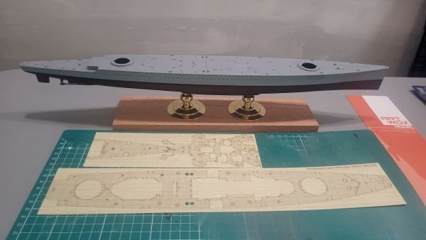

So, my first photo in forever.  The 1/350 ArtWox deck and the hull of the 1/350 Academy Admiral Graf Spee:
I have to say that cutting the deck from the backing has been a breeze so far.  ArtWox has done a great job to this point.
Pray for me, this is a one way, one shot deal😔
I followed David's guidance to remove the unwanted wood and leave the actual overlay on the backing.  He mentioned to save the remainder wood to the back of the overlay as potential repair material.  The ArtWox deck was laser cut quite well - I had no problems with either the large pieces or the pieces I had to pick out:
If there is a negative to this technique it is that it can become difficult to know if you have trimmed and picked what you needed.  The wood you have placed on the back obviously blends into the wood you are working on.  All in all, I think this will be a good idea.
Honestly, I have been pretty terrified of doing this.  I mean, it is a One-And-Done process to apply a wood deck to a ship model.  In the end, the ArtWox deck is extremely well built.  It is strong enough to be manageable, the laser cutting was precise and defined enough to be stable, and the fit was absolutely perfect.  Finally, it is not completely a One-Shot deal.  Because of the stability of the product you actually can adjust it on placement.

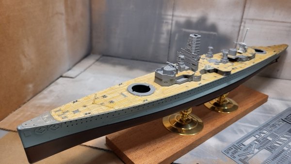

Well, got the superstructure wood down.
This weekend I'll be attaching the platforms.  And, ugh...  a bunch of PE.  Pray for me.  Building the catapults...  I had a bit of repair on the bridge deck wood, it was a little too big and the center cross piece escaped me.  The repair looks ok - I'm glad I saved the surrounding wood as I pulled the deck from the backing.

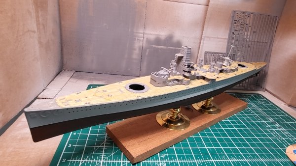

Well, I've decided not to get too hot and bothered about my very weak PE skills.  I'll use what comes out well from the bender.  Likewise, I am not going to play around with brass masts for this kit - that has been the reason for my current delay.  I can't be one of the Masters around here on my third build after a forty year hiatus.😆
One thing I learned by watching AlexModeling's recent 'Admiral Graf Spee' build is to NOT to not destroy the plastic parts till the PE looks good.  That was great advice.  The Edwards PE instructions had me cutting and grinding on the plastic catapult, then bending a long flat piece of PE into a long rectangle.  I didn't do it right.  Luckily, the kit is very well detailed.  PE is great, the plastic will be very good.
I'm happy with the light weathering of the deck.  I am modeling the Graf Spee as she left port in August 1939 - so, she will be two tone.  She was the national flagship of Germany prior to the commissioning of the Scharnhorst early in 1939, so she would have been extremely well cared for.  Heck, she was commissioned herself in January of 1936, so she was a young pup.  Here she is with some of the superstructure dry fit:

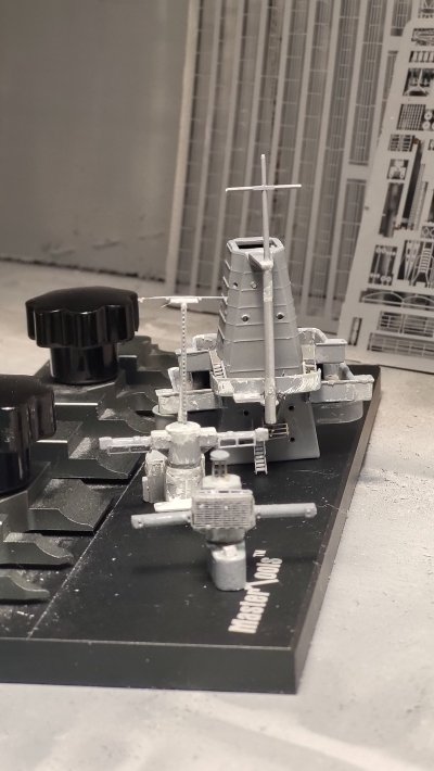

Flying Bridge Check, and Enclosed Bridge Structural Build.
Some of the instruments on the flying bridge went in soft.  I was a dummy and wasn't careful enough when priming/painting on the sprue.  Luckily, they still stuck and were only noticeable when I checked their condition.  A little filing and re-gluing and I think all is good.
LOTS of filing, LOTS of test fits, and LOTS of putty later and the enclosed bridge is structurally done.  Man, that was some poor fit for an otherwise great kit.  Some of it was my fault, but I can't think of a way to late-paint that assembly.  I would probably recommend something Revel Contactor Cement for the tower - then test fit the superstructure decks before things set.   Those decks are tight.  She is waiting a day before filing and sanding the putty, but she looks ok.  I don't think I'll have too much problem with the airbrush coat to follow.  I can just angle it such that it won't get paint on the tub decks.
