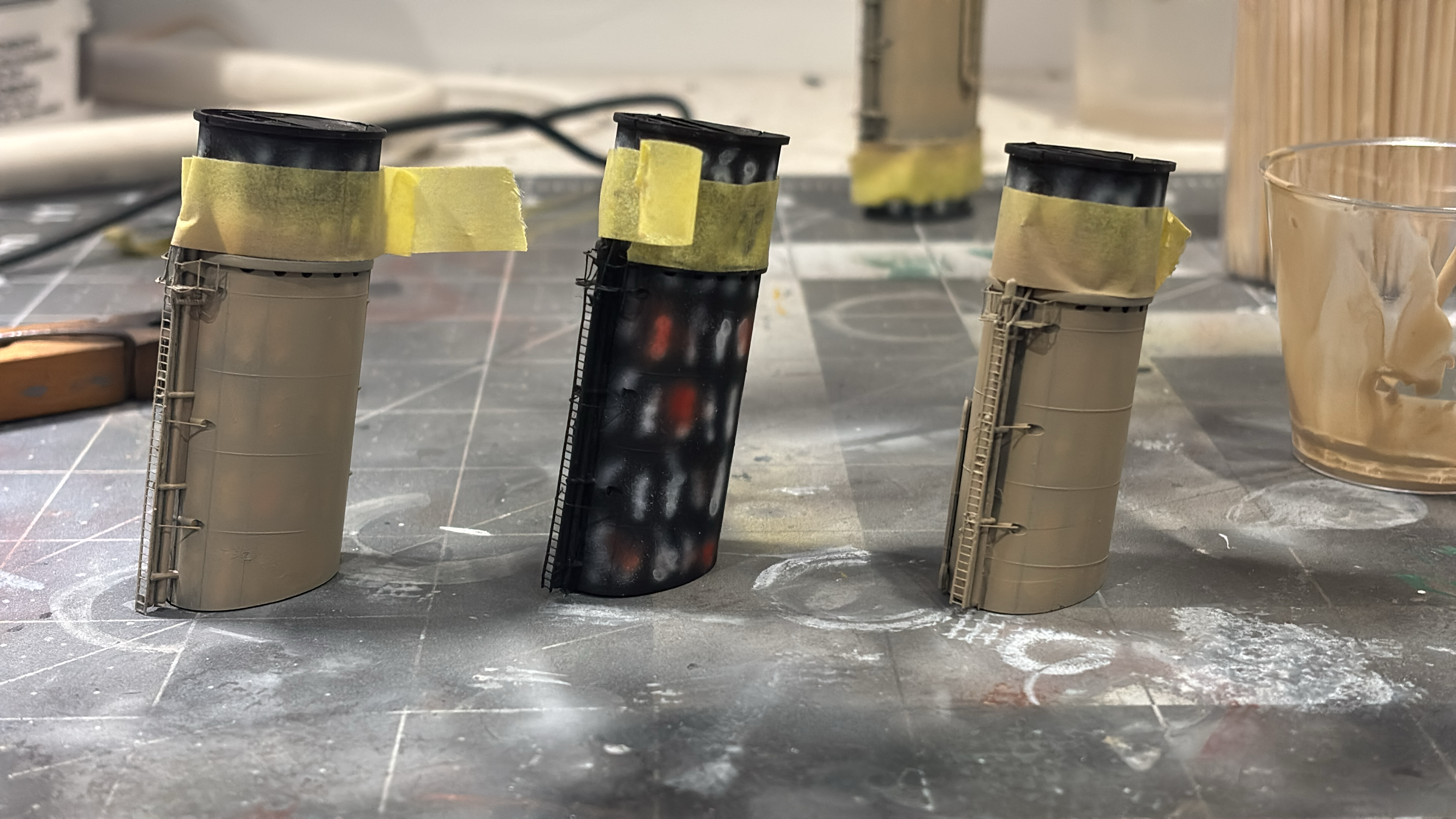

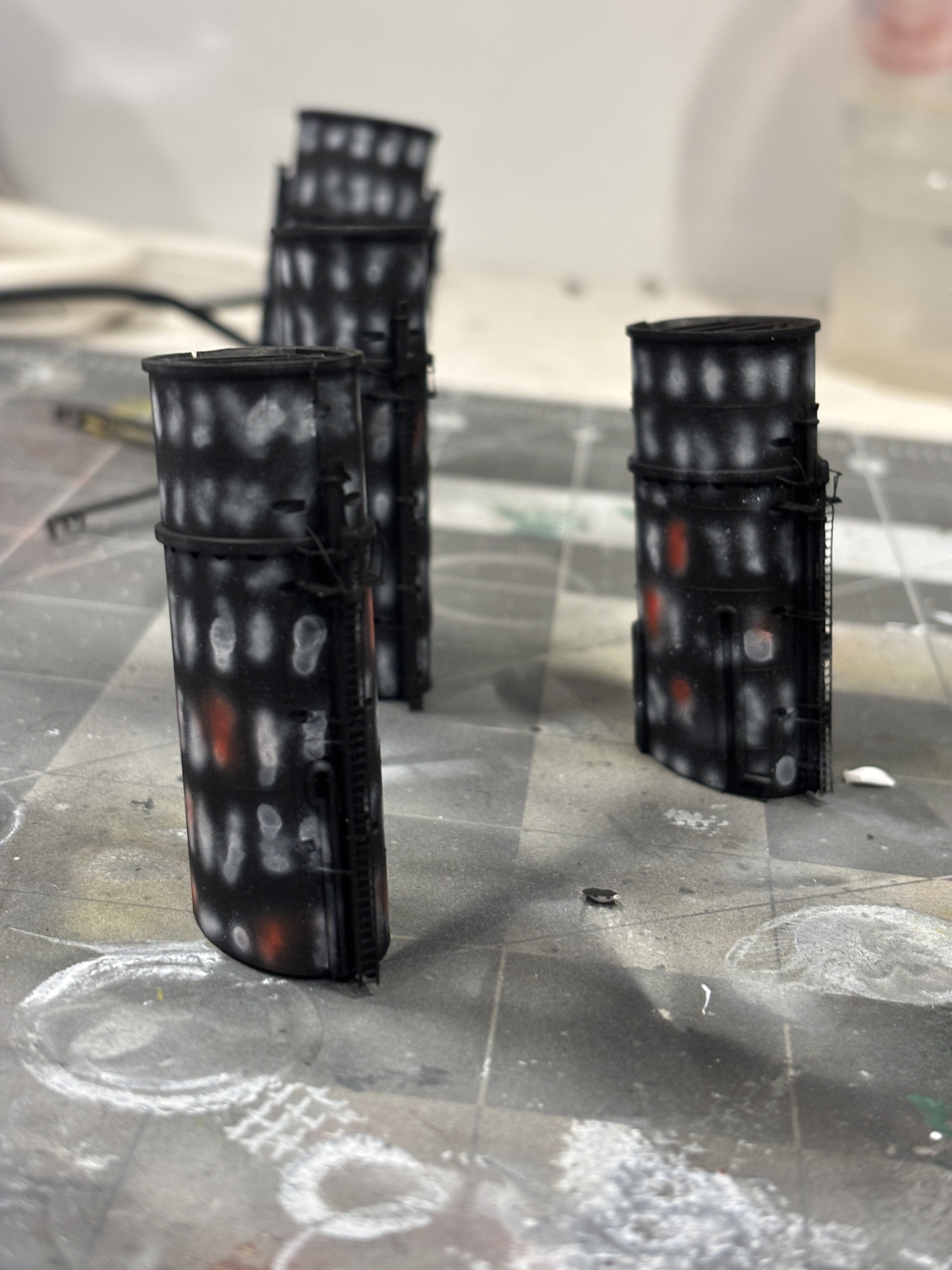

I also found some lovely reference images of the a funnel used on the movie I will post below for future use.
Funnel # 4 by the looks of it, posted below, taken from the following link:
IMG_0061.jpeg.a41c974ff2428b98bb34c74b19992baf.jpegIMG_0062.thumb.jpeg.9cc645f17a36daa41e13fb9679889dee.jpegIMG_0064.thumb.jpeg.53eb135ae1c74ea50ca3f0a0fc1a1f85.jpegIMG_0065.thumb.jpeg.964c9add24a8cf67aff21d483c4c3a2e.jpegIMG_0067.thumb.jpeg.e4bf81d0c79be1f7651bdc2b8208fa13.jpegIMG_0066.jpeg.8fa51612c43caea44248e17b8823c2df.jpeg
https://propstoreauction.com/lot-details/index/catalog/138/lot/28725
As seen the colour is very similar
to that of Tamiya XF-57, albeit with some warmer undertones – perhaps a pink or red preshade would prove useful:
Therefore when the time is right, this is what shall be used.

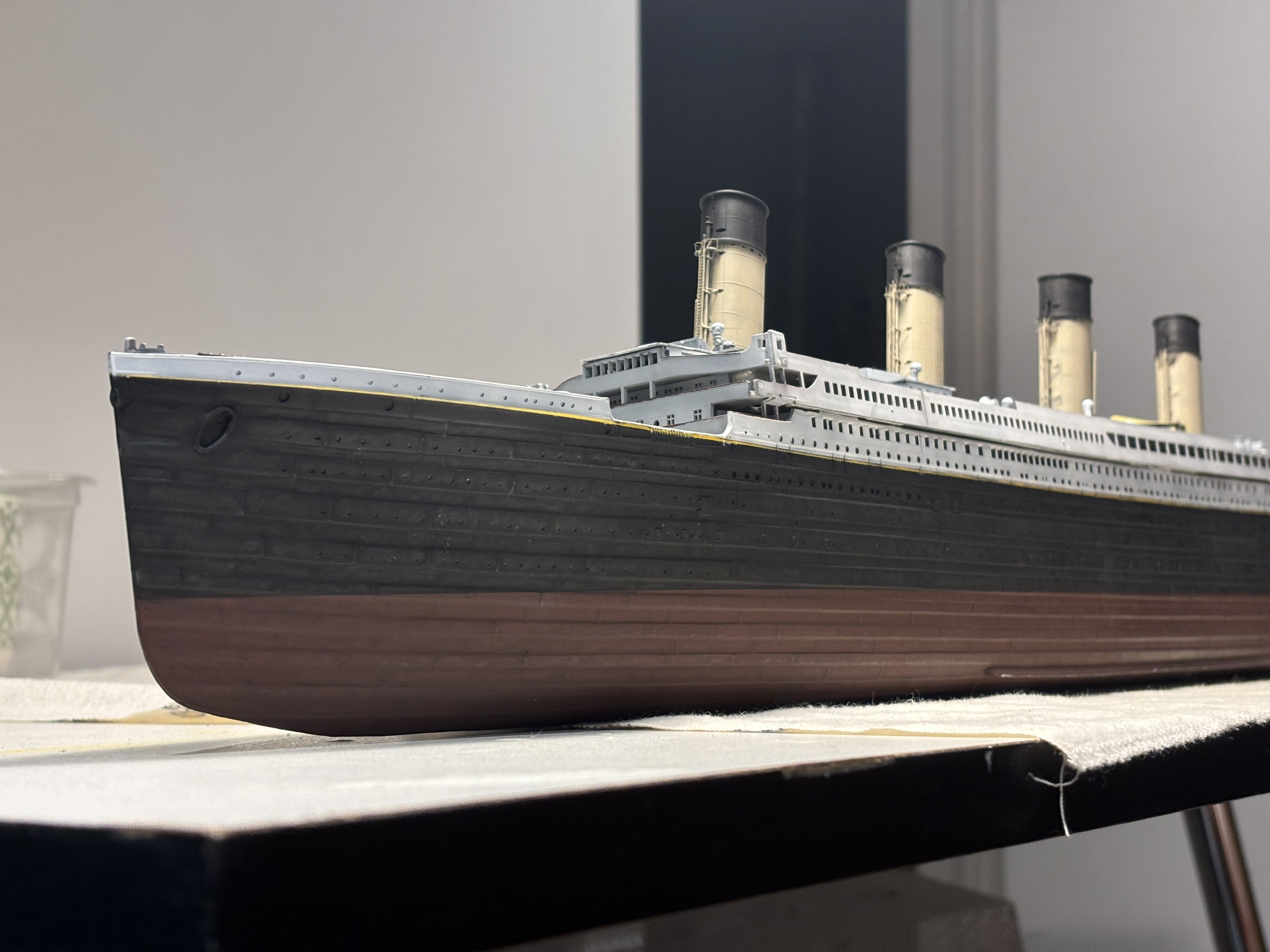

The interesting part—at least for me—has been completed. I’m quite satisfied with the funnels and their colour scheme. Although they lack a bit of warm tones I believe this to be a good thing or possible accuracy.
IMG_0850.thumb.jpeg.5450ec609fe2ebe3a3380f8bc8048e25.jpegBC92F224-B470-4B43-95E8-1275C392D388.thumb.jpeg.43d20a084e02f39c28af7a406a852c38.jpeg
A test fit makes them look very attractive:
IMG_0858.thumb.jpeg.c232fed50d54a61c63a5f3b1e839f4e8.jpegIMG_0869.thumb.jpeg.6b4e9d34357c7266496b17c4c5df0728.jpegIMG_0865.thumb.jpeg.403a35de6eb8b1a9cd98224e2a9418d3.jpeg

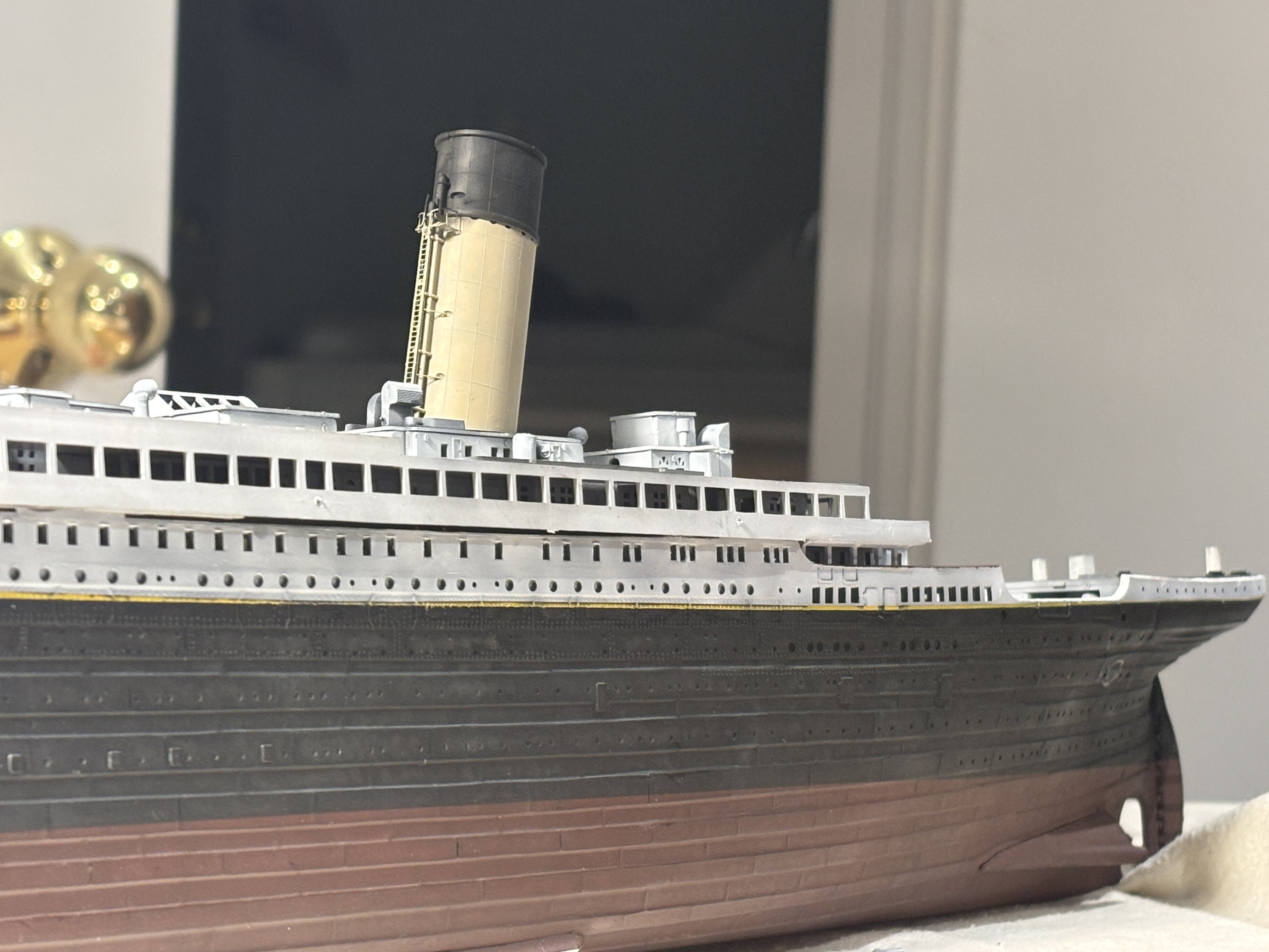

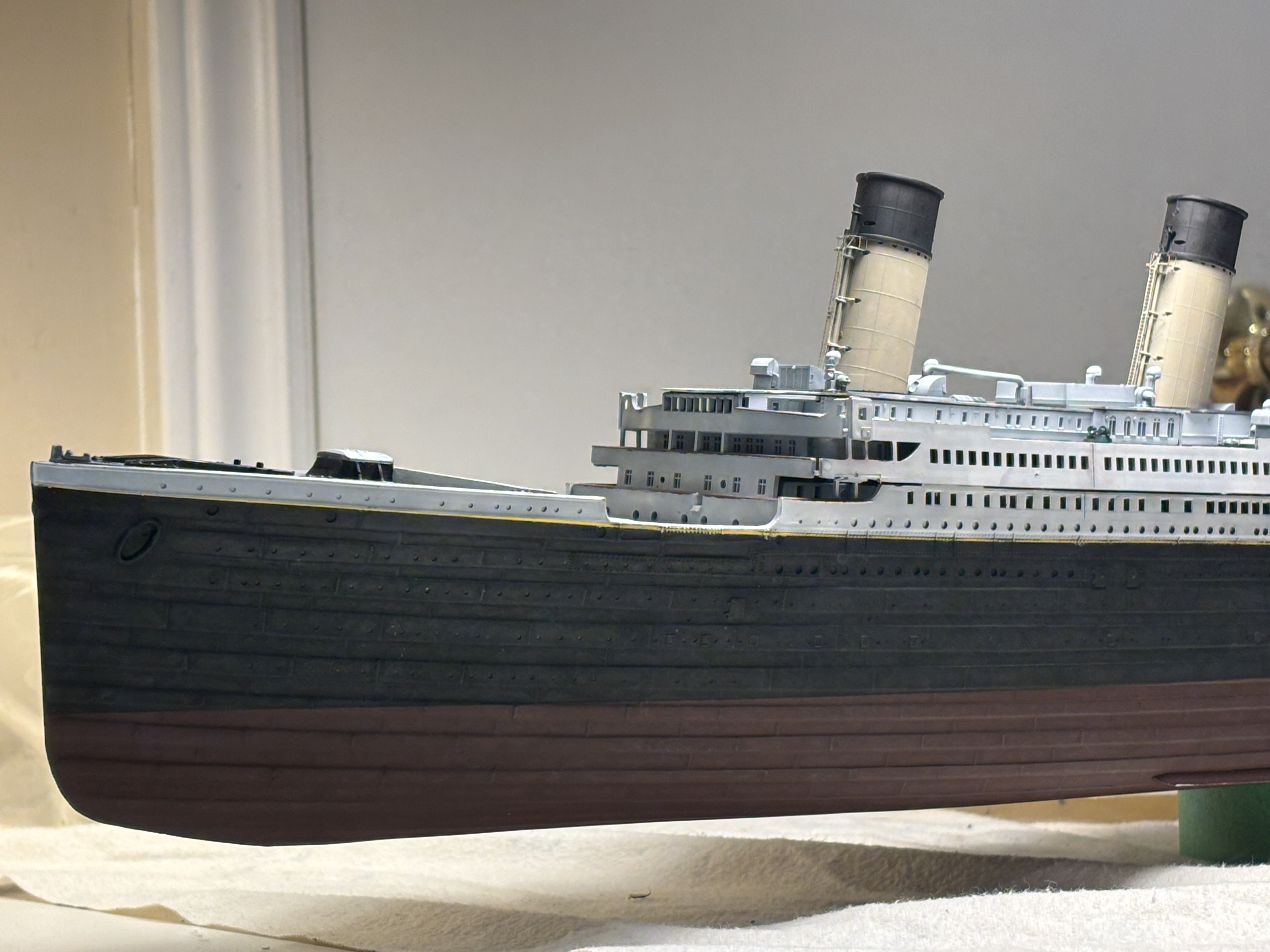

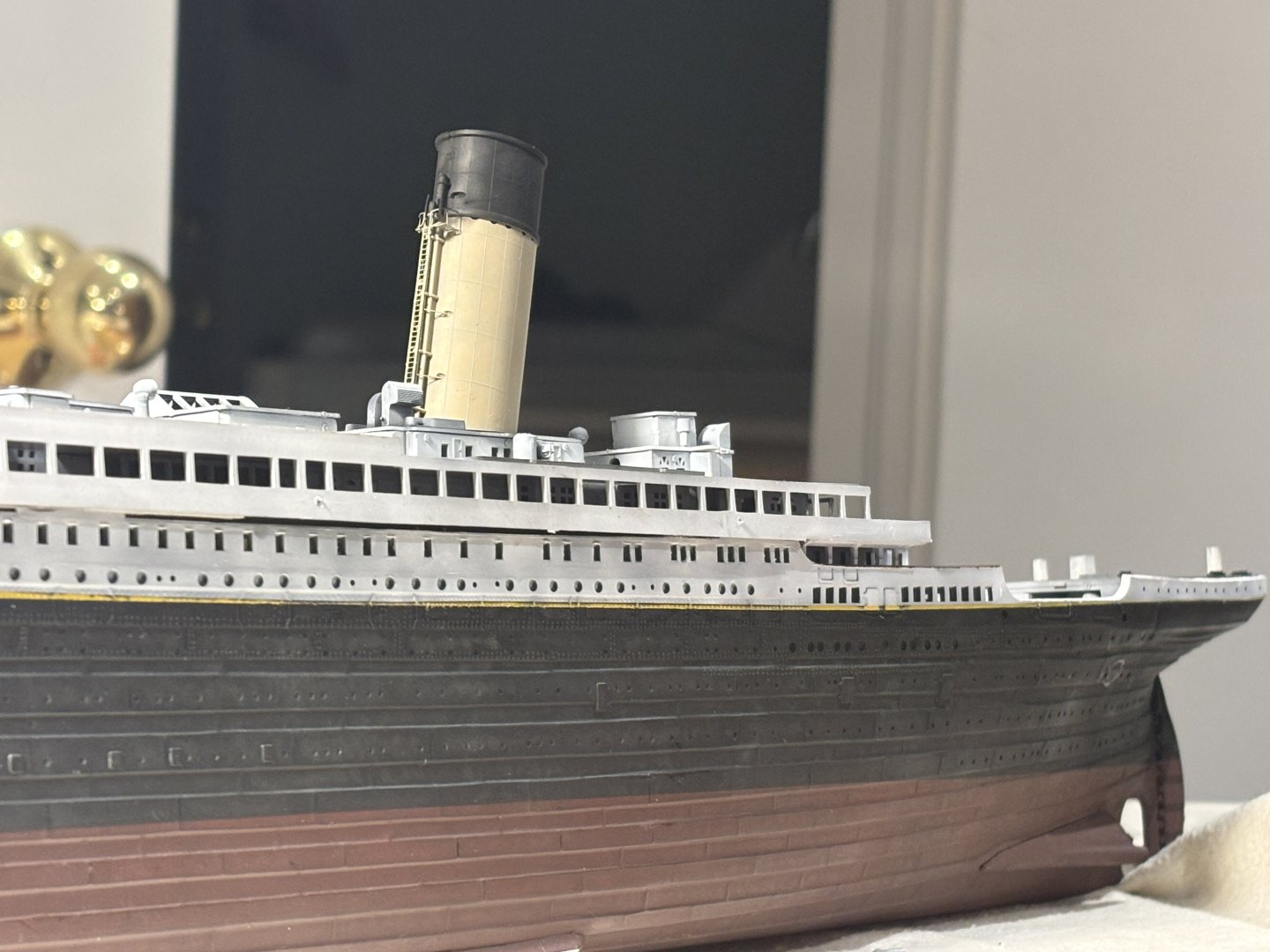

Came back from a trip a progress continues.
First order of business was to correct the funnel colour. After meditating on it for a month or so I was unsatisfied with the chosen colour. Therefore I mixed my own combination of several tan colours to mimic quite closely the one of the movie model. As can be seen in the photographs this colour is quite more accurate to what I had intended to replicate. They are now secured and can be quite forgotten about now.
Direct comparison:
Model
IMG_1386.thumb.jpeg.ae7e740e9f91cd93a5d01915578a7785.jpegMovie model
IMG_1382.thumb.jpeg.1db7fd52fd2551f760c854ddde71a1f6.jpegIMG_1385.jpeg.23c1a1cfce859dd1957e8542fcd3fbbf.jpeg
