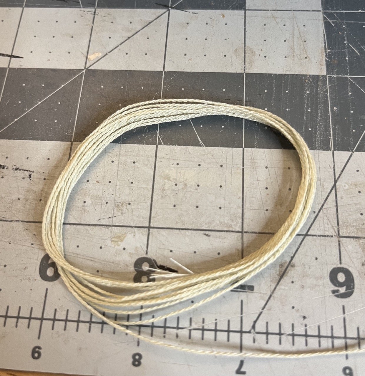

This would be my second attempt.  It came out ok.  It probably should have been wound tighter.IMG_3483Large.thumb.jpeg.8837c4ae9b97fcd45b5e292208226cc0.jpeg
  - Eric
