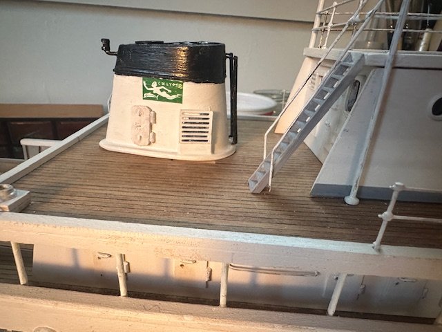

Here are two photos showing what I ran into on the starboard side of the chimney regarding the door. I had created a door showing where there was no room for the Calypso decal.
  I created a new smaller rounded door based on photos.
First chimney door:
New Chimney door with room for decal. Also glued stairs being careful to keep stairway parallel with handrails.

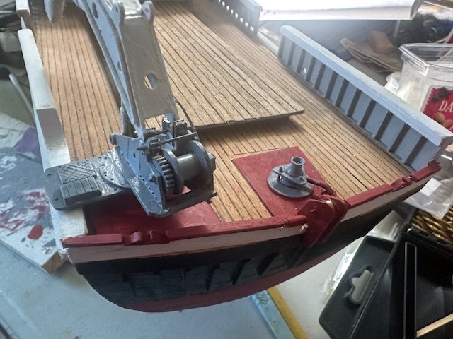

Worked some on the transom detail rollers and chalks.
I did a little more work on the transom today. Added and painted a rail cap and painted the rollers and deck hardware. Feeling good about the progress.

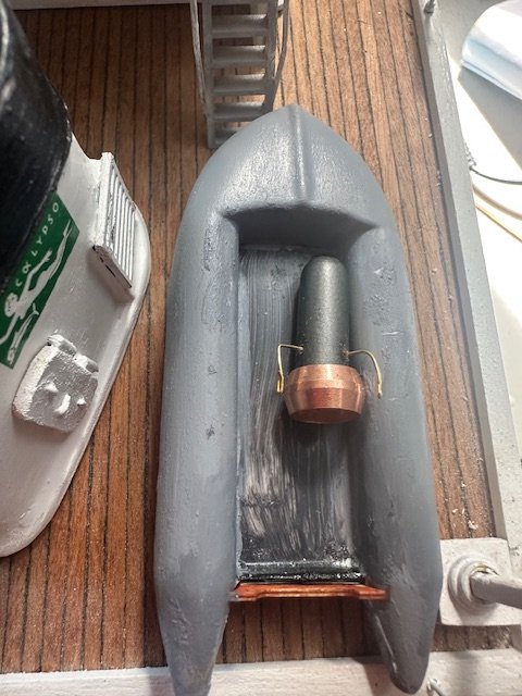

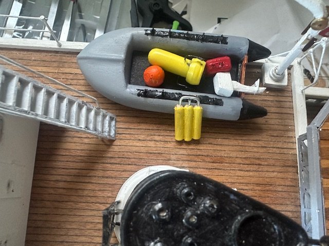

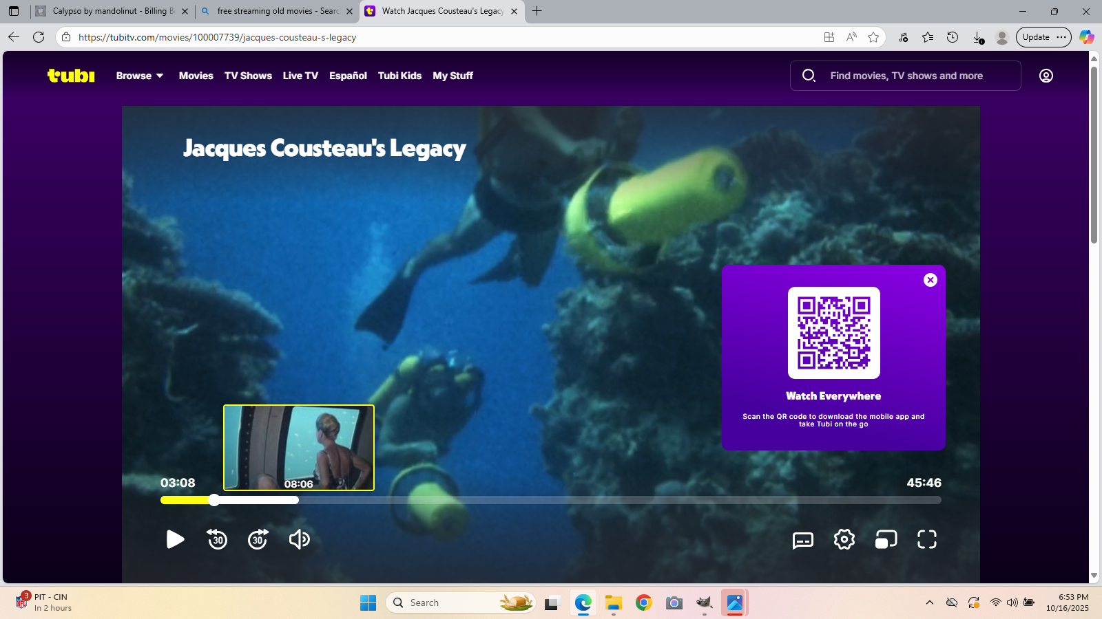

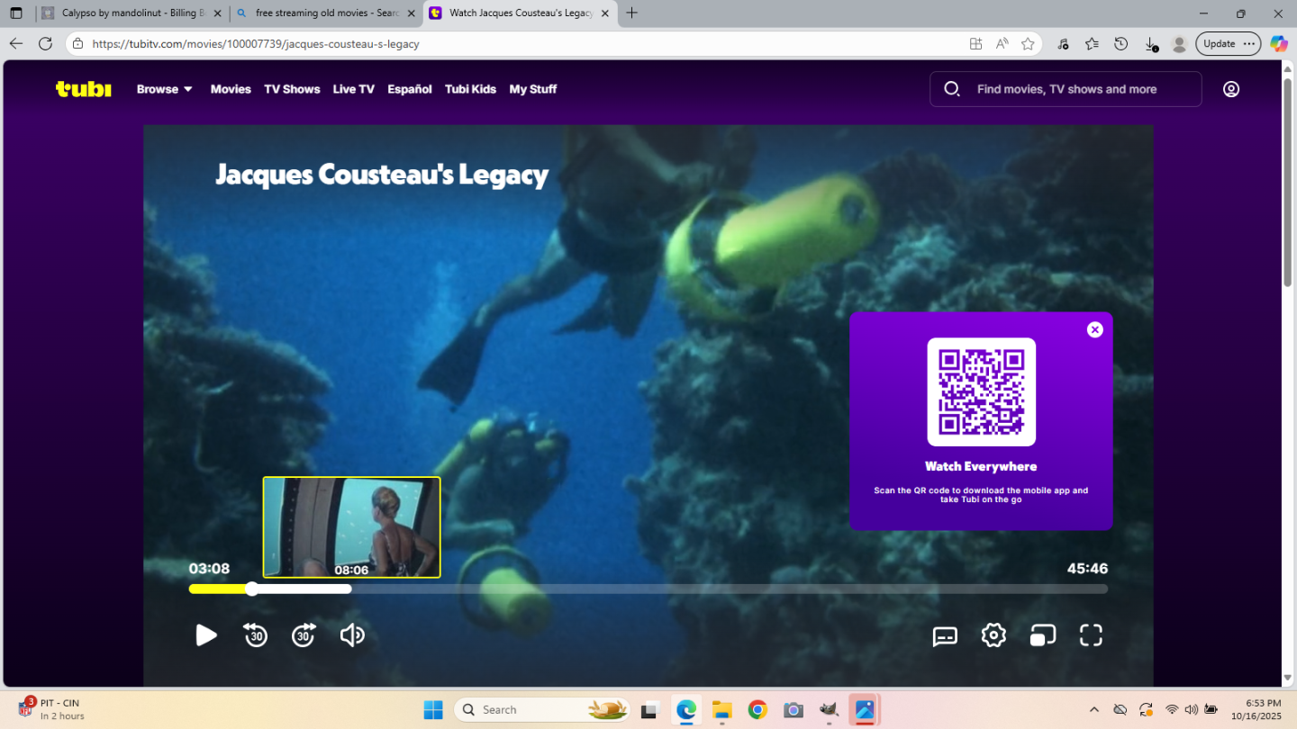

Just for fun and inspired by the old Cousteau TV series, decided to build an underwater scooter. Cousteau's documentaries were the first time most of us had ever seen such a thing
and they looked to be fun and practical. I used and old plumbing compression grommet, some wire and the cut off end of an art paintbrush for the build. Yet to be painted. The scooter will
end up living in the Avon dinghy along with a dive flag and dive tanks and floats and a gas tank for the outboard.

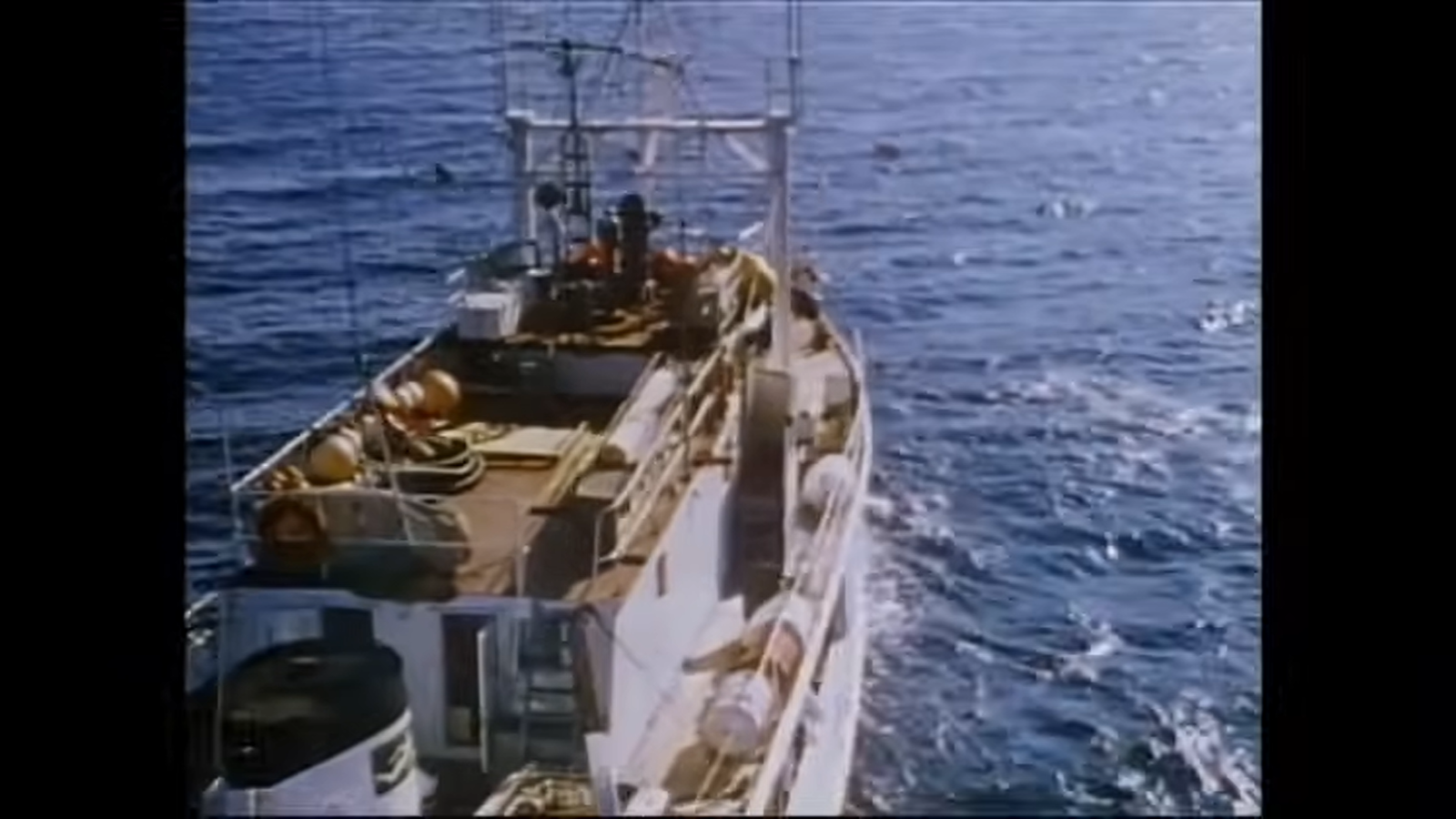

Here is a screen shot from a Cousteau video.

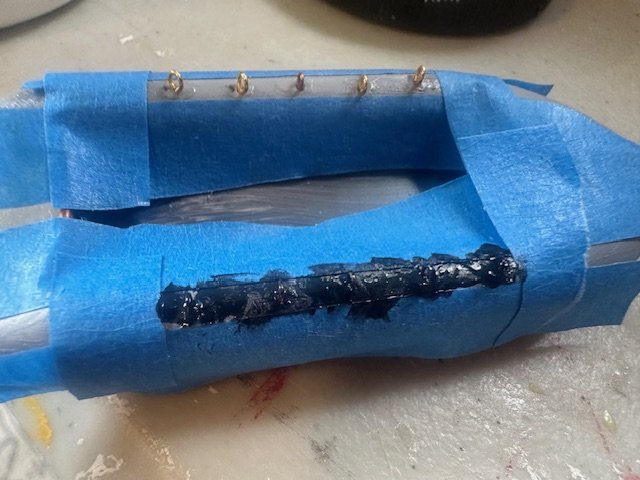

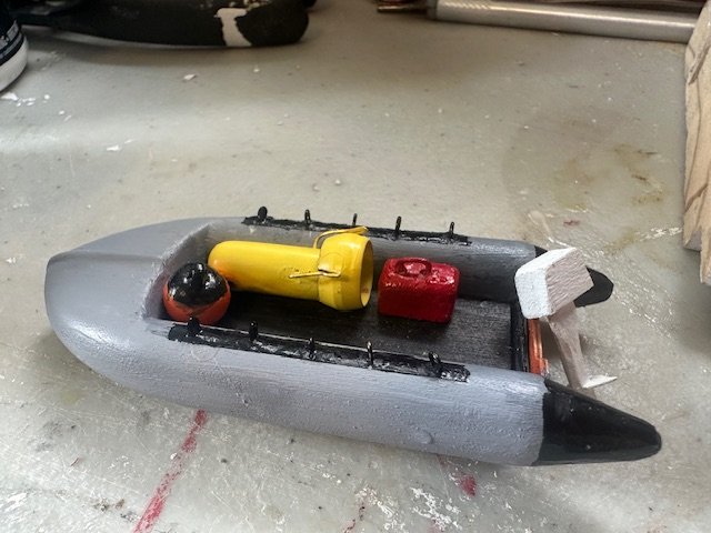

I had a little more time to spend on the dinghy today by adding 5 small wire eyebolts to each side. Then taped off to paint the border on top and the two stern extensions black. The grab lines on each side will eventually pass through these eyebolts as in the original photo.
Also painted the underwater scooter yellow.

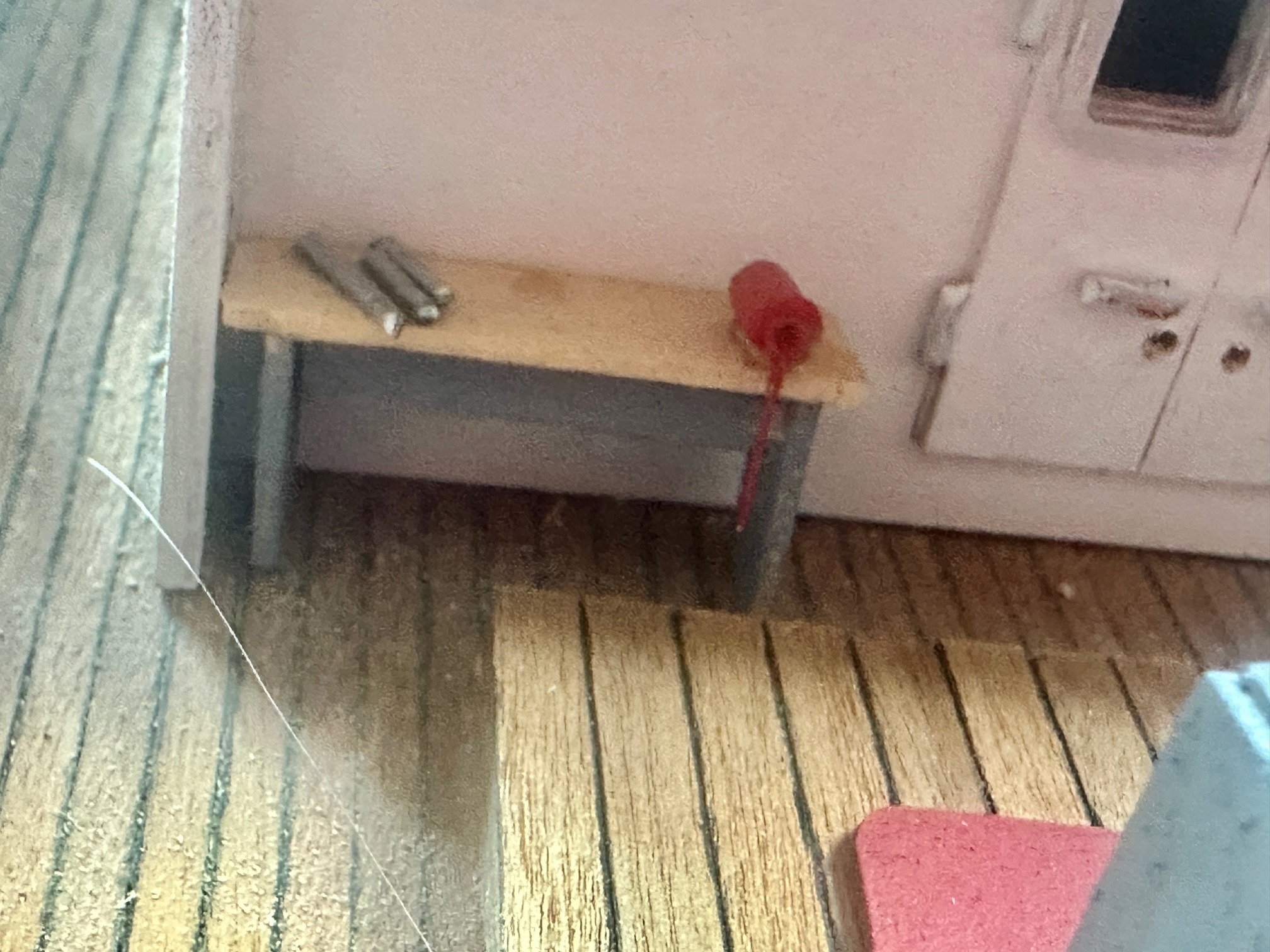

For example, I saw in old photos of Calypso where there was a work bench behind the lower deck cabin on the port side.  I came up with this today and added a vice.

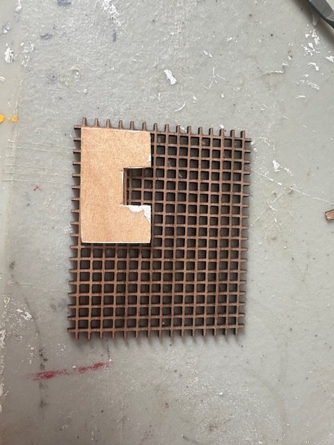

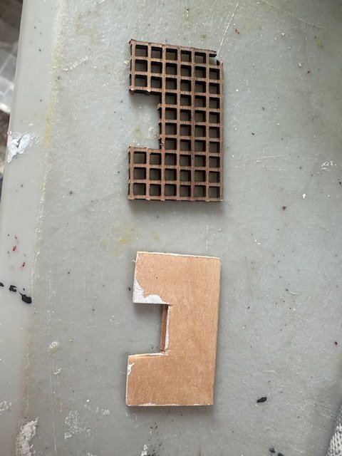

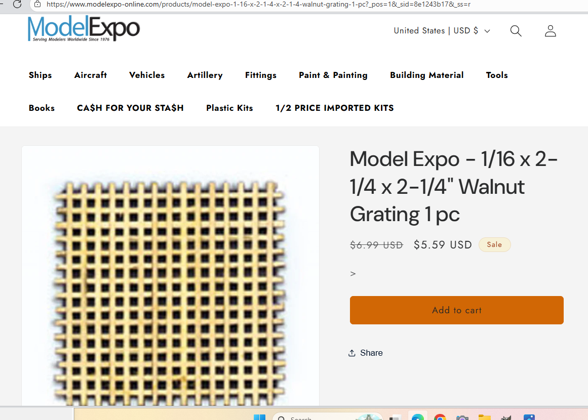

I also began working on the dive platform. The part supplied by Billing is a solid piece of laser cut wood.  I see that other Calypso builders have planked over this.  As a lifetime diver, this would be problematic as the wave action would lift and lower the solid platform in rough seas. Dive platforms are almost always grated to allow water to rise up and through and then immediately drain off. Calypso was no exception.  I ordered this grate today from Model Expo. which I will shape to match the original Calypso grate that had an opening for the divers access ladder to pass through.  Once again, one more little detail to look at.
I worked on my workbench a bit more today. Added a drawer front and some "tools" on top and painted the base gray.
I received my Model Shipways grate and cut it out to match the solid laser cut dive platform.
Mounted to the stern of the ship along with the ladder, support chains and handrails.
Happy with the overall look of the grate.  So many small details on this addicting build. Loving the process.

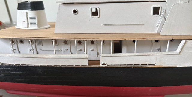

I began the planking of Calypso a few days ago. I find this part of the build to be very satisfying. She is starting to look like a ship.

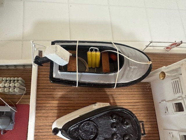

I worked on some smaller details this week. Started by making a "triple tank". I remember first seeing these iconic bright yellow tanks in the 60's on the Underwater World of Jaques Cousteau.

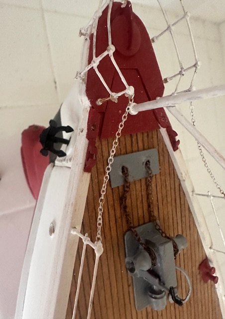

Then antiqued the shiny copper anchor chains and temporarily led them into the deck.

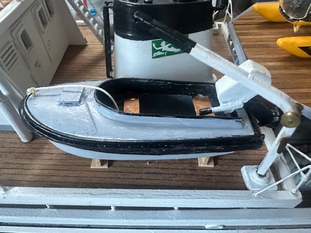

Added a bow cleat and some line for the runabout along with a forward seat and mounted the outboard engine.

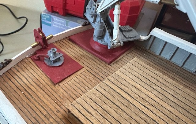

I had the time to do a few small detail projects this week. I received an aftermarket bronze bell and antiqued its shiny surface and installed.
Painted the cradles for the runabout boat and constructed the wood slat storage bins and painted them gray.
Then made a hanging firehose detail. Still need to add a valve.
I believe my next step will be painting these beautiful brass barrels and making cradles to hold them.  I have added an aftermarket handpump to one of the fuel barrels. .

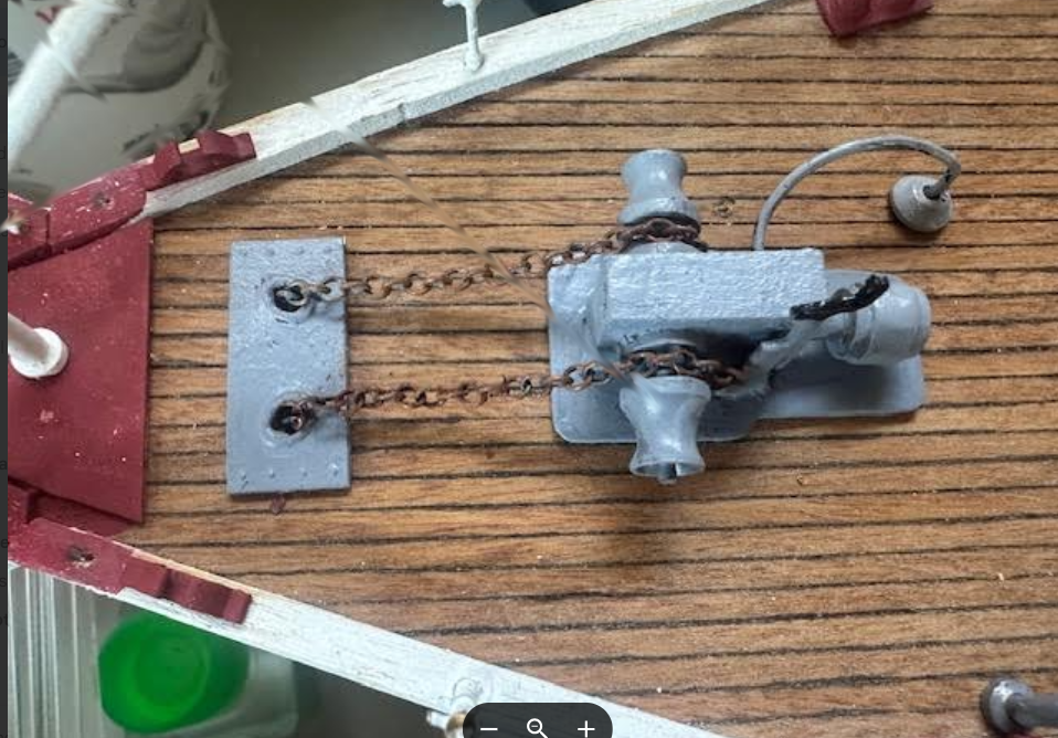

Added the safety chains on the forward deck with a thin coat of white paint.

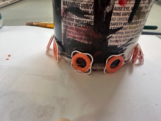

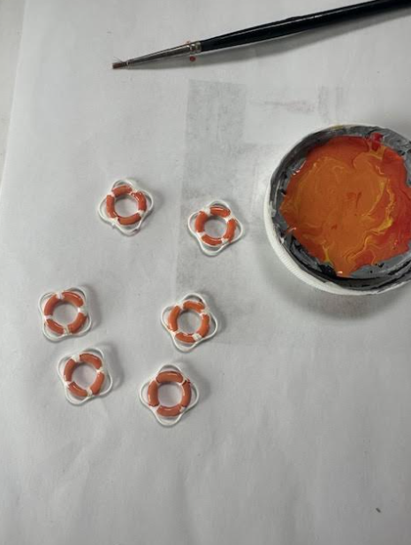

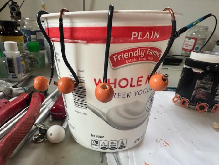

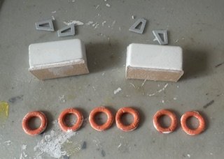

I then mixed some orange paint for the tossable life rings.   I left the white areas that suggest where the ring is lashed down and later decided to paint over the white and wrap it later with white thread for a bit more realism.

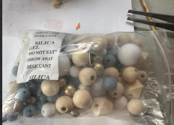

Found a bag of wood beads at Michaels in assorted sizes so I can make a variety of sizes of floats and fenders.

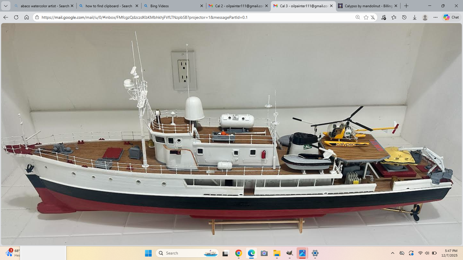

Here is where Calypso is at this time.

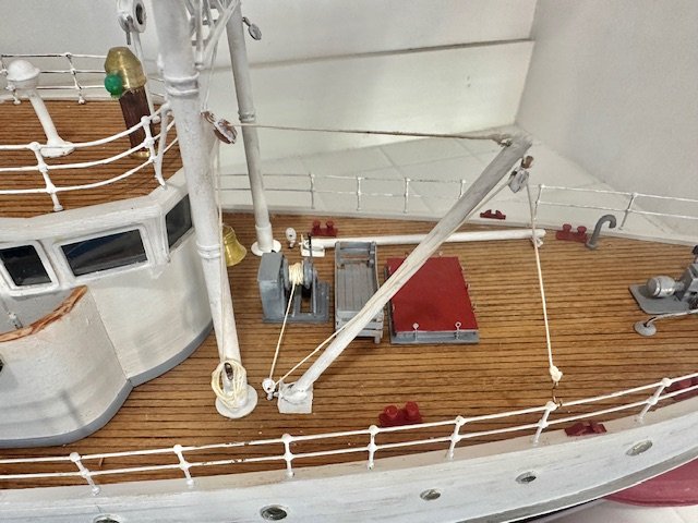

I finished up the rigging for the forward deck boom. It is nice to have more going on up front to help balance all of the eye candy in the back of the ship.

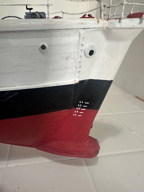

Also added the depth markers at the bow.

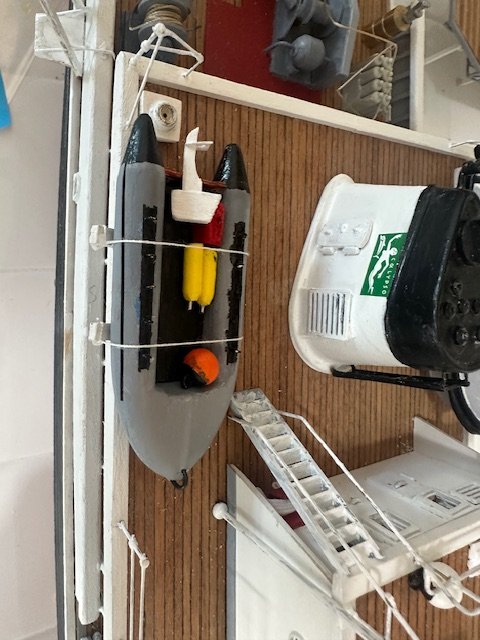

Made the cradles for the Avon dinghy and the small power boat tied them down.

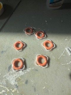

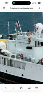

Working on the life rings. I noticed in the Calypso book that the life rings did not have ropes extending out the four corners.
The life rings supplied with Calypso I see are used in many of Biling's models. I clipped off the rope features and will repaint and make some metal clips to support the life rings from the railing.
Also working on the "Disposable fuel tanks". I found out what they were from the wonderful schematic in the Cousteau Calypso book.

Thankyou Mark. Funny, that was a typo error. It was supposed to say "did not have". I fixed and edited the comment :0)
Love the photo you included and will use it for detail. The picture I showed above was small but pointed out that there were no loops of rope around the life ring.
I see the colors on the life ring, like many other things on the ship, changed over the years.  Merry Christmas.
