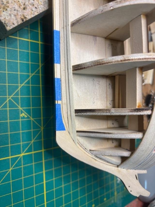

Quick question on the batton line vs. sill wood.  I've looked at two different WIP sites and see two different processes.  So I need another explanation or clarification for putting in the sill wood. I saw one person seemed to put his sill touching with the batton wood. But for my build, that seemed too low according to the middle cut laser line on the wood that makes up the gun whalls (SP?)  As seen in these first two pics.
But when I read the instructions, or at least thought I read them correctly, it seemed that the top of the sill (SP?) should line up with the middle laser line and site at the same level as the rib that crosses over the FB board.  As shown below.  It would seem that the batton wood was really in place to make sure the ribs form a nice line for lining up the ribs and curvature for the hull.
So which version is correct?  I'm leaning towards the sill wood should line up with the middle laser line. When I hold a piece of wood where the top of the gun port would go, it seems to make the required 15/32 measured opening.  Opinions / suggestions?

I think the idea is to place the top of the batten along the middle laser line then check for any weird bends, adjust as needed (and as little as possible) to get a fair line then mark the bulkheads where the top of the batten touches them (the batten can then be removed). That line will be where the top of the 3/16" high sill pieces sit. Doing it that way ensures that the top of the sill pieces sit as close as possible to being 3/16" above the transverse parts of the bulkheads which the deck planking will sit on. If they do, then the stacking of the 1/16" thick planking, plus the 1/16" thick waterway, plus the 1/16" thick carronade swivel brackets (pg 46 of the instructions) will leave the top of the swivel brackets even with the gunport sill, thereby centering the carronades in the gunport and level with the deck.
That's the theory anyway, for what it's worth.

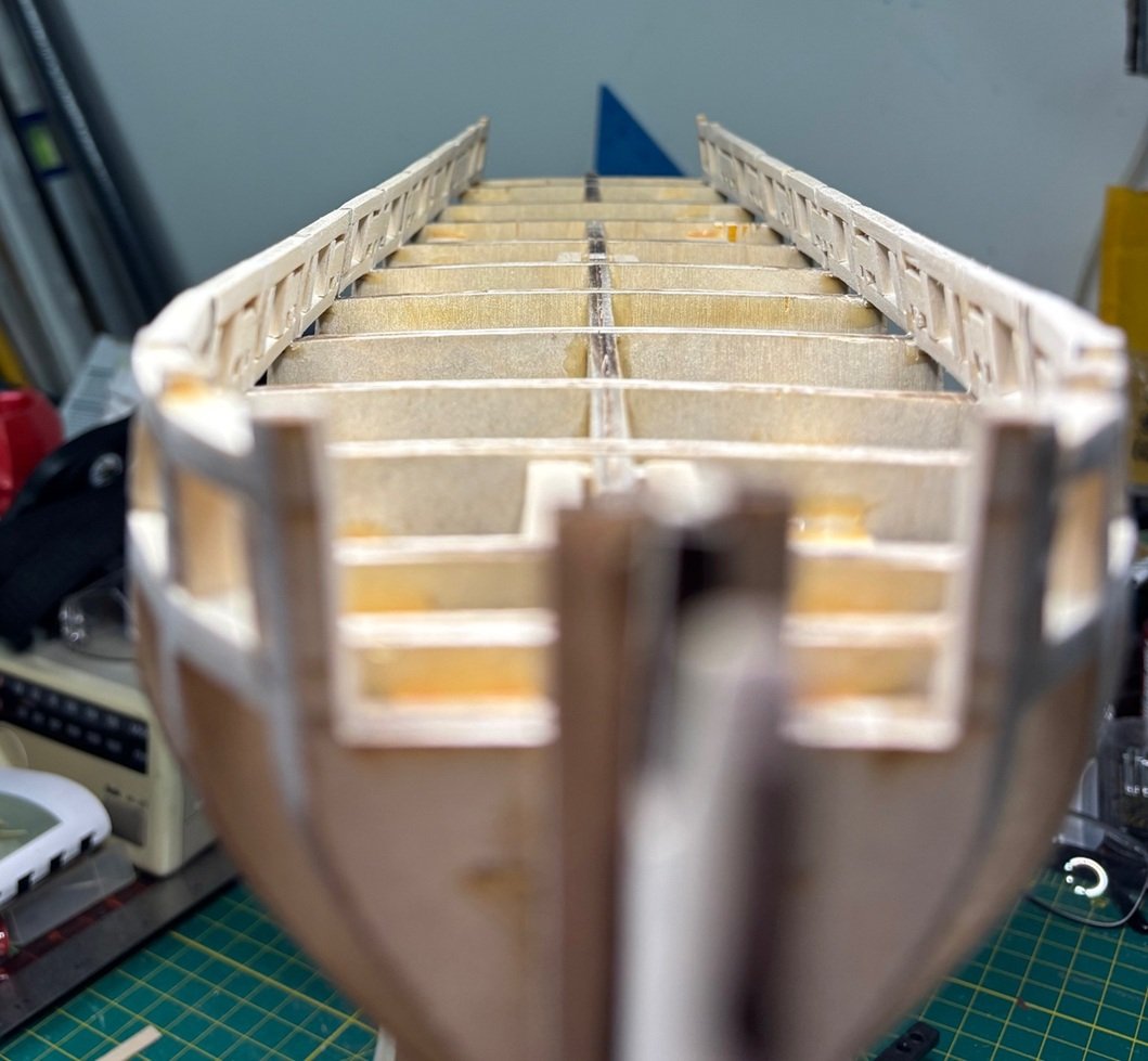

Okay, here's a warning!  I thought my bulkheads were rather straight / perpendicular to the false keel, but apparently, three of my bulk heads are not. Not a big deal when putting in the top and bottoms of the gun ports. Buuuuuutt, when you are trying to make sure the gun ports line up across the ship from each other, while putting in the side walls of the guns, it makes a difference.  So, I had to go back to the last properly lined up bulkhead and measure from there. Used the nice big prints to do the measuring.  The instructions want you to cut out gun port sacrificially paper for this, but since those three didn't glue in properly, that trick wouldn't work.  Took a little extra time to get both sides lined up; but I think I got it.  Luckily it was only 3 bulkheads, but it still made for extra work. We'll have to see how the sweep ports line up next.  So, I used a strip of wood that make up the gun port sides and basically eyeballed it.  But only after careful measuring.  Belts and suspenders.  See pics below.

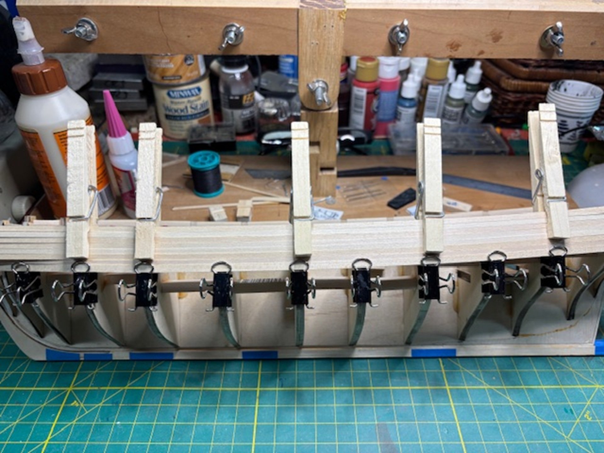

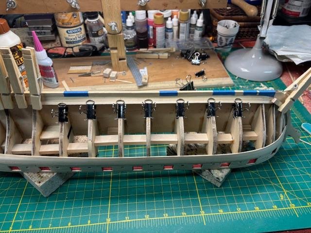

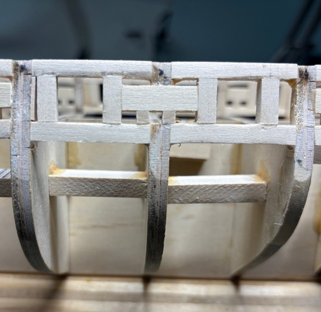

Okay, finished the carronade and oar port framing.  Took a bit longer than I expected but it's done. Got a lot of wood sanded and cut off the framing pieces.  I don't have a lot of advice as I finished this chapter.  My biggest advice is to read all the way through the chapter to make sure you know the dimensions of both ports.  The instructions didn't give you those until almost the last paragraph.  I also made a jig for each of the ports, so uniformity was met.  Without further ado, here are the pics of my work.
The instructions said to cut out this rib but I decided to cut and sand just enough so it would frame in the top of the oar port.  The instructions want you to completely remove it and leave it free floating.  I thought this would make for a stronger frame.

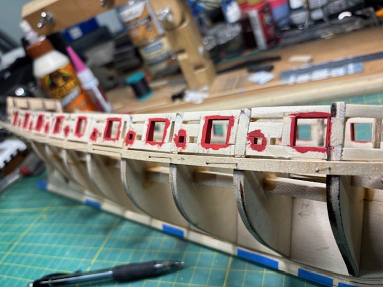

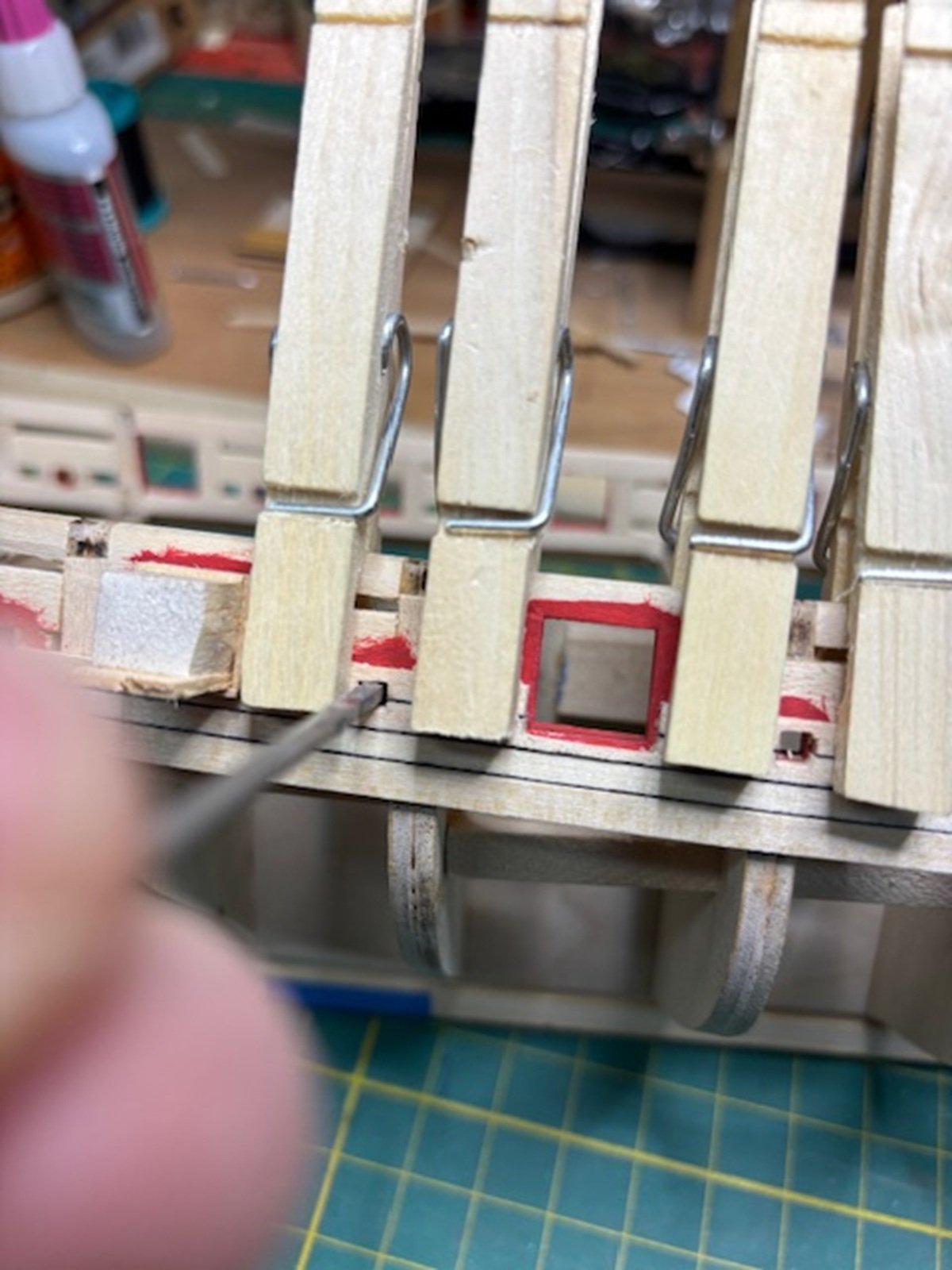

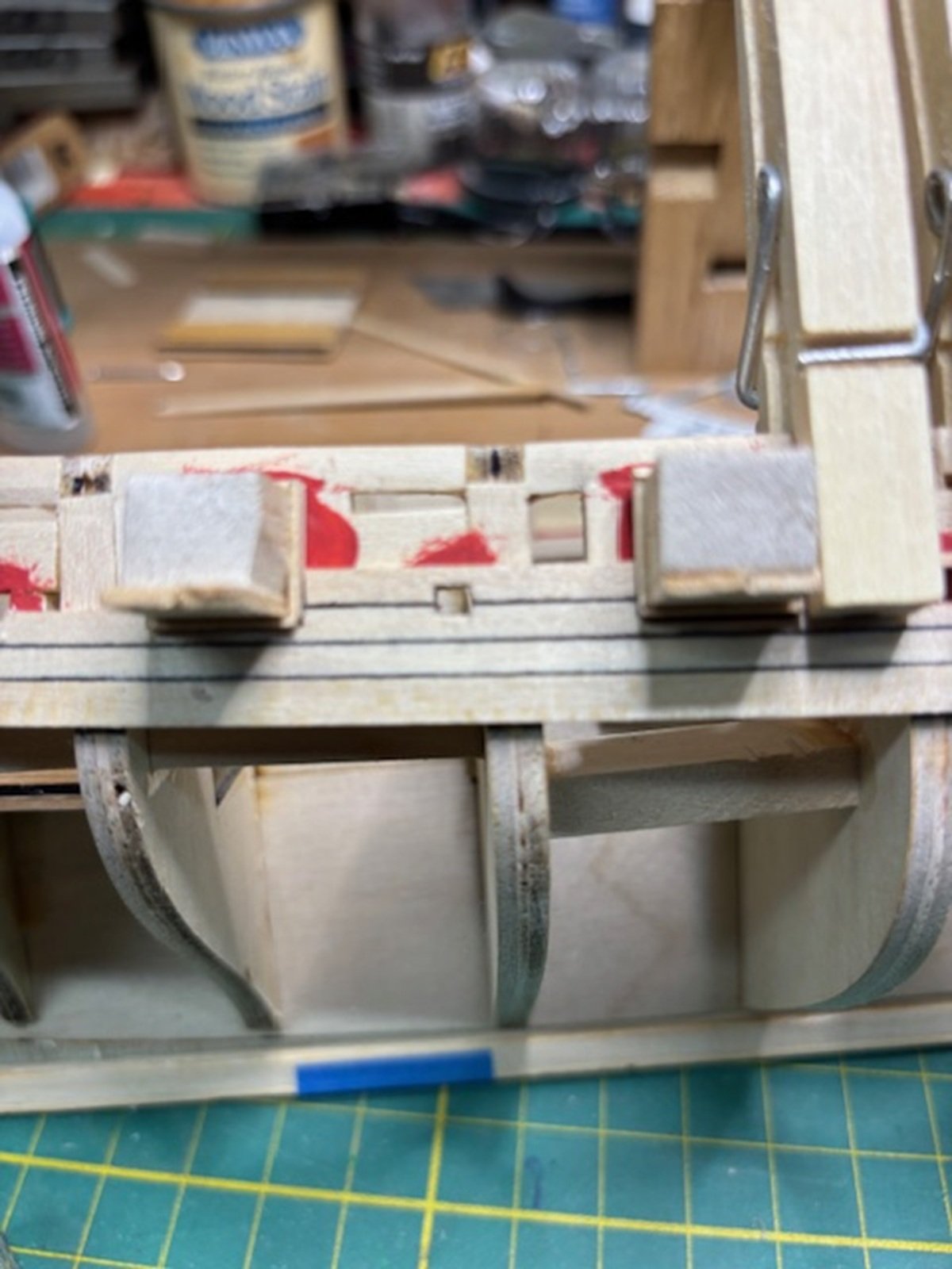

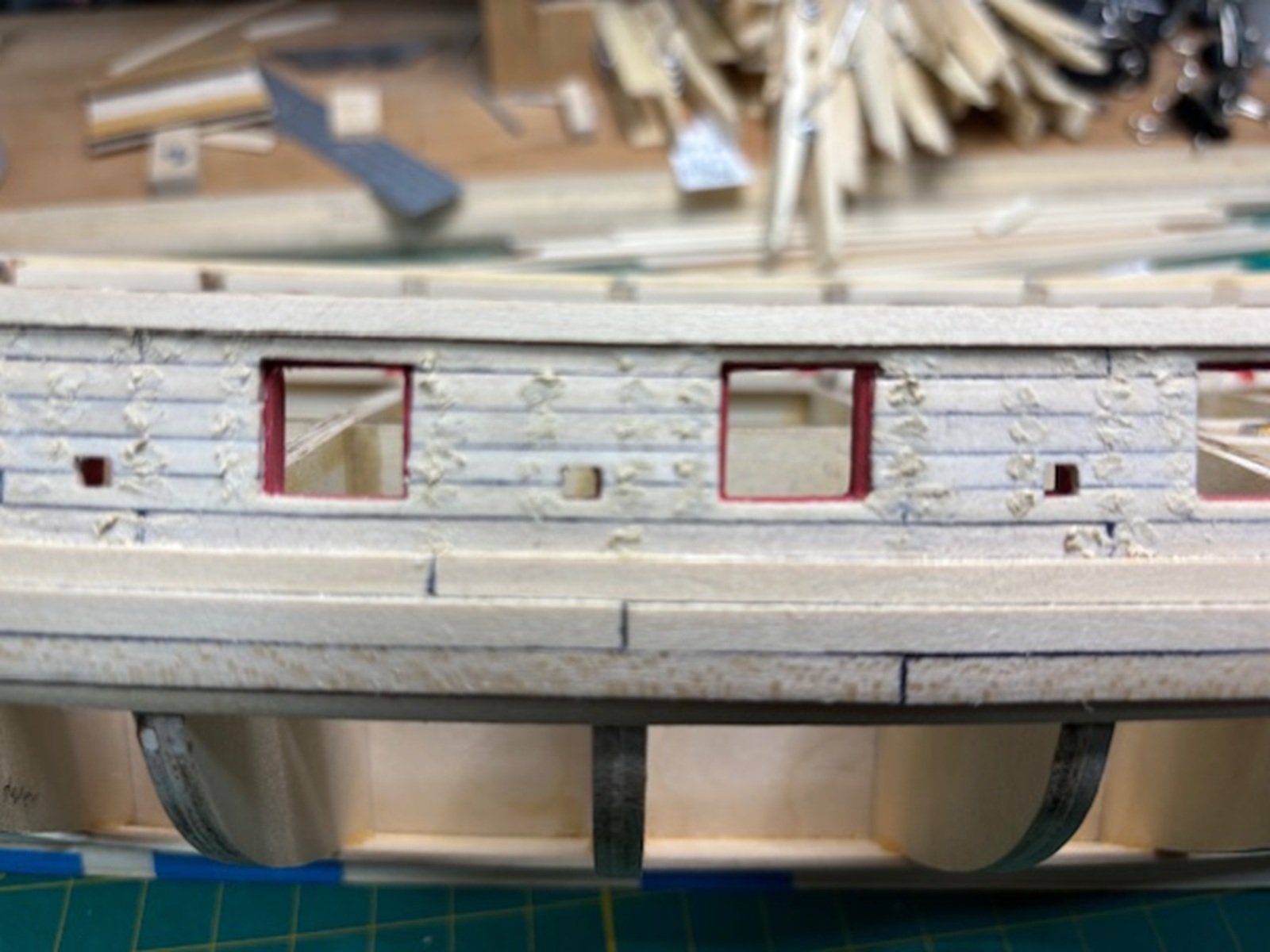

Decided to post this work a bit earlier as this chapter is very crucial to the model.  Got the ports painted red.  I did the Batton lines marked, then I used my plank holder clips to hold the batton in place as I tried to fit on the 7 gunwal planks.  I think I nailed it as the 7 boards fit right to the top of the ribs as they should.  Either I got luckier than I should be or the building skills are coming back after my hiatus.

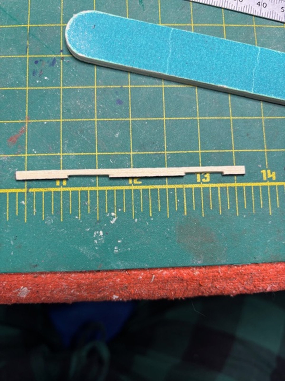

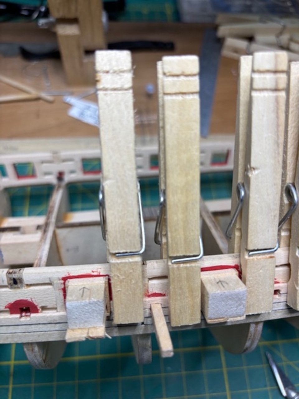

Started the wall work around the ports.  I created a jig, (Idea from another builder) to put in the gun ports with a 1/32 frames so as to make the cannon ports the appropriate size and take a lot of the guess work out.  I think the most difficult plank was the ones at the bottom of the gun ports because not only did you have to notch out the gun ports but also the oar ports.  That one plank was definitely the most difficult.
Following are the pics with the jigs, the plank notching and sanding.  I know you see a large nail file in one pic, but I didn't use it.  I ended up using my smaller metal jeweler files. Let me know if you have any questions.

Well, I can't take credit for the idea, it came from redshadowrider.  My jig is not as pretty as his, he's far more professional than I am, but the concept was the same.

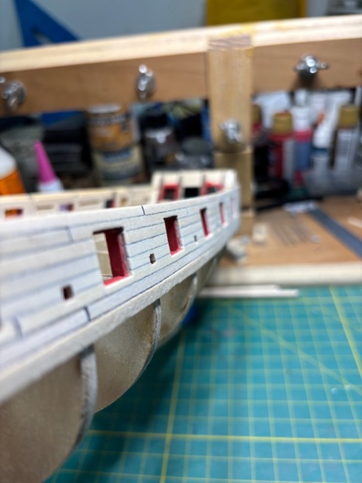

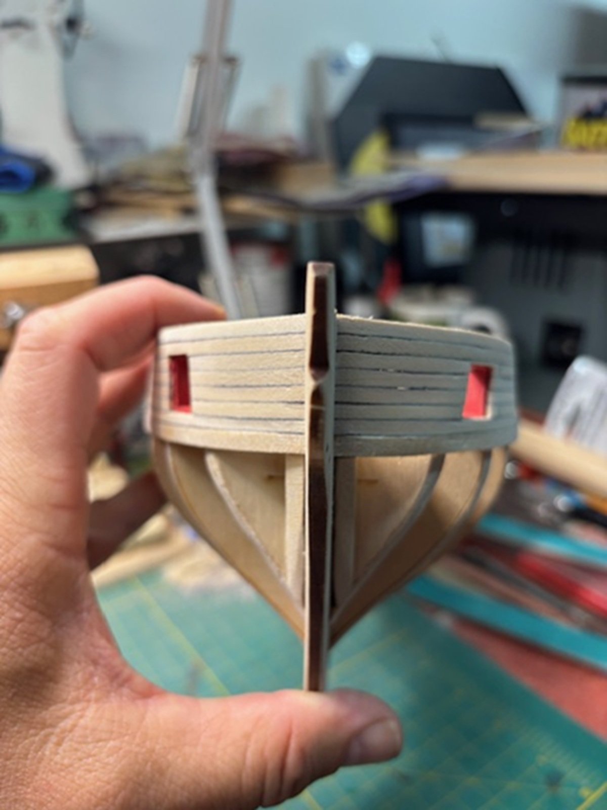

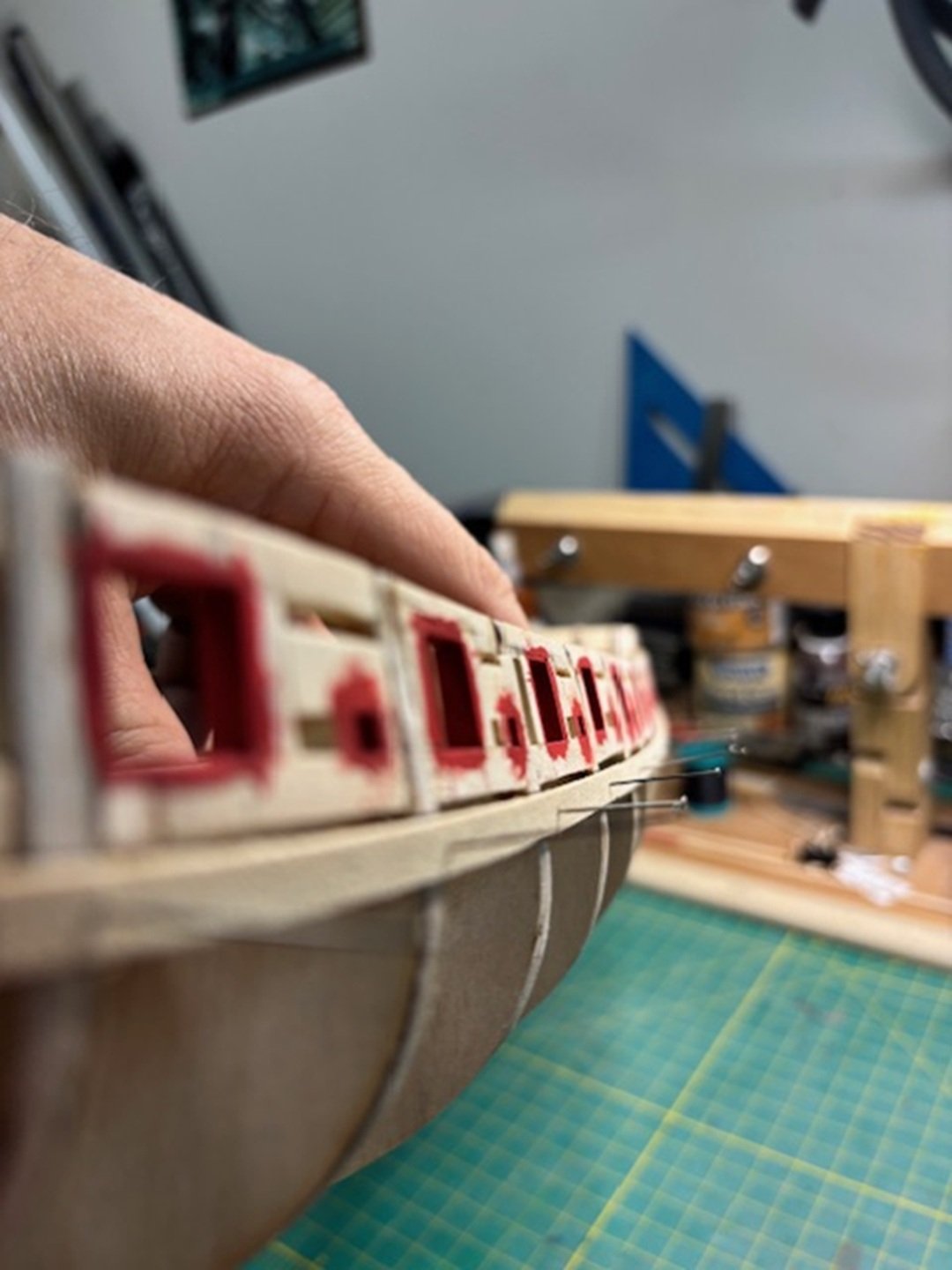

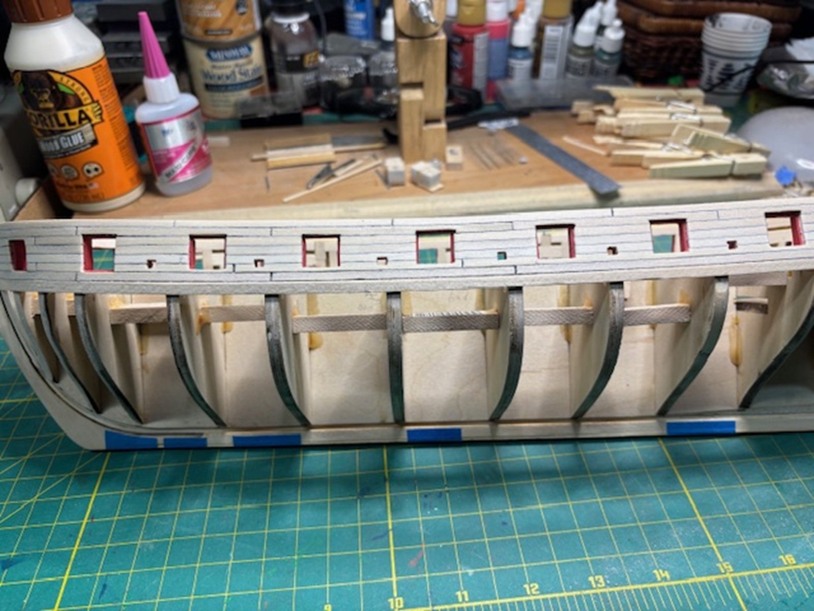

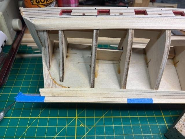

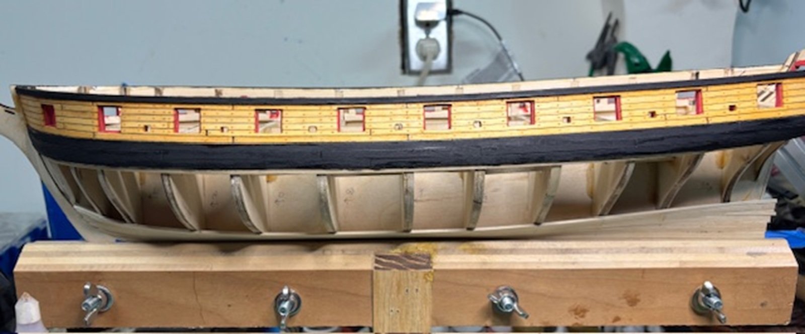

Making progress.  Got the exterior gunwales completed.  The cannon port Jib definitely helped.  Still had to do a little square filing, but not a ton.  Then a little overall sanding to even everything up.
Looks like my planking lined up better than I had hoped.  Happy with that.  I really don't have much wisdom to pass along in these steps.  Simply follow the instructions.
and the sides with the slight edge on each cannon port to allow for the port doors to close well.

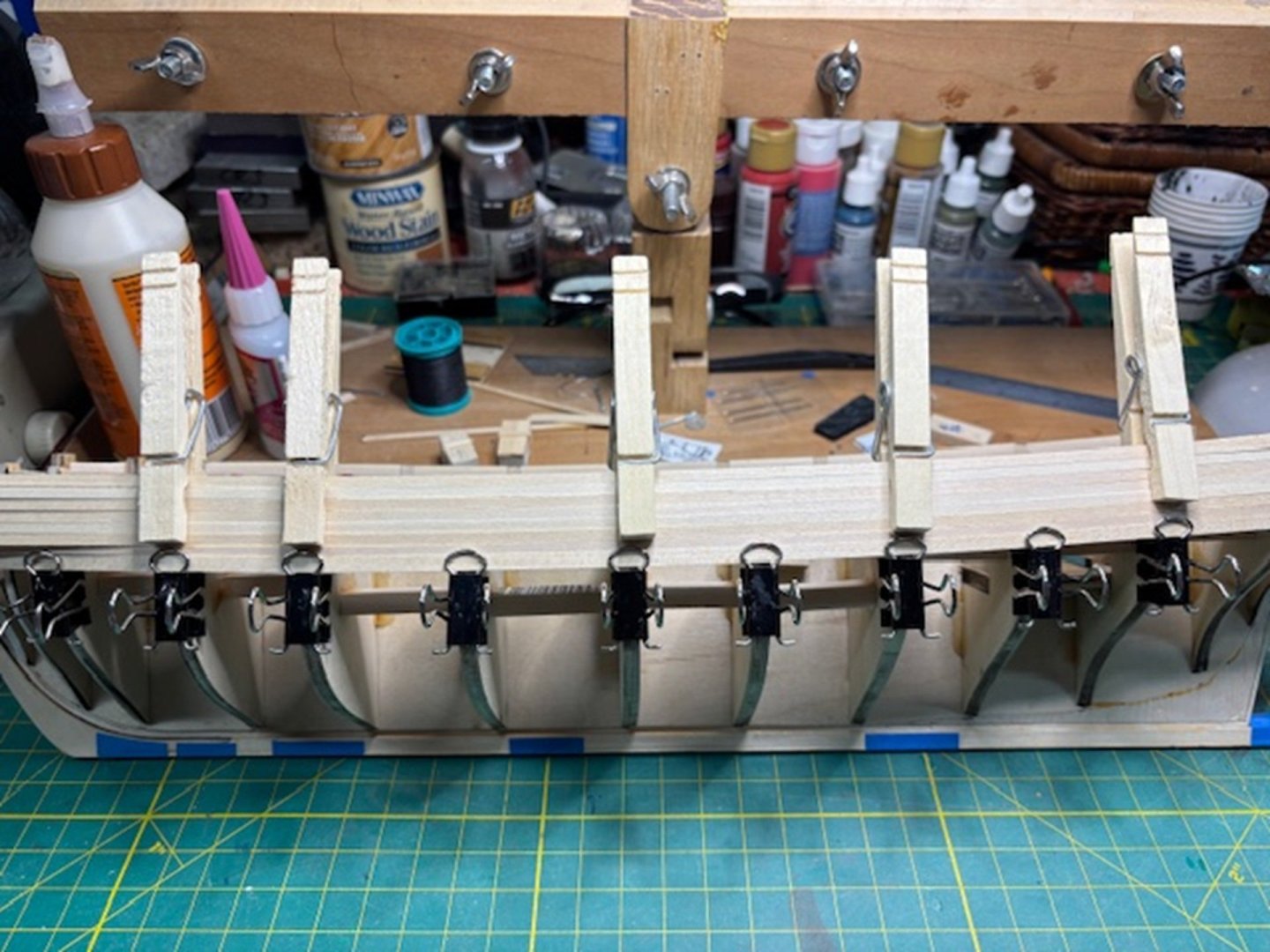

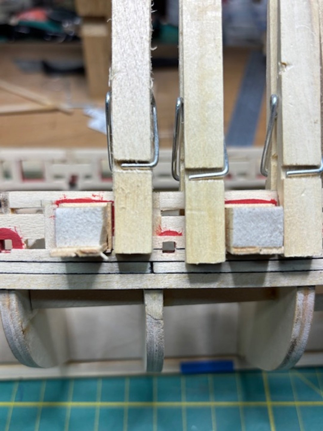

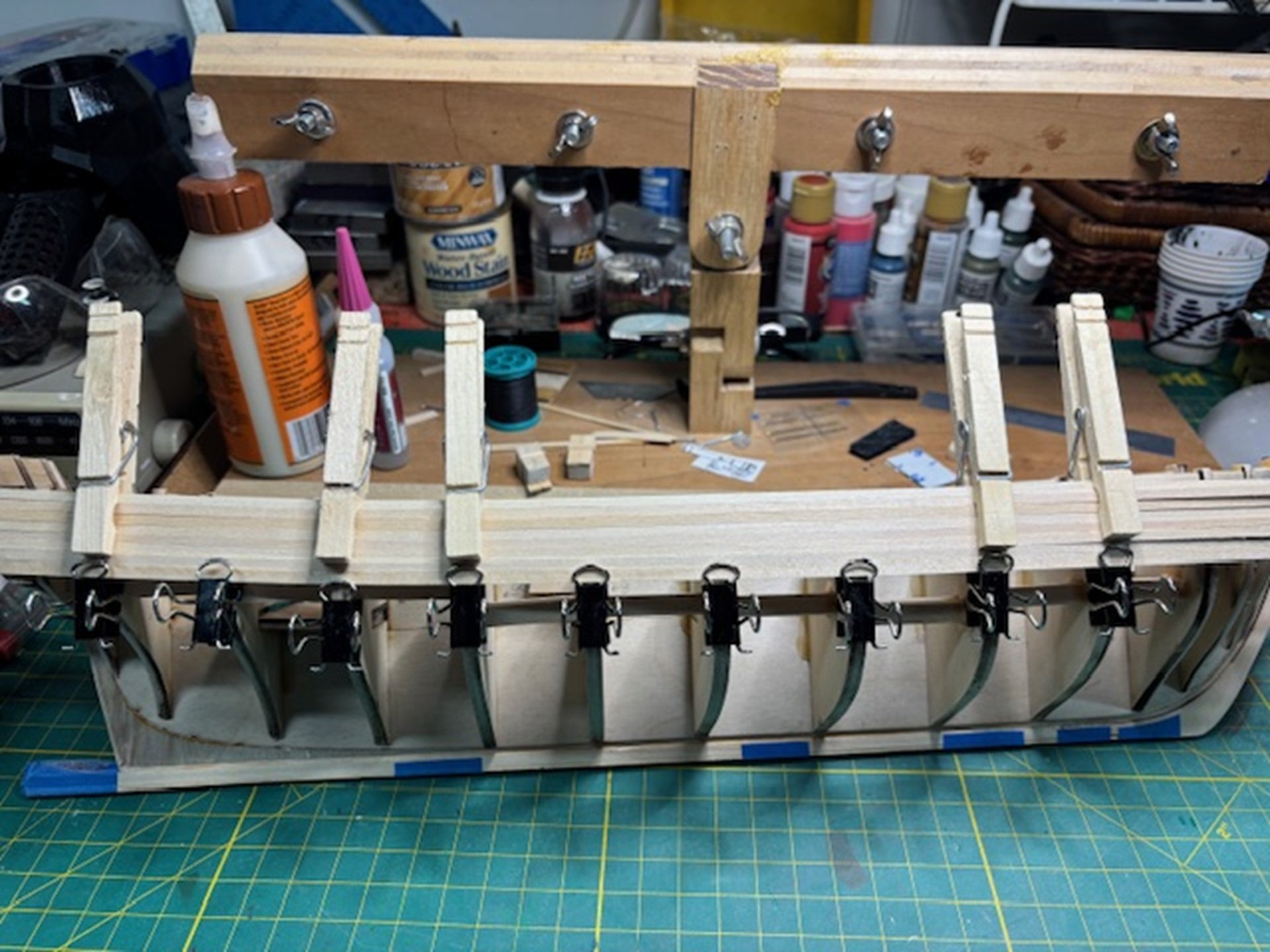

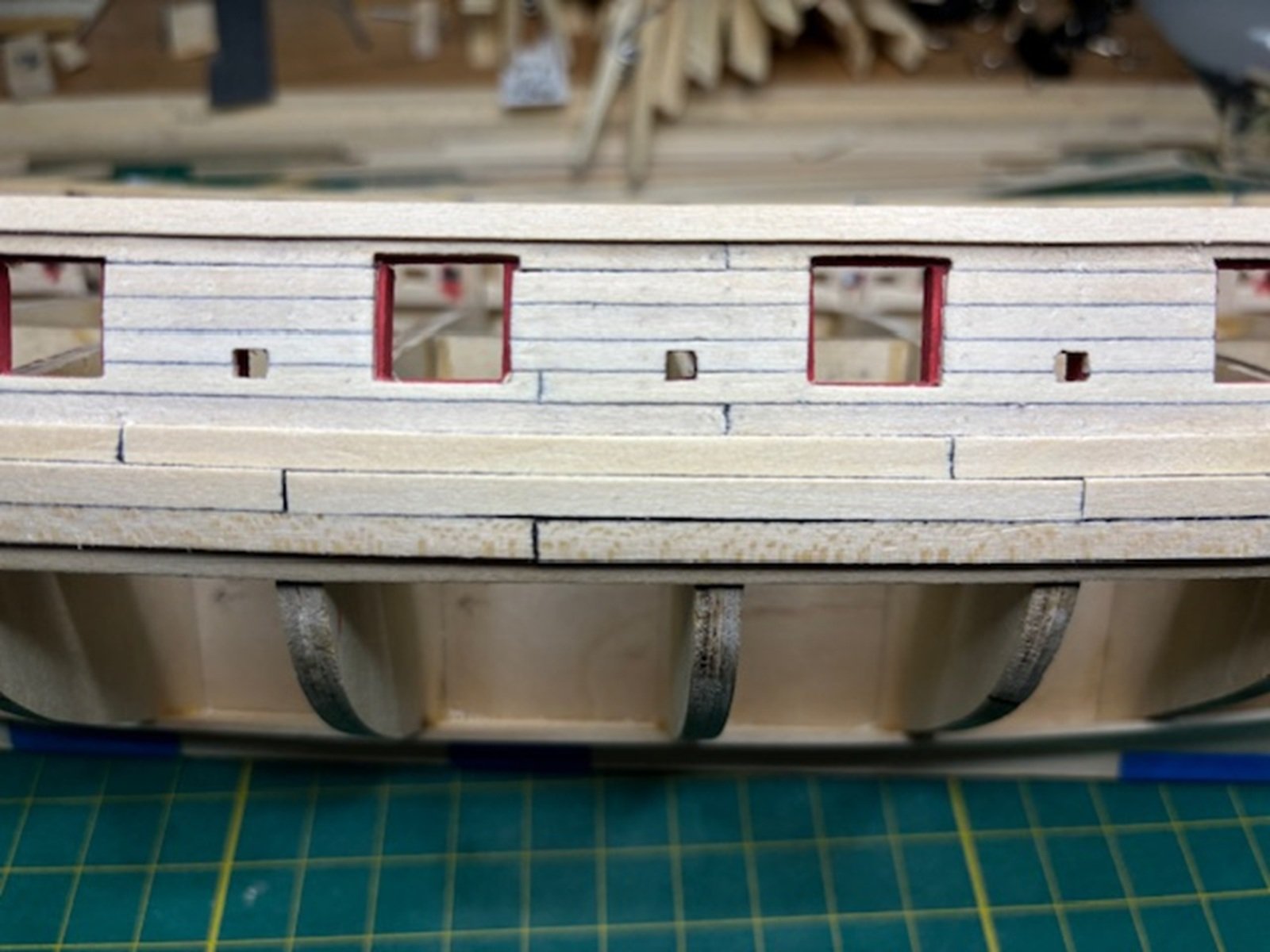

I keep moving forward.  Thought I'd add this one post while working on the planking.  Not sure if others to this, but I have found that as the ribs start angling down to the keel, right where that angling starts, that if I bevel the top inside of the plank, that it fits better against the previous wood plank.  But that's just me.  Thought I'd share.
It's been a while since I posted.  Been busy moving forward and some personal issues.  But here is an update.  Honestly, not a lot to talk about at this point.  Simply follow the instructions as they are printed.  Keep the planks straight and don't let them waver down the line.  This is even more important as the planks begin coming into the stern area.  I've already put in some extra pieces to make sure the planks stay straight.
These bottom planks will get sanded once I finish the rest of the planking process.  No need to do it now anyways.
You will note that now that I've put in the double plank, you will now start to cut them as they would on the real ship.  Remember, the planks underneath are a single piece of wood.

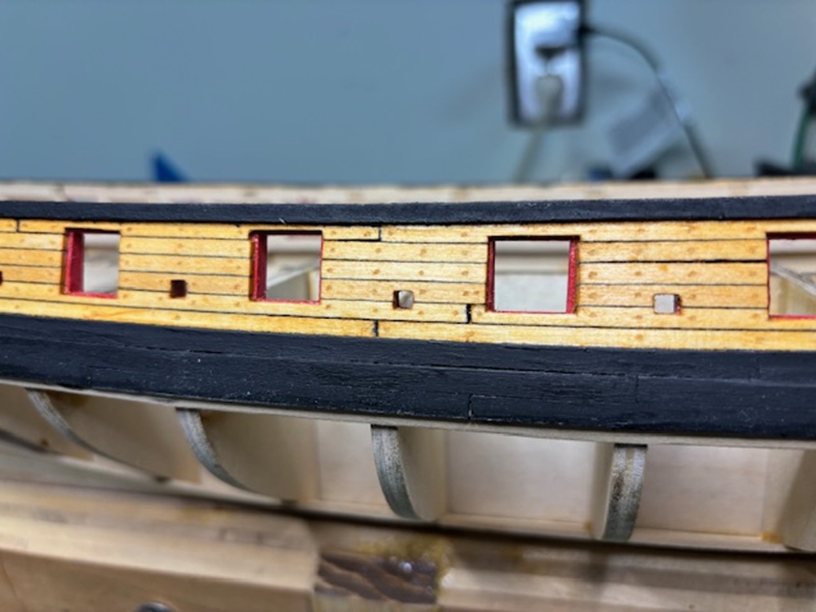

Finally got to the tree nail portion of the instructions.  I've never done this before, so I was a bit anxious and a bit excited. Pin drilled 480 holes of 0.025 diameter drill bit! Yeah, had to stop a few times to shake the cramp out of my thumb using that pin vice. I used Dap plastic wood, wood filler, even though the instructions said to use Elmers.  Which I couldn't find.  But given the age of the instructions, I'm not surprised.  The Dap is a water-based silica wood filler. As you can see in the pics below, the natural wood color really matched the wood used for the model.  I was a bit concerned, after I sanded it, that due to the color closeness, the staining process would show no difference in color and thus I wouldn't be able to see the work I did.  But I'm happy to say that there was enough of a difference in the color that it is seen but not over the top.  I also did not use the stain the instructions recommended.  When I did a test stain on some scrap wood using the color recommended, it looked horrible, so I went with Varathane summer oak. I think I got the "Ochre" look pretty close. Not the same as painting, but it's stain.  The two are much different. Hope this helps you in your build.

Great stain color and your treenails look just right for size and color. Just to double check - the instructions call for drilling the treenails with a .55 bit but you used a a .025, is that correct? They sure look right.
