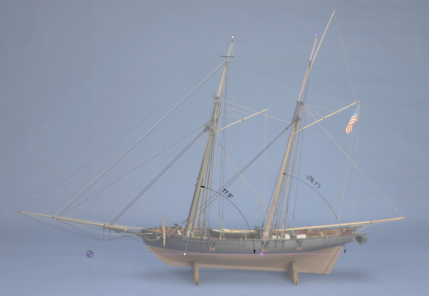

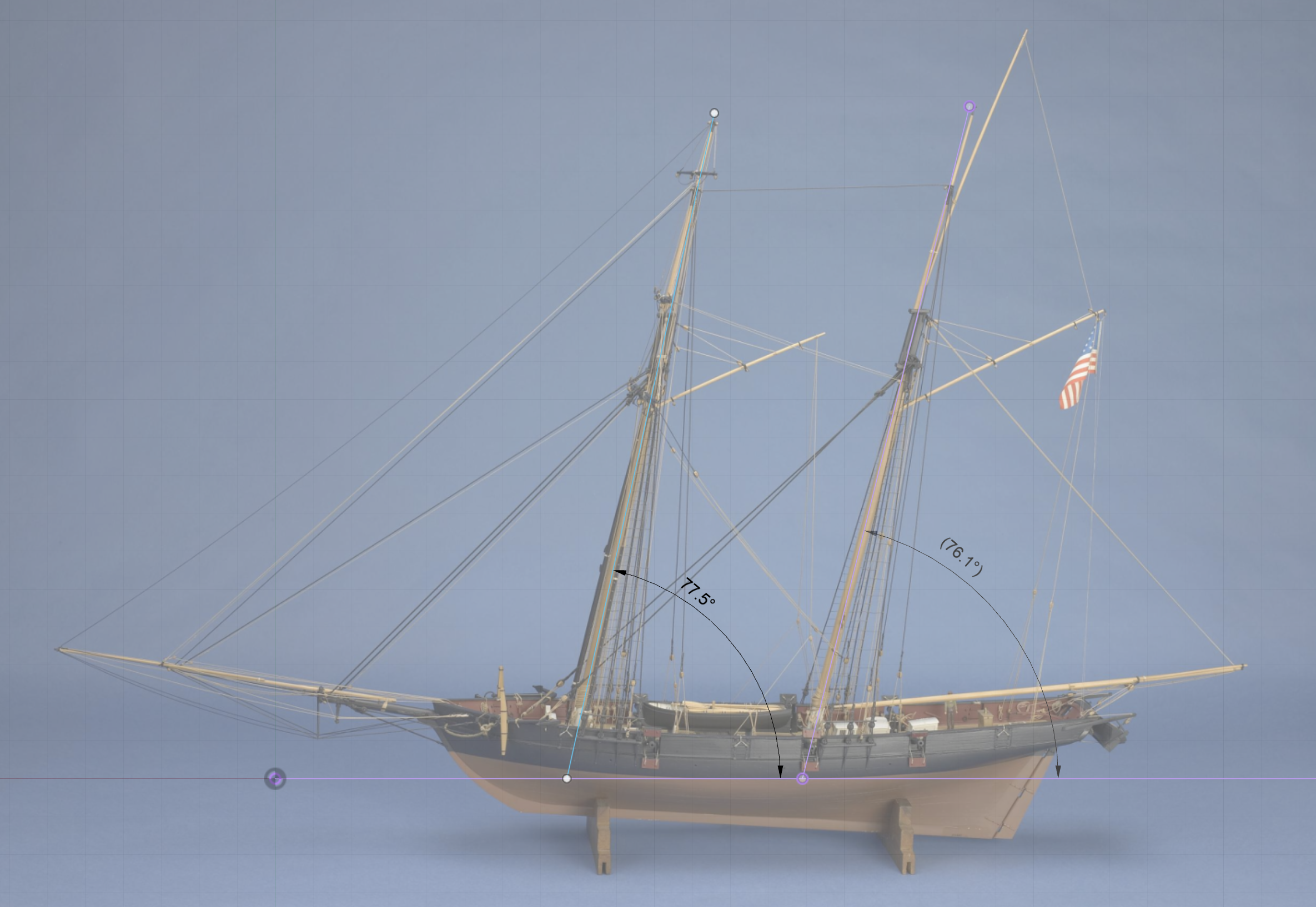

I have been happily active in the shipyard this afternoon, images to follow later today or tomorrow. I wanted to share something with you (specifically @Dr PR and @Keith Black). I took the image in post #113 into Fusion and measured the rake angles, using the waterline just below the chain plates as a reference. Here's what I got:
Judging by these angles the foremast on this particular model has a rake of 12.5º (90º - 77.5º) and pretty much 14º on the main (90º - 76º). So, going on what @Dr PR has suggested, I will use these rake angles on my build. I am also going to rig the mast steps as he suggested here (thank you Phil). Back to the yard, I just wanted to share this. Any observations or comments are always welcome.

Mark,
Because of the angle of the photo the actual angles would be a bit different if the photo had been taken parallel to the plane of the waterline. However, they would not be much different. 12.5 degrees for the fore mast and 14 degrees for the main mast is close to the average mast rakes for Baltimore clippers. These are good rake angles.
Slight difference in rake angles are not critical - no one knows for certain what they were on the real ship. The transverse (port-starboard) angle is very important - it should be 90 degrees to the waterline, and it is imperative that both masts have the same angle - any difference is very noticeable. And both should be on the centerline of the deck, otherwise would look strange.

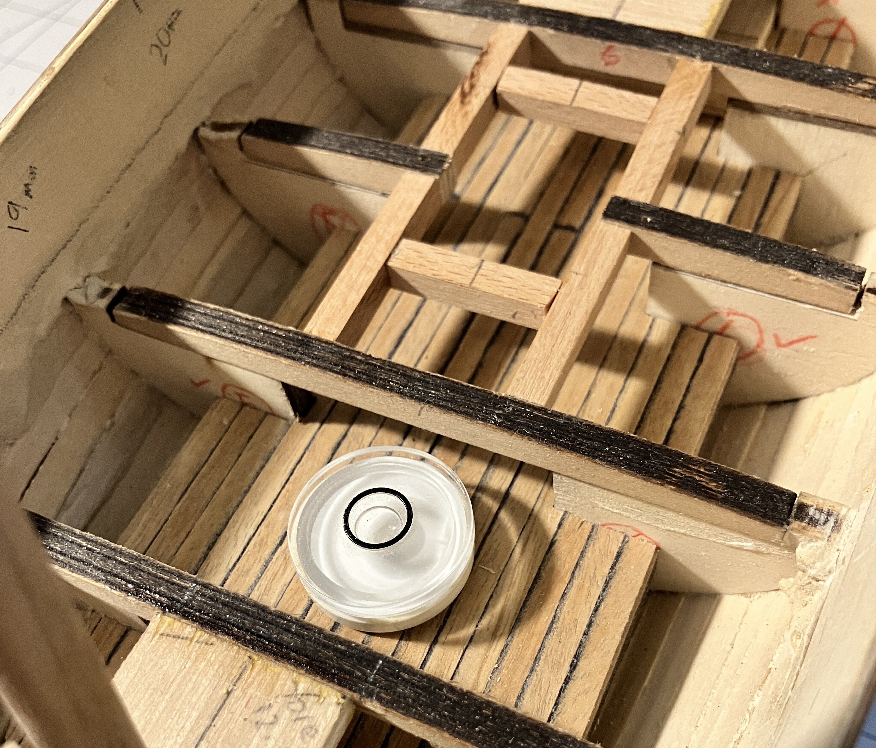

I have a list of tools that I want to add to my inventory, a laser level being one of them. I was using a digital gauge that I have in my woodshop to measure angles yesterday. It is a (magnetic) angle finder that sticks to my table-saw blade and gives precise readings when making angled cuts. I zeroed it on the shipyard tabletop and used it as a guide for the mast rake angles. The laser level will be a must for getting the masts vertical. I shall approach the treasurer about it this morning :)

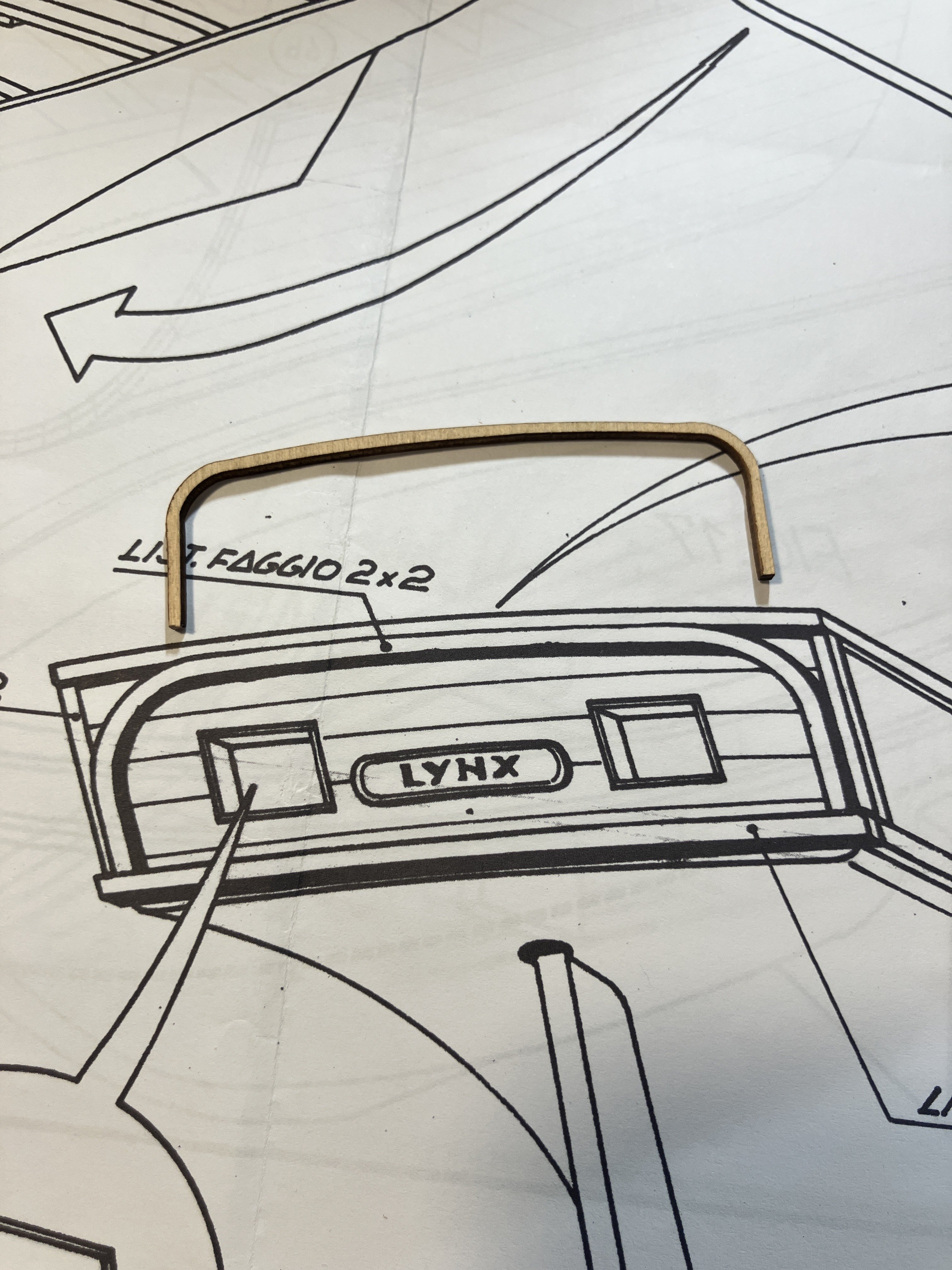

A mixed bag of items on the shipyard itinerary today. Because I am building this model as the Musquidobit and not the Lynx I will not be doing the transom as it is laid out in the Panart plans:

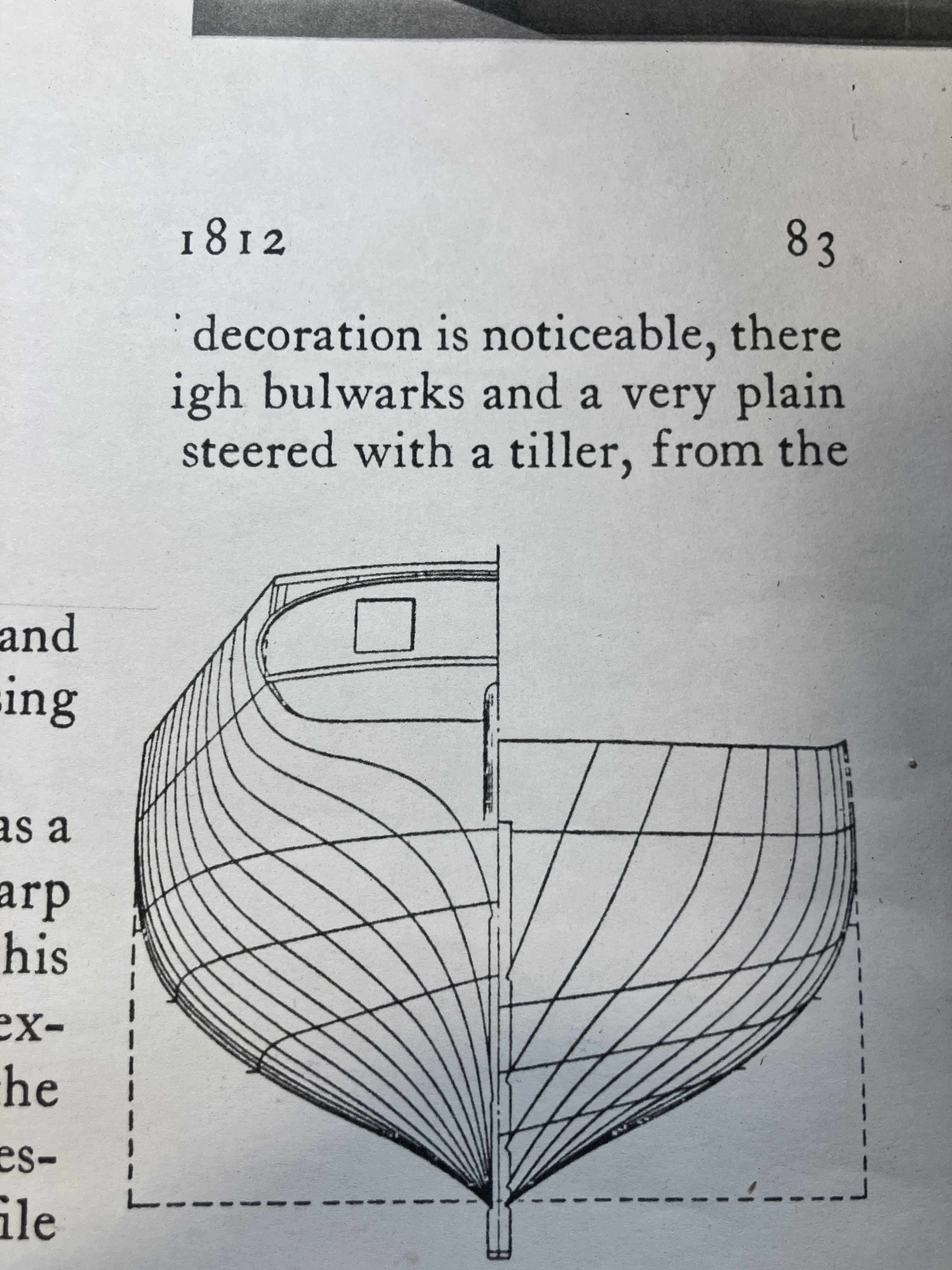

I will be following the drawings of the Musquidobit and therefore have to modify her rear end a little. Chapelle's book shows clearly that the bands on the transom were quite different:

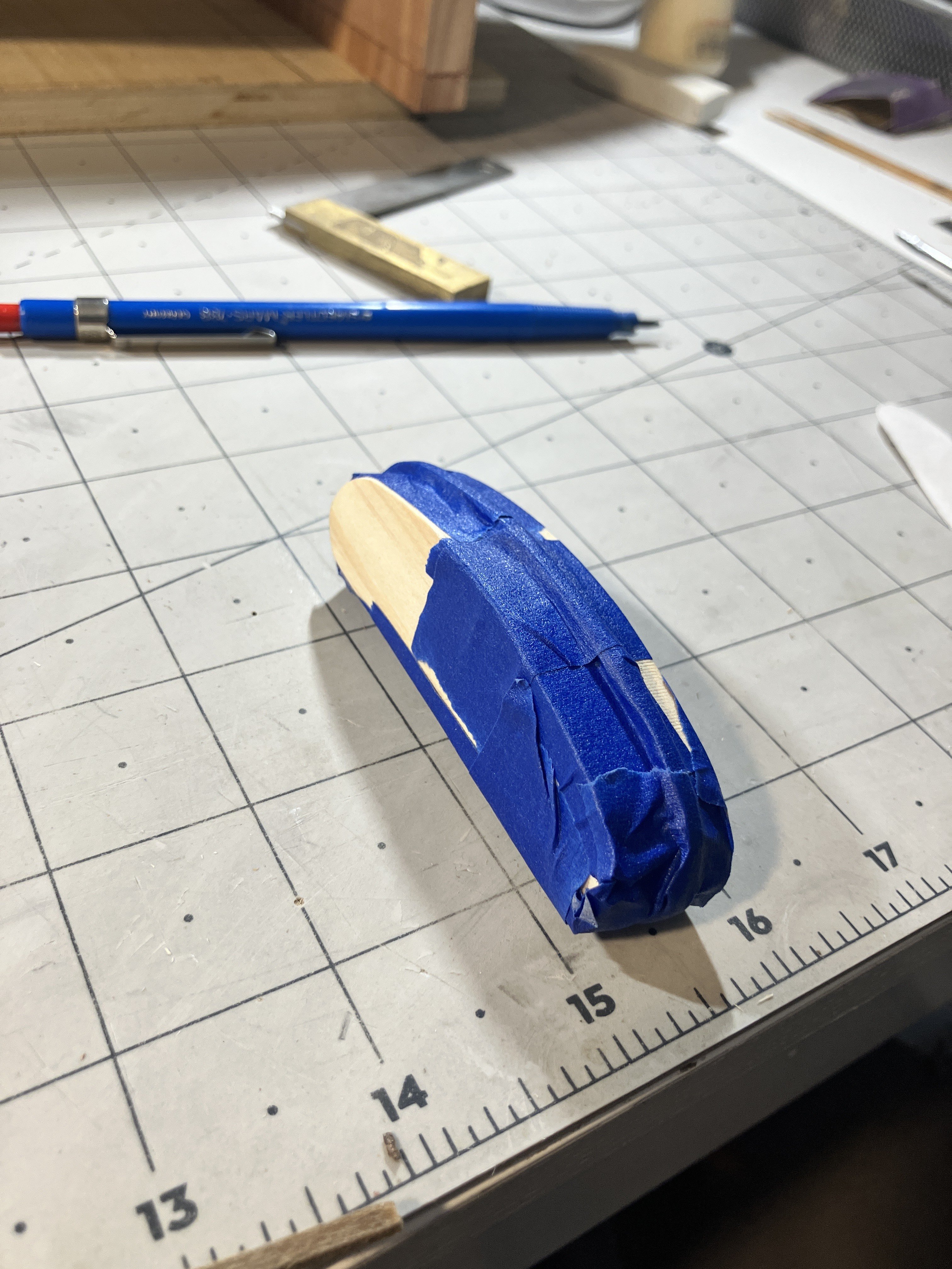

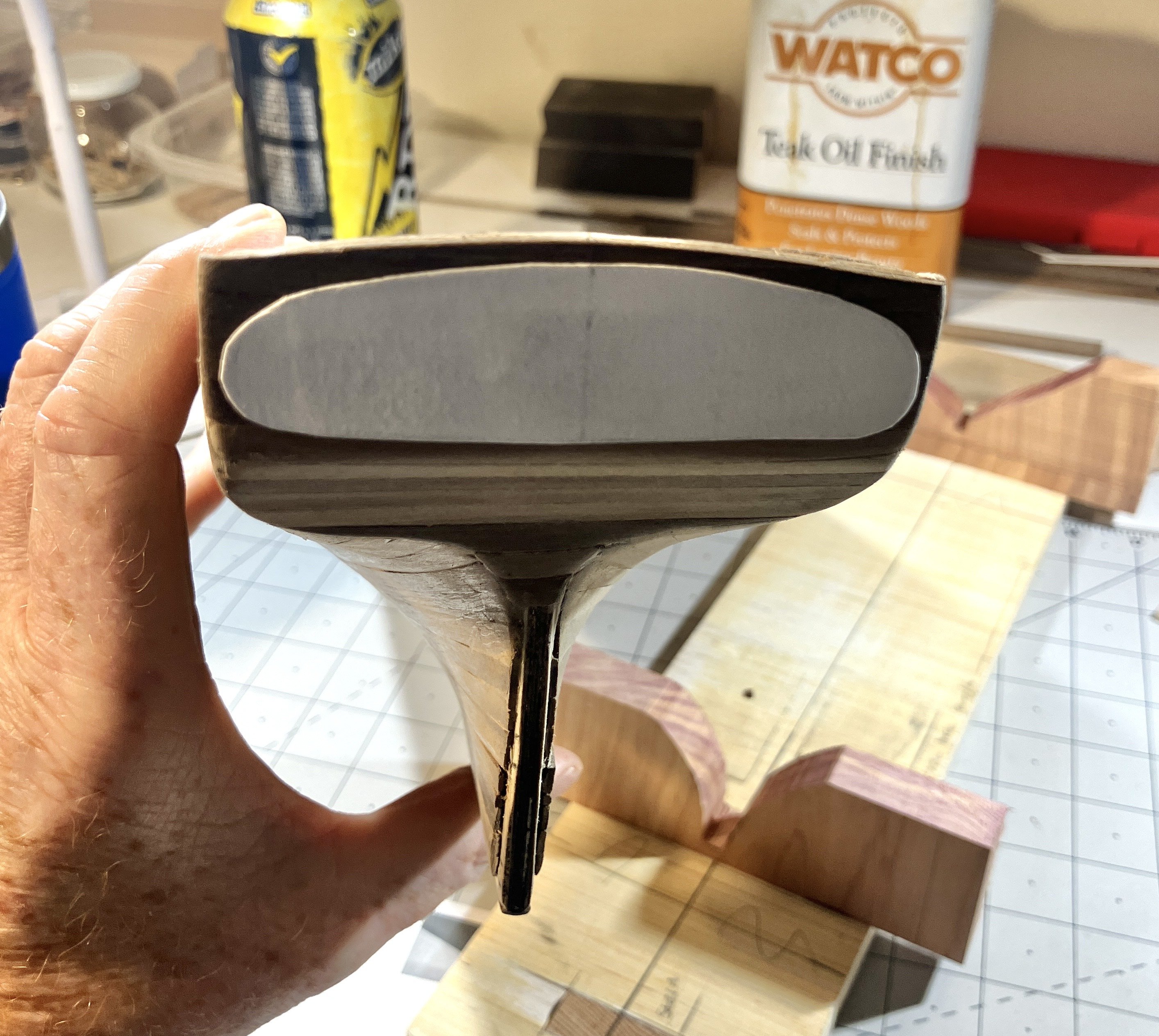

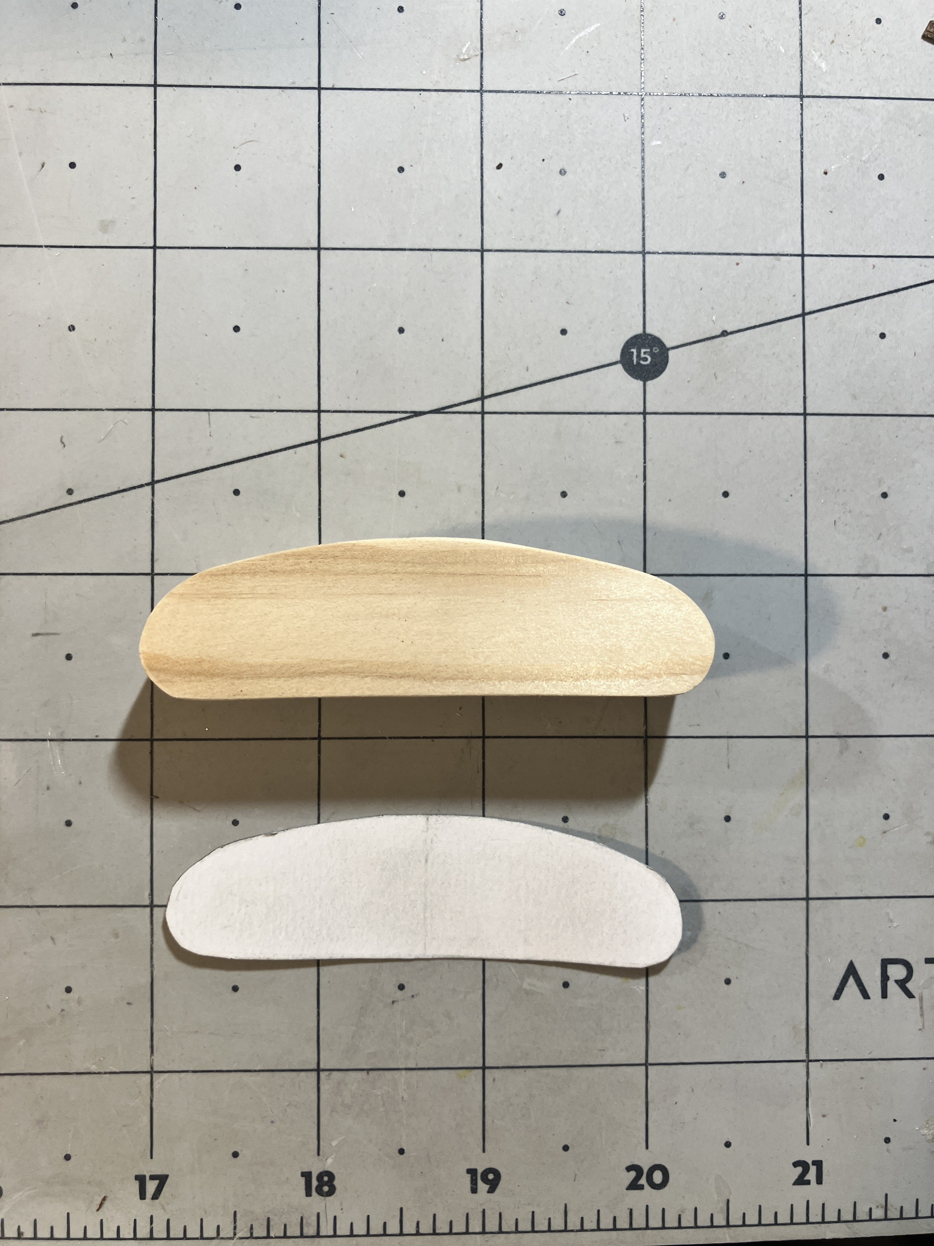

Because of this I decided to steam bend the wood to fit this (nicer) shape instead of using the form supplied in the kit. Before I could do that, I had to make a template, then a wooden form from that template that I could bend the wood around:
The strip was placed in boiling water for 15 minutes then steam bent around the form. I taped it on and will leave it overnight to take shape. We will see how it looks on the morrow:

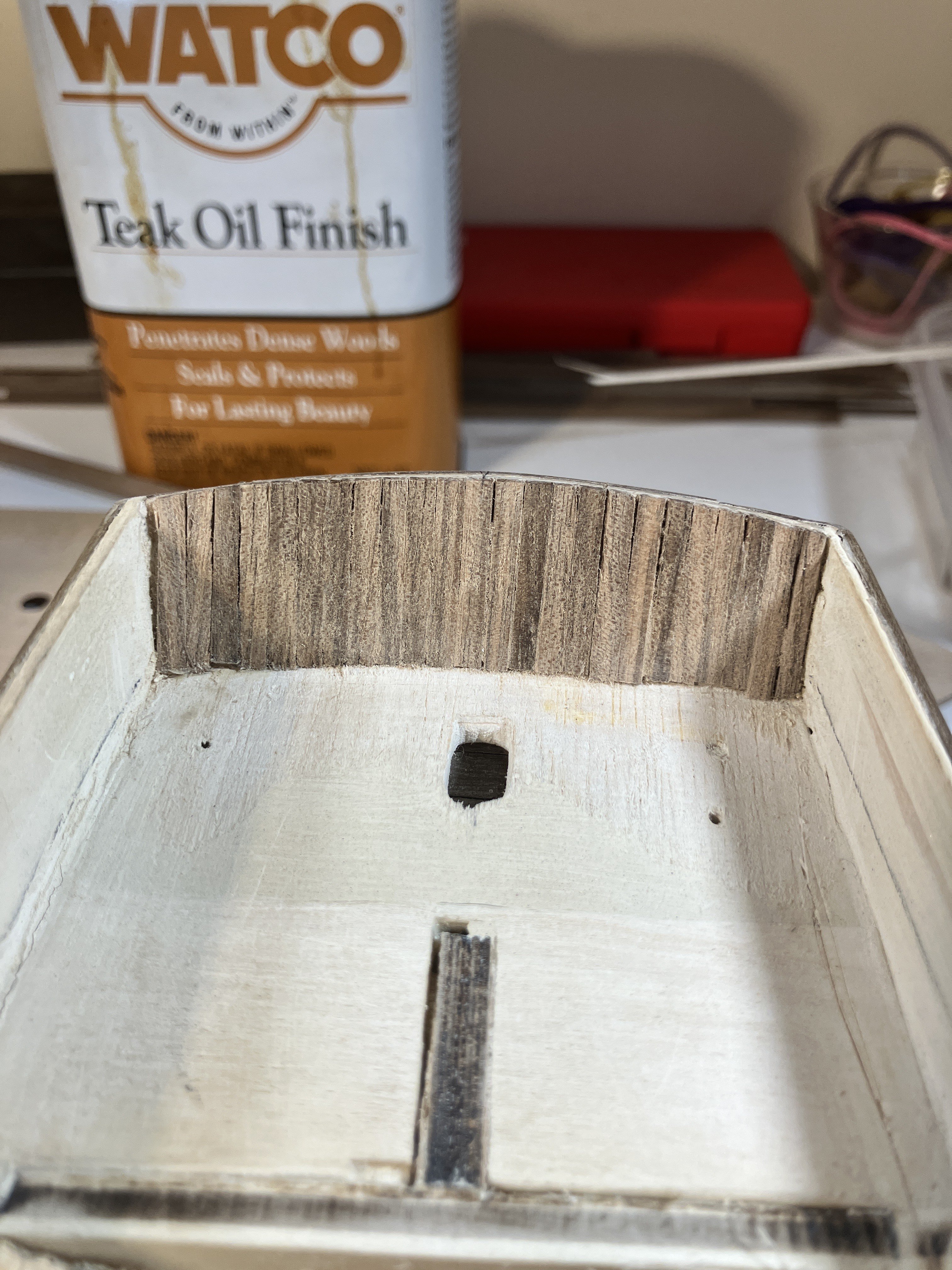

Moving on I planked the inside of the transom with 0.5 x 3mm walnut strips. These were not supplied with the kit, I am guessing they wanted me to stain some of the deck planks which are the same size. Instead of doing that (I ran out of planks on my last build because I experimented with a few of them so I am a bit gun shy), I cut some of the outer planking they supplied (which I didn't use) and glued it on. I will cut the rear gun port holes back on once the beading is fitted:

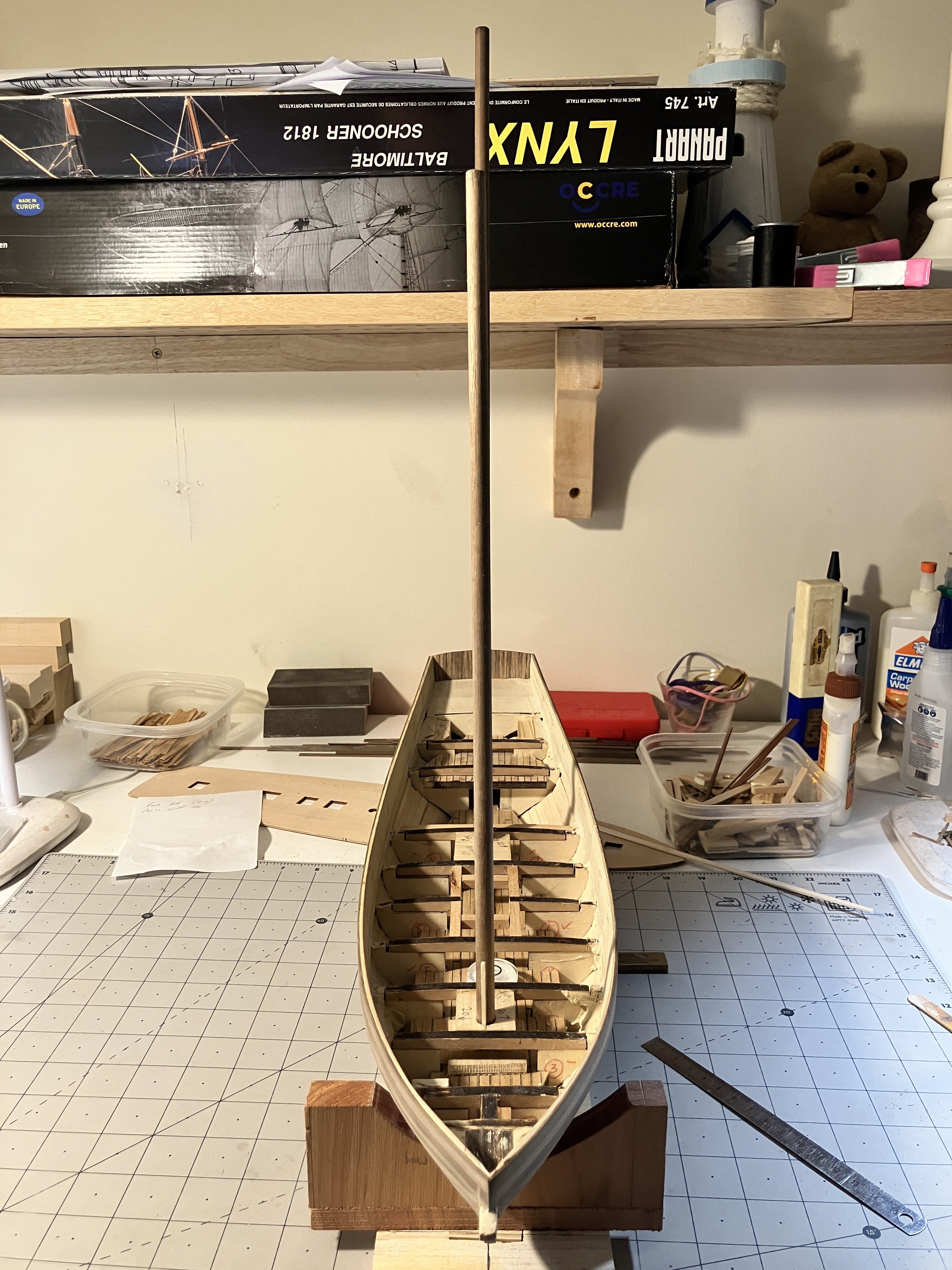

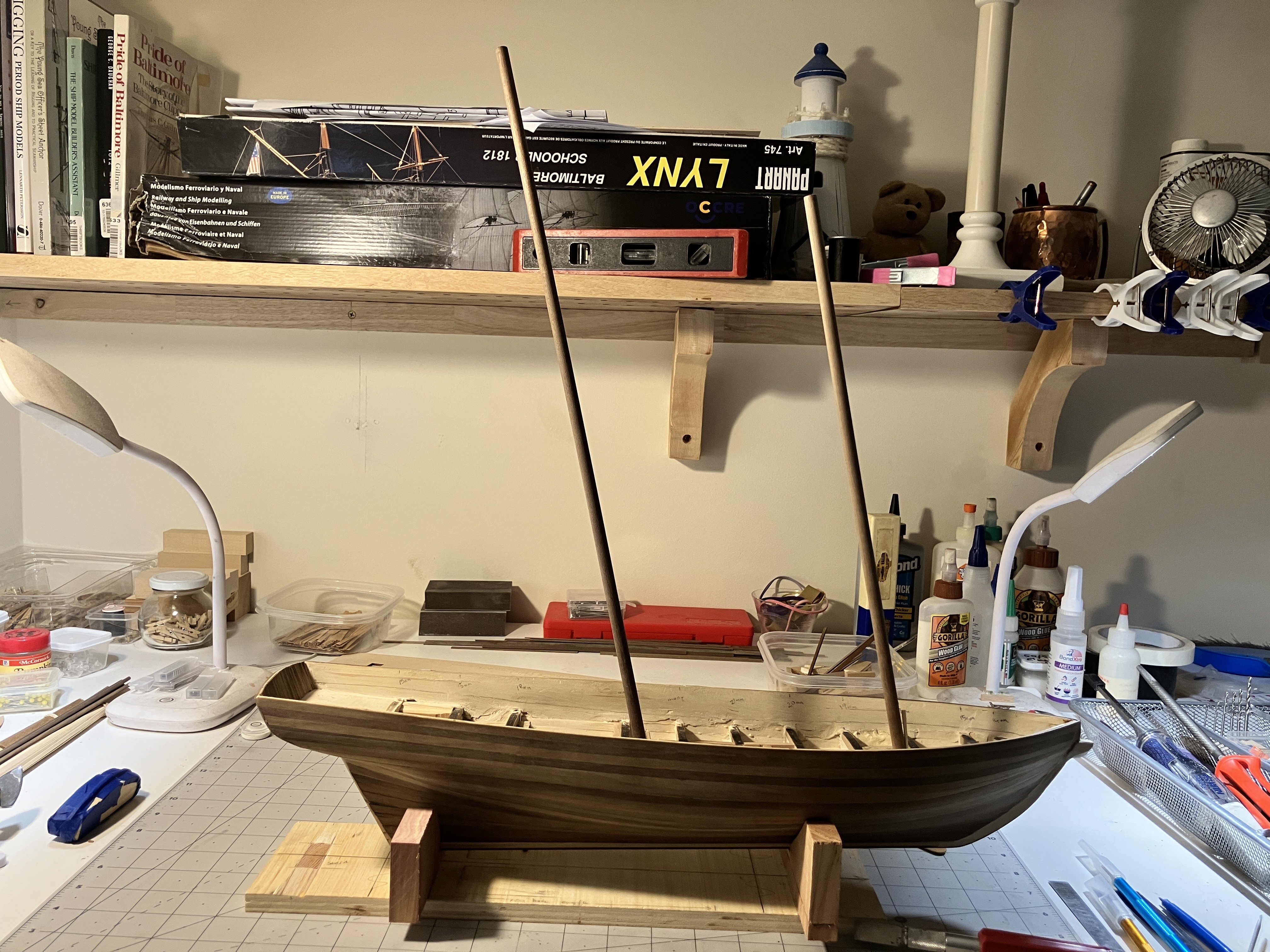

Following @Dr PR's suggestion, I mounted the plates onto the cross beams and dry fitted the masts, making sure the hull was as level as it could be. I measured across the hull and got them placed exactly on the centerline. That all went well. The masts will be glued into their final position once the deck is planked, I have a little wiggle room now (pun intended) to get them lined up in all directions correctly:

 The rake is much improved, Mark. I hated like heck saying something when you posted the photo of the first mast rake but after seeing the latest results I'm glad I did. 👍
You keep that criticism coming, Keith, and don't worry about hurting my feelings or anything silly like that. Without comments like those, how would I learn from my mistakes? Yep, keep 'em comin' mate :)

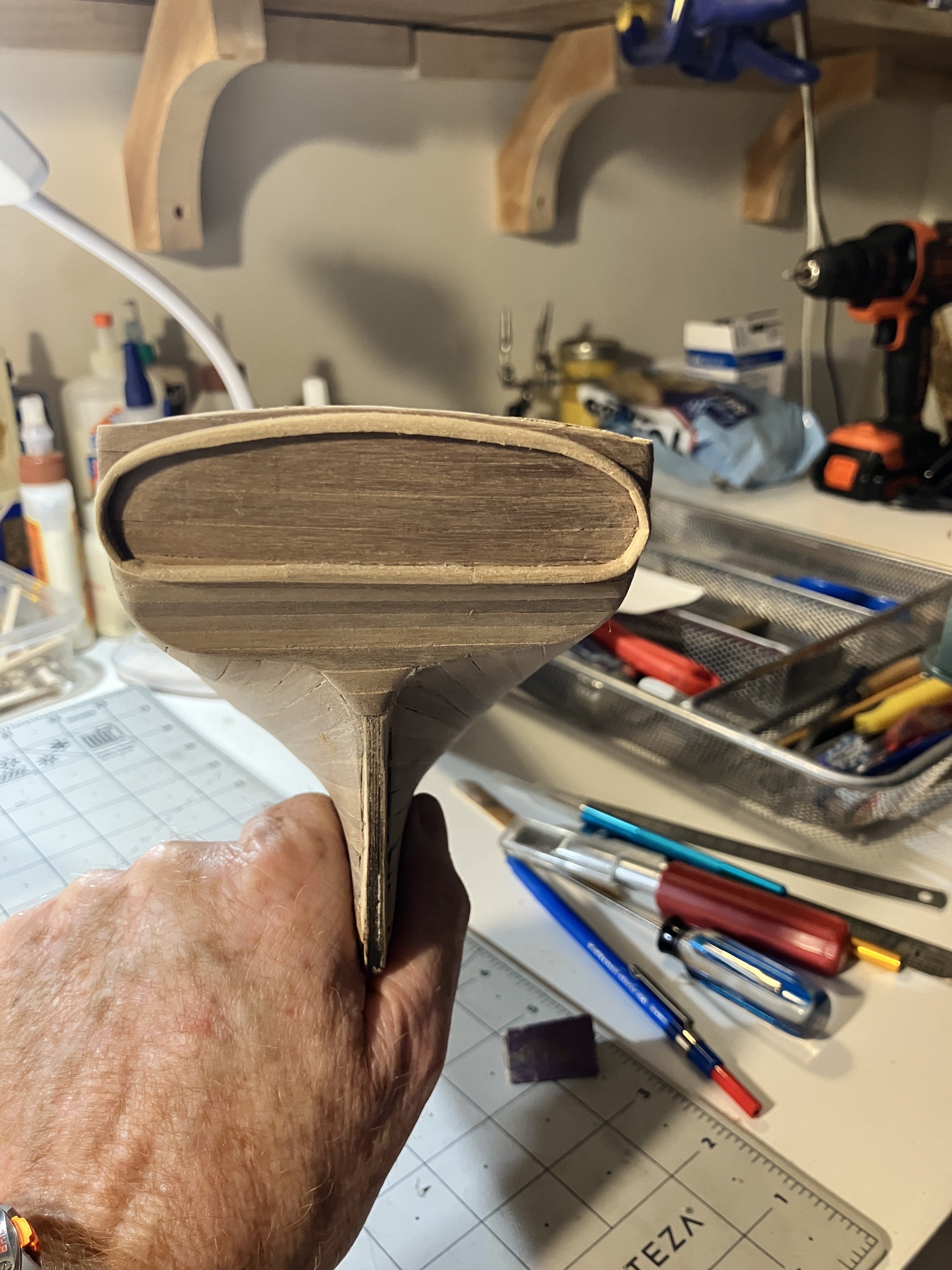

Mark,
Your mast positions look good!
It was common on ships of this period to make the transom (fashion piece) a bit wider than the hull, and with a rounded outer edge. Then a decorative piece was placed against the hull planking and the front side of the curved transom outside the hull planking. However many schooners of this period had very little decoration at the bow or stern.
Chapelle's lines drawing in The Baltimore Clipper (page 83) shows this curved outer edge of the transom extending slightly beyond the hull planking (the drawing in your post #134 above).

Yes, Phil, I noticed that too. Because I hadn't paid attention to the rear end "decoration" until now, I fashioned the transom according to the plans. It is now not broad enough to accommodate the overhang. I am not going to change anything, I will take a happy medium and get it as close to the edge as I can.
The wood bending turned out a lot better than I expected. I was truly in the mindset that this would not turn out as nice as I wanted it at the first try and I would have to bend some more. How wrong I was. I am very pleased with the result:
It does still need a little TLC to smooth out the edges where the more extreme bends are but all in all I am happy.
