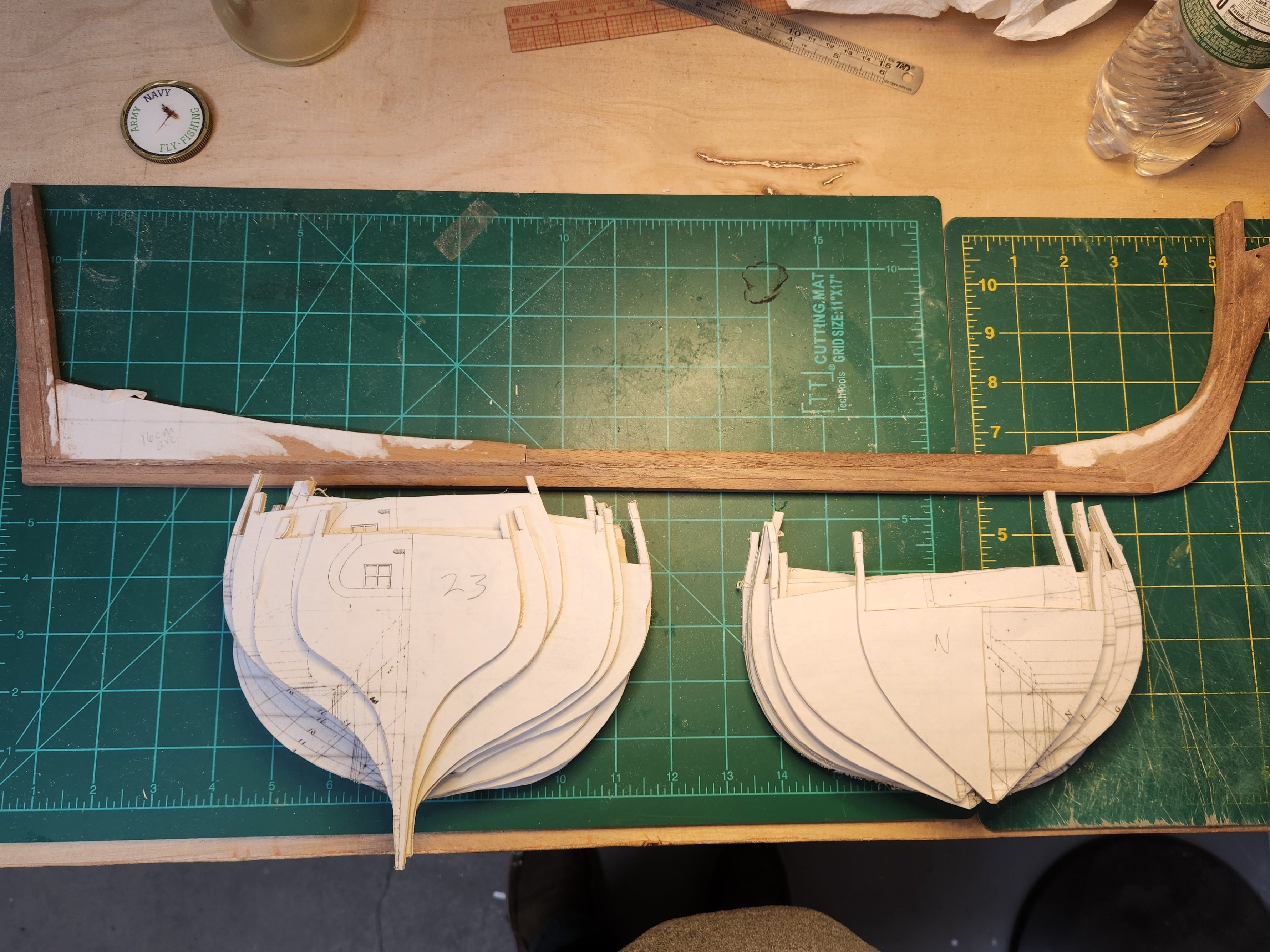

Rabbet line is done, and bulkheads have been cut out. I will trim them to fit the keel assembly as I go. Also next up framing out the stern assembly.
Rich

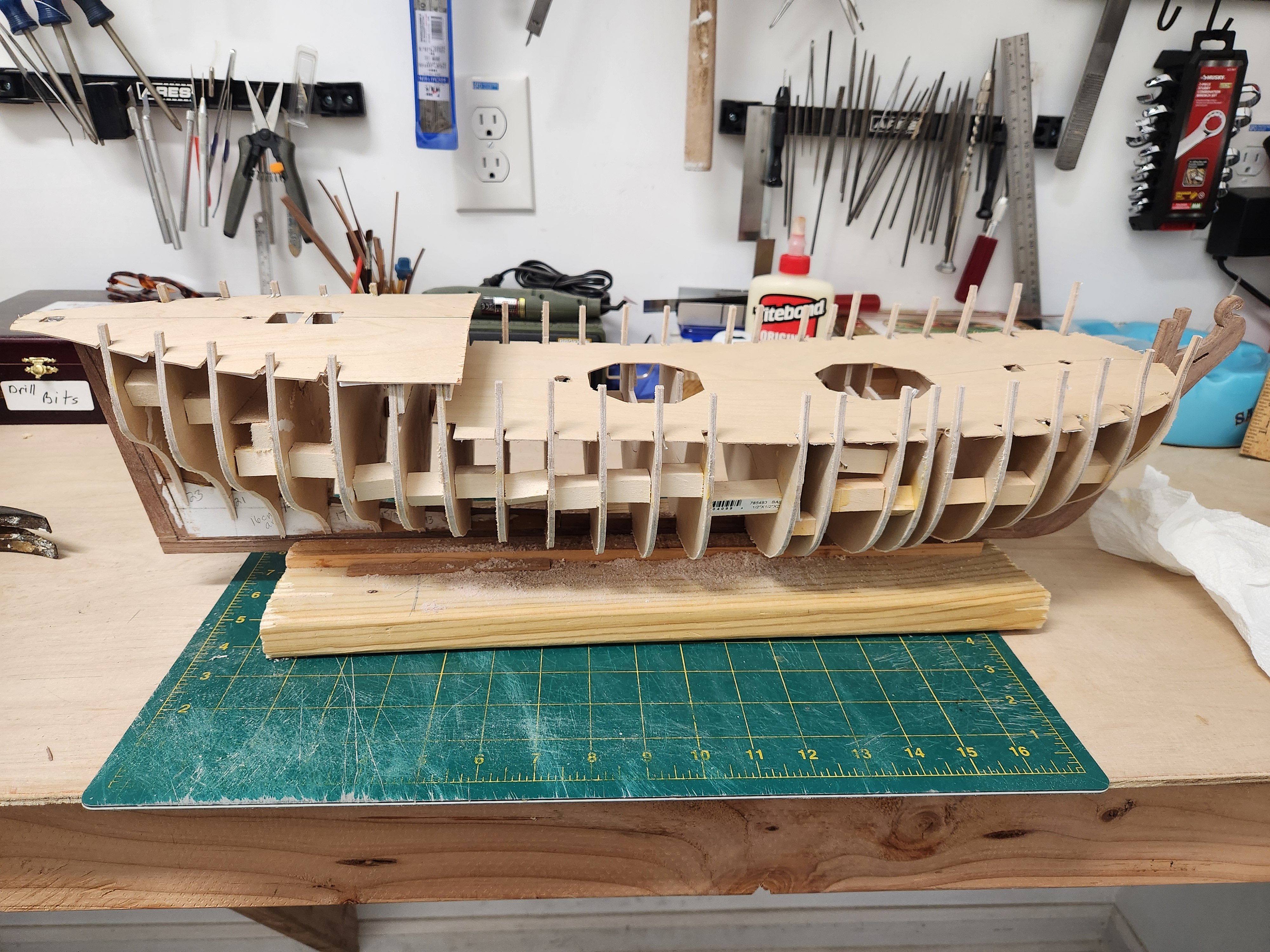

The bulkheads have been installed as well as the sub decks for both the main deck and quarterdecks. There is a foredeck, but this is open to the main deck along its aft portion.  I will not do a subdeck but rather a single plank on beams. I found two slightly different sets of plans from the NMR. One has two masts while the other has three and the quarterdecks are different lengths. I went with the 3 masts as this is how she is depicted by John Cleverly the Younger on her Nordic expedition with the Racehorse. Next job is fairing.

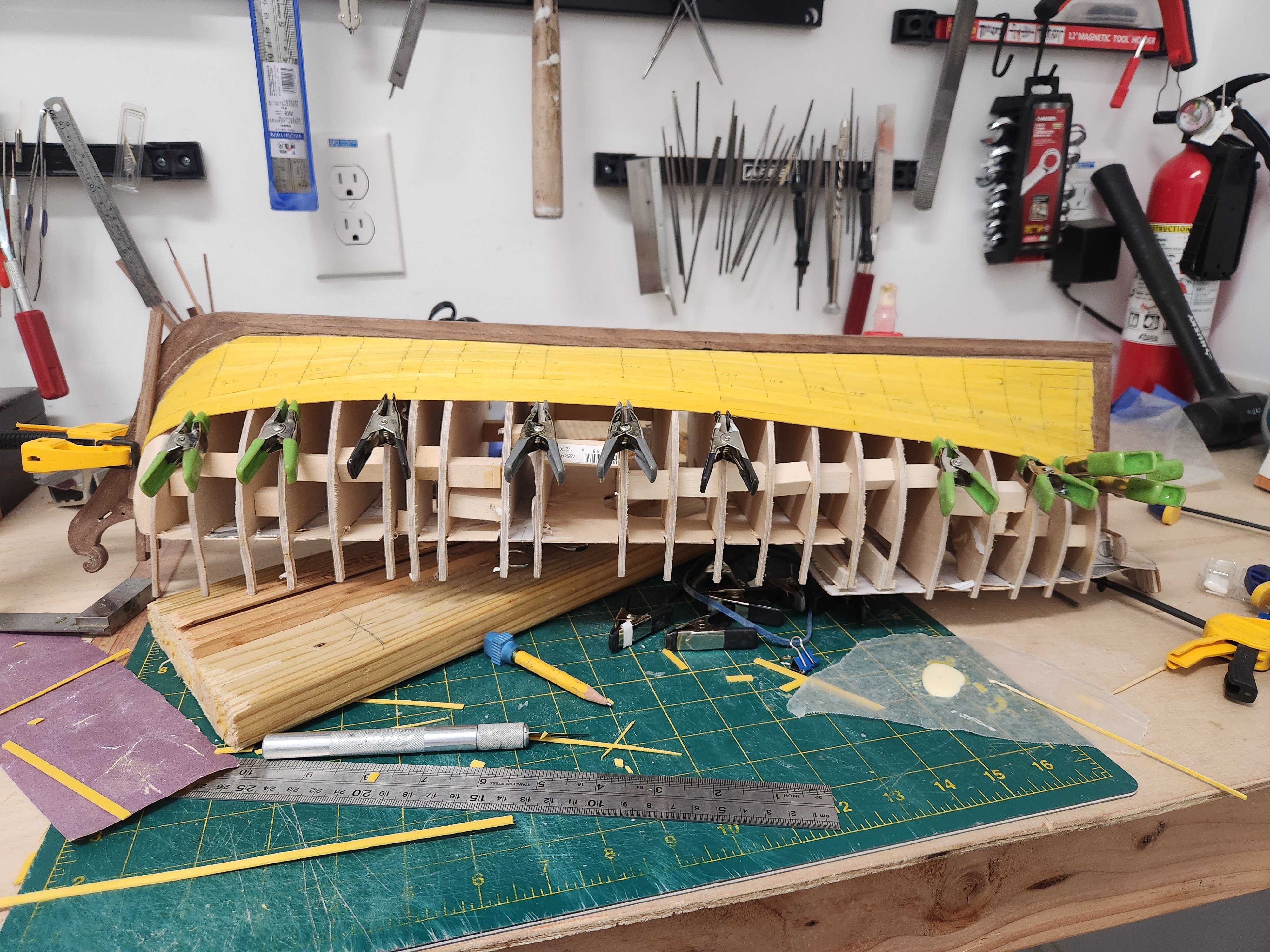

I've been working on the first planking. I thought I ordered natural strips but I either hit the wrong button or they sent me the wrong color. Doesn't matter as this will all be covered up. It does look though like it would glow in the dark at this point, however. Not quite sure yet how the planking is going to wind up at the stern. I may be able to continue or put in an additional piece. oh well, that's part of the fun figuring it out.

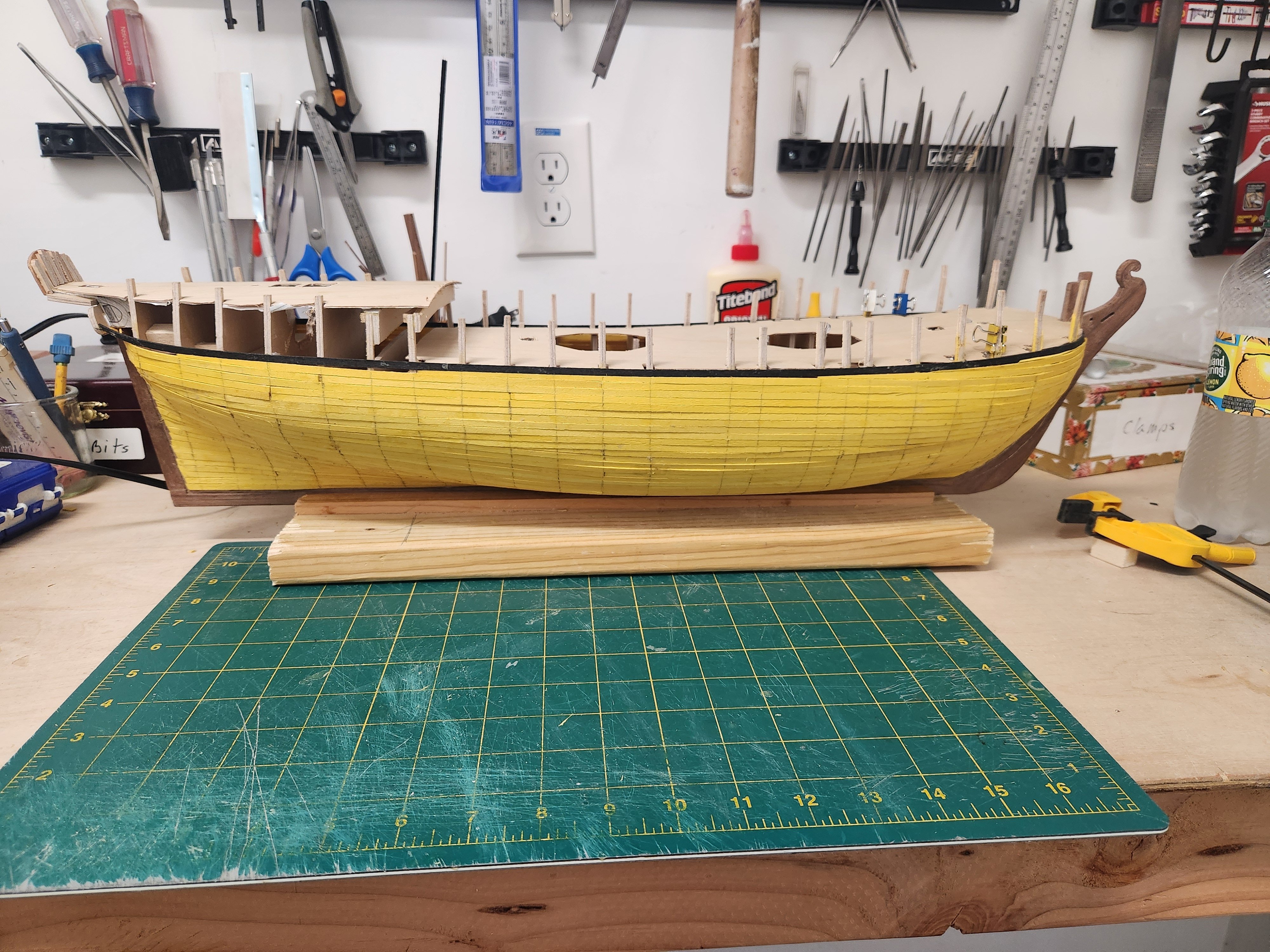

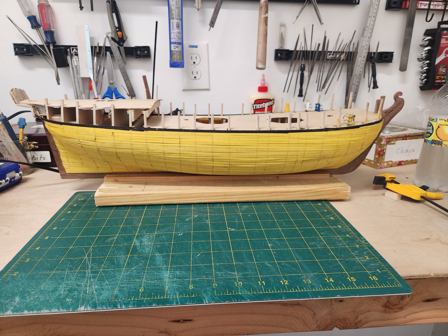

The model is now ready for the second planking. Any rough or low spots have been filled and everything sanded smooth. I have penciled lines where the bulkheads are. These will be where the butts of planks are placed. I use trenails throughout. I also measure along each line to figure out my overall taper. I'll do 5 to 10 planks and then remeasure and adjust rather than breaking the hull surface into smaller divisions. This allows me to deal with any problem in tapering before it is apparent and so do a milder taper over a longer stretch.
Rich
The second planking is coming along. For scale 1/48, maximal length of planks is 5 inches. This would be 20 feet.  My trenails ae .6 mm or #72 drill bit which would give me to scale just over an inch.
