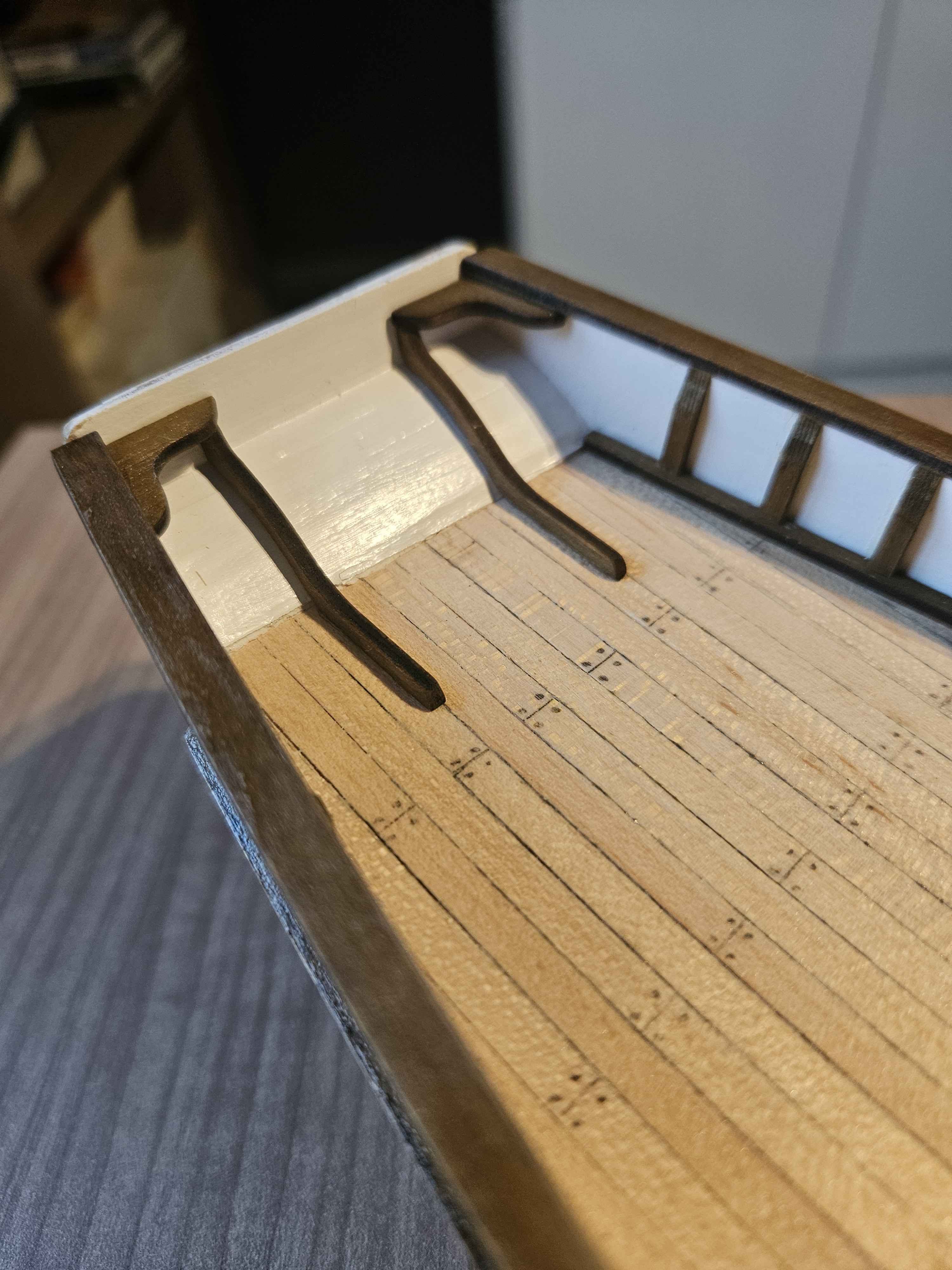

Some time later and i'm extremely happy with the progress i've made!
When planking the deck i found out the majority of my planks were bending sideways, some even so much it would've been hell to use.
I first looked for all the straight ones and then looked for the ones with partially straight planks or ones with just a very slight bend, these i would use the outer parts of the deck as i didn't need to use the whole length there.
Then i started planking the deck using contact glue, first i drew a straight line in the middle so i could nicely place my first plank. And here, i made my first major (and very silly) mistake, i was so focussed on placing it perfectly on the line i didn't pay attention to the length and i reached short at the end! ouch...
As the plank was already stuck on i decided to cut a small piece from another plank and glued it on the leftover part. Hoping it won't be too obvious to see in the end.
I then drew on the lines and nails with a pencil and put on two layers of satin varnish.
Sadly, i noticed afterwards that some of my pencil lines and drawn nails were badly visible or fully gone after the varnish. i tried to fix it up a bit more but not everywhere was as visible as before. oh well, not the end of the world.
After that was one of the parts with stressed me a bit, although, afterwards i realized that wasn't necessary at all.
I dry fitted the deck on the frame and with a bit more sanding i felt like it would fit quite easily.
I put on some wood glue and pushed the deck on, forcing it on with my hands for a good 5 minutes untill i felt like it was stuck enough to let go, adding a drop of super glue at each rib to make sure it would definitely be properly attached to the deck.
Overall i'm very happy with how it turned out. After the varnish i also found that the small part i glued on separately wasn't too noticable.

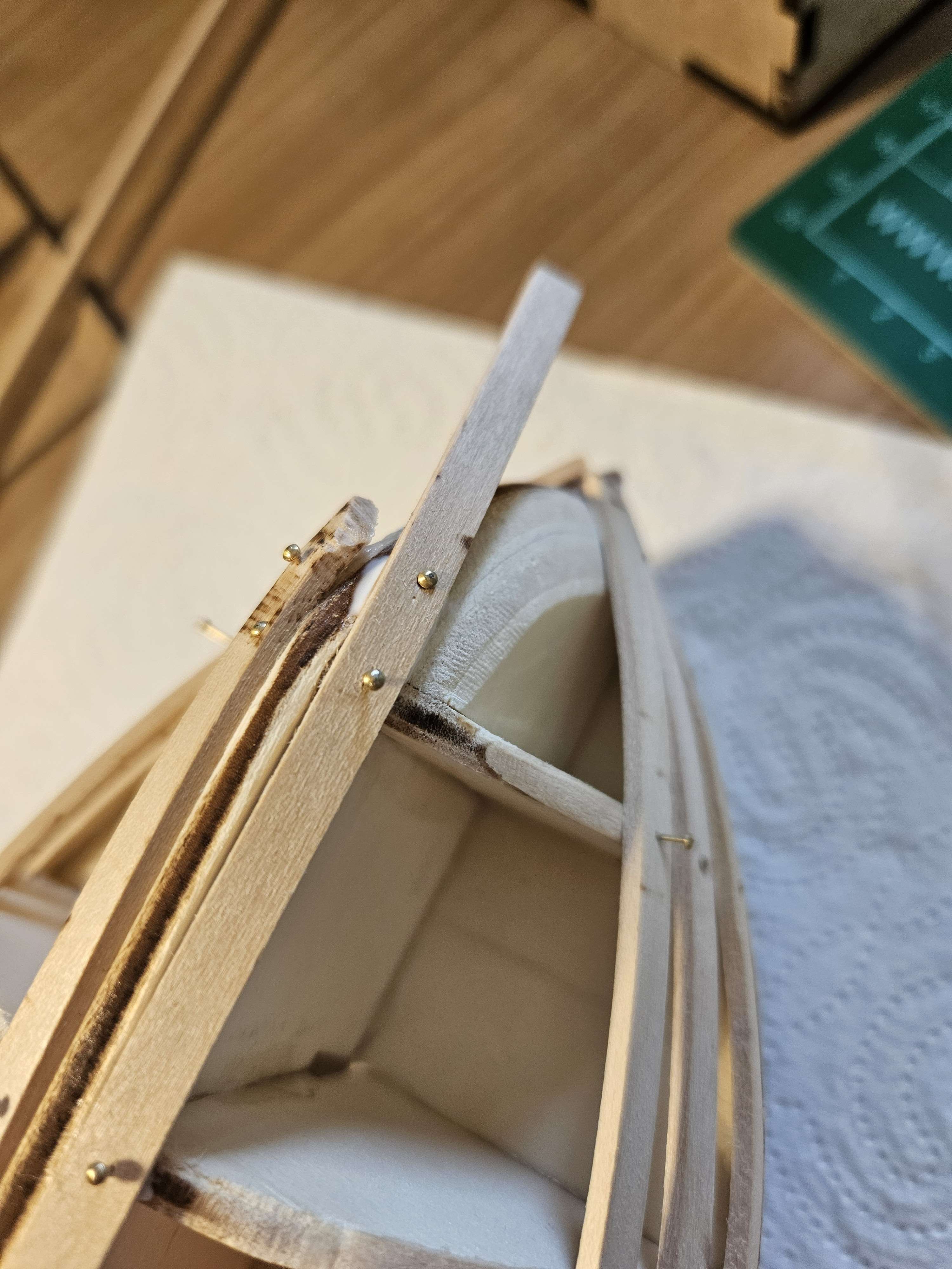

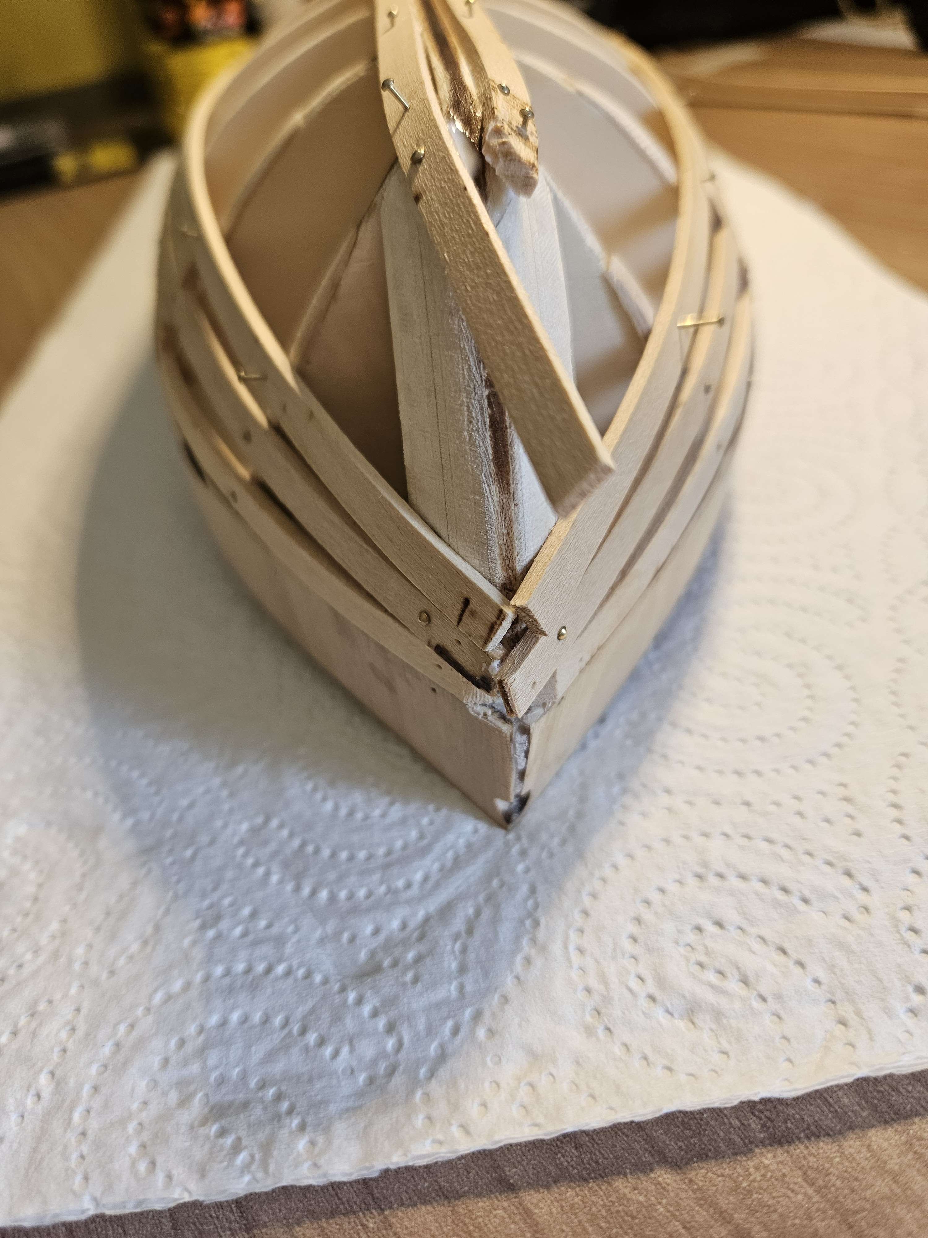

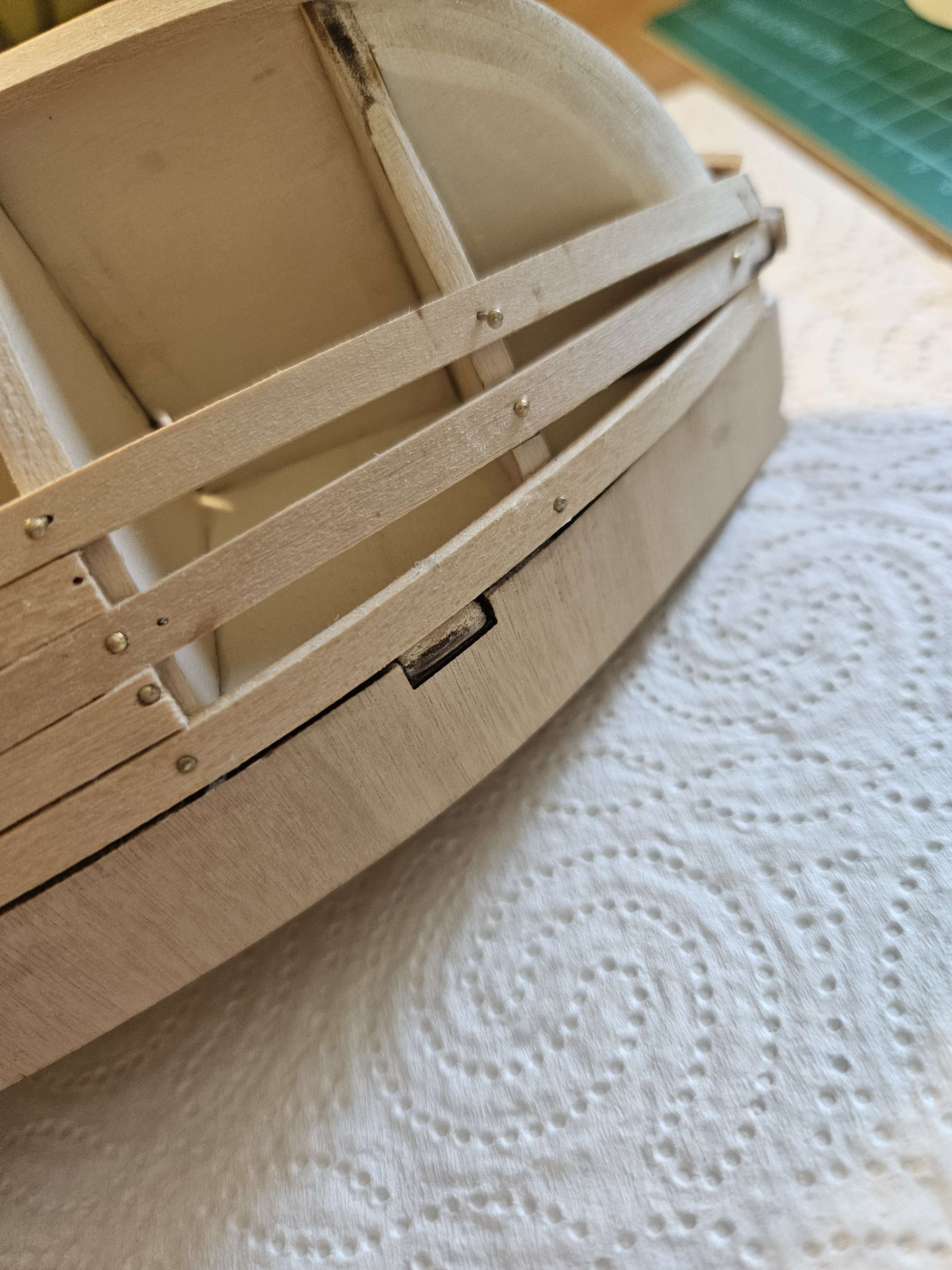

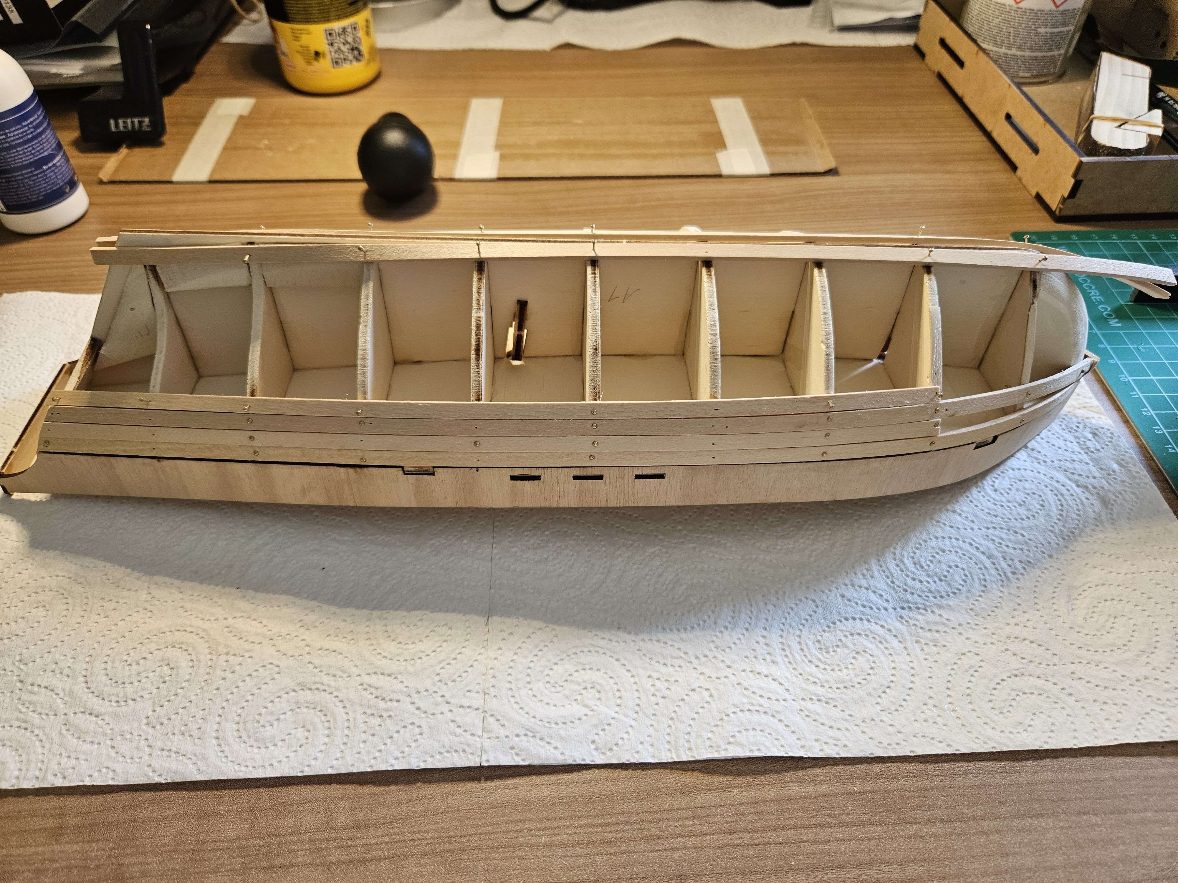

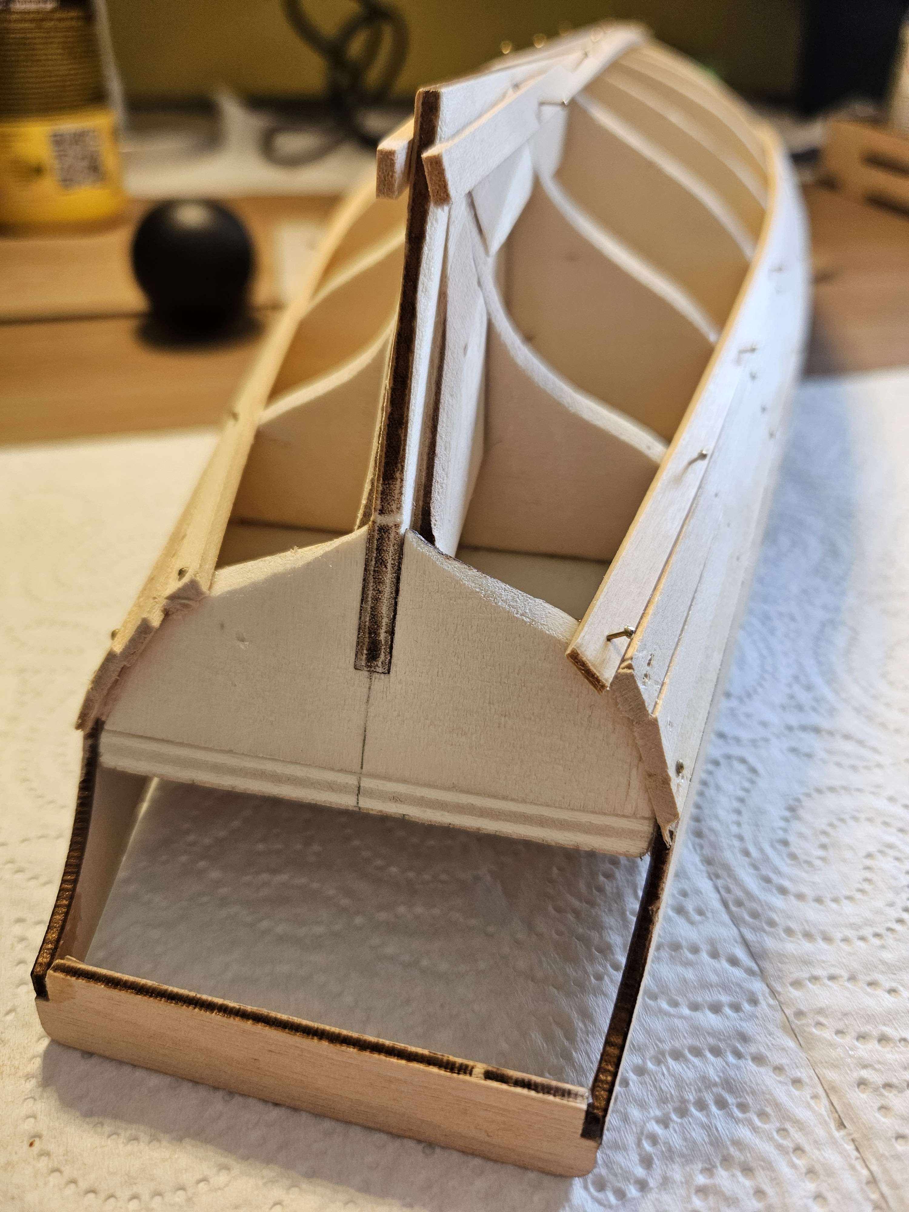

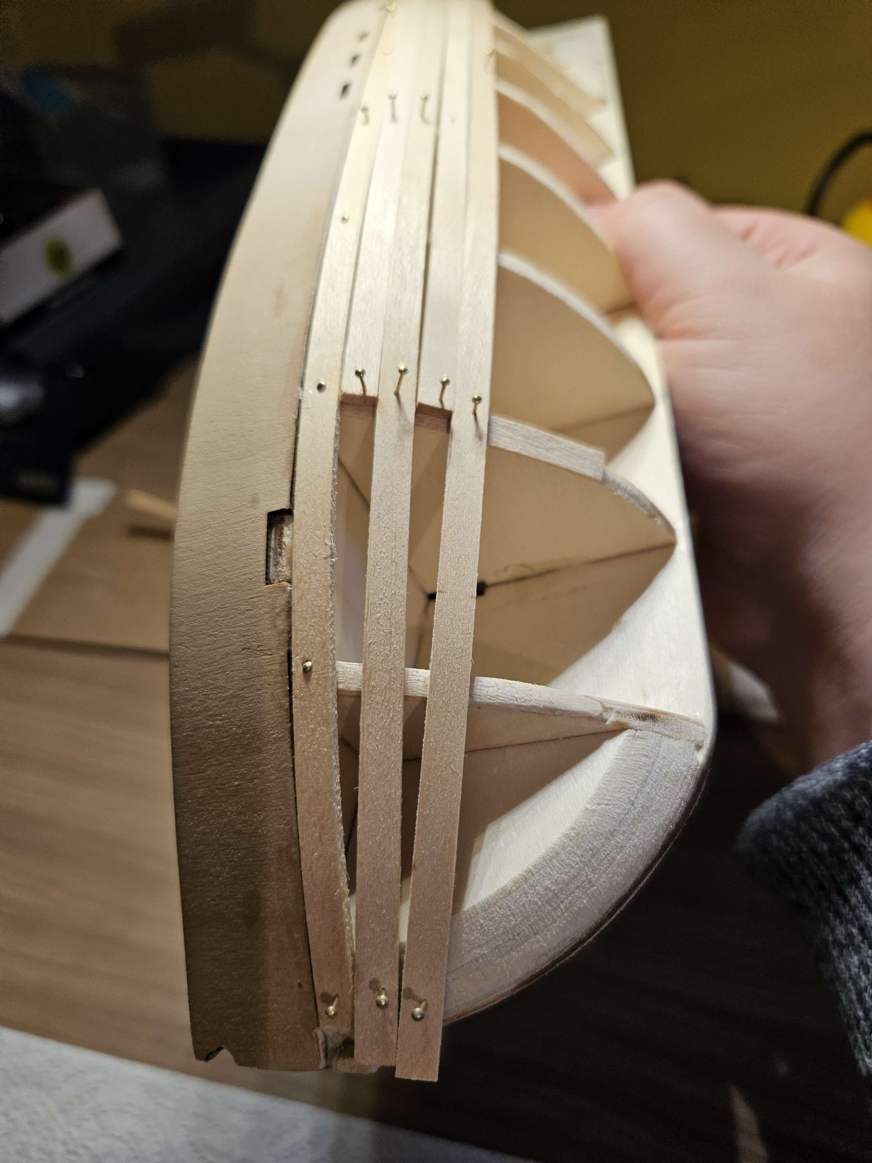

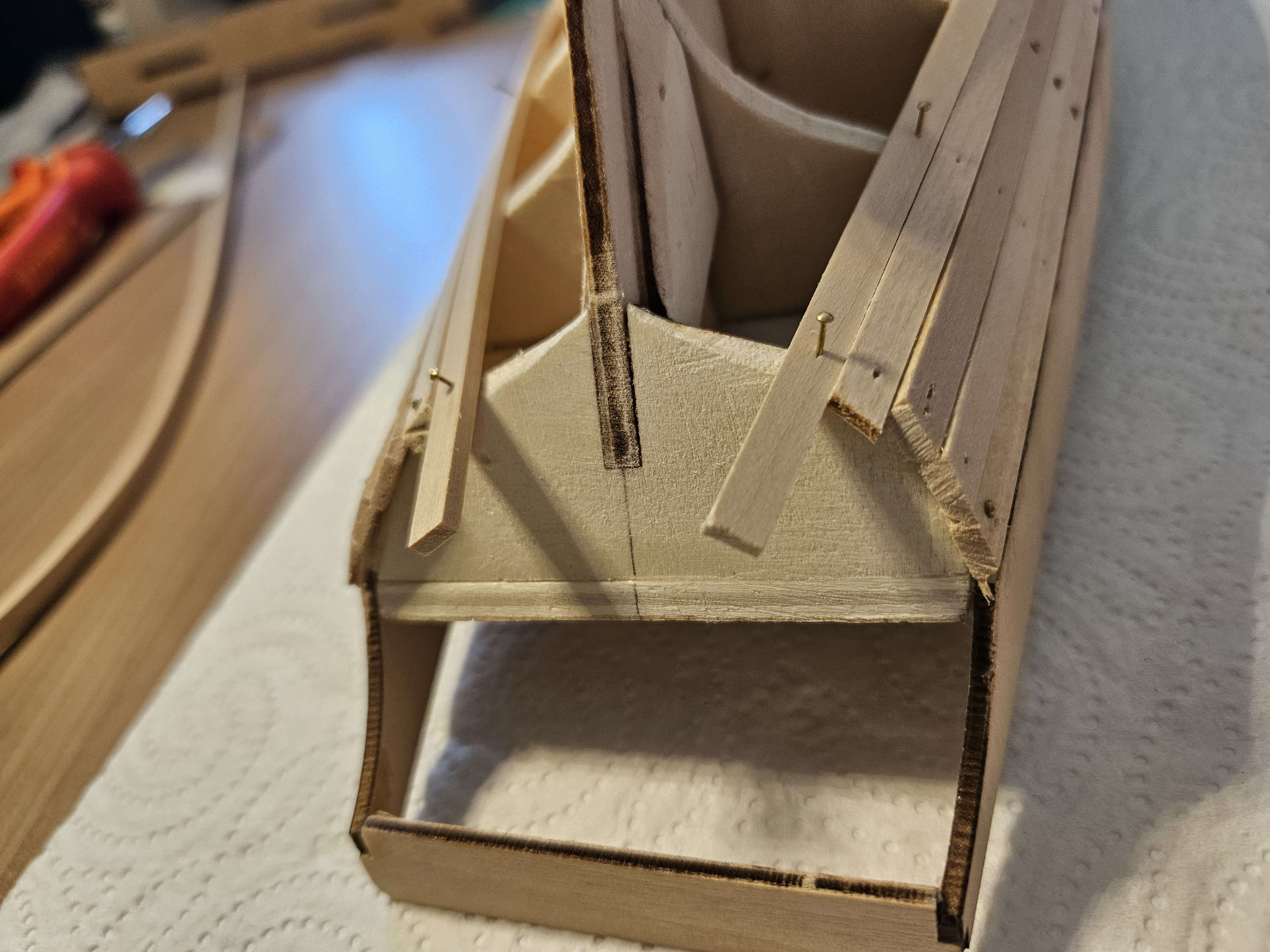

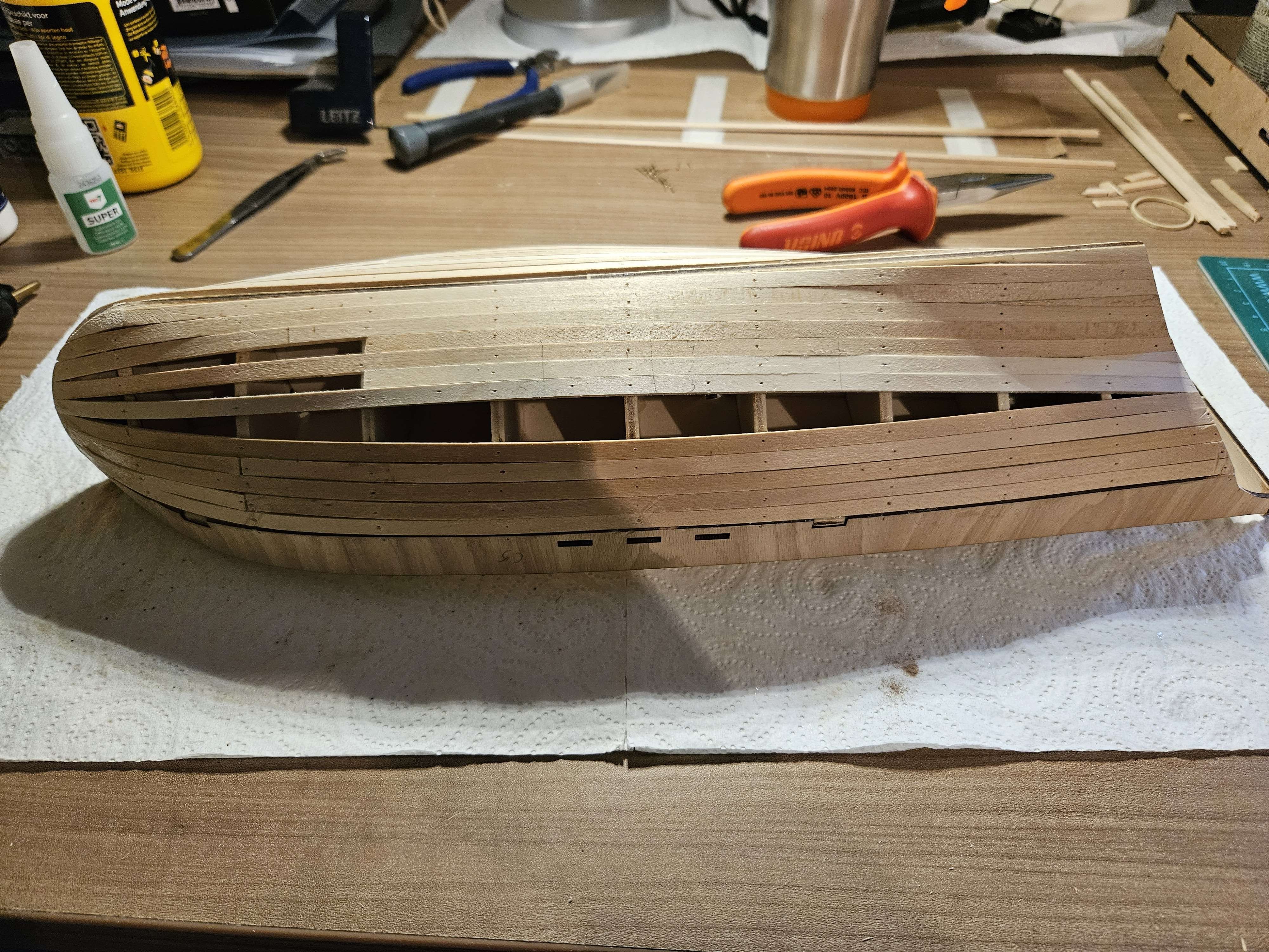

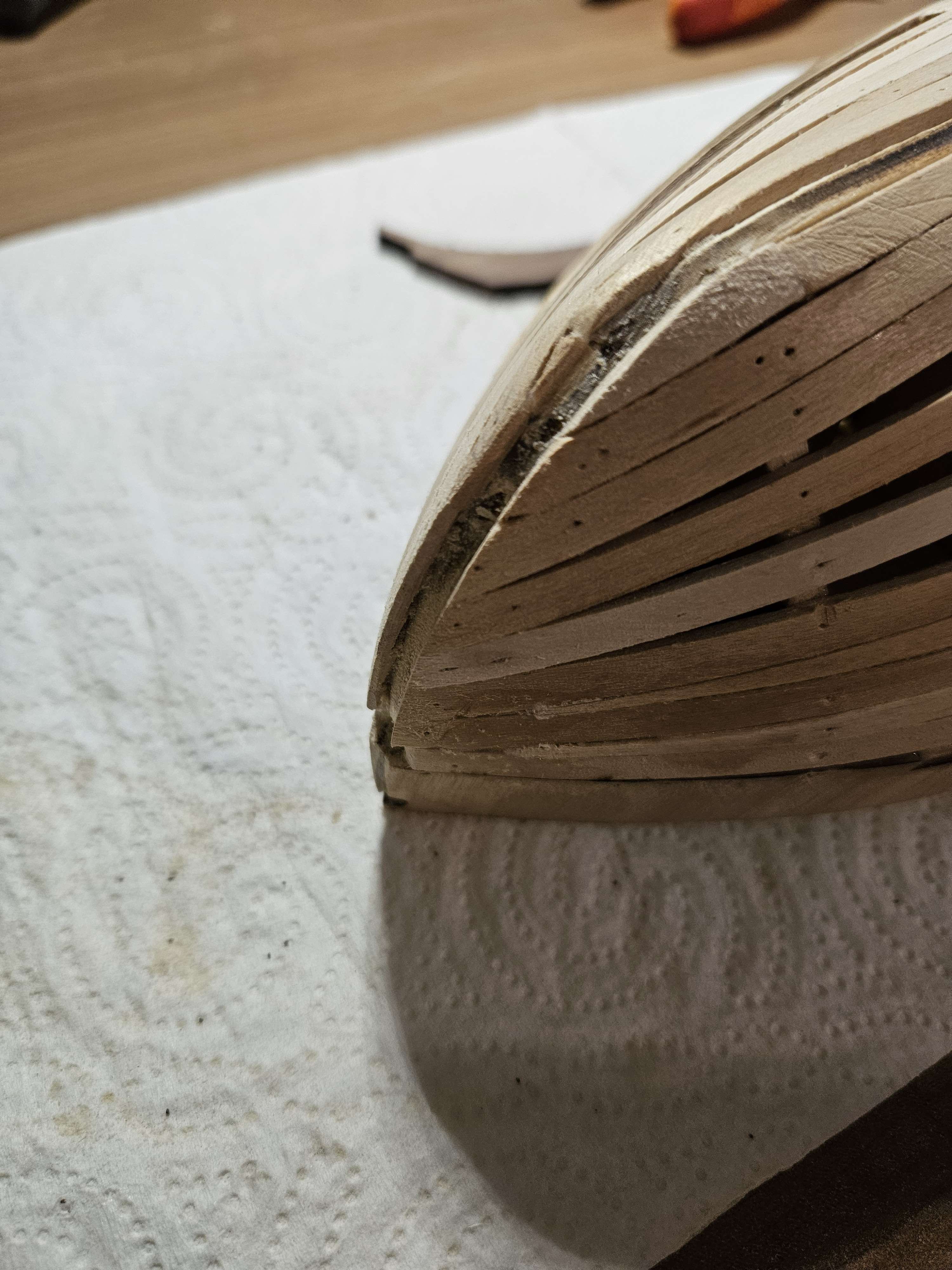

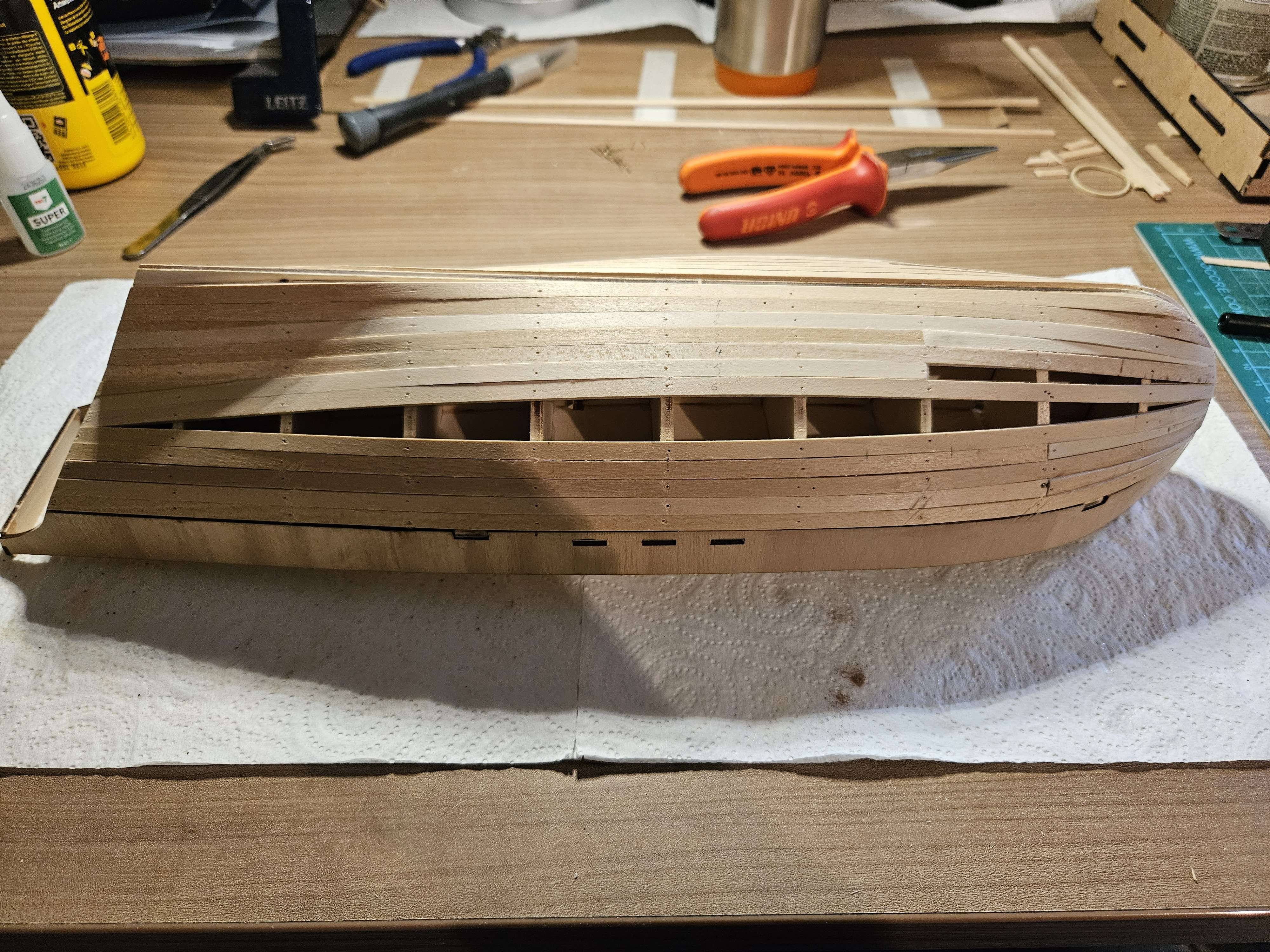

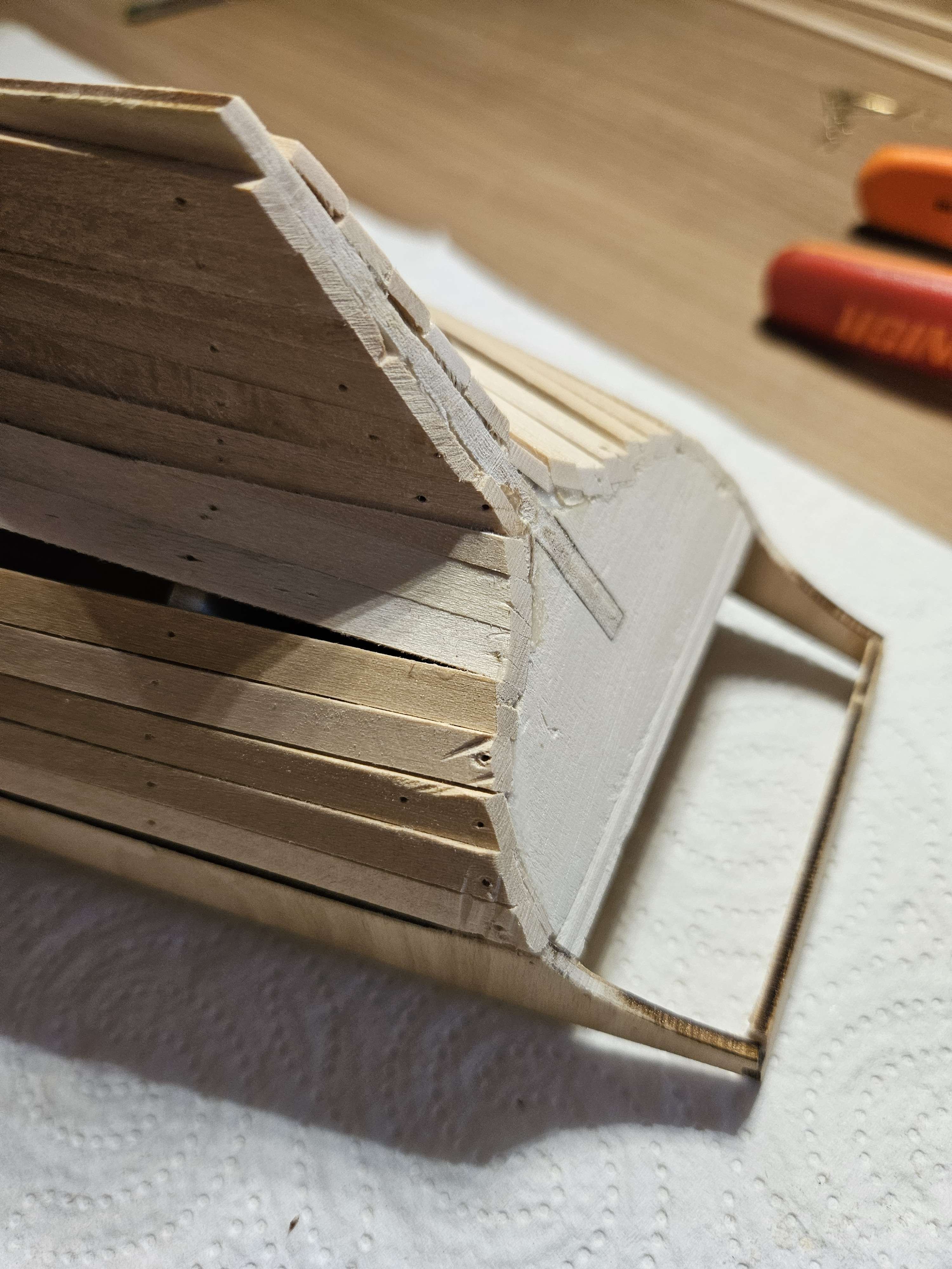

So it's been almost 2 weeks now and i've made slow but steady progress.
To bend my planks i soaked them in water for atleast 5 minutes, bent them slightly around a can and then used a soldering iron to finalize the shape.
I've glued on 4 upper planks and 1 lower plank so far on each side and currently have 1 dry-fitted with nails on each side.
On the ribs i had to glue on a few thin planks from the cutouts of the deck to shape a few of them better as i found out i sanded a slight bit too much off.
I'm well aware it's not the prettiest and far from perfect, but i hope i'll be able to hide all the imperfections under the second planking.
The ends of the planks haven't been fully cut/sanded to the perfect fit yet but i felt like it'd be better to do that at the end when all planks are glued on.

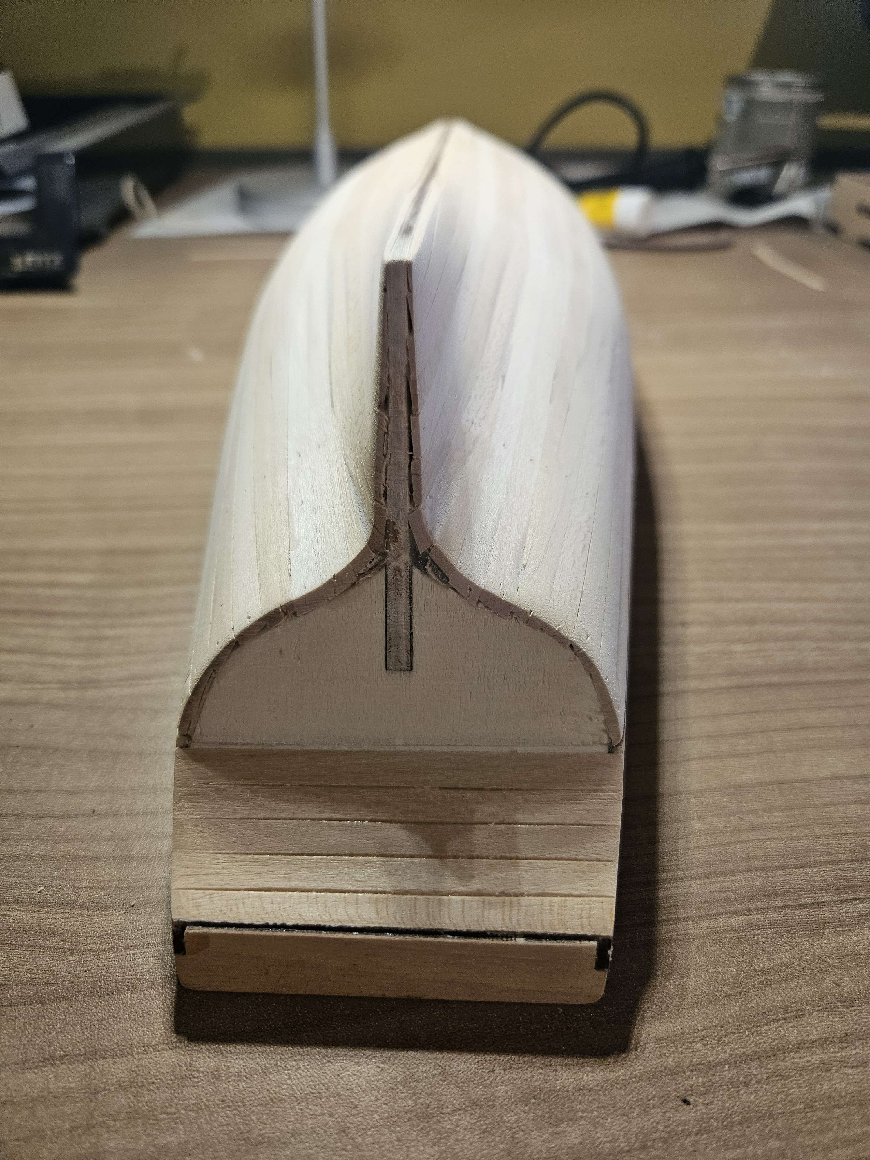

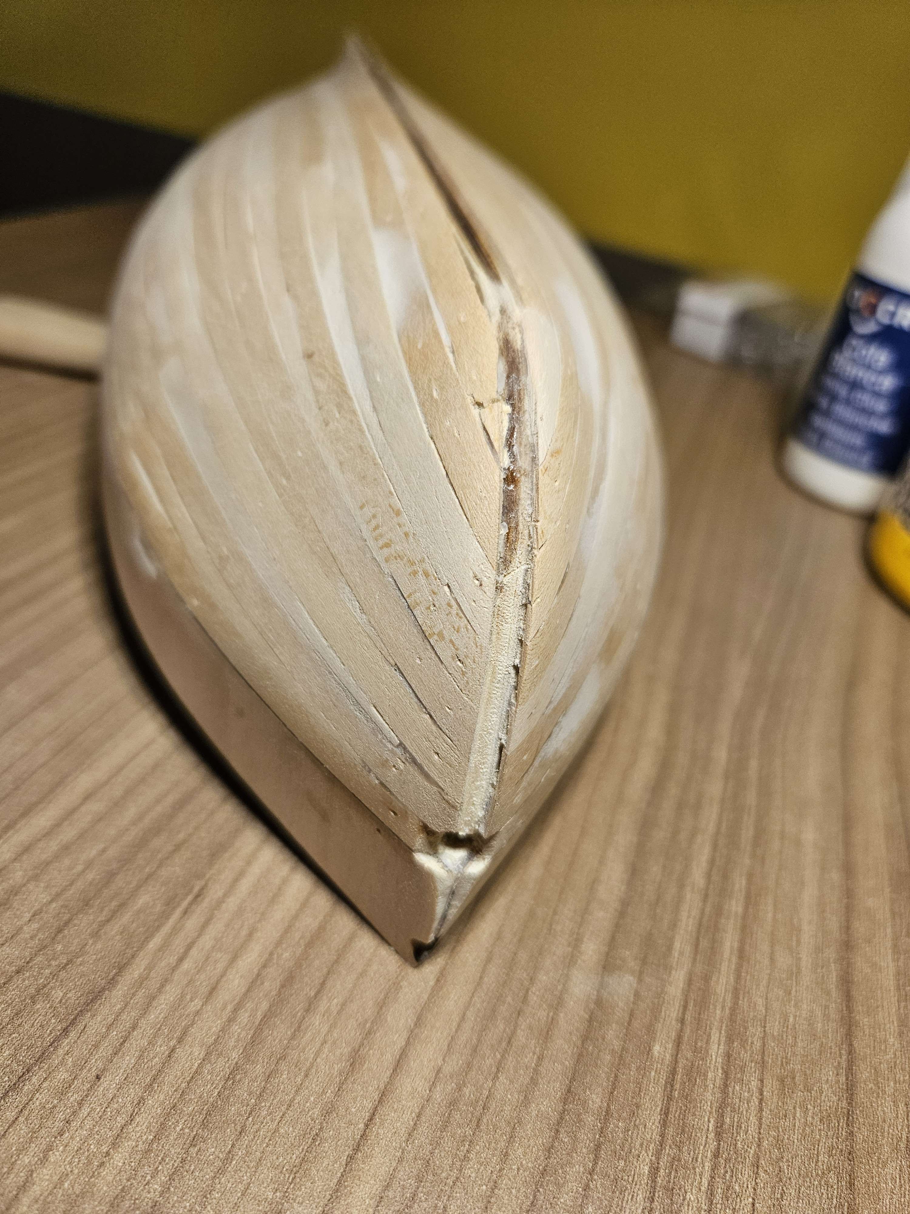

Nearly 3 months later i've finally finished fitting all the planks and sanding them down perfectly for the finishing layer of the second planking.
It was tedious work but it still went fairly smooth! I didn't have any issues or made any major mistakes (the small ones i did make were easily fixed).
With some putty i filled in any major gap and then sanded it down evenly to make it all as smooth as possible.
So far i've been loving this project, my least favorite part definitely has to be the sanding though. 😅
Here's a small photodumb from during the planking and a small photodumb of the finished planking which has been sanded down.
I look forward to gluing on the second planking, although it makes me nervous because mistakes here you can't really hide anymore.

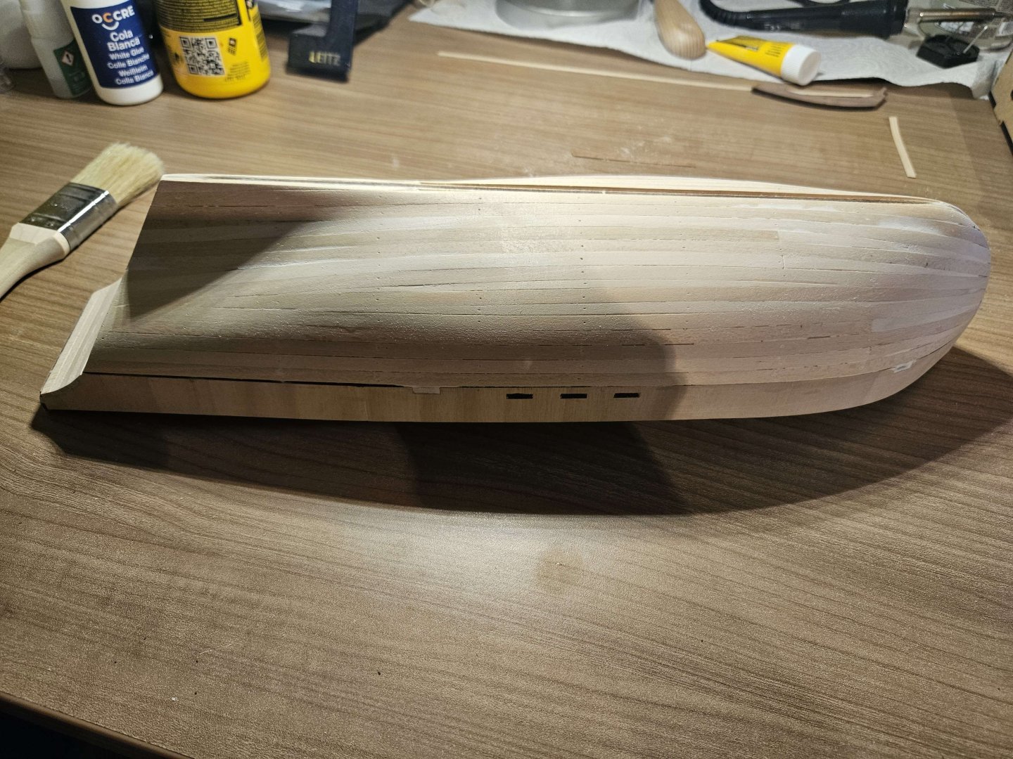

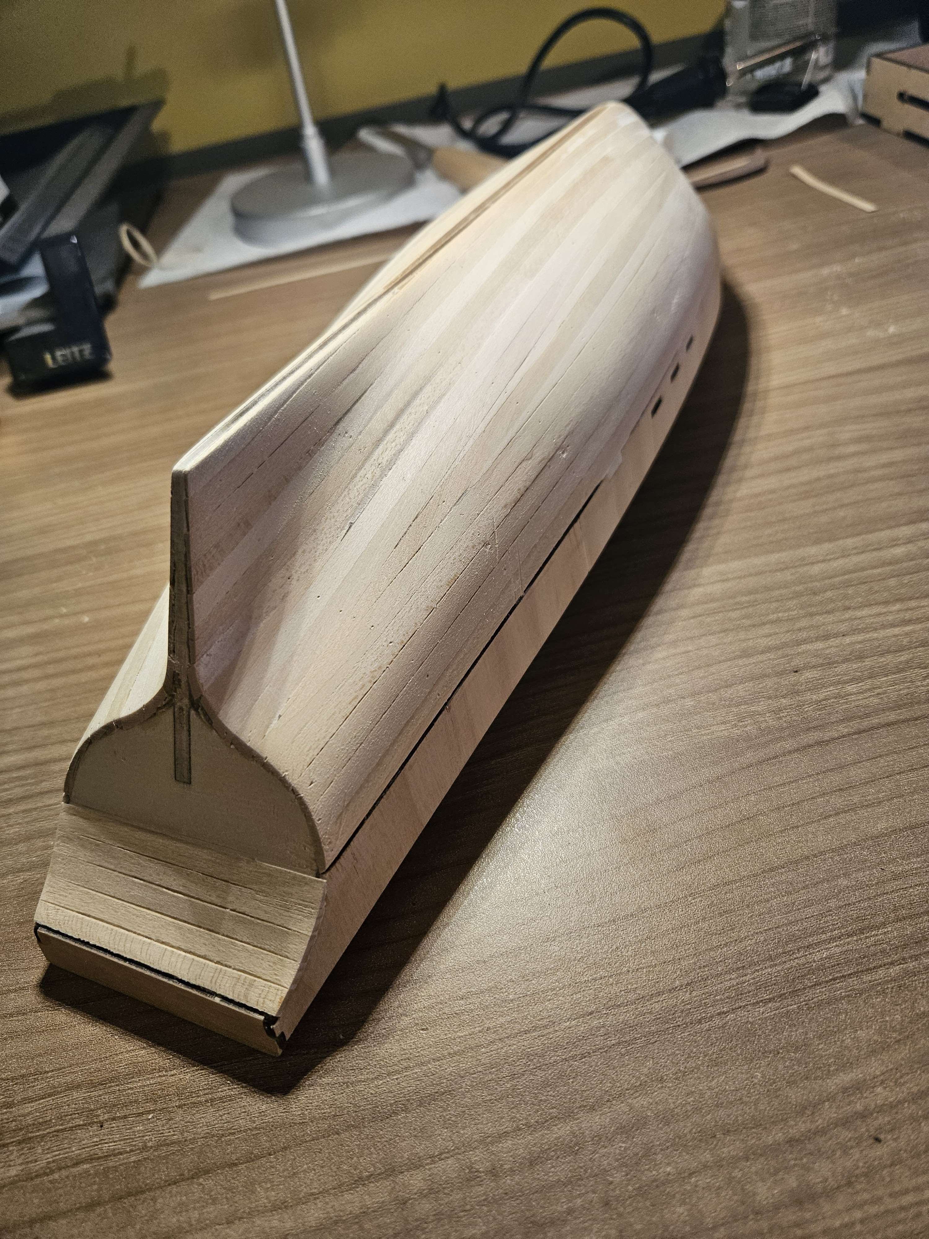

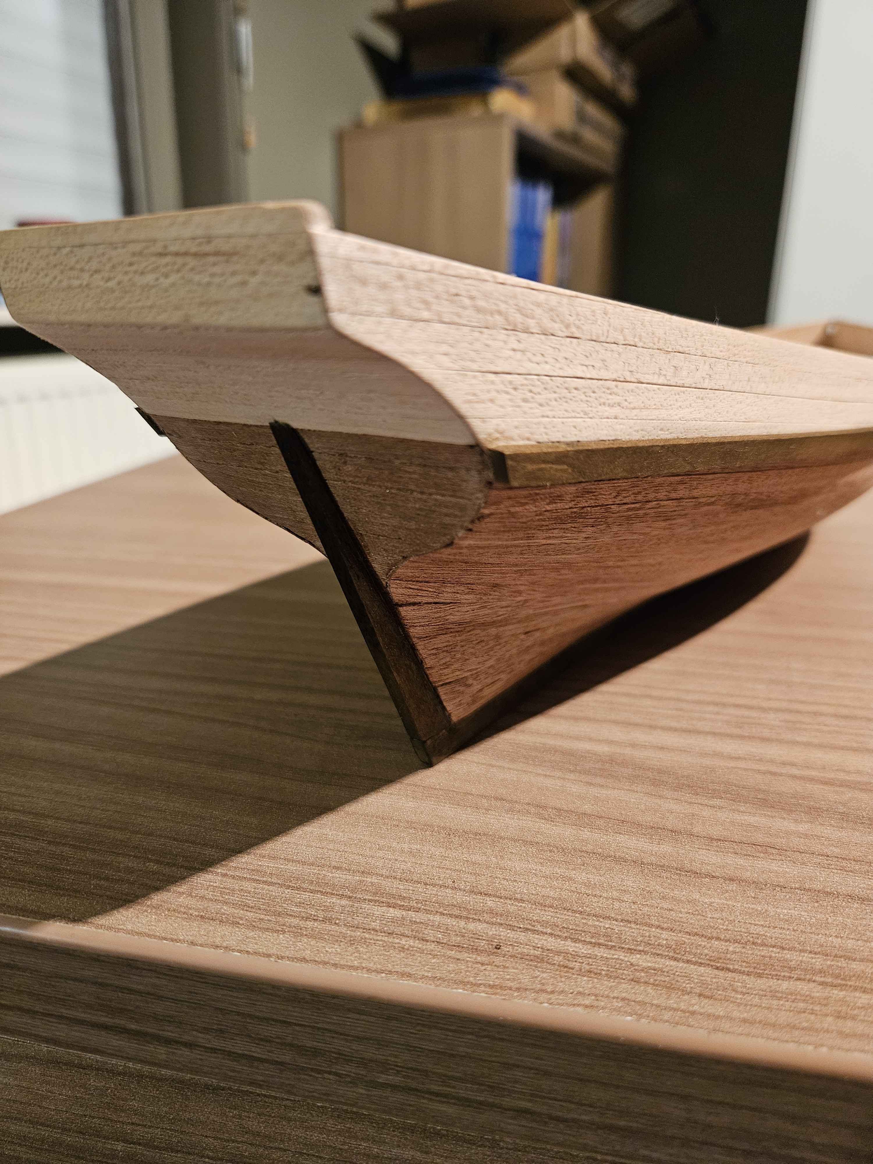

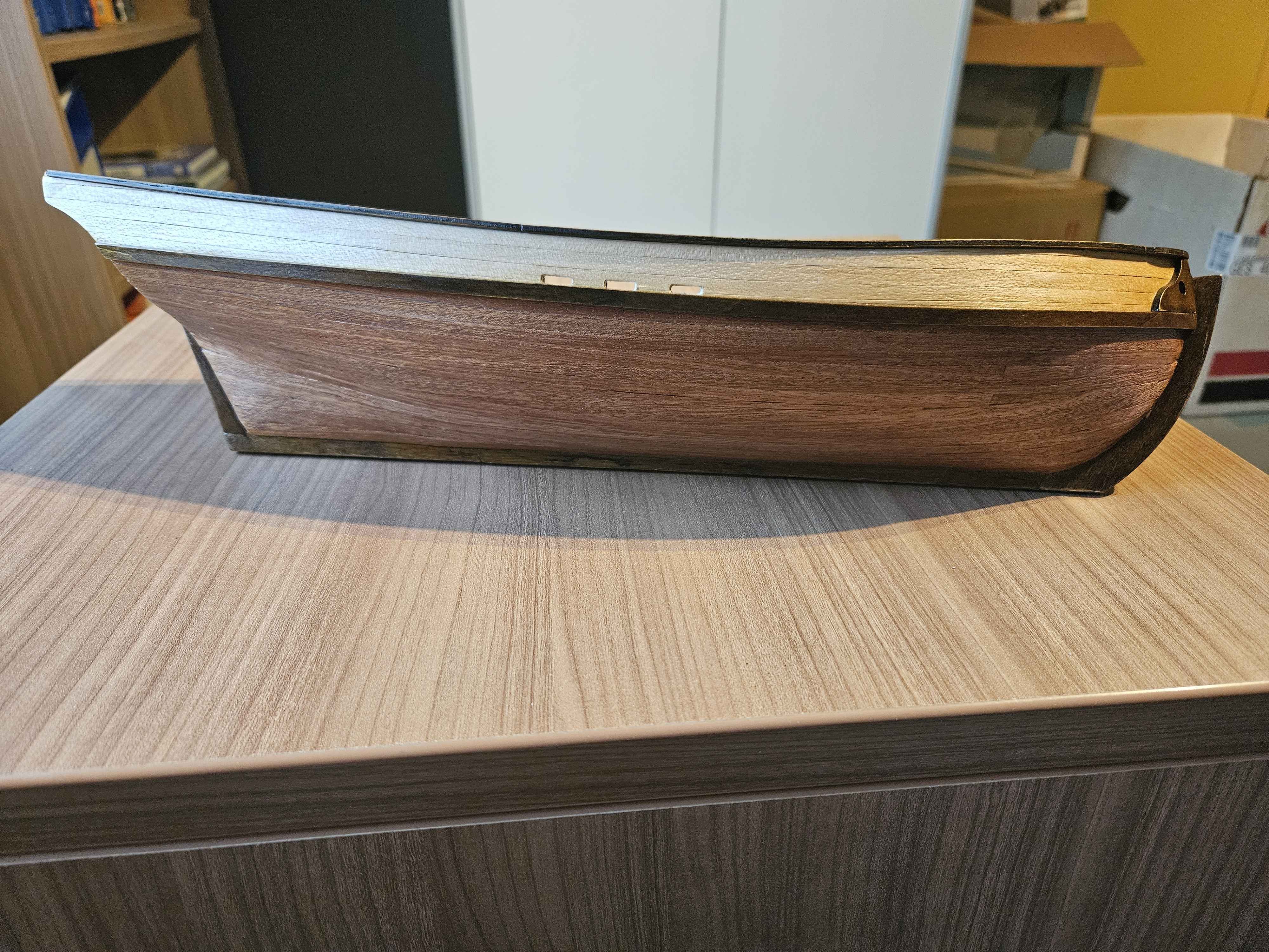

Another long time later, I can finally post an update!
I’ve got to say, the second planking has been a real rollercoaster. There were plenty of ups and downs, mistakes and fixes, but once it’s done you’re a huge step closer to the detailing stage.
To make fitting the second planking against the keel easier, I decided to glue the keel on earlier than the instructions suggested. This is where I made my first silly mistake: I completely forgot to stain the keel parts with walnut dye 😅. I’ll do this once the second planking is finished, and I don’t expect it to cause any problems.
I started with the starboard side and, for some reason, decided not to follow the instructions and instead go my own “logical” way of planking. This turned out to be big mistake number two. It caused far more difficult placements and a lot of small pieces that needed extra cutting and sanding.
In the end, this side took me about three months to complete. I was so worried about making mistakes that I ended up burning myself out a bit, especially while being very busy with work.
Once the starboard side was finished, I switched to the port side, and this went incredibly smoothly. I managed to finish it in just a week by actually following the instructions. A fresh wave of motivation, along with more experience, made a huge difference.
The next step was the second planking of the upper part. I struggled more with this than I expected, mainly because the planks really didn’t want to bend along the curves. In some areas I had to cut the planks in two to make things easier. It definitely isn’t as pretty as I’d hoped, but it’ll work. You’ve got to learn somehow, right?
image.thumb.jpeg.49a9c5a45f57360ddc00645b79f0ac0c.jpeg image.thumb.jpeg.52efb2db760a7ece5e8e6f4f5f511f06.jpeg
image.thumb.jpeg.79d2c118127b75066bc32b15c48fe780.jpeg image.thumb.jpeg.8beb671e25eae3c5766a29b1315d80c6.jpeg

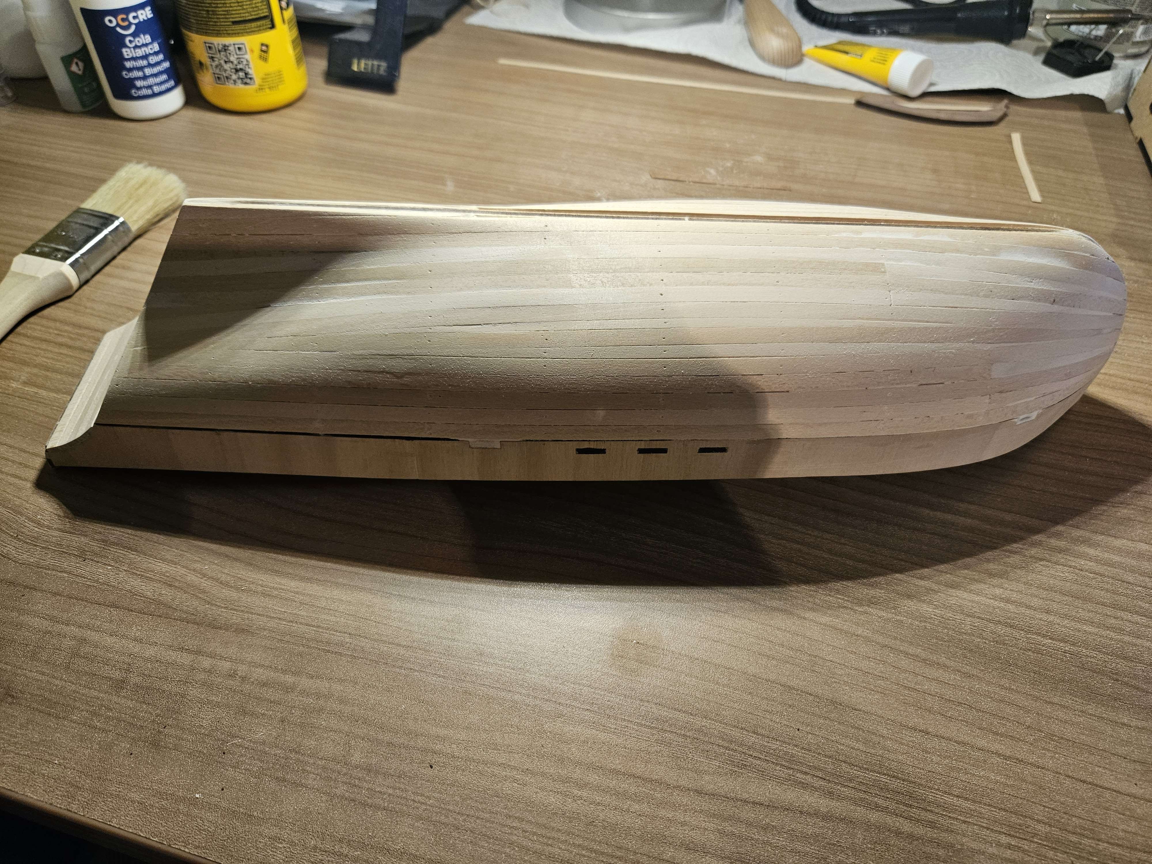

After that, I used small amounts of white spirit to remove leftover contact cement that was sticking out between the planks. This worked surprisingly well. I then sanded everything down to smooth it out. I can still feel some grooves, but I’m afraid to sand too much since the planks are so thin.
image.thumb.jpeg.b33a6470e5f2971d0b43f37136d56e26.jpeg image.thumb.jpeg.0b282165b5a5fd816b70e49e130b212e.jpeg

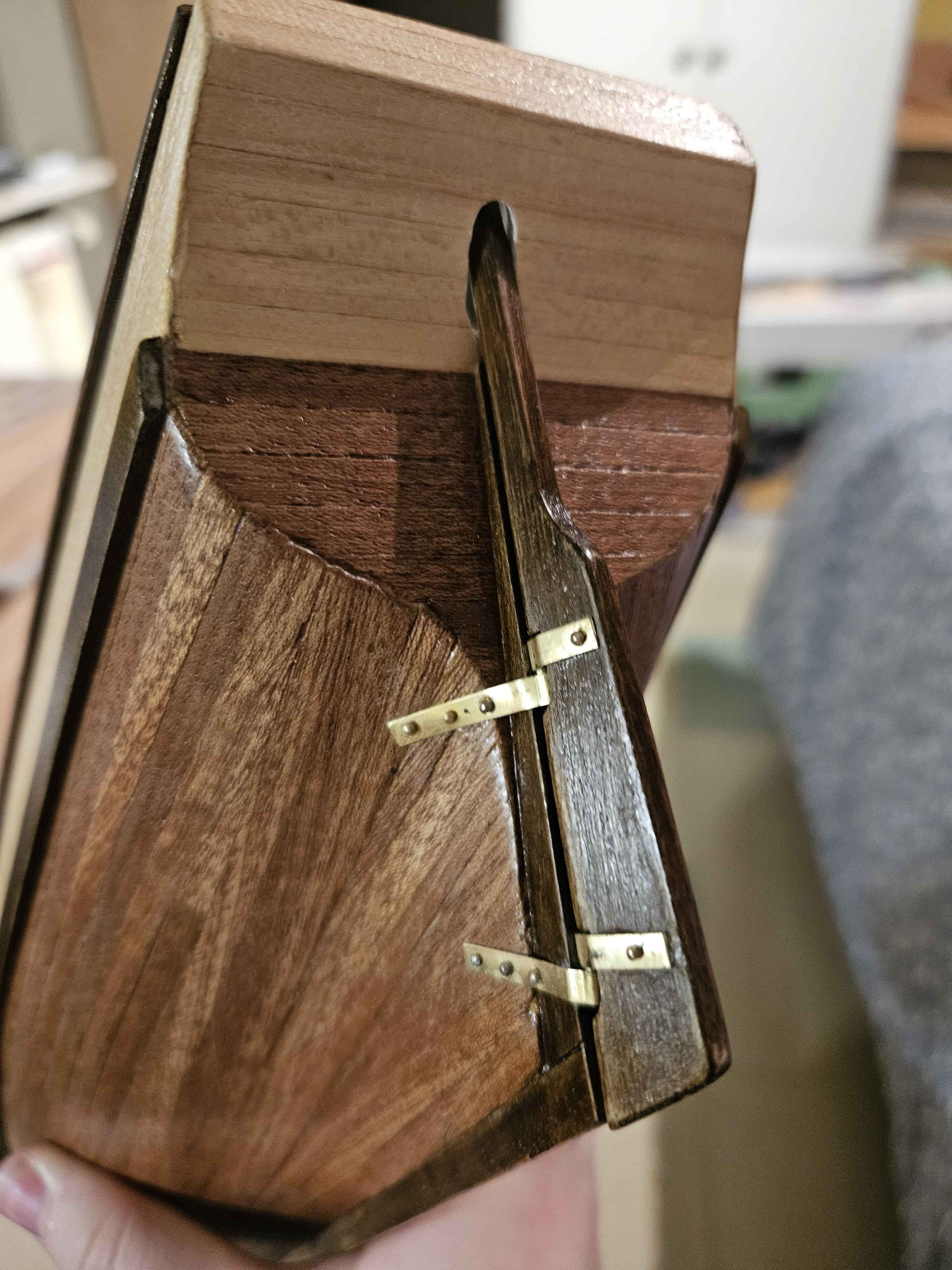

My biggest mistake, and the one that will probably bother me forever, is that I rushed the placement of the front part of the keel. As a result it isn’t fully centered or straight. I really hope it won’t be too noticeable by the end of the build, but if it is, it will be a good reminder of a very important rule.
Do not rush.
Even with a few mistakes here and there, I’m very happy with the result so far. And thanks to some Black Friday temptation, my next build is already waiting… OcCre’s La Candelaria 😉

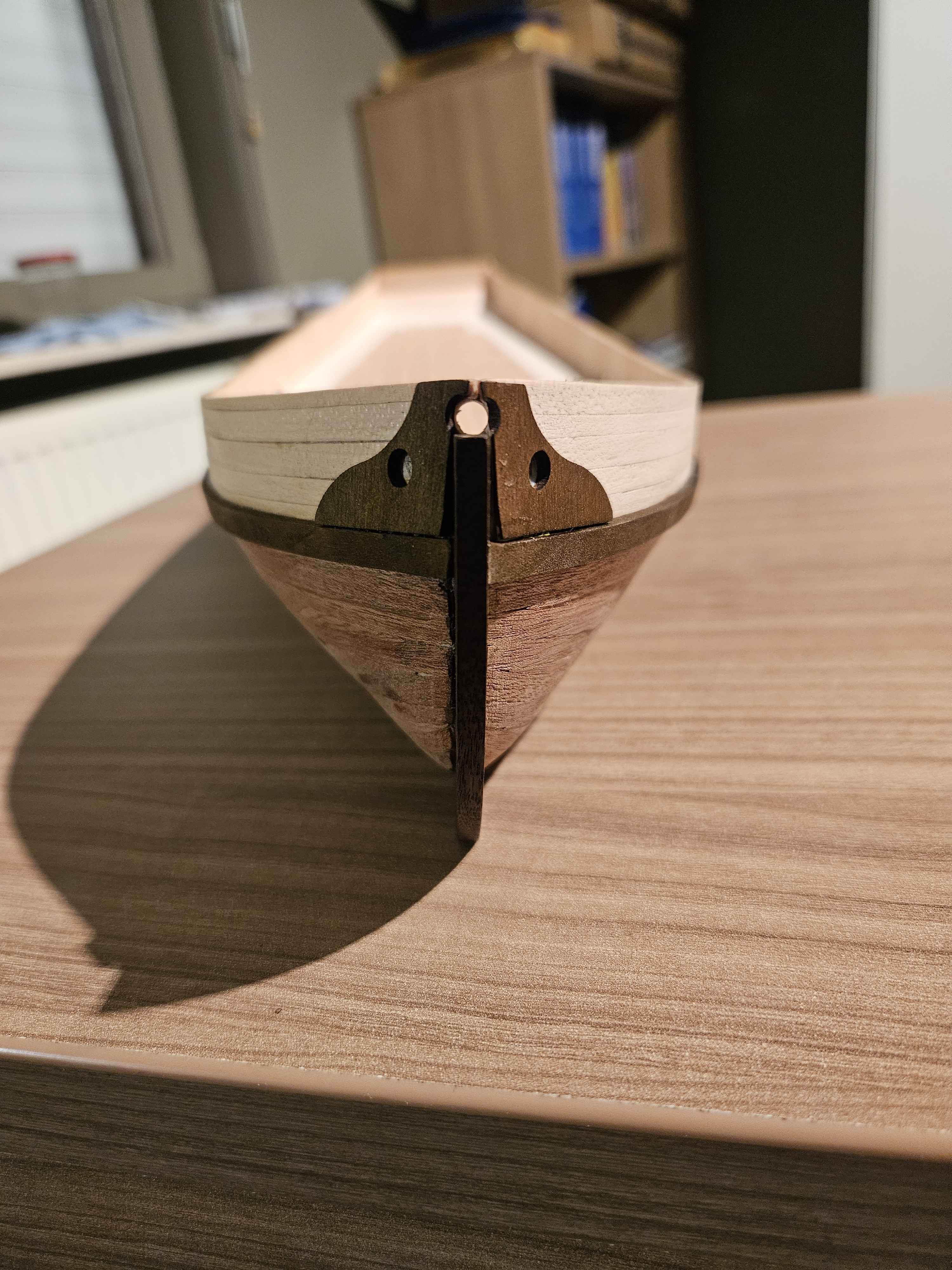

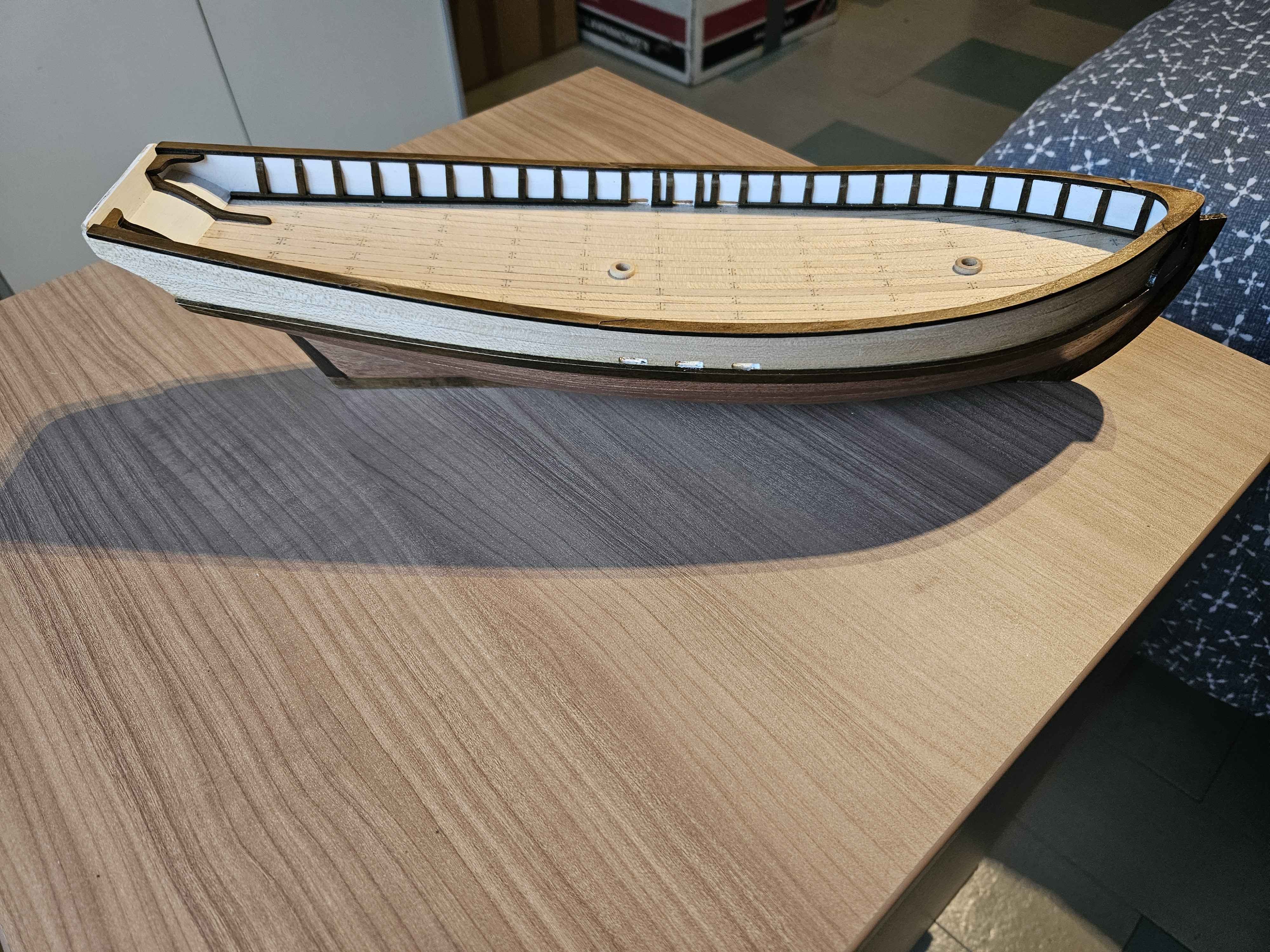

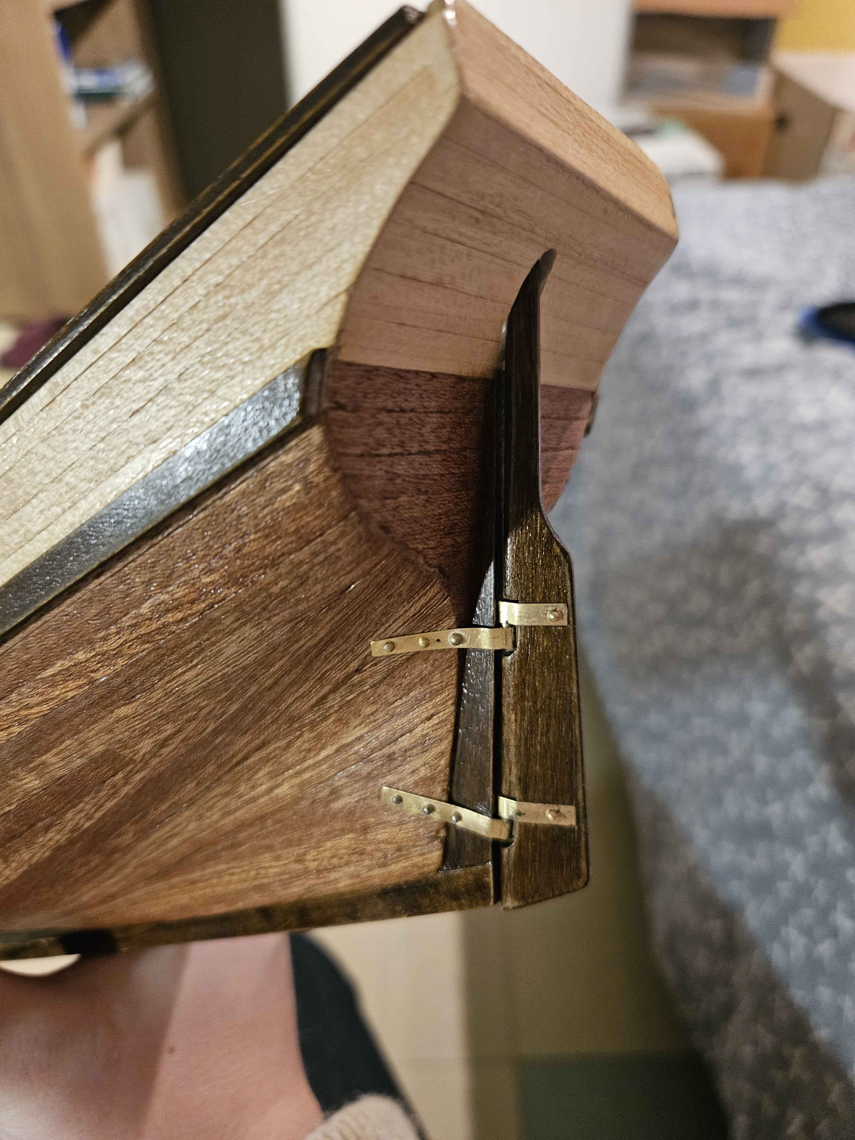

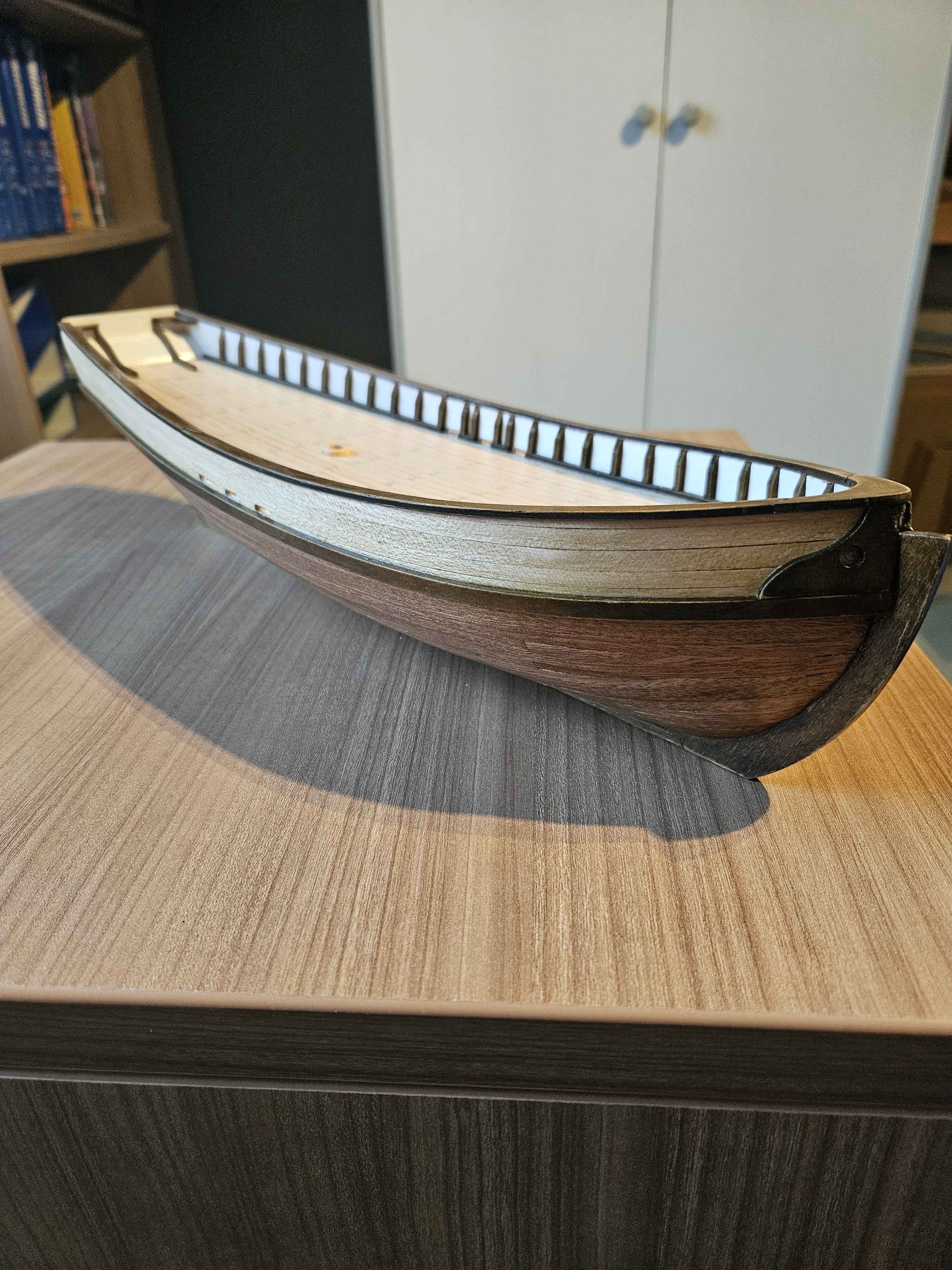

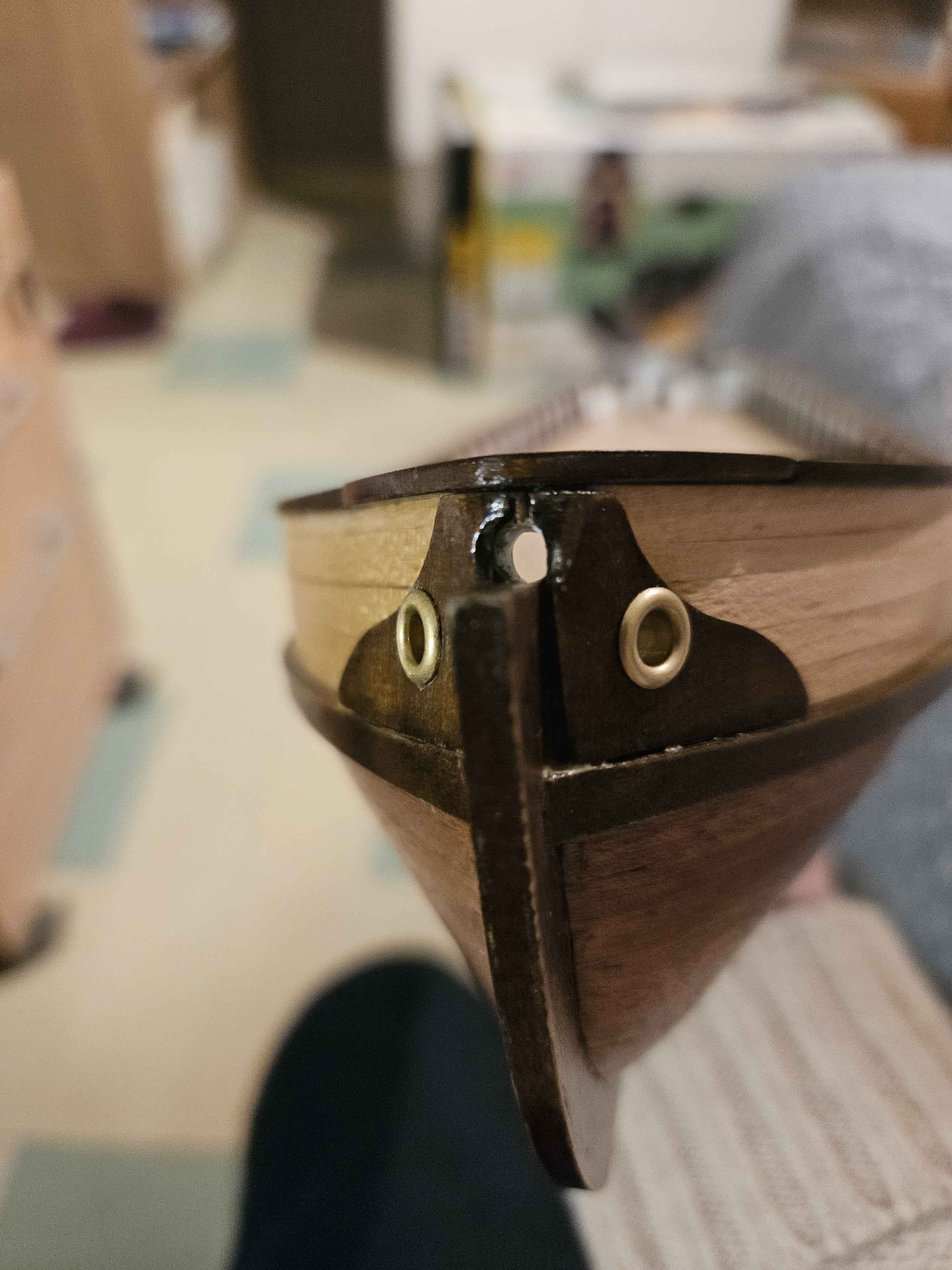

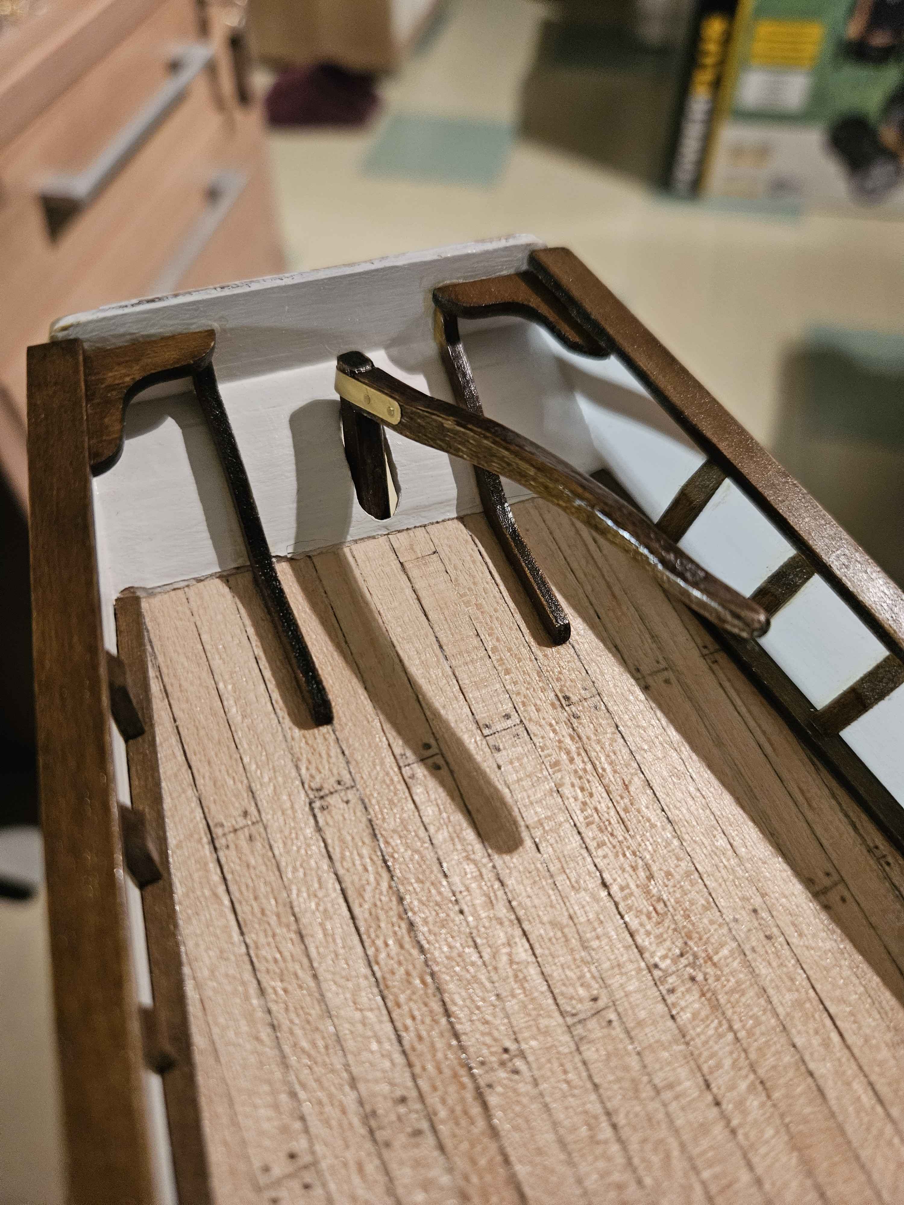

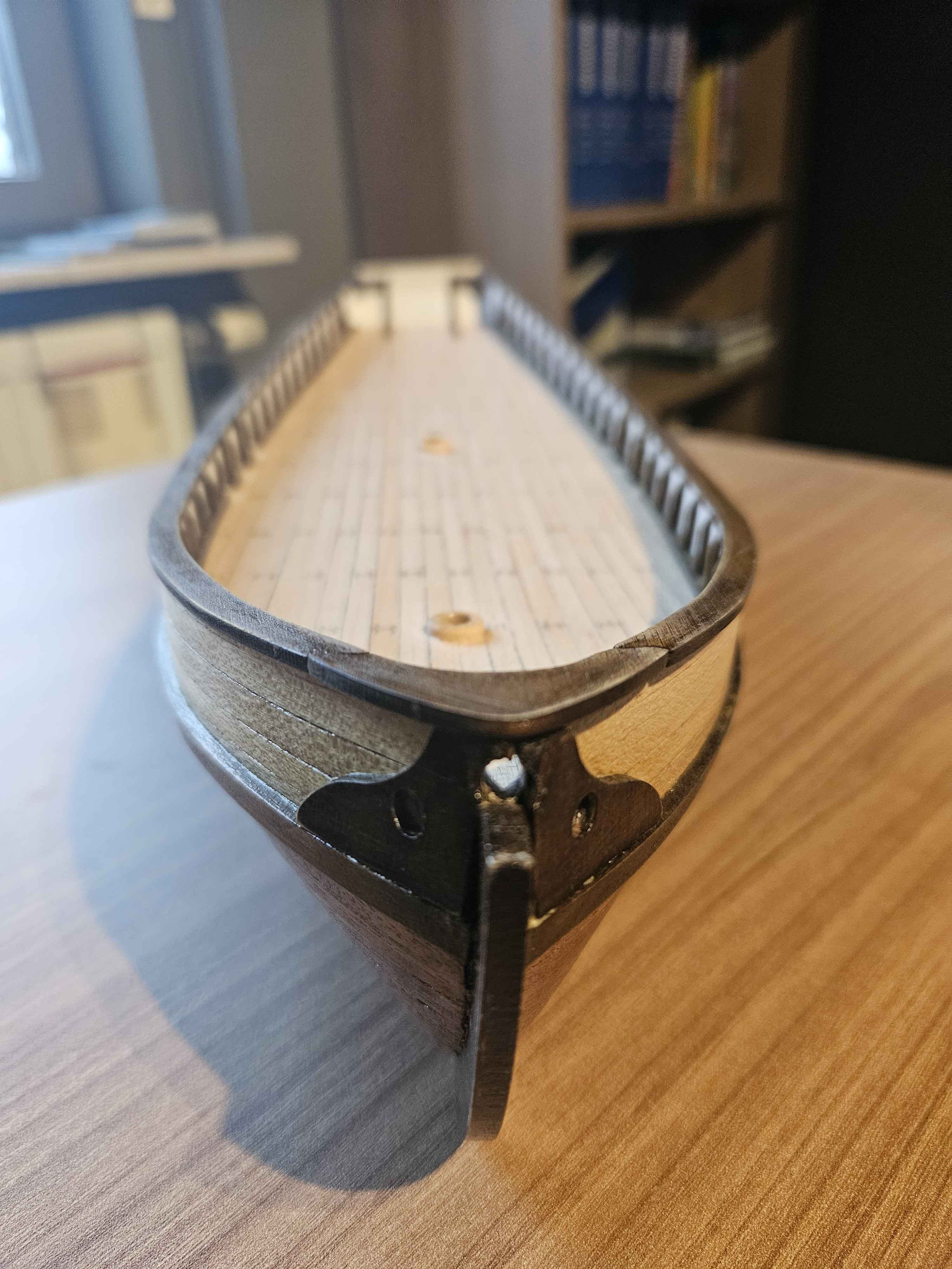

The progress has been decent over the last month.
I didn't take too many pictures so this post will be a little messy.
I glued on a few more parts like the stern post and the wales and then gave the hull 3 layers of varnish, making it look quite good!
image.thumb.jpeg.2a99ec1b1366fe3b13b324f66e034516.jpeg  image.thumb.jpeg.0a4e525a678afdb653fc4c5fc2244114.jpeg
Painting the inside of the bulwarks wasn’t much fun for me, but I did learn a lot from it. I applied two layers of primer, expecting it would make painting them white easier, but I found out the hard way that it really didn’t. In the end, it took six (!) layers of white acrylic paint to make it look somewhat decent.
After that, I glued on the footrails and the bulwark stands, having first stained them with walnut dye. I then sanded the stands at an angle. A few of them popped off while sanding, but luckily they didn’t damage the paint. It’s not perfect, but since it’s only a minor detail, I can live with it.
One thing I noticed is that when you apply white glue to walnut-stained parts, the glue turns a yellowish color, which leaves nasty marks. It was a real pain to clean and/or hide.
Finally, I glued on the rail caps and the stern trim, which was a bit tricky but not too difficult overall.
image.thumb.jpeg.f291a264c48f18d847a946ef36e27f92.jpeg  image.thumb.jpeg.9cb15d22f9f649a97dc1cd1077da8fc7.jpeg
Now onto giving the railcaps a few layers of varnish.
I made and attached the rudder and i found it suprisingly simple.
I do recommend making the opening for the rudder earlier than the instructions do, before you start painting the inside white.
Making the rudder itself didn't take too long but making the opening for it did. In the i used the dremel from Hardell to shape after first drilling a few holes with it.
image.thumb.jpeg.88e6d342e4863e6f7afec8b49299e696.jpeg  image.thumb.jpeg.3ca6abd7eeb114bb989f9d1682a426b6.jpeg
I did notice afterwards that i probably should've made the opening for the rudder a bit wider.
